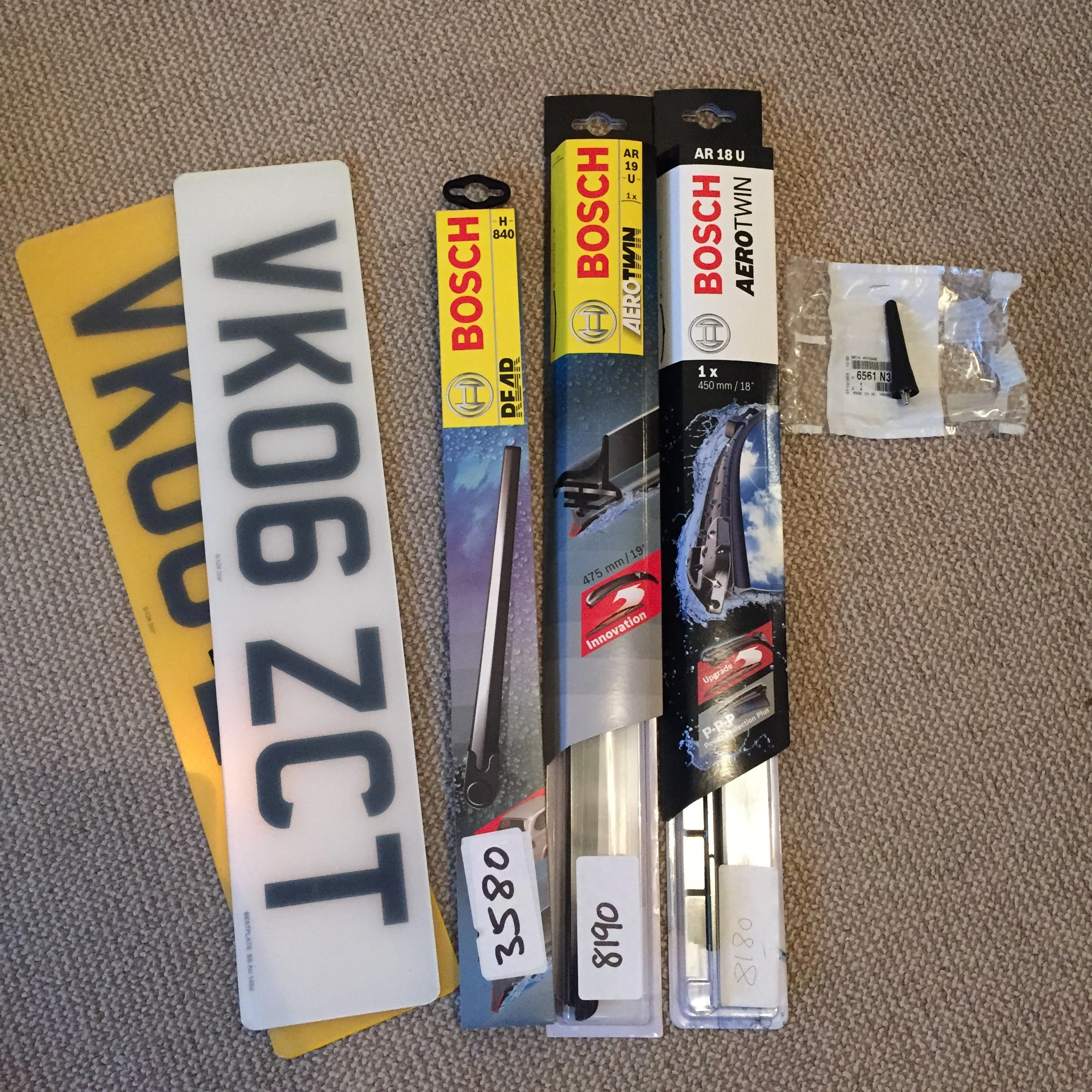

Also fitted the usual used car essentials - Really grips my s**t how people put up with smeary wiper blades.
Citroen C2 Aerial for under a fiver.

Where did you get the numberplates from? I'm after a set for mine
I used to work at a Peugeot dealer, so popped in and made them myself at the weekend 😂
You should be able to into a dealer your friendly with and providing you have proof of ownership etc, ask them to make you some 'plain' plates - I bet there cheaper than you'd expect also!
Funny you mention that, I had my mate who works in a vauxhall dealer make some up for me a few years back with 'mates rates' Bloody £25 when they are £15 on ebay and he also trapped a flys wing under the clear part of the plate!

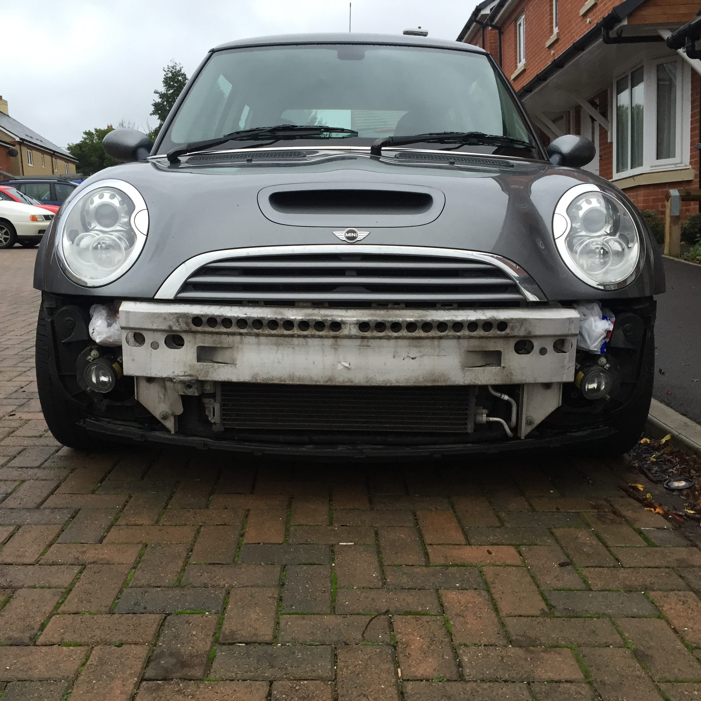

Couple of little bits to post in here.
Aero Grilles are now in/on, I really hate doing the bottom one..

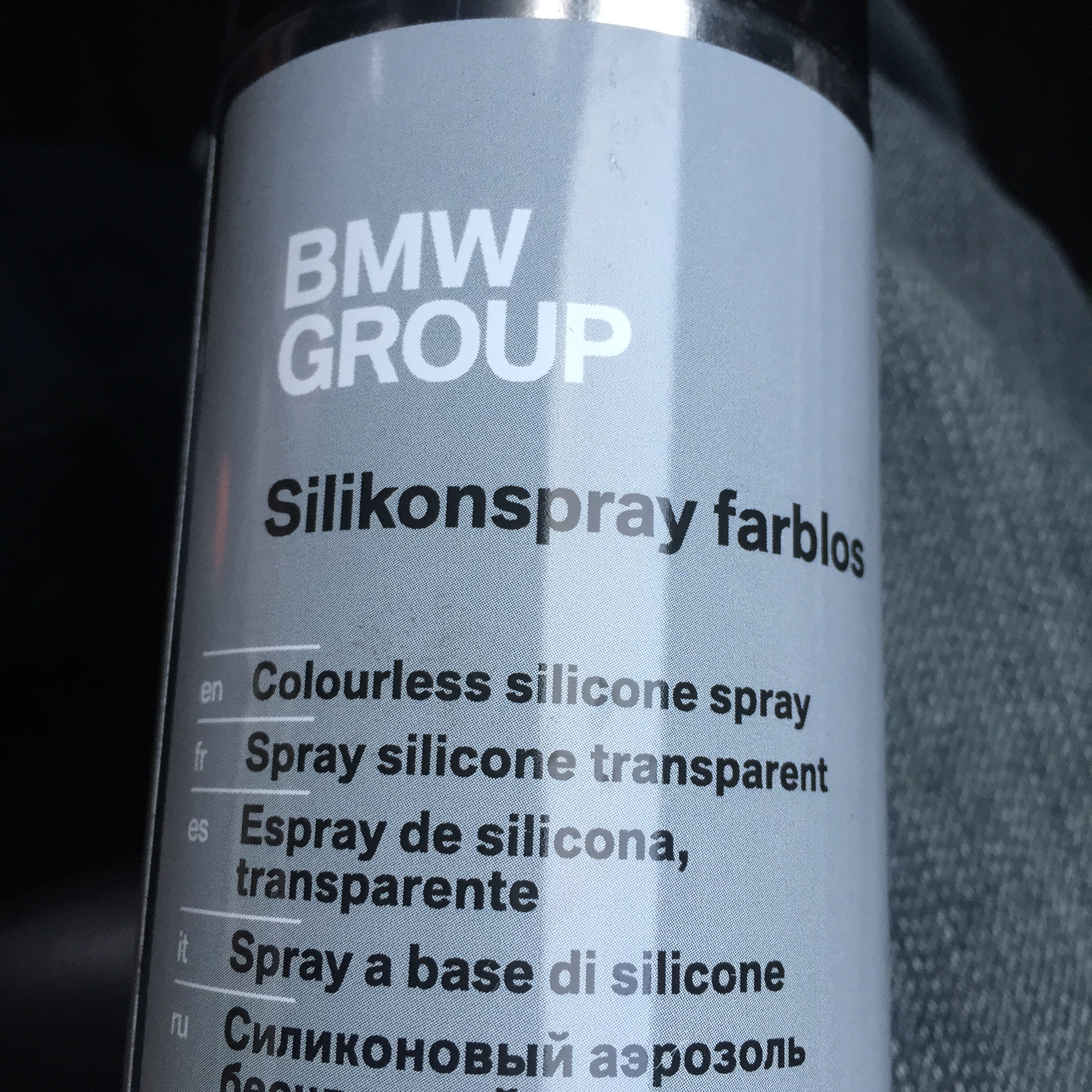

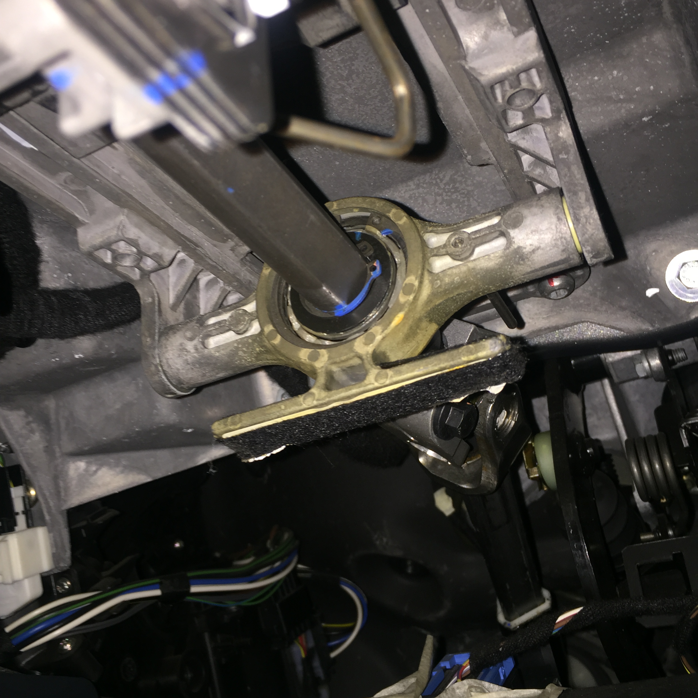

3 days after I bought the car, the steering started to 'Creak' at low speeds with left to right input..
So a brief bit of researched suggested it may be a dry bearing situated on the steering column.
Armed with this stuff (BMW Silicone Spray - Such a nice product) I doused the bearing whilst turning the wheel side to side - Problem Solved.

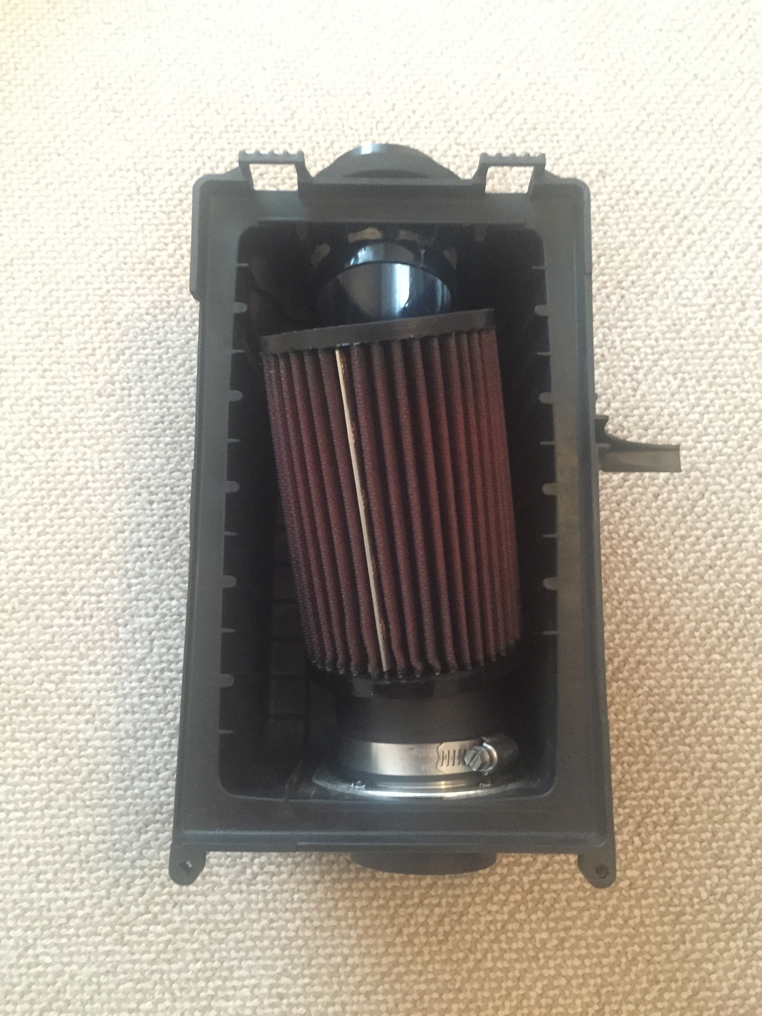

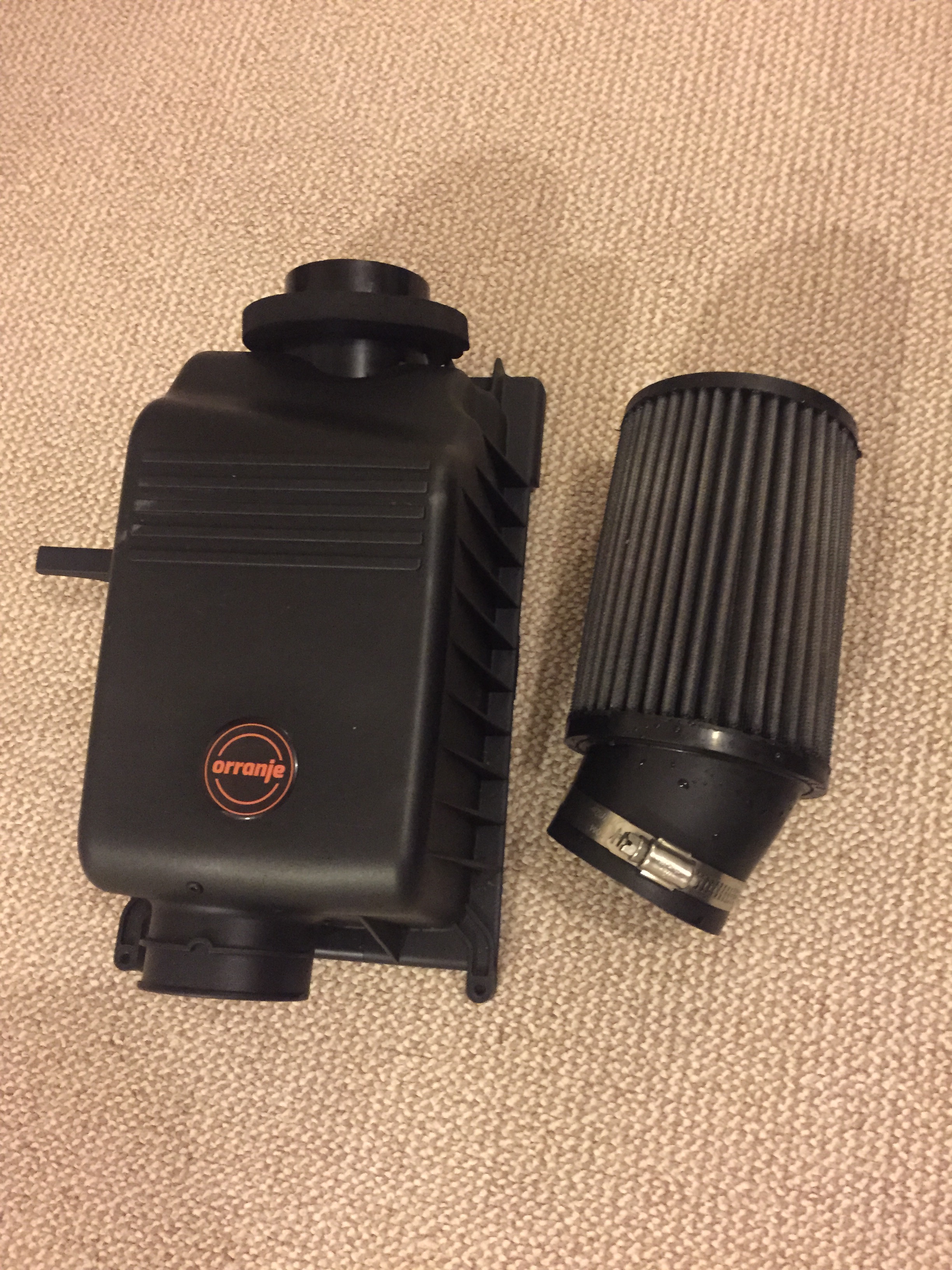

Oh and a 2nd hand Orranje Stealth Airbox has arrived, which I'm just in the process of giving the filter a clean and re-oil before fitting. (Filter had just had a bath at this point)

My steering rack is creaking too, where is the bearing that needs greasing? Do you have to remove anything? It's annoying me and garage want £500 to replace
  Peugeot 308
Lower the steering wheel, Remove the lower steering column plastics and you should be able to see and access the bearing (If using anything else rather than an aerosol tin, you may struggle to get in contact with the bearing without removing the steering wheel).

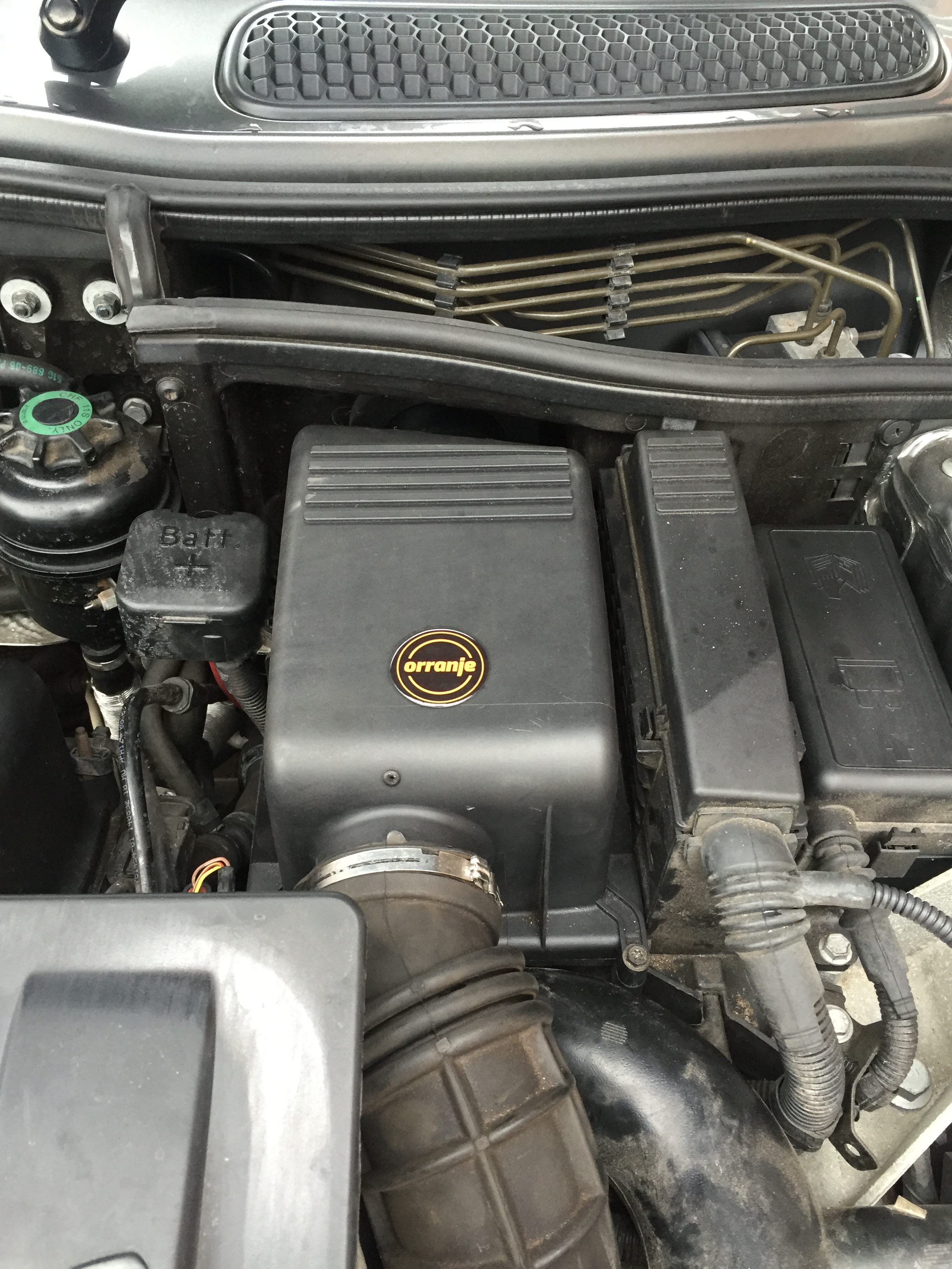

So got a couple bits and bobs done over the weekend / this morning;
Cleaned and fitted the Orranje Stealth Airbox - That included hole-cutting an 8cm circle into the bulkhead for the additional feed.
Yes, the bay needs a good cleaning!!

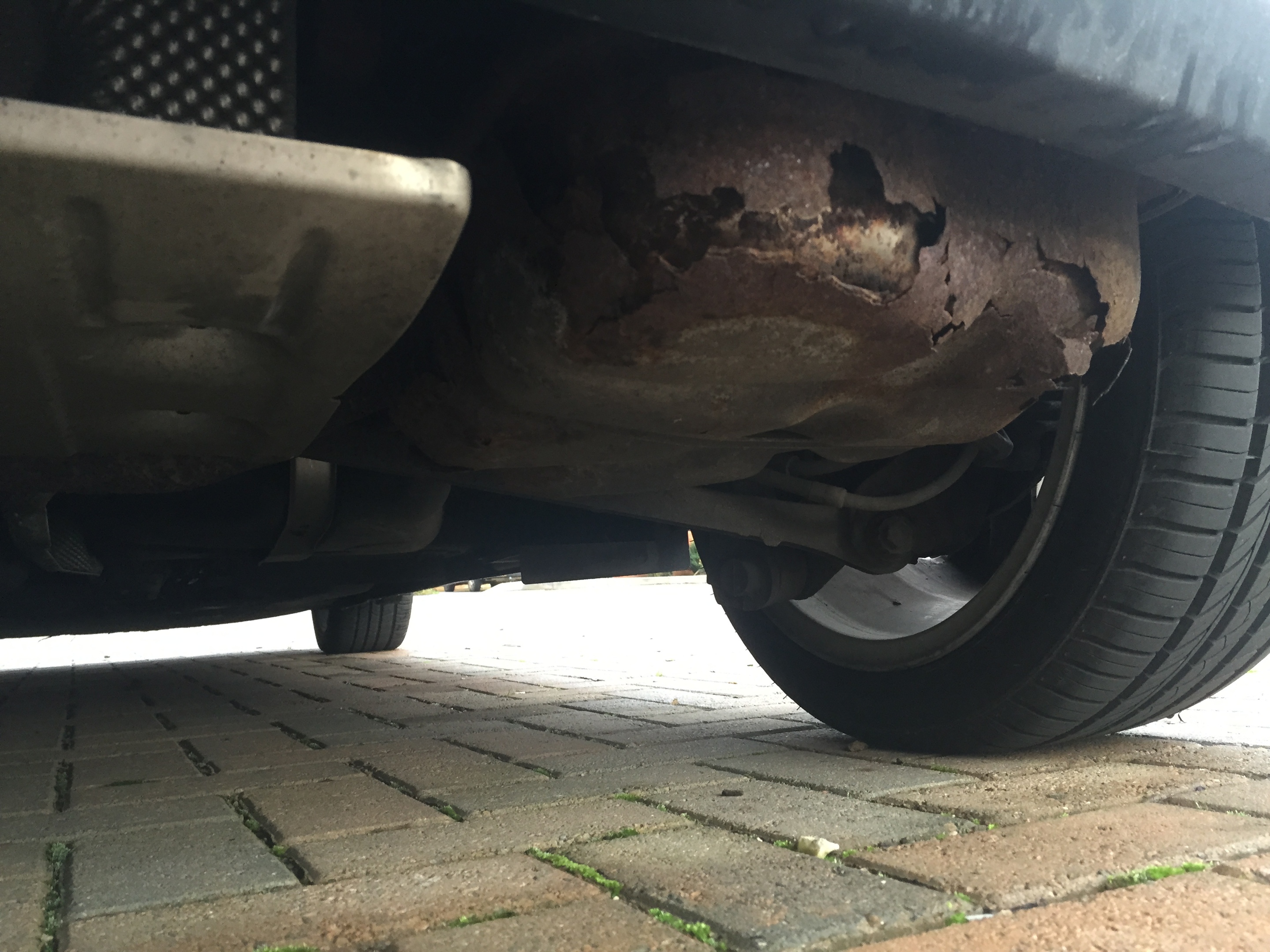

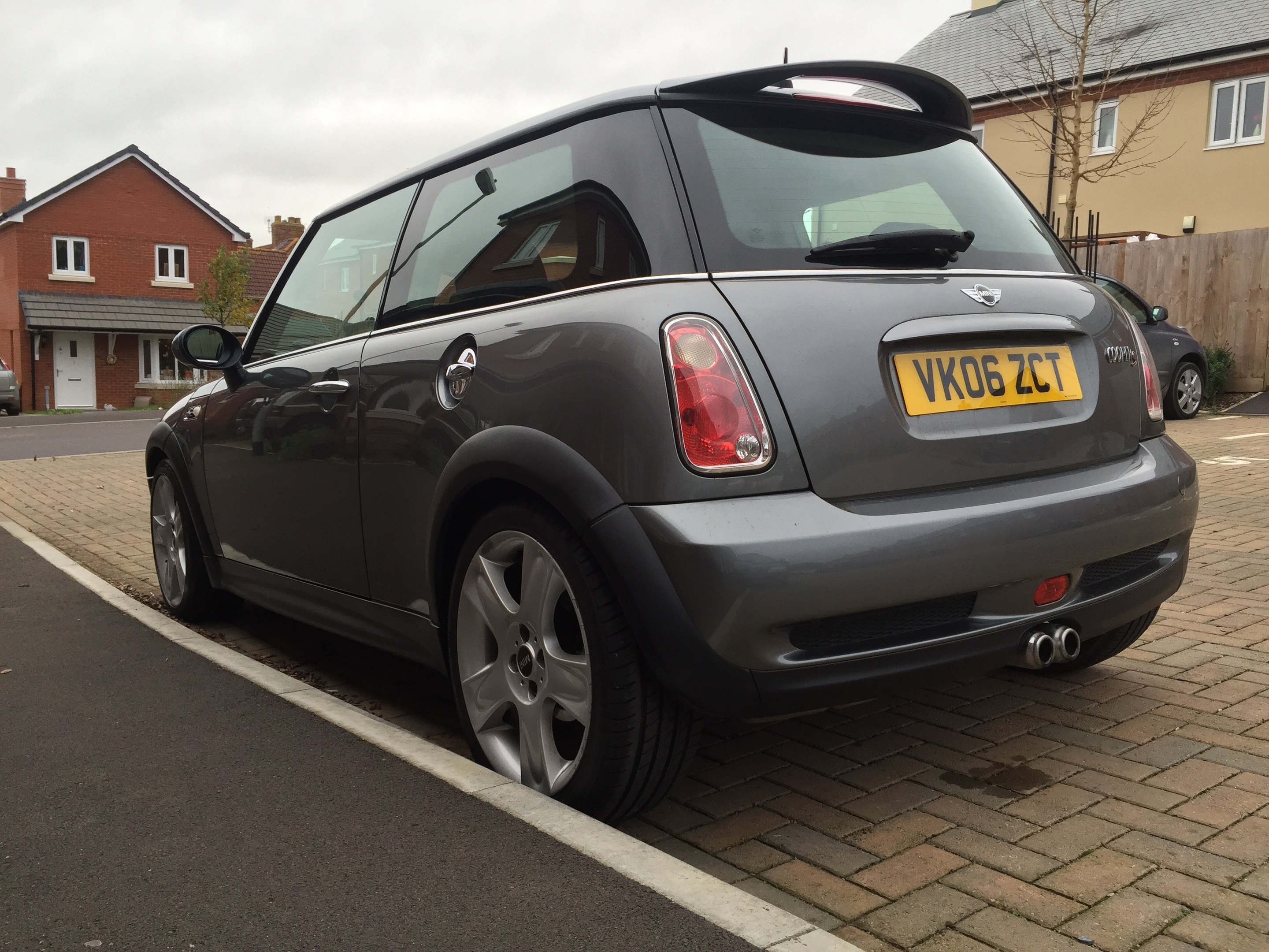

Today, the car was booked in for the 'One-Ball' Mod - The usual silencer looked shabby from the outside, yet the guy who done the work said once he was taking it off the car, it pretty much started to crumble in his hands.
Nice little weight saving, tidy up and some extra popping/noise.

Orranje Stealth Airbox - nice mod - you have to cut an 8cm extra hole in the bulkhead for the extra cold air feed!?!?!?!?!?

Yep 8cm to get the airfeed pipe through snuggly. 😅😅

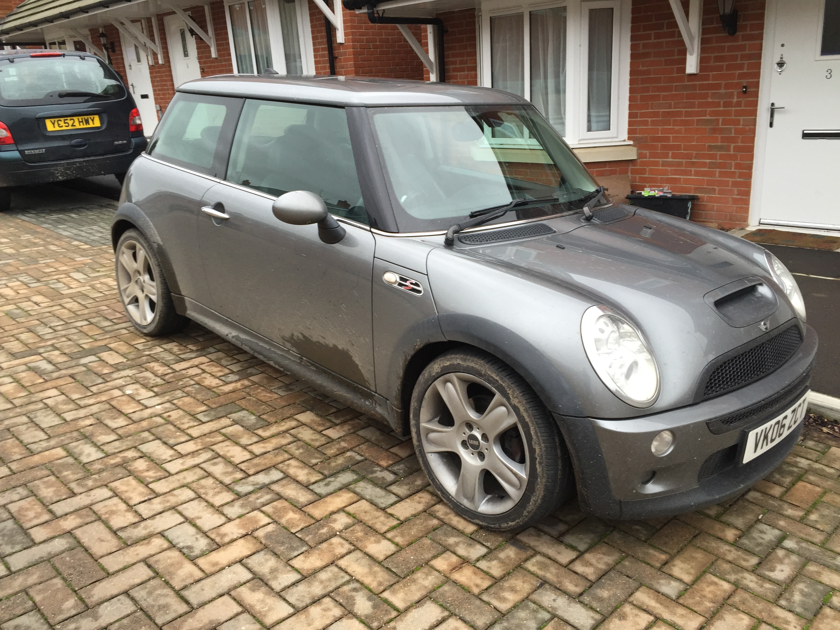

Gave the car a quick clean up today after a weekend of fun.
Being the 1st time I've actually cleaned it, it's come up better than I thought it would! - Result!
Starting to really enjoy the car, took a little while to get used to the heavier steering and man-ly gear change consider everything I've driven in the past 3 years has been newer if not new.
