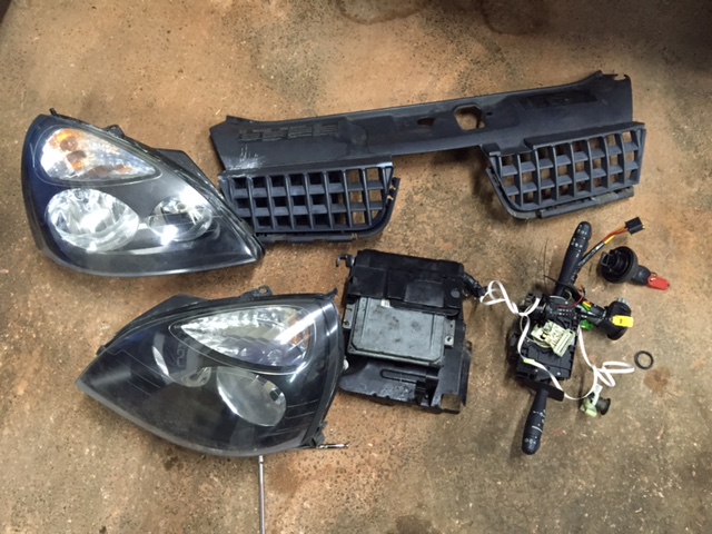

Thanks to @RetroTed for the Grill, Headlights and ECU changeover parts below
I believe its all there, if anyone can see anything missing, please let me know :grin:
These parts are hopefully arriving this week

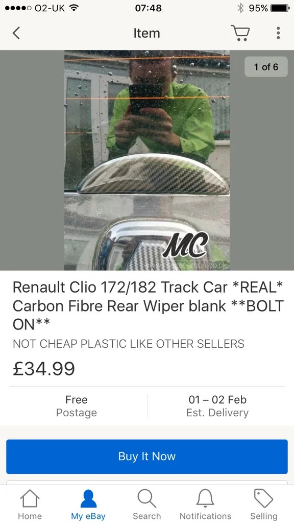

Once I've finally got the Rear Wiper arm off the car what would you recommend
just a grommet or should I go for something like this
Also awaiting delivery of the @RichValver Washer Jet Grommets
A nice cheap alternative :up:

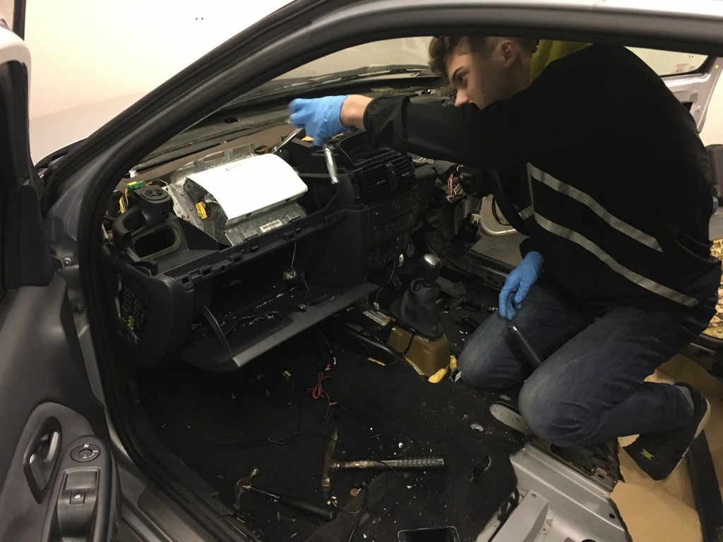

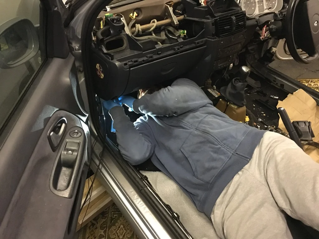

Not to bore you all too much, but the front seats came out, as did most of the dash.
Here's the lad taking out the Airbag after we had battled with the dash.

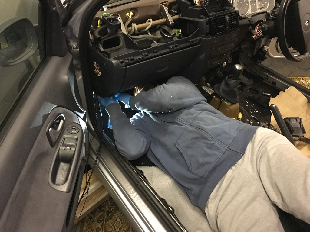

We made a nice comfy bed!....Errr......This is not a comfy place:neutral:

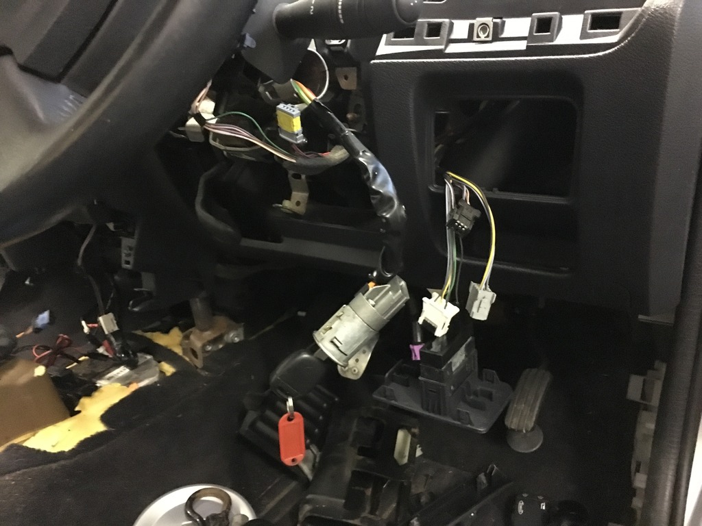

This was for me to see where and how the UCH was mounted, and took it out.

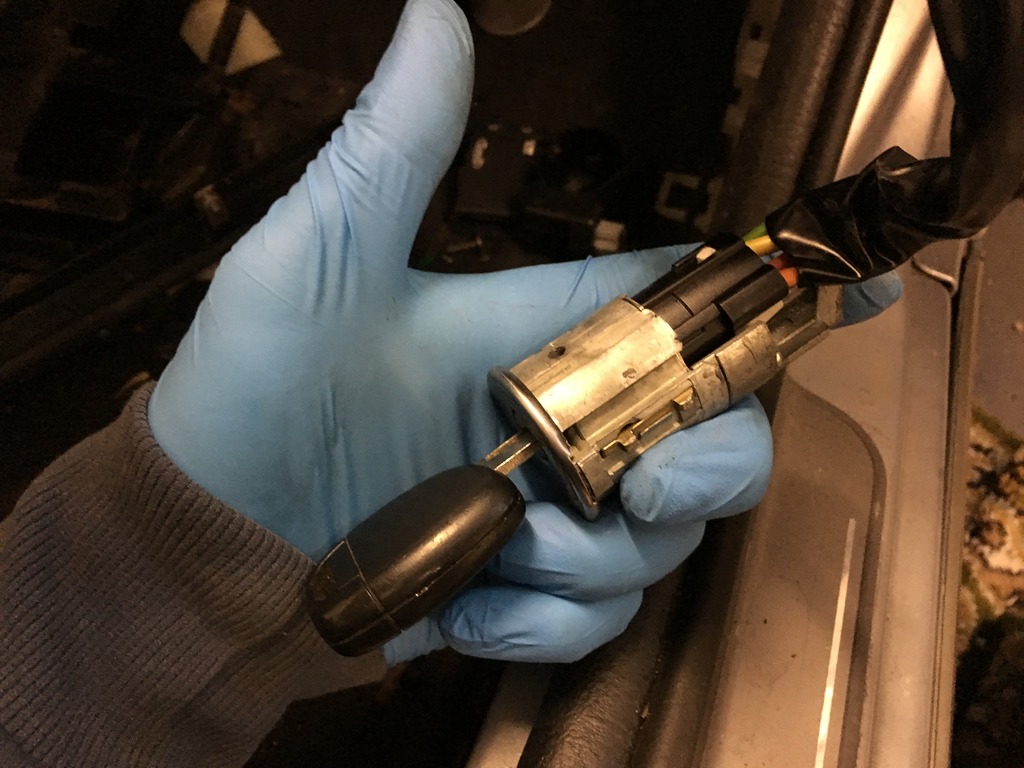

Then moved onto the Ignition barell
Old unit out
Again, we had support from an old CS thread for this
Don't forget to put the key in the ignition peeps 🙈
New unit going in.
Learnt my lesson about the key didn't I 😂

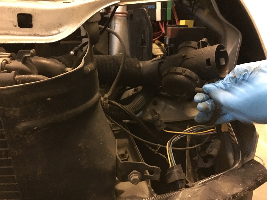

The lad then got rid of the air feed pipe.
He likes the idea of modding a headlight for airflow, so we may venture into that.

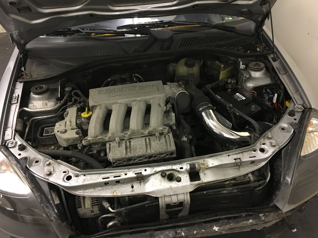

With all the bits I'd accumulated over the last few weeks, it was time to fit them
Headlights went in, as did the RamAir Kit
Engine cover came off #BecauseRaceCar 😂😂
