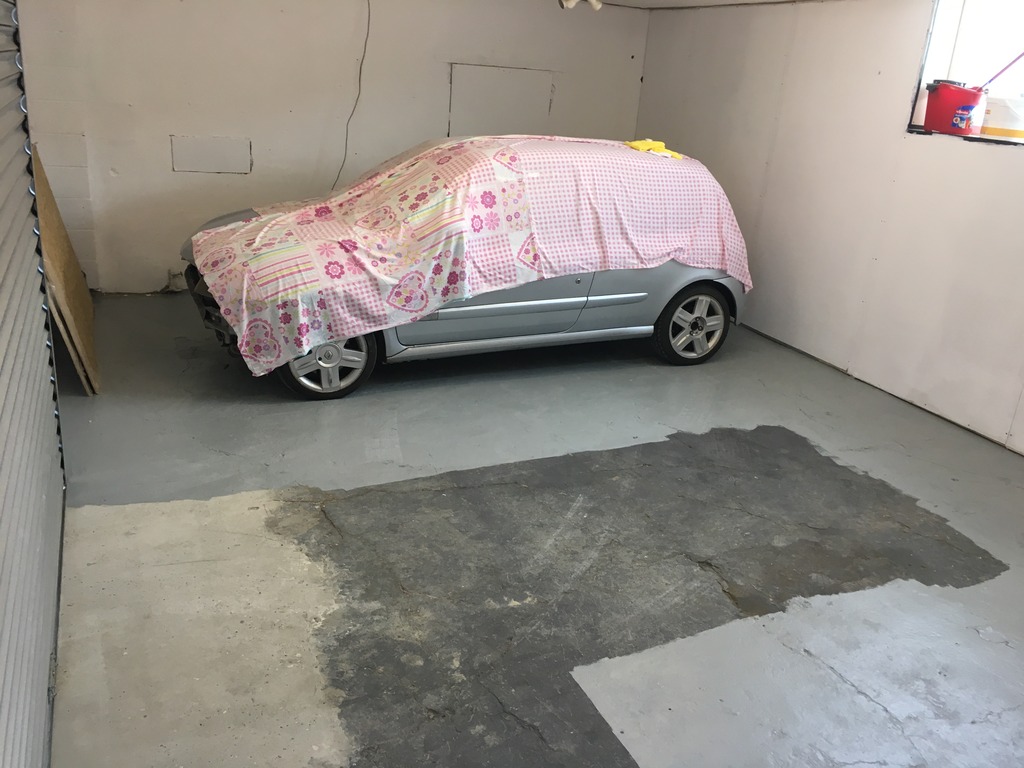

🙈😂😂.... my wife almost killed me!
Her words "Those are the girls first matching bed set"
My words "Well there about to be mismatched with paint on" 😂
I don't like car covers, and I'd certainly NEVER put any thing on a car I was detailing etc... but i had an epic fail moment when I lifted the paint pot up the other night 😂

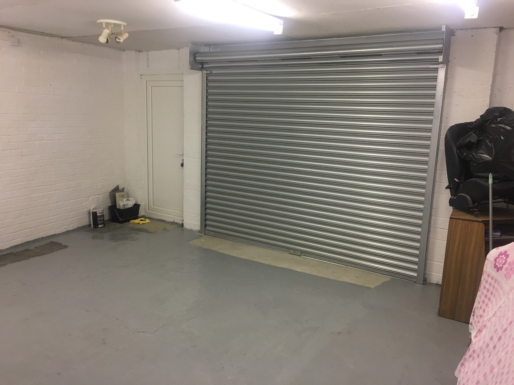

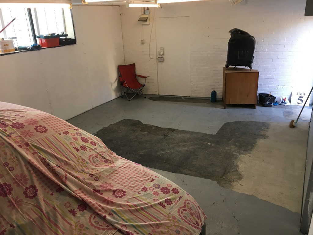

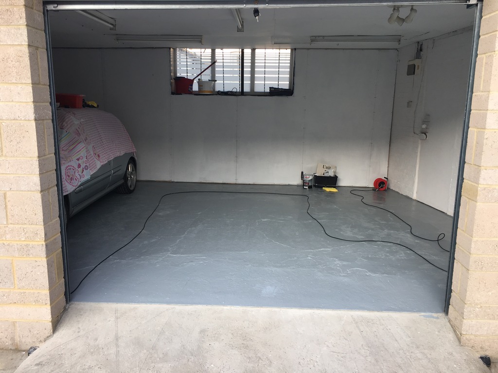

Went down to the Unit this morning (04:30) and got a load more painting done.
I still needed a walkway to the light switch and I'll be painting the shutter door area in due course.
That's all for now, I shall hopefully have some parts on order very soon :blush:

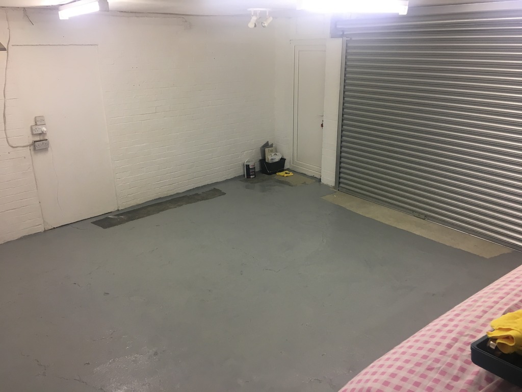

Morning all...
Just got in from a brief visit to the unit this morning.
I've painted all of the 'Walkway' patches and I've got a small amount of the floor paint left for any touch ups that'll need to be done. :up:
The extension cord was a WARNING guide for me... DONT CROSS THIS LINE THE PAINT IS WET!😂

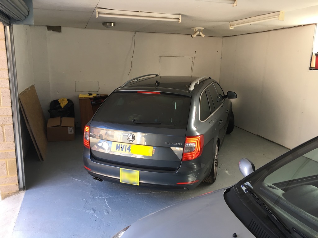

I popped down to the lock up in the race bus earlier, just to see what painting still needed to be touched in before I fill it up with car parts :laughing:
There are only two small sections that I should have enough in the tin to do.

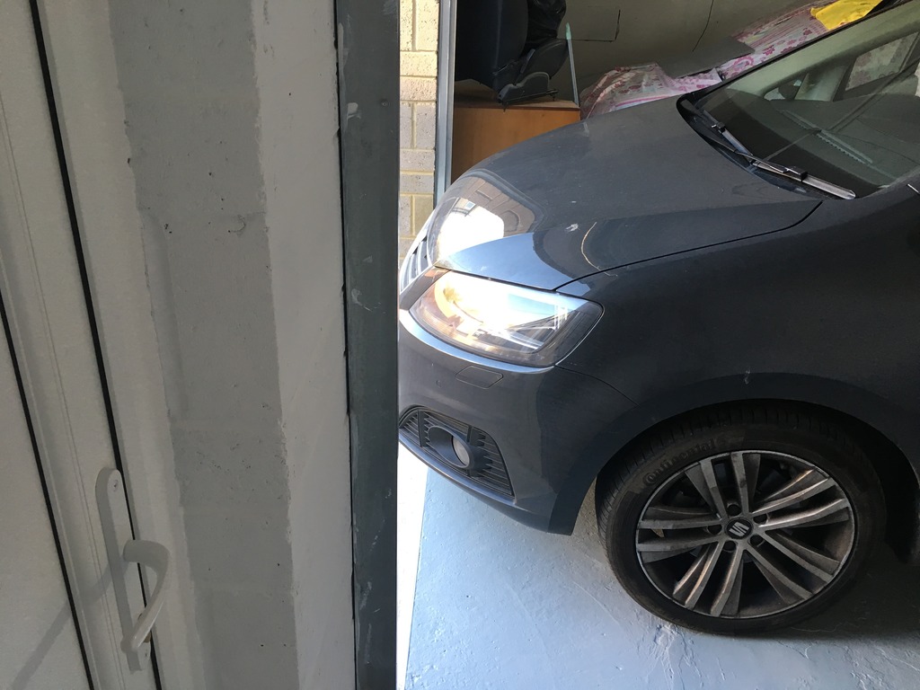

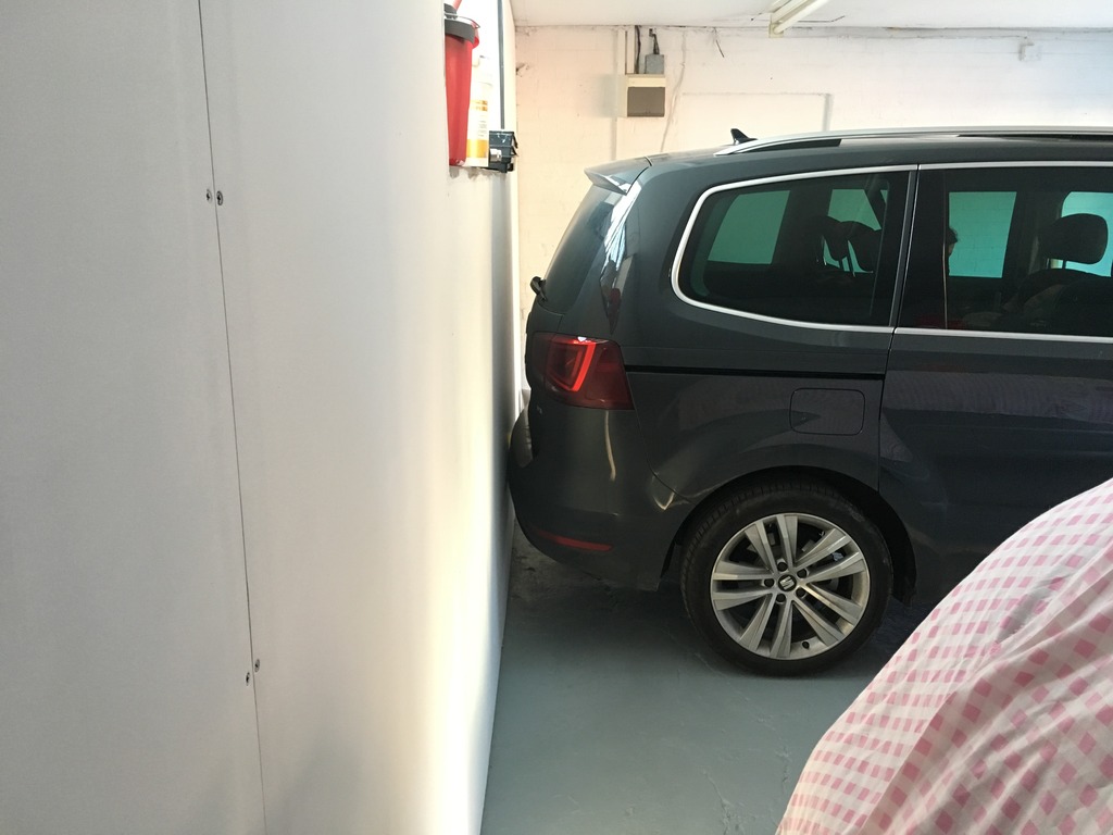

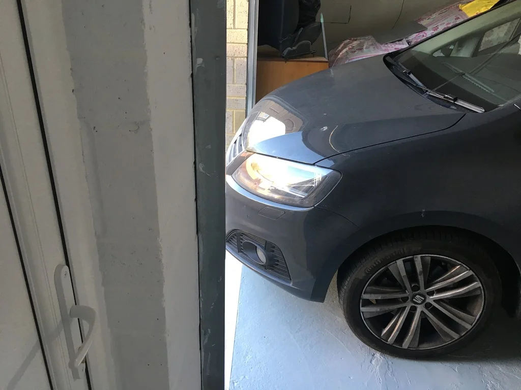

Whilst I was there, I wanted to see whether the Alhambra would go in straight.
Results
That's a NO then...Literally a foot!
Not to worry though as there is plenty of space in the lock up and I'm not likely to have the Superb or the Alhambra in the lock up very often, it'll be only for Detailing purposes.
Hopefully I'll get them both in with a bit of Jiggery Pokery :up:

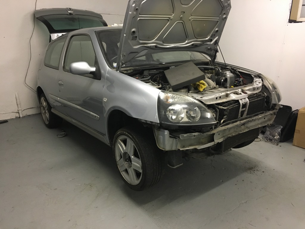

On Monday after much bartering, I finally placed an order with DemonTweeks.
I then went to the lock up with all of my gear and set about getting settled in.
Firstly, moved the Clio to the other side and then swung the Superb in.
I built the two shelves that I'd ordered, these are great value for money. Once I'd done that and emptied the Superb, I loaded the Superb with pretty much every interior part except the dash!!

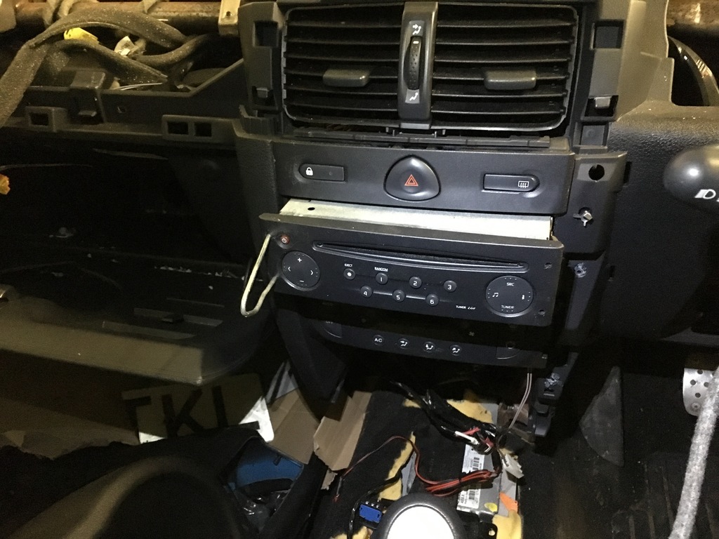

I then set about tidying & labelling up wires so I'd have a good chance at starting the car once I'd finished cutting.

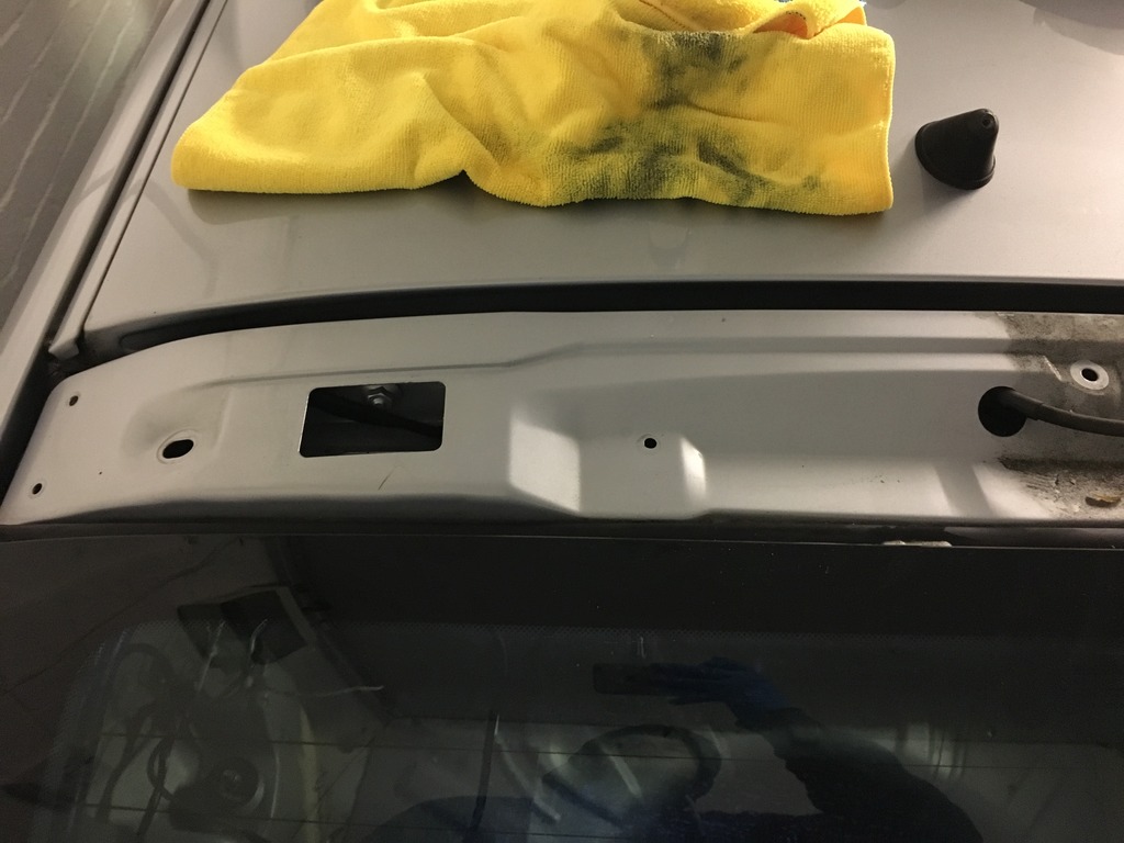

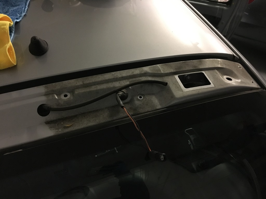

Whilst I tidied the rear wiring, I took the spoiler off so I could get rid of the pipe work for the rear washer jet, then gave the area a good clean. I also cut the wiring to the Aerial as I won't need it and I also cleaned underneath that also.
I then made my way to the front, came across a few issues but I made SLOW progress.
Progress was slow as I was labelling every connector possible, mainly so that I A) Knew what it was for and B) Ideally I don't cut the wrong wires 🙈

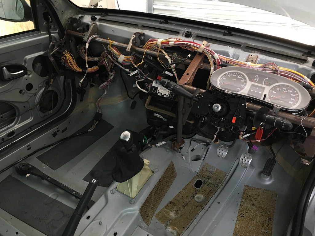

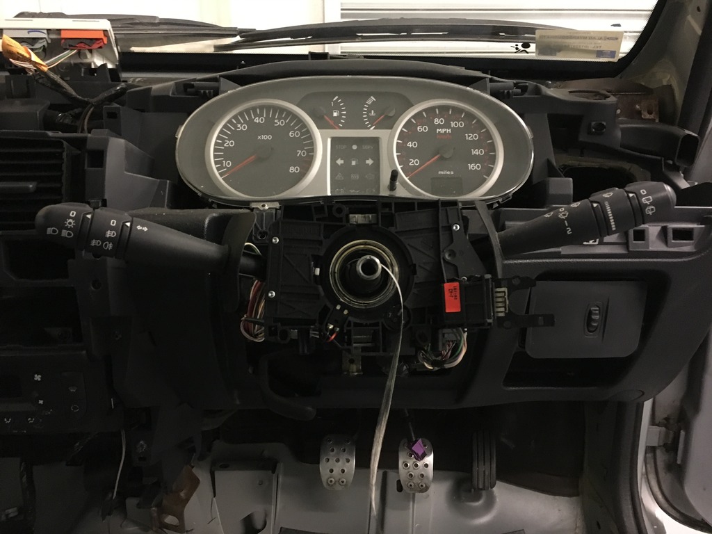

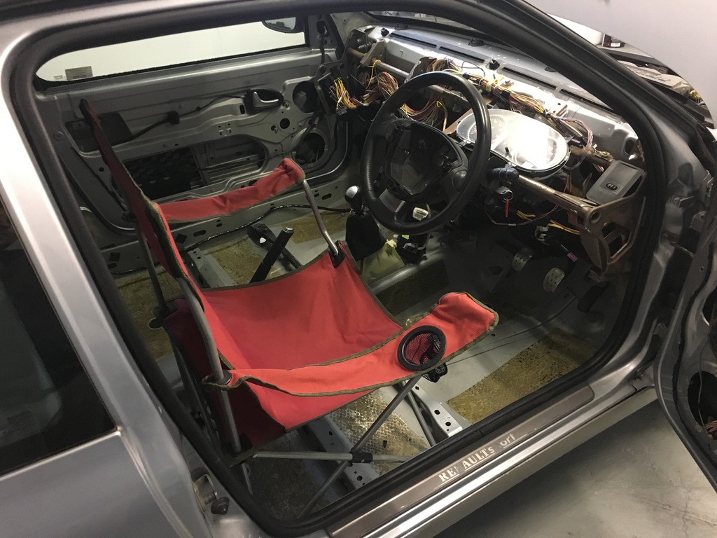

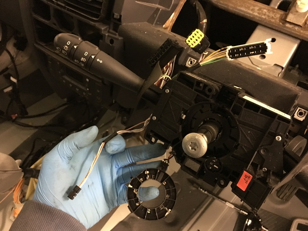

Head unit coming out
Airbag out

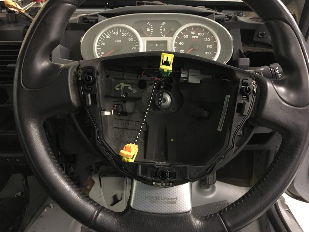

I then got the steering wheel off.
Labelling these I took a guess that...
Black top left plug is headlights & indicators
Yellow - Airbag???
White - wipers
Then there's the two I'm holding???
No idea if I need to keep them or what they're for???
That was the last picture I took tonight... but I got quite a lot more done.

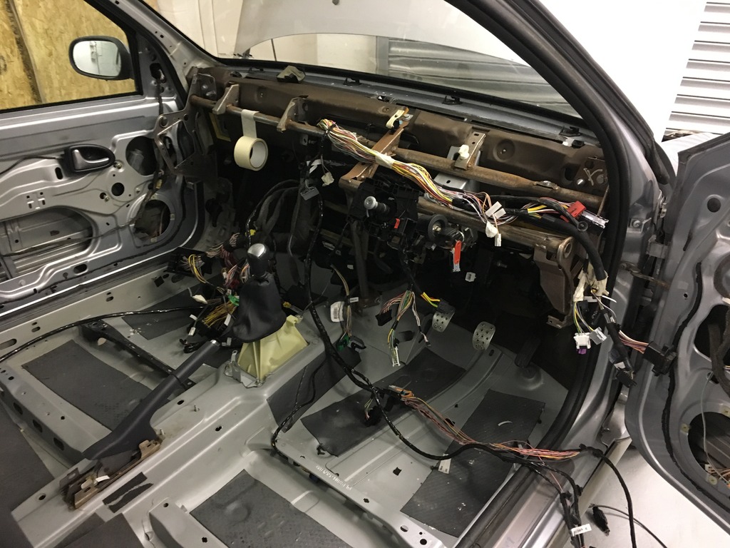

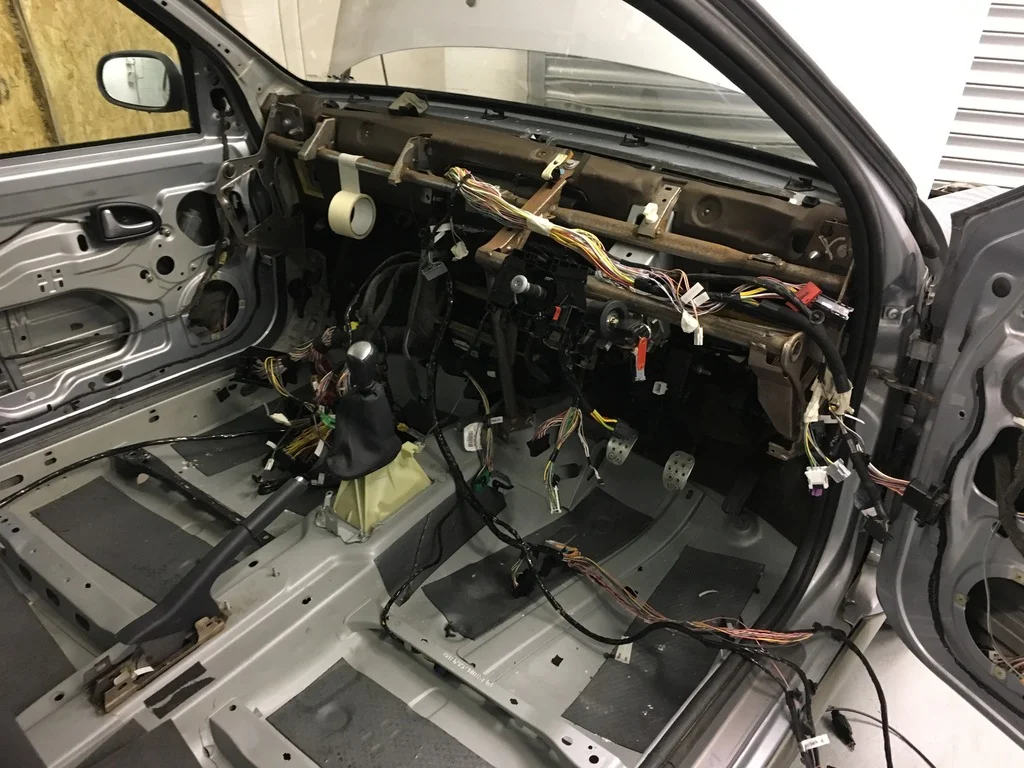

- Upper and Lower Dash are both out
- All wires are labelled (except ones I have no idea what they're for)
- Interior loom is out (Well I say out, it's still in the car being held in by the alarm wiring)
- Wipers Removed
- Scuttle Removed
- Washer bottle out (Needs cleaning)
Next
- Cut as much loom out as possible, being very careful along the way.
- Decide If I want the lower dash put back in.

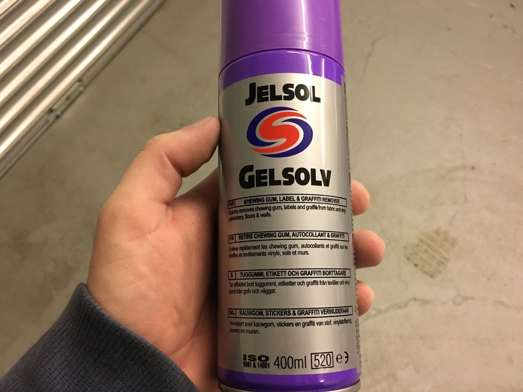

- Get sticky! & Remove sound deadening
- Clean Interior
- Re-fit dieted wiring Loom
- Start the car and hope for the best 😂

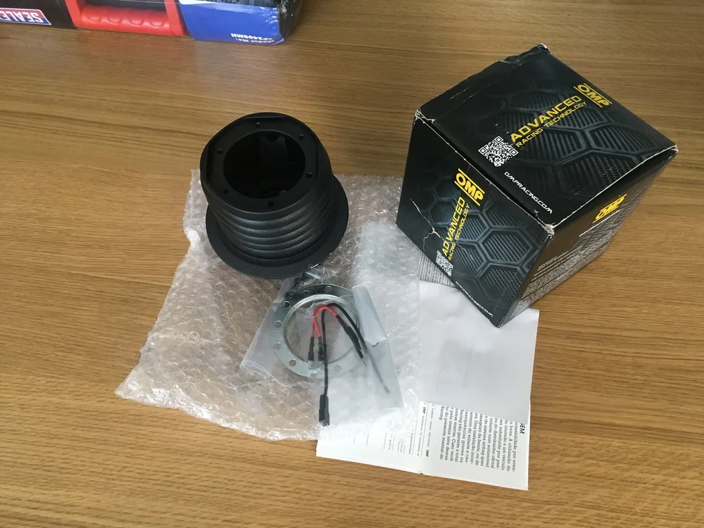

Here's what I've bought so far...:hearteyes:

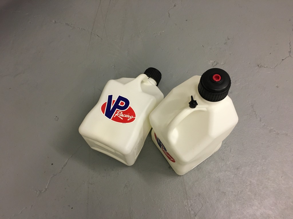

Spare fuel for track days :up:
Aerocatch set... Shall I order a Fibreglass bonnet :tonguewink:

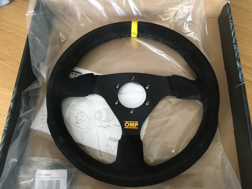

OMP Targa Suede :hearteyes:
OMP Boss kit

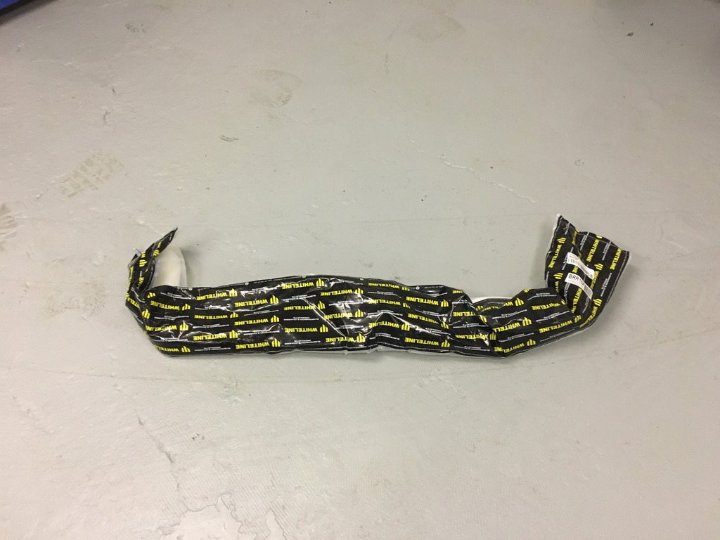

Whiteline RARB

Superb progress mate, very jealous of your little unit :)
No reason why you couldn't use a pot spec washer bottle with just the one pump, these pumps are different to sport ones so make sure you get one with a pump attached.
I'd hazard a guess the wiring on the left of your hand would be for radio controls, and the right is part of the steering angle sensor?? (I've never taken one of these off so can't be certain I'm afraid) if the one on the left is for radio Co tools then you should be able to follow it back to the centre dash display and unclip out the back of said unit
Ads
I think I'm just going to disconnect the pump for the headlamp washer jets, then ill blank the rear hose off.
If I get serious in terms of weight reduction in the engine bay, I shall probably modify a plastic carton :laughing:😂
If they're radio controls they'll be coming out. As for the circular part... if this is a sensor, will it matter if it disappears?? :grin:

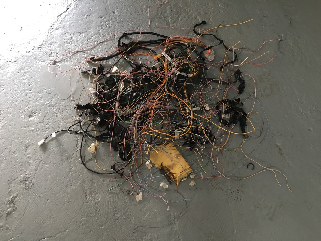

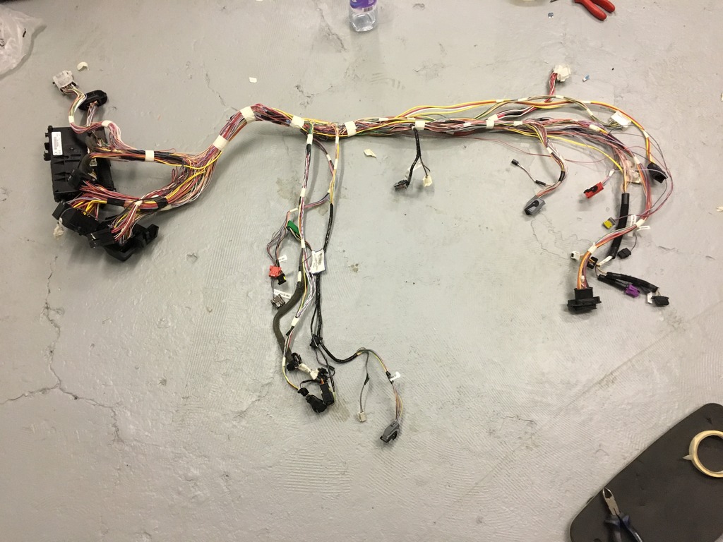

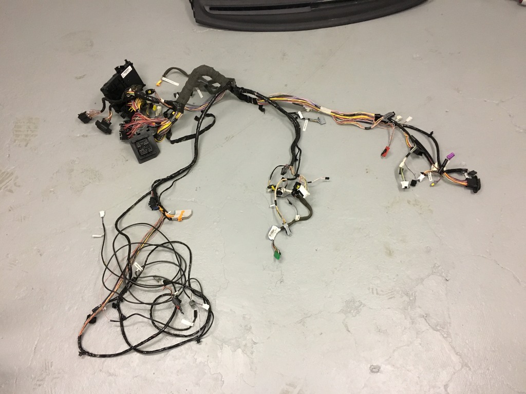

Last night I got the wiring out of the car.
I'd labelled all of the connectors whilst it was in the car to make things easier.
Anything that I was getting rid of was simply cut out.
About to get the wiring out
Loom out :up:
Wires cut out
Chopped loom

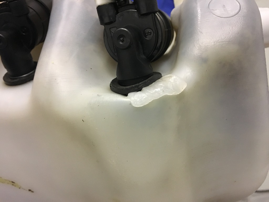

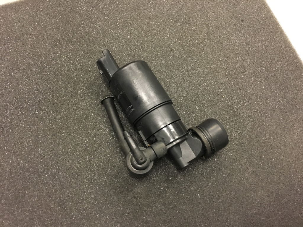

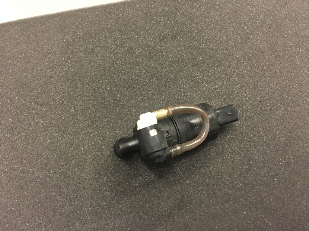

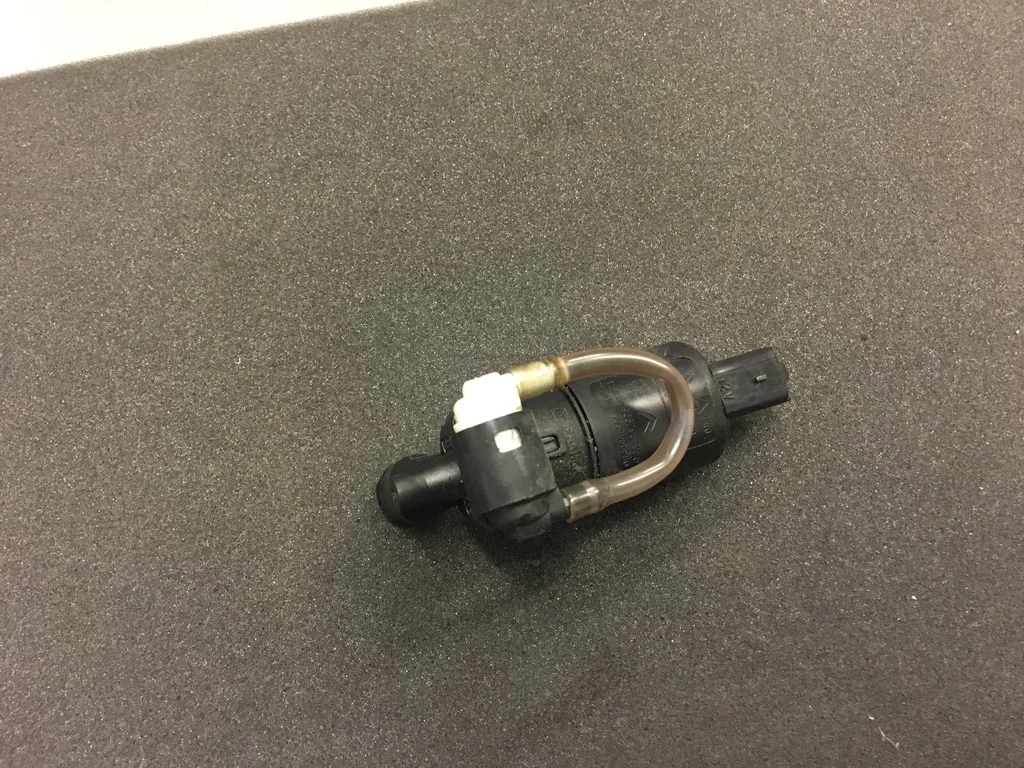

Before I put the loom back in, I wanted to see where my washer bottle was leaking from.
Sure enough it's sprit by the front washer jet motor
I tried a Plastic bodge, but it was never going to work, I just had nothing to loose in trying.
So, New washer bottle is needed.
Whilst I was there I blanked off the motors

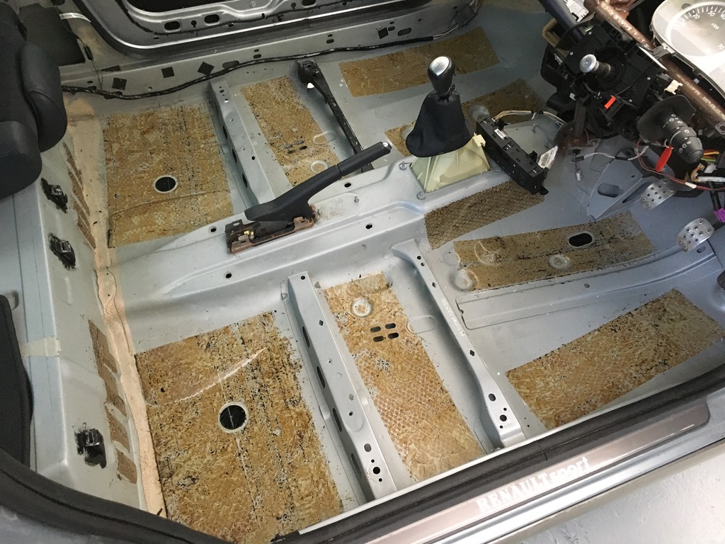

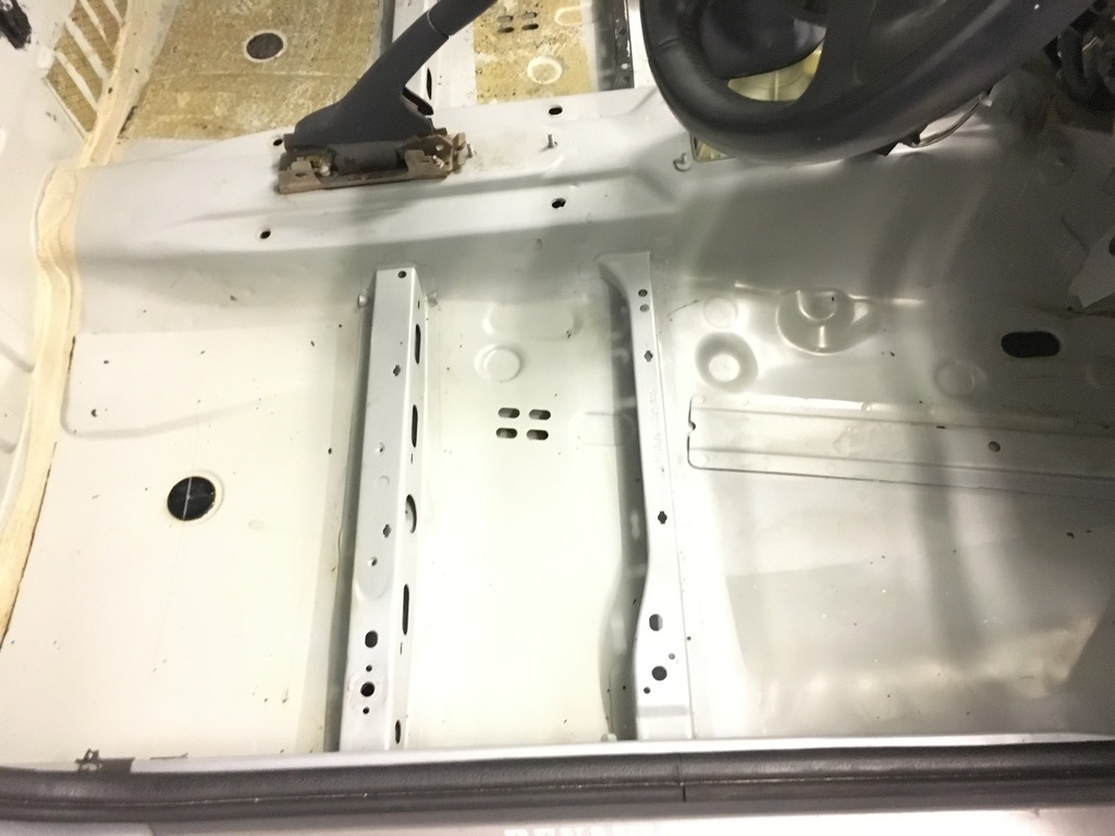

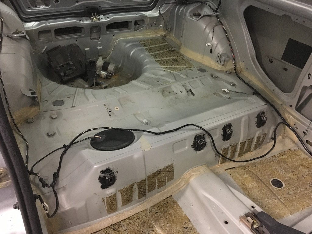

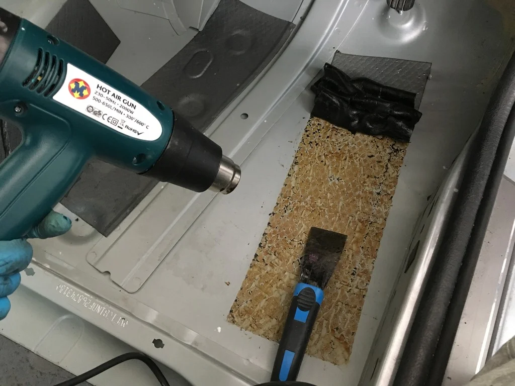

I then had to get the sound deadening off the floor and into the bin :smile:
Trying to get as much done inside the car as possible, before the seats and mounts go in

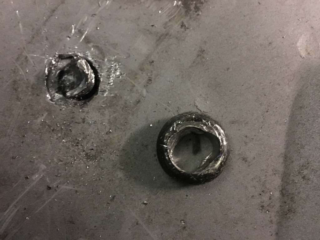

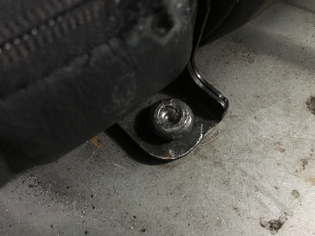

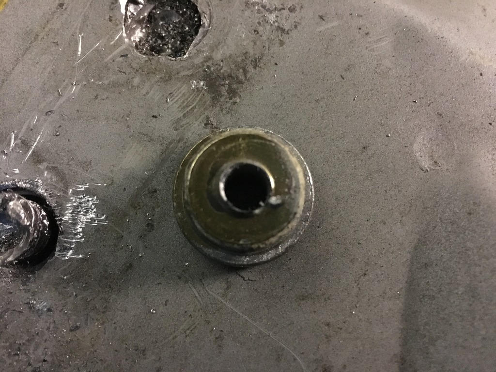

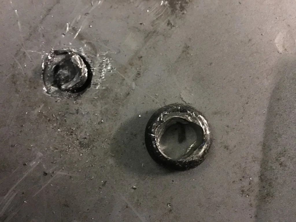

Also got a little further with this bolt!
I'd really like to drill it out as I really don't want it to be sticking out, but it's being a pain in the arse, so a grinder will be on order shortly, so I can get rid of this bench!
That was the last thing I did with the car last night (yesterday morning for all you normal people)

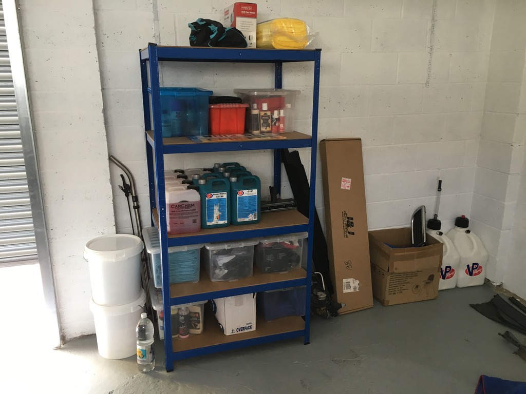

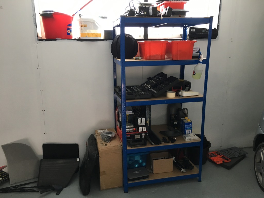

Also thought I'd show you the Shelving units. I am really happy with them :smile:
(Also the goodies on the shelves :up:)

good to know how you get on with that bolt. I'm collecting a roll cage over weekend, and after my MOT early May the rear seats are coming out too, and guessing i'll battle this bolt as well
Be handy to see how you deal with it
I'll be ordering a grinder very shortly 😂
That's the last resort now I think 🙈

How much have you cut out and did you just follow the wiring to a plug and cut it off flush to the plug?
Good progress being made!! :up:
I'm in the middle of tackling the wiring on my cup. Was thinking about cutting the alarm and all the crash sensors out but worried it wouldn't start after haha.
Airbag loom, Speakers, Radio, Centre dash display & Alarm.
I think that's it:laughing:
  dan's cast offs.
Do they pull out easily then?
Not in my experience... maybe I'm doing something wrong, but at the bulkhead end of the cabling, mine didn't want to pull out easily.
Would have bee good if it had though.
you can get a proper tool for getting them out, generally just held in by a little tag. if you're like me you can do it the cheapskate way and use pins or paper clips!!
  Clio 182, EvoX FQ360

Seats will be here 16th May
Wheels will be ordered shortly as I've not managed to find any elsewhere
So.....
I've got these two bolts out of the car now...
Leaving me with a nice empty interior
What a mission that was with only a drill at hand....
I'll be tidying up the rest of the mess shortly
I had a little bit of Jelsol left and thought I'd give it a go on the remaining tar/Glue on the car...
let's just say.. LIGHT WORK!!
This stuff is brilliant for the remaining tar and glue and I always recommend it to EVERYONE!!
Spray on and seconds later, wipe off
Went from this
To this... in about 10 minutes
There are a few areas that I'll need to go over again but I had a very little amount left so just did what I could.
I've order more and that'll arrive over the next few days.
I then got the wiring all back in after my recent alarm removal.
The car DIDNT START!
I shat myself thinking I'd fucked it all up...
I then look inside the car and spot the Earth strap that I deliberately leave off (my way of immobilising the car)
I got the car started
Moved it to a better location in the workshop
Mainly so that I can sort anything underneath the car, but I can also get the Corsa in too now
The car is now up on two stands and will be up on the other two later tonight.
I've removed the carbon canister...
(no idea what I removed from behind the N/S bumper no though, as I thought it was the carbon canister 🙈 )

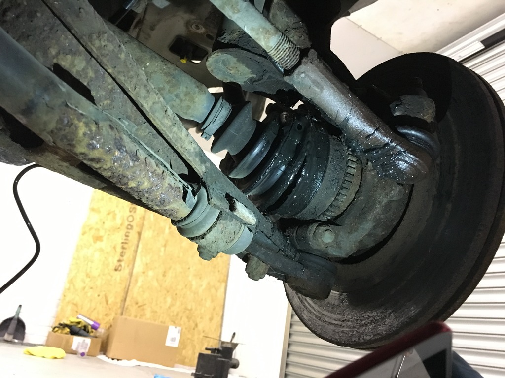

Need a new CV Boot (possibly the joint too) on the O/S

Only trouble I've got when that seat is in the car..... I can't close the door :laughing:😂
Should've seen me trying to steer the car, whilst holding the door and trying my Dan hardest not to hit the nice fresh shutter door as I couldn't see out of the drivers side wing mirror 🙈
