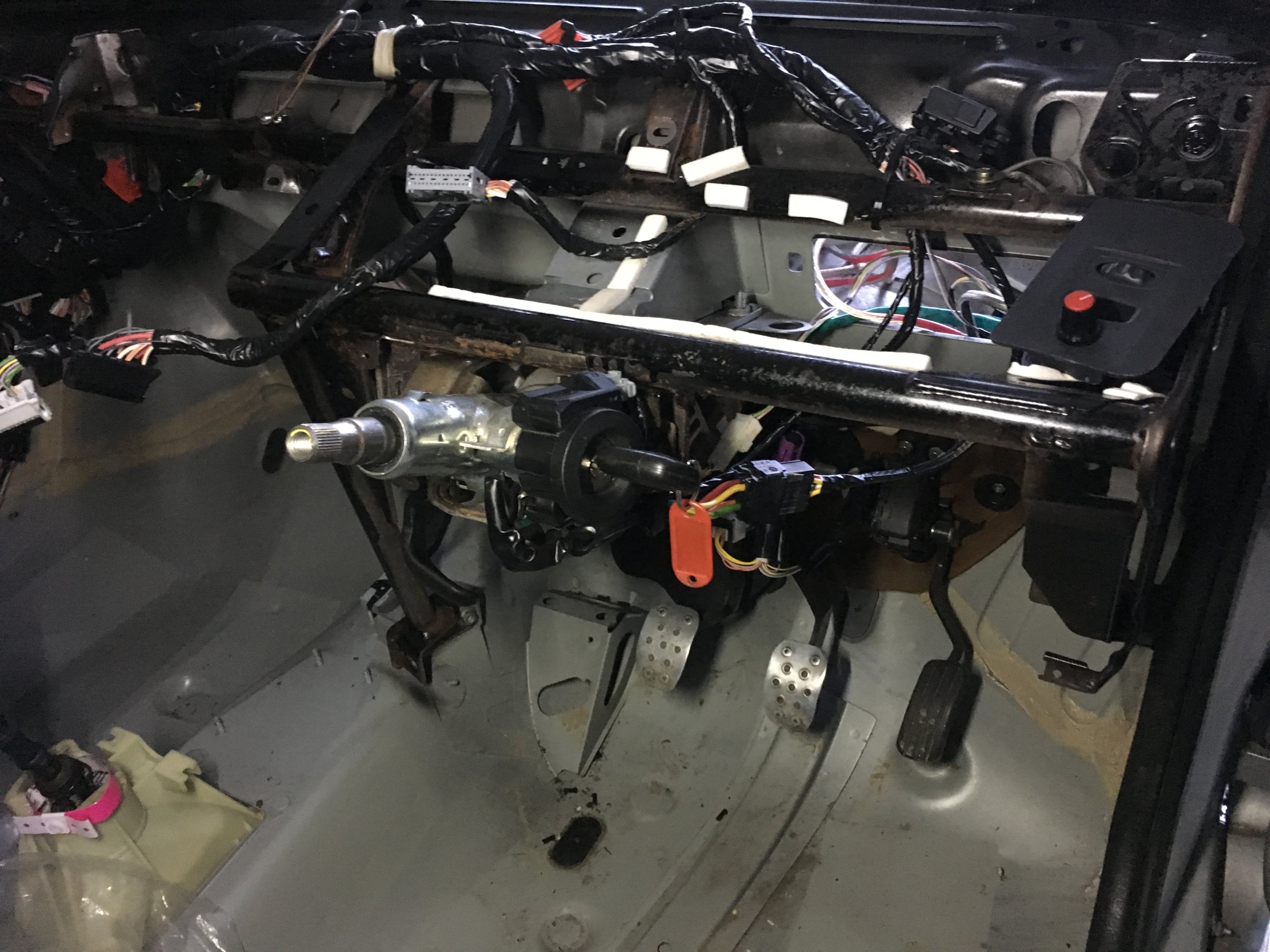

Firstly, I got the column out of the way.
Being under the car and fitting the funny shaped bolt for the column was a lot easier than the last one I did.
A) I knew what I was doing this time
B) I’d split the column in two parts so I wasn’t fighting myself constantly.
No pictures of this, but its in and tight ?

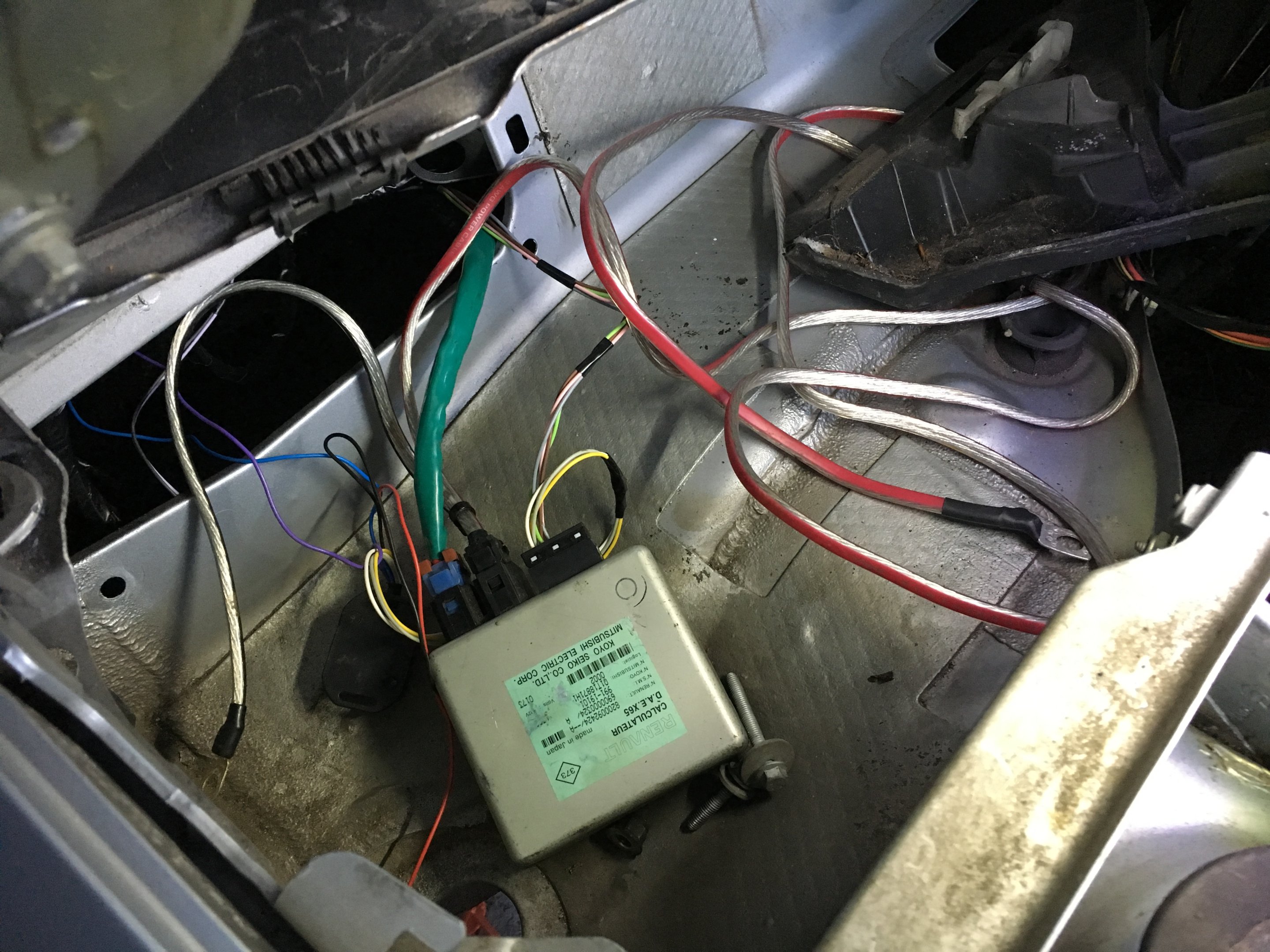

I then got on with fitting all the EPAS stuff inside the car and finding a place for everything, I’ve still got to sort where I want the wiring to be earthed etc, but it’s all in! ??
I may mount this box on the outside of the bulkhead, not sure yet.

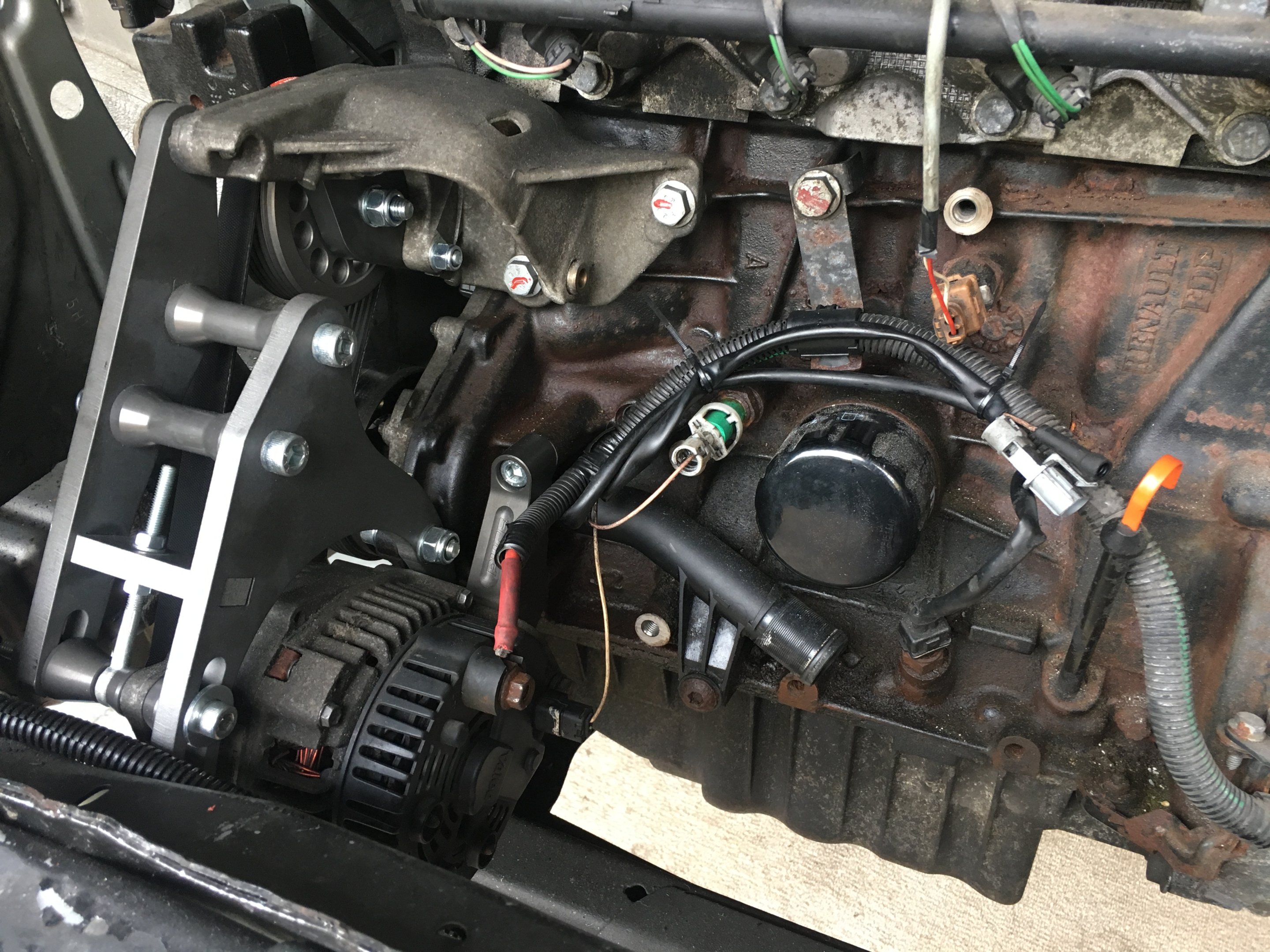

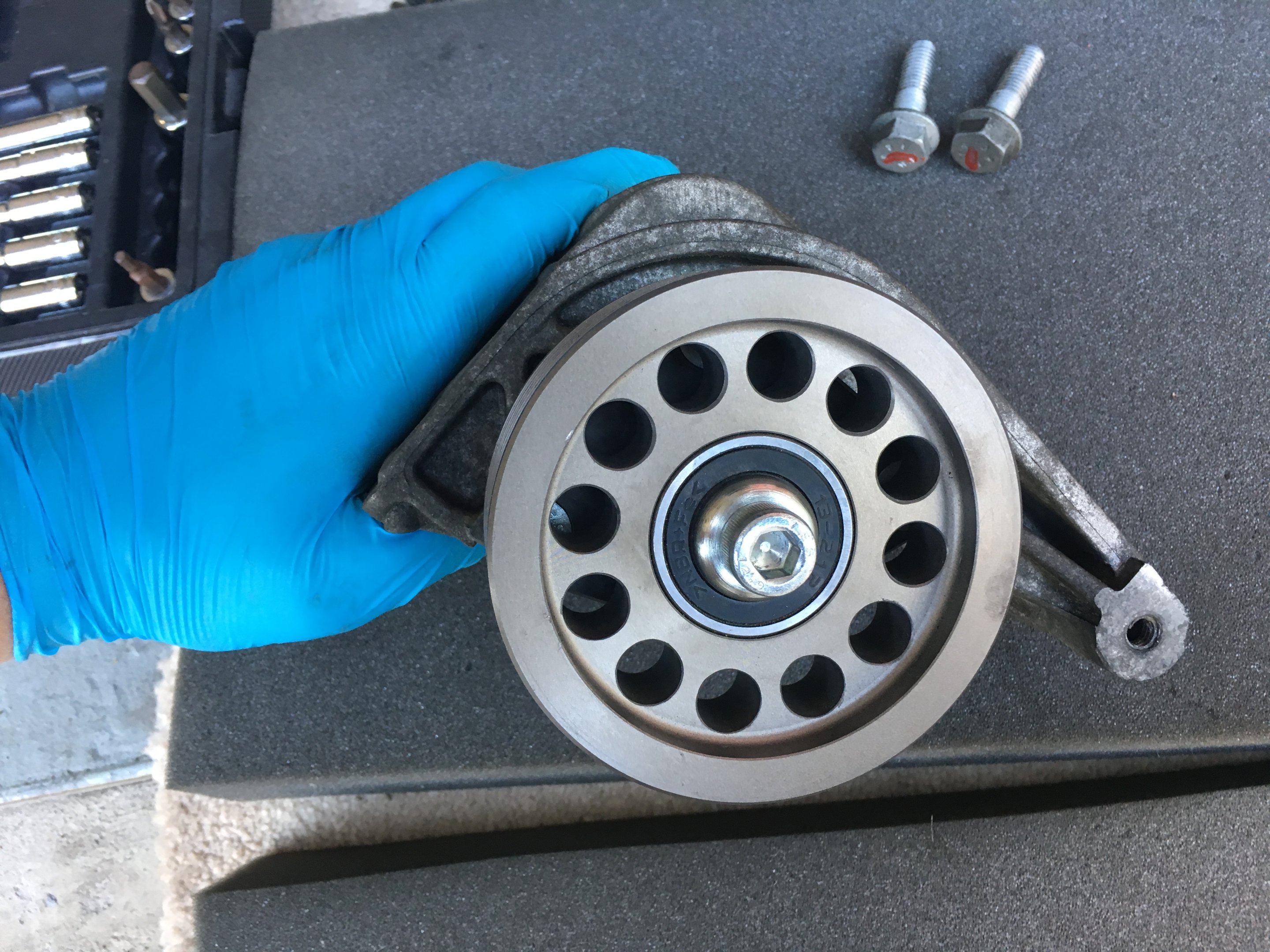

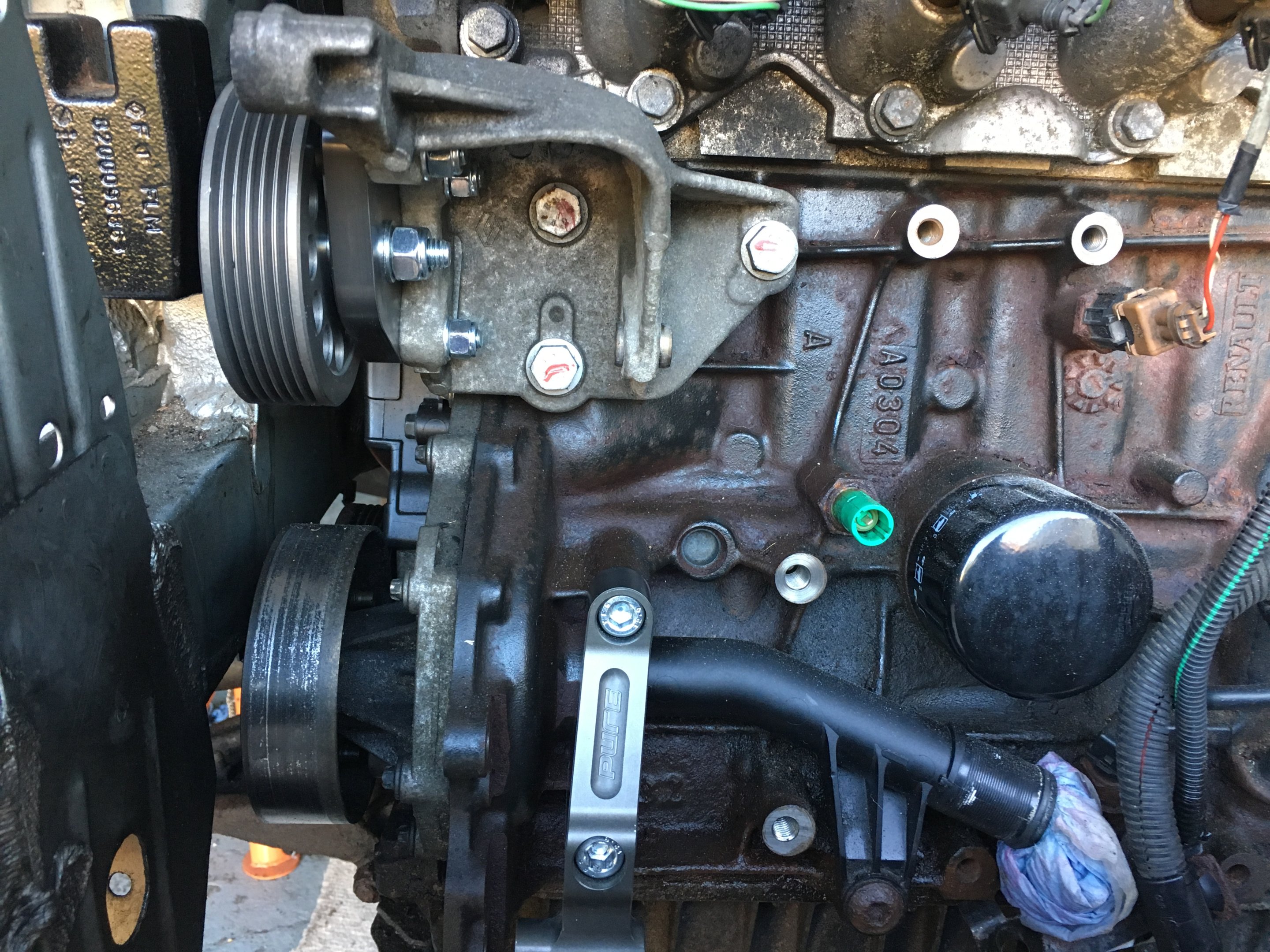

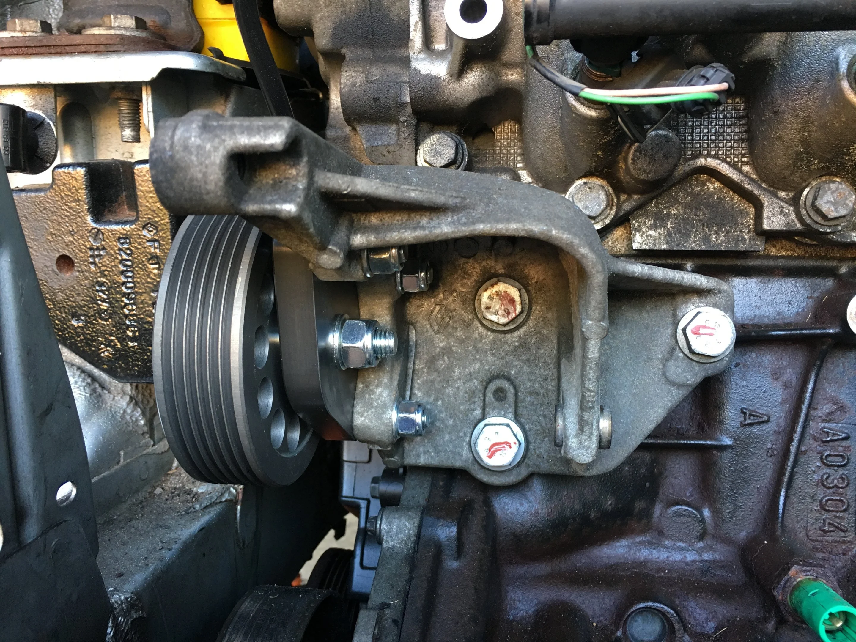

I’ve also fitted the AC and PAS Delete kits, however I’m having a few issues... you’ll see below...
Here’s the PAS delete going on

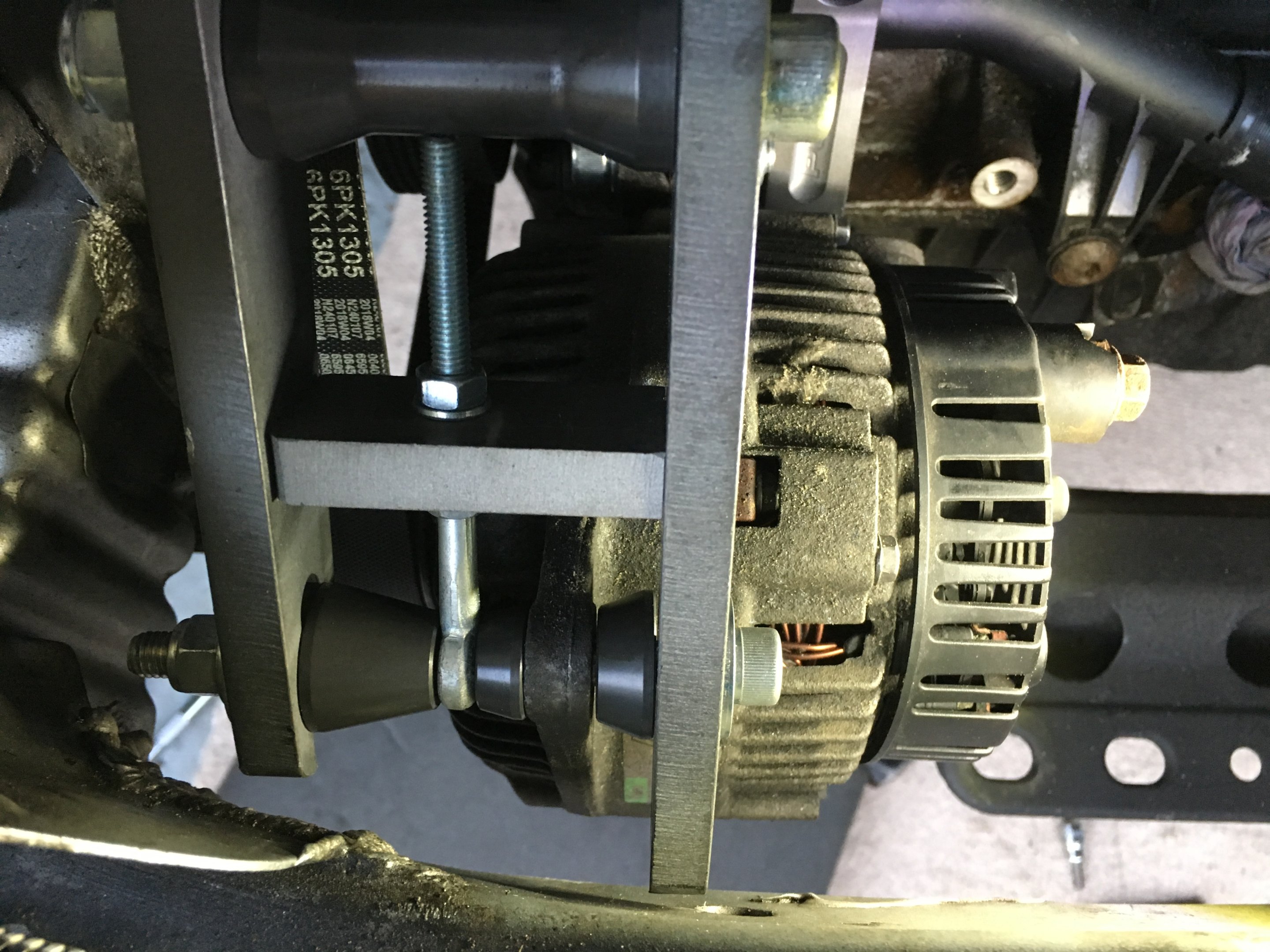

Then the AC Delete

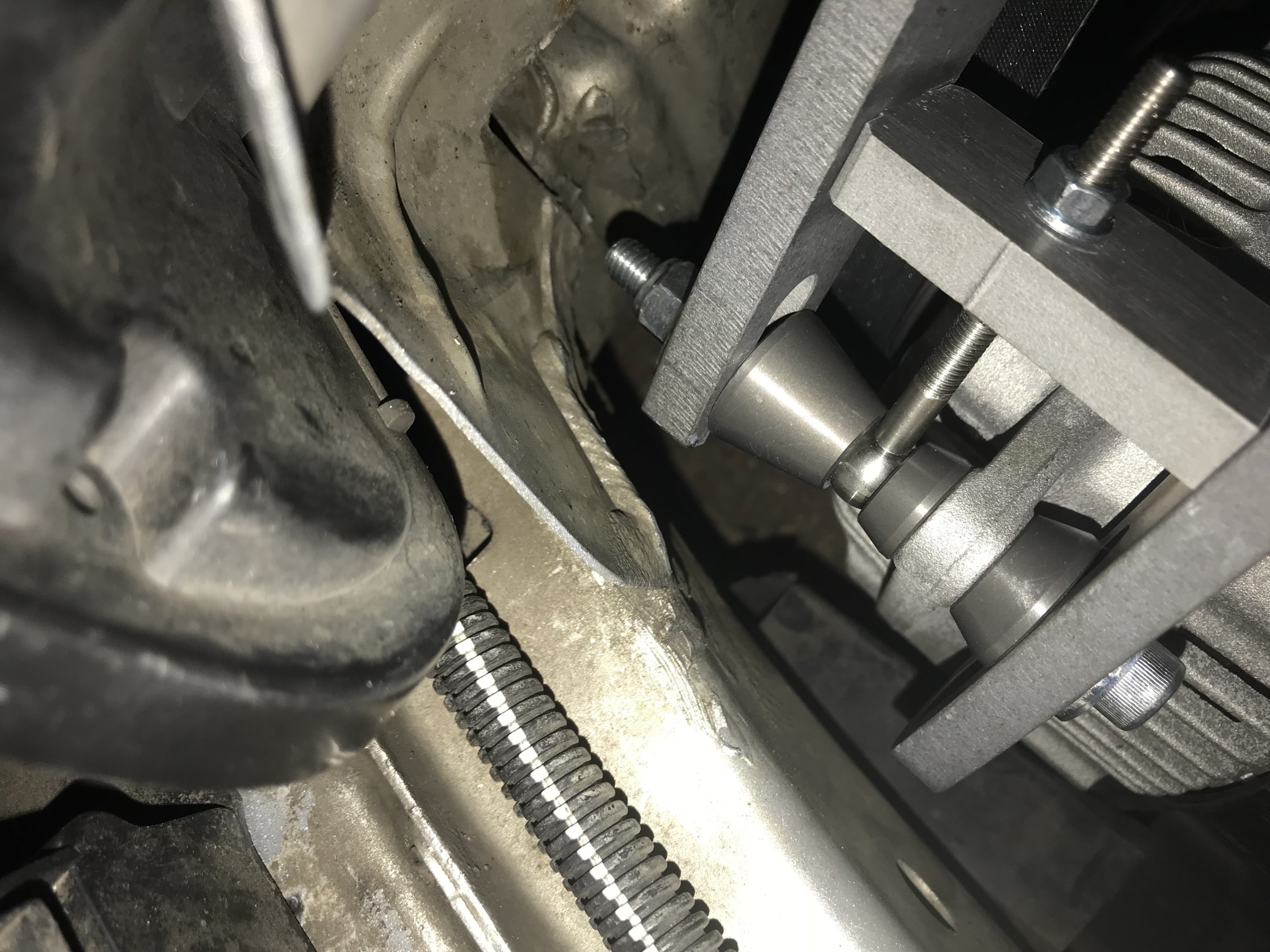

As you’ll see above, there is hardly any room between the bracket and the slam panel (remember it’s a Cat C) but it fits, JUST!
Will this cause me issues with engine movement?
Also the adjustment on the bracket is at Minimum... which leads me to the most annoying issue I’m having

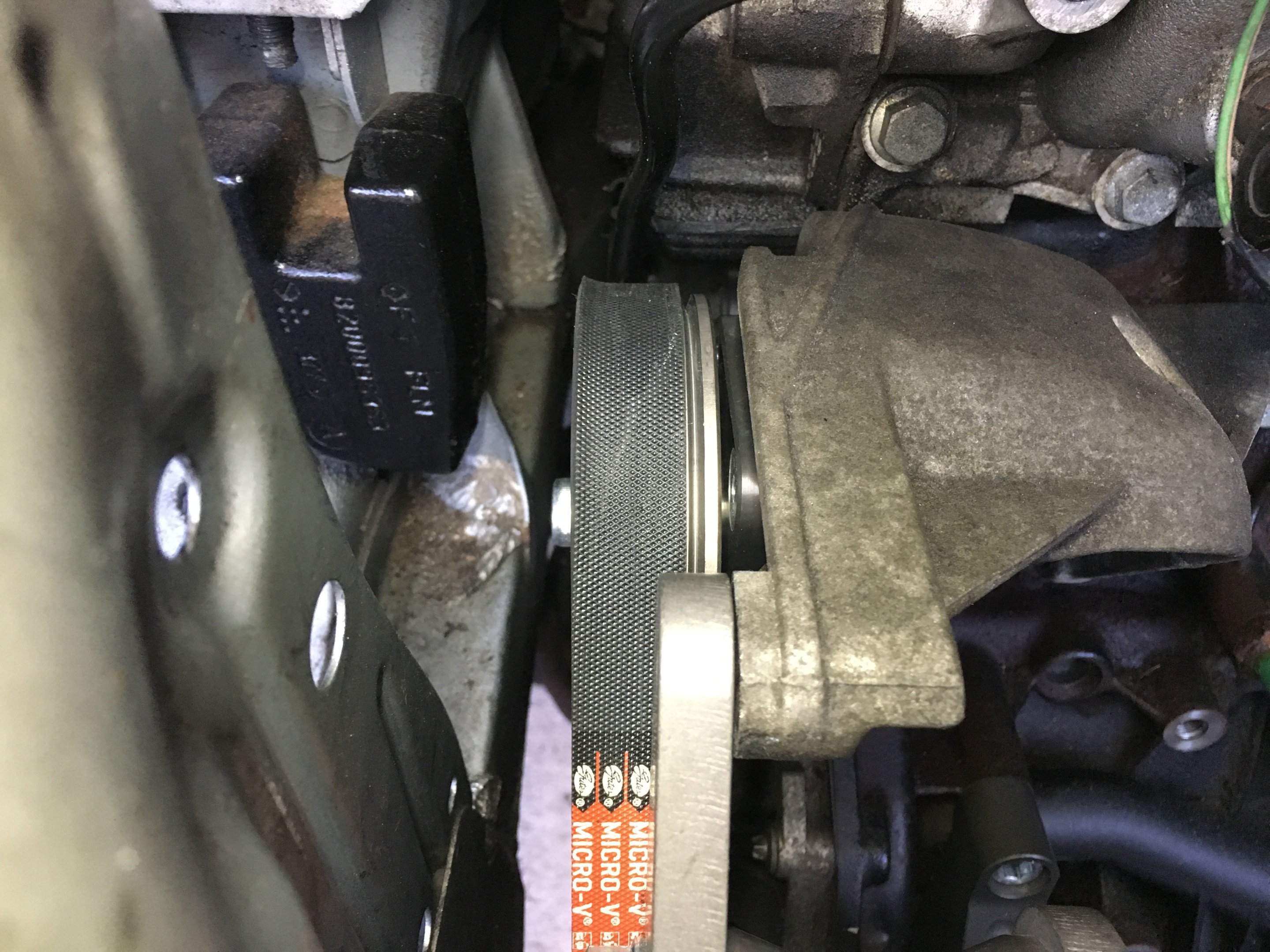

The belt isn’t on properly... I’ve tried and tried to get it to sit right but it will not jump over another tooth! It’s too sodding tight to get on!
I hear you all saying... release the tension on the belt Karlos, that’ll solve it.. well, as above, it’s at minimum on the tensioner and it’s very tight!
Im guessing I need a larger belt?

"I've used a 5PK848 belt (5 ribs, 848mm long) "
https://www.cliosport.net/threads/epas-on-172-cup.687703/post-9555054
I'd use a bit or string to get the right length you need though just in case that isnt right.
The setup that I’ve got is slightly different to the one mentioned on that thread, however the belt that I’ve got would benefit from being a rib thinner.
I’ve got four pulleys, pas delete, Alternator, Waterpump and I guess it’s the drive belt (no idea what it would be named)

Here’s a photo of my a/c delete with the same new design bracket.
I do have more room but I don’t have power steering delete. I don’t know if that makes a difference?
Also I was actually sent the wrong belt with my kit. It was to shorr as it was the one for power steering delete. Make sure you have the correct one for your kit?!
@Hyperhatch that photo settles my nerves a little bit...
I knew my slam panel was bent, but I thought it was REALLY bent when I was fitting this and I thought it would be a massive problem, hopefully I’ll resolve my issues with the kit shortly.
I think the issue might lay in my hands... I didn’t take the PAS Delete pulley off when I was fitting the belt and the guide says to do this, which is a bit stupid if you ask me, as the tension could all be taken with the alternator pulley...
I’ll give it a go ??

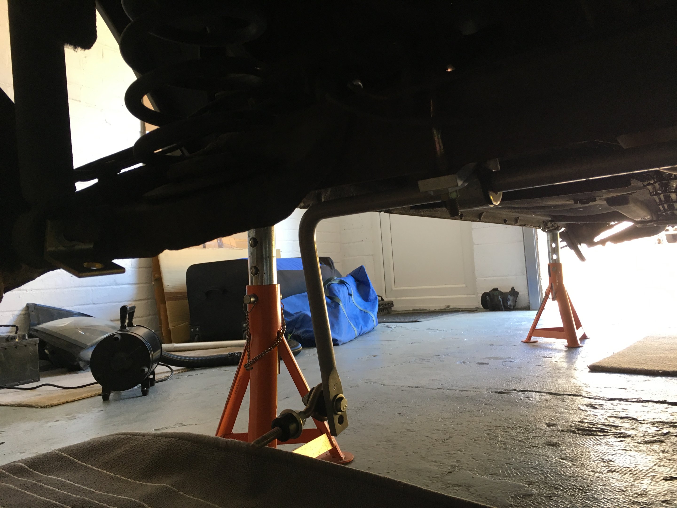

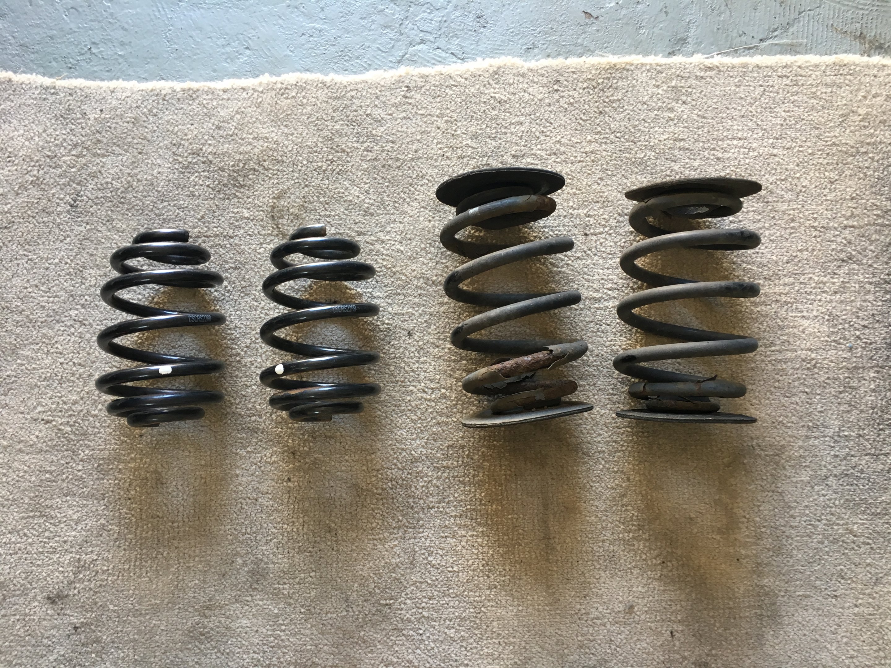

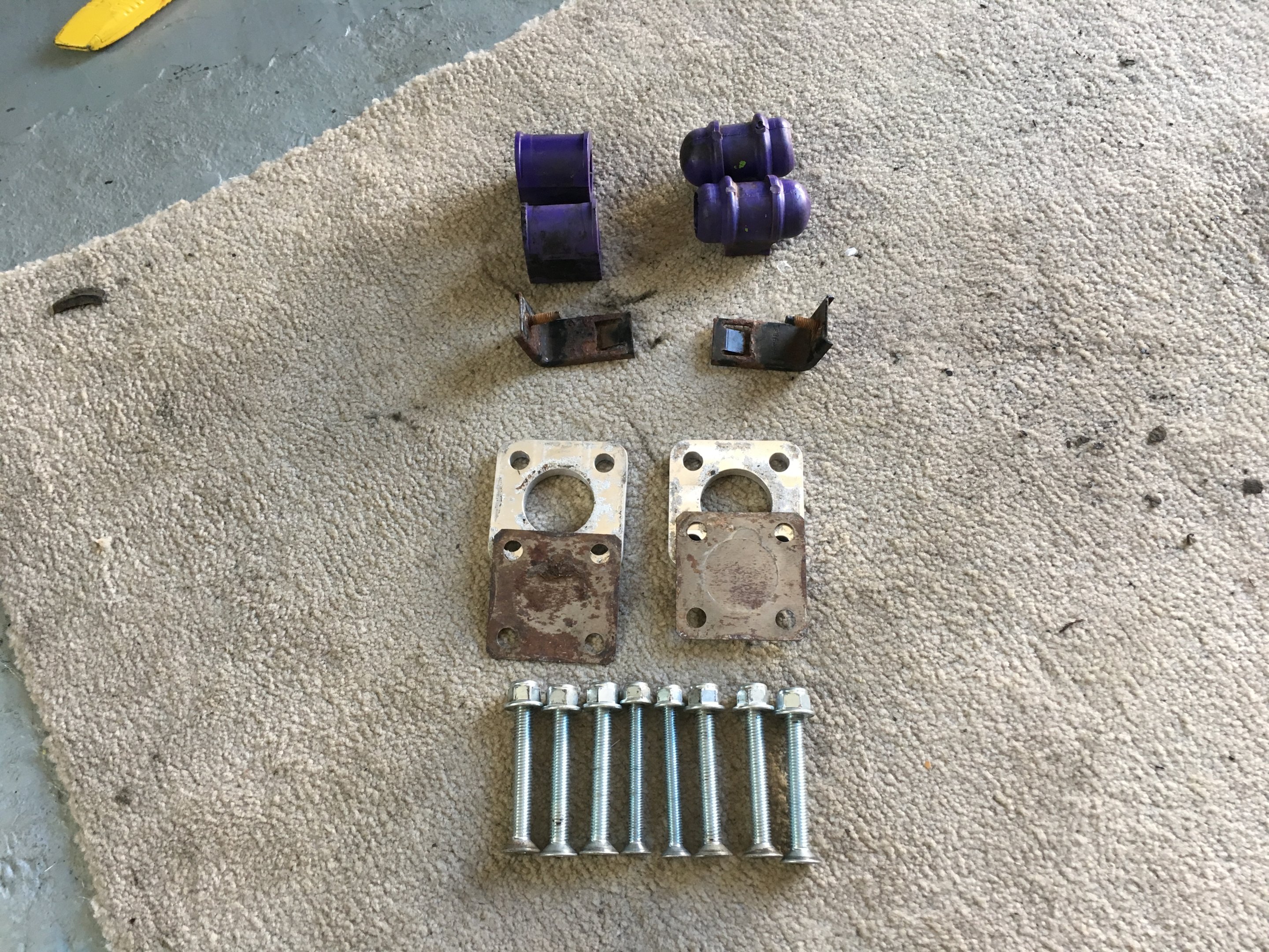

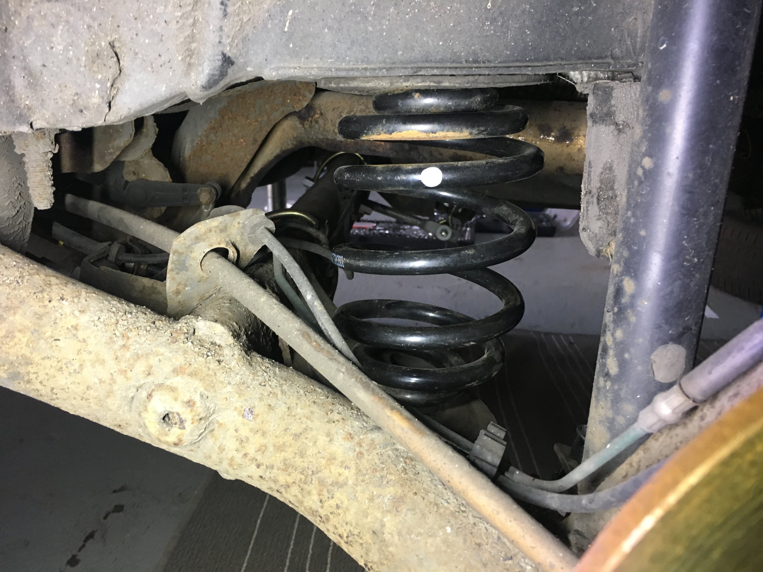

I started a the rear of the car and lowered the rear axle down so that I could fit the Cooksport Springs.
I haven’t ordered or changed the rear shocks as of yet, but if the car isn’t great on track with this new setup, I’ll order a set of cup shocks ??
All was quite smooth and I got them fitted pretty quickly.
Dropped the ARB
New v Old
After shot (taken this evening before I came home)

Then just after half 3 the replacement belt arrived... tried it...it didn’t fit... tried it again... Nope it definitely doesn’t fit...
“I must be doing something wrong”... clearly I’d gone the wrong way around one of the pulleys when trying to route the belt this time... Idiot!
So I got the new belt fitted, it was tight, but it fit so that was perfect.
Tensioned the belt up which was great and set about fitting things back into their homes, or new homes!

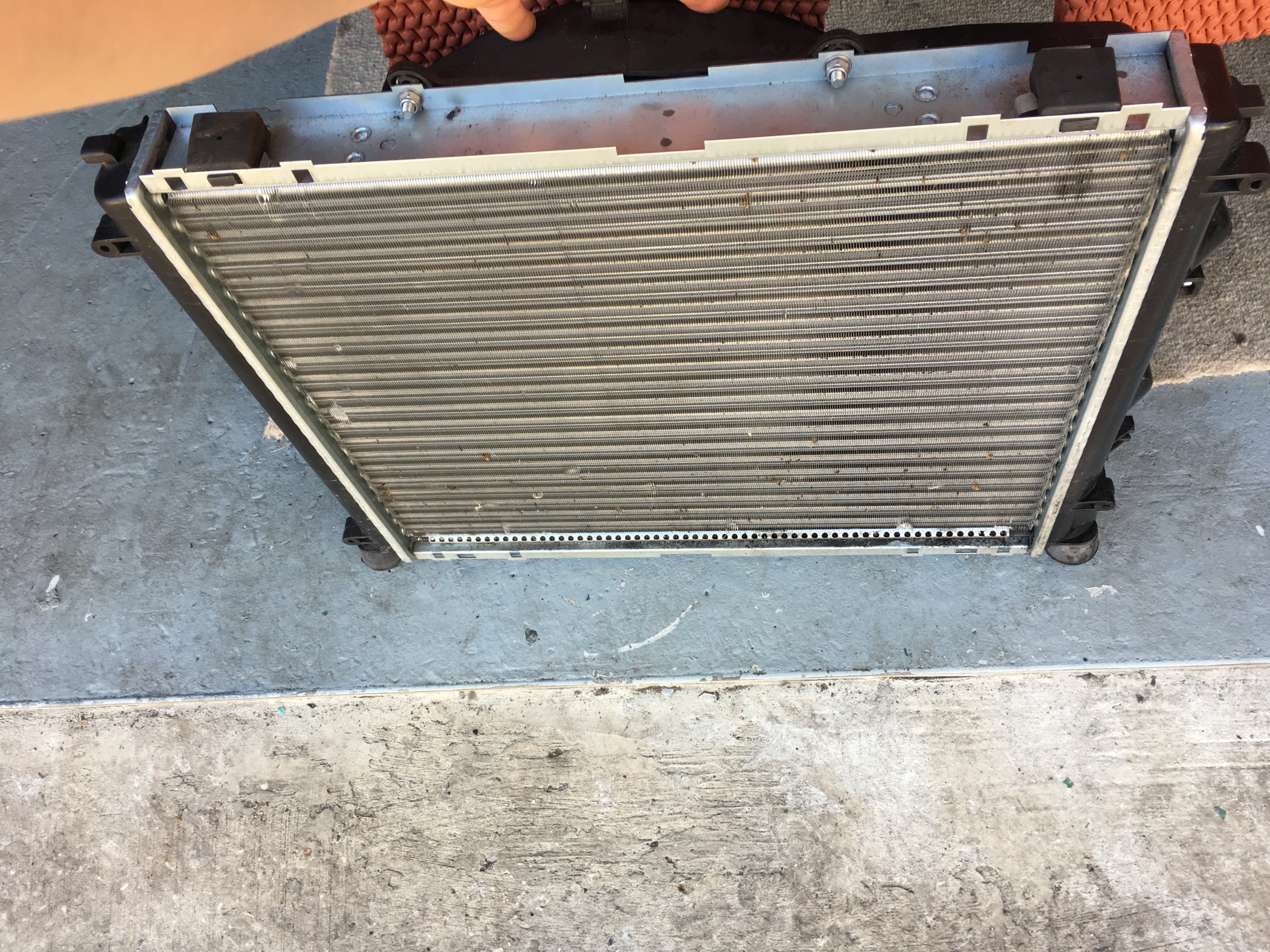

When my wife came down to the unit earlier in the day, she also came baring the gifts that I’d bought from @JP83
I’d asked John if he could send any mounting brackets that he had with his radiator as my radiator had been more mangled than I thought and it was definitely a good idea to swap it out.

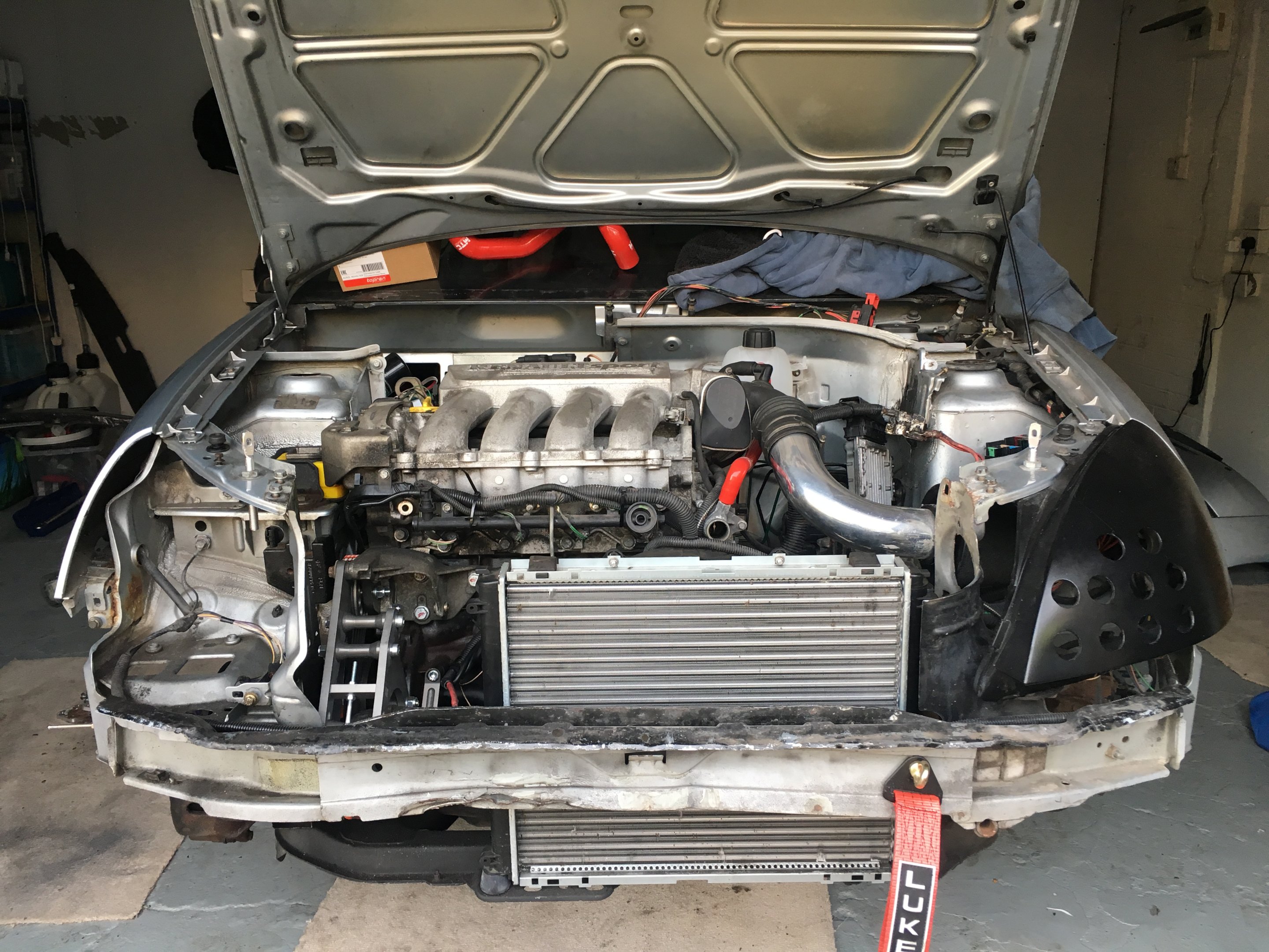

So it would’ve been rude not to mock the radiator up in the bay

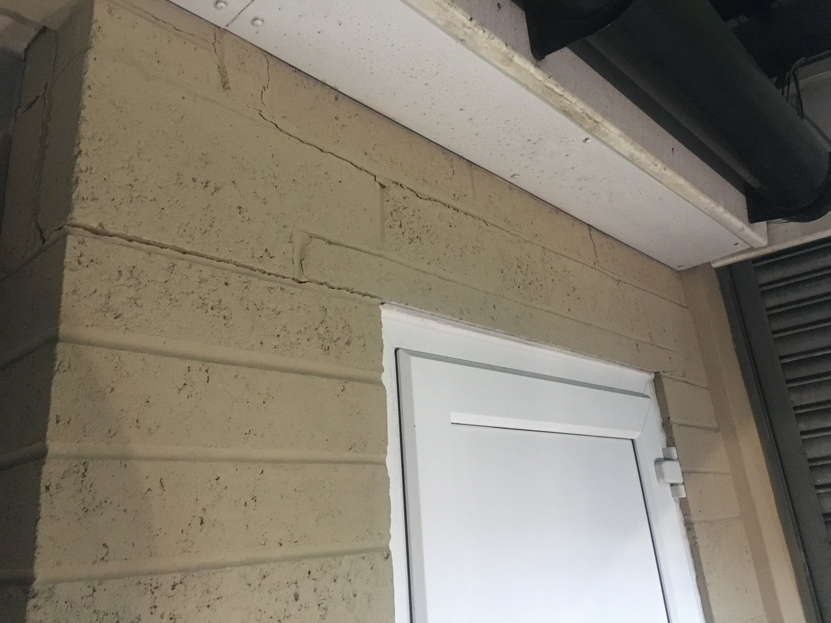

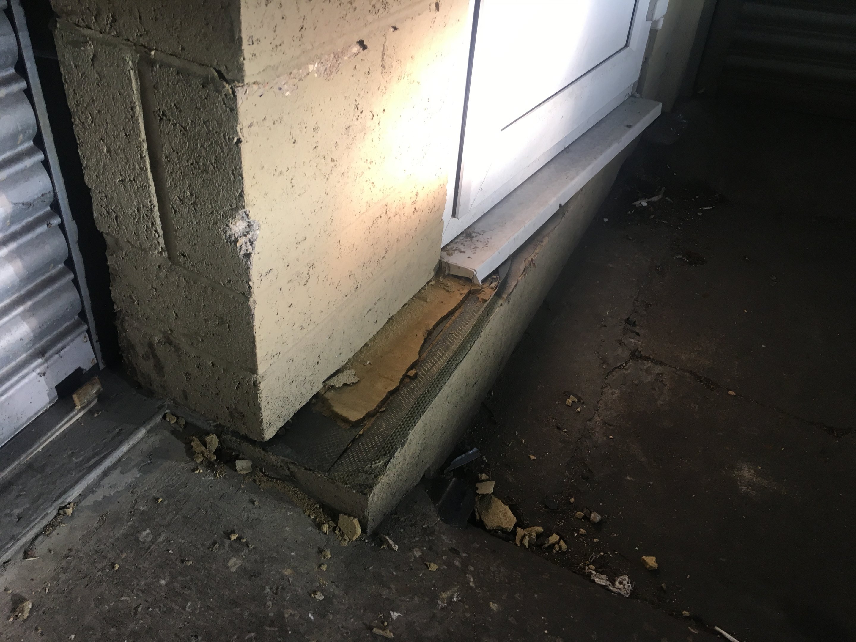

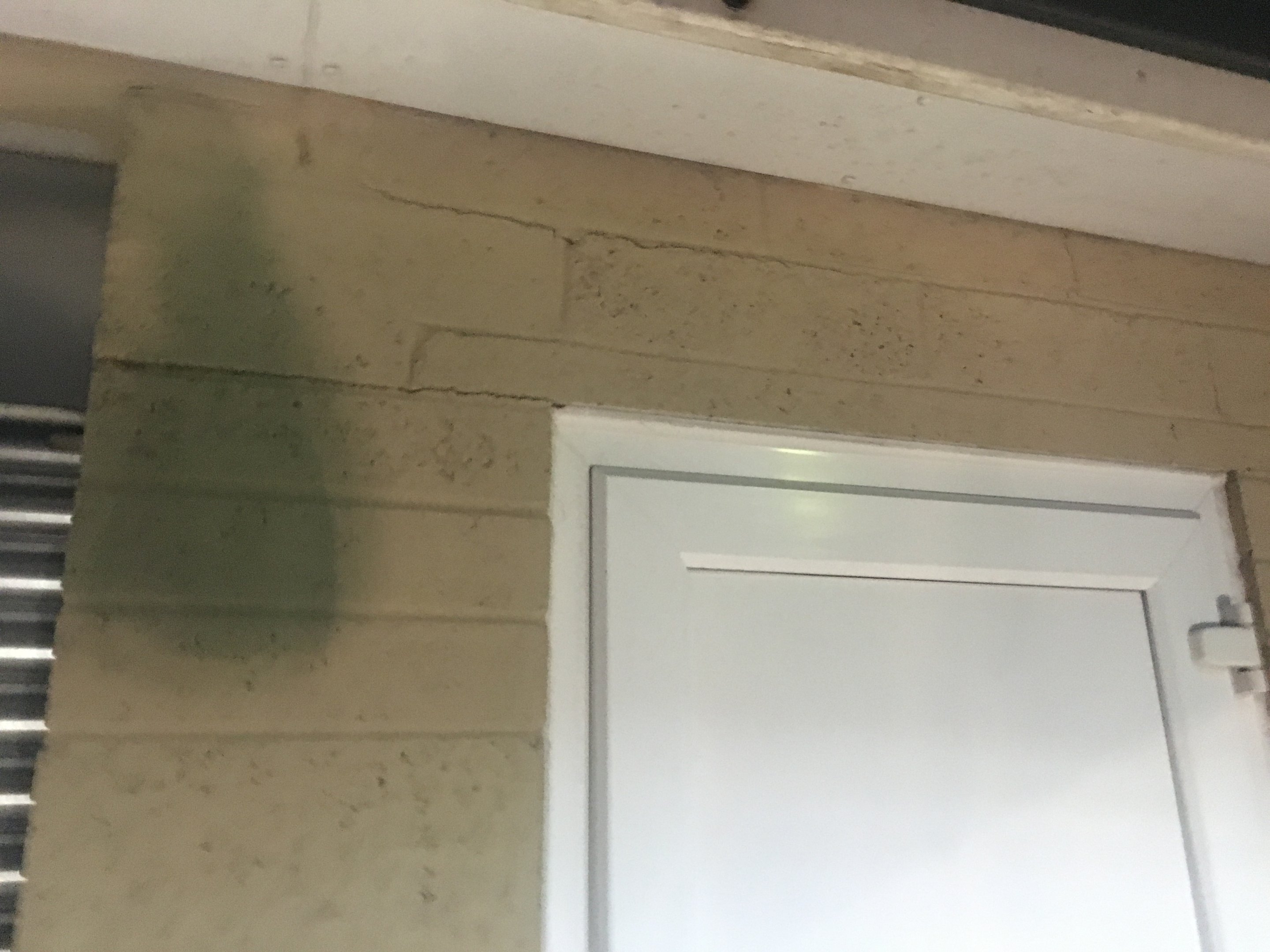

After a very busy summer with work and a very well deserved week away, I went down to the unit to drop off some parts I’d accumulated at the house.
I dropped them with the intention of going down to fit the parts the following evening.
When I got down to the unit the following evening, It quickly became apparent that the unit had been driven into!
The wall was pushed back a good 6 inches and the shutter and entrance door were both bent/pushed in!
I couldn’t even get in!
Completely disheartened by the whole thing and having a conversation the the bloke next door, I came home.
The following morning I called another of the Unit owners and asked if he could put a copy of his CCTV onto a USB stick for me, so that I could go through it all.
I then went and spoke to my Unit neighbour again and he hadn’t seen or heard anything, in fact he even had the cheek to say “I thought you’d done it” and then proceeded to put the blame on others...
Well, after a long time trawling through all the CCTV, a Silver Citroen C3 is being worked on, facing down the hill, bonnet open and then the next thing you see is... LAUNCH... BANG!
Straight into the unit!!
