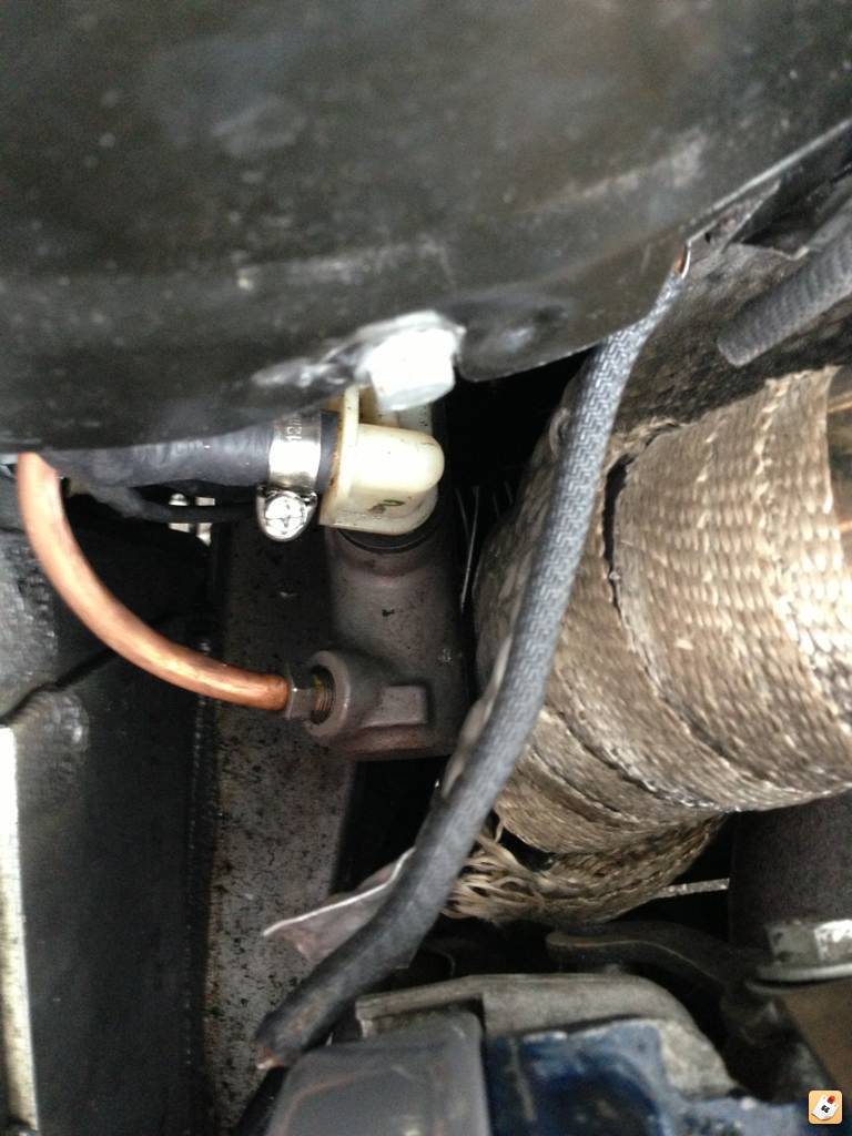

it would if you missed it completely. Any good pics of how it lined up during fitting?
That's how the cylinder sits now

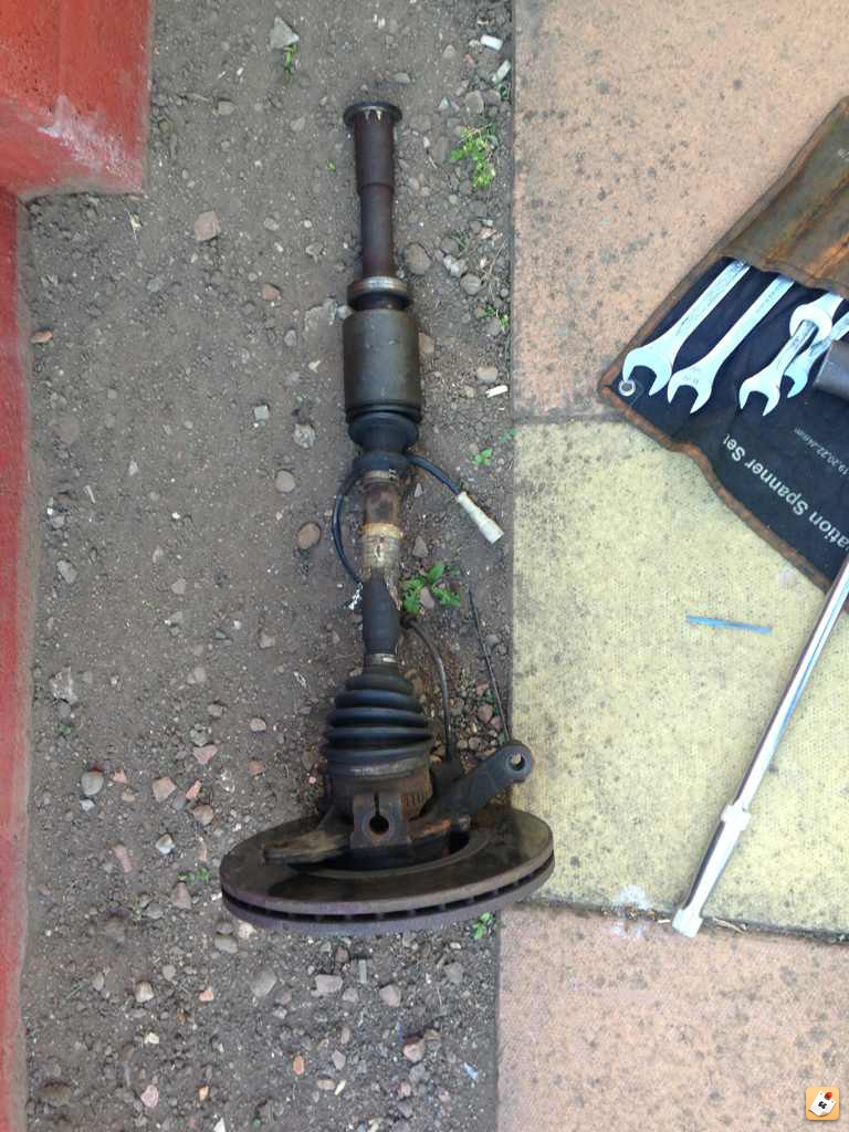

But got a few teeth issues so I've spent today stripping the car to fix them

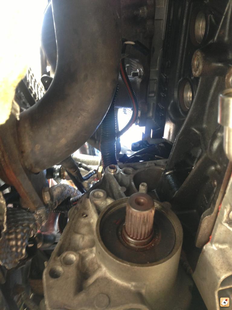

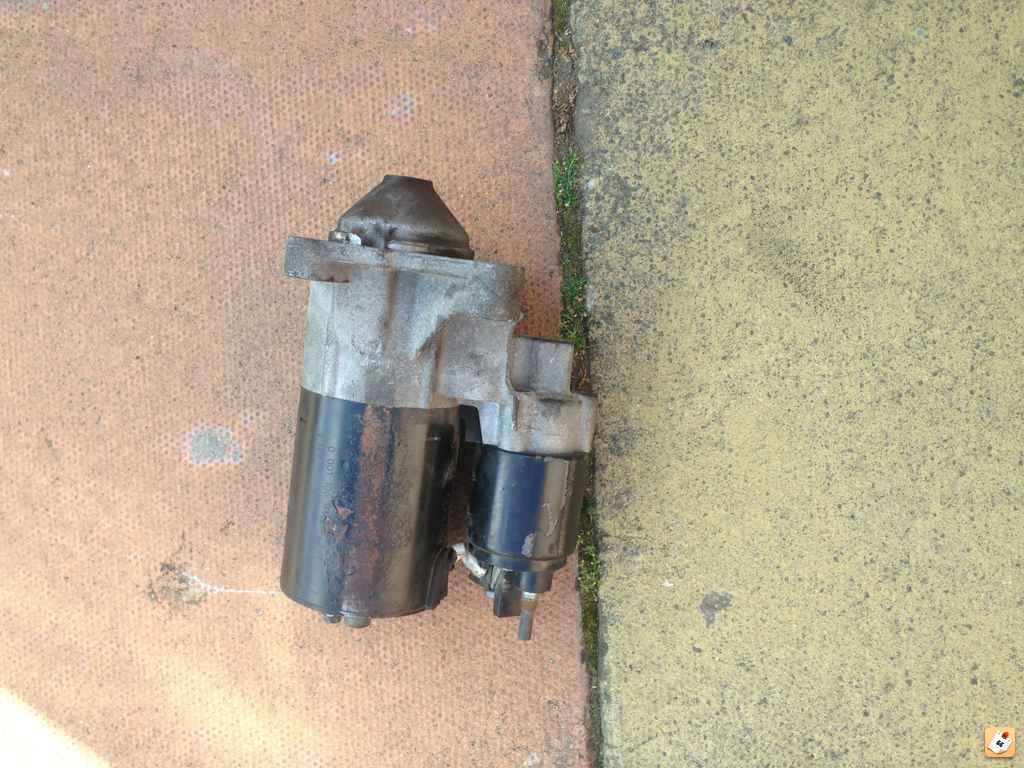

Starter motors out as its sticking
Had to pull the driver shaft out to get into it

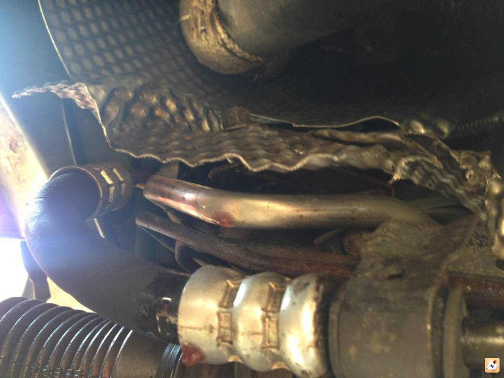

Also found me low pressure power steering pipe as been rubbing on the standard heat shield bracket and is now leaking so that'll be changed too
