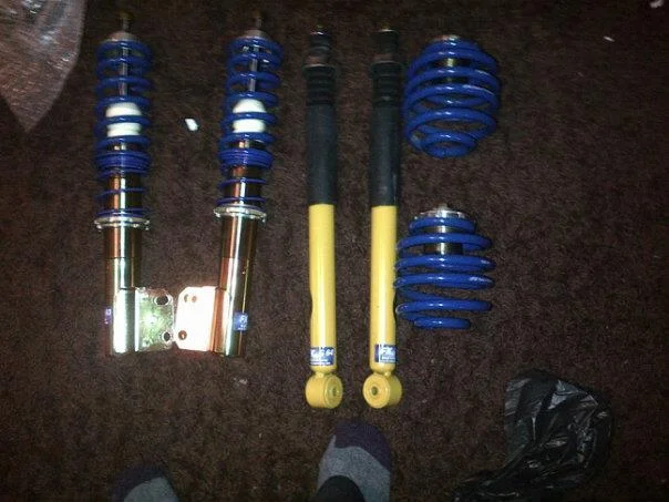

as always started with suspension I went for FK Highsports

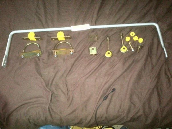

whiteline rear arb

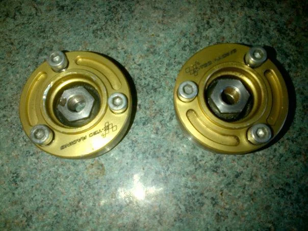

Recently added Ktec solid top mounts

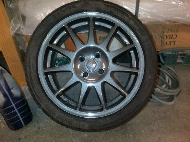

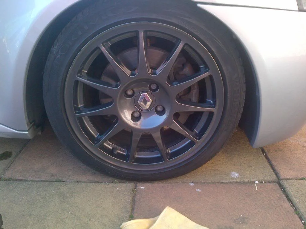

once they were fitted I had to change the standard wheels so bought a set on seedline turini's and had them paint in nissan structural grey

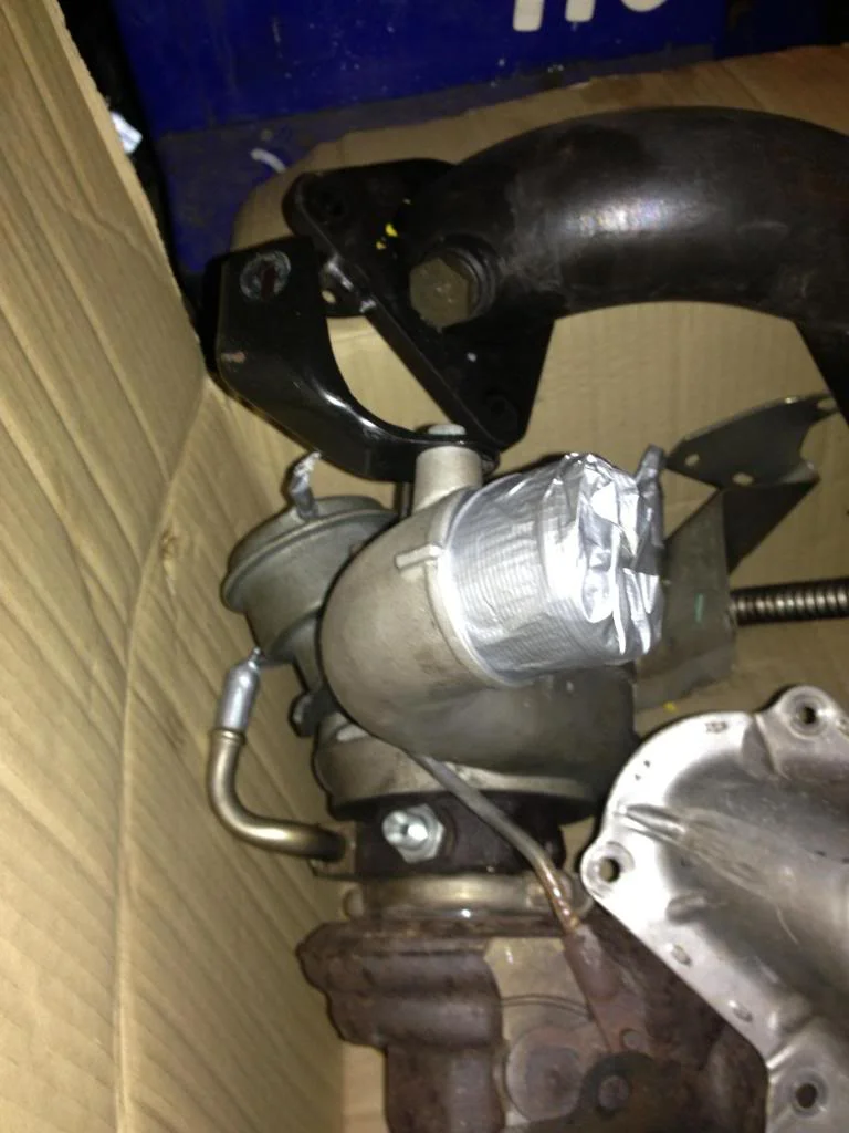

I always had the thought of turboing the clio from the minute I bought but never gave it much thought but recently one of my mate stu robertson superchargered his Ph1 sunflower which just put the turbo right back in my head then someone mentioned to me the Steven Lang was selling his turbo set up from his 225 power cup which you's will all know of course.

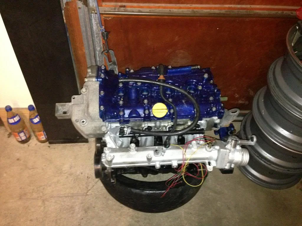

So I've ended up buying whole set up more or less, which is a F4R block with megane internals, megane head and td04 turbo with down pipe and link pipe to a 172 exhaust system which I only picked up last night

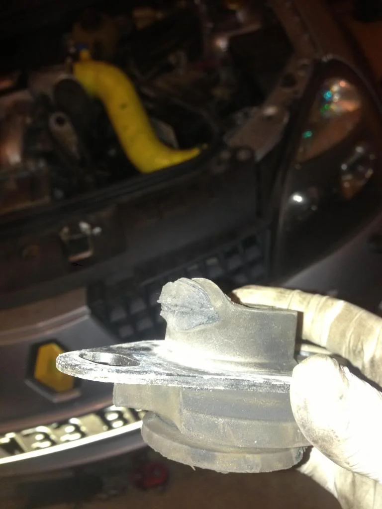

been having issues with my exhaust blowing for the last few months and I've stripped it out and repositioned it, yet it starts blowing a few weeks later
So it happened tonight again so decided to find the cause of the problem which turned out to be a knackered gearbox mount
so luckily i had a set of vibratech uprated mounts waiting to be put in when I doing the conversion,
so I installed them bit of a pain but what a difference already car feels alot more solid with hard acceleration

yeah exactly I bought the engine of steven lang (cupman on here) its a F4R block with megane internals megane head fitted with 172 cams its using the megane inlet as the td04 turbo fouls the clio breather system, using megane downpipe with link pipe made ti fit 172 exhaust.
Planning on using adaptronic 420 ecu which will being getting done a EFI as I have no clue about wiring at all
Will be keeping the power safe at around 240 until I sort something out with my gearbox as the car will be a daily driver

And my Turbo Trophy block lives in yet another Clio! The only thing I'll advise is get a custom downpipe made, every Clio conversion I've seen using the 225 turbo has been bodged to some extent to stop it touching the master cylinder, a custom down pipe would sort this out and it's not as expensive as you might think.

I thought the engine came from andyrg?, tbh the downpipe seem good this time around and as for the master cylinder cupman says you can turn it 90 degrees to clear the downpipe.

Yeah Steve, your block goes to another good home. Custom downpipe would solve this but I have reduced the length towards the mater cylinder by 15mm and rotated my master cylinder by about 20deg and it clears it nicely.
