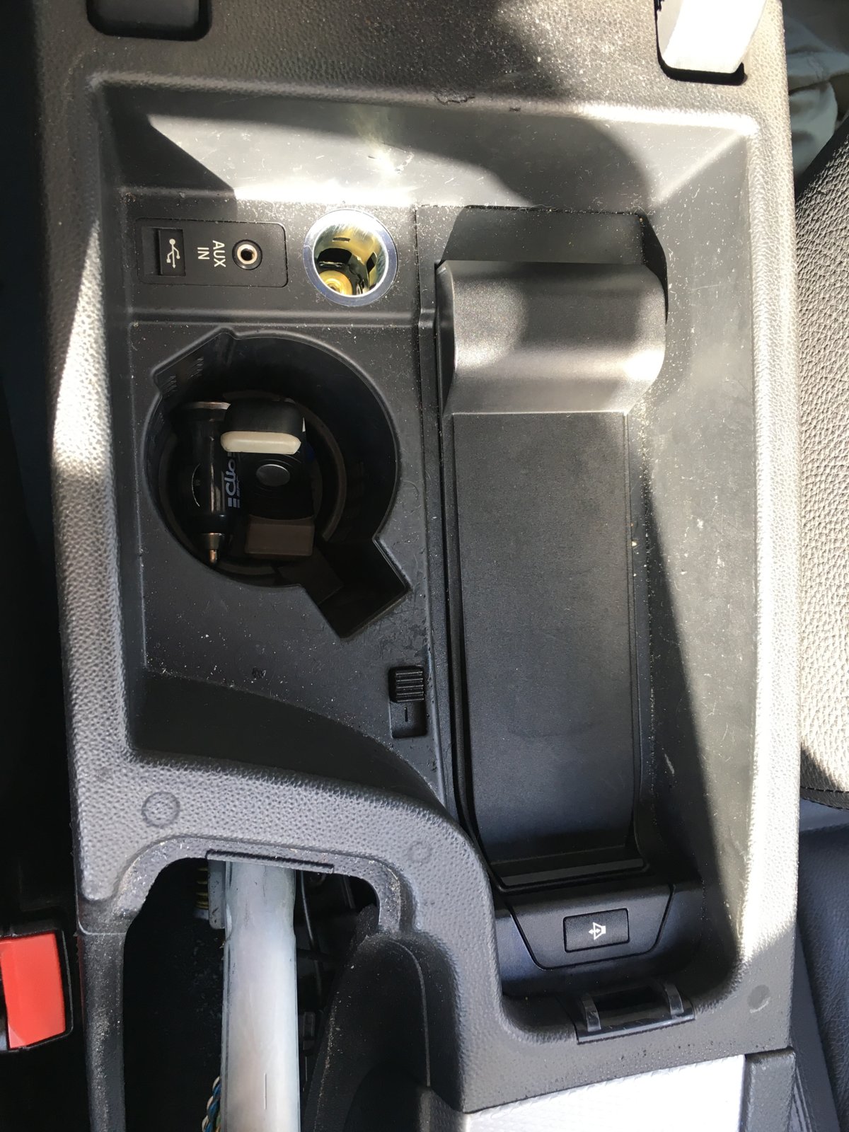

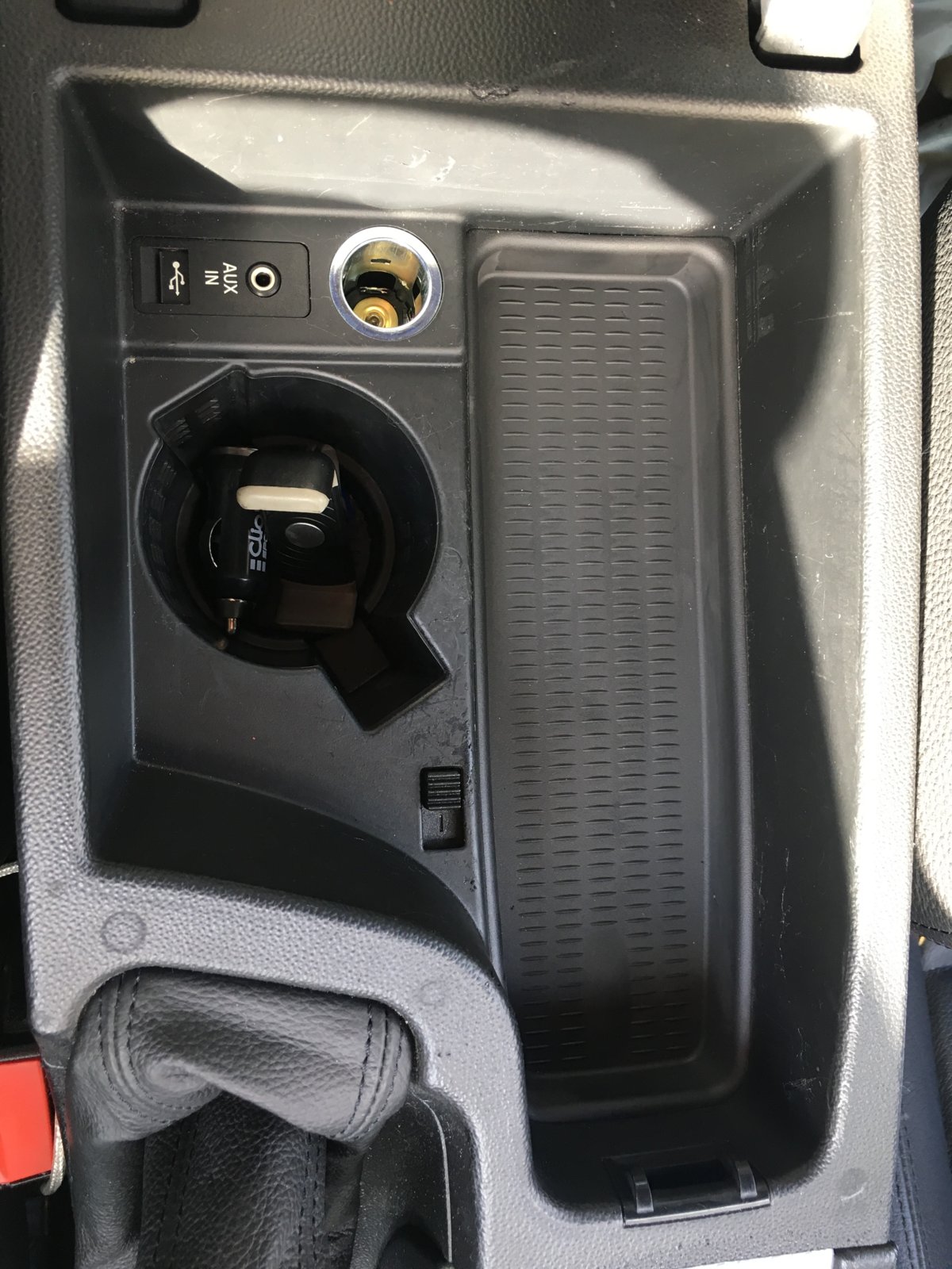

Just a very small update. Only took 5 mins to fit but a lot more space where the phone cradle thing went
Part number 51167118064

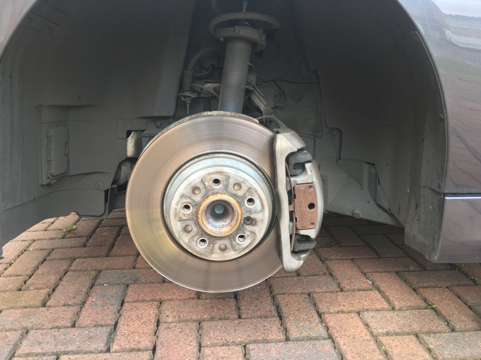

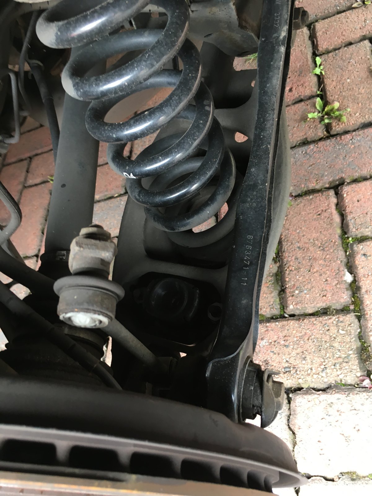

Cleaned it, took the front wheels off and gave the front suspension a look over. Have a slight knock somewhere but can’t find anything obvious. Calipers need a lick of paint. They’re much bigger and better looking than the 325 brakes. Also ordered everything for the rear shock replacement thanks to @terryc101

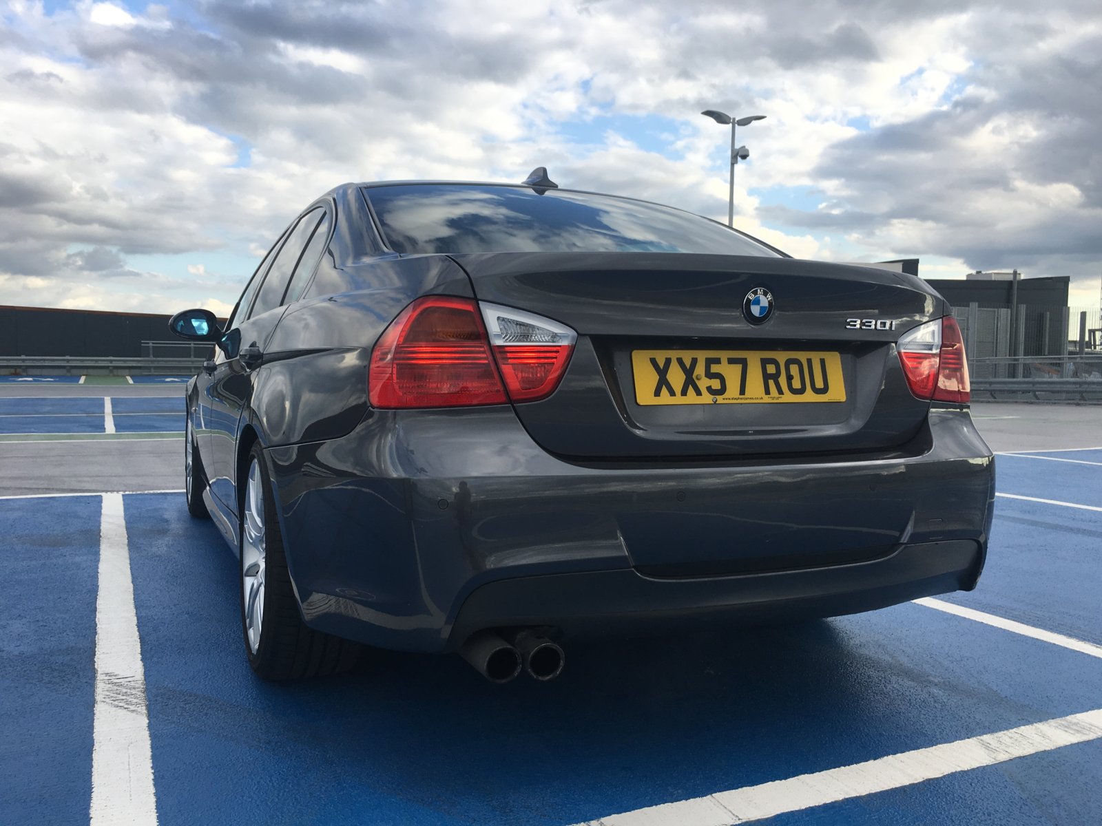

Tail pipes badly need a clean

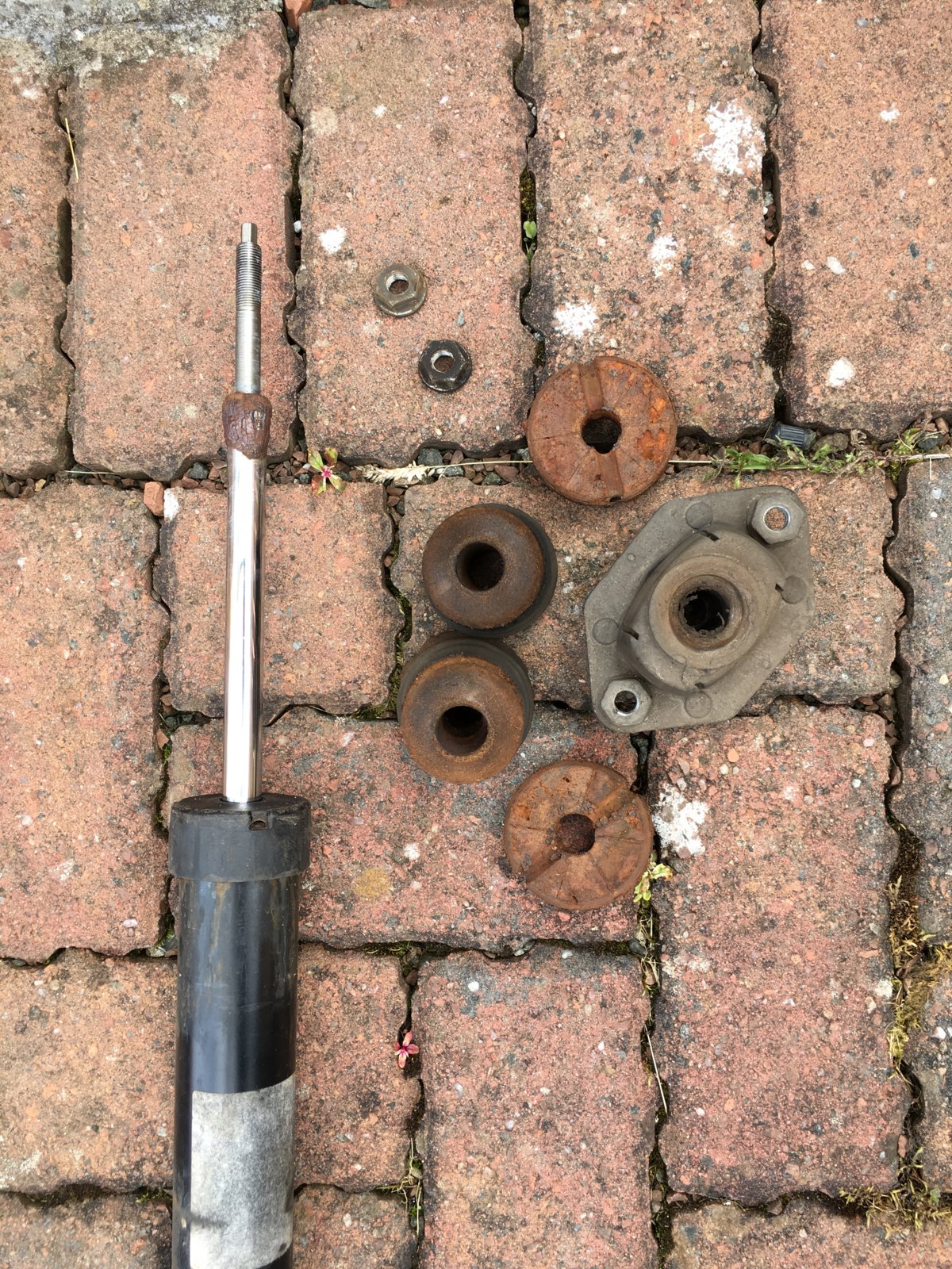

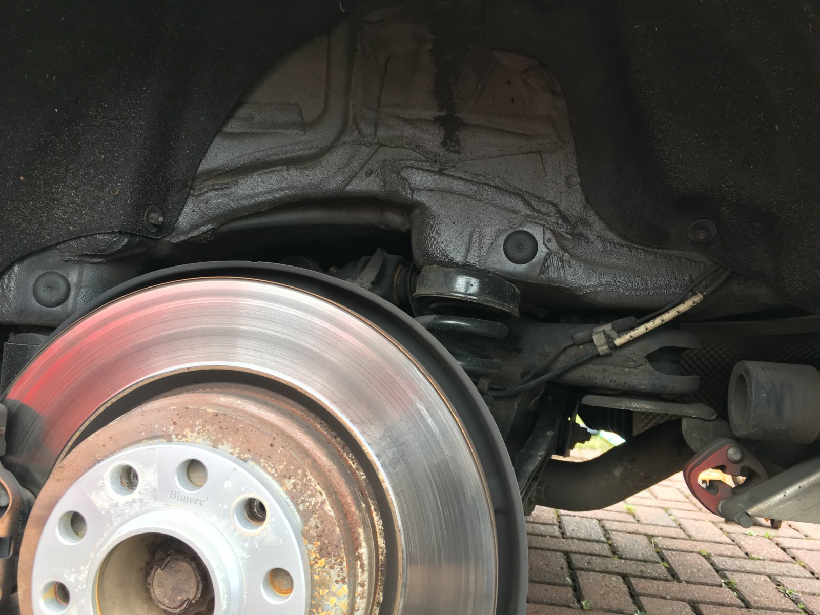

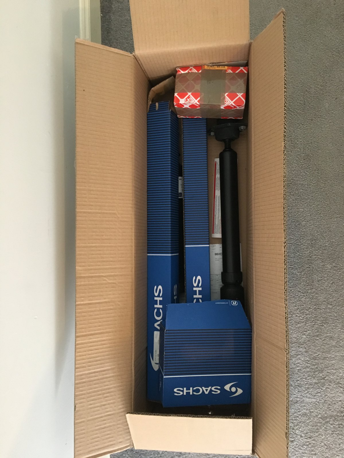

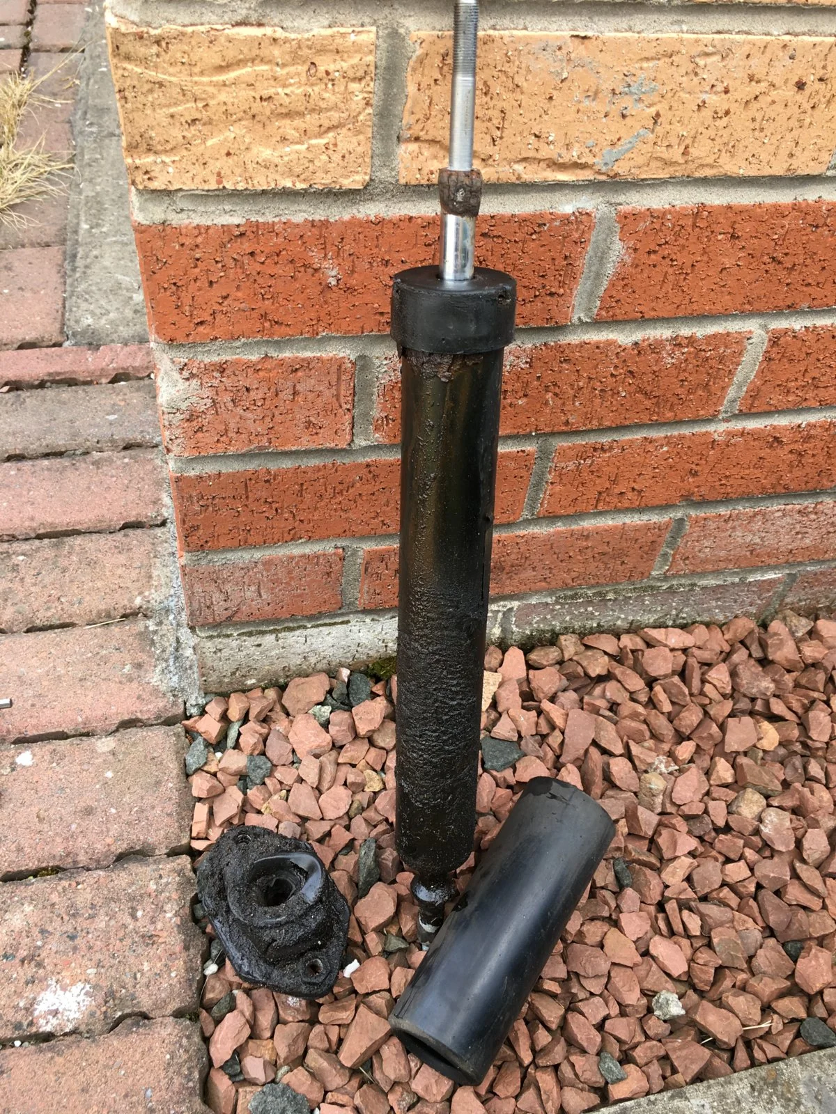

Got the parts through for the rear strut replacement.

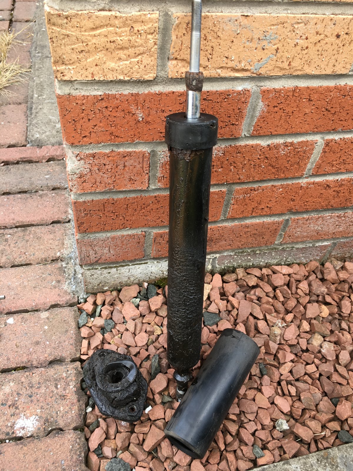

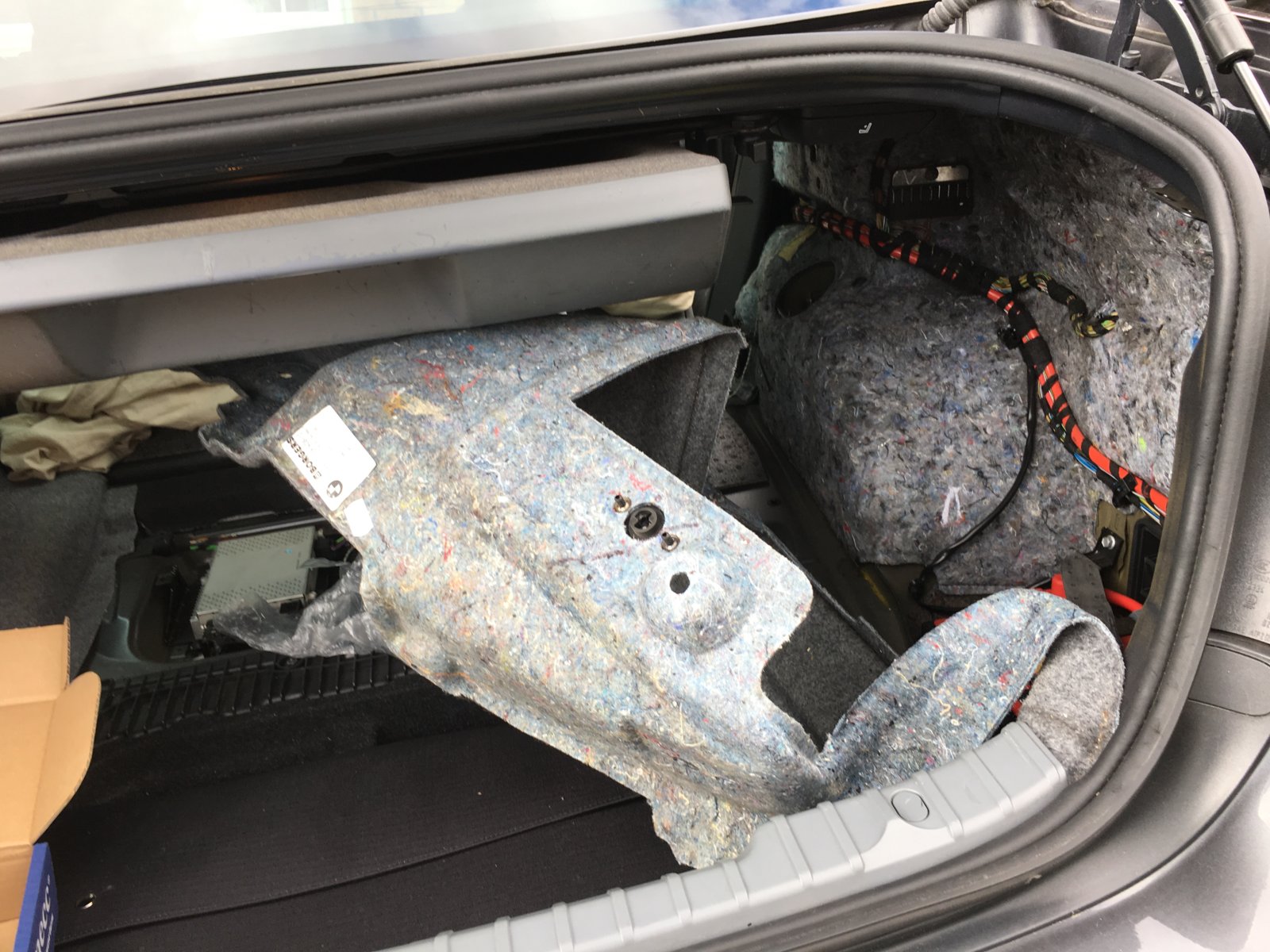

Came out in literally minutes. Helped by the fact neither had any pressure left. When I pushed them down they didn’t return even a millimetre
Most awkward part is moving this s**t out the way
Small rubber mount was also replaced
You can see the condition of the old parts. Rusted, split and just generally shagged
Took it out a drive. It does feel a bit better, the near side is a definite improvement, it was much crashier before, now it’s supple

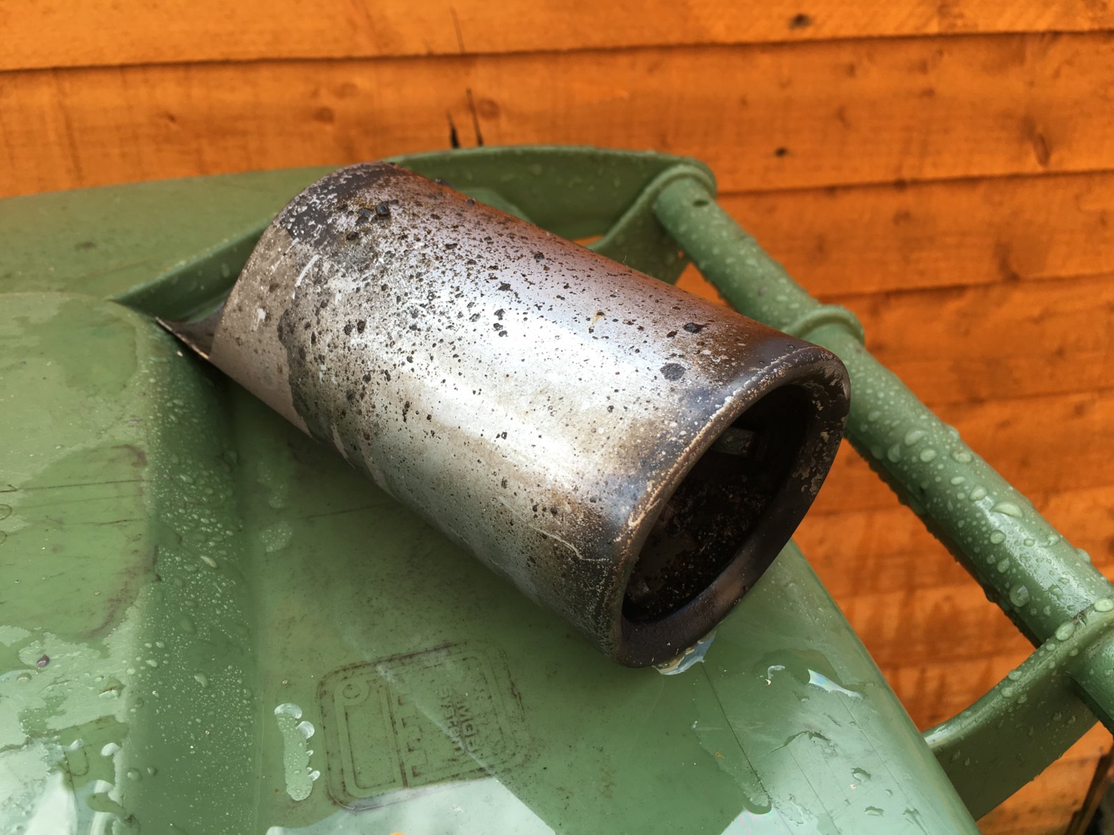

Pulled the tips off and cleaned them up. I have no idea how they can get so much shite on them. They came up ok, I’d quite like new tips but more similar to the performance exhaust tips

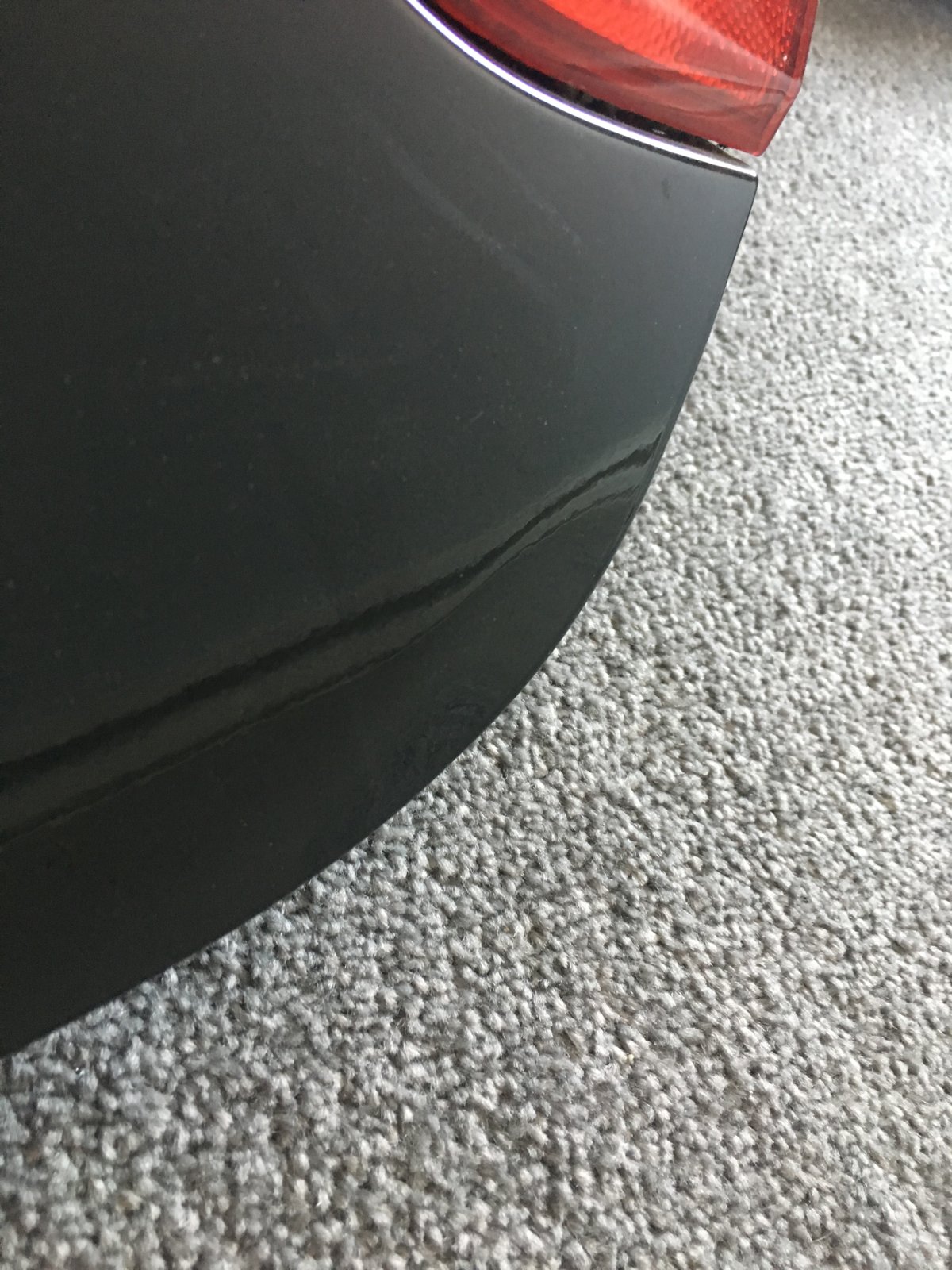

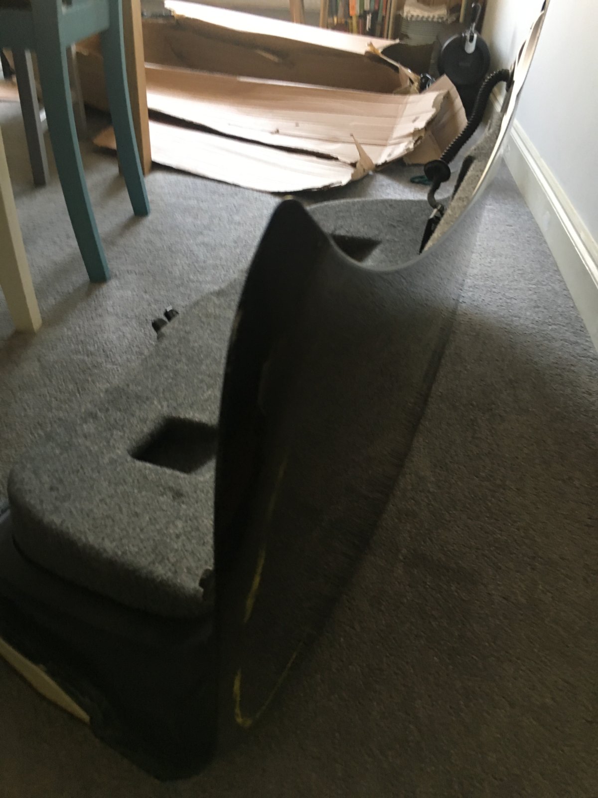

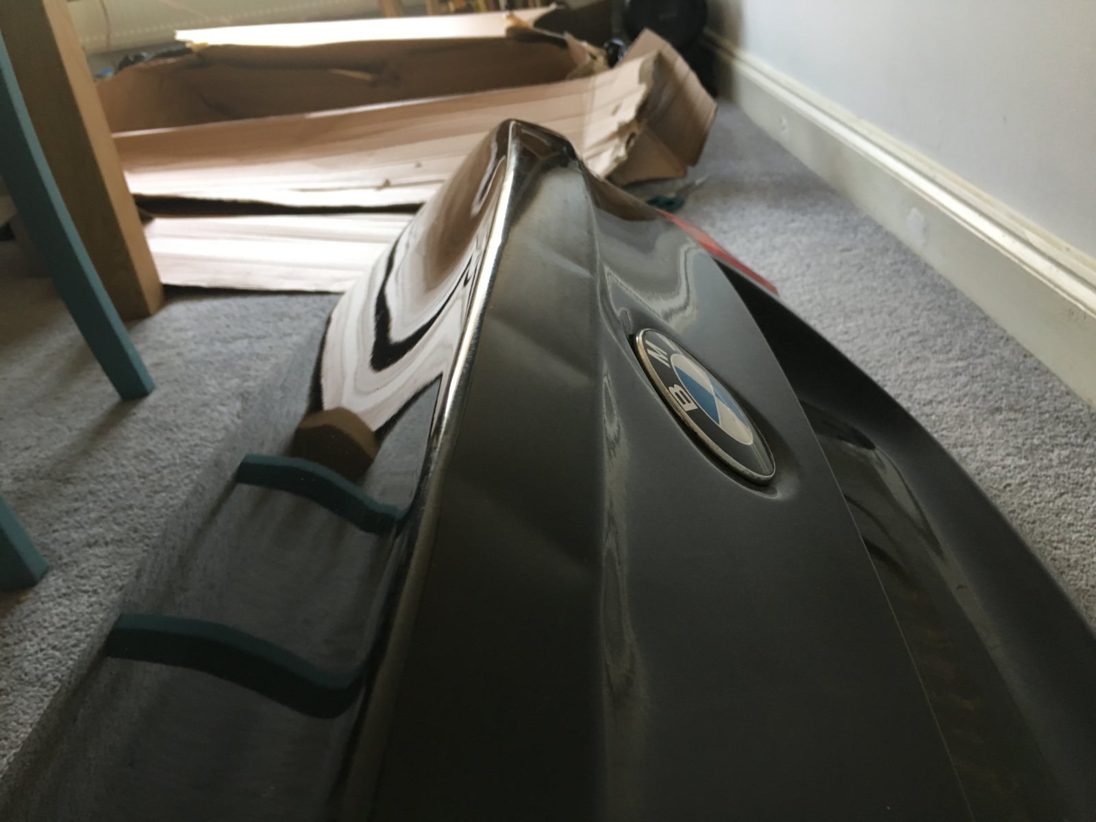

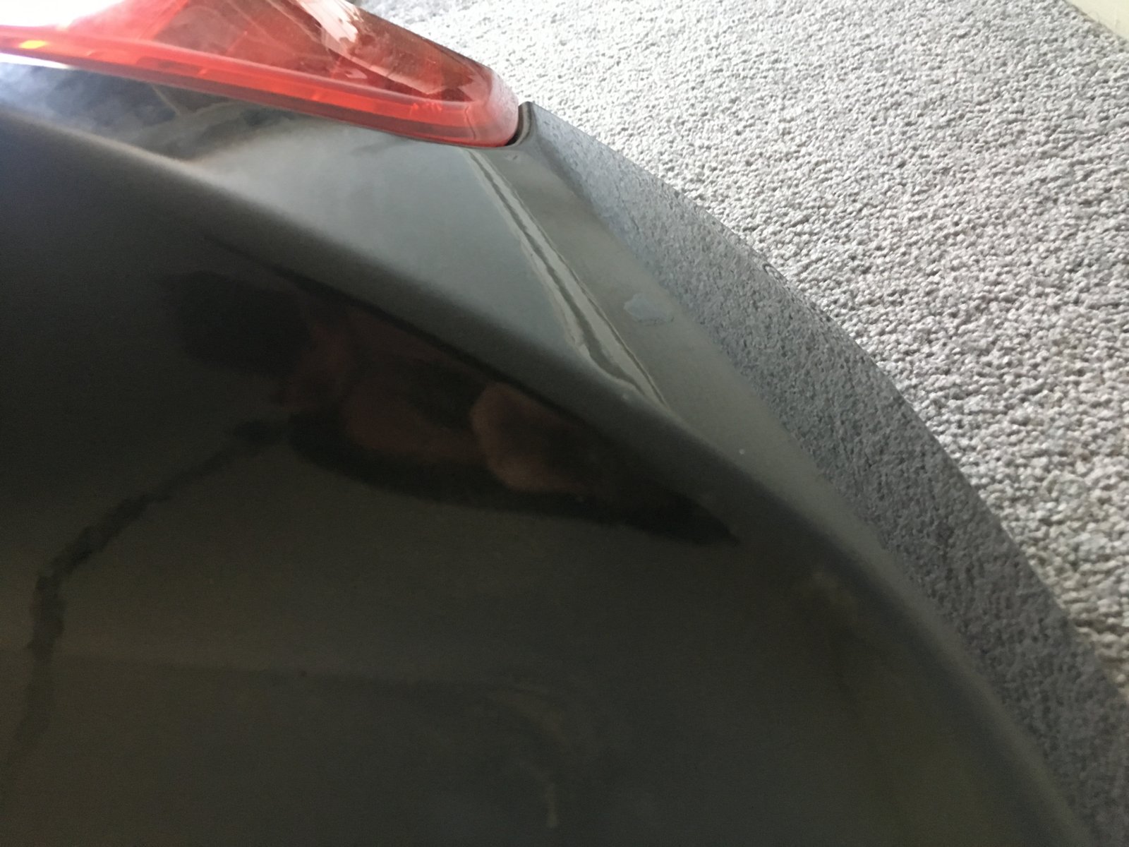

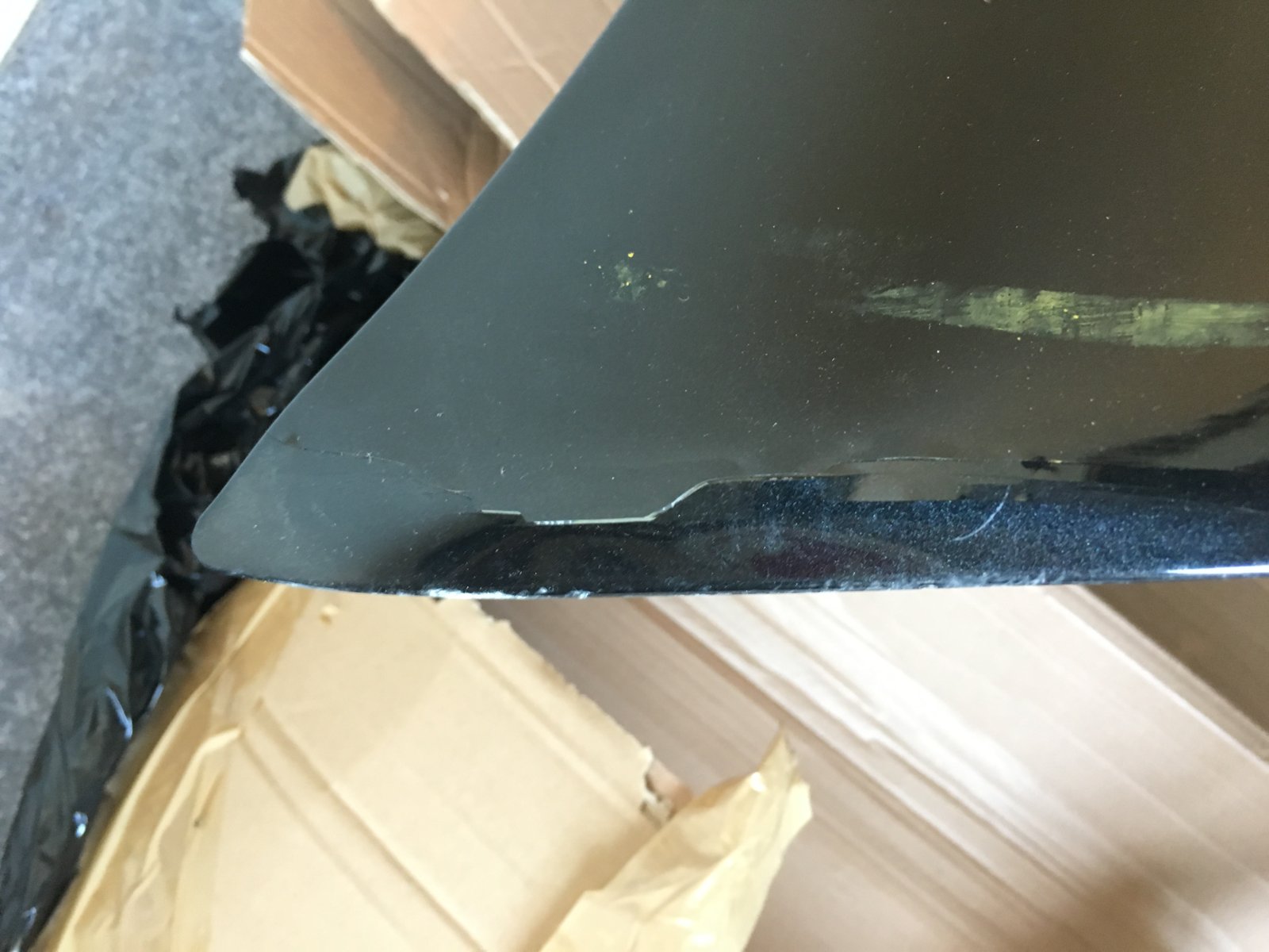

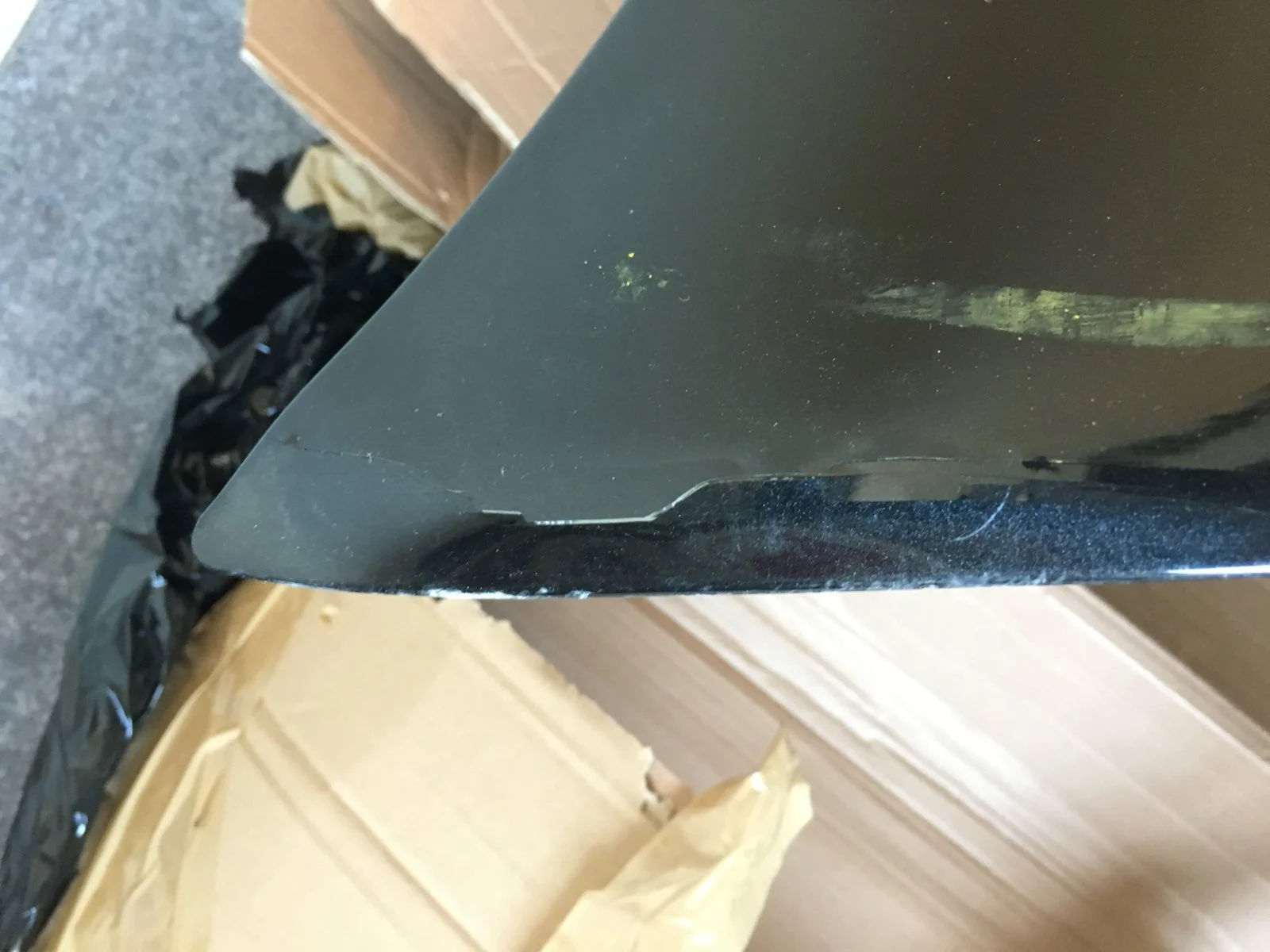

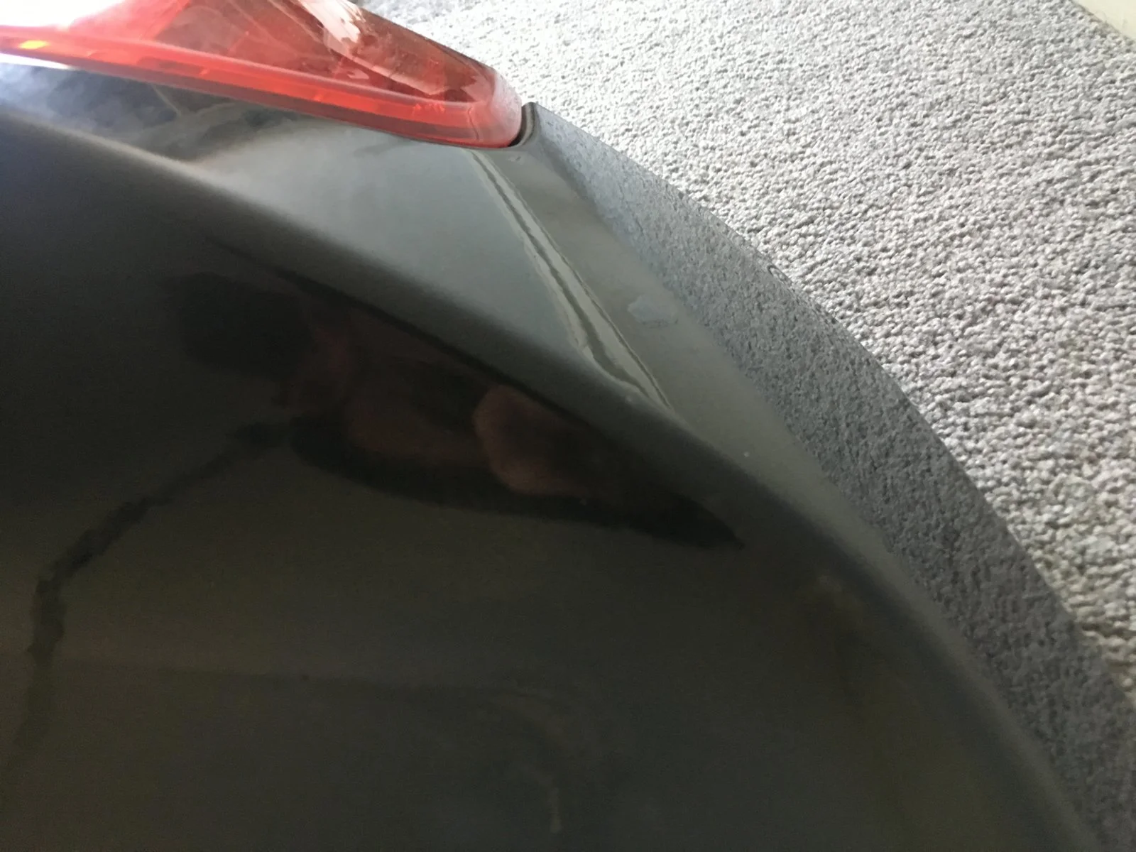

Don’t know why I do this to myself. Want to facelift the rear and bought a LCI bootlid and have been in contact with @gally to have the work done. The item arrived today (eBay). It’s heavily damaged. Both corners damaged, one very badly. There’s damage all over it even though it was described as ‘light scratches’.
The corner damage is obviously the courier but the other stuff can’t be due to where it is and how it was packaged
Hard to picture tbh but it needs a lot of work. Contacted the seller. Also tried to open it when the courier dropped it off but it was packaged with about 3 rolls of packaging tape and was very difficult to get in to

Should’ve just sourced one which I could have picked up! Let’s see how this goes with claiming against the seller/courier. I don’t have much hope. Cost £105

I’m just about to embark on getting the rear sturdy replaced as because as I like the low look of the rear fully expect something has worn out causing it to be so bad over bumps ? where did you get all the bits from?
Crybert
  Cup 172
Sorry to hear about the Bootlid. Hopefully you get something sorted.
The struts were from carparts4less £88 the pair
The lower mounts and dust covers were off eBay, around £35 for all those bits. I would recommend getting new screws for the lower mounts if you’re gonna replace them as they rust quite badly
Crybert
  Cup 172
It’s an easy diy too. Once you’ve worked out the first one the next takes minutes to get out and the new one in. Just take note of the order which the bits go together as I didn’t and it caused a bit of issue initially

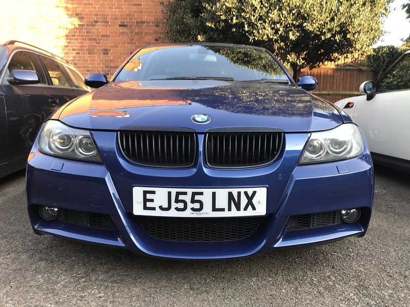

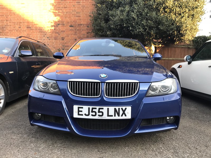

Have you still got the original kidney grills? I’m tempted to give matte black a go on mine - the chrome front end really jars when I look back, but I worry it’s a slippery slope and I’ll be putting an ///M badge on next ?
Crybert
  Cup 172
Yeah still original. I think the chrome grills look good with the grey. On the Le Mans blue they can look a bit bling, think it’s the blue that sets it off
