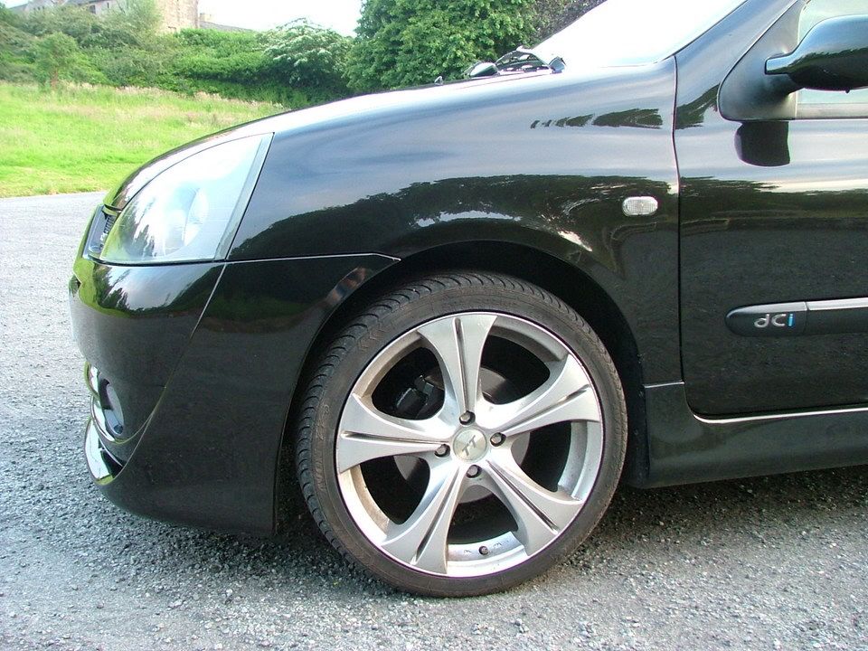

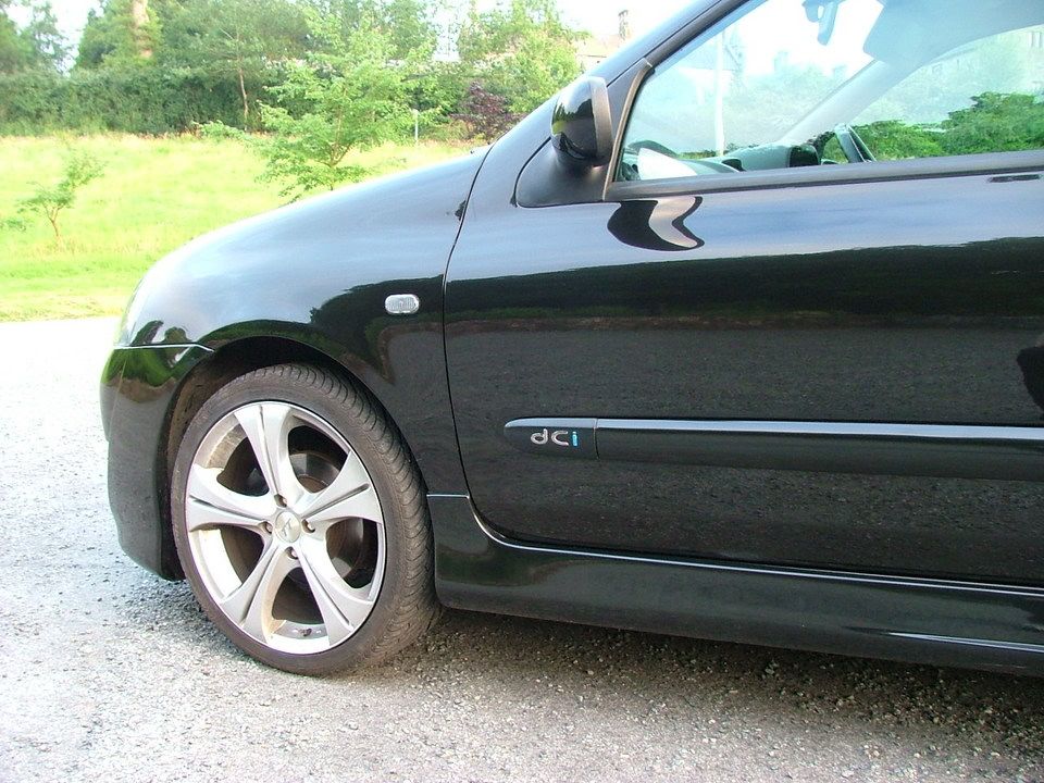

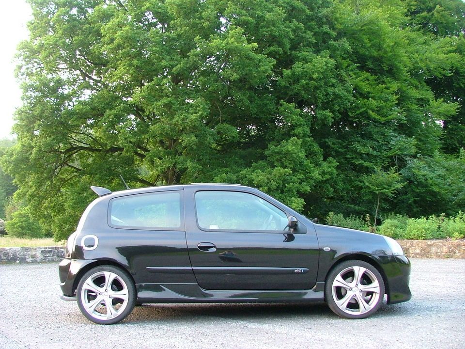

Since the only thing left on my "wish list" for the car is to lower it - ive been doing some thinking...
After a bit of surfing online, and asking around, topped off with my in-experience of lowered cars - my brain is fried! :confused:
So a little advice/opinions is needed please.....
*** Is there an Apex Kit available for the Dynamique dci ?
*** Sould I go for the uprated dampers or just the 40mm springs?

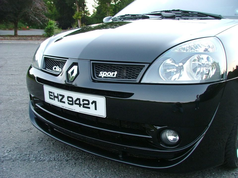

PS - my modded bumper already has a little trouble on standard dynamique setup :eek:

My dci IS a dynamique - 1.5dci 80 Dynamique :D
Are the dynamique std shocks ok to lower with? or should I go for a shock/spring kit?
Is it true the dci will bed-in a little lower at the front with the heavier engine than the petrol models?
Im guessing this is why there is not as much choice for suspension kits to suit the dci - but I dont know:confused:
  "Navy" N17 TWO
40mm would definetly be my limit - front bumper already has trouble on std setup - Cant afford to risk wrecking my bumper after the time/money has went into it

Its the front splitter I need to be careful of
