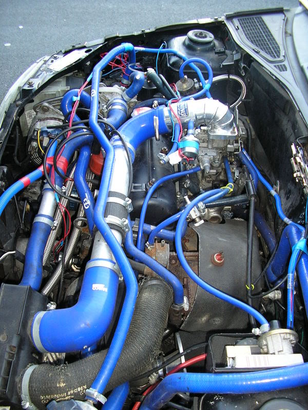

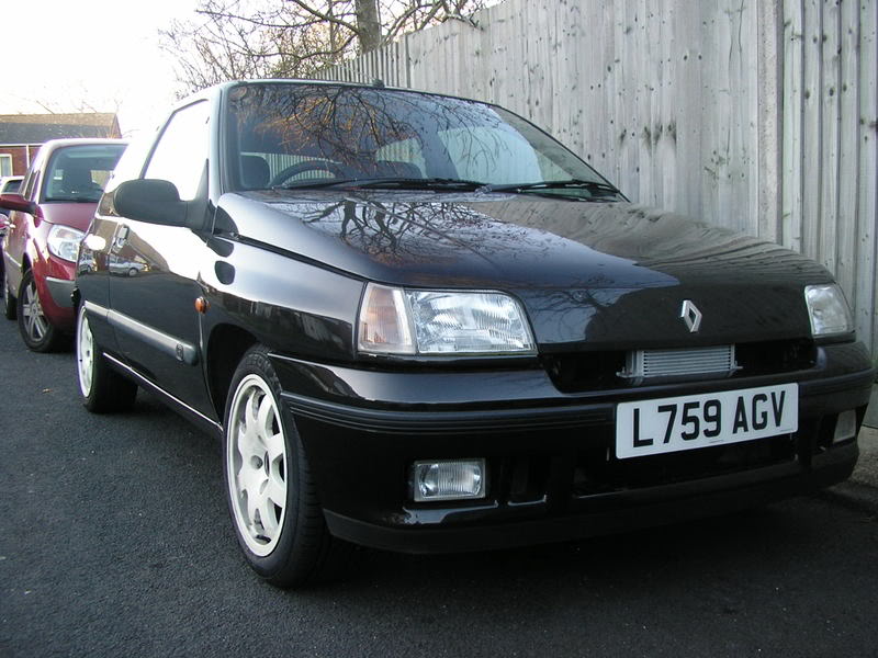

this was my old one which was a valver
Its a must! the sound of turbo :o ... Would love to see that go ivan :cool: , did it feel quicker than your 172?
alot quicker than the 172...it was alot more raw as i had to loose the abs and power steering to fit the lump..and had to relocate the battery to the boot...i do miss it but it just wasnt practical as an everyday car that ran 30 miles a day
