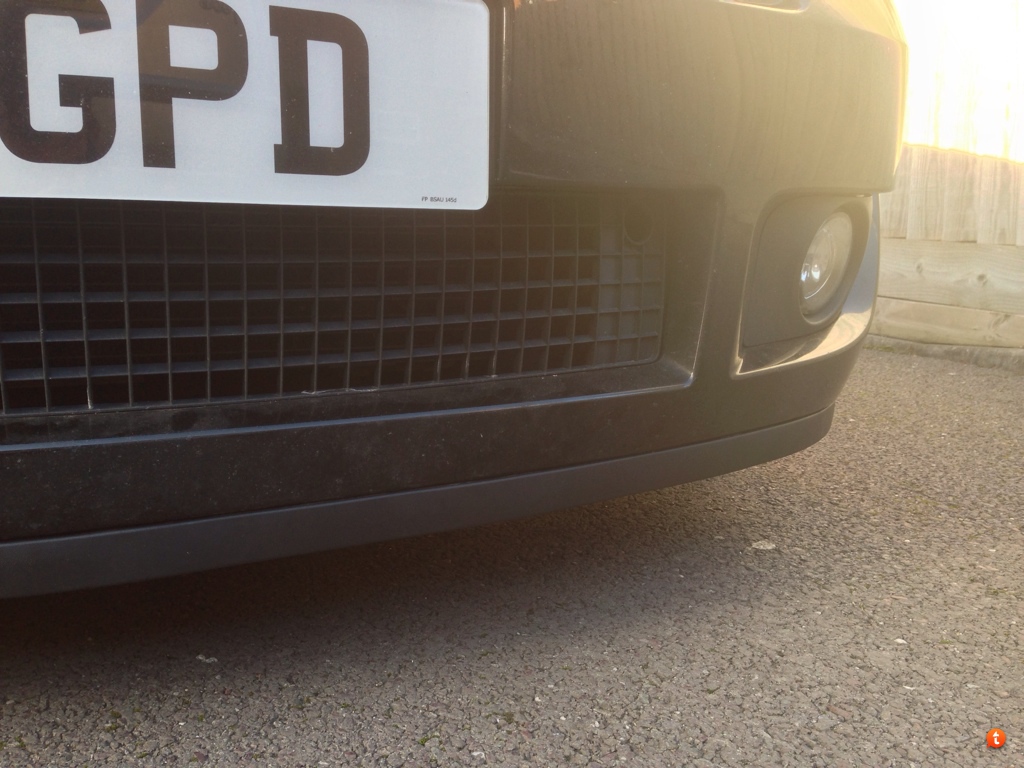

Skoda Fabia splitters fit nicely btw
Cheers, the door is a different shade, this is due to the previous owner getting into a scrap with a shopping trolly, for that reason I HPI checked it before I bought it, it does bother me a little but you can only really tell if your in the right light to see it.
Looked at the skoda splitters, god there expensive!, I think I am still swayed towards a vented laguna splitter to be honest, half the price too :)
Ahhh makes sense!
The skoda splitters are £13 iirc? About as cheap as you are going to find mate!
Unless you think I meant the actual RENAULT CUP splitters?
Here's what £13 and a couple of screws looks like!
