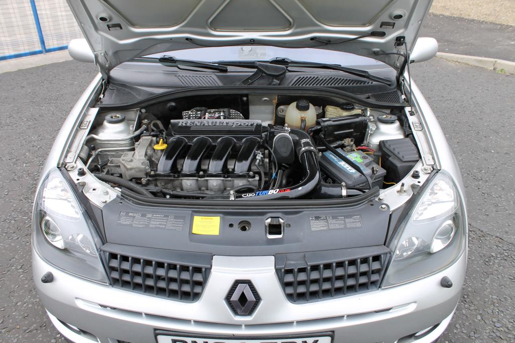

-One of the boost pipes is rubbing on the bonnet so its taken a little bit of the paint off. I'm gonna either try to lower it a touch or put something between pipe and bonnet to stop it doing so then touch it up.
-Got some of the 3D printed washer blanks coming so going to paint them and the bullets the same anthracite as the Turini centre cap's diamonds & the front and rear diamonds.
-Pioneer Renault fit speakers are in but need to tackle the tweeters and fit the steering wheel control leads
-Fit new fuse box cover (under bonnet one) as I broke mine being moody with it.

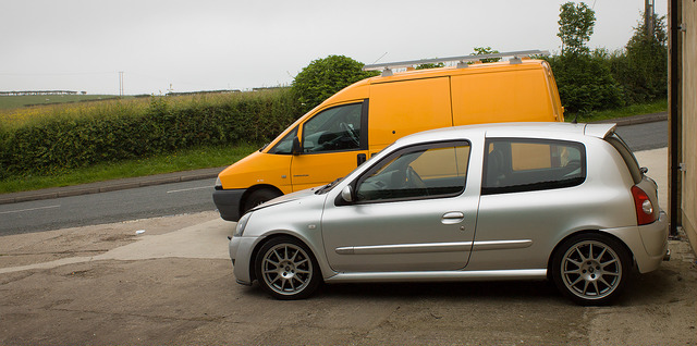

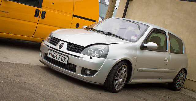

Well, the sun didn't want to play ball, and the car is well overdue a full detail (which will happen soon). However here is how the car now looks:
  Clio 172, Pug 106
Looks awesome mate! We will sort out that detailing day and get mine yours and Paul's some overdue pictures!

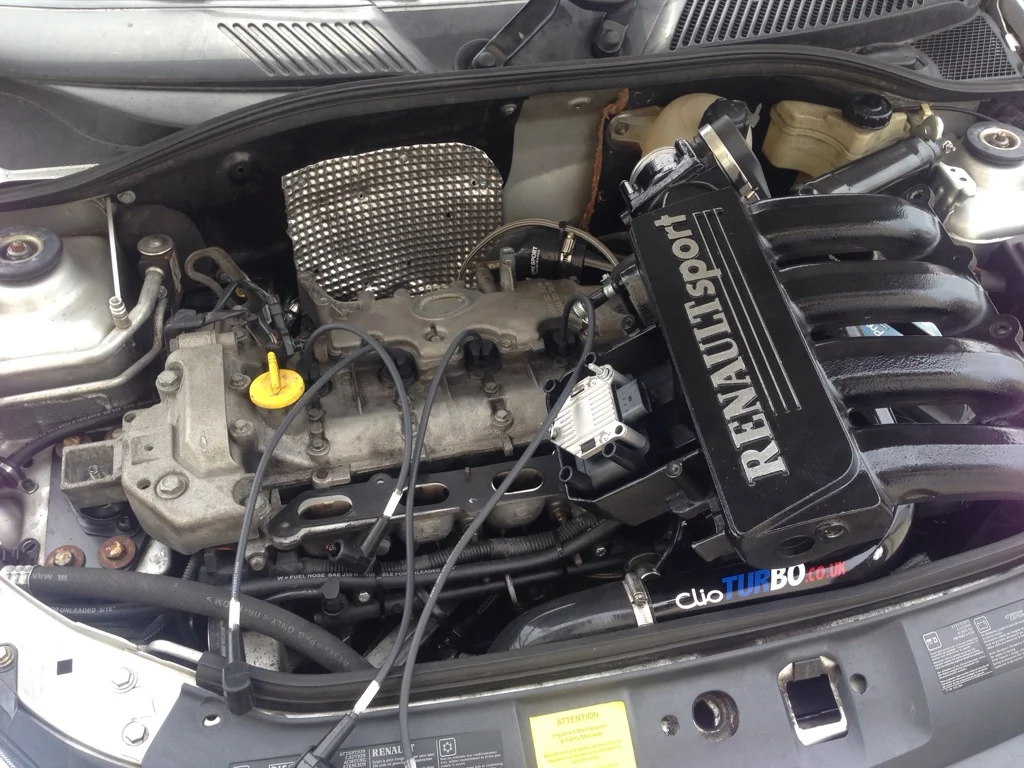

Started the car up after work on Tuesday and it was very rough. 2 cylinders rough. Called Andy and did some initial checks but to no avail. I decided I'd nurse the car home and get the laptop on the Adaptronic to help Andy diagnose what was up. 5 minutes down the road it decided it didn't even want to run on 2 cylinders.
Andy sent me out a new coil pack, leads and plugs via Special Delivery which arrived today. If these didn't sort it I'd be without a car until Andy could get to me.
Fitted them earlier :
And it fired right up!

I've just been out for a little country lane and A road rip and the car has been struggling with the coil pack for sometime it appears! It's taking off much better on boost now and the misfire as the turbo is spooling has gone!
