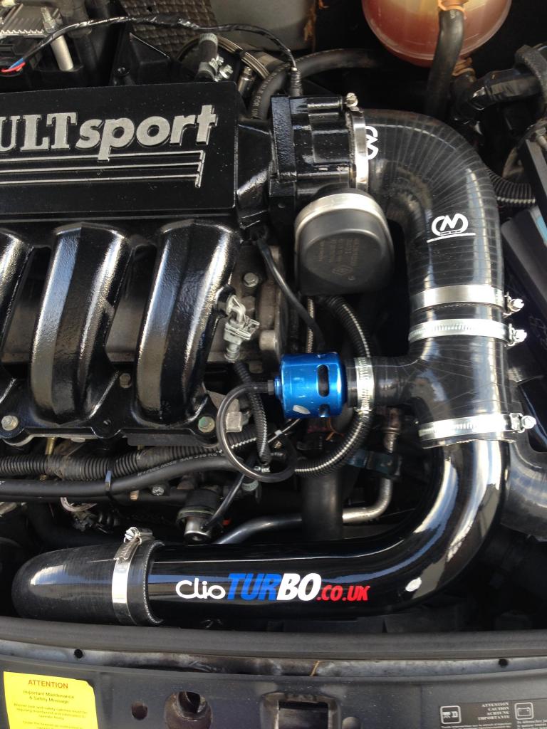

Ok, so some bits done on the car, none of which produced the expected results unfortunately. I bought some pipes/hoses from ASH to fit the Baileys DV26 and (Andy will kill me for this) chopped into the lovely boost piping he fitted to get a T piece in to fit the valve to. I also cut the vacuum line and used a T on this to operate the valve:
Unfortunately I was getting both a slight dump and a flutter/chatter at the same time which sounded really pants to be honest. Luckily I had bought an end cap to fit where the dump valve should be and a straight vacuum joiner incase all went wrong and I had to reconnect my boost/vac pipes. I'm just so relieved I got these bits as I needed them to reconnect everything! After some googling and whatsapp'ing Andy I realised this is because a car converted from N/A to turbo doesn't run as much vac as a car that leaves the factory with a turbo! So the Clio isn't creating enough vacuum to open the DV26 to let all the pressure out. Looking into a new valve that will work under these conditions but it's much further down the line as I have the following to sort...

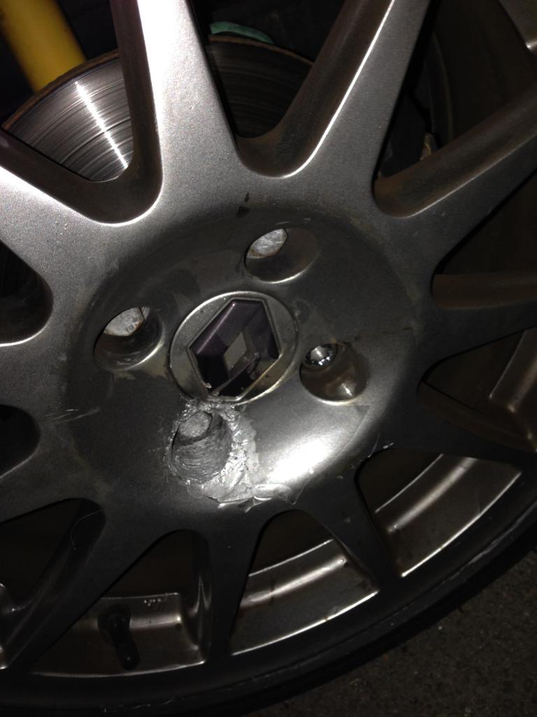

I had bought some crap Grayston locking wheel nuts when I got the Turini's which are the type with 4 pins on the key that locate into 4 holes in the locking nuts. The garage got 3 out before the pins on the key bent and wouldn't locate into the final locking nut. They tried to bend the pins back on the key which didn't work. They then tried to drill into the locking nut and knock in a socket with a hex key but this just tore the nut apart. In the end it had to go to a welder so that they could weld a wheel bolt to it to release it. It made a right mess but as the tyre on that wheel was the worst I authorised them to do whatever they needed to to change the tyre. Afterwards, I tried to tidy it up a little and here is how it looks:
Finding it a bit disheartening to be honest as I've ploughed a hell of a lot of money into this car and it's my pride and joy. Had many great comments about it being immaculate and so discreet so the damage to this alloy is really bothering me! The only plus is the PS3's are providing me with oodles of grip in the dry; I've just got to wait for rain to see how the grip is on wet roads!
I'll be after a single Cup Turini after payday so I can get it sprayed the same colour then will keep this damaged one as a spare and get some rubber on it when money is less tight. Need to get this car bob on again!

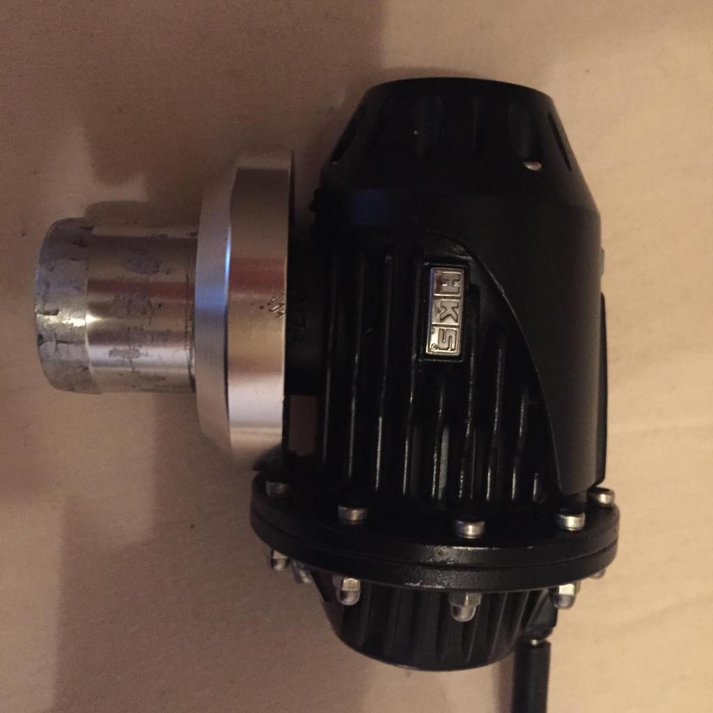

Also, after the fitment of the Baileys DV26 didn't produce the expected results, I had been keeping an eye on second hand HKS SSQV dump valves on eBay and put a few cheeky low bids in on a few. In the end this paid off as I got this for £45 delivered:
It's a HKS SSQV4 Black Edition (on examining it and comparing to real/fake HKS BOV threads I'm 95% certain it's real) but the only issue is the adaptor on the valve is 30mm diameter and my T piece's spout is 25mm diameter so it doesn't fit just yet. Ordered a 25mm adaptor for the valve from eBay so I'm just waiting on that now.
Dump valves seem to be frowned upon in the turbo Clio world but I've wanted that signature HKS blow-off sound since I became interested in cars so I'm really looking forward to getting this fitted!

Did you ever get the HKS dump valve sorted?

Not tried since as it was fluttering twice then blowing off. Going to relocate it hot side but cars struggling on boost at the moment. Think it's the CTS so I've ordered one from Renault. Temp guage dips slightly under harsh acceleration which I think is bringing in the cold map limiter at 4k. Also the needle was hunting yesterday so it's worth a shot. I can only get it on boost in 3rd gear or higher currently.

WTF is that locking wheel nut removal about!!
We get stuff like that all the time in work and have never left a scratch on a wheel, let alone mullering one!
That's shocking workmanship tbh.

Just read the bit regarding the alloy wheel issues, isn't that center cap removable? Surely they could have at least removed that to negate some damage? That's sickening
Nothing worse when you spend more time sorting problems than enjoying your car! Caused me to get rid of my old R6 a few years back, hope you get it sorted mate! At least before we do this photoshoot lol
Maybe mate, I don't think they were aware and my priority at the time was keeping a relatively quick car well within the limits of the law! I just told them to do whatever they had to to change the tyre as it was the most worn of the 4.

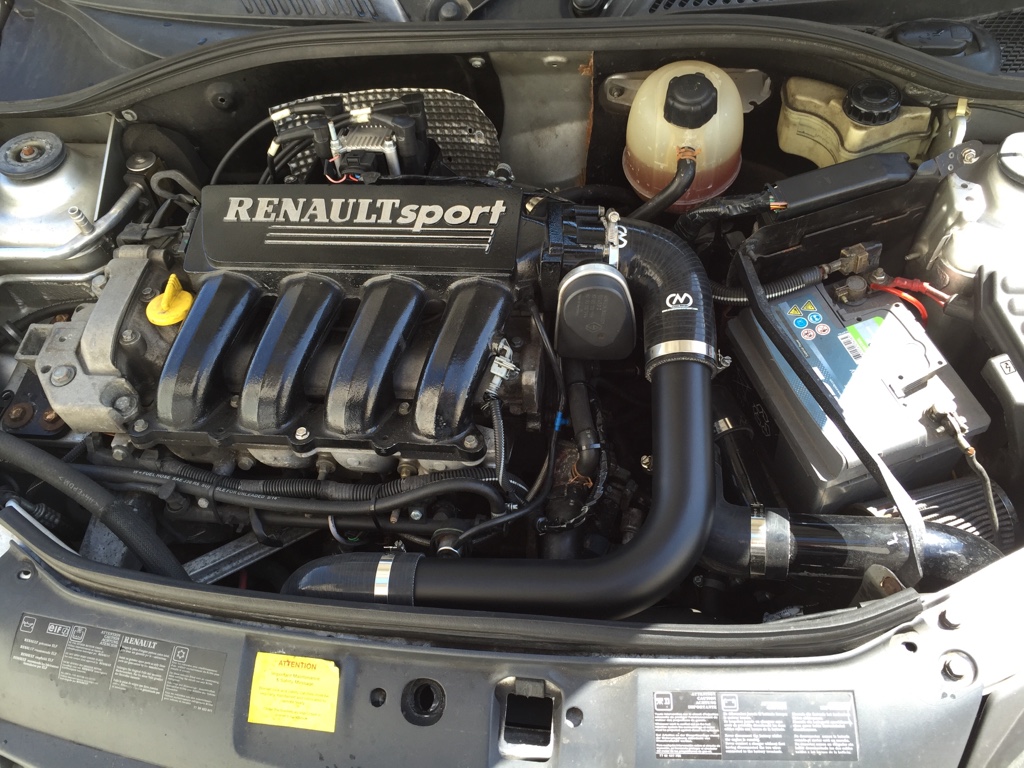

Ended up taking the car to EFI a few weeks ago and Andy had a tinker with it and Chris spent time updating the Adaptronic firmware and tweaking the map. The car drove fantastic, I was utterly overjoyed.... For 3 hours!
It started throwing the electronic warning light and limiting revs if I tried to give it any stick. I eventually got a P0120 throttle body/pedal circuit a fault so it went to Sparks & Sensors in Kirkham. Ryan got it to throw a 'throttle potentiometer tracks 1 and 2 incoherance' fault so rewired the tracks from pedal all the way to the body as there was no visible damage to the wiring. Job done.

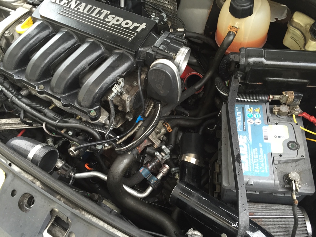

I had a 90 degree bend sat around so started to begin tidying things up. Removed the T piece for the dump valve and it's looking better already. Once the weathers better I'll remove and repaint the other pipes matt black too. Still need a Turini centre cap and one of the EXH008 exhaust mounts has sagged so I have one to go on when I have time. Looking into changing the cone filter too, maybe a Pipercross as Andy is now using these for his conversions. Belts are due in six months too so preparing for that.
