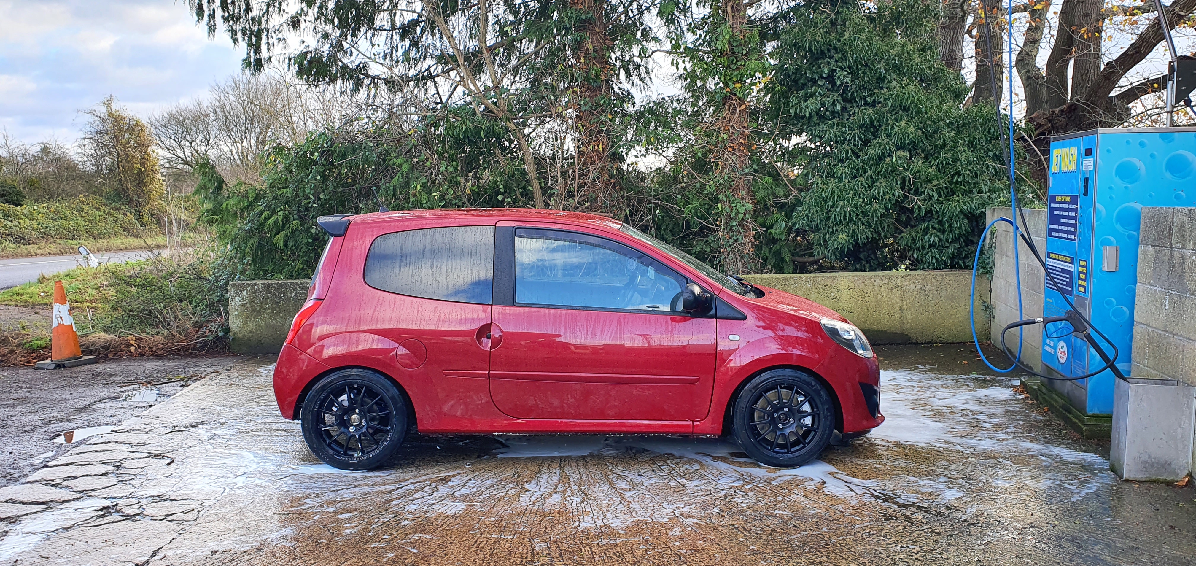

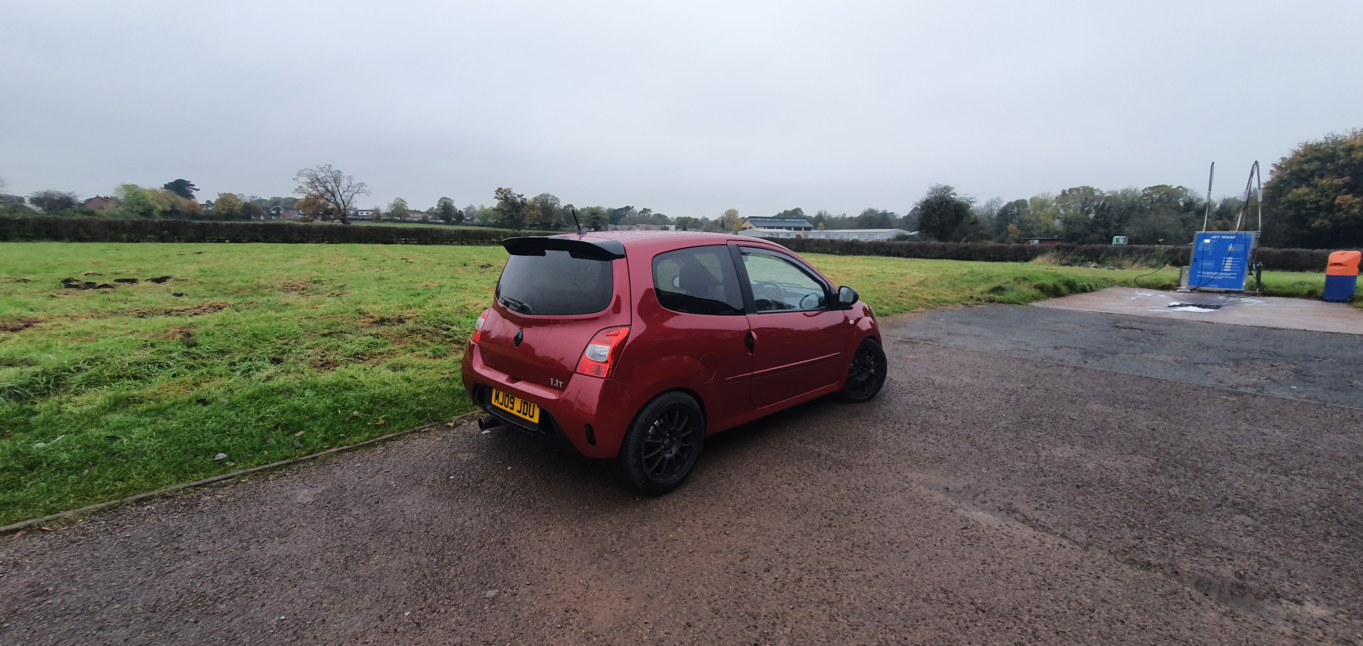

Finishing up on the swap now and very little left to do. Some tires, sort the wheels with a quick rattle can touch up and get the alignment sorted. When I get that done I will take the measurements for the rear beam and have that properly shimmed up so everything is properly squared up and set nicely.

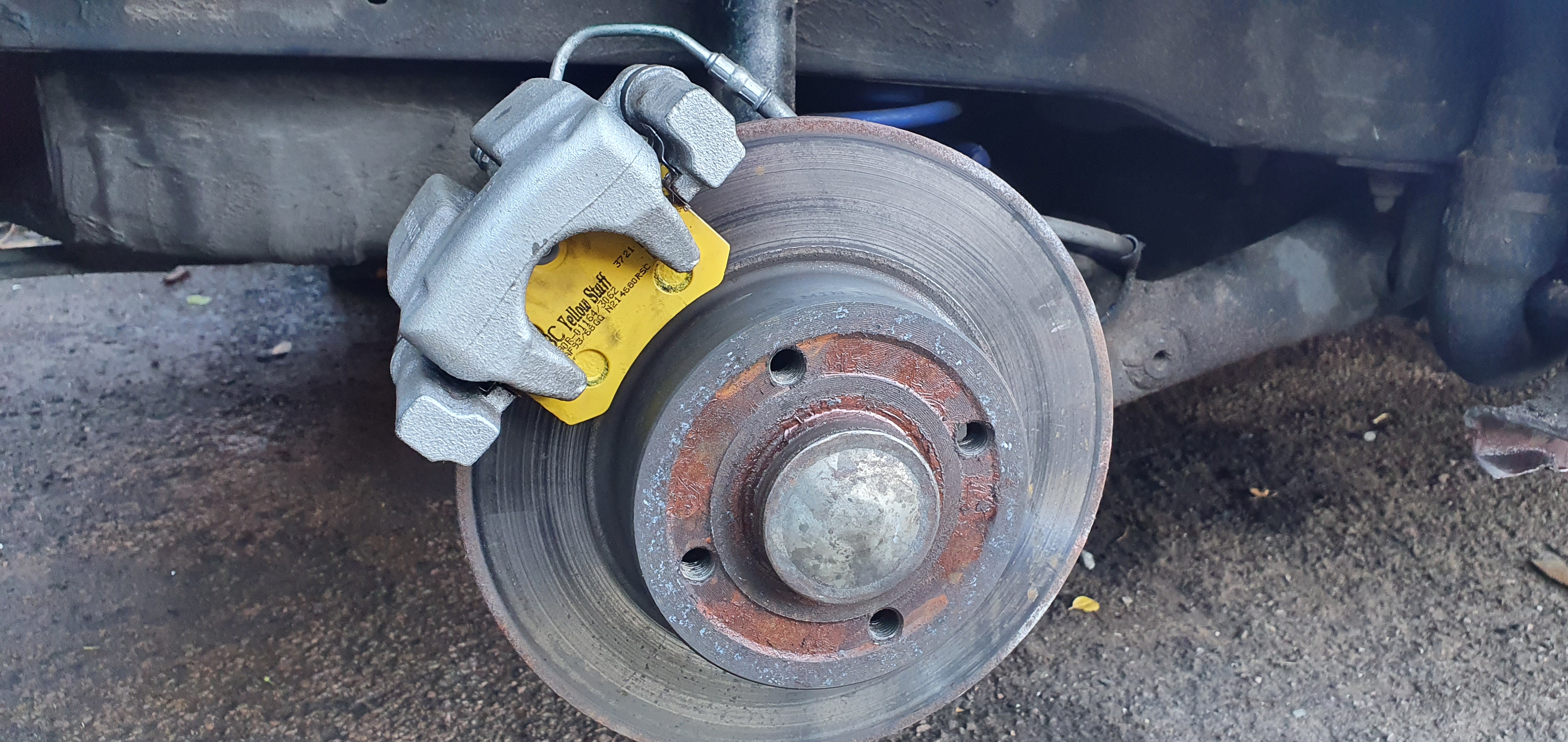

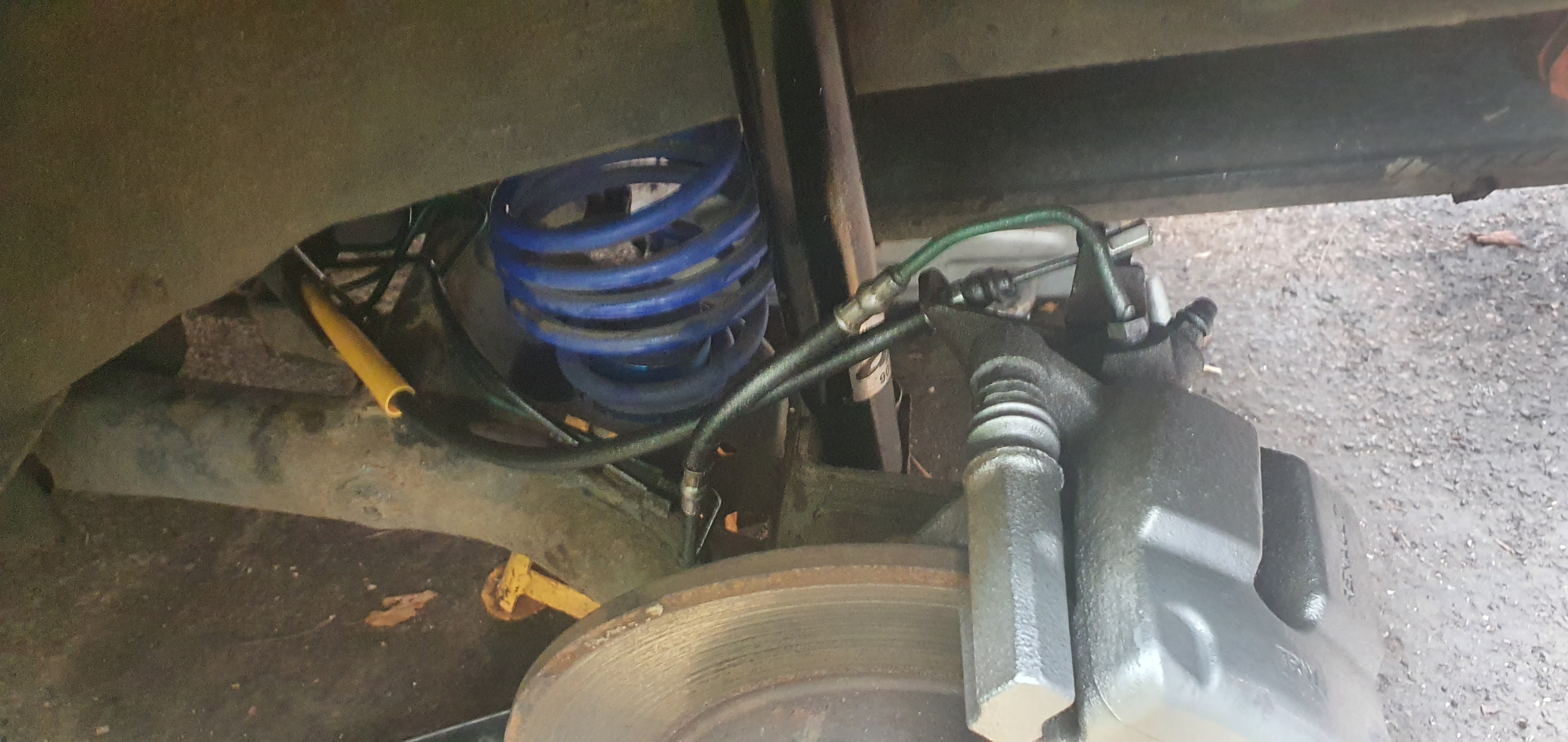

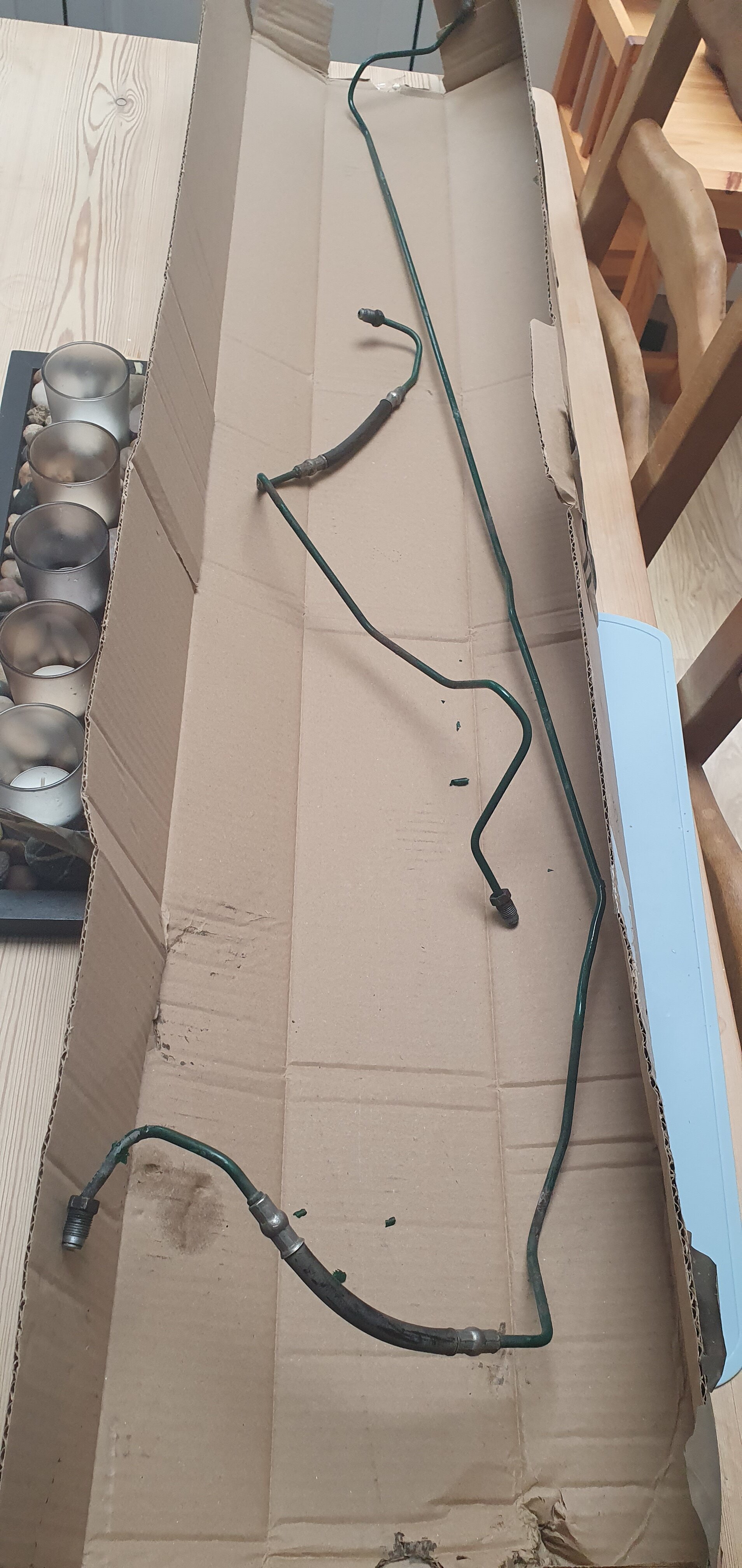

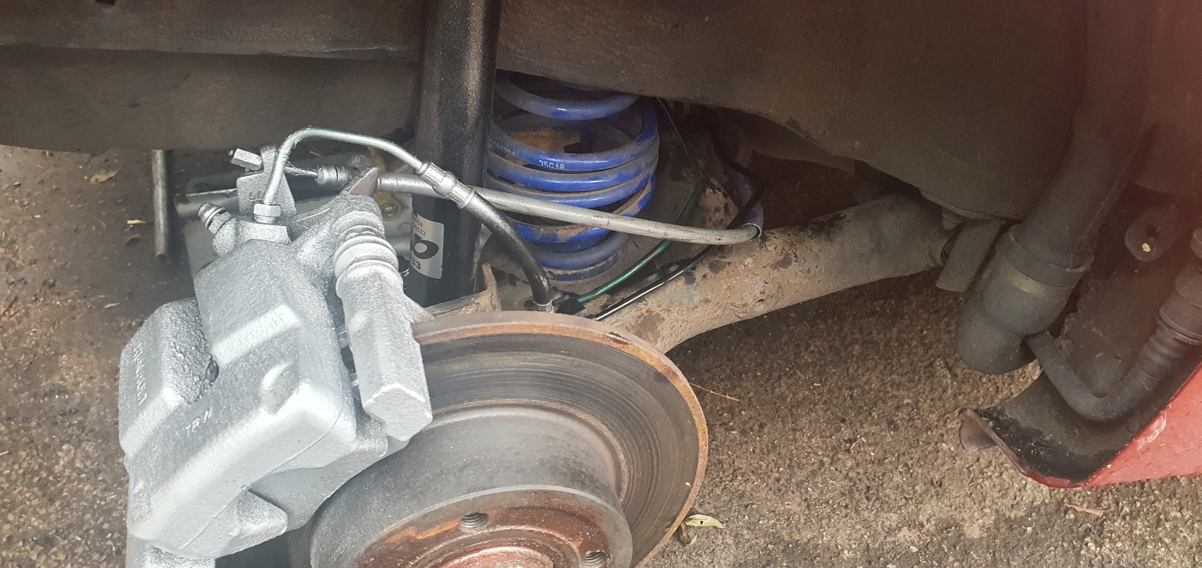

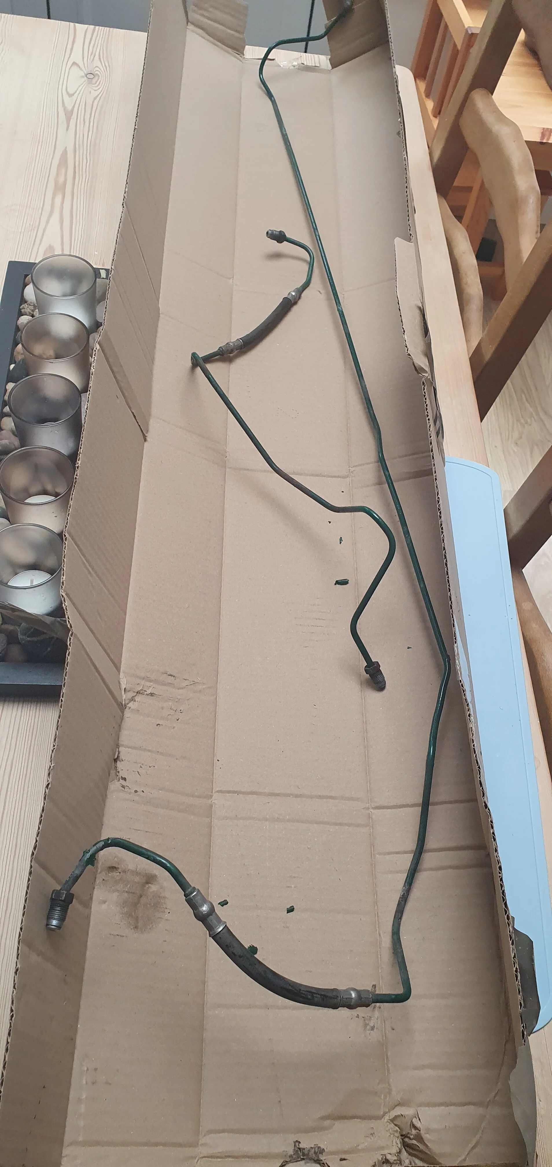

Big thanks to @YamYamRob who sorted me out with some OEM rs133 rear brake lines, these have the flexi section in to allow for movement in the calliper. I fitted them up this morning and gave the brakes a good bleed through with some fresh ATE type 200. That pretty much concludes this round of upgrades now, just need to put some miles on it all and check for faults or issues (y) I may even give it a clean :D

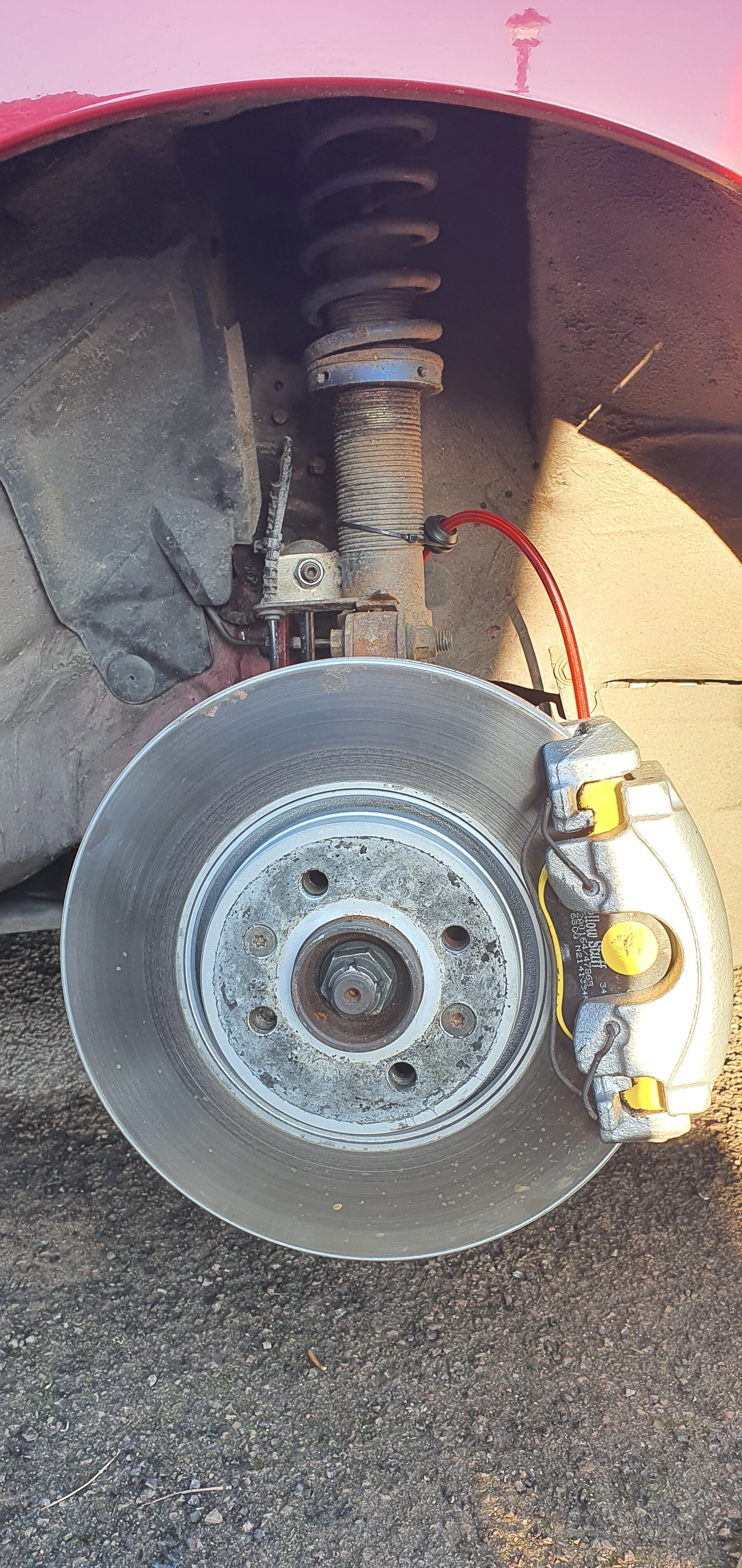

there's a few differences that I've noted. The spacing on the RS hub 60mm on the GT its 58mm. The RS hub is made for 14mm bolts the GT is 12mm. Then there's the tab for the arb as you mentioned. On my coilovers the lower hole is slotted up and down so it was spaced to suit both hubs, all I did to make mine work was sleeve the hub to 12mm and add the arb tab (y)
There may be a difference in mounting angle between the shocks on the standard GT and RS shocks but without them side by side I couldn't comment on that. Hope that helps?

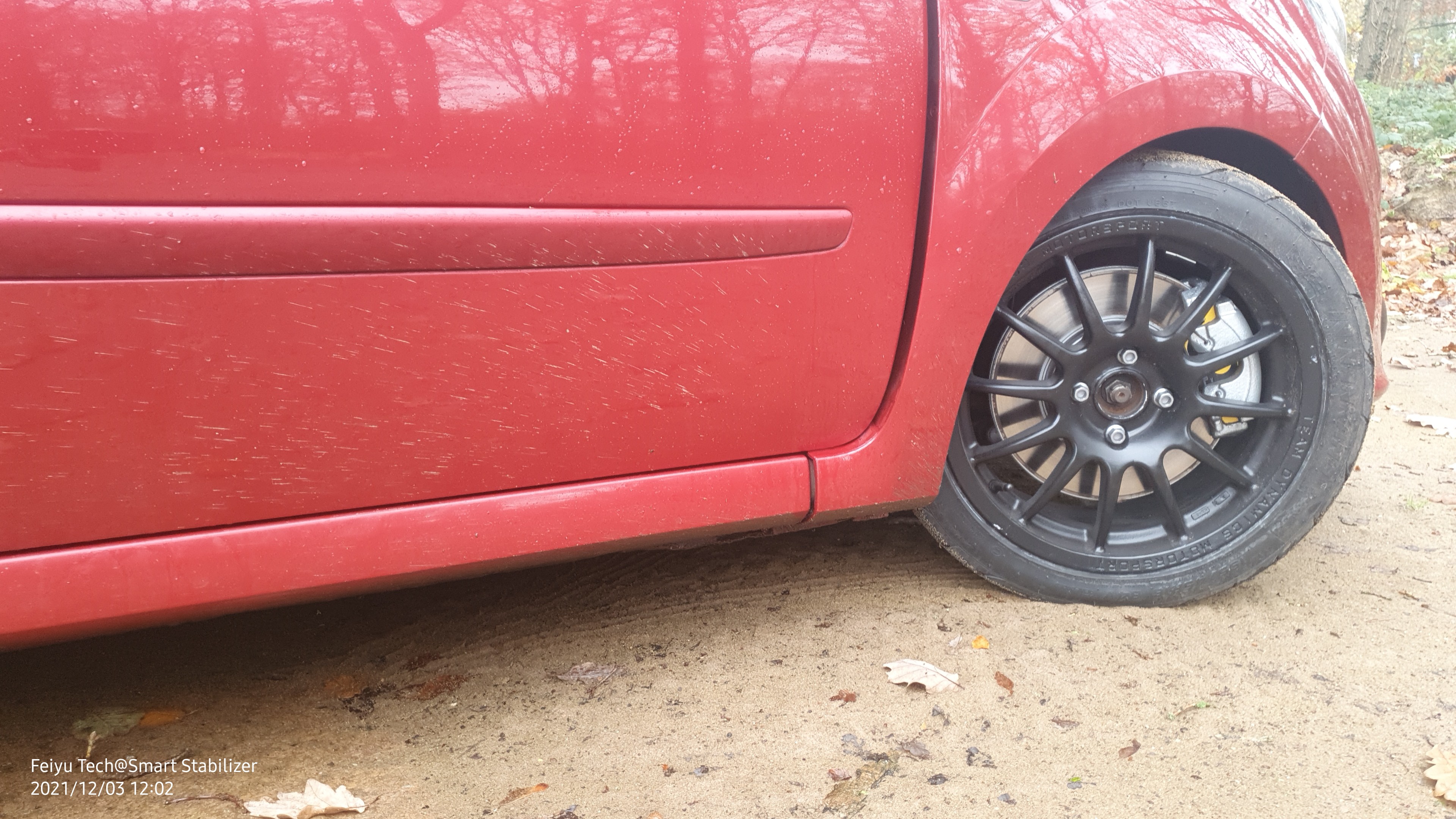

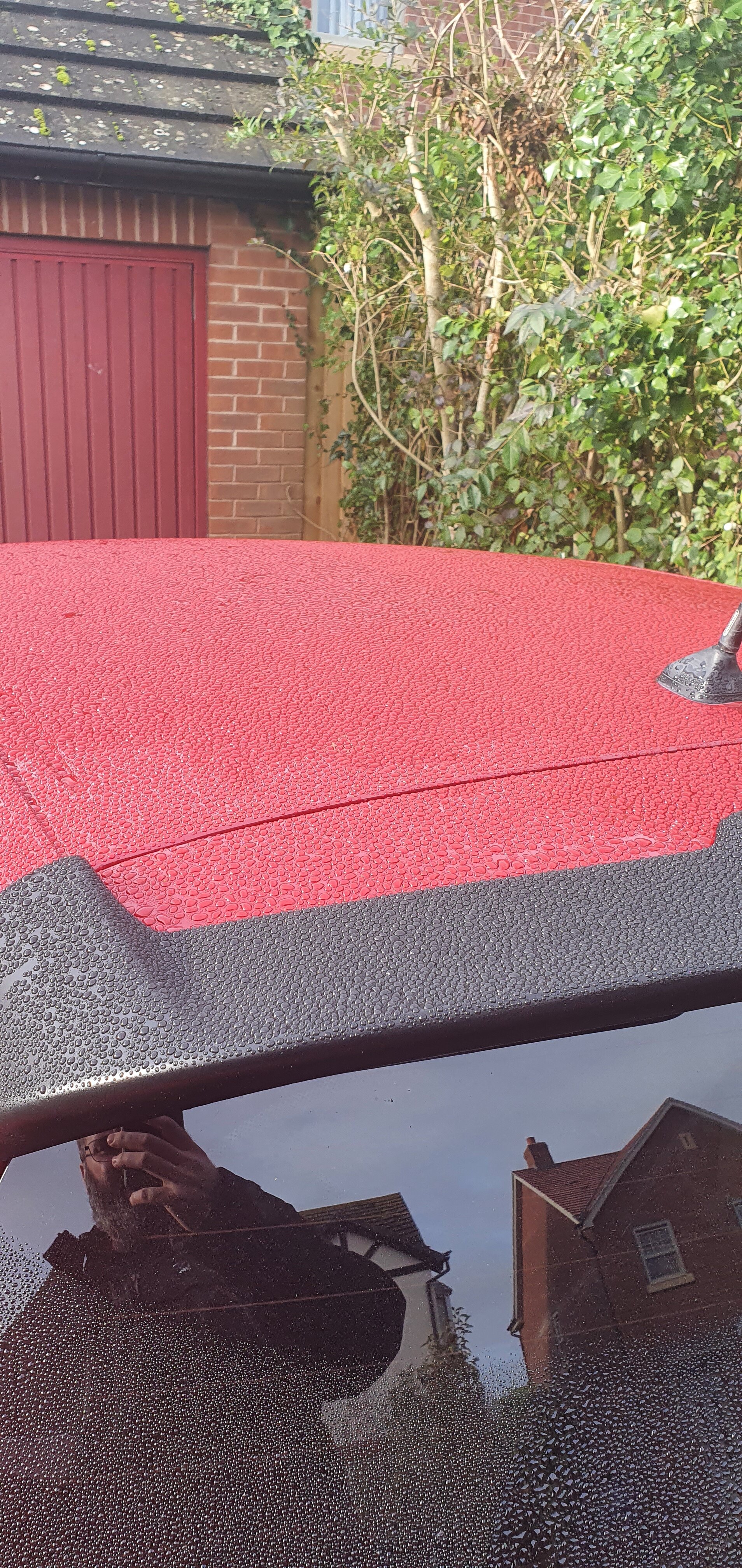

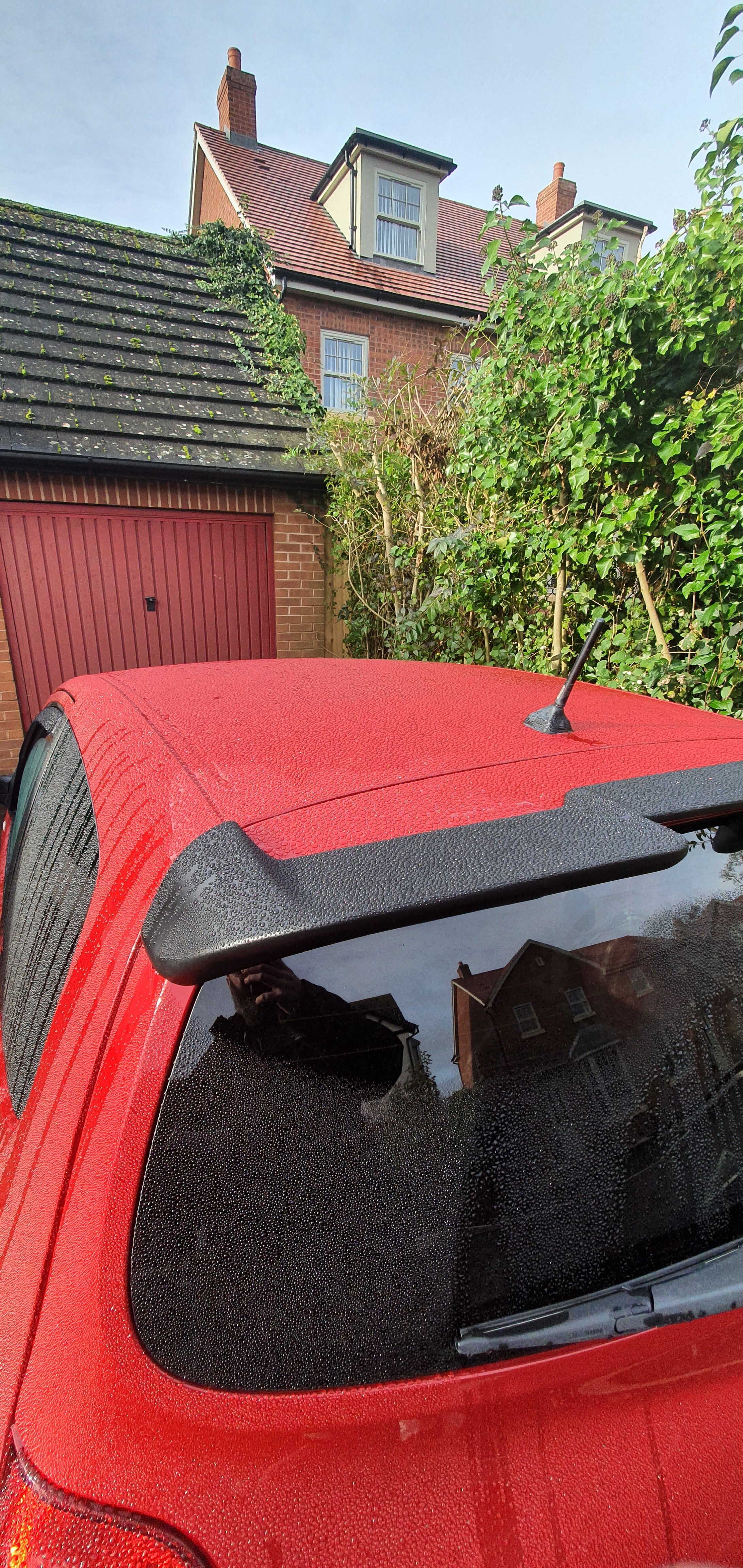

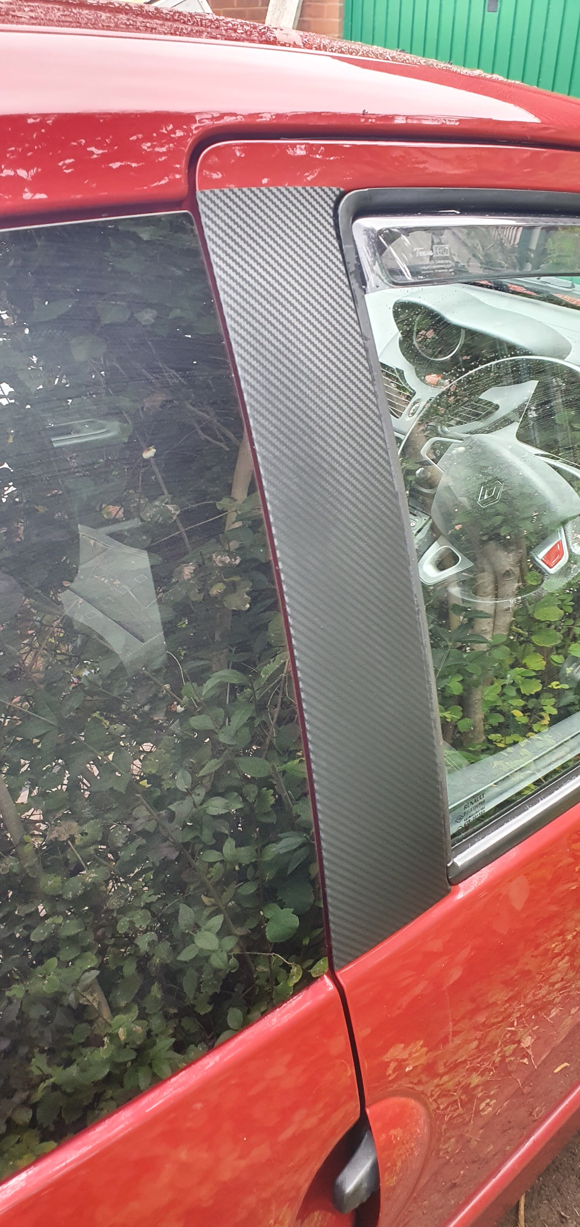

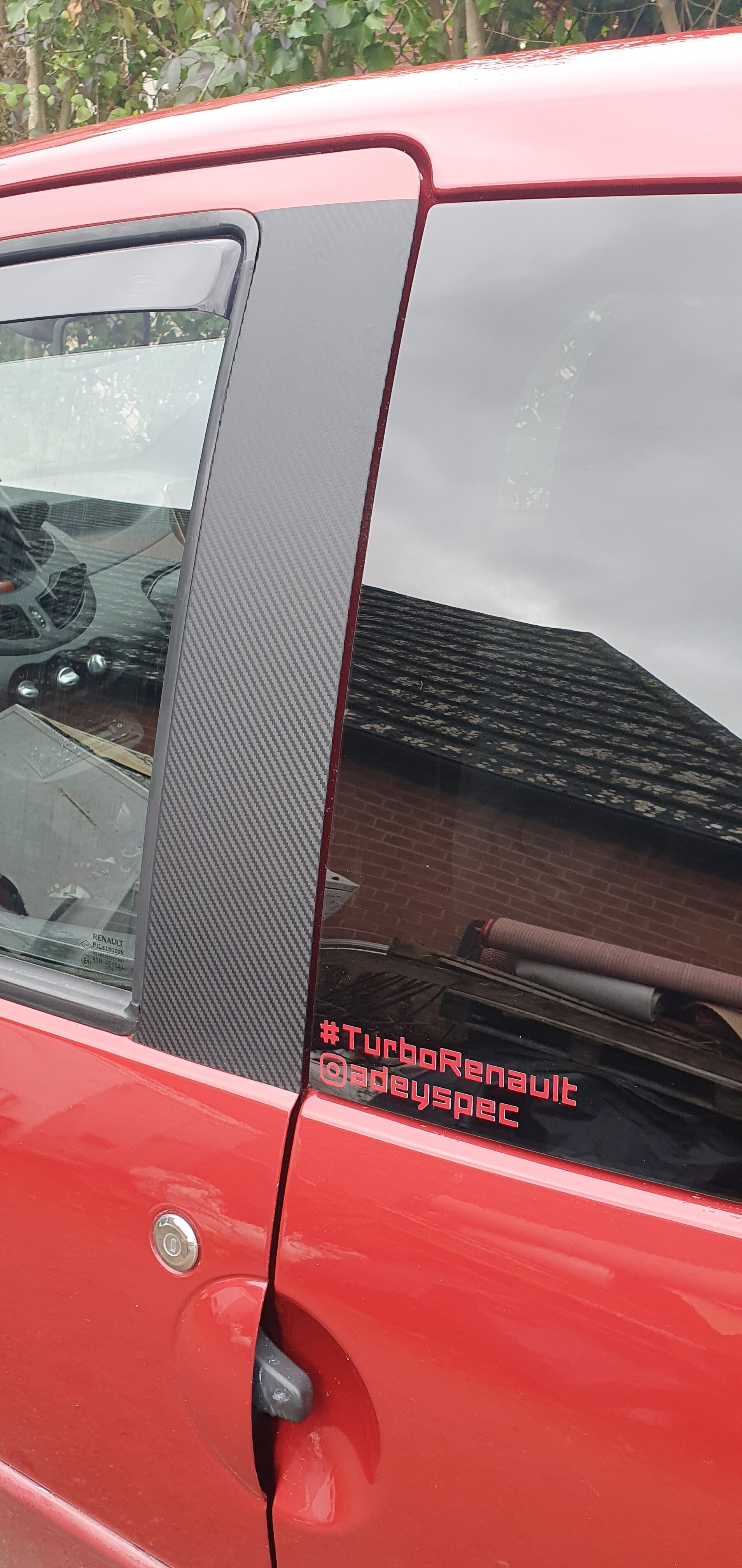

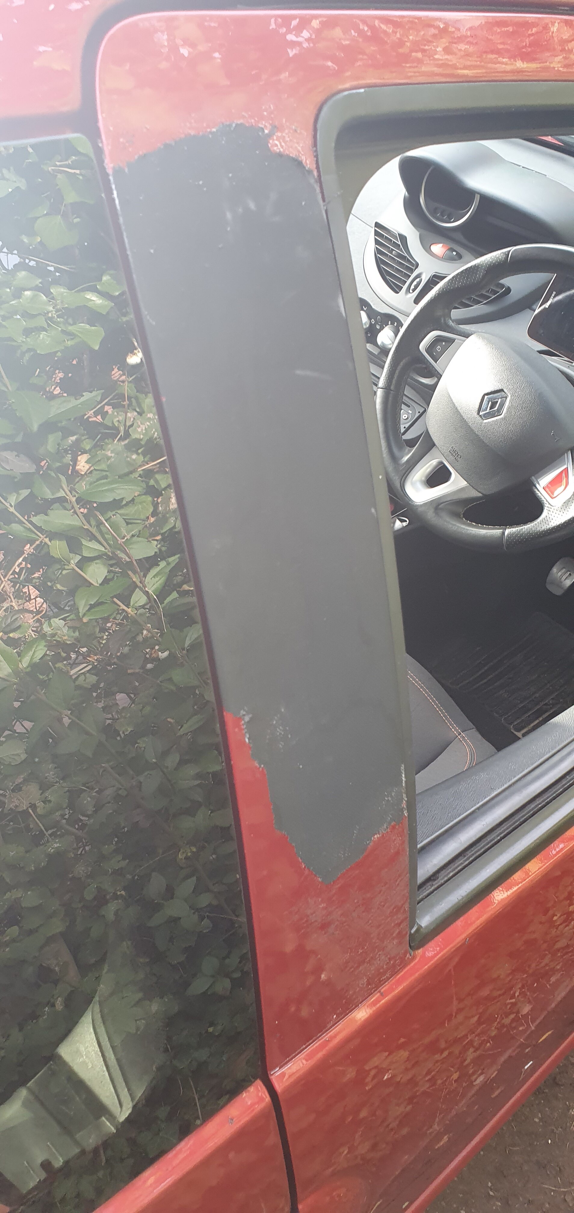

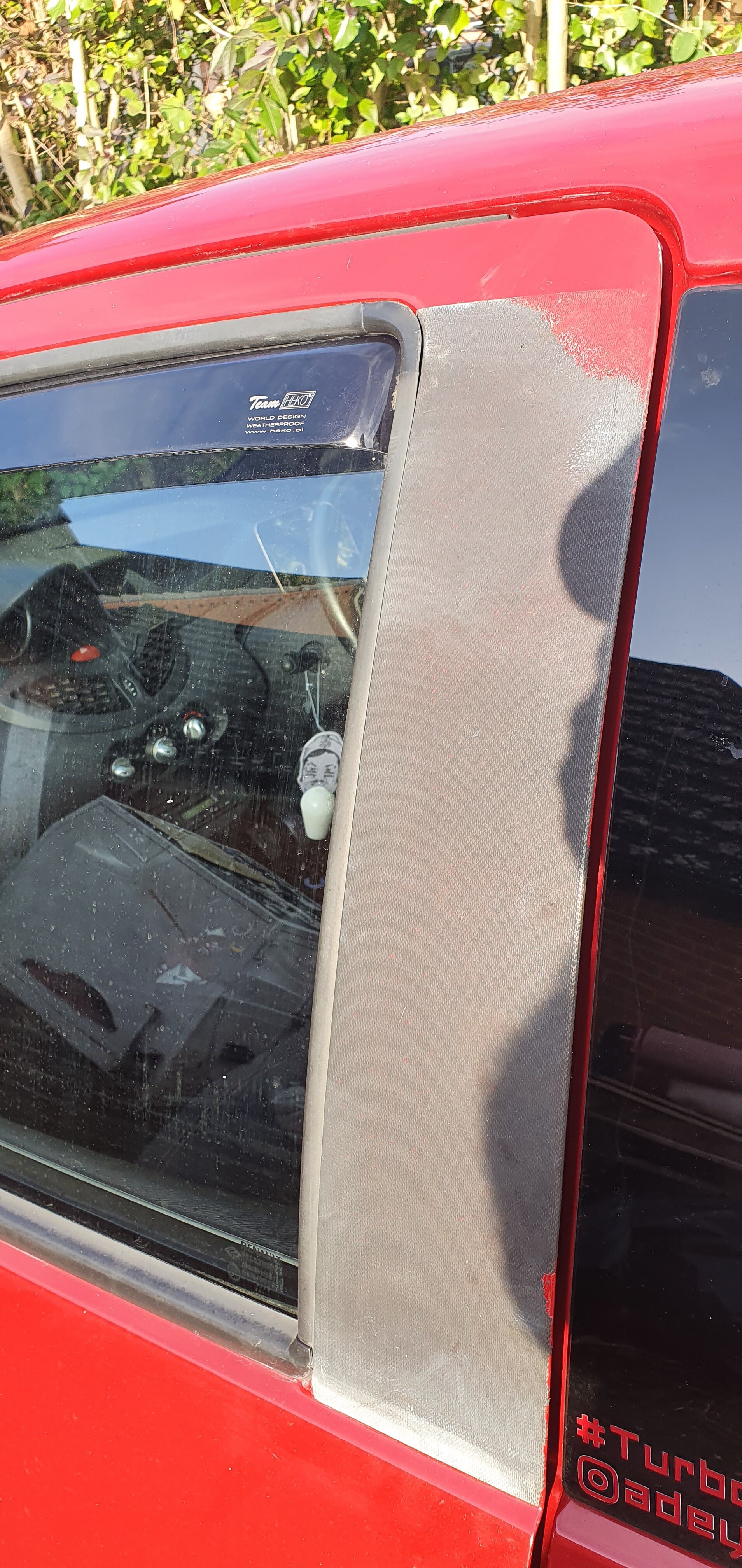

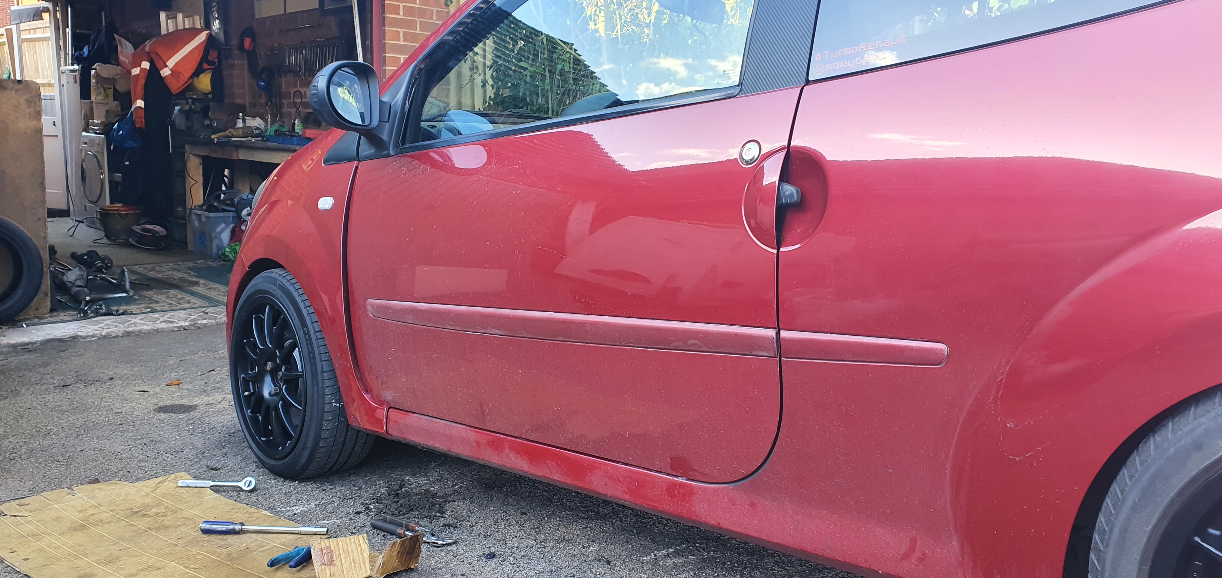

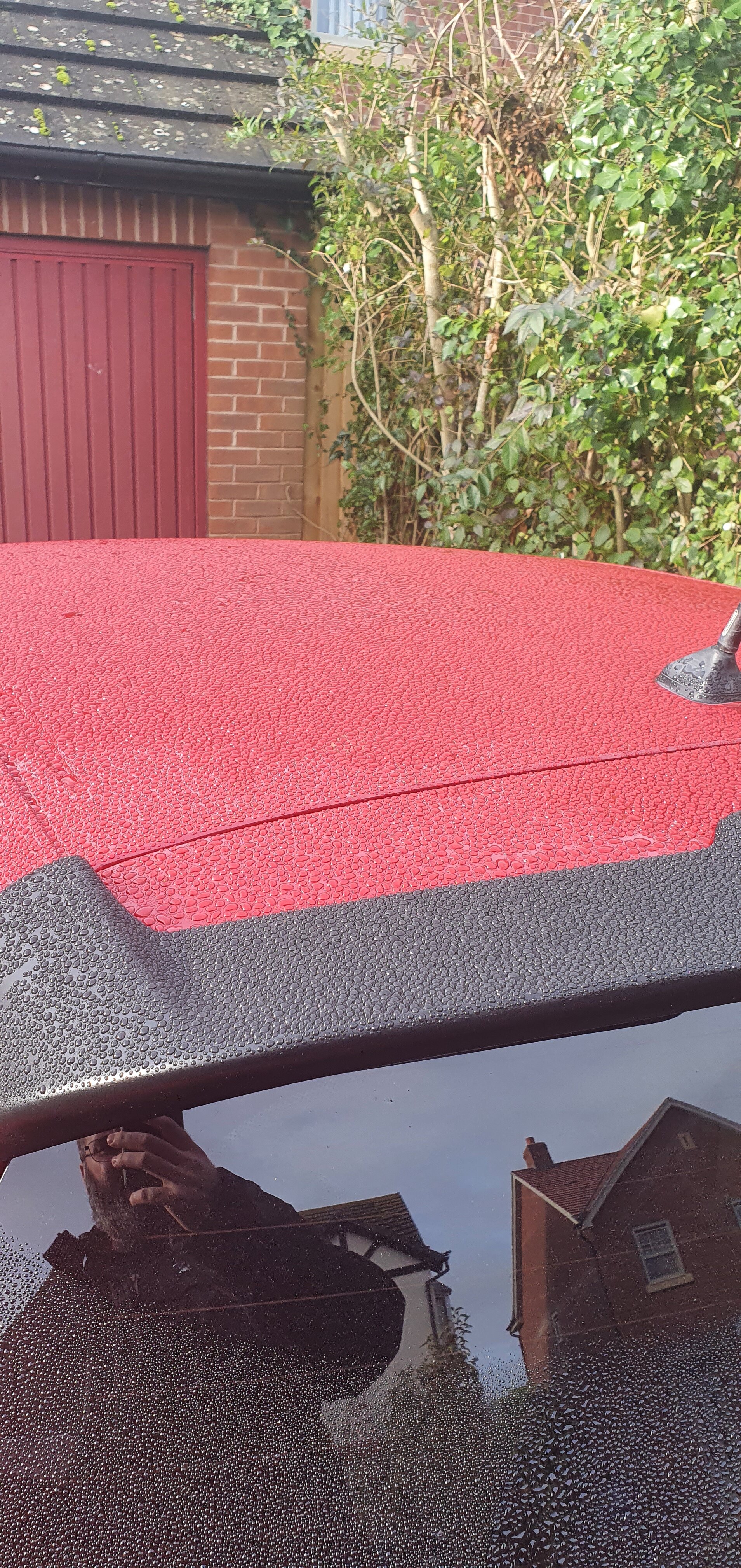

Another "make it look better" post, I replaced the B/Door pillar outer trims that had gone crusty. Well one had been replaced already but I removed all of it and fitted some new carbon look ones. TBH I think id rather pull the engine and box than have the job of removing the factory stuff again. What bollox that was. Any way got it all off and cleaned after about and hour and a half, then fitted the ebay supplied ones that seem nice and thick and good quality. Time will tell.
View attachment 1566193View attachment 1566194View attachment 1566195View attachment 1566196

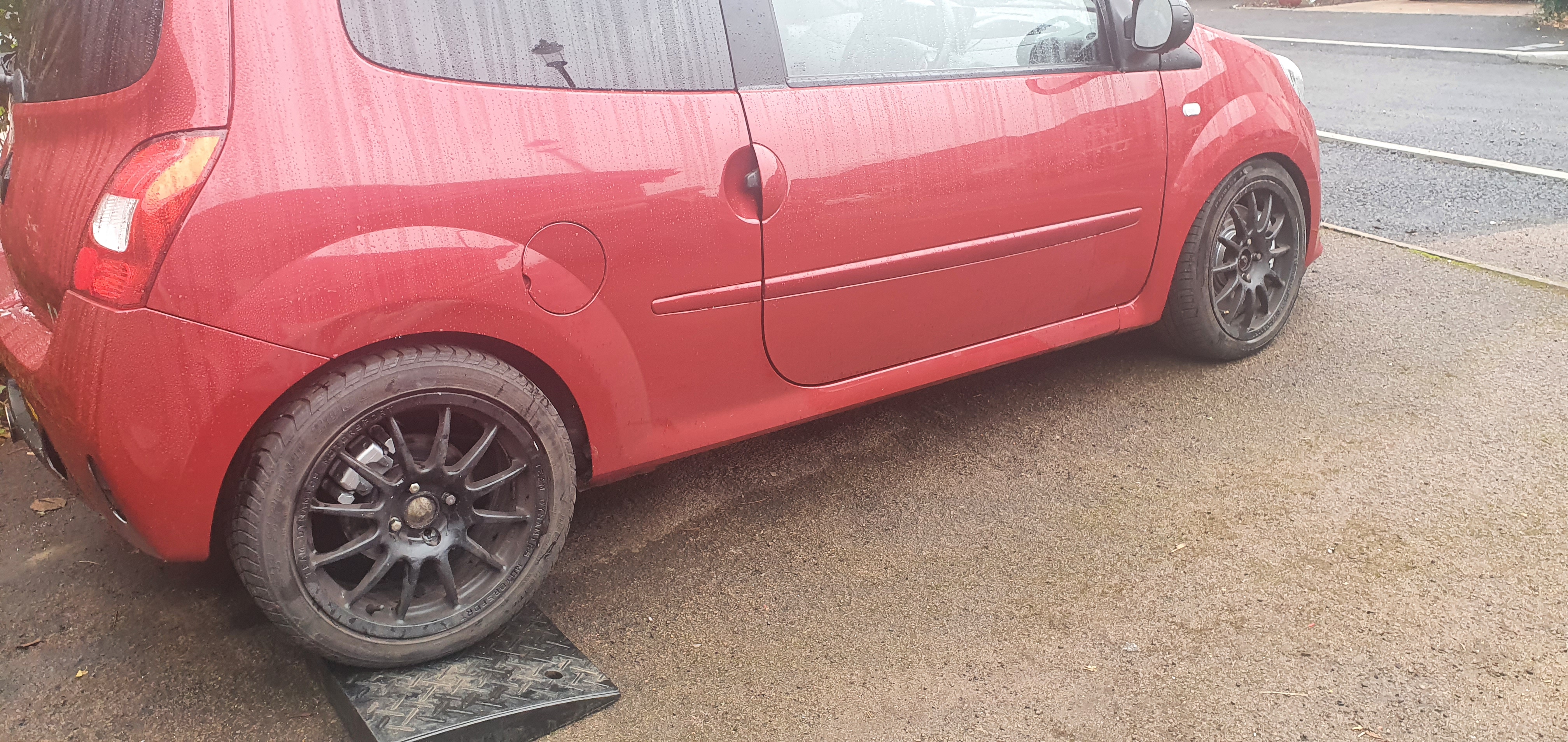

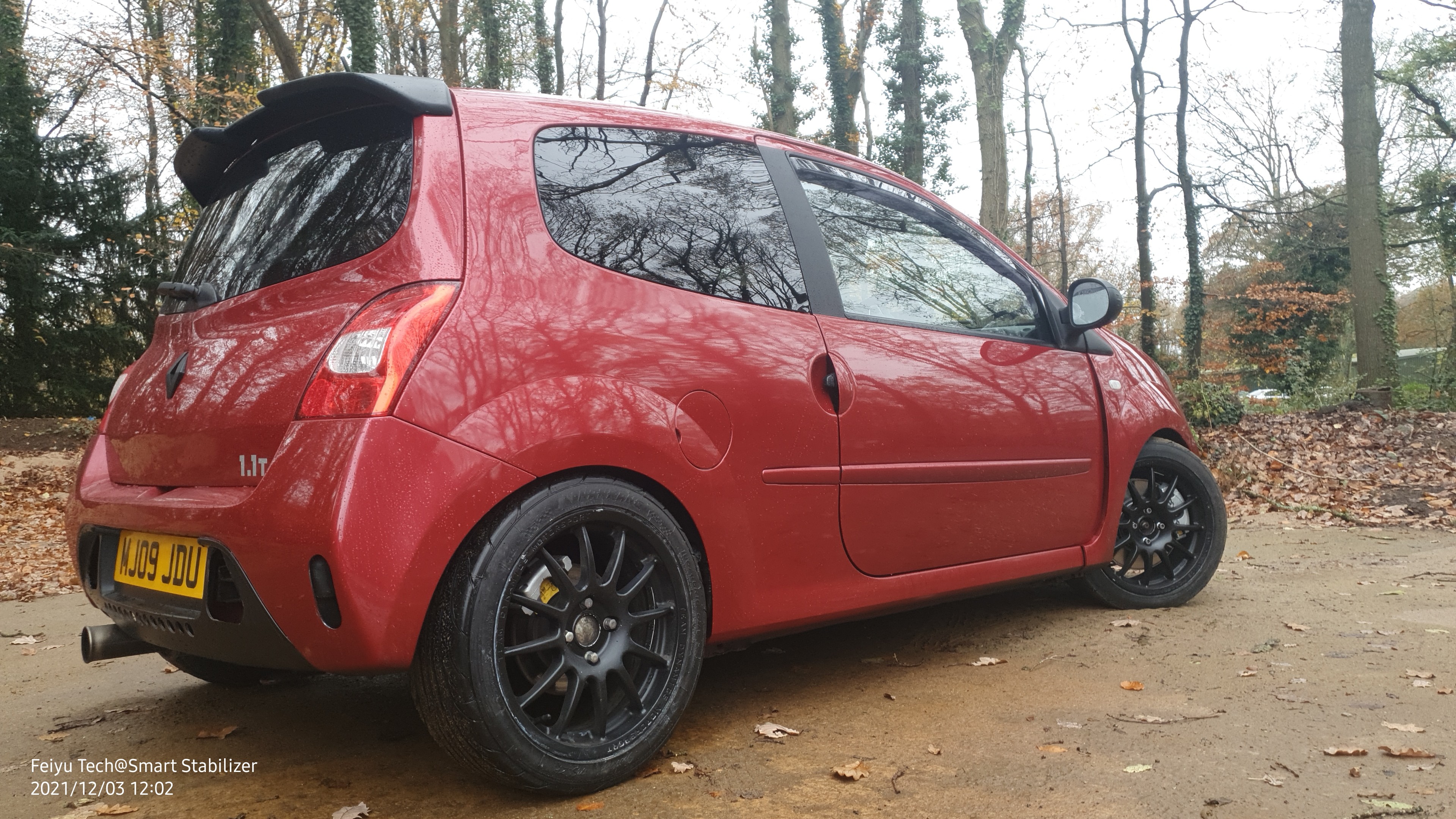

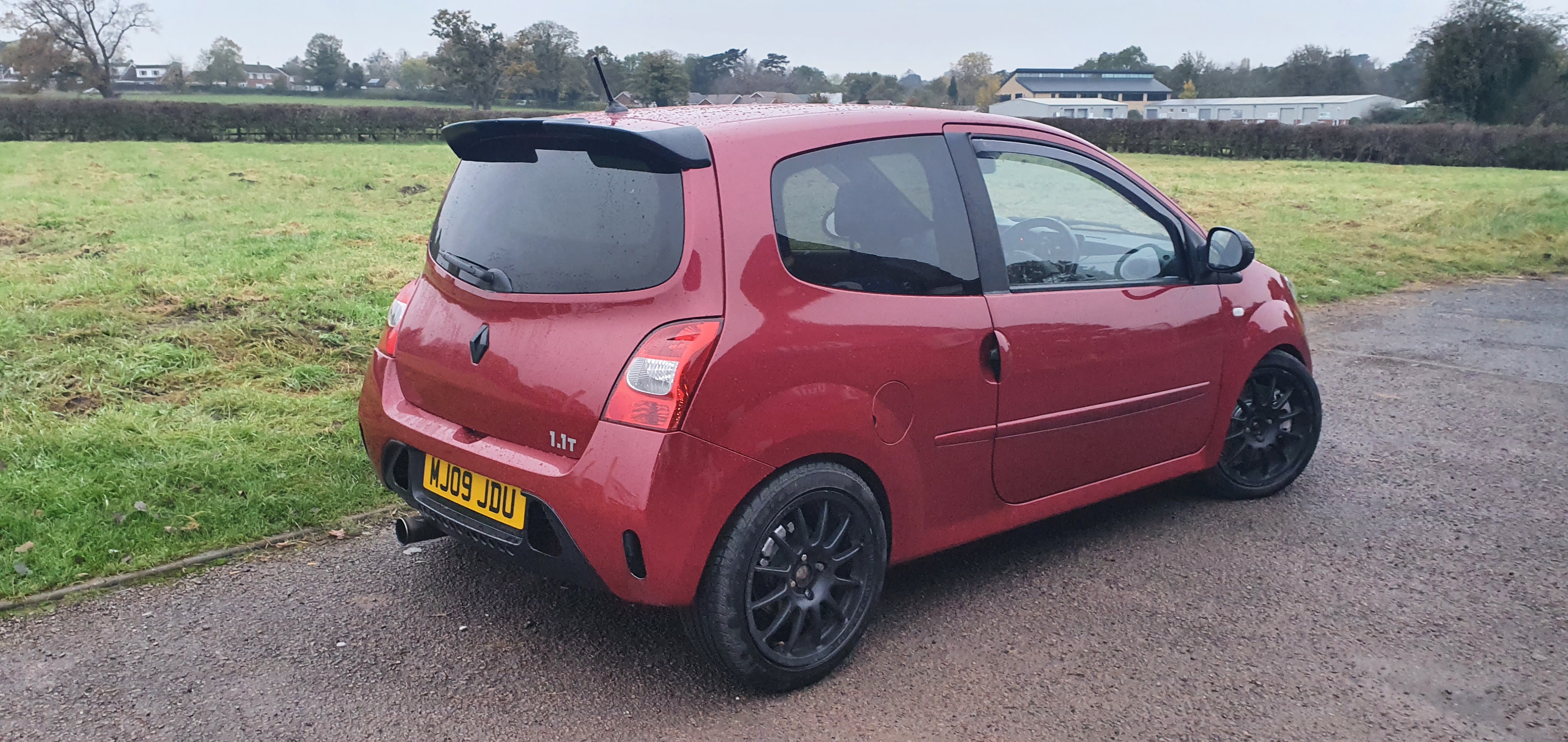

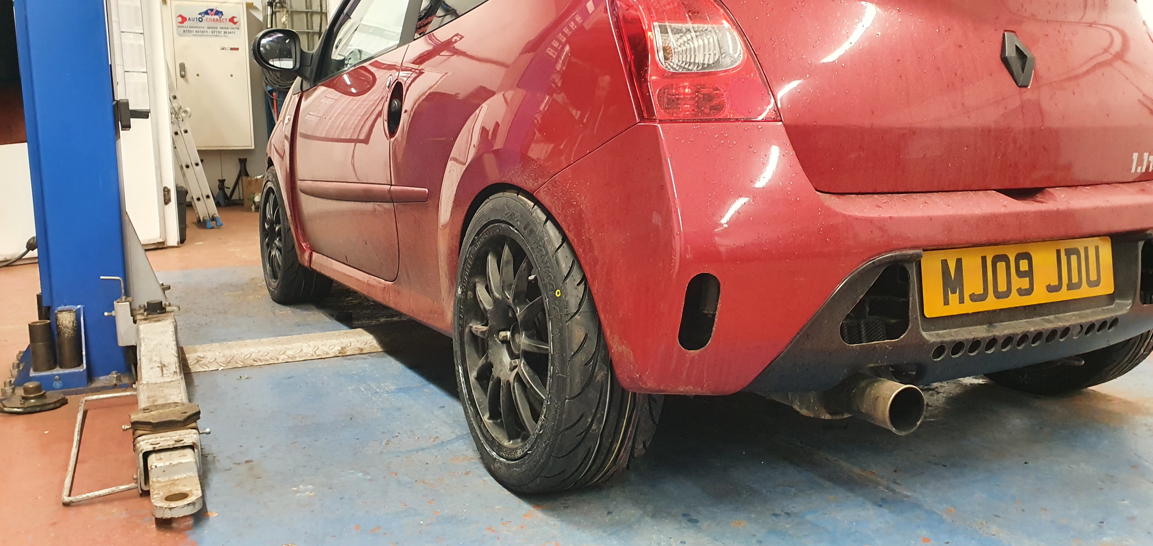

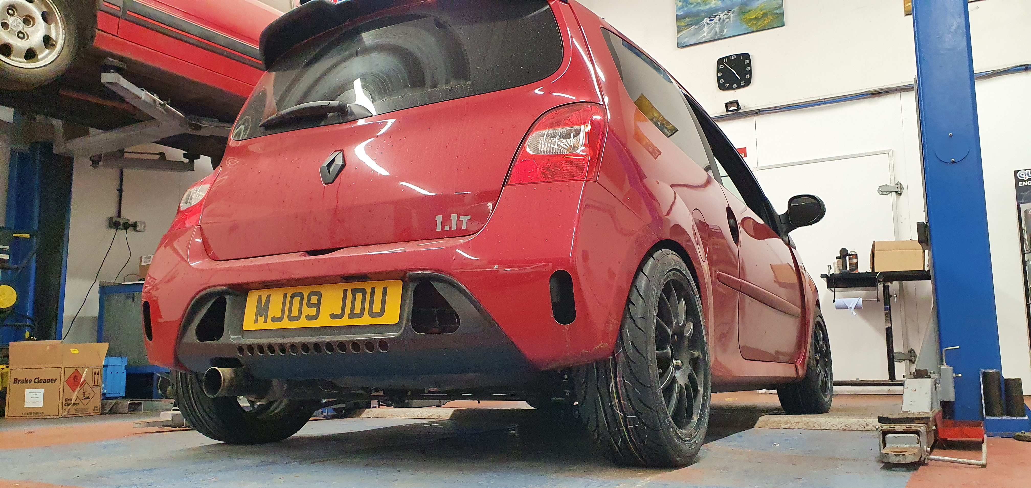

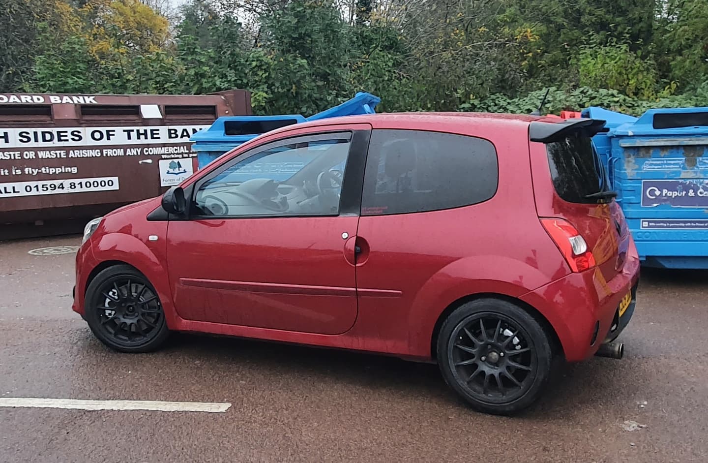

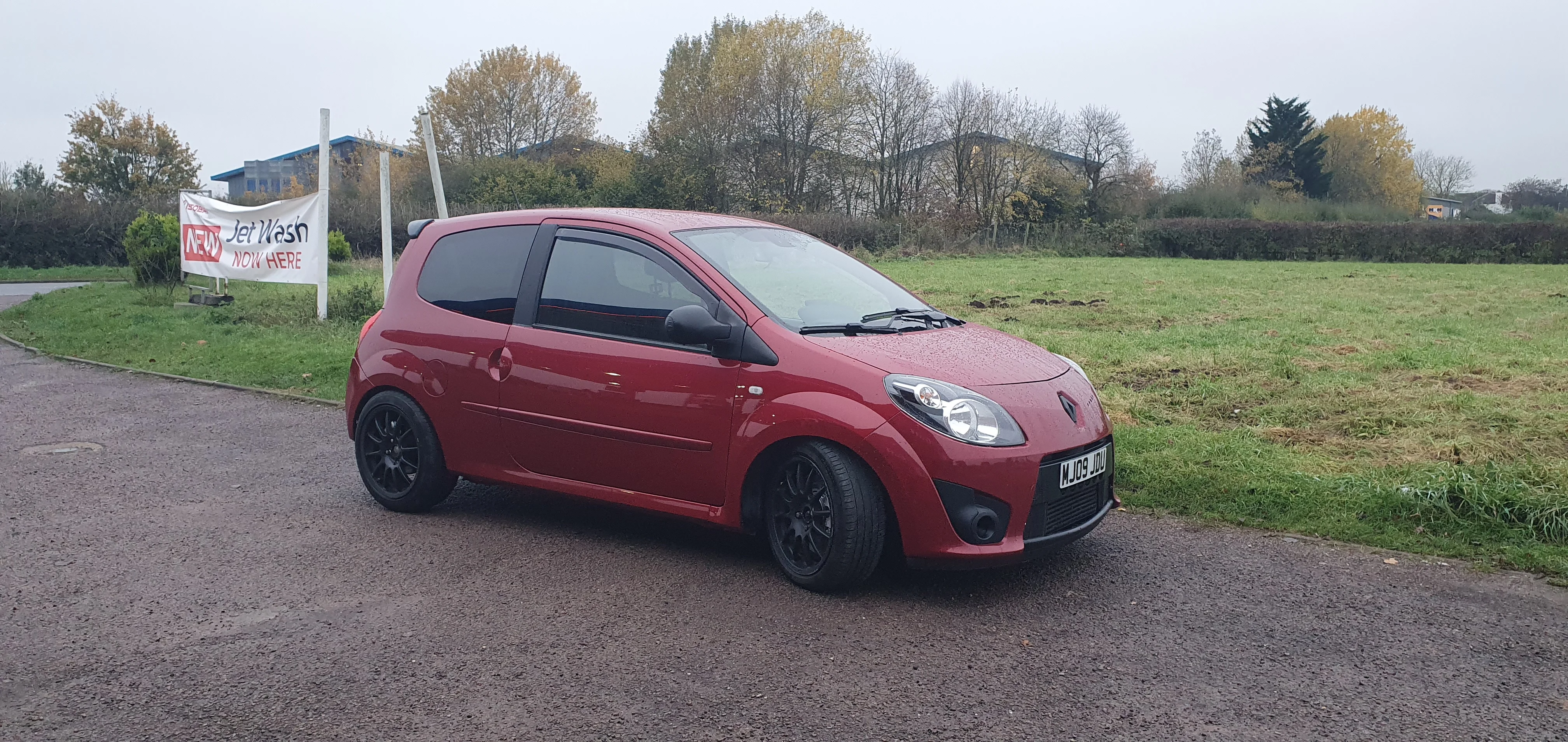

WOW I'm very very surprised at the difference the suspension swap has made. Considering at a basic level I've only made my car about 10mm wider at every corner than it was as I was already on spacers, the change in angles and the rear arb has made a huge difference in feel. I've had it aligned this morning and got hold of the rear measurements to get it shimmed also (its a bit off, input please on what shims I need) and it feels super planted and a lot flatter when cornering. The brakes are a huge upgrade also! Bearing in mind I'm on old odd tires and old stock brake pads I cant wait to fit decent stuff in there!

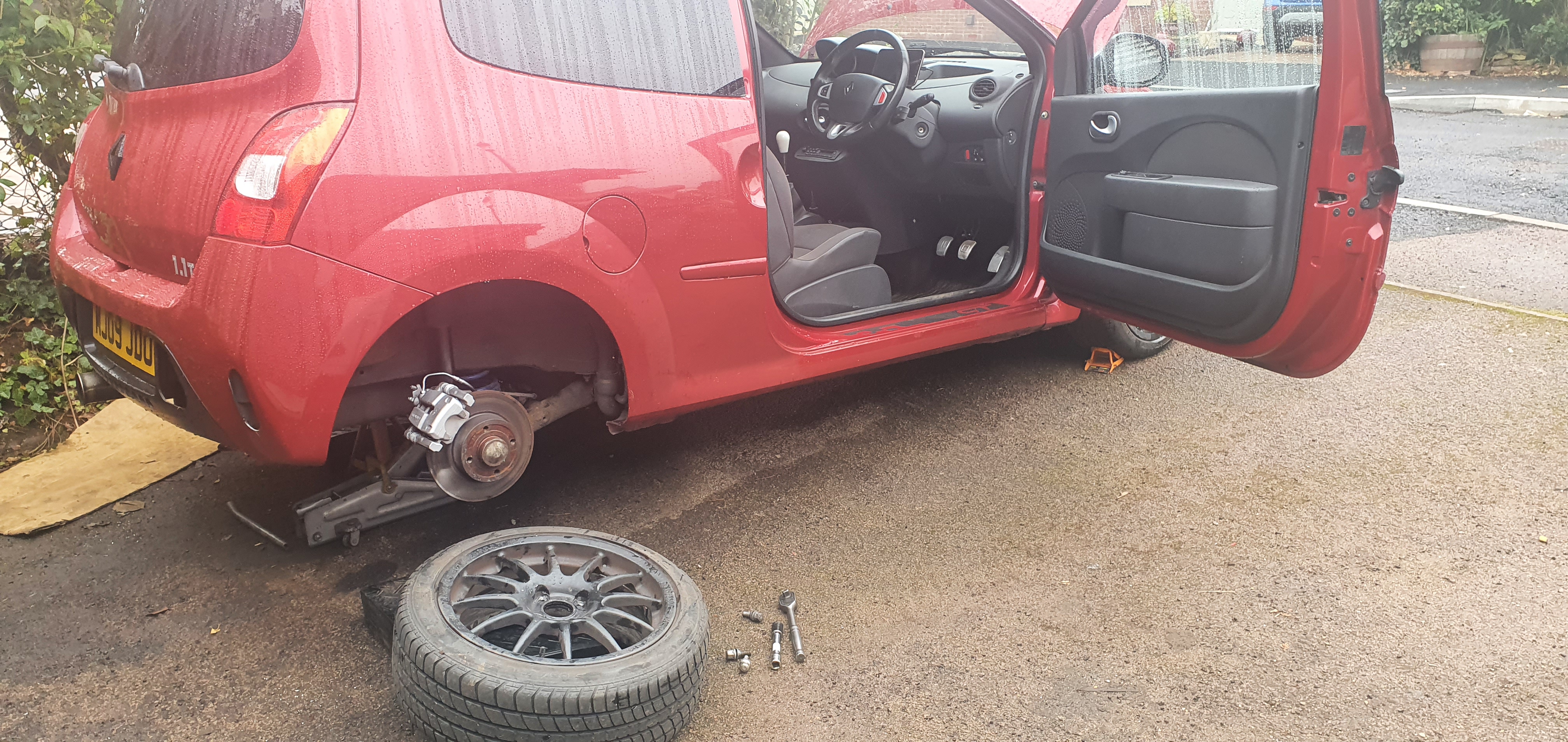

View attachment 1566664View attachment 1566665View attachment 1566666View attachment 1566667
Is that backend alright? Anything bent?
Adey.
Nothing visible, been like that for years to be fair and if it is its in the beam itself as I've now swapped the stub axles. Its only because I'm trying to get everything sorted properly that I want to shim it up. I wouldn't even say it it handles "off" or anything tbh

Seen your posts on fb. Dunno why everyone keeps going on about the beam being bent.
That ain’t even bad
Adey.
That ain’t even bad

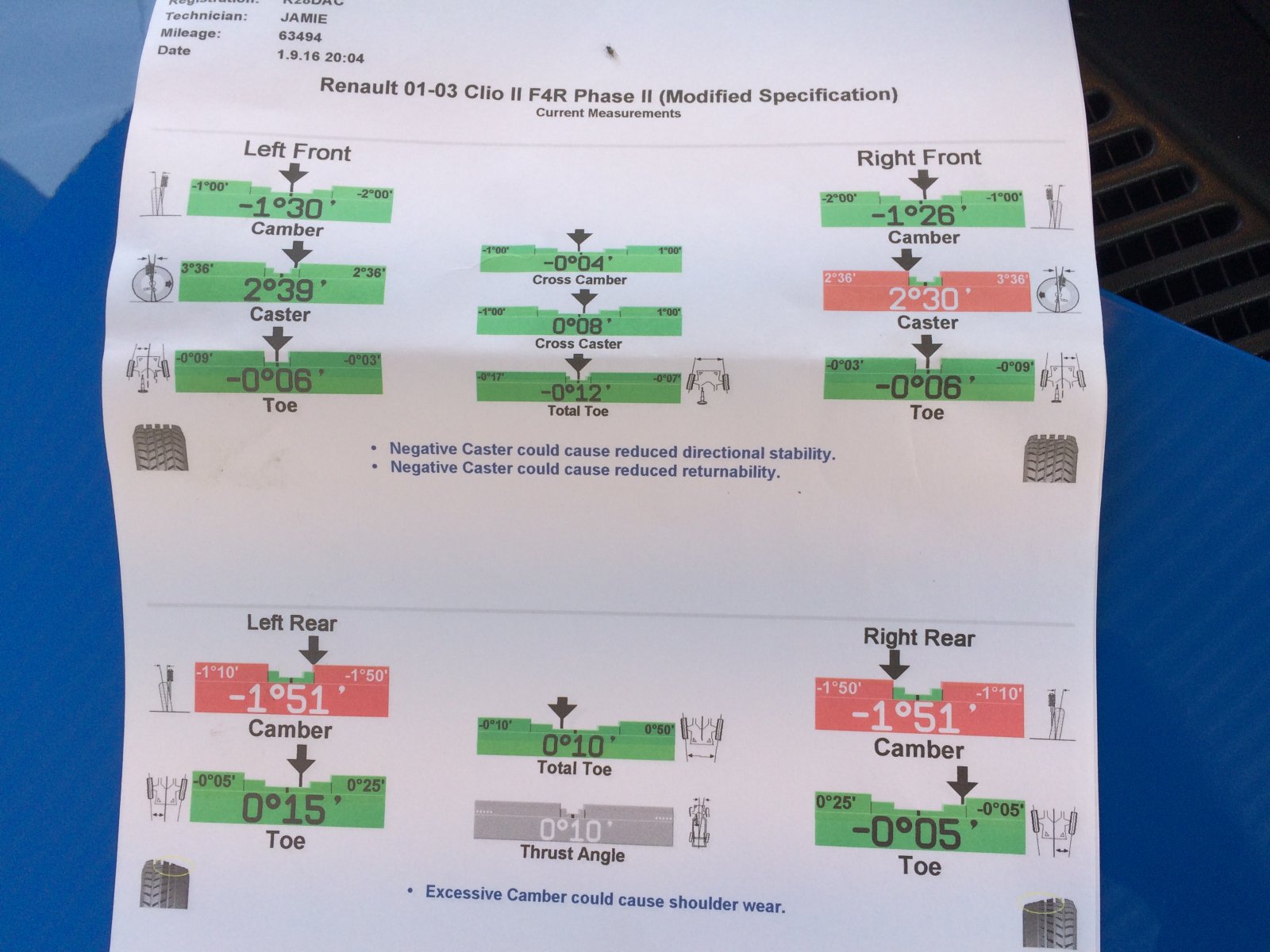

I didn't think so tbh. I've not crashed it yet lol doesn't throw me off down the road or mid corner or anything. I did post in my bent beam thread but will post here. After some Google foo it seems its common for Clio ones to be all over the place with camber and toe.

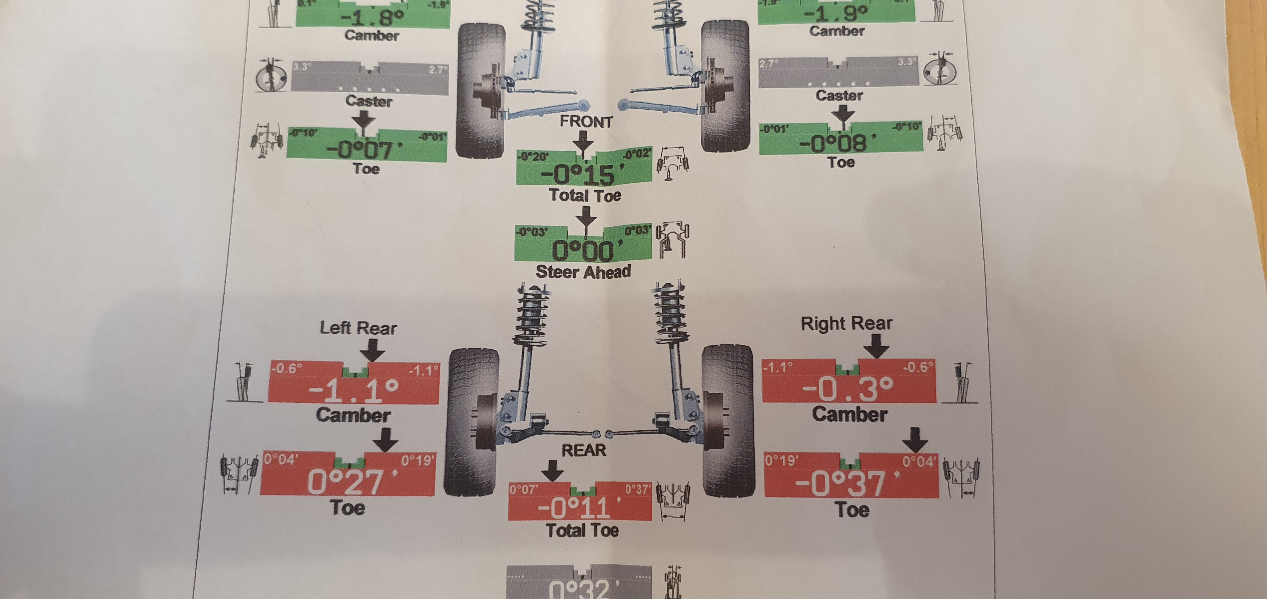

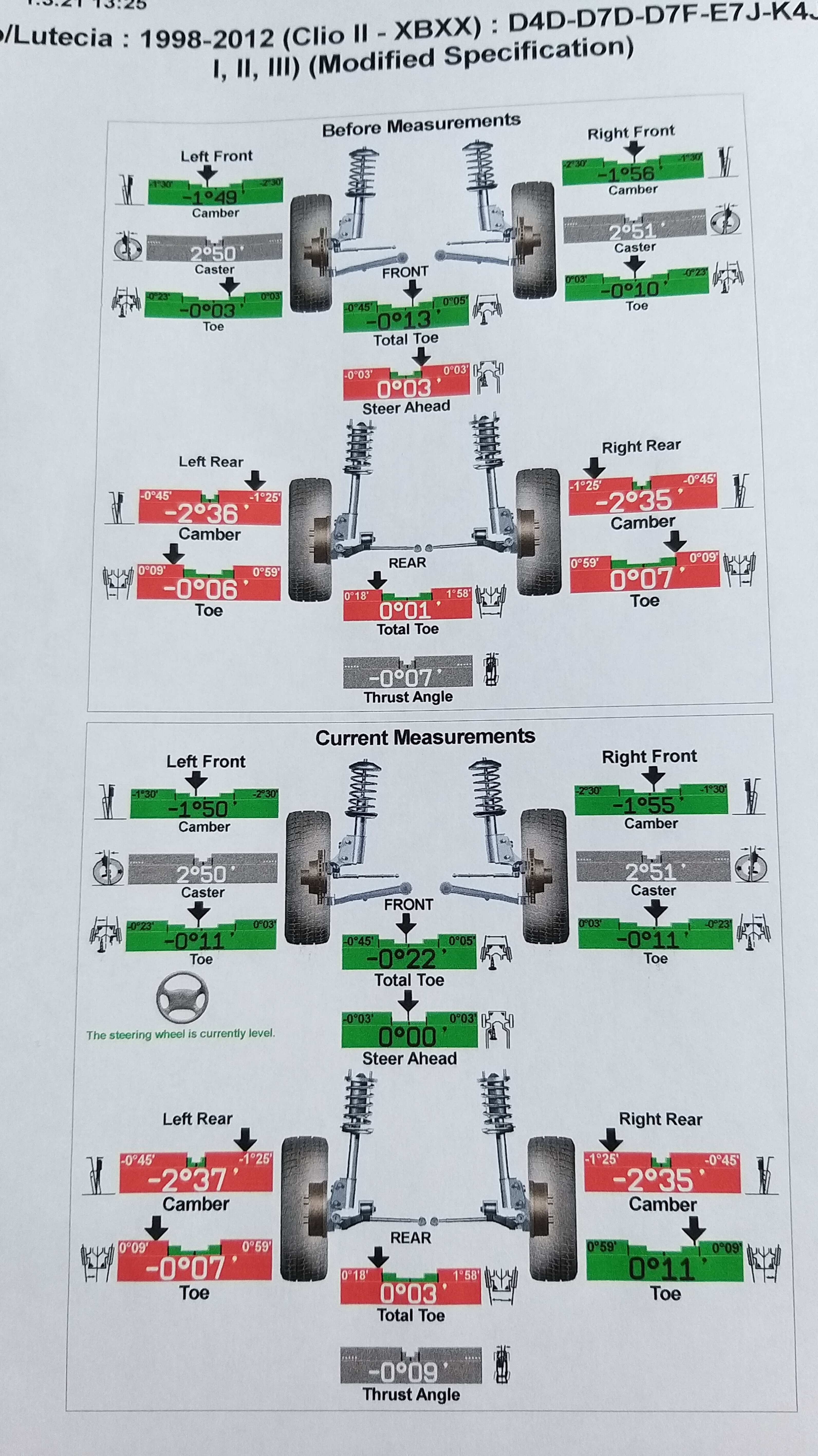

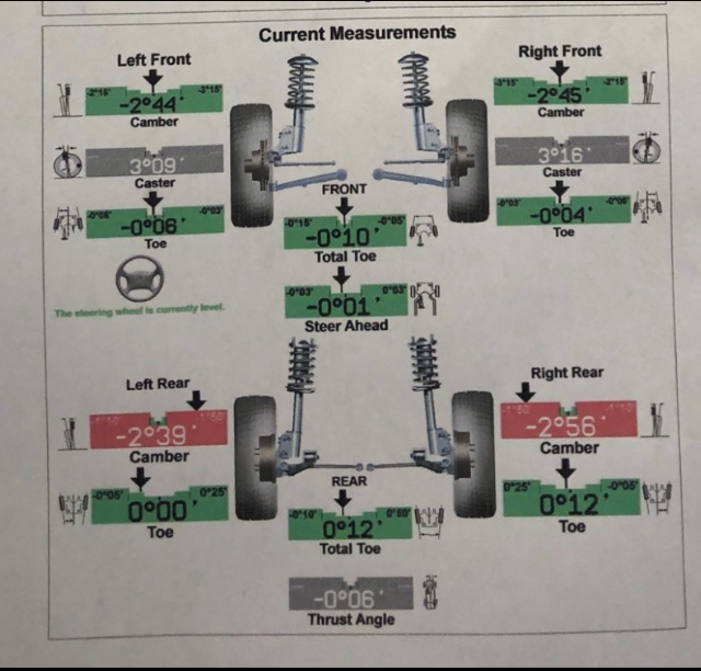

I just have to say about the amazing customer service received from Nick at Pure Motorsport. I'm not a returning customer or anything but fired off an email regarding my rear alignment, he must of emailed me back about 5 times yesterday (y) Absolutely amazing service to average joe. Shims ordered up as a result.
Did you shoot over the print out and they advised what shimes needed to bring it back in?
I've always had a great service and fast response to emails in the past and that was buying parts for a second-hand shifter. You really can't fault their customer service.
Exactly that (y) well the first time I didn't actually attach anything to the email because I'm some sort of technologically retarded jeb end. But yes a little advice and the shims needed to bring it back in somewhere close. Not set for a full race car but squared up even. Will definitely be a returning customer now though (y)
In the future I may get another beam to replace this one so it has less shimming required and fit a strengthening kit to it but for a road car with maybe 3 track days tops it'll be good as it.
As I think you said previously, it's a common trend with these back axles to have a bit of wonk in them...
Some are better than others but I doubt you would know it till it's all fitted up and put on geo. Perhaps with some thinking you can work out which way it's flexing and adding the stiffening kit and a bit of 'genital persuasion' could see it slightly closer to zero?

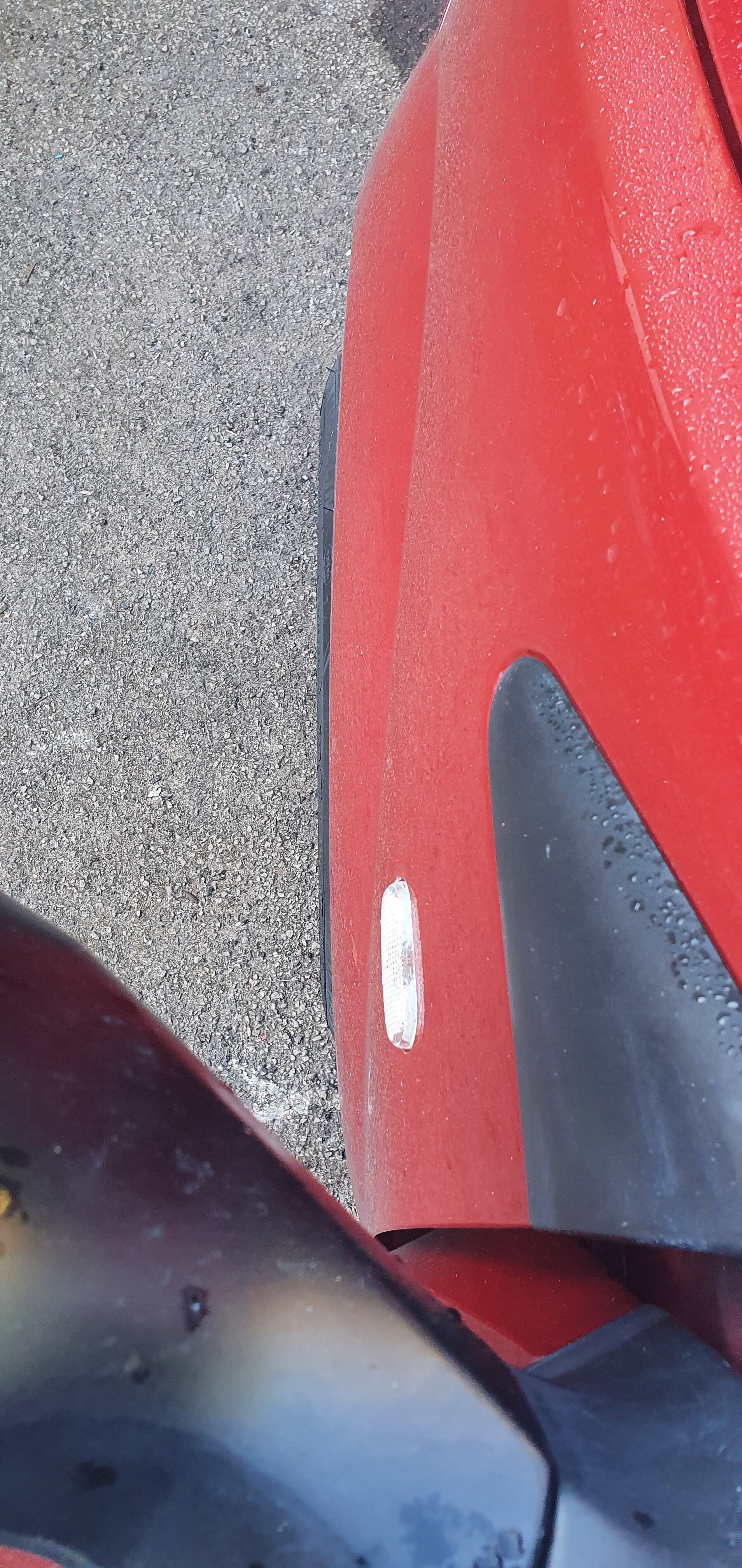

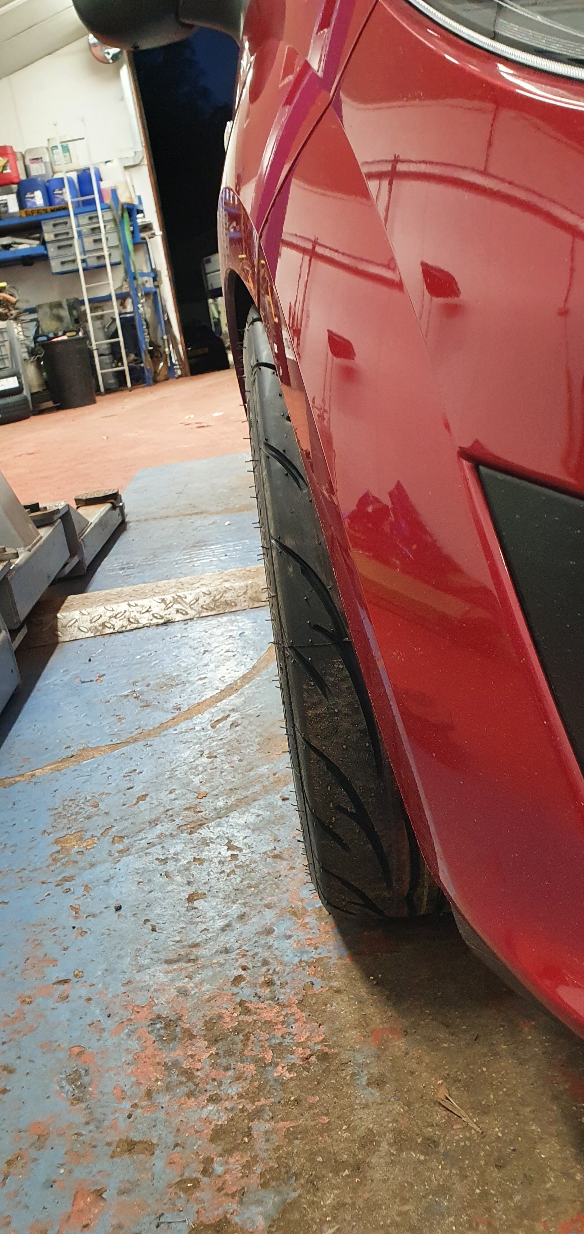

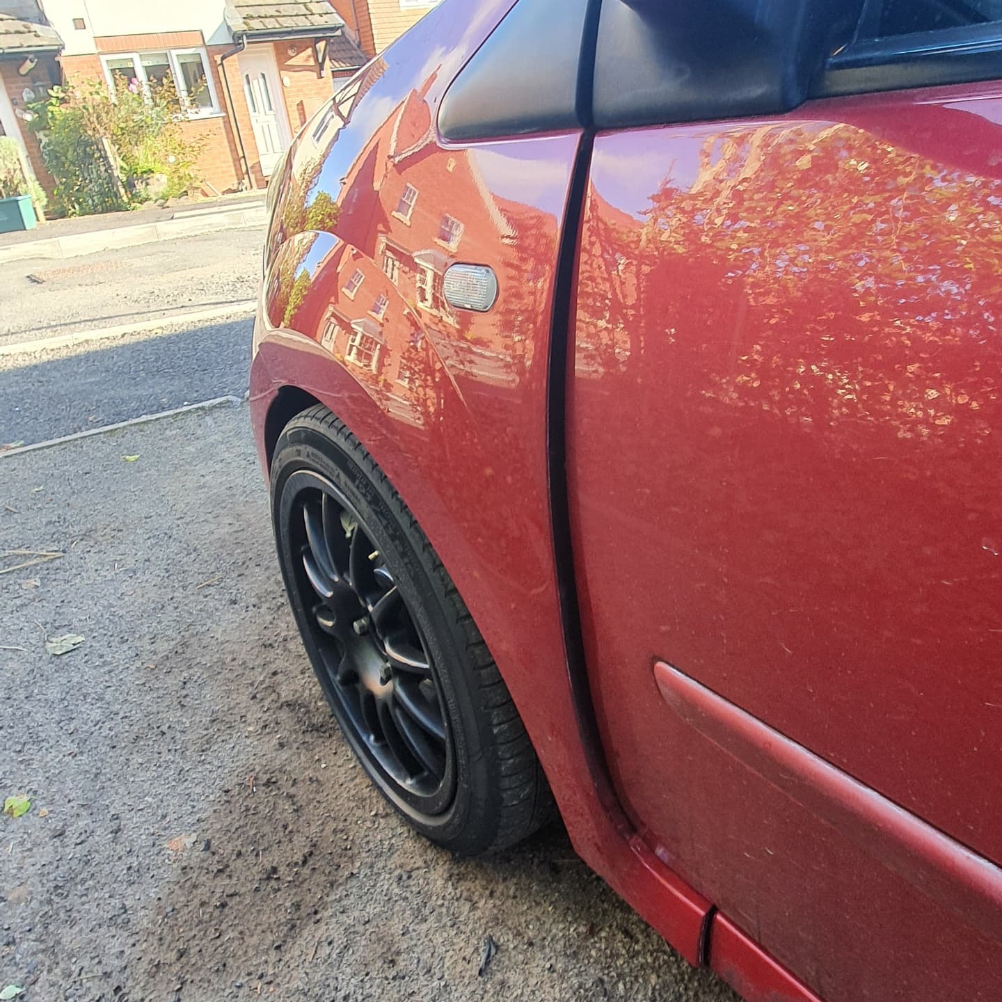

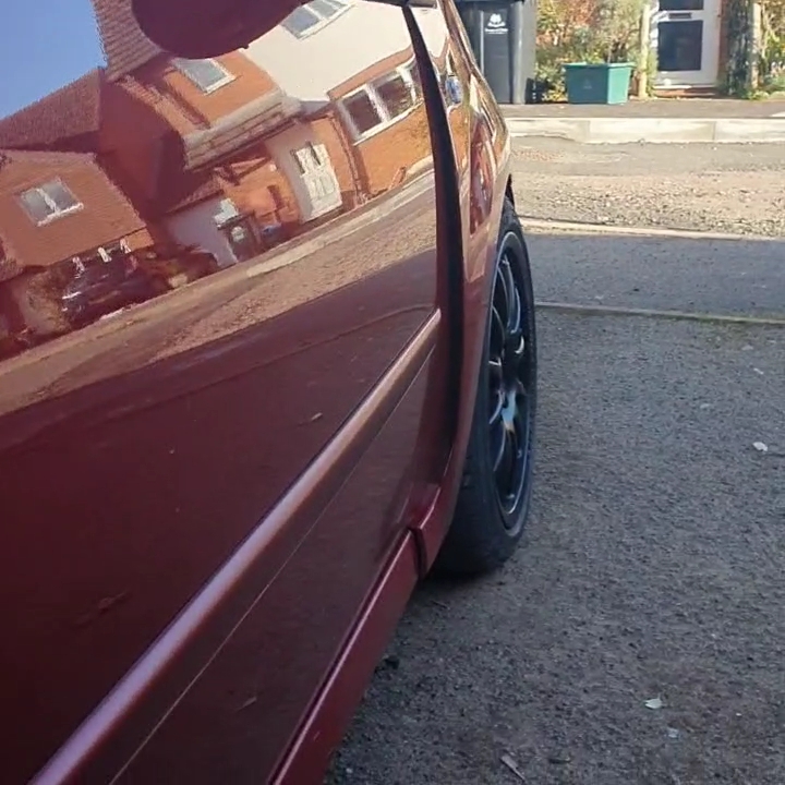

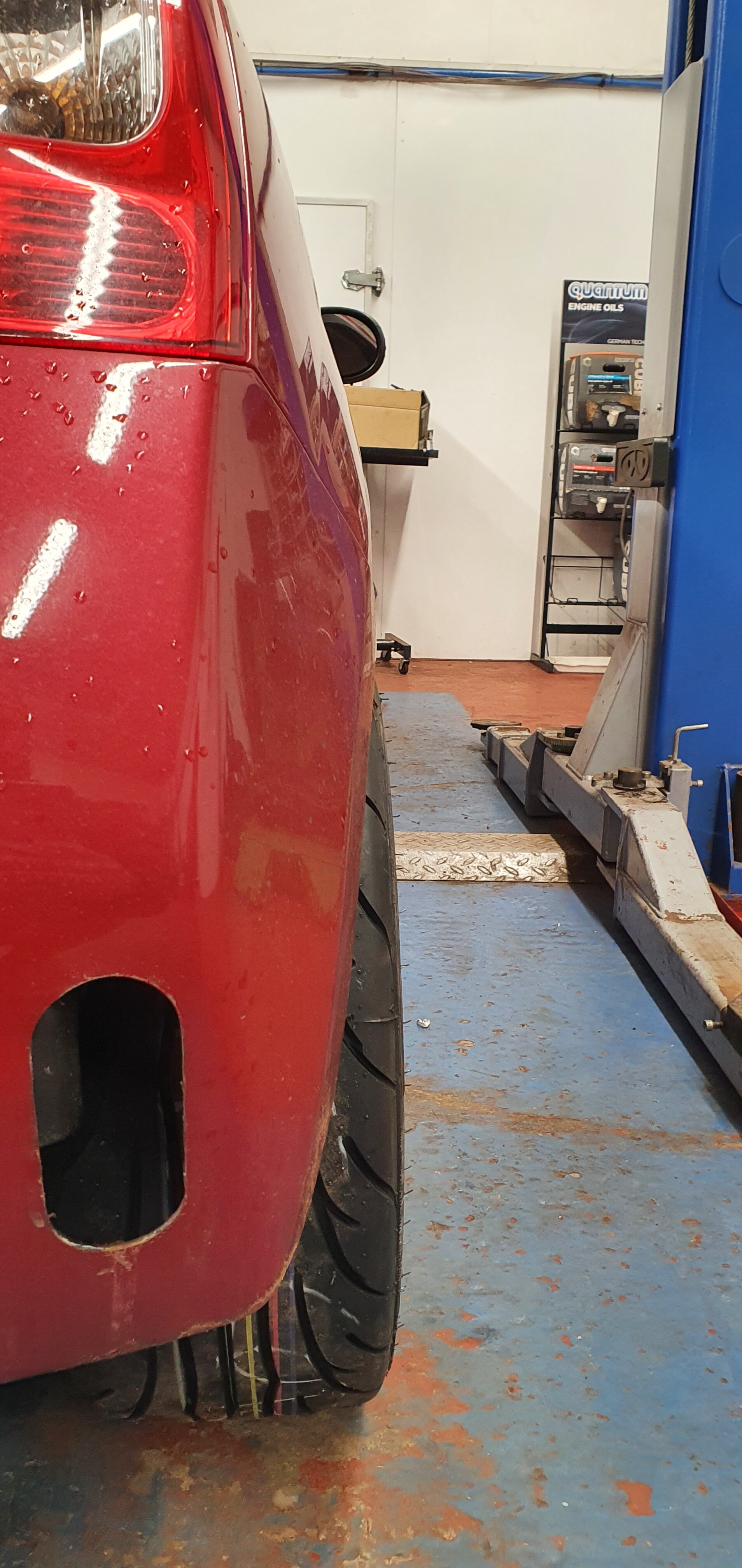

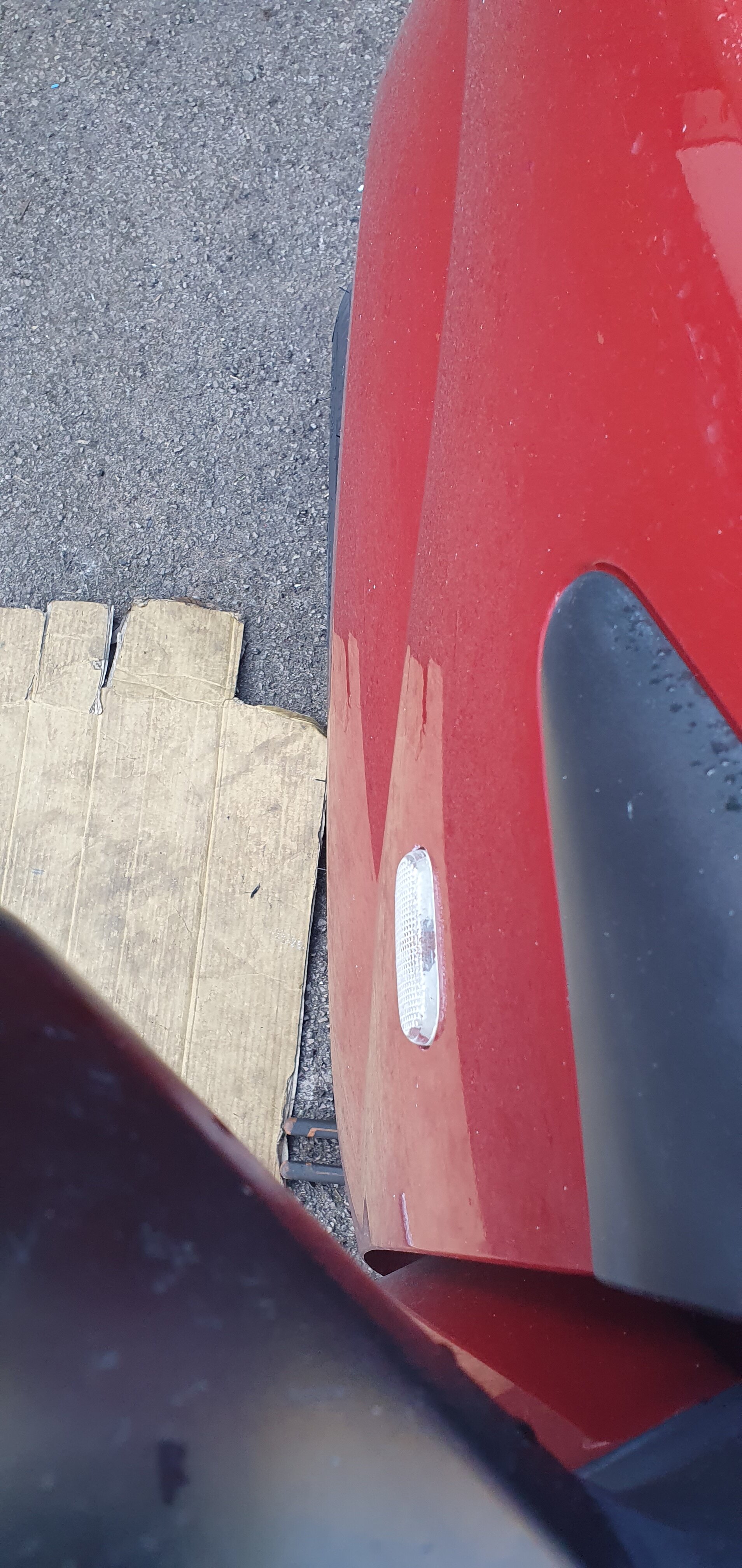

Decided to space out the front wings Kanjo Racer style, pretty common to do on mx5's and civics. This gives me a little more space for the wide track conversion. May look to space the front of the wing also at the bumper mounting point. Done quite easily by adding an 18mm spacer to the mounting point behind wing mid mounting point behind the door.
VideoCapture_20211121-151030.jpg IMG_20211121_122307_723.jpg 20211121_114549.jpg 20211121_112737.jpg 20211121_111528.jpg

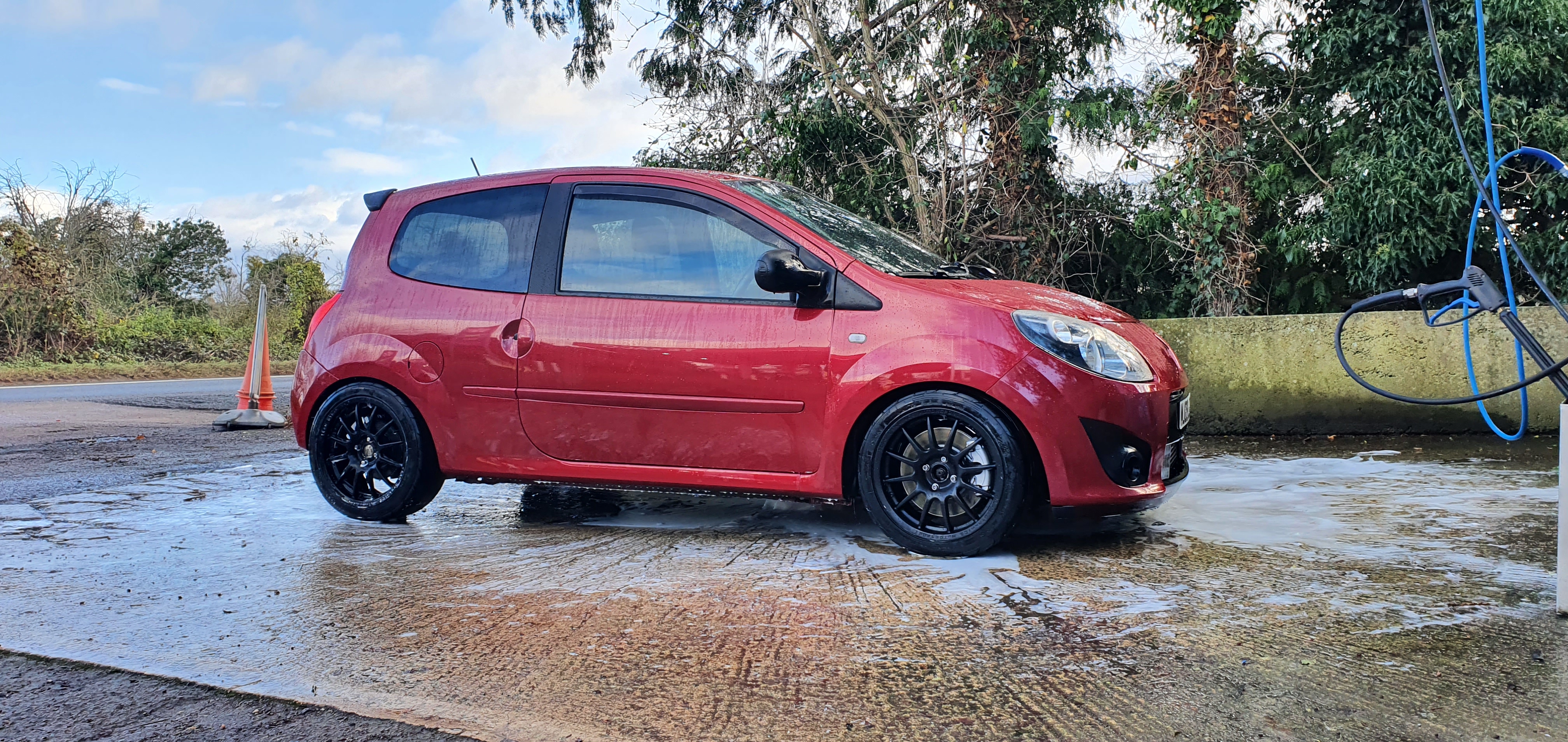

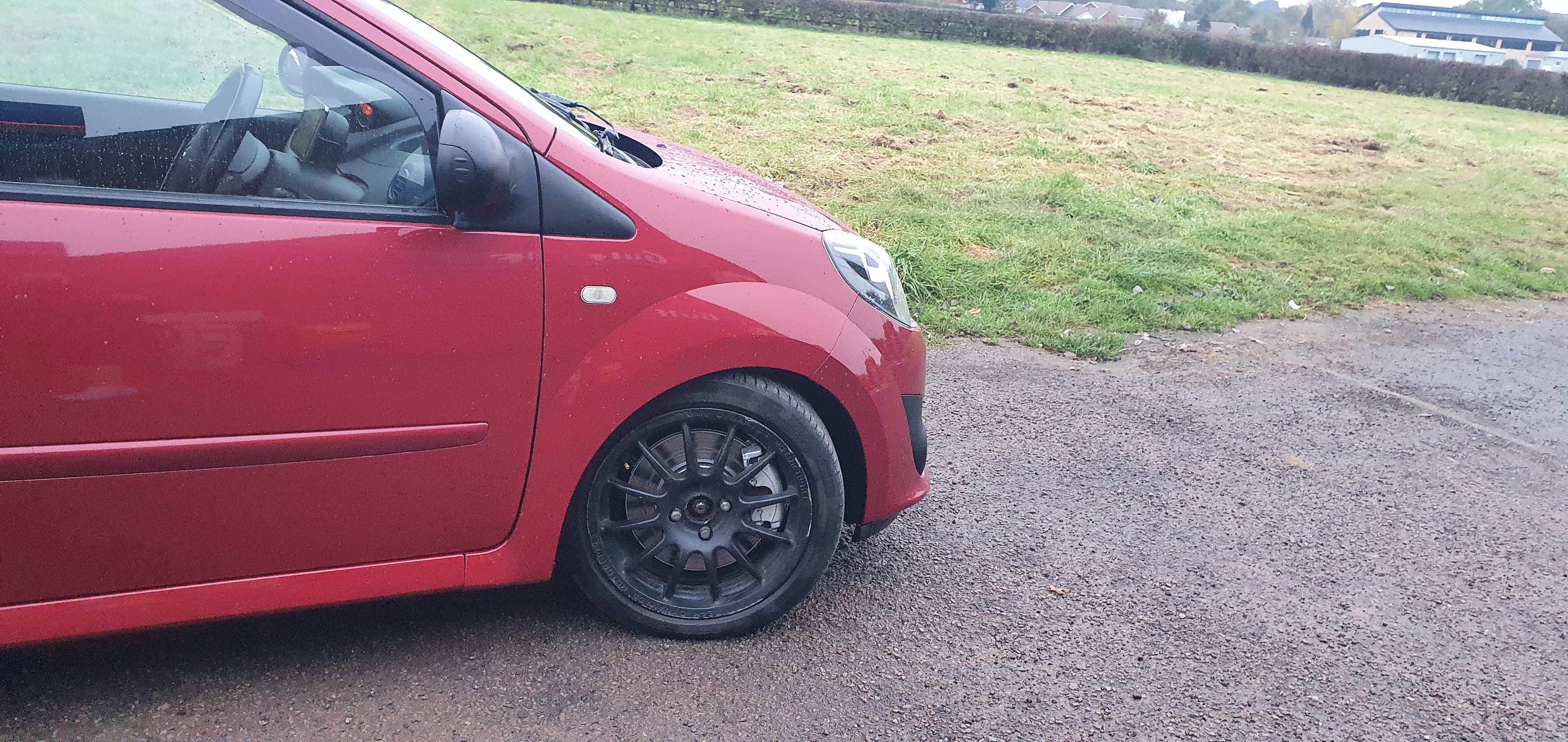

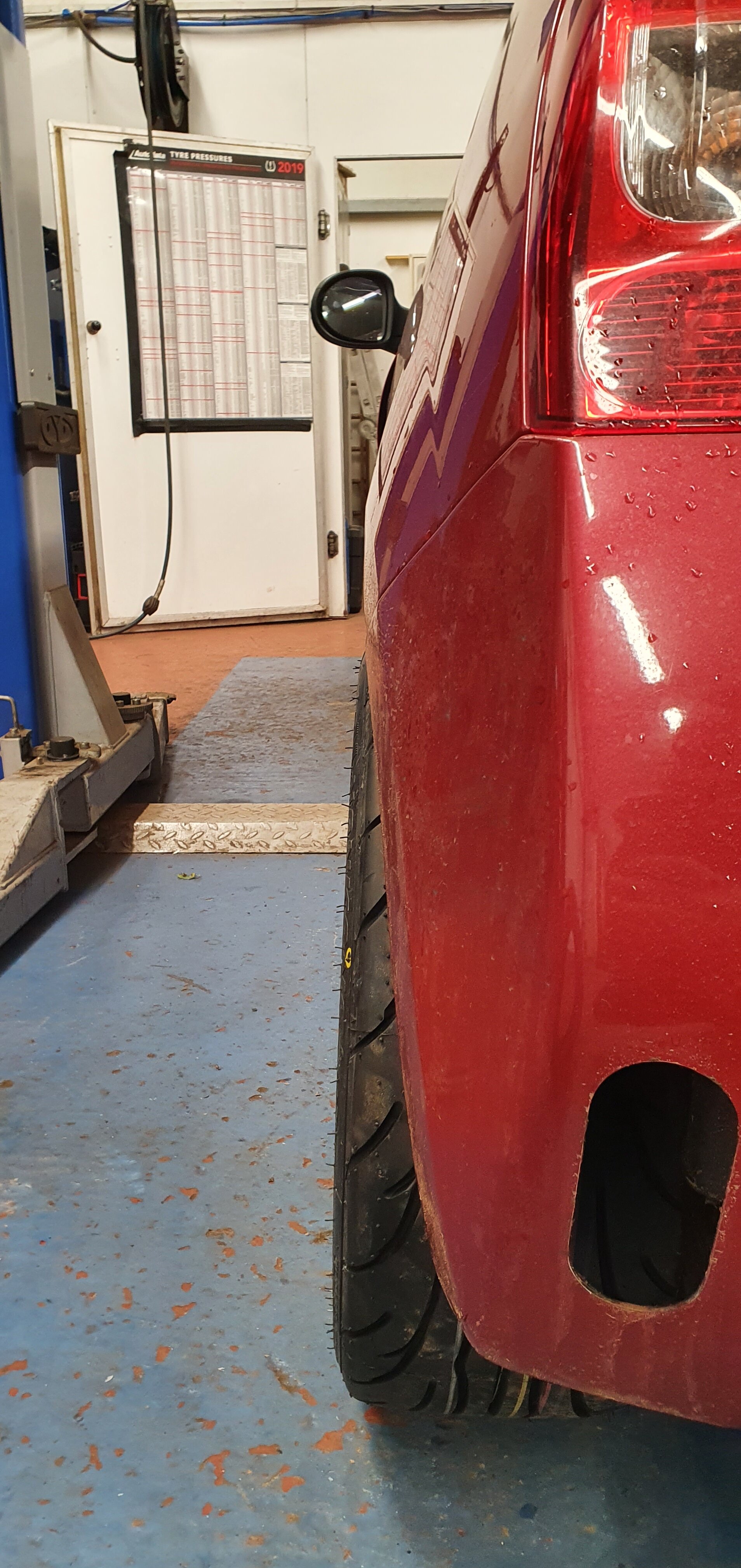

Not really much to report, finally got some new decent (depending on who you speak too) rubber, went with the NS2-R in a 195/45r16. I had them fitted yesterday and today was properly bloody cold so I didn't get out and try the tyres out. I want to remove the rear springs and drop the car down to make sure I have decent clearance back there. Once that is done I want to make sure the car is level all round then get the camber and alignment reset. Once that is done I can start to lean on it abit and really see what the suspension changes have done. Currently it feels super flat and neutral, no major under or over steer, that said I was on the old tyres when I tried it so now it may be different. Next on the wish list are a set of better brake pads front and rear and maybe braided lines. A harness would also be good but only if I plan on a track day (I did used to have one for the car that I have misplaced 🤦‍♂️ ) I really want to make a flat front undertray/splitter so may tackle that over the next month, plenty more reading to do before I start it though.

A bit unfortunate the Weather a bit s**t at the moment for a good blast to try out the tyres. Mate has taken some harness out of his rally car and probably wouldn't want much for them.

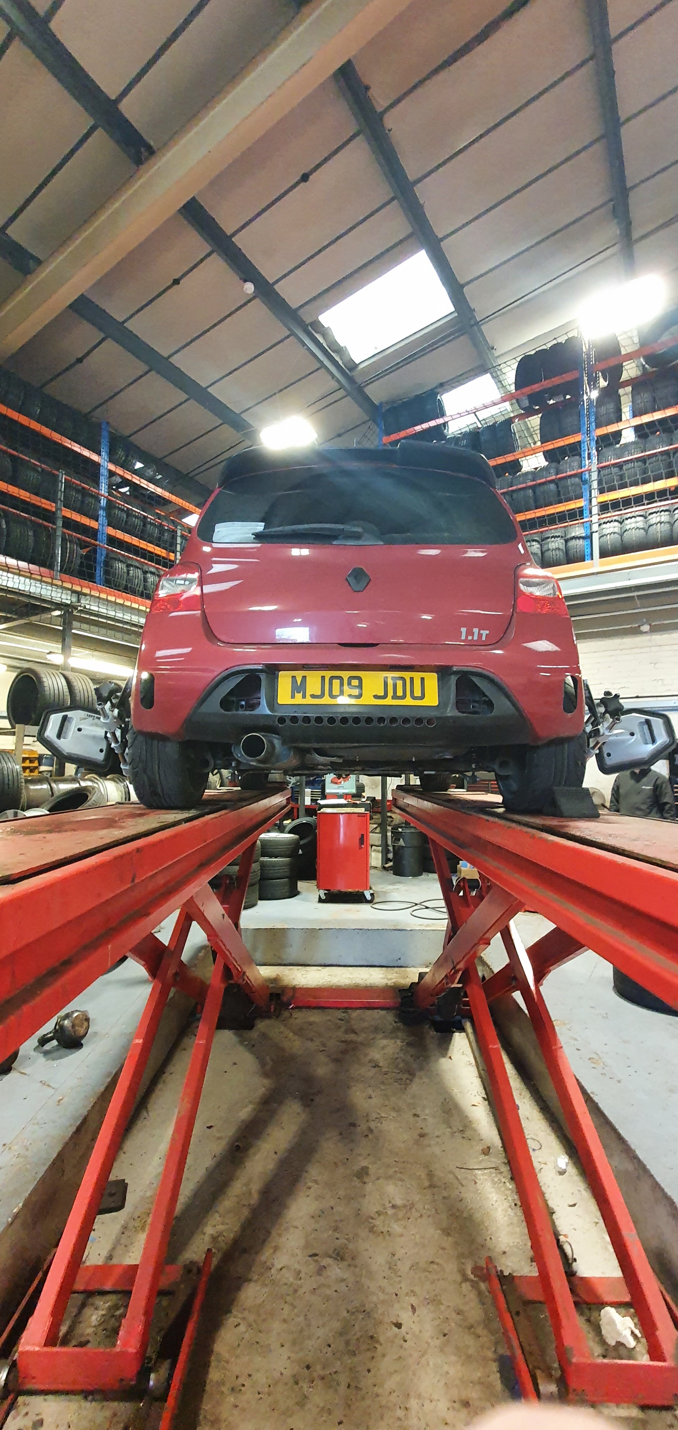

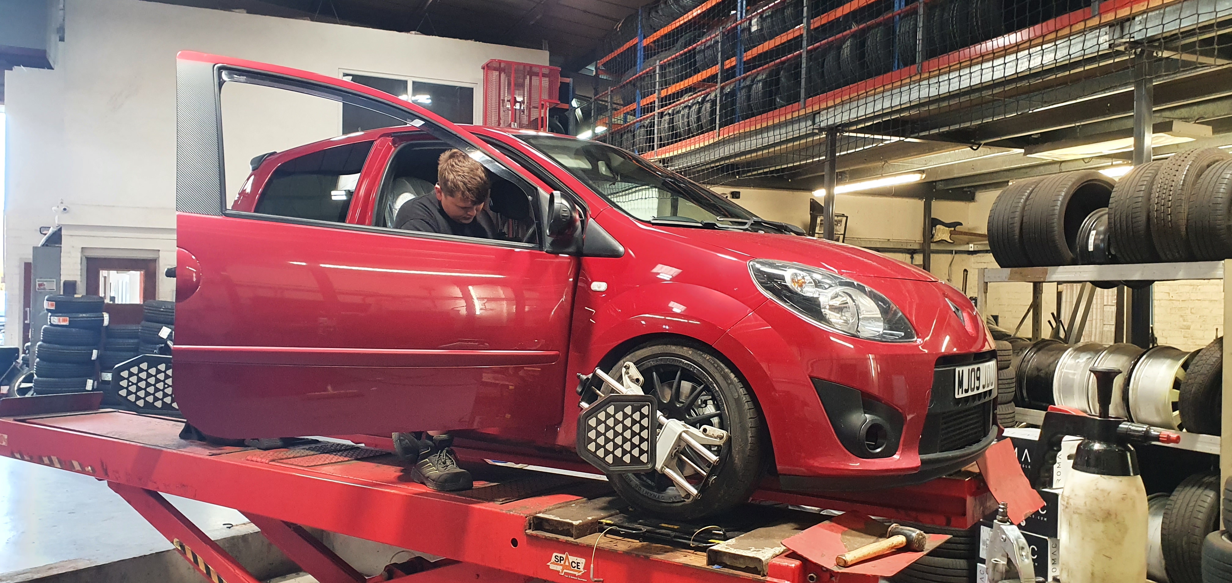

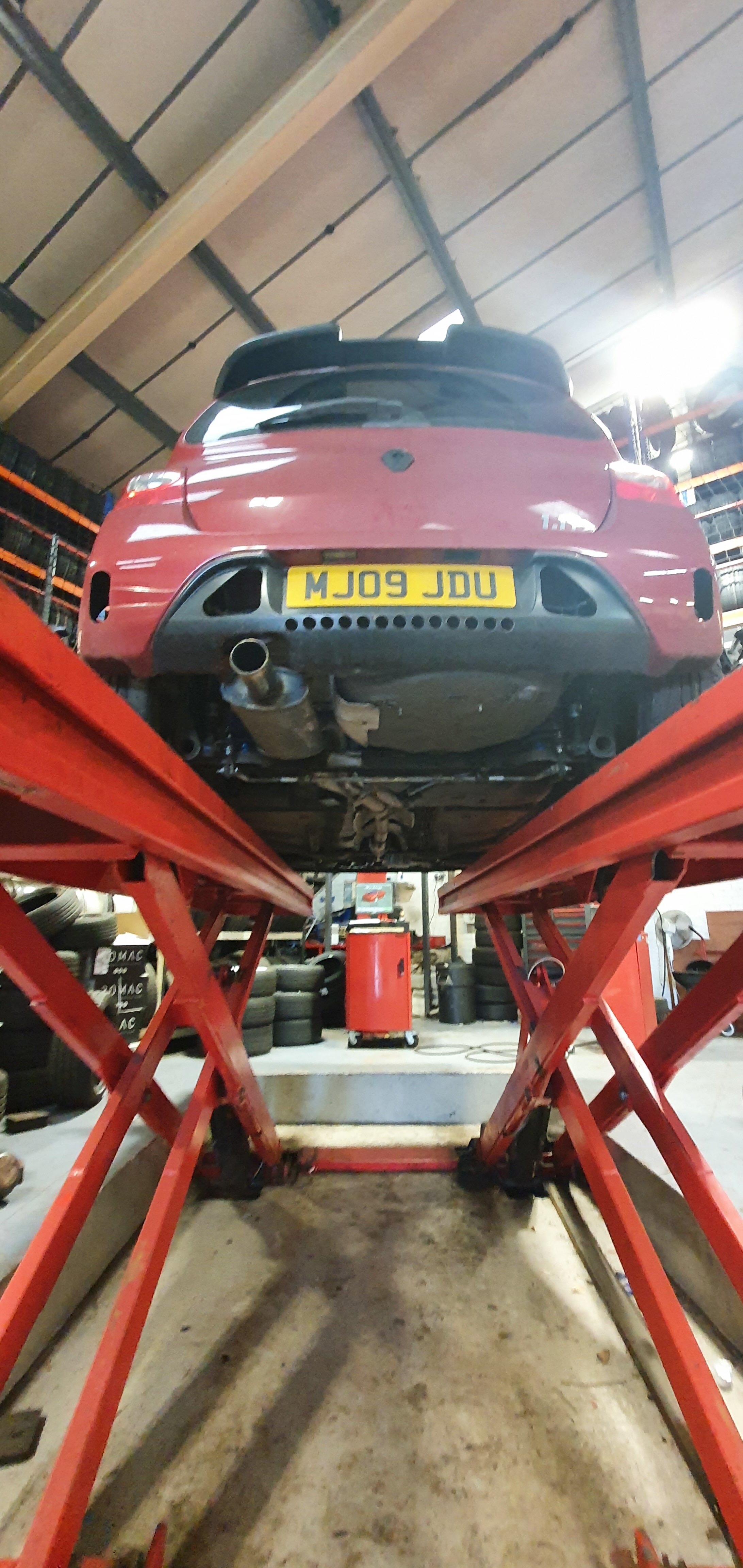

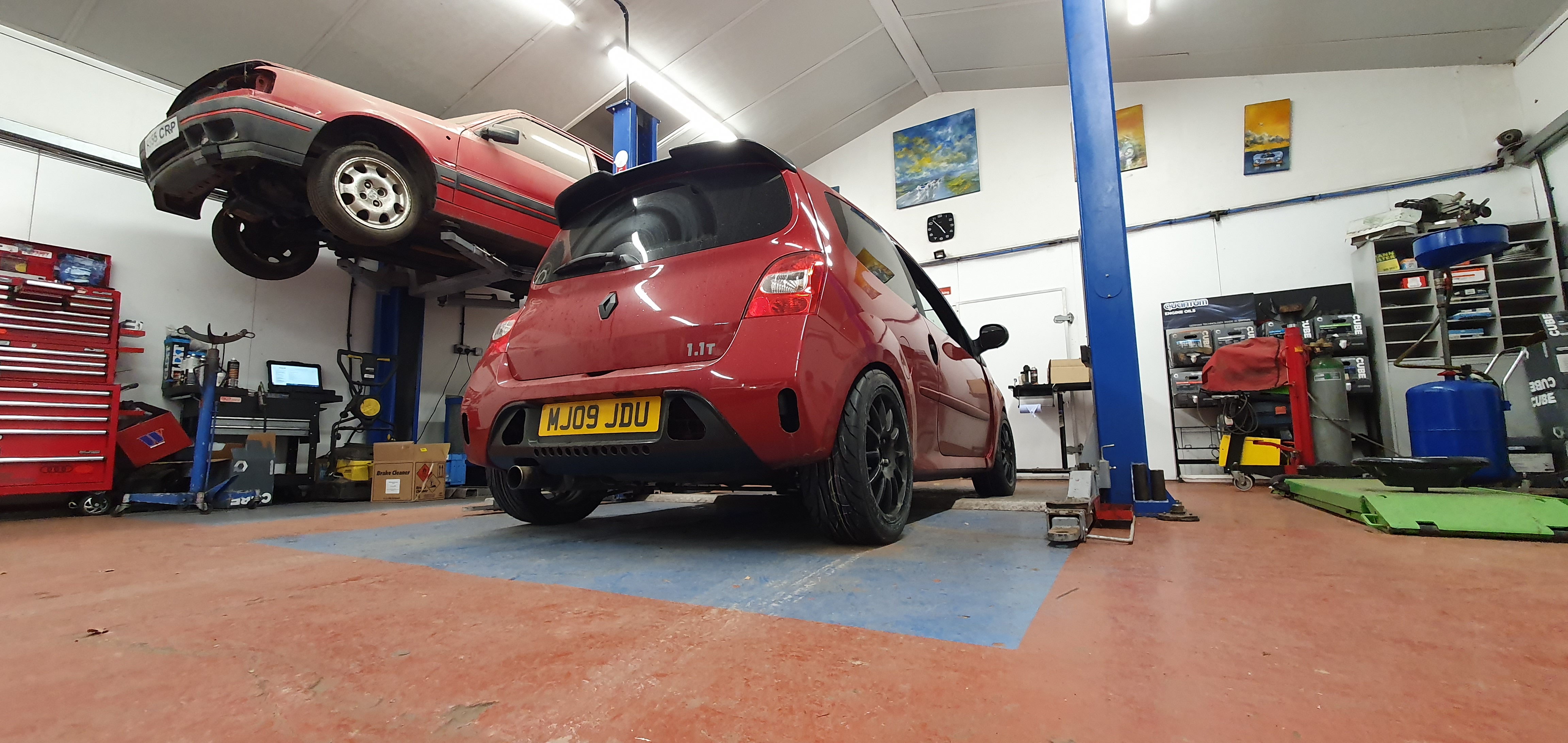

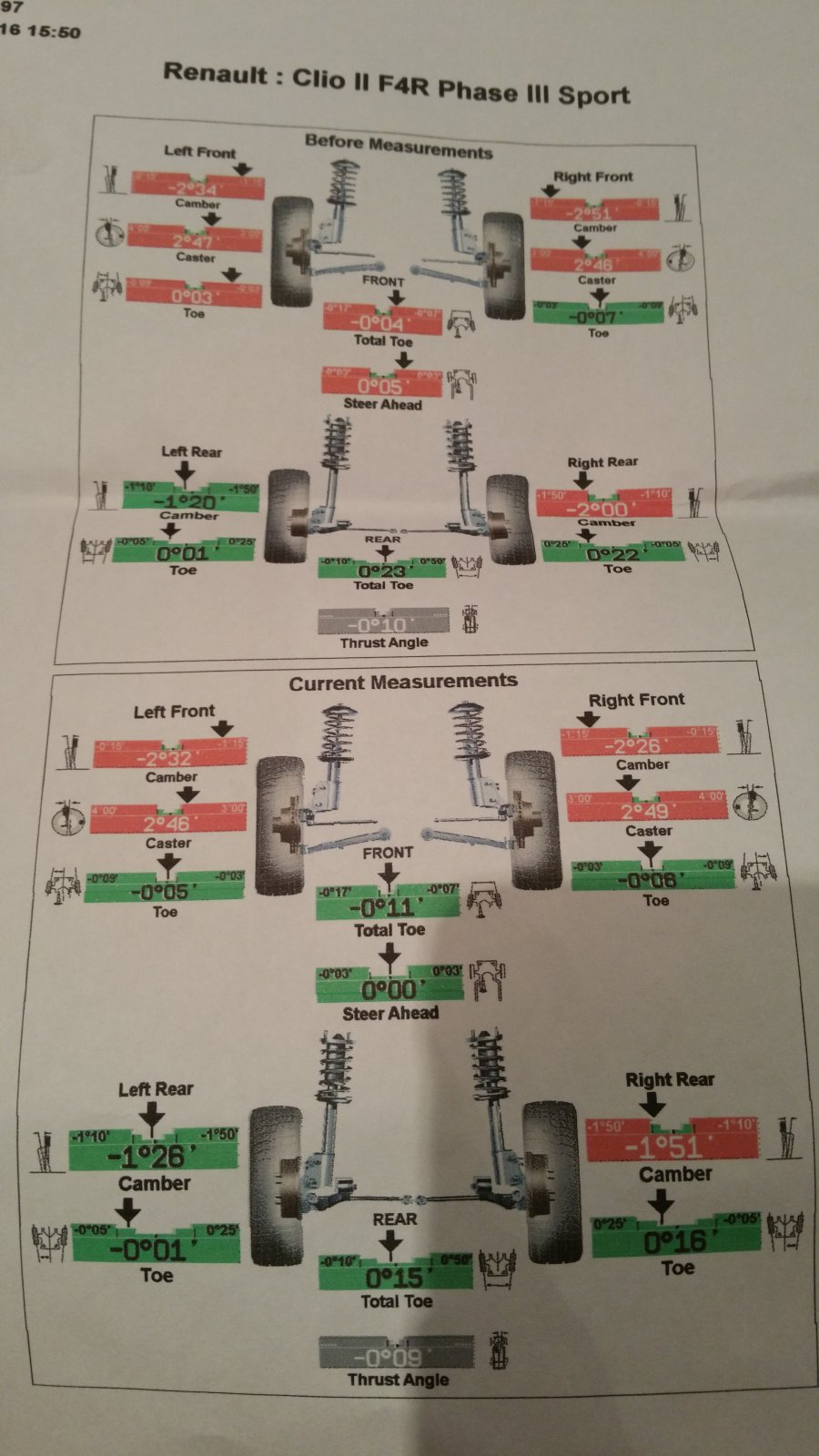

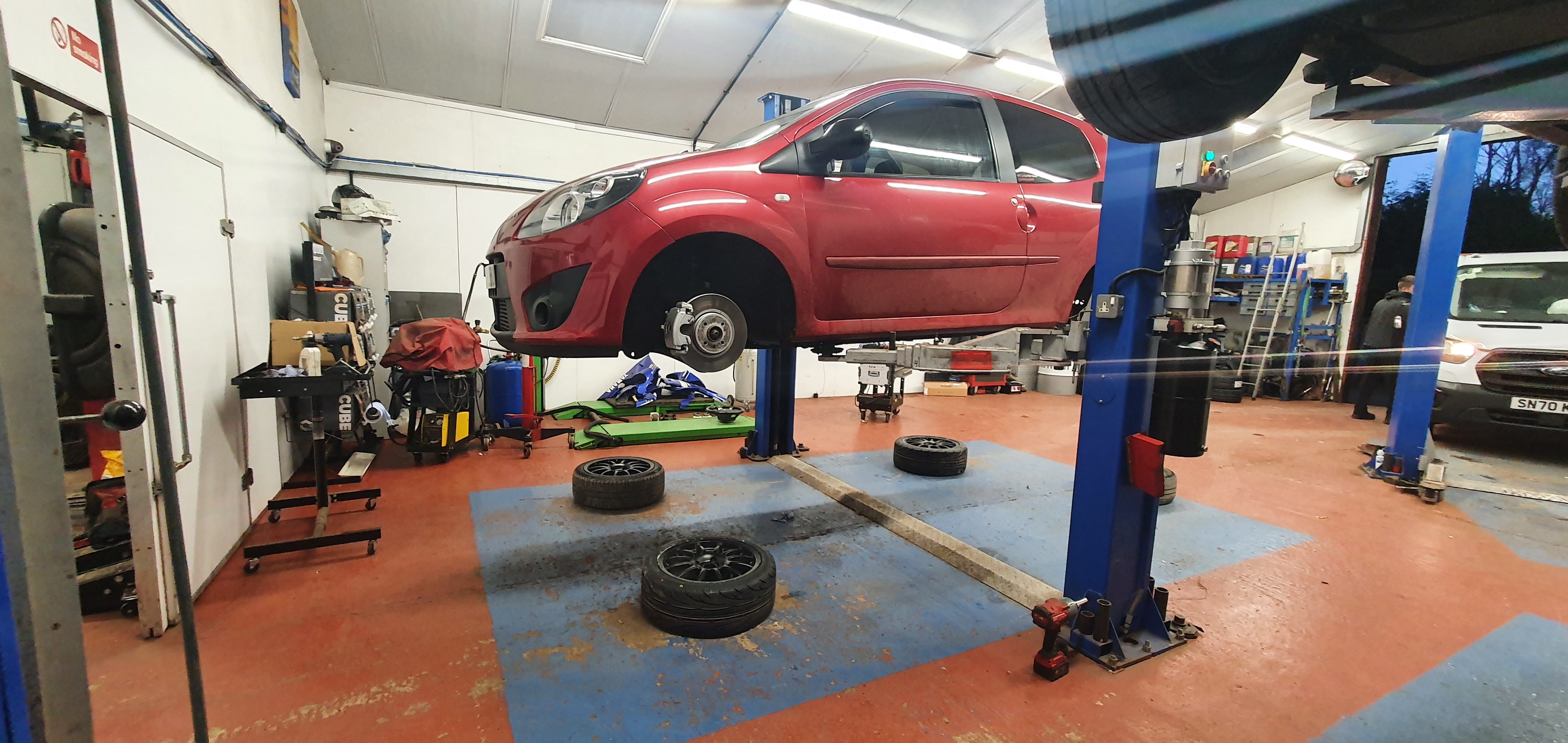

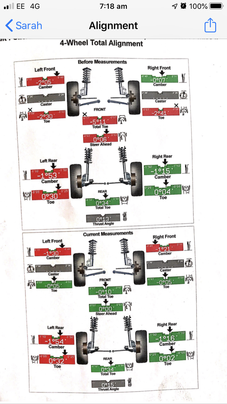

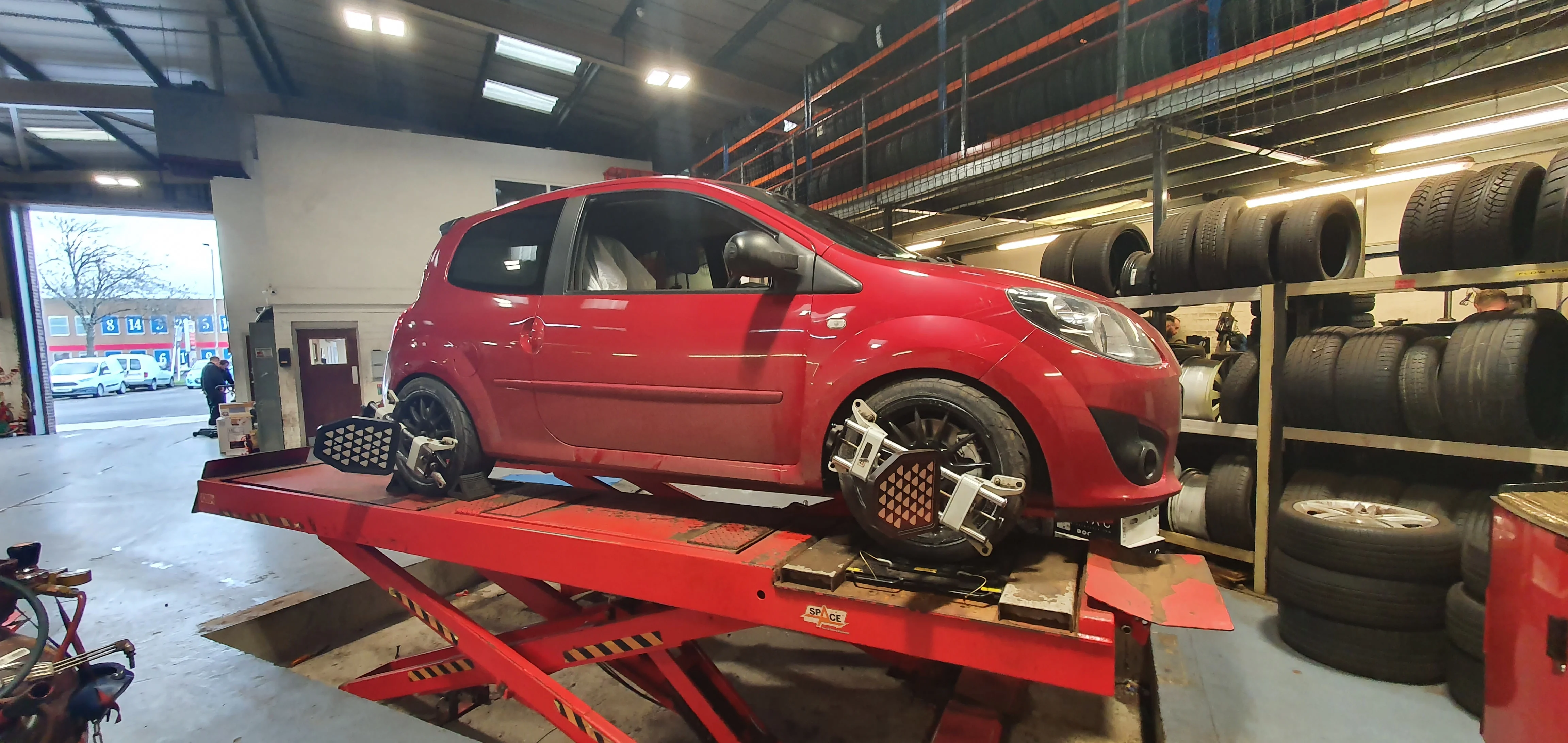

Managed to get the car back on the ramps for re alignment and measuring of the rear axle changes since fitting a new front CV boot and shimming everything up on the beam. The rear end after the info from Nick at Pure Motorsport is very close to parallel now! the front has been dialled in with a touch of toe out and its running -2 Degrees of Camber all around. Handling with this and the new tyres is confidence inspiring on the roads. I've not had chance to really lean on it yet but it feels great, flat and very planted. I'm happy so far (y) Hopefully we can get some dry days in soon so I can try and have a decent play in it as the tyres in the cold and damp/wet feel just like "normal" road tyres to me, Loads better with a few spins and on a dry line though 😁

Nothing really, just an off Renault rear beam 🤷‍♂️ Nothing visibly bent or anything. All sorted with shims and advice from Nick at Pure Motorsport (y)
Ah ok so it's possible to sort without buying new stub axles/beam? Just wondering about our little 133. Want to stash that away and never sell it, but that'd be a PITA if could only use Twingo RS axles/beam.
Adey.
Yeah, well if it was obviously bent and damaged you would replace the beam or stub axles? setup is very similar to a 172/182, uses the same camber shims as them and fits the same between the stub and beam. Even a brand spanking beam would be out of alignment tbh and most have twisted over the 10+ years they been around. The RS133 has specific rear stub axles though, may be shared with the wind but i think you would be doing well to bend one.
