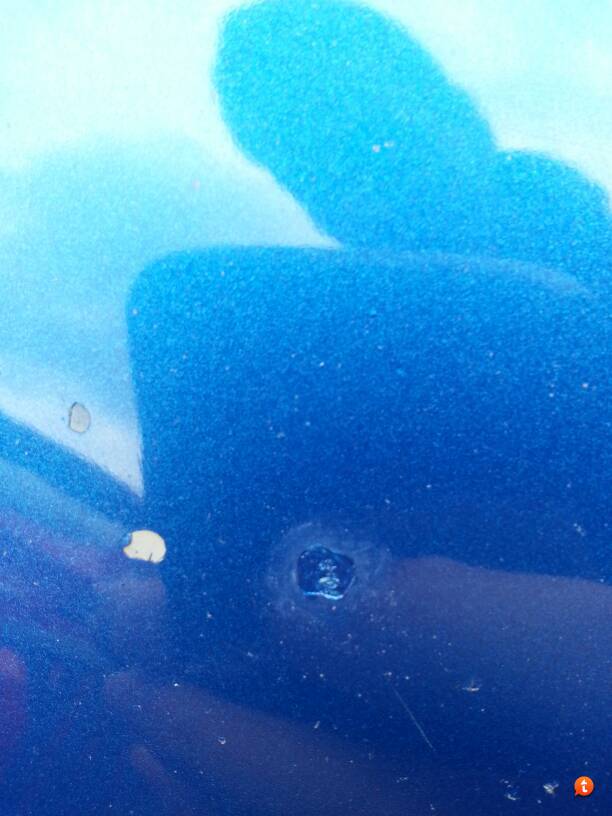

Had a go at repairing some paint chips on my bonnet. Had the paint chip kit from paint4u which contained everything for about £15.
Ive cleaned and smoothed the chip before hand, before mixing some lacquer and paint and applying to the chip. I've finished rubbing down and the result is below.
Where have I gone wrong there? The chip is now smooth but you can clearly see the edges of the chip. I was under the impression it would 'blend in' when polished.

You will never hide it by just touching it in.
You dont mix clear coat and base coat together.
My advice to you is to get the (bonnet?) painted professionally.
It looks like it's blistering so it's probably been done in the past.

It's not blistering it's just the way the photo looks. Pretty adamant it hasn't been sprayed before - just because of the shear number of stone chips and general low mileage.

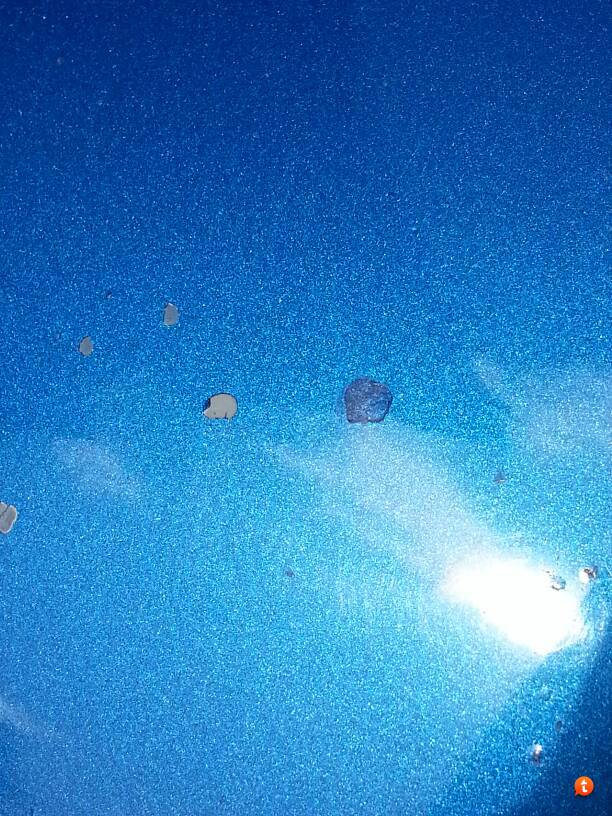

Didn't specify if it was metallic or not though. Currently applying in stages as we speak to see the difference...
You can indeed mix 2k Lacquer + Base Coat, thats how tinted lacquers are done etc etc, but you have to keep the proportions of base to lacquer low, else its possible it can crack or have other undesirable effects. With 1K Lacquers its absolutely fine to mix base and lacquer in any proportion in my understanding, the above only appies to 2k lacquers.
For a stone chip repair, you want standard base coat put into the chip, dried, then a 2K lacquer with the fastest hardener you can find (potentially with an accelerator in it as well), blobbed on to the chip so its slightly proud, covered and either left to cure or even better force dried, leave it like this for X weeks so all the shrinking back occurs as the lacquer cures properly, then use the Festool denibber (ideally) or wet sand to bring it level then polish it up.
If you do it well enough will won't see it after, unless really really looking close up at the metalics........Is it worth the hassle? probably not............it can also be done with a 1K Lacquer, but its much more difficult due to the lack of build and generally in blob forms lengthy drying times.
The colour match looks pretty poor to be honest , unless it's just the pic . You need to build the paint up so it stands proud of the chip . If it's only a small chip or scratch you don't need any lacquer .

I'm giving it another go at the moment. One with no lacquer and one layered with the correct amounts per instructions, just to see difference.
