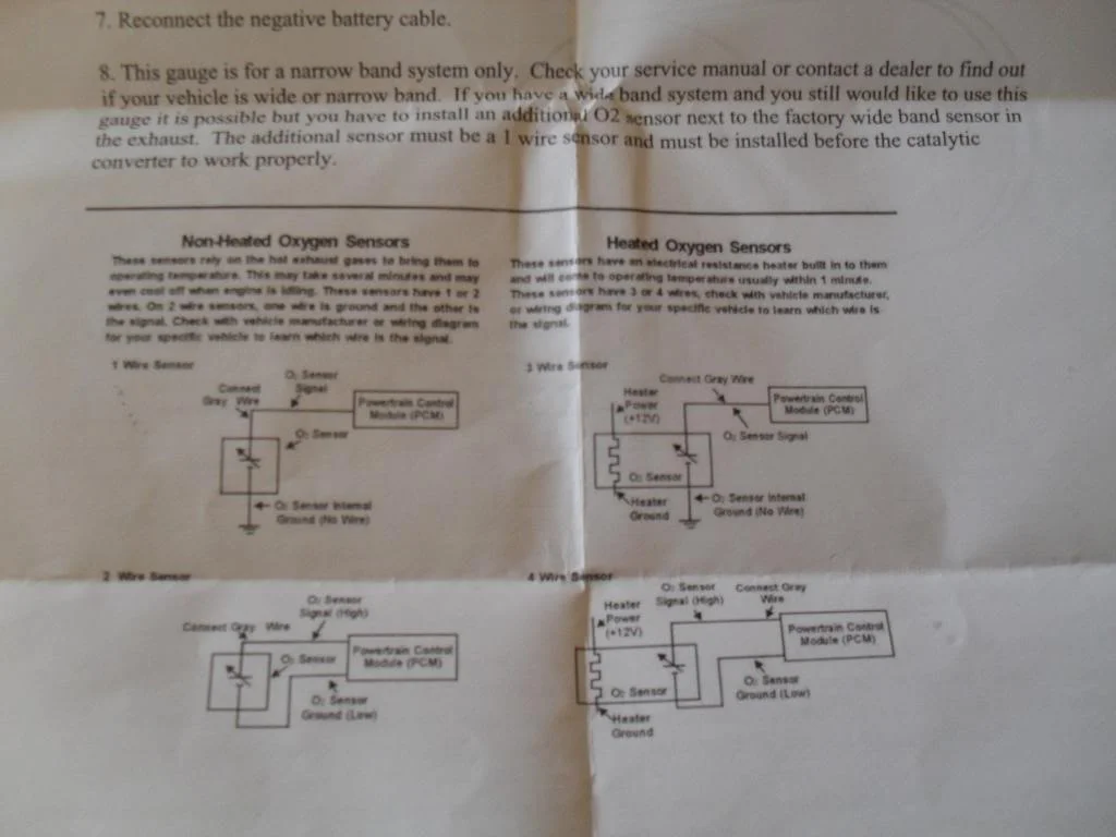

and hears the back of the sheet, talking about heated o2 sensors,
i know about electronics, but not when it asks you to do a number of different things!
