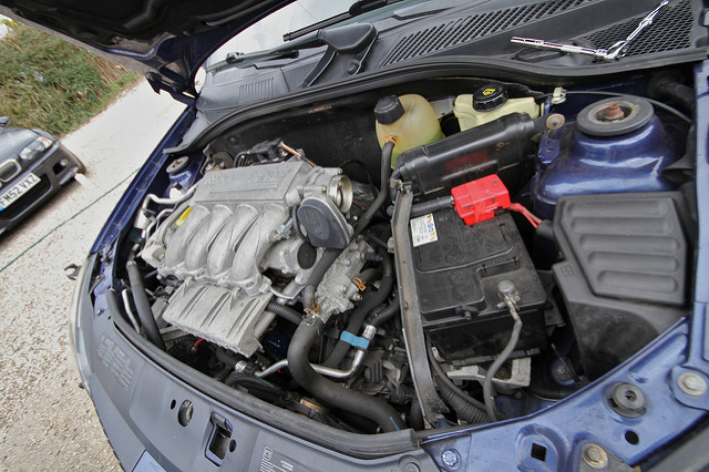

Should look something like this:
No box by evil_giraffes_rule, on Flickr
Honestly can't remember how on earth it's fixed down and don't own a Clio any more to check... does it 'clip' down under a part of the base/tray ?! :S Someone will tell you...
Why have you got a non-OEM fit battery anyway ? Halfords sell them.. not like it's hard to find one that does the job properly ?
It's a block clamp that bolts to the battery tray and wedges the battery in place. It's located on the left side of the battery in the middle
