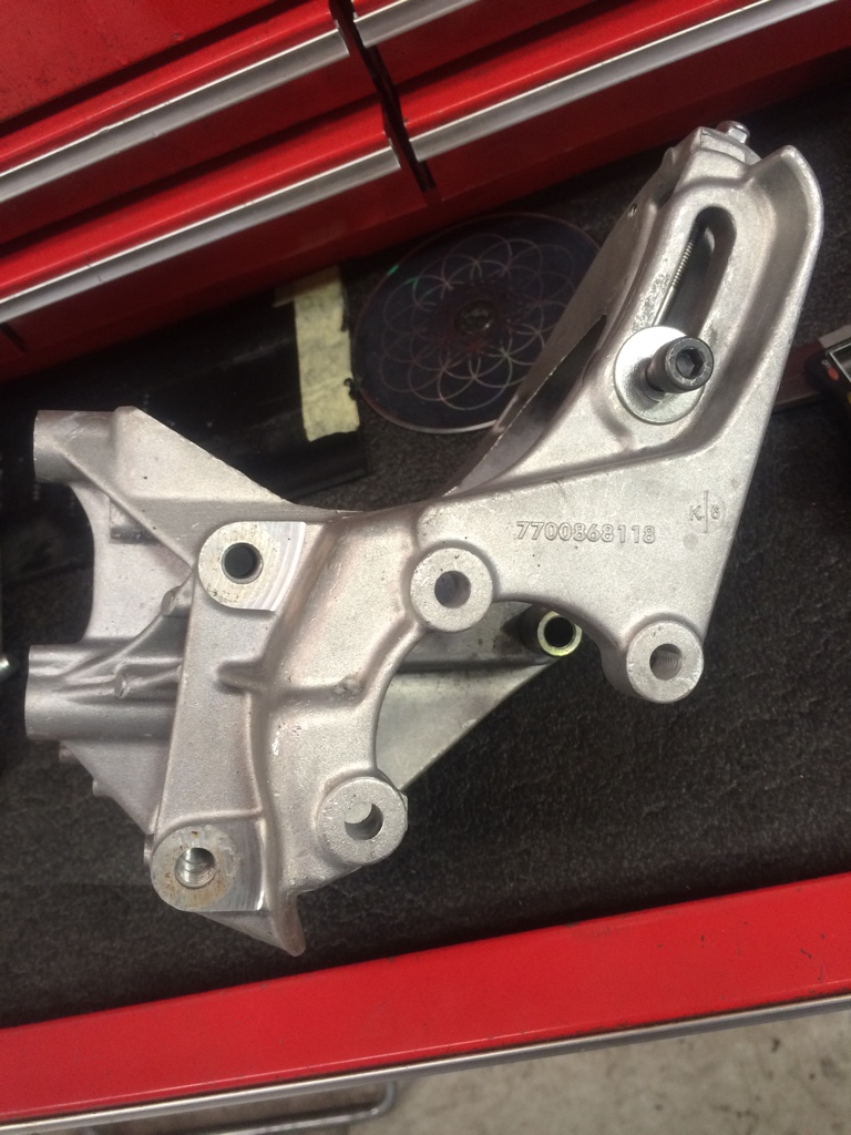

I think you are missing the adjustment bolts from that list.
This is a cup bracket , part number is on the side .
Different to the one you have listed
