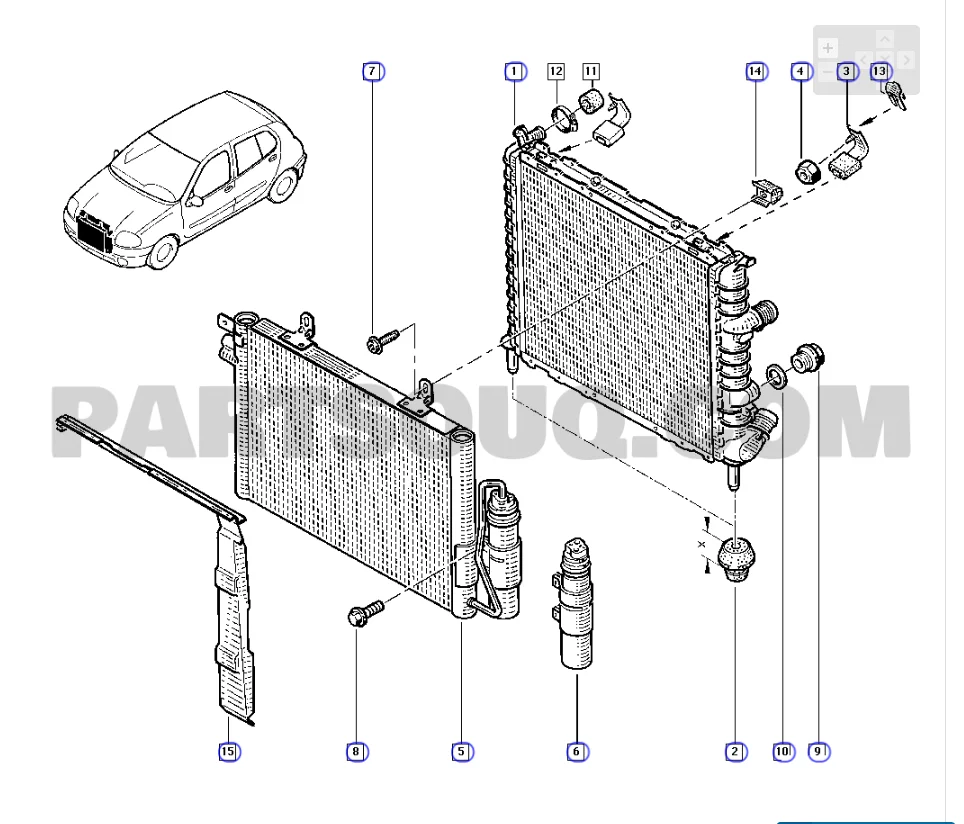

The air con rad is attached via bolts and these are tight but the rad is still a loose fit with maybe 5mm of wiggle - so I am assuming that some sort of rubber grommet should be on rad bolts to allow it to be firmly attached with some movement to take up vibration - is this correct?
I could do with a set of exploded parts diagrams for the car to be able to answer these sort of questions - anyone know of an online source?

AC rad is attached to the main cooling radiator via 4 brackets.
These brackets are riveted to the AC condenser and over time wear from vibration and can get loose. I imagine this is the movement you're seeing.
Crayola
Like this?
