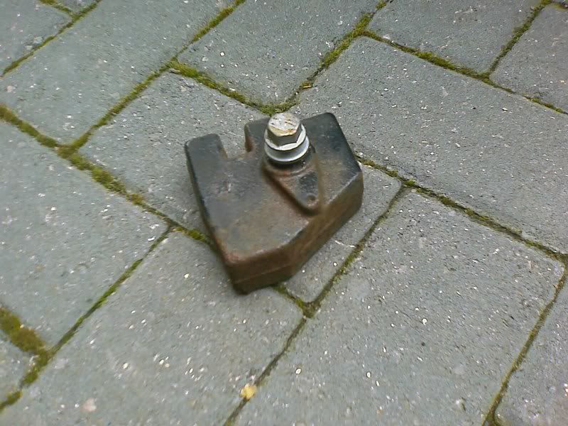

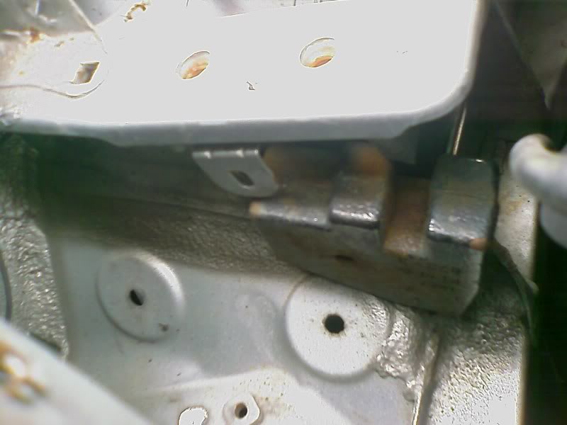

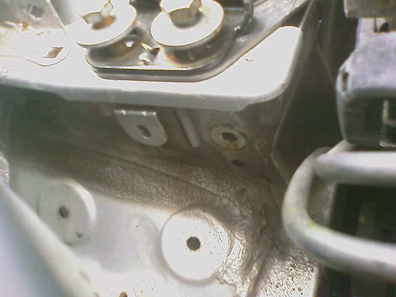

Courtesy of Mr Burp, this is what I removed:

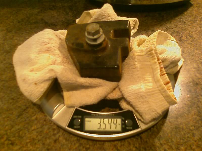

Not a massive update but quite a nice weight saving.
Under the engine mount is a useless lump of iron
Or shall i say, there was.........
Hows this then?
Not as heavy as the one on a 182, that is a massive 6kgs!!!

Not sure mate, some kind of counter balance/weight. Seems completely pointless but it was the only change I made other than the mounts so thought it may be relevant.
