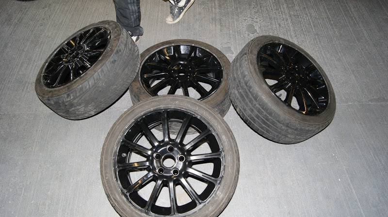

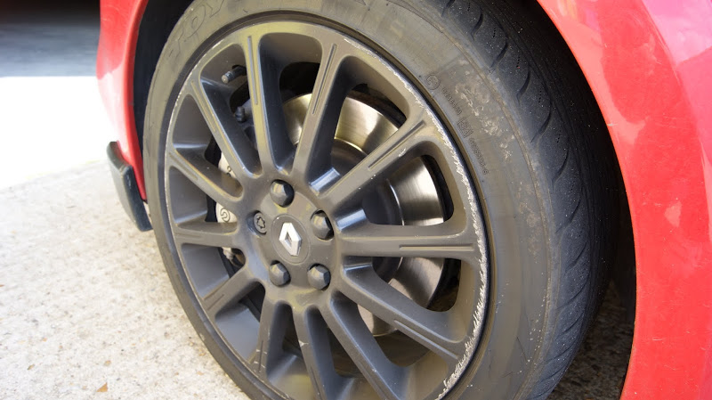

Now I'm not one to 'curb' my wheels but after you lend your car to fellow CS members they tend to come back like this lol

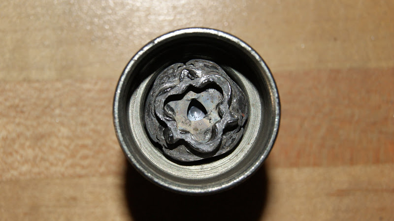

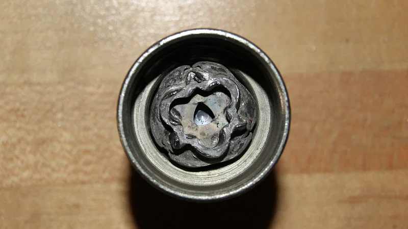

Now I would love to know who in particular designer the wheel locking nut for Renault, personally think he should be shot
Had to use the impact gun to remove them as the nut was slipping and on its way out

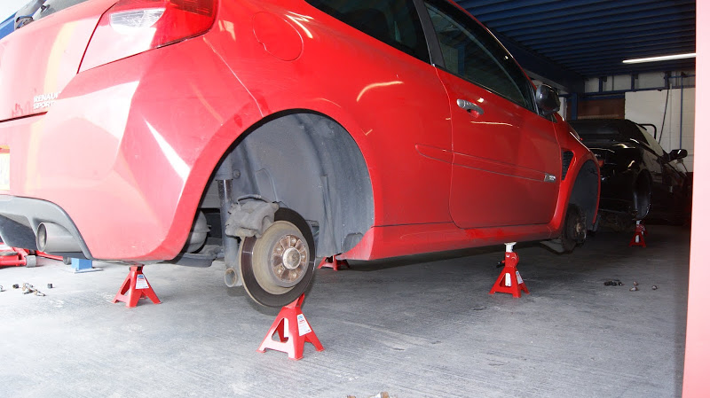

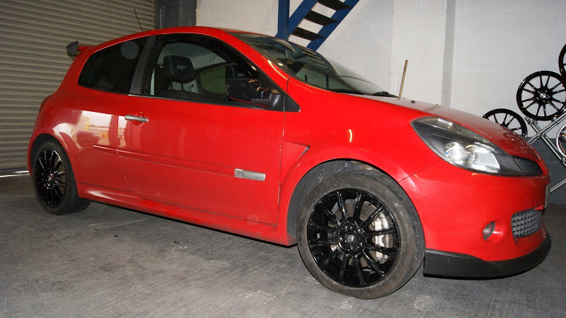

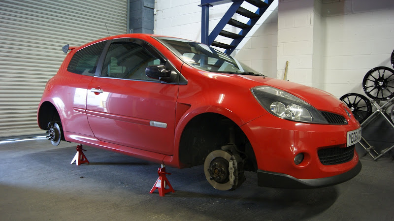

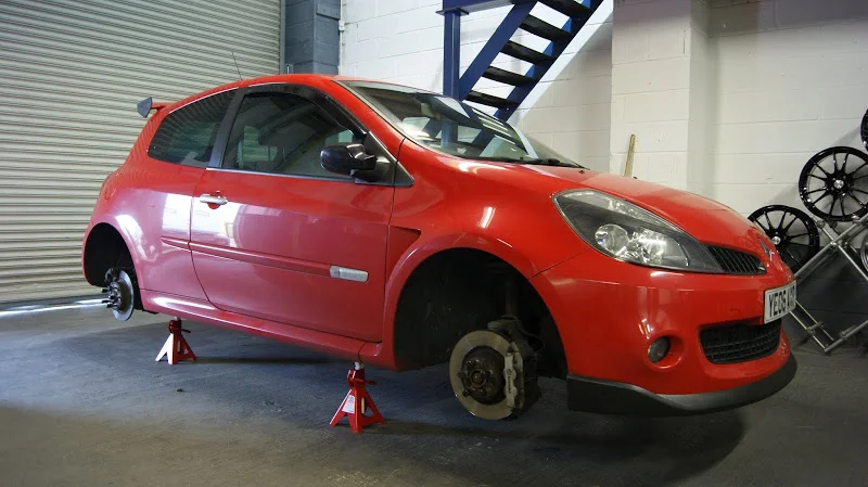

so into the garage I go, jacked up and wheels taken off

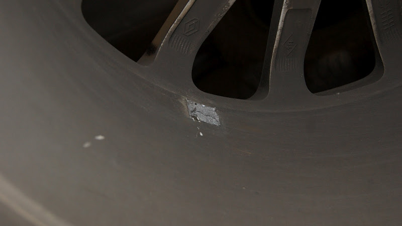

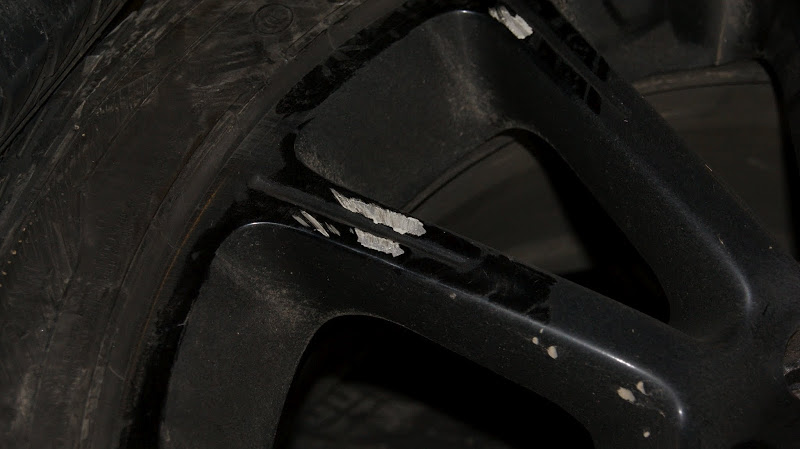

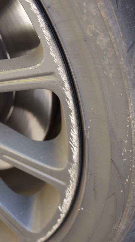

closer look at the damage, made by CS members (would never of been me)

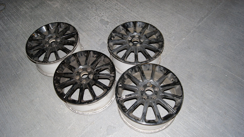

Next stage was to take out all the valves to deflate the tyres, then all weights removed
onto the tyre machine to remove the tyres. All 4 complete with centre caps removed

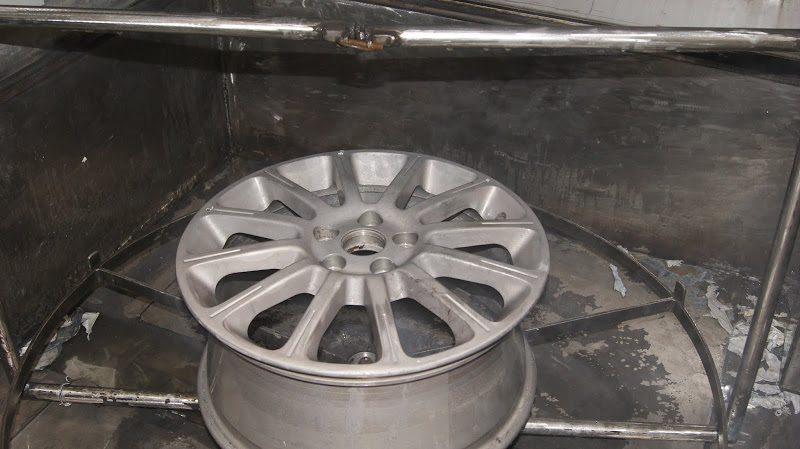

Next up was to put these in the acid tank to strip the wheels back to the bare metal
Now this is serious stuff makes your eyes water even when you go in the room
After only 5 minutes it started to work it wonder
After 20 minutes they were pretty much done.

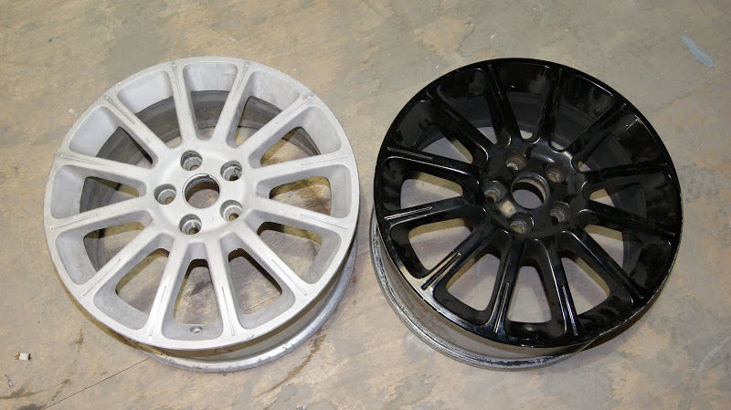

So into the jet wash machine they got have all traces of acid removed
This is a before and after shot

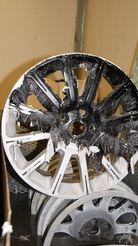

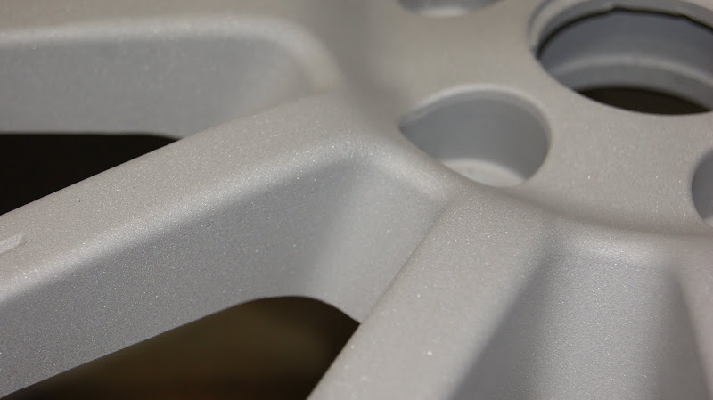

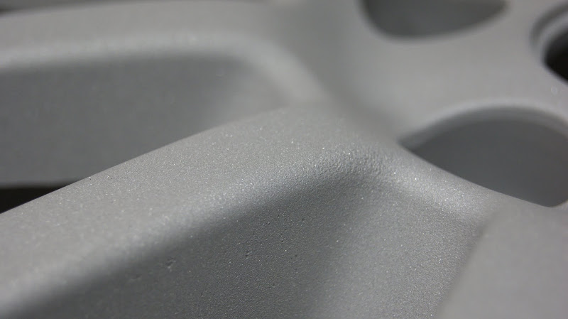

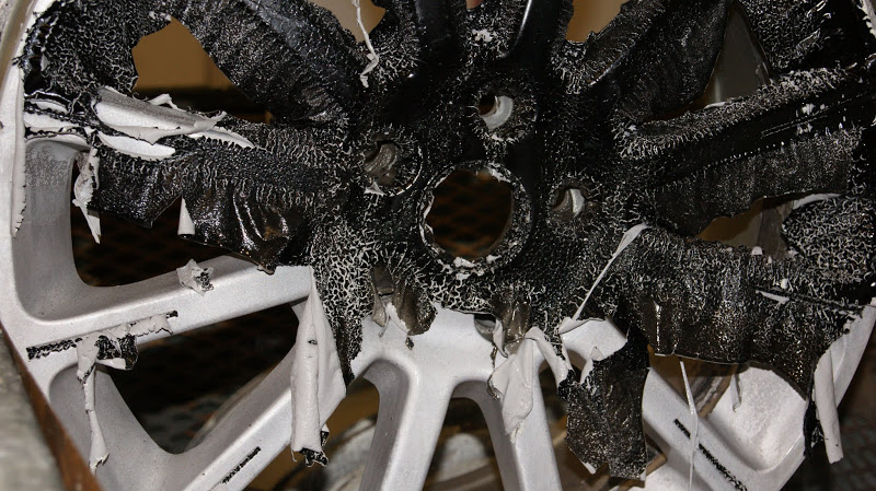

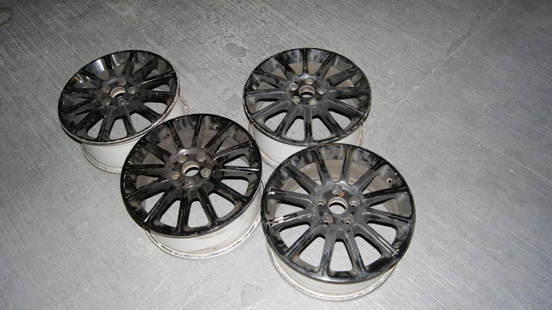

The next step is to Shot/Sand blast them to get them ready for painting.
The finish comes out like this

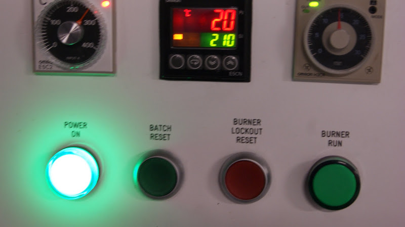

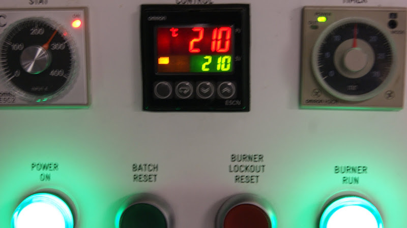

After all 4 have been done, hooks are placed in the vales, and then placed in the oven to pre heat.
Oven set to 210 degrees Celsius and a timer is set for 15mins

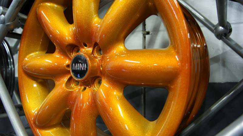

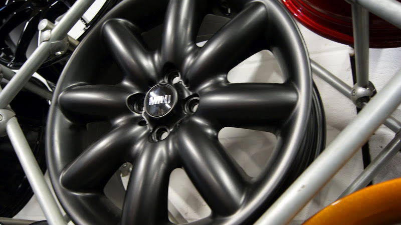

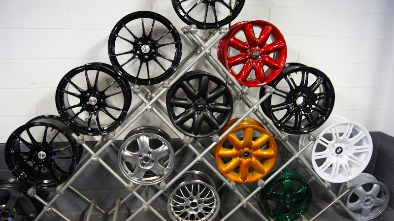

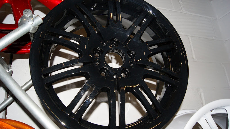

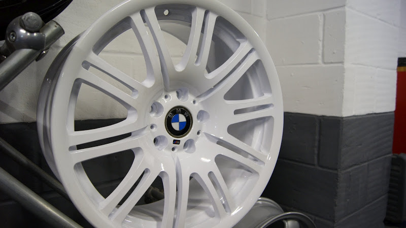

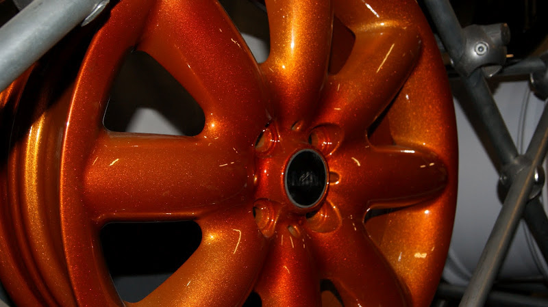

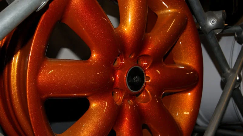

While we were waiting for the oven to heat up, I took a few pictures of some samples done in various colours so far.
Yes I know you wanted to see the beast again in all its dirty galore
sample stand

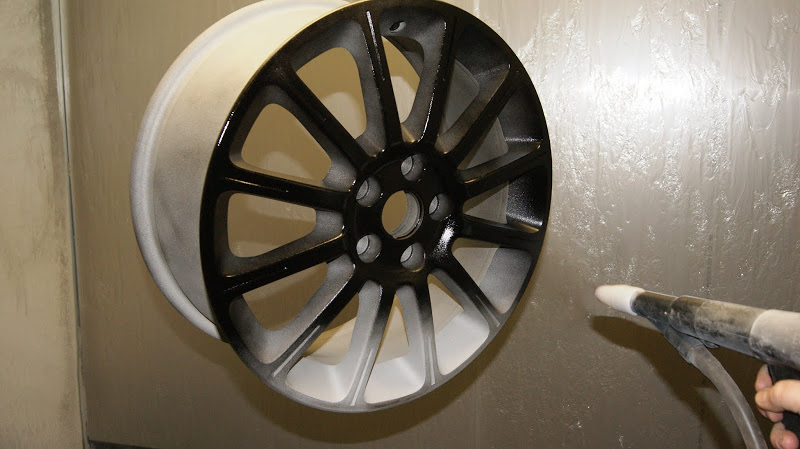

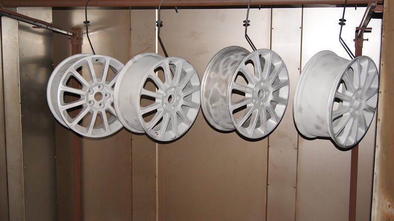

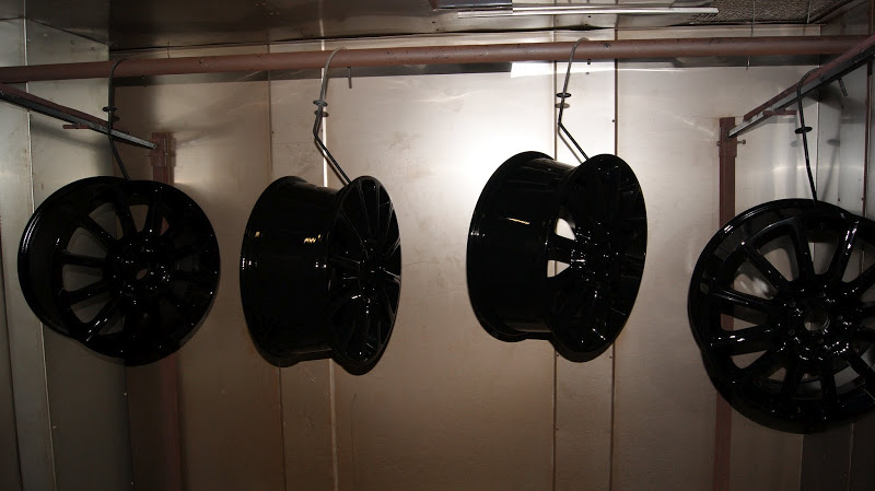

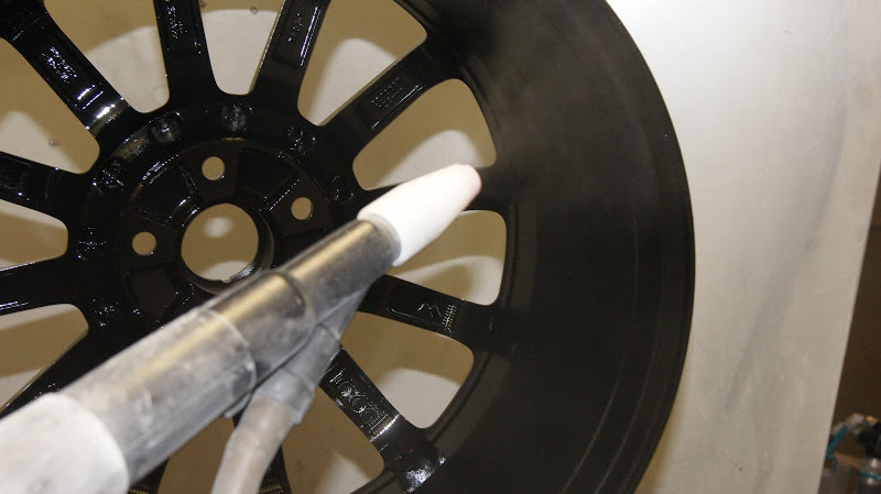

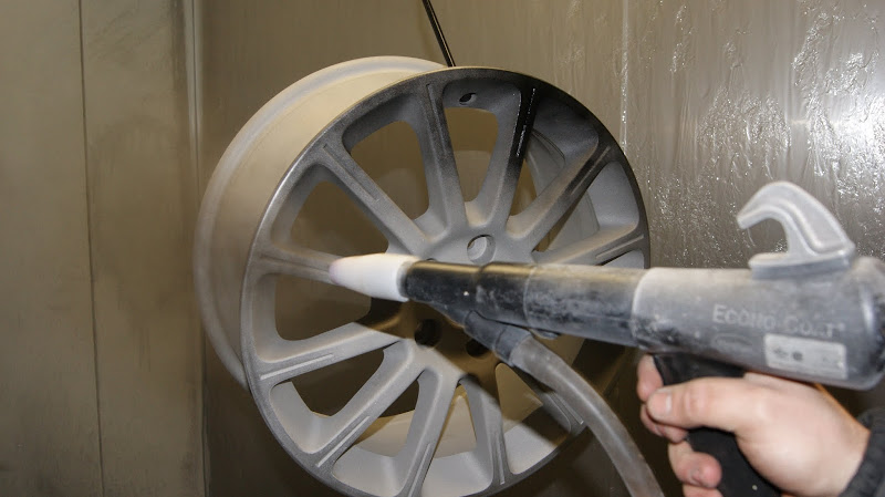

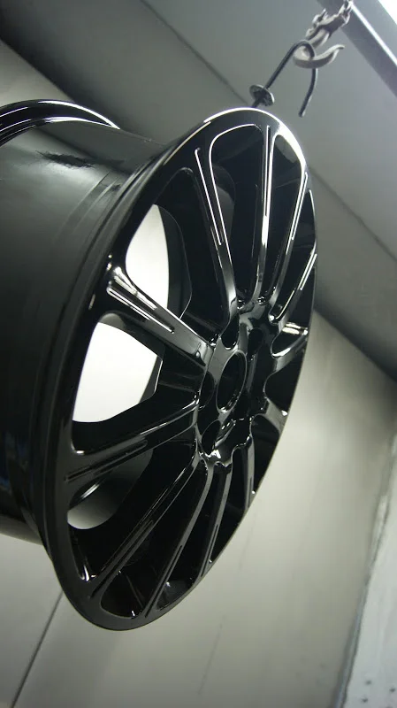

Out of the oven and into the spray booth they go ready for a powdering
Electrostatic charge (some technical term for the power will stick blah blah blah)

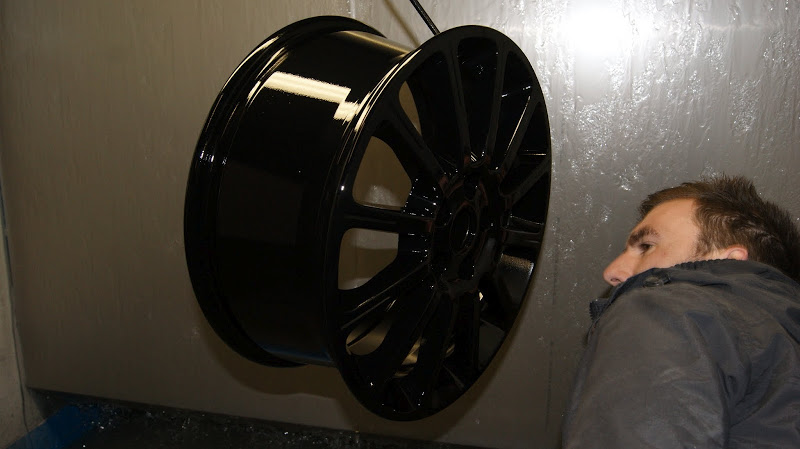

all done, check we've not missed any gaps
Then back in the oven the cure for 10 mins

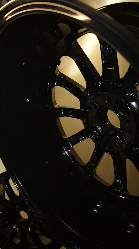

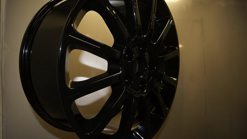

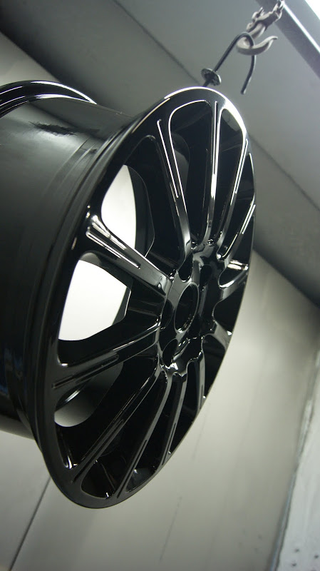

Now I choose not to have these lacquered, its optional when using the powder we used.
They are not a matt or satin finish, but there not super shiny, just gloss.
This is the finished result
and the back done, so all nice a smooth when you come to clean the back of your wheels through the front :)

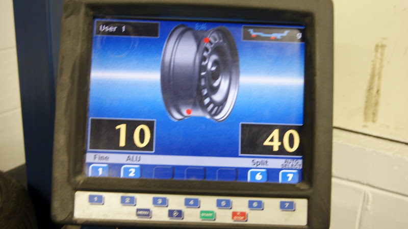

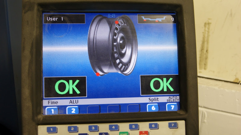

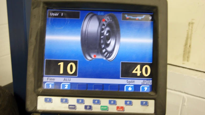

onto the balancing machine
not bad
Weights on and retest.
Spot on

Locking nut not used due to crap design

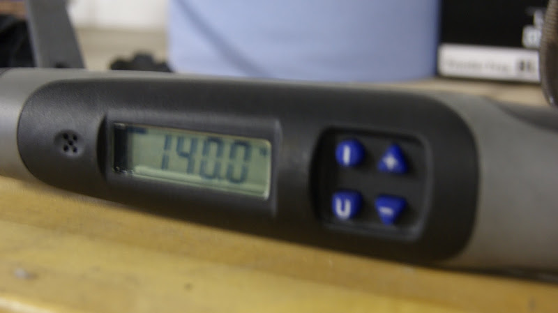

Torque wrench used for tightening

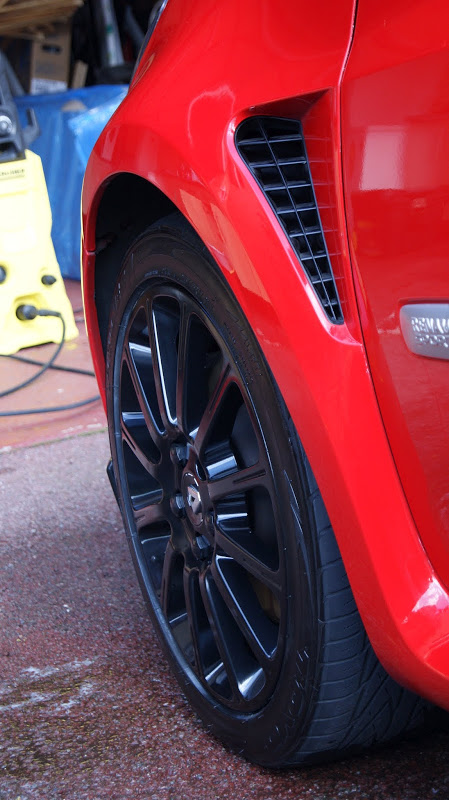

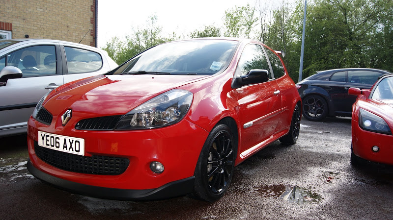

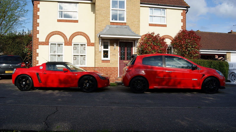

And the end result. Must say I'm over the moon
and with my VX220 he also done

No pictures of the curbing repair? This bit interests me.
Its done in a sand blasting machine, basically its a sealed unit that you put your hand in gloves through, inside is the wheel with a hose that fires compressed air along with sand/broken glass/walnut depending on what finish your after.
This process gets rid of most of the curbing, any chunks that are missing need to be filled using x and DA'ed back down to the shape of the wheel
