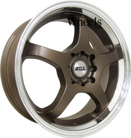

probably stupid question but could he not mask during the painting and then remove the masking etc for hardening in the oven?
or use say a circular piece of metal after doing the entire wheels black to hold in the centre of the wheel whilst doing the rim a different colour... (i know it would be messing about)
only asking because they have a very prominent lip...
originally looked like this.. but the lip is smooth...
