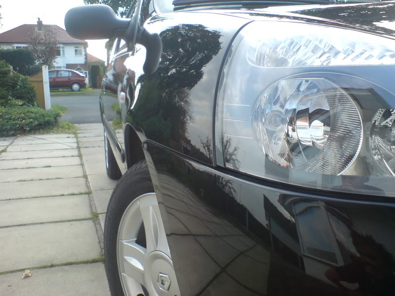

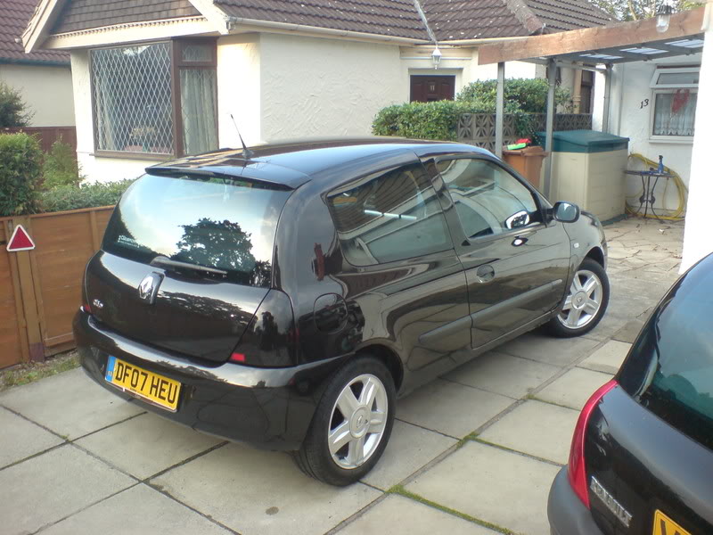

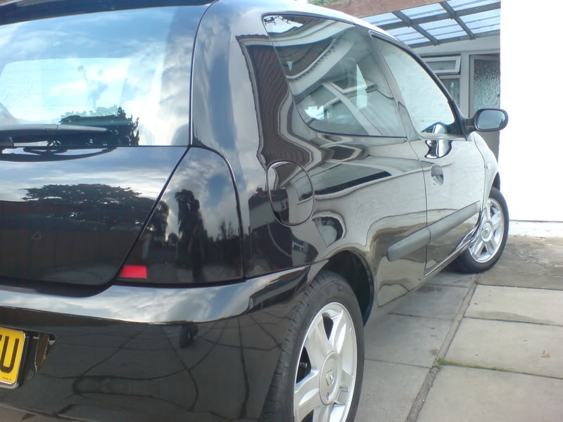

Some of this was done after the photos because i wanted some pics before it got too dark.
Method:
-Pressure washer rinse
-Wash (2 bucket) with Autoglym Bodywork Shampoo Conditioner
-Clay with Sonus SFX Ultra-Fine Detailing Clay
-Wash again with
Autoglym Bodywork Shampoo Conditioner at half concentration and dry
-Autoglym Super Resin Polish
-Autoglym Extra Gloss Protection
-Autoglym High Definition Wax
-Turtlewax Extreme Nano-Tech Speed Wax (quick detailer) (applied this after the photos i think..)
Windows- AG Glass polish
Wheels (after photos..):
AG wheel cleaner
AG SRP
AG EGP
The photos were taken on my phone so arent the best.. but in real life the paint looked like glass!
Any comments/criticisms?..

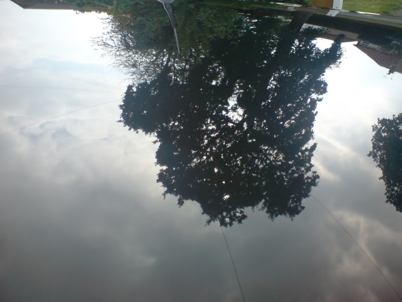

^ glassy roof =P
