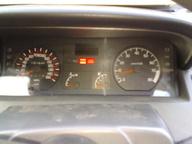

Once running we manage to wire in the rev counter which took some work to do neatly.

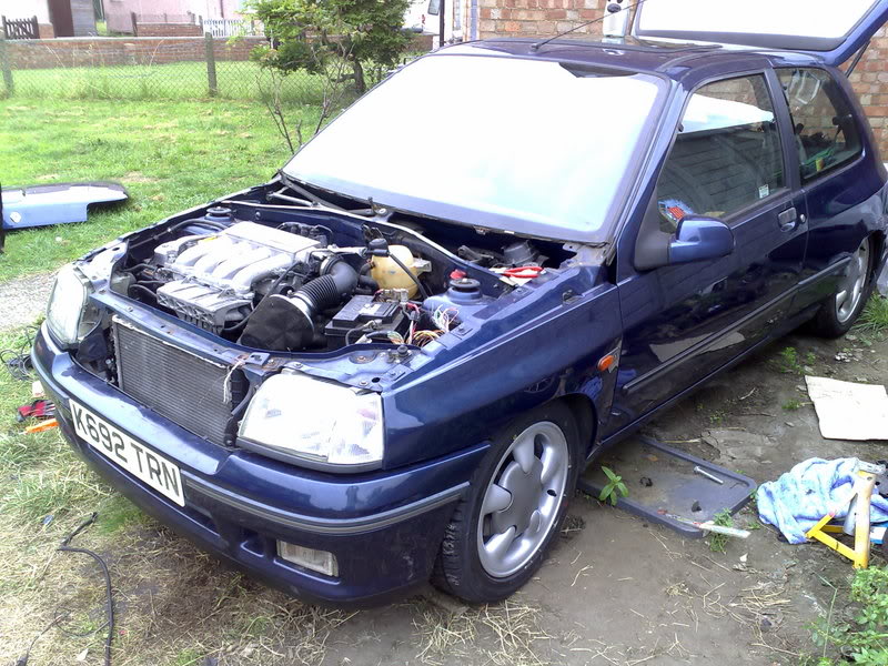

More developments!

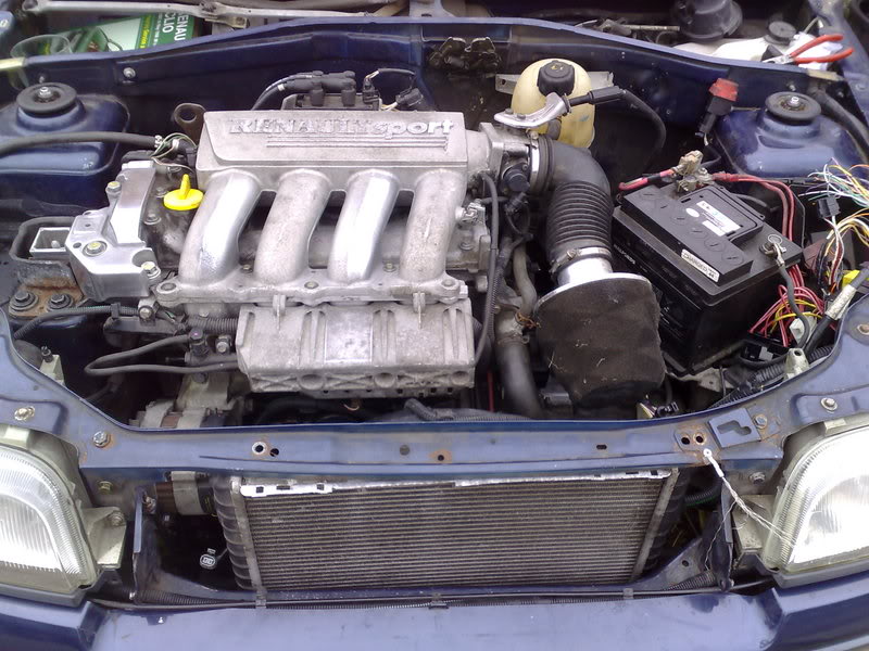

After a day in the garden we've got a bit more done.

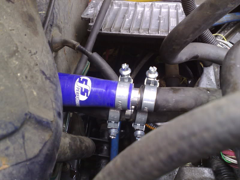

We've piped the cooling system up using an adaptor from demon tweeks.
And once we'd done the clips up it was water tight! :eek:
Then next job was to get the alternator charging (eagle eyed may have noticed on the cluster photo!), so we ran an ignition feed to it which took a surprisingly long time to do neatly as the 172 alternator only has 1 wire!
We've put the front wheels on it (though we must remember to buy and fit some brake pads soon)
Then we tested the gearbox and clutch by gently driving the car back and forward and all is good!
Now all is left is to bleed up the cooling system, get the temp gauge working, fit the non pas steering column (we've got one, just haven't fitted it), fit some pads and tidy up here and there, but for the sake of the neighbours we need to get an exhaust sorted first!

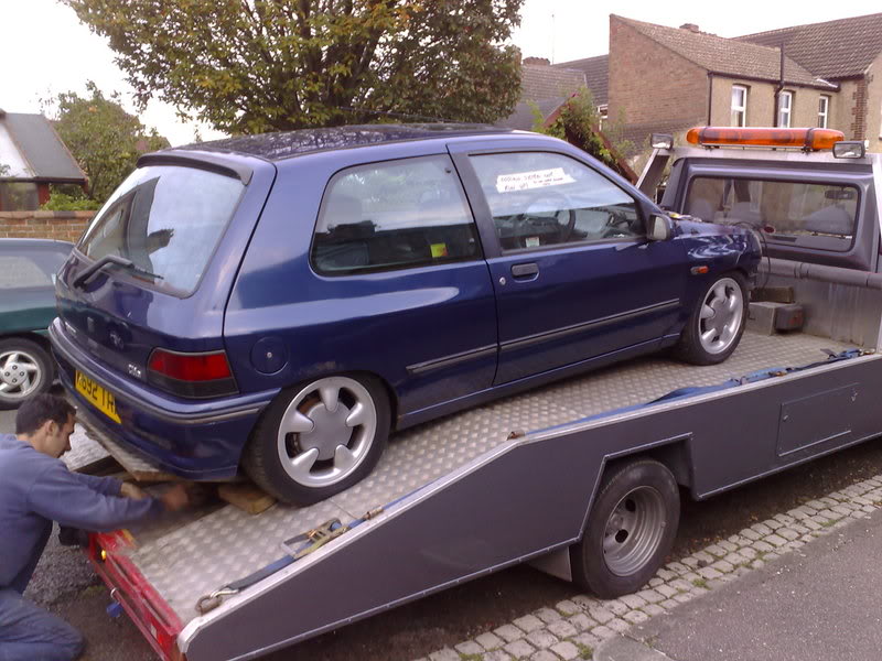

So yesterday we started her up, drove her onto the back of a mate’s recovery truck (setting off a couple of car alarms) and shipped her off to powerflow.
Good sign that it can move under its own power, although we did realise we haven't wired up the reverse lights yet!

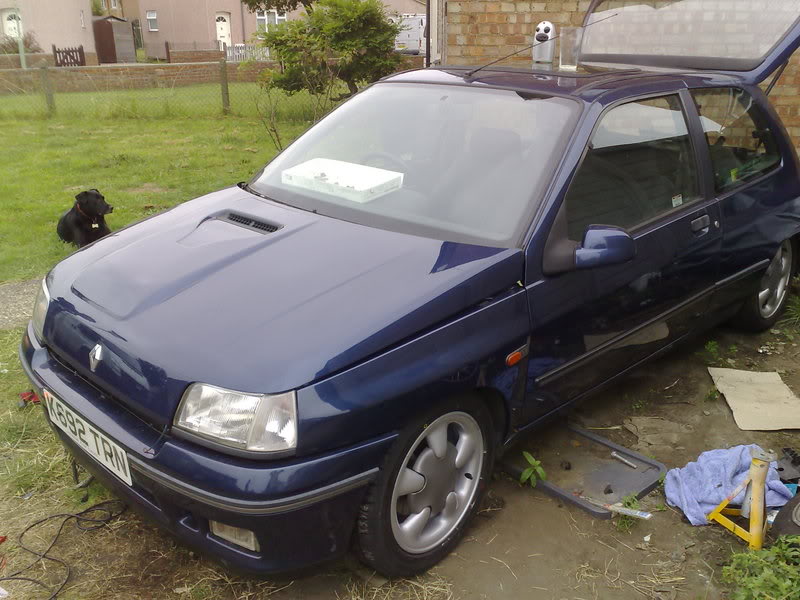

Got the car back this afternoon with exhaust fitted and all is very encouraging! Its loud, but not too bad, we've bled the cooling system up and all the gauges seem to work!

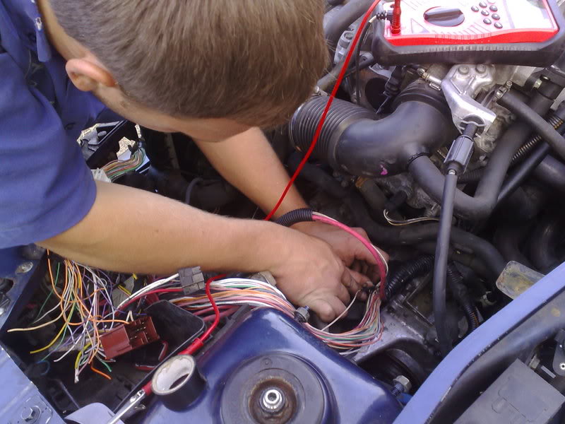

Only problem we've got is it starts and runs fine until it gets hot, then it starts to rev itself up on its own at idle. It revs up fine and everything, its just an idle problem. Only thing I can think at the moment is the lambda sensor plug got pulled apart when we stripped the old car and I'm not sure if the wires are in the plug in the correct order.
Has anyone else had a problem like this with a 172 who could shed some light?

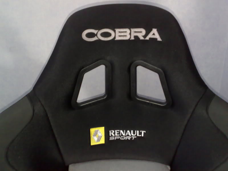

Cheers mate, progress slowed significantly over the last couple of weeks as we had some issues with lambda wiring but thanks to the forum we're on track again now. Also as you know I’ve been on a big old buy up with some cobra buckets, an omp roll cage, fibre glass tailgate, quickshift, possibly carbon fibre bonnet and a few bits to sort out some long standing issues with the car. I'm also working hard at getting a carbon fibre roof skin made up and seriously considering fibre glass doors.:approve:

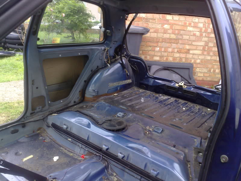

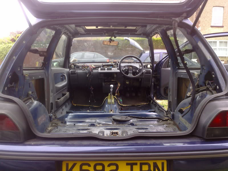

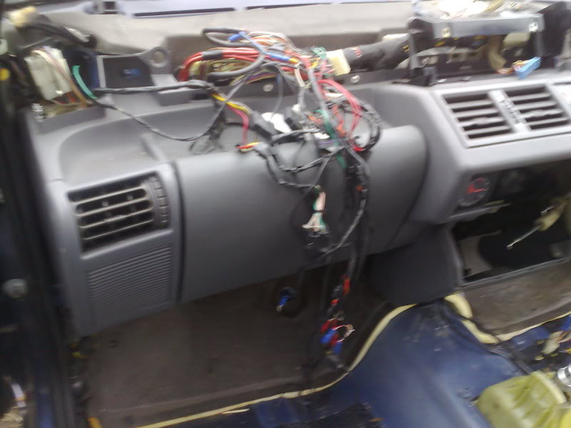

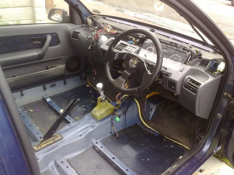

We spent most of last weekend stripping the entire interior (although that didn't seem to take all that long), but were unable to remove the dash due to a slight running problem we still need to sort.
With the interior out we've located a multitude of aftermaket alarms, none of which still work but certainly need removing.

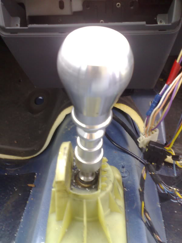

Next thing to do was fit the quickshift make sure that was all ok

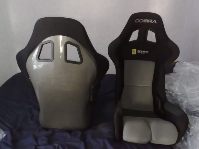

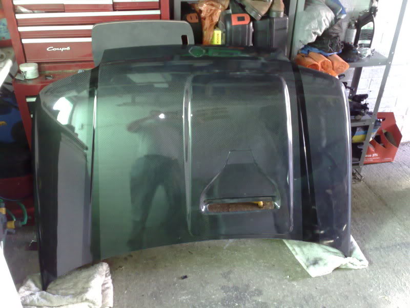

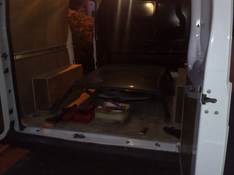

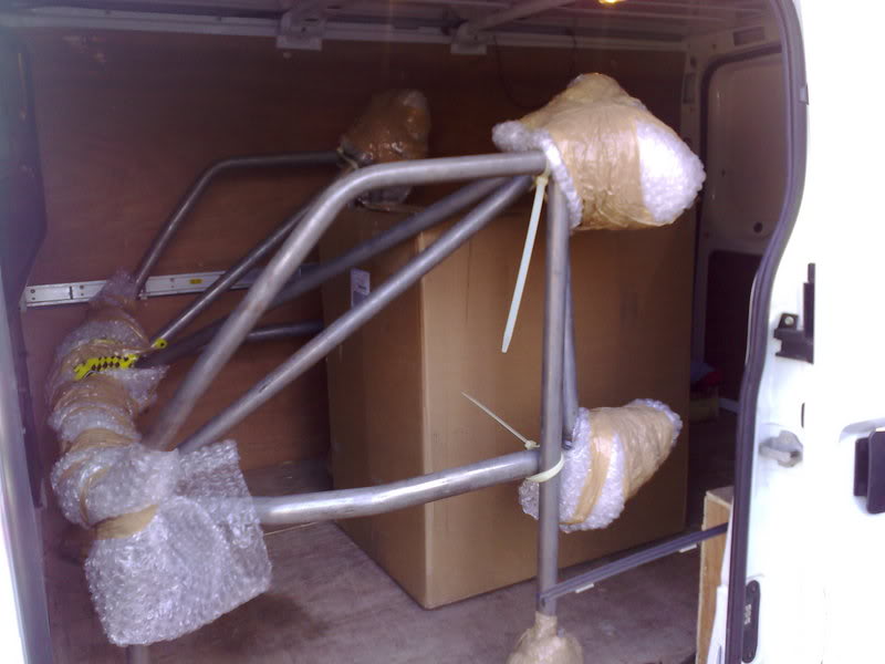

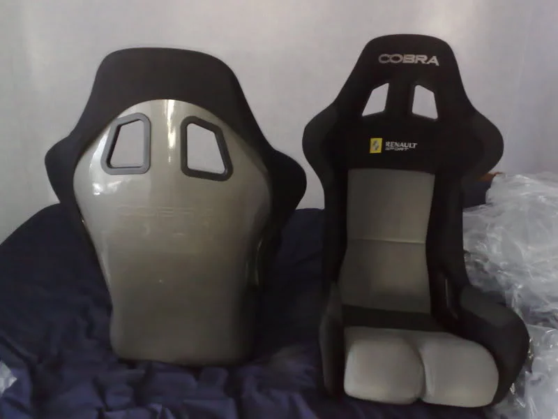

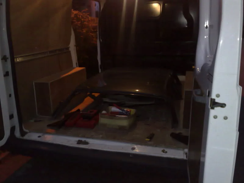

Now, this weekend, after a week of organising we rented a van and somewhere within the 500 miles we did we managed to pick up a roof severed at the pillars from a scrap clio, a carbon fibre bonnet, a pair of seats, a weld in FIA rollcage and also drop the roof off at the carbon fibre specailist to be moulded etc.
Now just a case of knuckling down and removing the dash and sound deadening then get the cage and seats mounted.
We'll keep you lot posted:D
