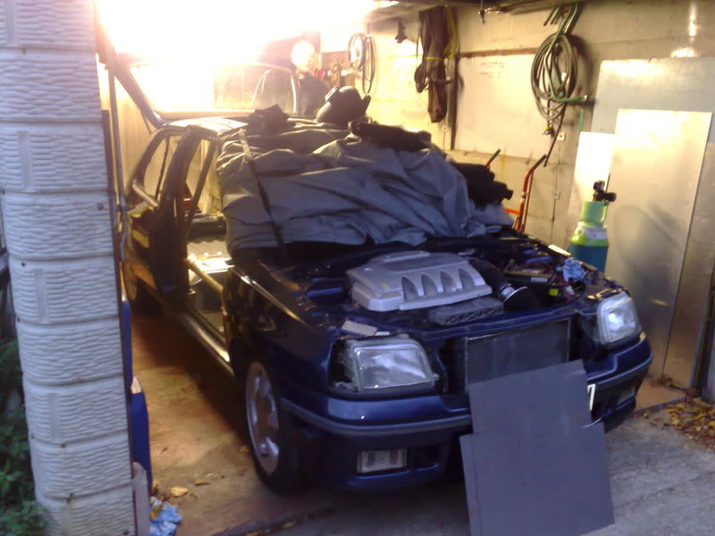

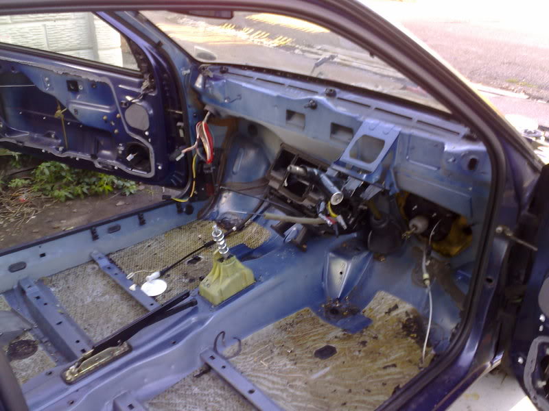

Todays progress, Got the dash and the rest of the interior and sound deadening removed and managed to remove both the Renault alarm immobiliser and a few gastly aftermarket ones. Then swung the dash back in and checked everything still worked with these removed.
Once we'd established all was well we whipped EVERYTHING except the heater box out the car to make room for the cage.

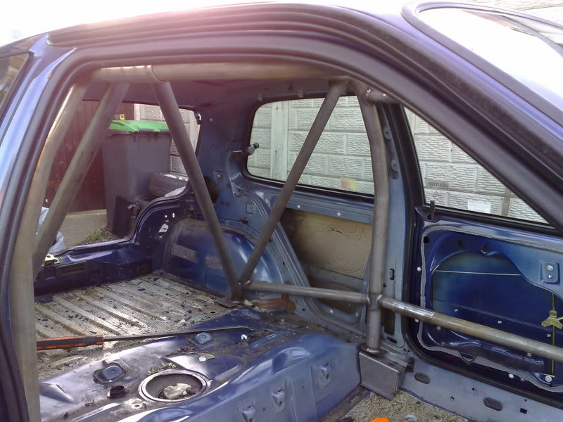

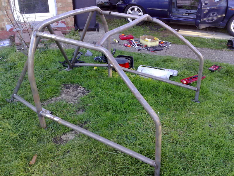

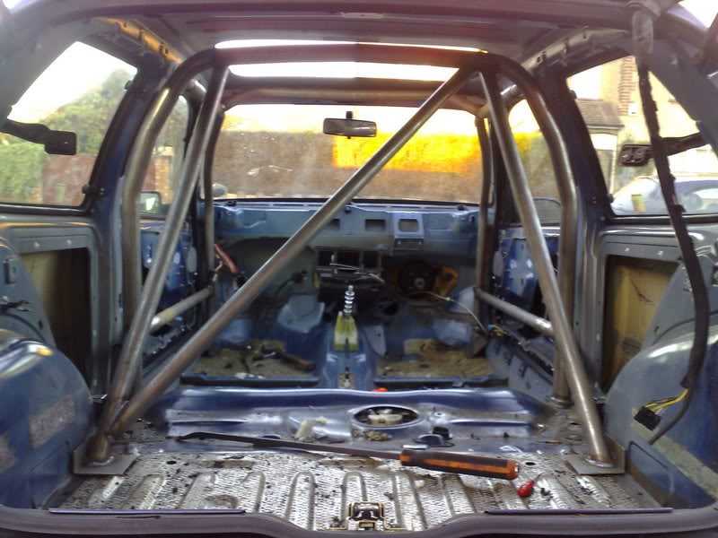

Next we trial fitted the cage in place which took some persuading and revealed we need to do a bit of playing with the brackets supplied. WHAT A CAGE THOUGH! really profesional.

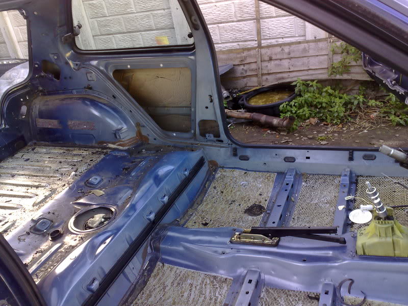

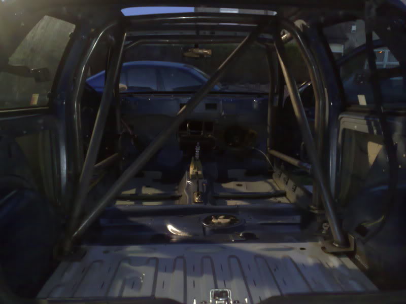

By the end of the day we'de sourced some tardis (tar and bug remover) and hoovered, scrubbed and scraped the rest of the deadening out and put the cage in it's final position

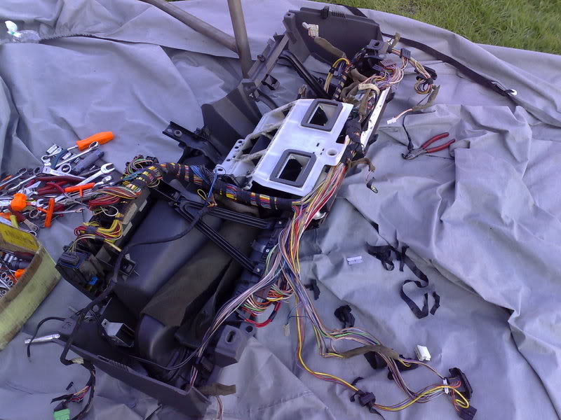

Cheers for the support fellas cars getting to the interesting bit now. Not much to report for a whole days effort today but we did work pretty hard all day basically removing all the wiring and switchgear we won't be using. Removed all the wiring for heated rear window, rear wash wipe all the cental locking wiring radio and speaker looms all sorts of stuff found it's was into the bin. Now as we're not using any trim we don't want any rendom plugs dangling around the car. Also we did a lot of cutting, griding and aligning of the cage and brackets which is pretty heavy going.
OH yeah and the cage is an OMP weld in 6 point number from yb racing who got it to us in good time.

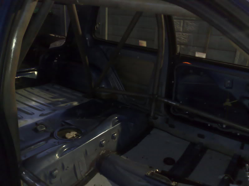

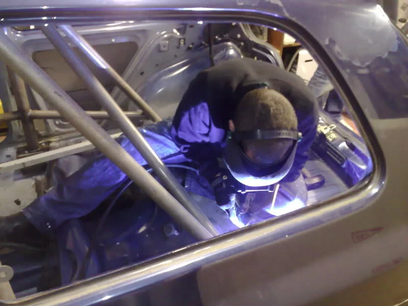

Just a little update really work has slowed a bit really as the cage is a B4$74&D job to weld in but we've got that under way. It took a lot of cutting, grinding, prying and hammering to get it into position. the biggest problem we encountered was the ridiculously thin floor pan and the very thick roll cage brackets meaning i now have a couple of small holes to get welded up by my very generous friend ady who for a couple of chip shop dinners is welding the cage in for us. We've got it positioned but now to make it perfect I need to make some small brackets up to box up the untidy bits
THANKS ADY!!!!THANKS ADY!!!!
While all this was going on me ever loyal brother has been tracing and unpicking wiring from inside the dash we don't want and when it's uploaded i'll post a fairly funny pic of him working on a very complicated loom on the lawn.

We've lost the origioanl picture of my brother cutting up the loom but this is the back of the dash having the radio, door hazard, rear wiper etc wiring being removed
