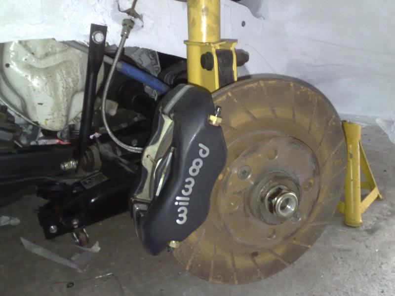

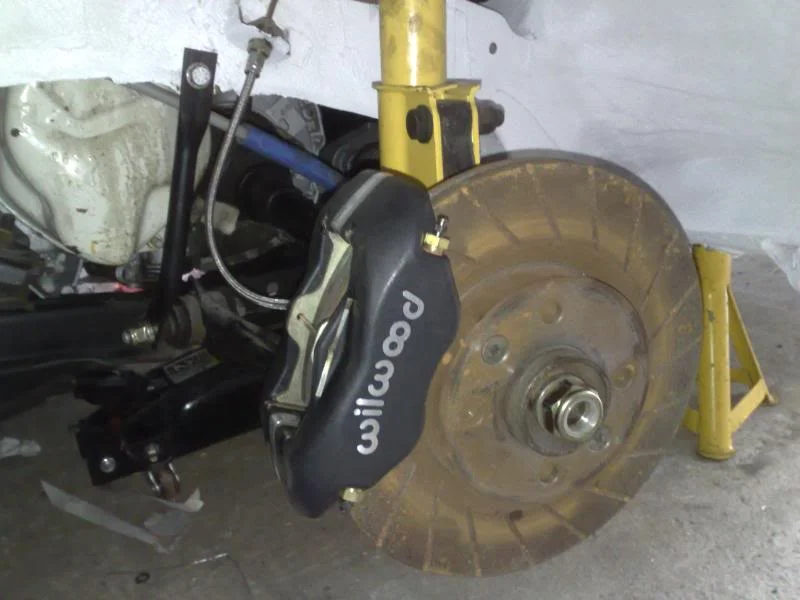

Northy the hub nuts were only on there so we didn't loose them, theyre now tight as we had only just fitted the brakes at that point and couldn't keep the car still while torquing them up.

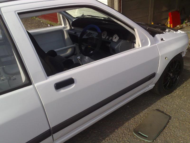

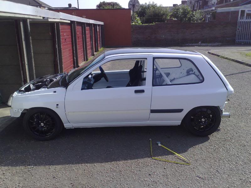

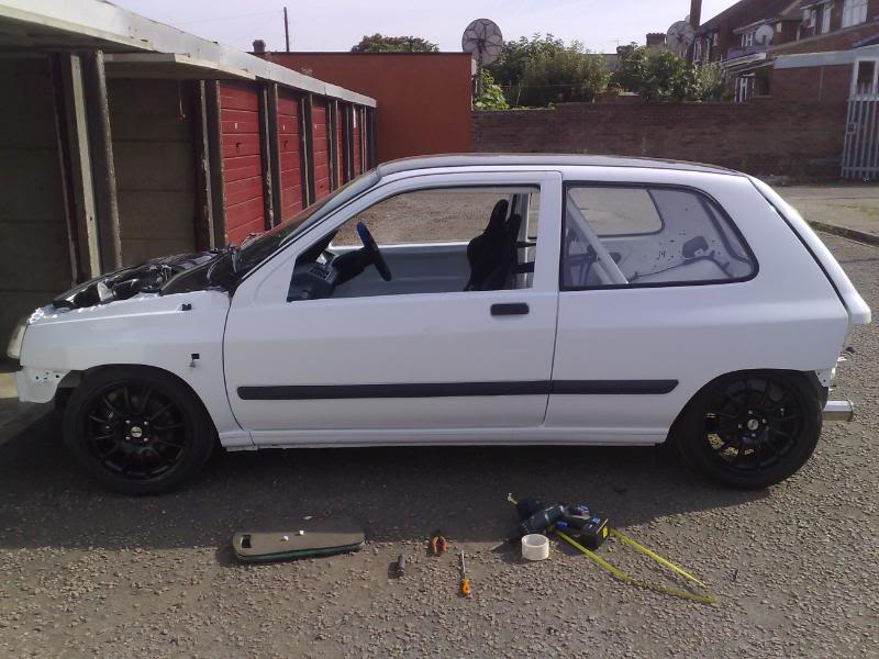

Right, due to public outcry we got our asses in gear and got down the garage. LOL

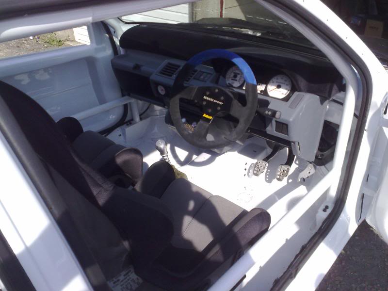

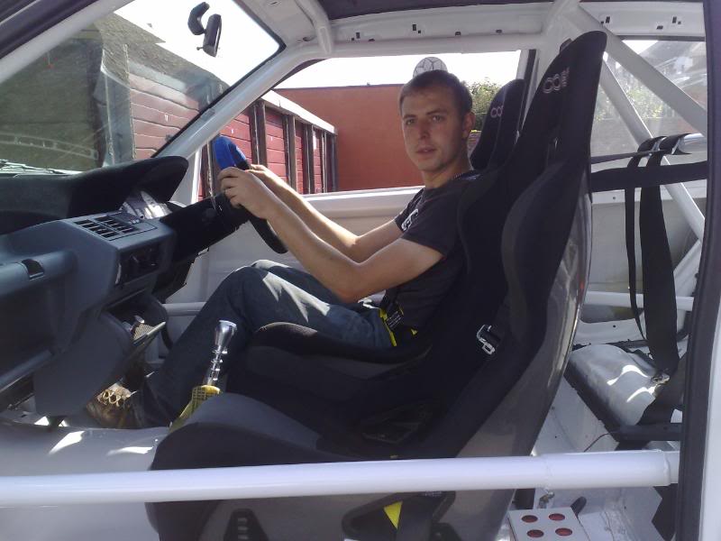

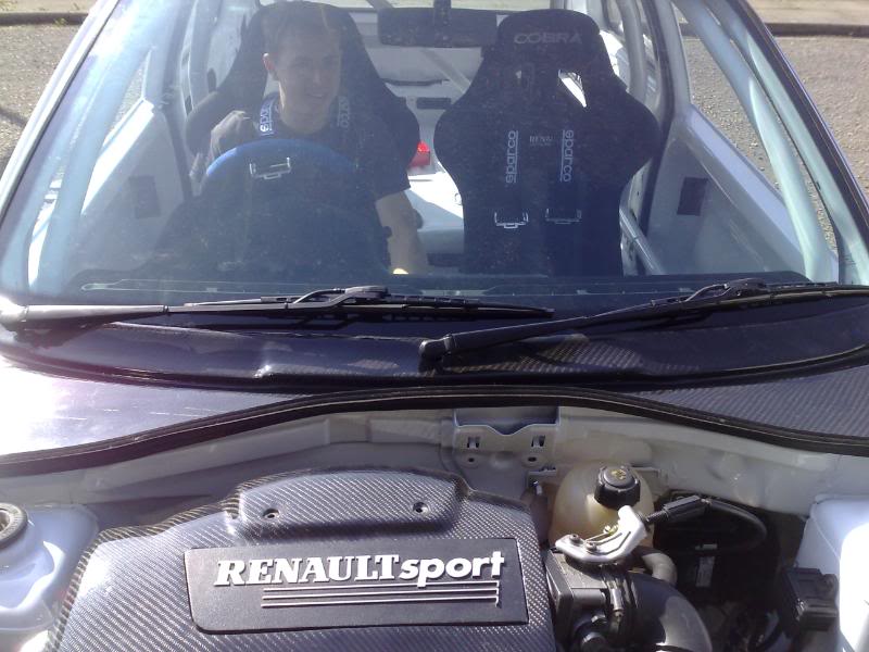

First thing we did was after getting the wrong steering wheel boss from a dude off eBay, we managed to get another and get the wheel on.
Rather impressed!!

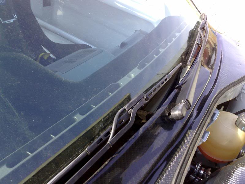

We've also managed to locate some wiper blades with washer jets in them to clear up the scuttle.
So we fitted them, but they still need piping up.

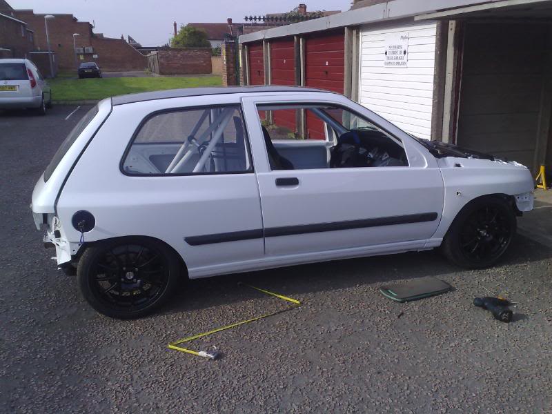

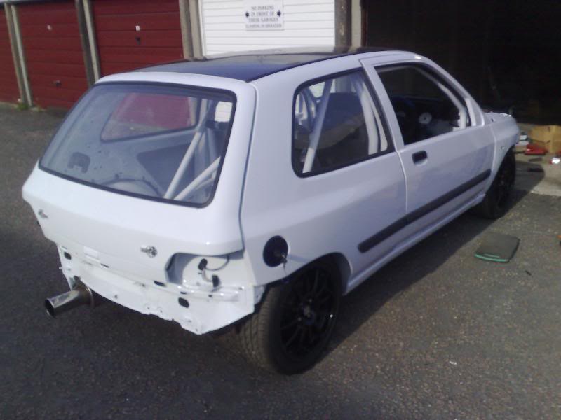

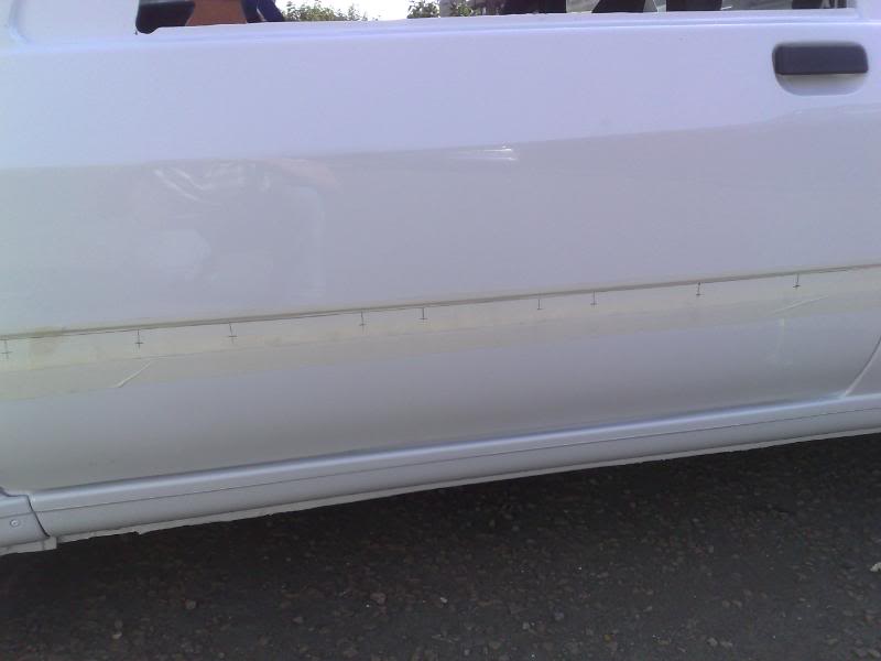

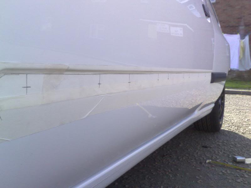

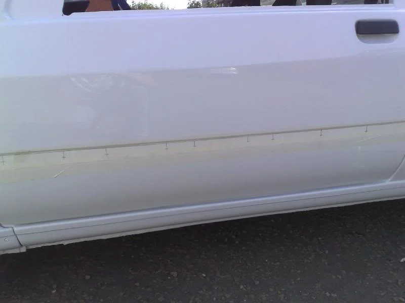

Next thing was, after a lot of hunting around we managed to locate a pair of quarter mouldings, so we got on with fitting those.

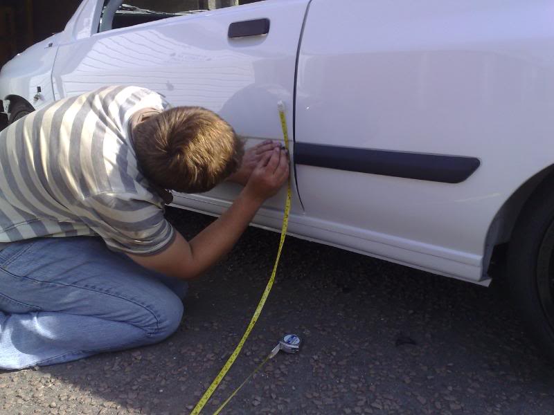

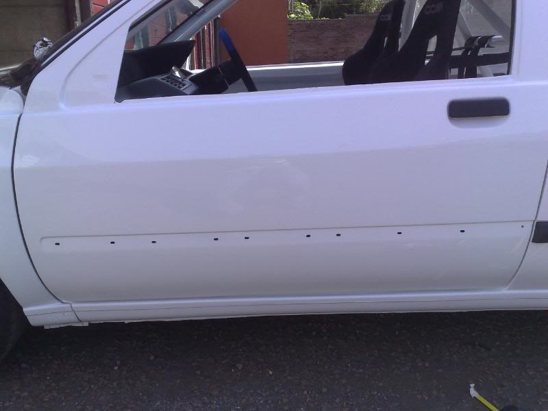

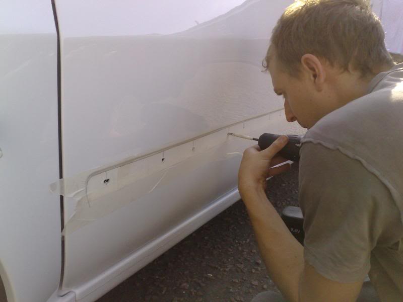

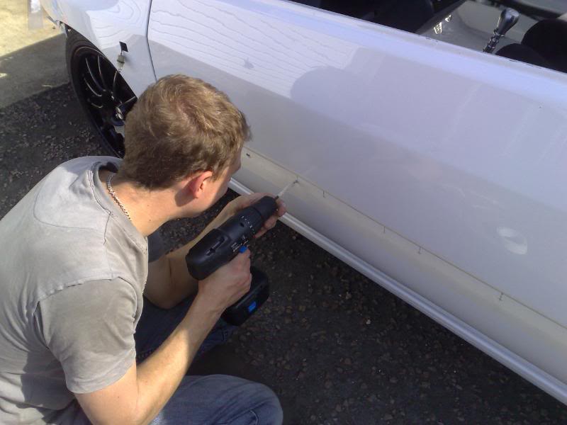

Clipped the rear mouldings on and set about lining up the door mouldings with them and drilling the doors for all the fixings.
Finally managed to clip on the door mouldings which make a vast difference to the profile of the car
Hopfully more to come tomorrow, we'll keep you posted

arse! I forgot - where did you say you got that steering wheel again? was it direct from renault? I remember a part number floating around but I've forgot that too!

Must have been a bit nerve wracking drilling the doors, I hate doing that sort of pernament work to bodywork!!

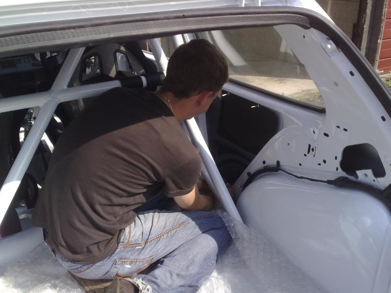

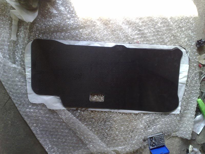

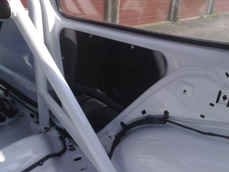

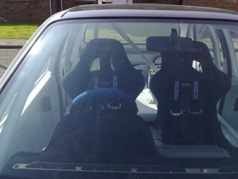

Well we're back but unfortunately without a vast amount of progress to report, mainly due to hangovers. We started off driving down to mum and dads and braving the spiders in the shed to retreive the door and quarter cards only to dicover the door ones were no where near big enough for the fibre glass doors.:(
So we made a greaseproof paper templates of what we need making. To show how much too small the carbon ones are we put one on our templates.
So the carbon door cards are up for sale now

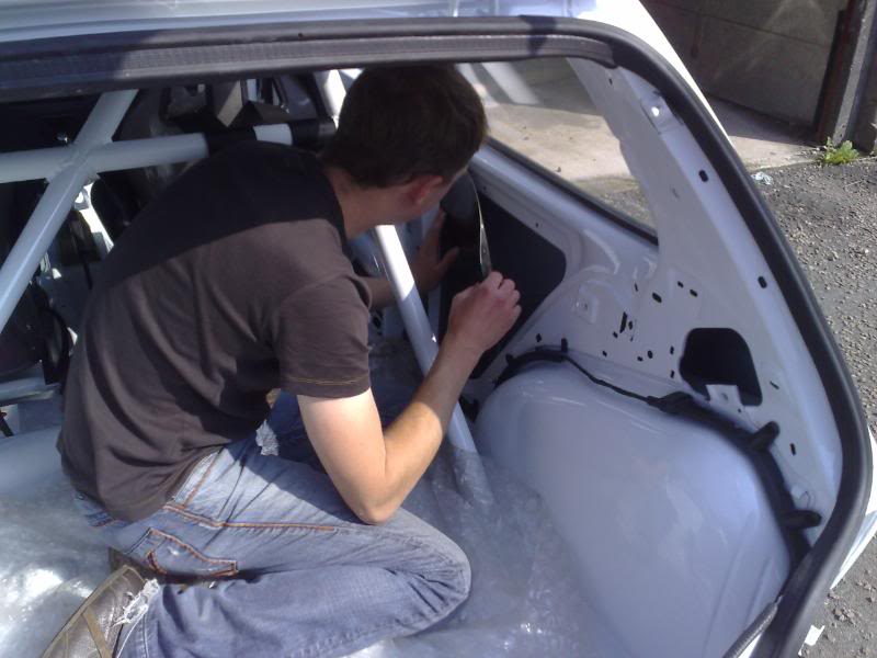

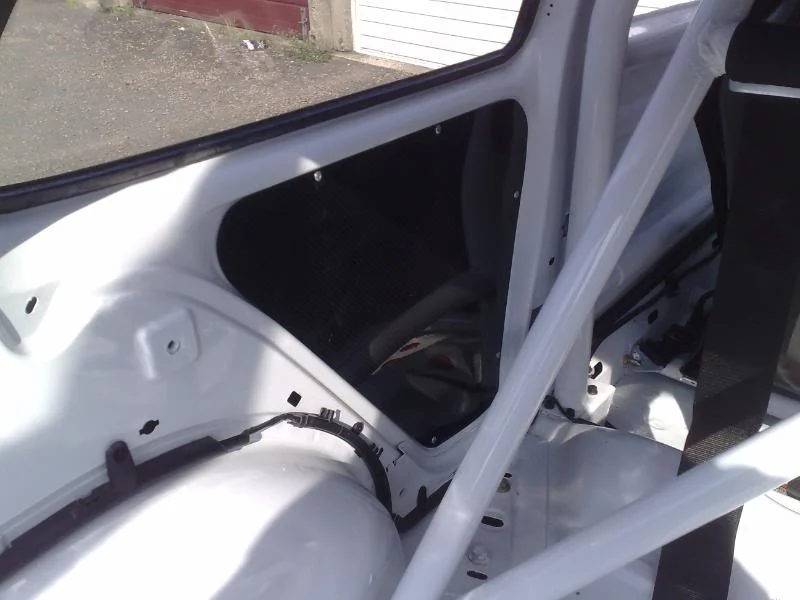

Anyway, not to discouraged we got on with fitting the quarter trims.
These tidy up the interior vastly and it'll be good to get the door cards sorted. We'll be ordering those soon money dependent.
We aslo noticed we hadn't posted a video of it running since we got it back together so here we are.;)
We've said it before but we're optimistic we should have some realy interesting stuff to post up next weekend.
