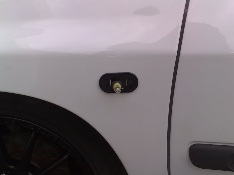

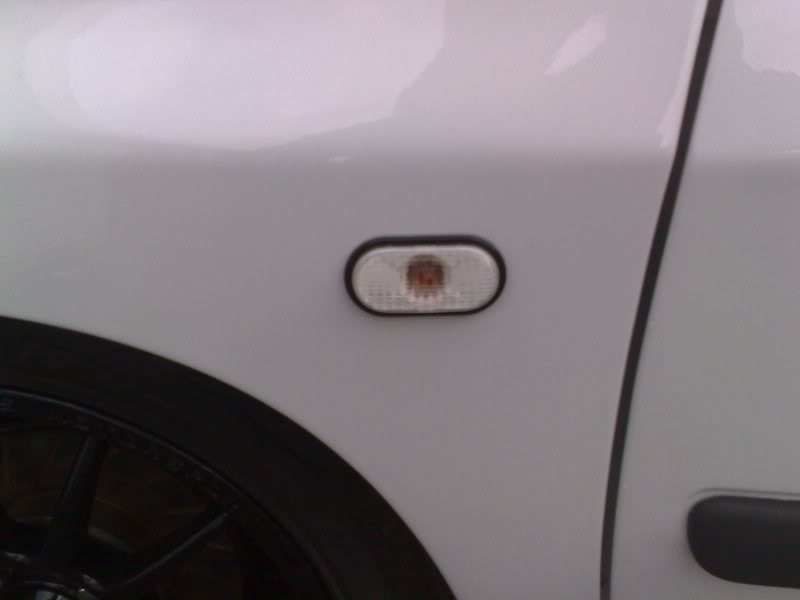

Progress from this weekend is small to say the least owing to a friends wedding and the aftermarth meaning neither of us were in any way fit to work on the car.
But we did manage to get down the garage and get something done, we managed to fit the repeaters.
Before
After

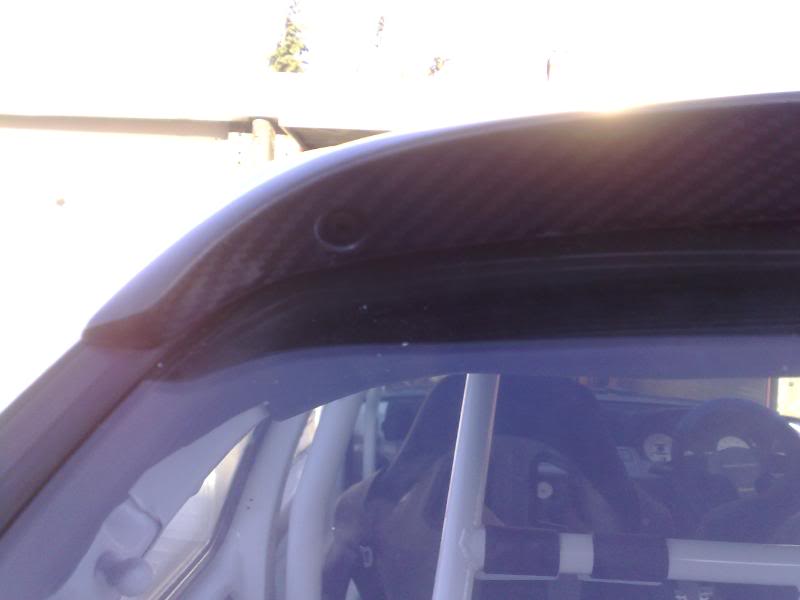

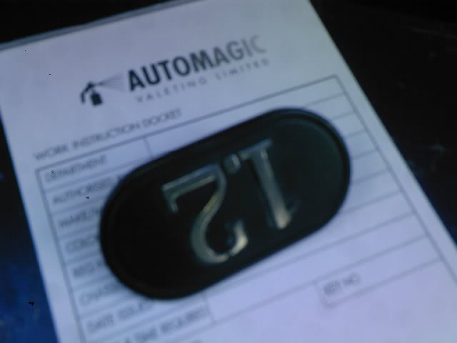

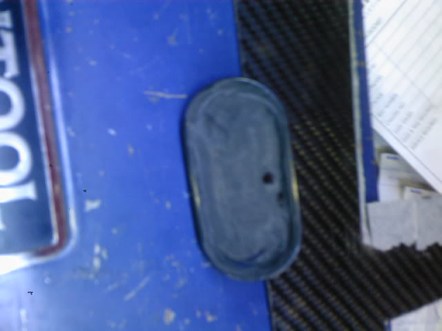

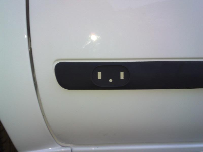

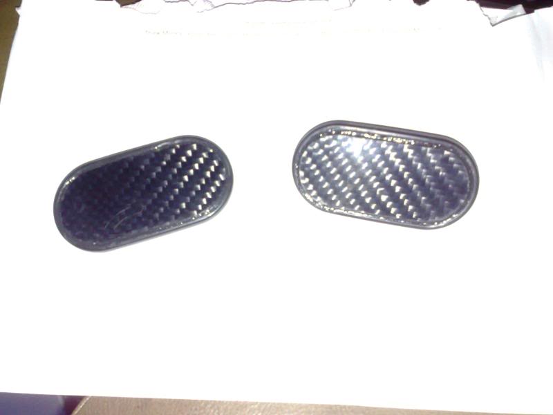

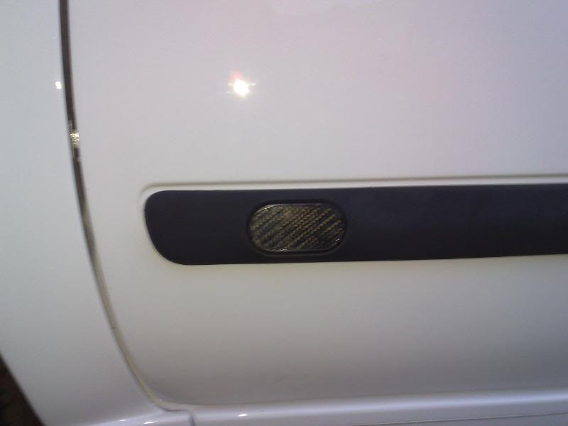

Right!! I've been basically messing about in my lunch breaks and i'm pretty happy with what i've achieved. Basically I started with a set of standard 1.2 door badges.
Then i filed, sanded and ground the centre sections out.

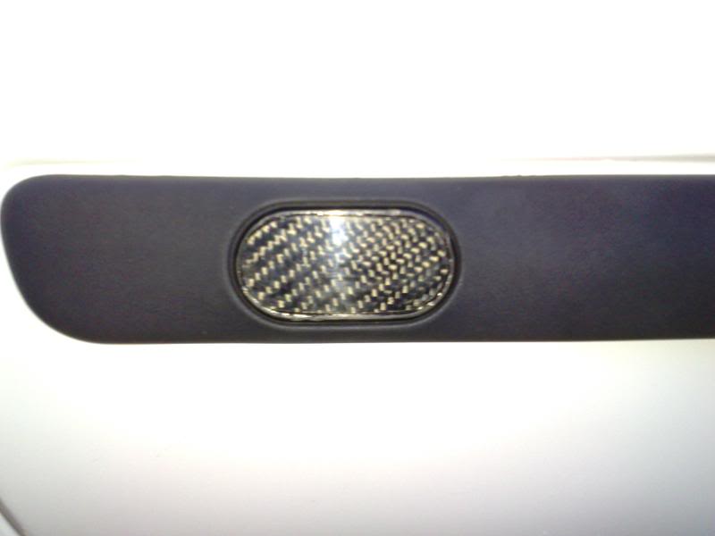

Next I cut a small peice of carbon fibre from some spare i have in my toolbox sanded it into shape and bonded into the recess i'd made. Sounds simple but was a real pain!
Fitted. Chuffed!

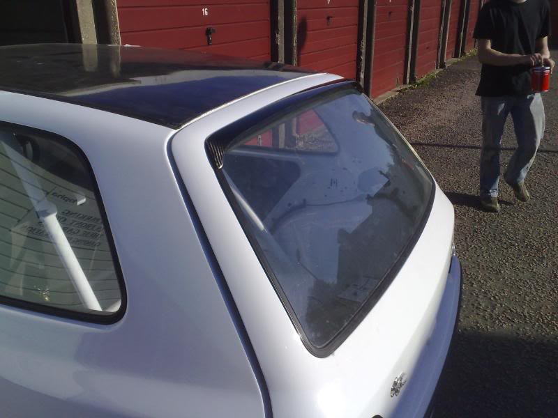

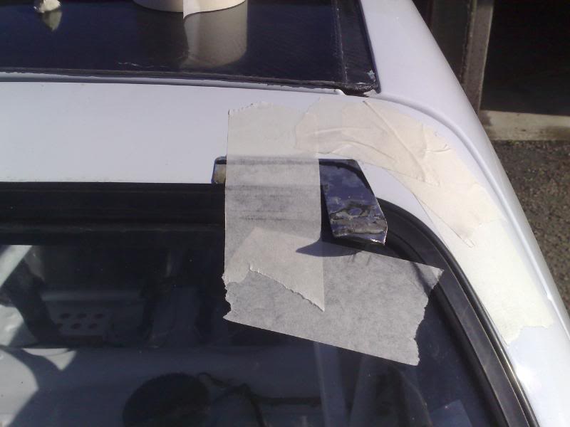

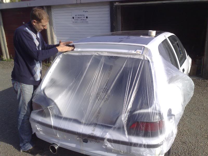

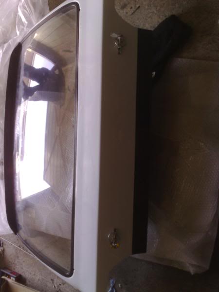

RIGHT! Back again and with a slightly larger update this time. The day started with the tailgate spoiler, stage 1 was to try the brackets on that i made at work in my lunch breaks and adjusting them where neccissary.
Then once we were completely happy with them we drilled the tailgate, gave them a coat of paint and rivted them on with soft ally rivets
With those in place a thin line of screen primer and glue along the inside and on goes the spoiler. With some creative ways of keeping it tight on the tailgate while it goes off.
And an hour or so later the big reveal and it looks very neat.
:cool:

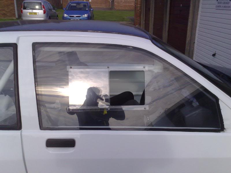

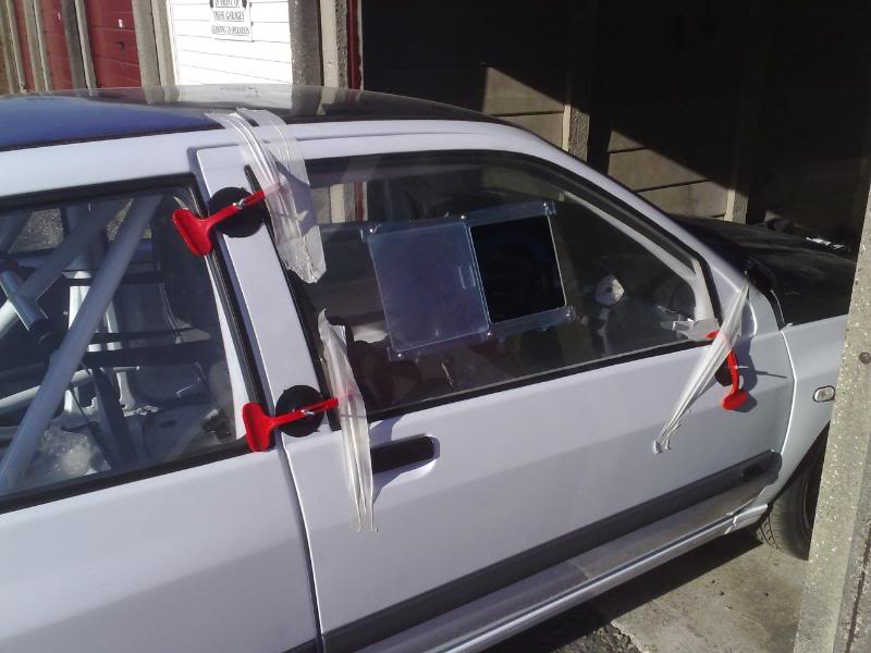

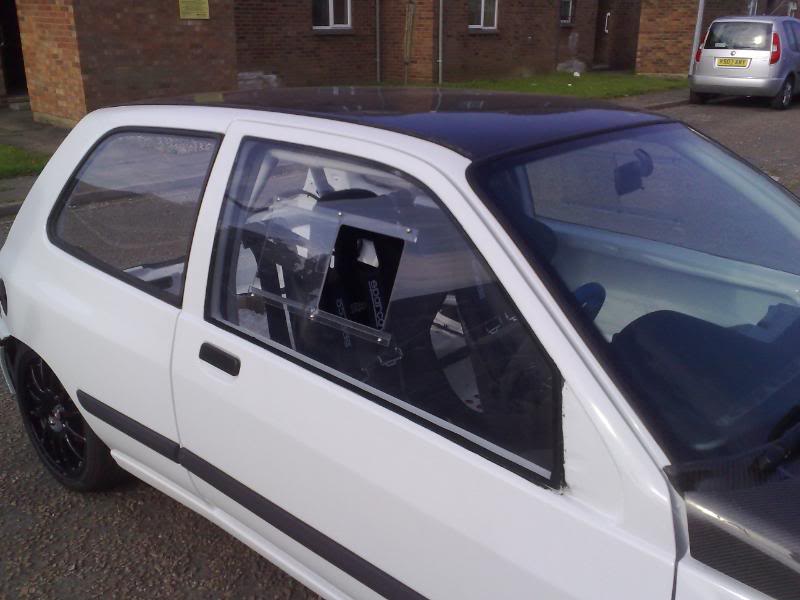

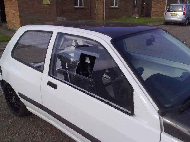

Next job was no fun at all!!!! We had to fit the drivers window which the more eagle eyed amongst you might have noticed we didn't manage last time after a catastrophy ended up with us both covered in glue and a big gap where we wanted the window to be.
So tomorrow we can hopefully whip all the rubbish off and wash our hands of the door glasses once and for all!
Another silly little job out the way but worth doing...
More tomorrow fella's.

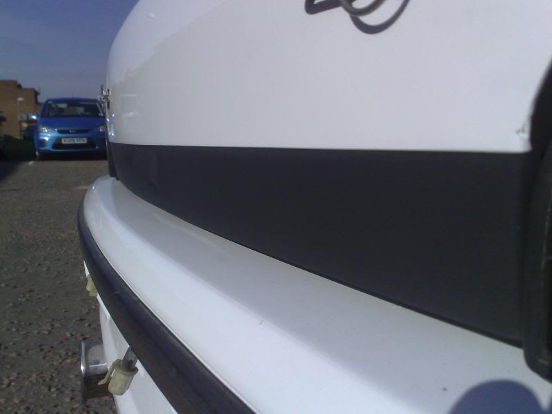

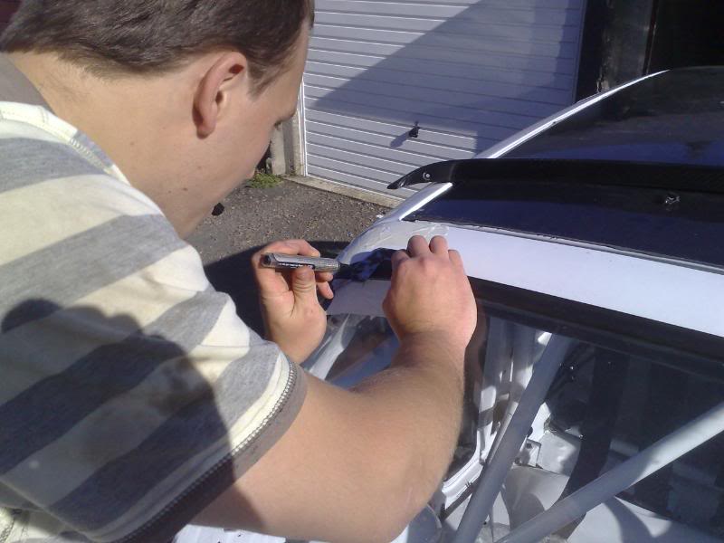

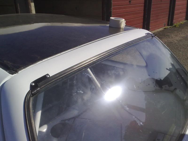

Well today really isn't a massive update purely because there isn't really any massive jobs still to do. We started off by peeling off the tape and suckers off the drivers window which thank god are fitted nicely now.

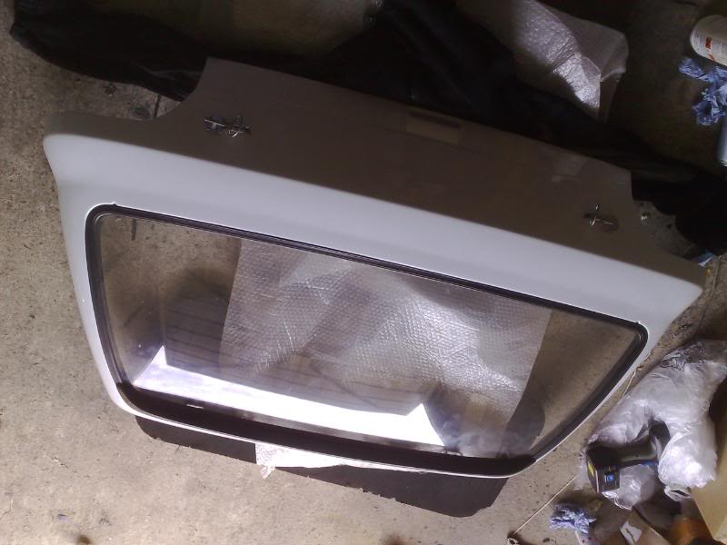

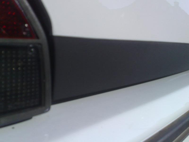

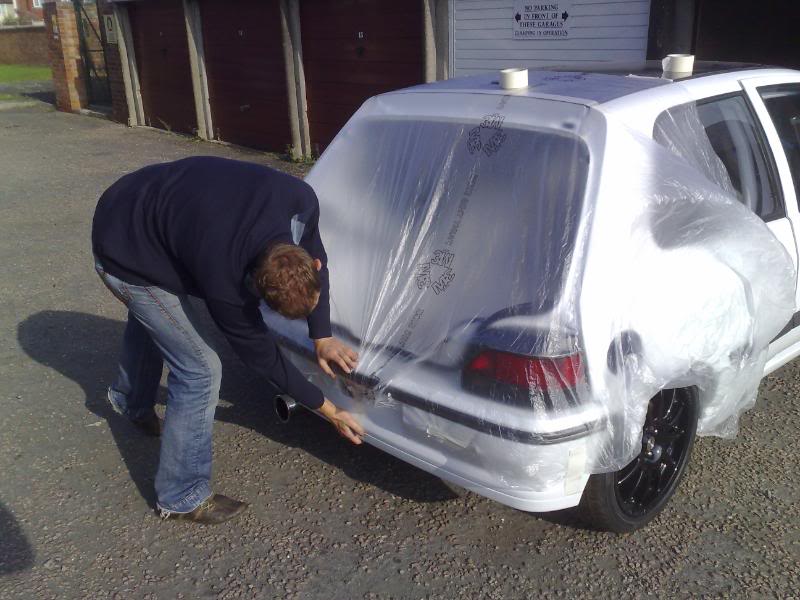

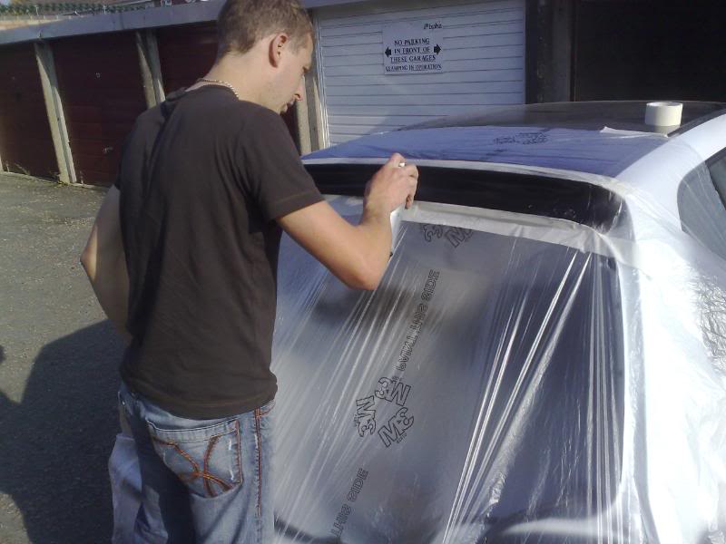

Next we started with a couple of little asthetic jobs which have been on our minds for a while now. First thing to do was remove the tailgate and rubber.
After that we masked up all the areas we didn't want to end up with paint on which was most of the car lol
Quick scotch brite and a nice even coat of satin black. JOB DONE!

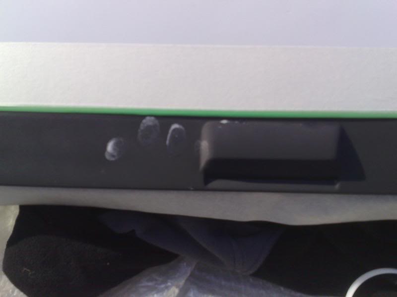

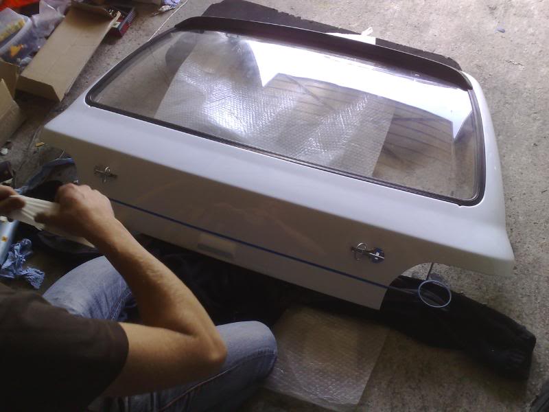

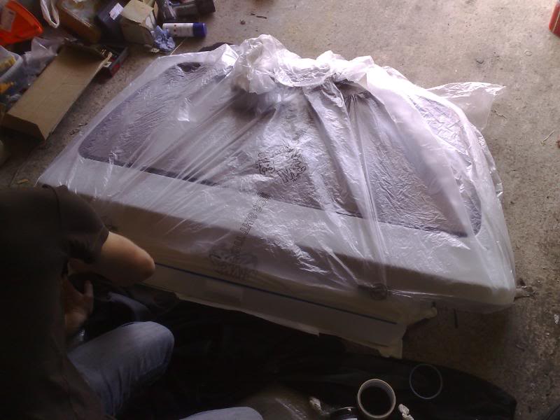

Next thing we did was, while the tailgate was off, was to texture the bottom edge of the tailgate to really finish the rear of the car.

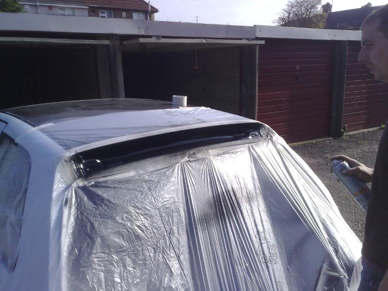

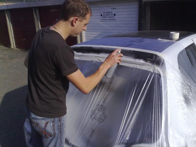

We masked everything up.
Scotched it, painted it,
Then promptly found out it wasn't dry and ruined it :mad:
Round 2 went much better and we got the tailgate on

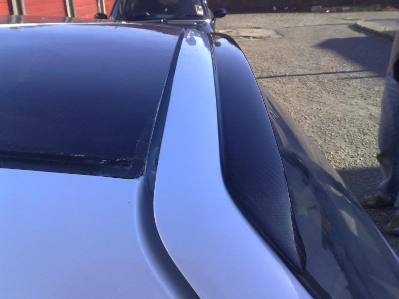

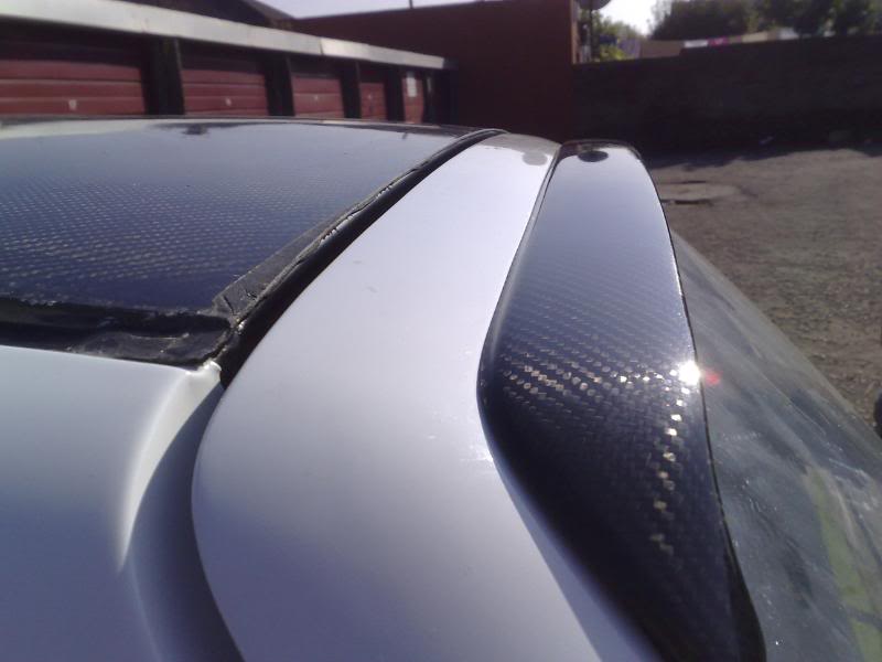

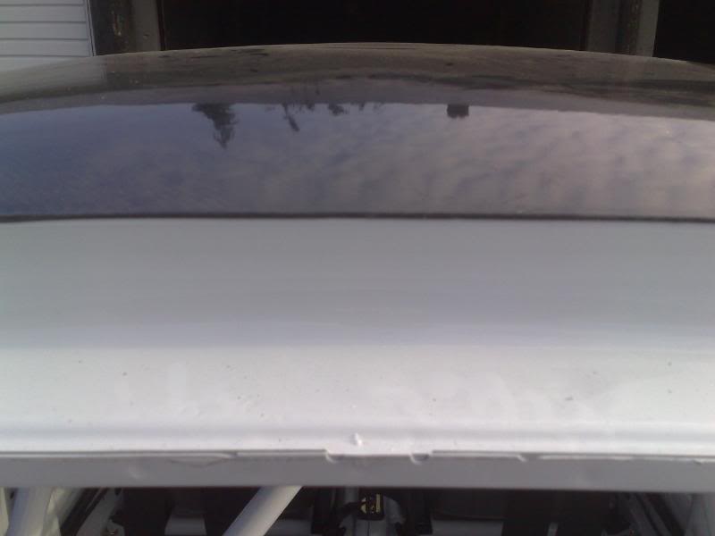

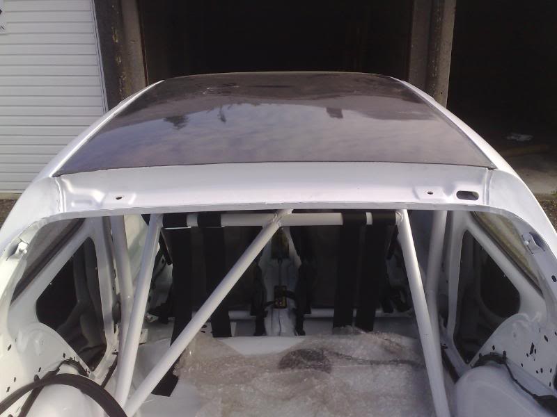

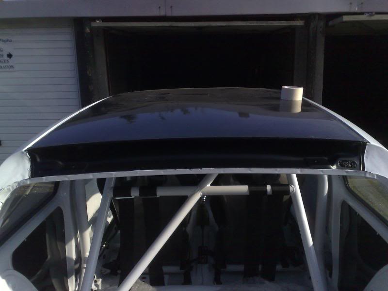

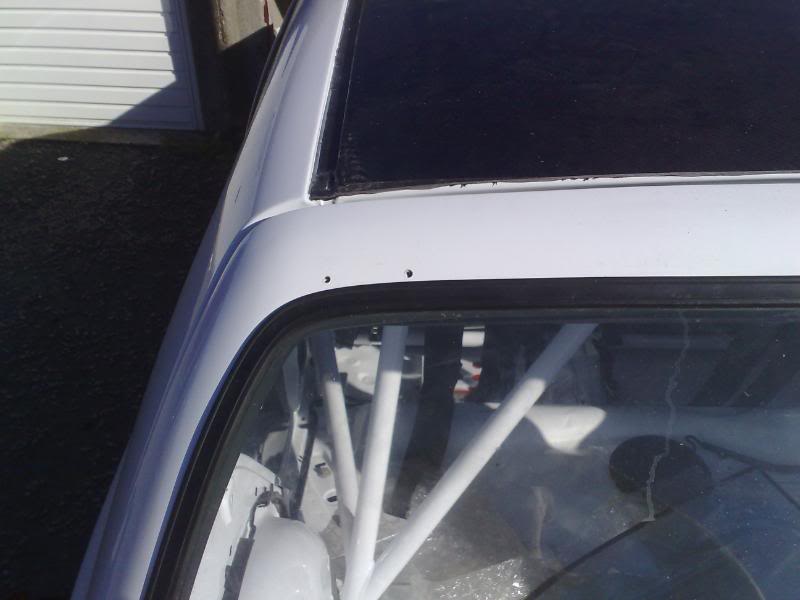

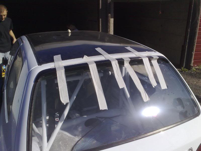

Just to give you an idea of why we painted the back of the roof here is a before and after.
Before
After
Not the best pictures but you get the idea.

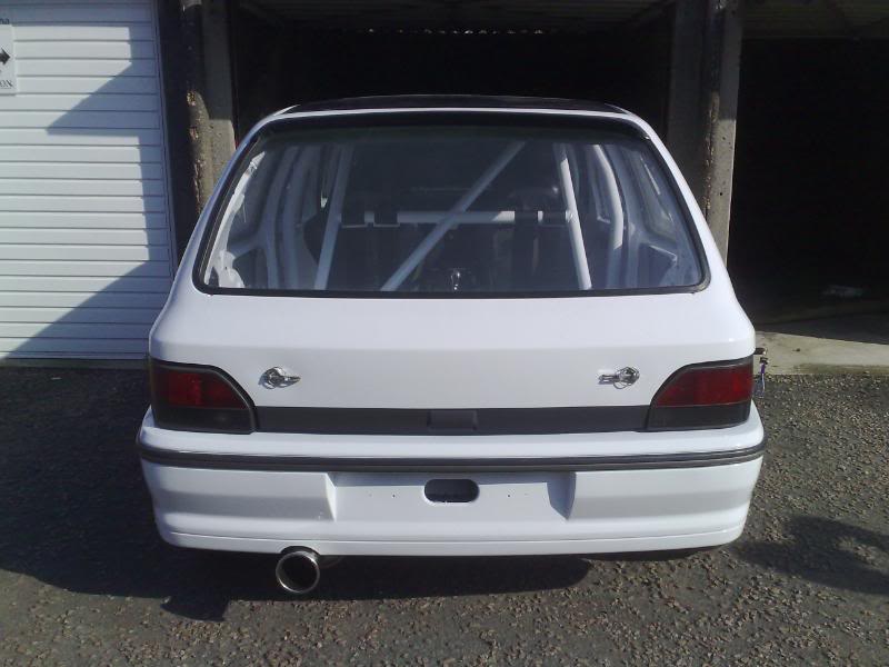

had a nosey at this today absolutly stunning really nice factory fit and feel about it really tidy job guys good wrk ! got me and the old man thinking about them doors stupidly light compared to steel doors

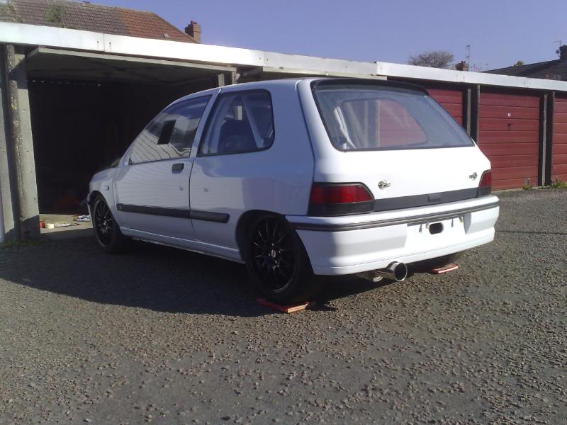

PMSL!!! Didn't think it'd be long before someone noticed but i thought I'd wait until someone did. Basically the rear wheels are on a pair of haynes manuals as a very unscientific way of working out our ride height issue. The rear is definately 1 haynes manual (20mm ish) lower than the front so we'll be dropping the front another 20mm rather than raise the rear.
Cheers for coming down today wayne it was great to show you round the car, think when it's on the road i'll pop up and take alook around your secret car laboritory LOL.
