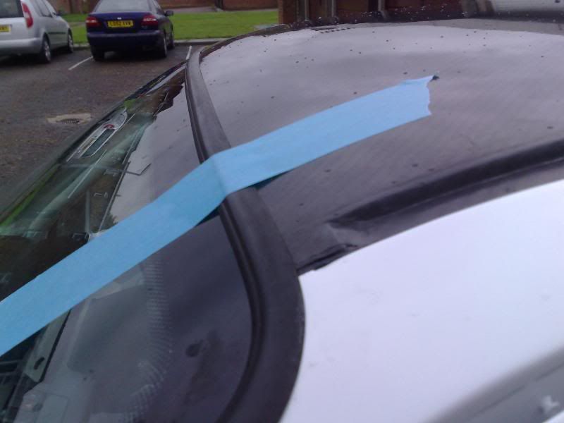

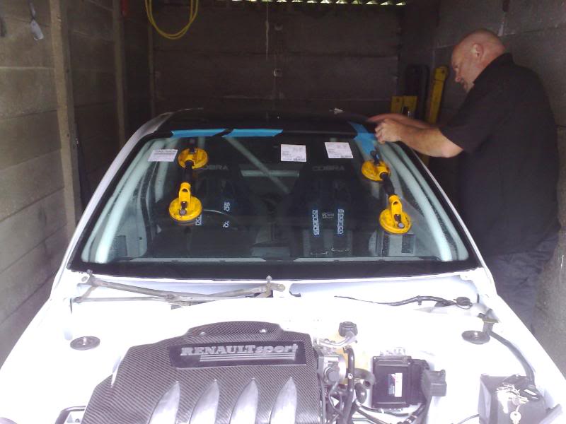

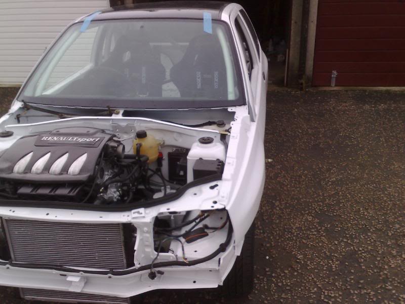

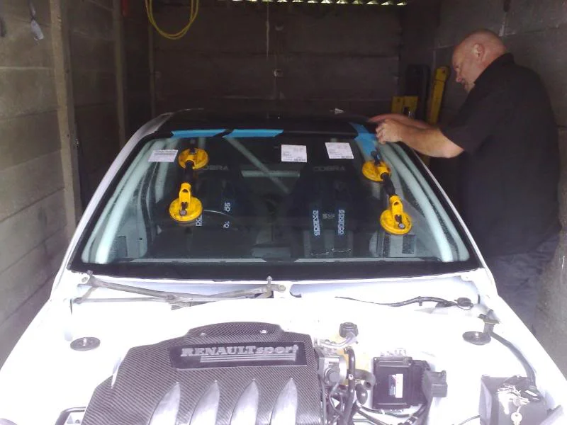

Back again although feeling a bit battered and bruised as today proved to be a bit of a battle to be honest. It started off pretty well really as we spotted a ph3 in a breakers yard when traveling back from Moo's flat that had the window rubber we needed in it. so a fiver got us that and brought the Clio one step closer to being water tight. Then when we got to the garage we got a phone call from the screen fitter to say he's only 5 mins away. BONUS!

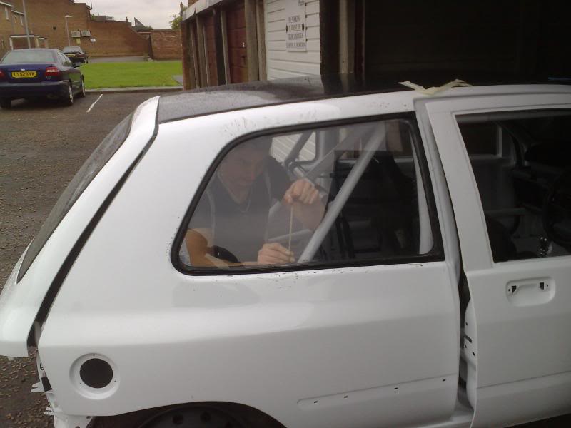

Once that was in and we'd fitted the other quarter glass things stopped being so fun.

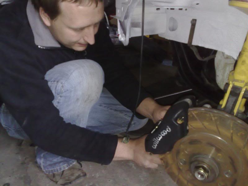

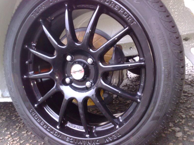

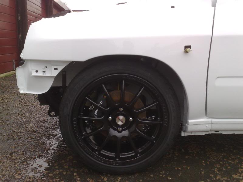

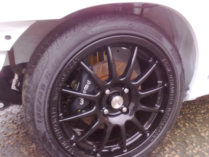

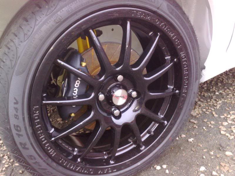

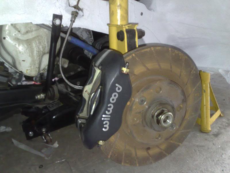

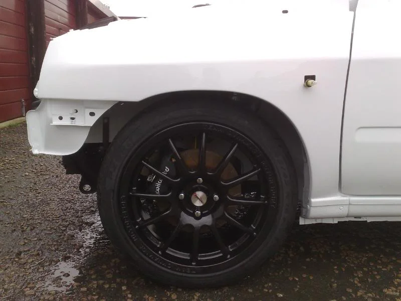

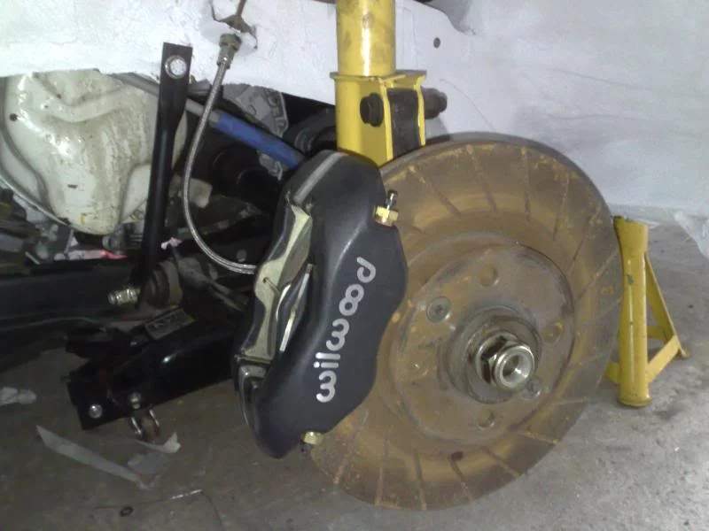

We begun fitting the willwood's which first of all the caliper bracket bolts were too long and fouled the disc. So we sanded those back only to find the Knuckles foul the caliper a little. More sanding and filing. Then once we fitted them for the last time we found the wheels don't clear them so we had to dash to halfords and grab some 3mm spacers! LUNCH was in order!!!
Once lunch was done we fitted the wheels with the spacers no problems and rolled the car out the garage to have a look.

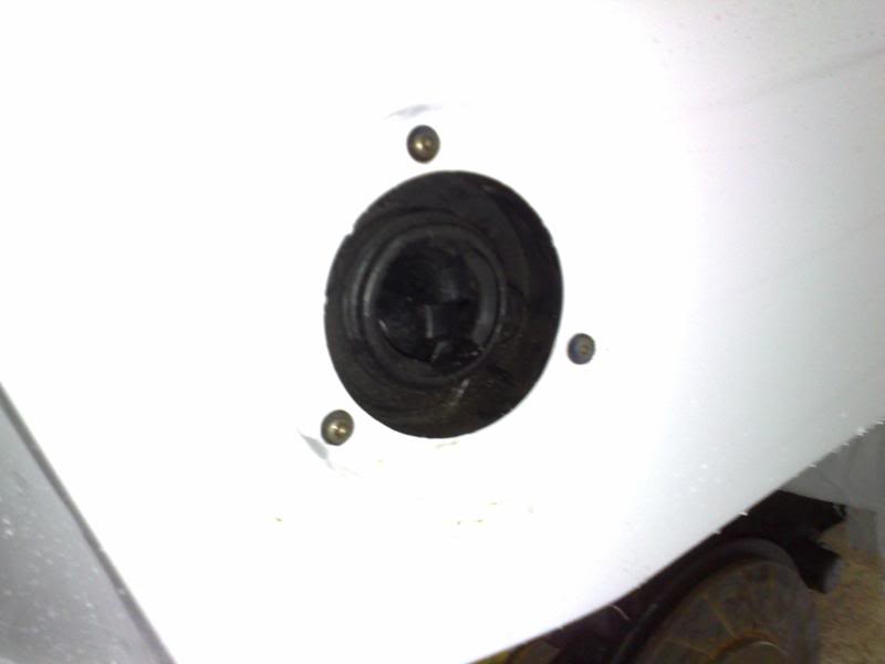

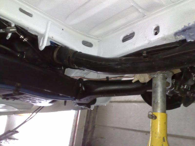

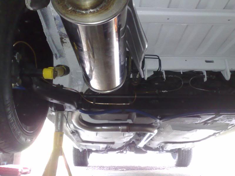

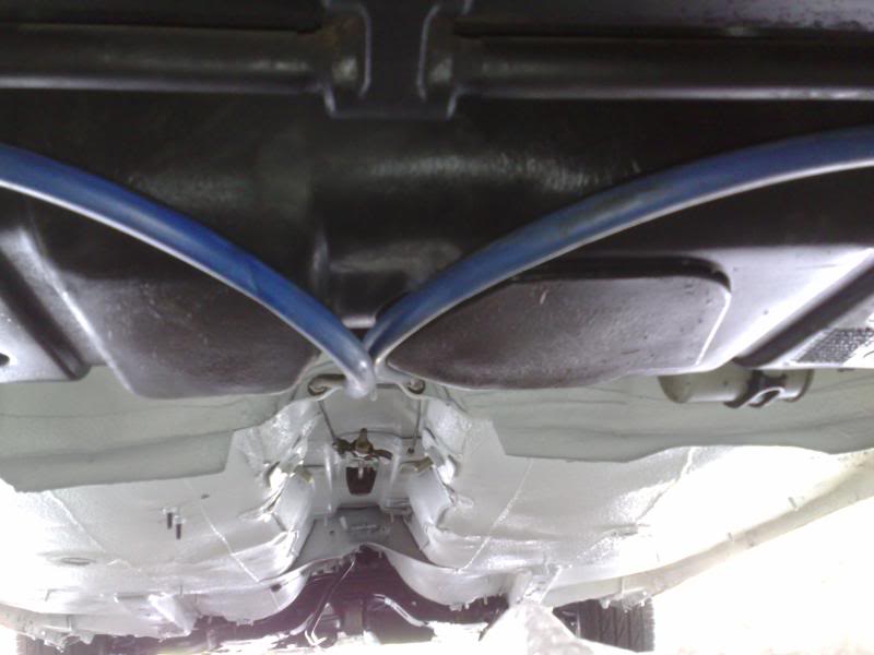

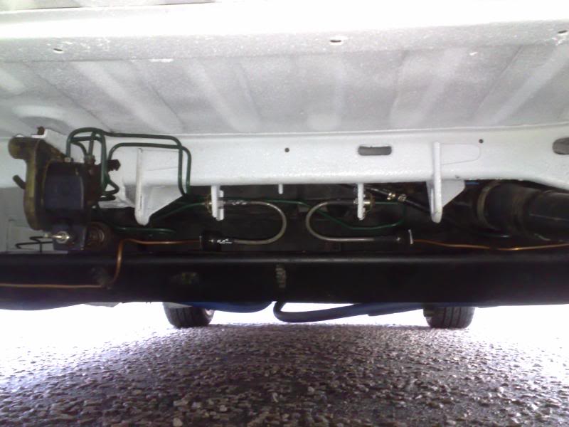

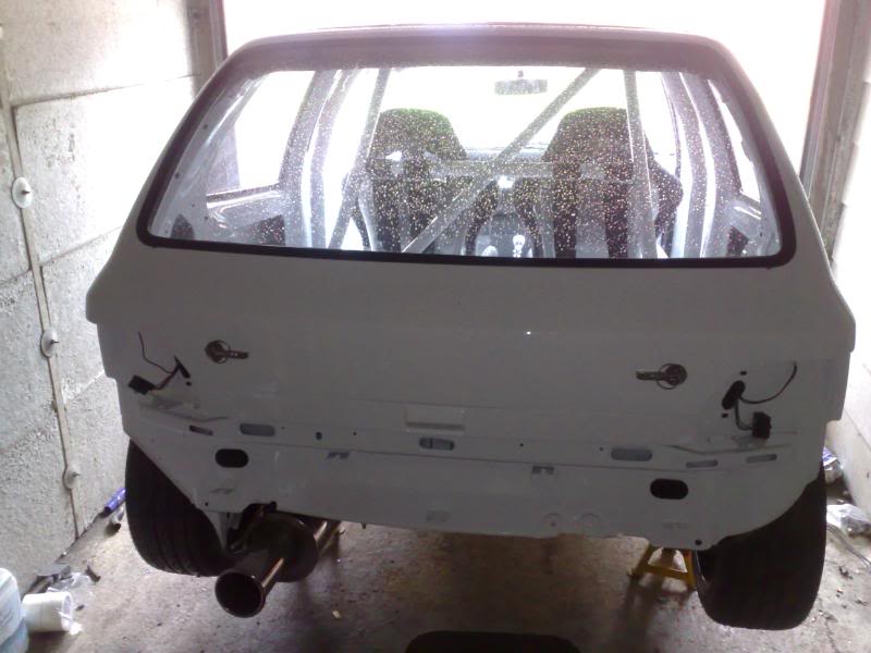

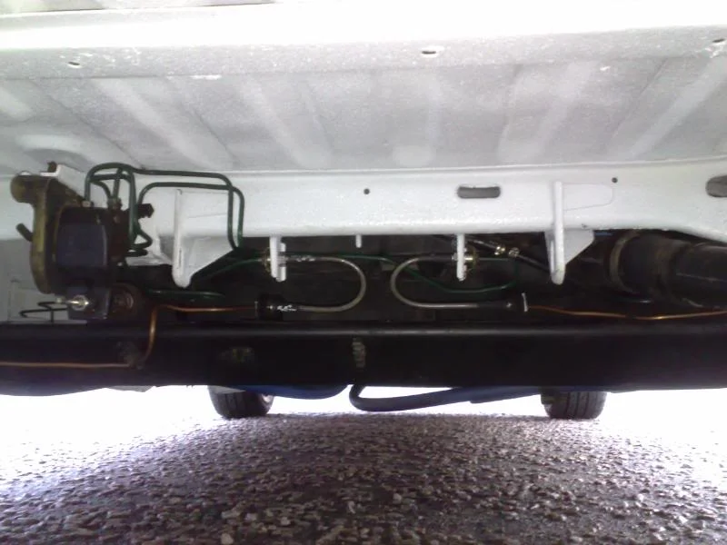

Next task to get done was the underside rear really. First thing was we lined up out 3 filler necks, 2 aux tanks and 2 main tanks to see what had to be done to convert to a phase 2 tank with no aux.
Once we'd worked out what we needed and what we didn't we boltd our new tank and filler neck in with no problems.

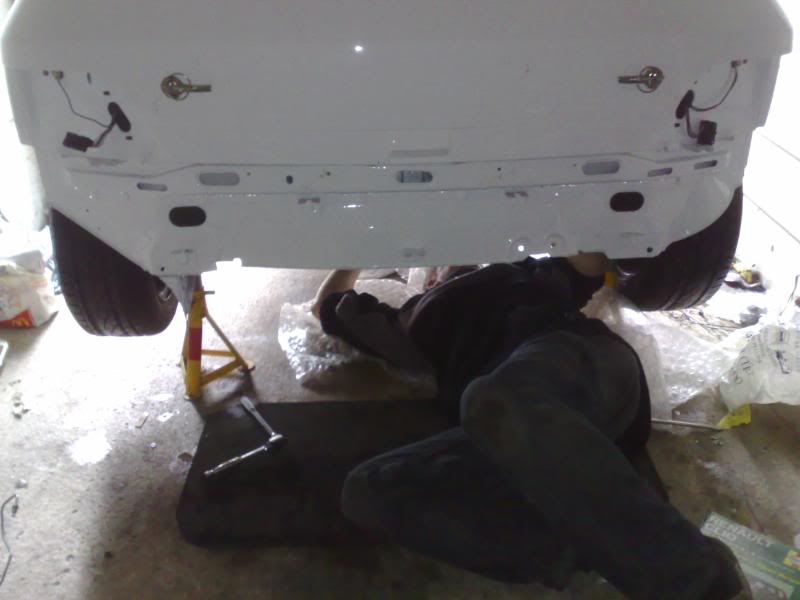

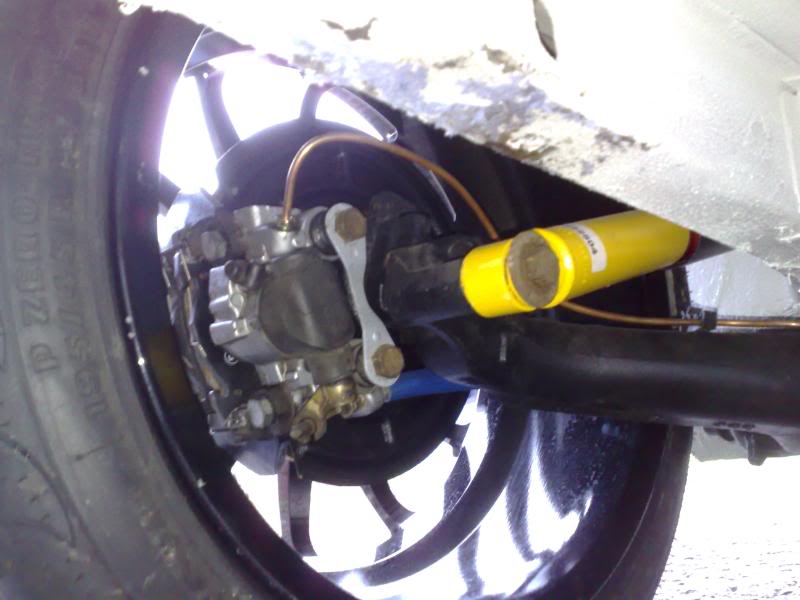

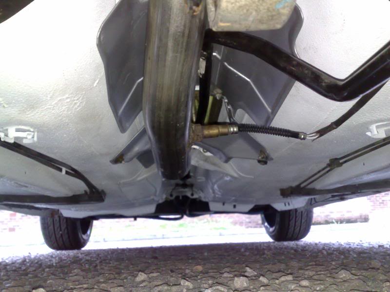

While we were under the rear we also decided it was time to get the rear brakes done.
We fitted the pads, connected up the hand brake, fitted the brake load valve and front-back brake lines.

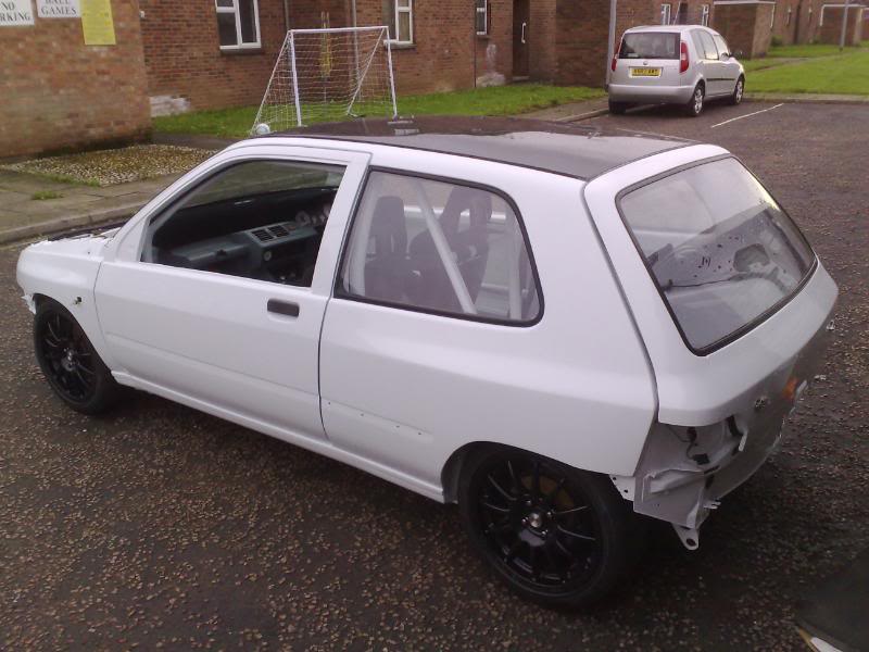

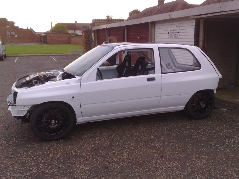

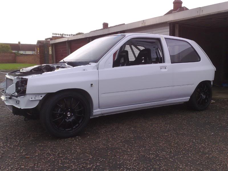

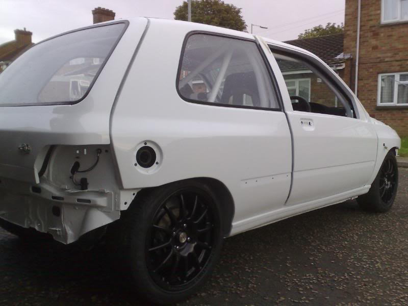

With all this looking neat and tidy ready for bleeding (which I think has a good chance of taking up most of tomorrow), so we decided to fit the rear wheels. Here we found that the hub nut cap on the rear hubs fouled the wheels so they had to be removed. Now it was safely down on wheels so we rolled it outside and took a couple of pics.

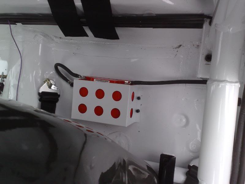

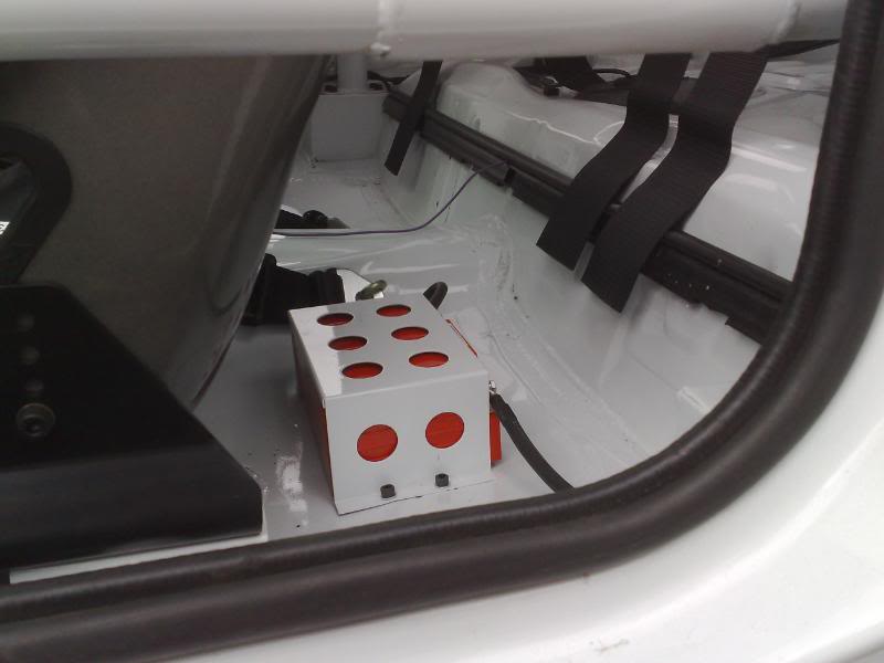

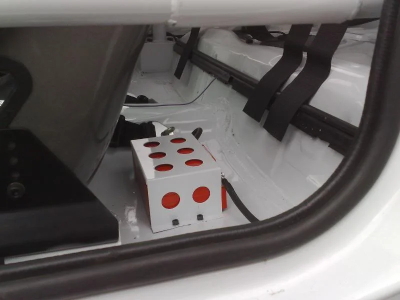

We made to battery cables to route front to back for the battery relocation, we still need a couple of connectors to complete it fully but the car is now showing signs of life.

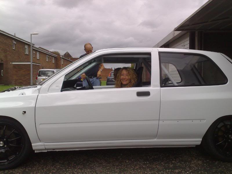

OH GOD.
Please tell me that isn't one of your mums....
SUPERB work by the way... Top class project. I love it. x
  Golf GTi Mk2
Hah, beans mum in car, beanie in driver seat, beanie dad in background.
Btw, i strategically parked my car on friday so it appeared in the background of your pics!! you photoshopped it out or something? hah

The car is superb lads, are you gonna run the fuel lines inside the car??

fellas. Can I ask about your brake system?
They look like willwood dynalites to me - are they?
Is that a standard size valver disc?
Who did your caliper adapters - did you get them machined yourself from blanks?
LOVE your project.
  Some of a Clio 1.8 16v
Lol, you lot are a nightmare!!!
Point8 the brakes are standard size and they are indeed dynalites too. They were bought off someone who bought them with all the brackets in a group buy. There's another one of the same setup being put together as we speak over on williams clio the fella called Tony16v is who you need to speak to.

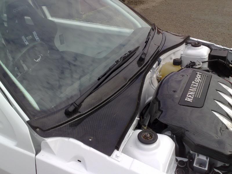

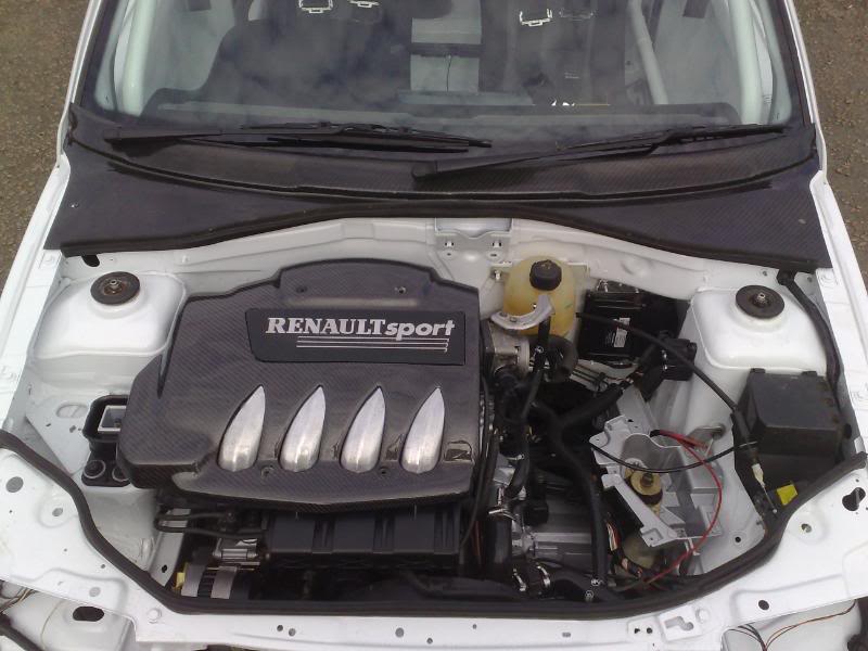

The first thing we did was we finally got round to drilling and bolting on our carbon fibre scuttle panel (still not sure about washer jets).
You can't deny the outcome though, its lush!

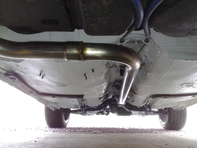

After that we tidyed up and fitted the exhaust heat shields and fitted the front section of exhaust. We can't do the centre section for the moment, but that'll be on soon, postman dependent. As you can see (minivalver) the fuel lines are standard and staying under the car.

We managed to bleed the brake with relative ease which was nice, which ment we could then adjust the park brake and then fit the rest of the exhaust.
The backbox looks MASSIVE but once the bumper is on it should be ok.
