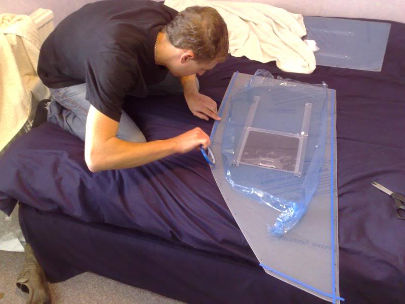

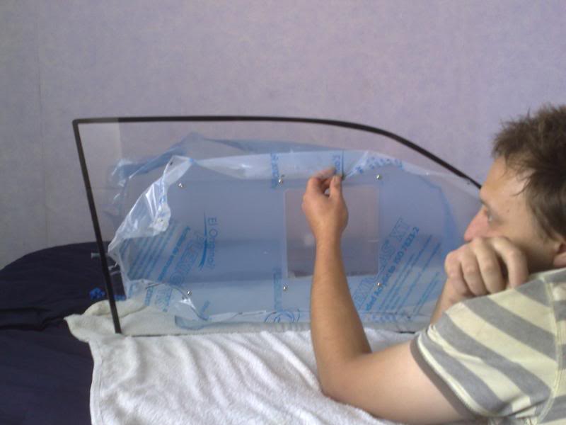

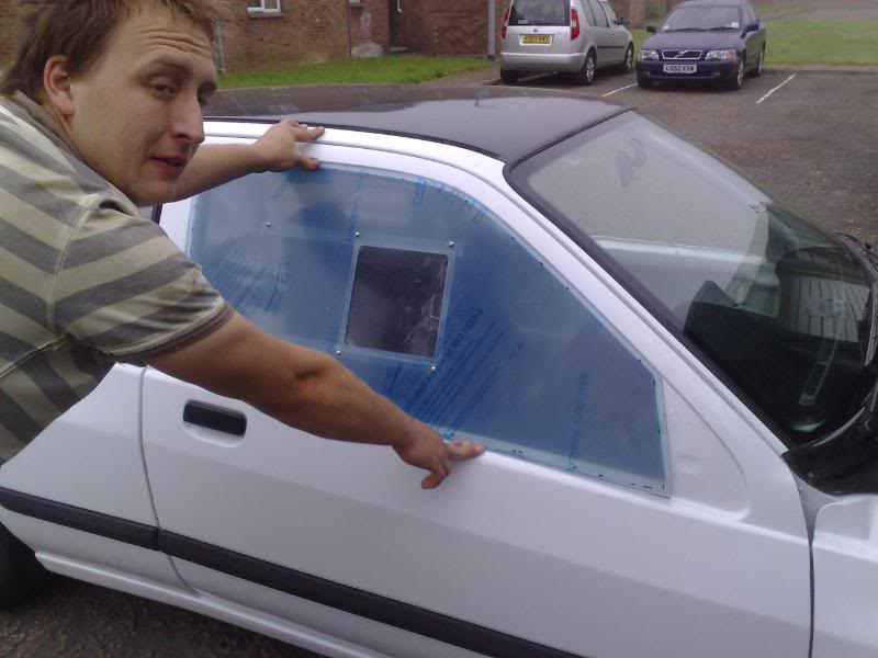

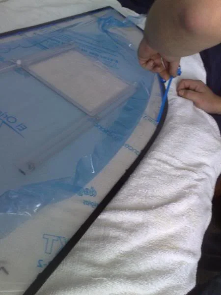

Hi there everyone we're back again, sorry if we've not answered any questions at the mo but it's been a mad old week. This weekend we started off with the door glasses, sounds simple enough but i found ways to over complicate the whole affair. First off I had to cut down the standard plastic windows.

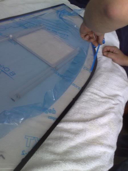

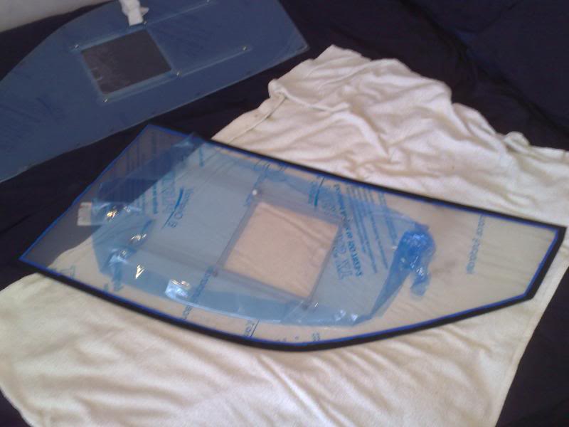

Next, since we're bonding them to the surface of the doors i needed to put a black boorder on the windows so i sourced some window etch primer and some fine lining tape and got artistic Lol.

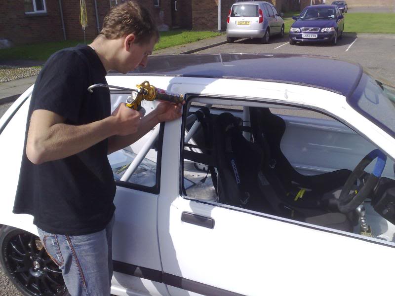

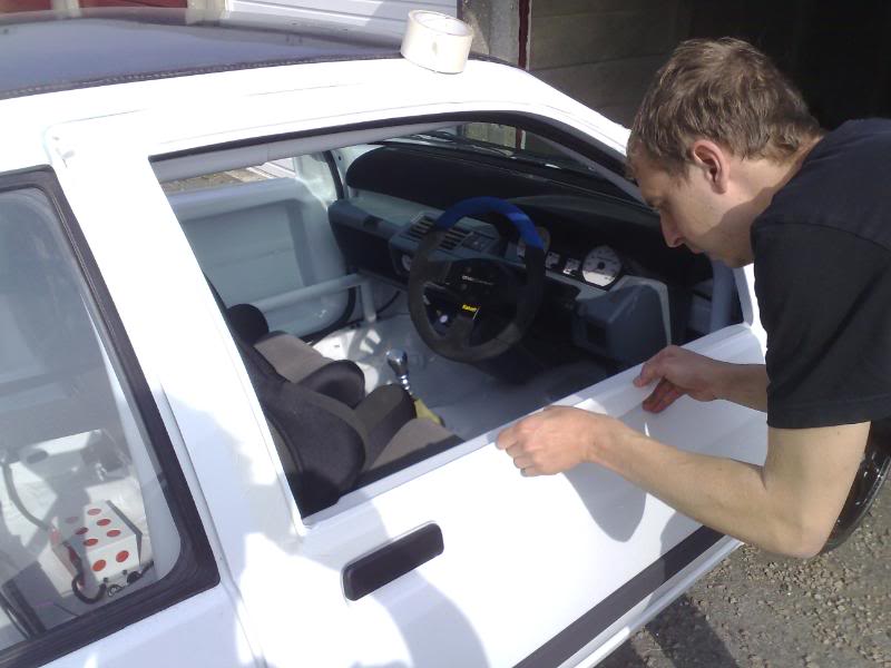

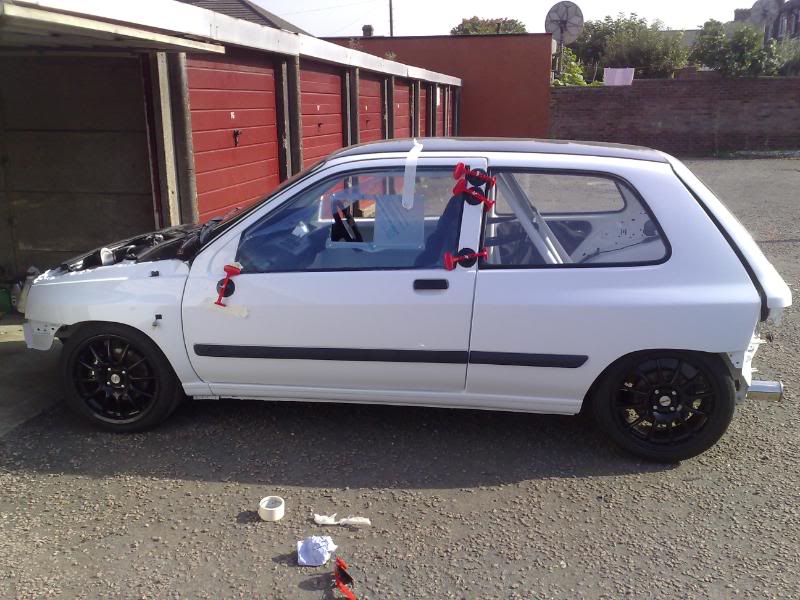

With that done we headed for the garage and mask up everything we didn't want the glue covering (although that turned out to be pretty much in vein).

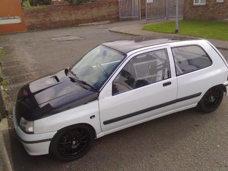

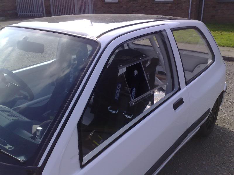

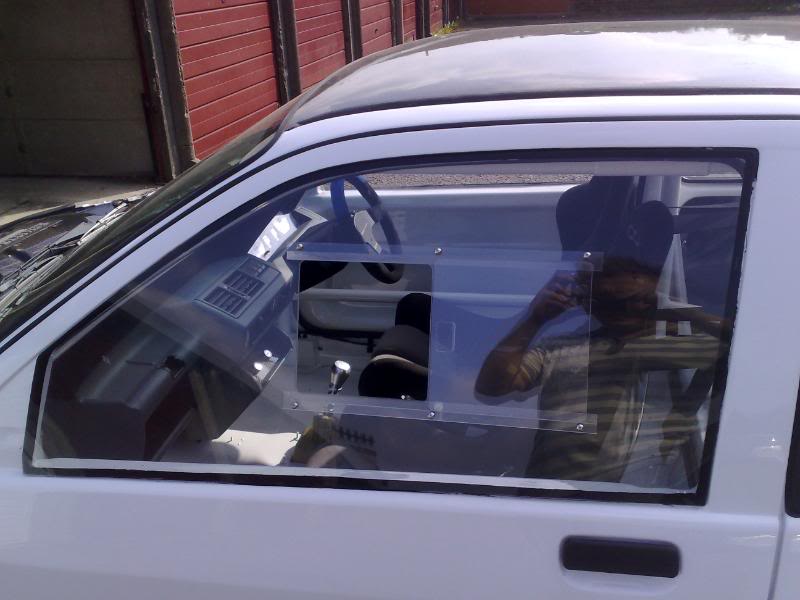

And in goes the window...

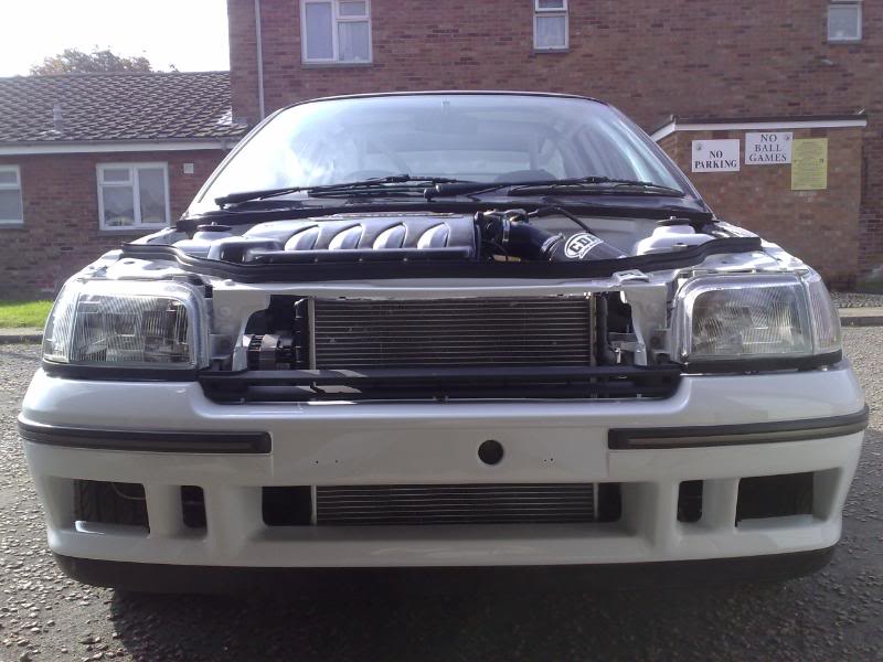

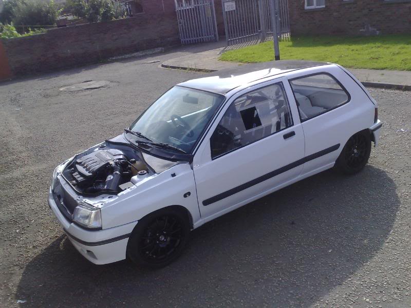

With that drying nicely in the supprisingly hot sun we turned our attentions to the bumpers etc which took a lot of messing about to get the gaps anywhere near but it was worth it I think.

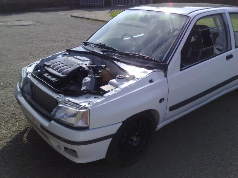

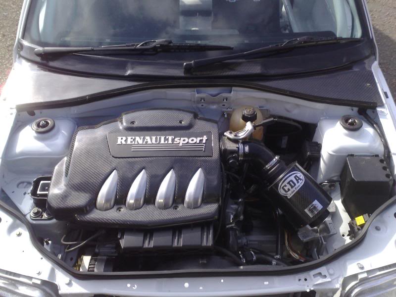

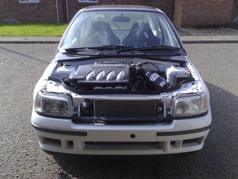

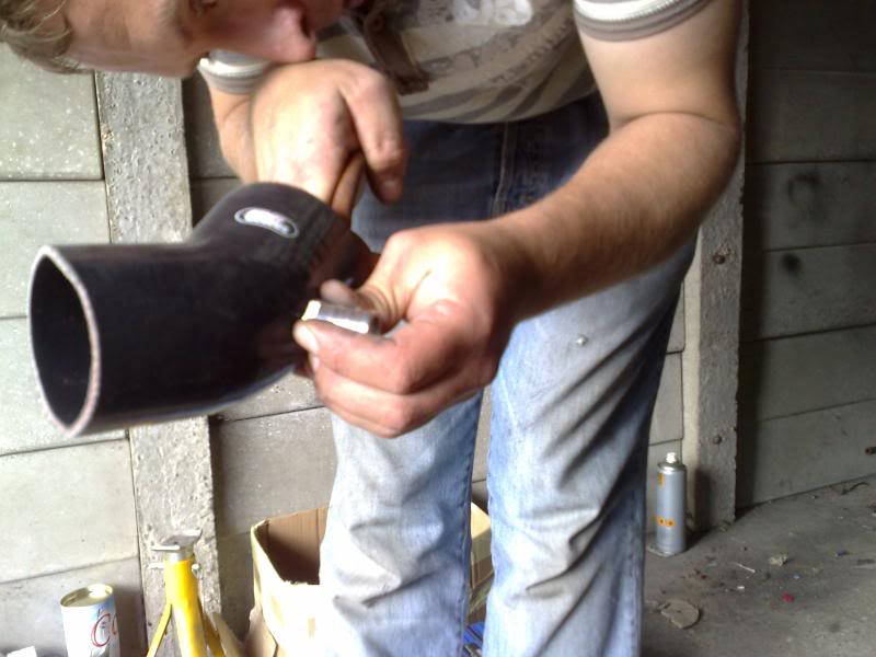

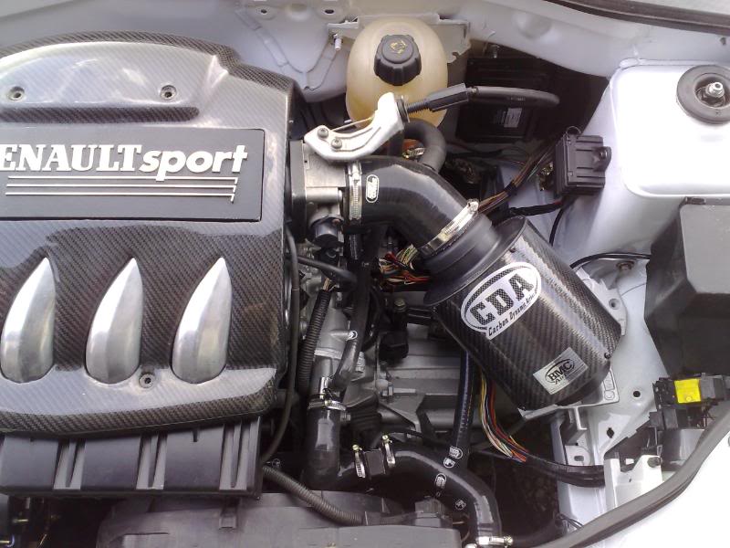

Now the car is looking scary complete we've set about fitting the air filter now that our hose has arrived.

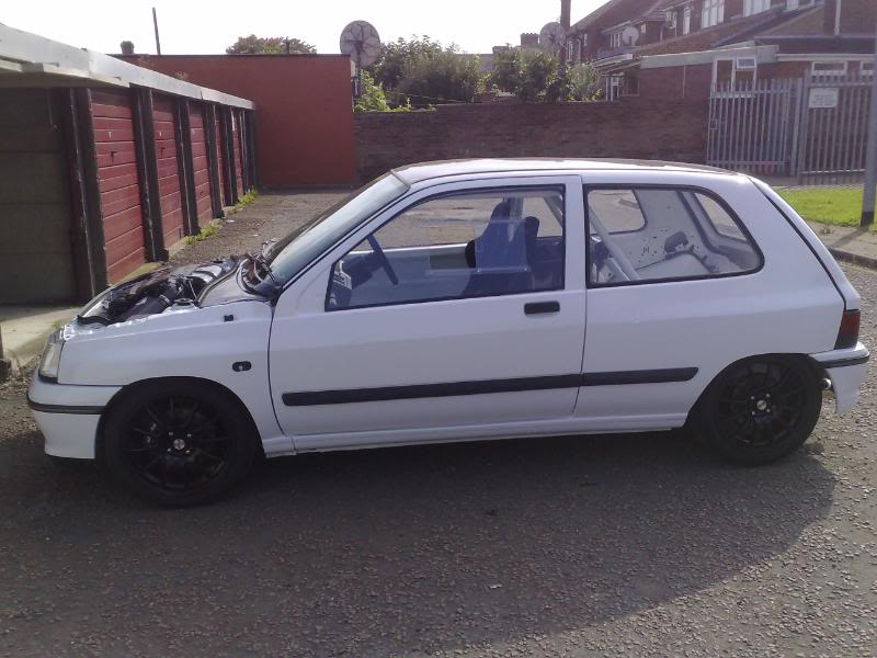

Well we've been down the garage again and made a very small step forward.
First thing we did was finished fitting the air filter, still needs properly restraining, but now the idle air control is now piped up

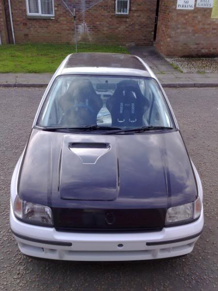

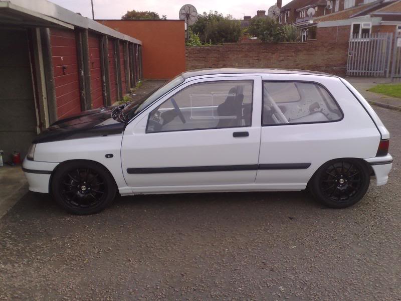

Next we got the bonnet down the garage which was quite difficult since the nissan ran out of MOT.
We painted and fitted the hinges and marked out where we need to cut to get the bonnet to shut, but thats a job for another day, but its looking almost there now but there is still a lot of little problems to sort.

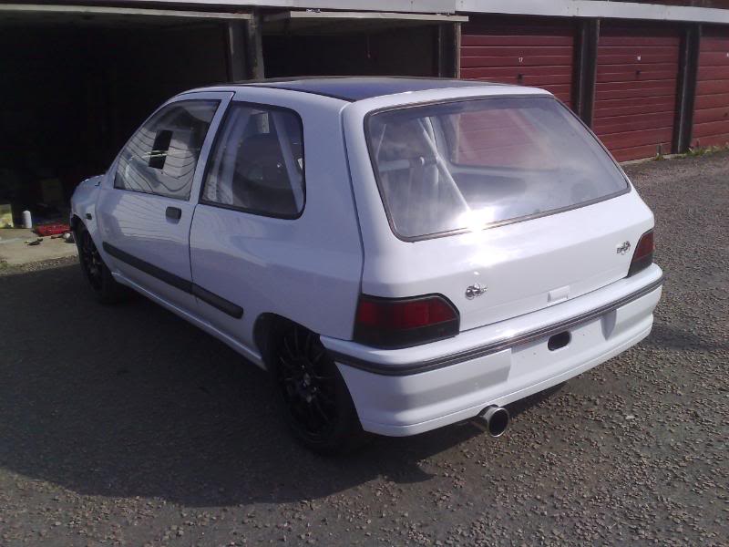

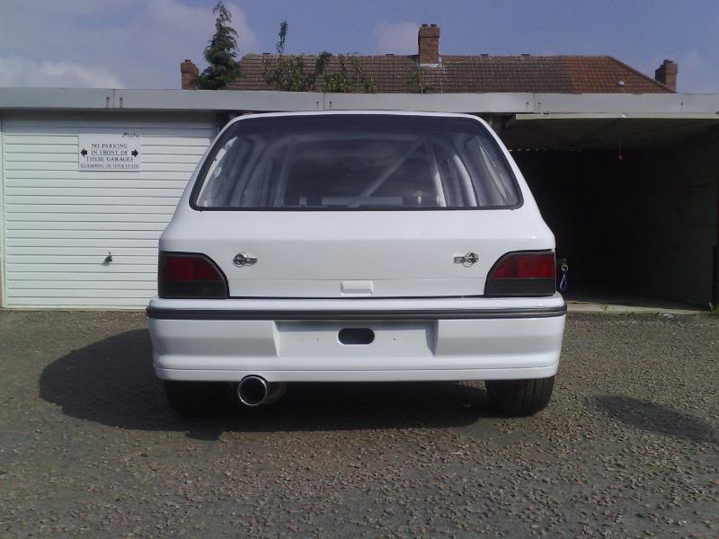

the rear looks really squashed and more narrow than it should do. :S
windows look good though!

looking better and better... no plans to take this model into production then lol? (oh how we all wish renault would take lessons from you guys). for some reason i agree with the raise the back slightly comment though...
all in all something to be very proud of

Cheers fella's for all the nice comments. We know about the ride height but we're still a little undecided about what to do about it, the car was lowered by 50mm when we bought it (many moons ago) but we could only find 35mm springs at the time. I'm tempted to sell those and drop the front more now i know where to get them from but Moo's not sure if it might be better to raise the rear instead.
Don't know about the rear track though, it's a standard valver rear beam and the wheels have the right offset so:S

I dont want to say it but that looks sick! Those back wheels look very nice under those arches:D
