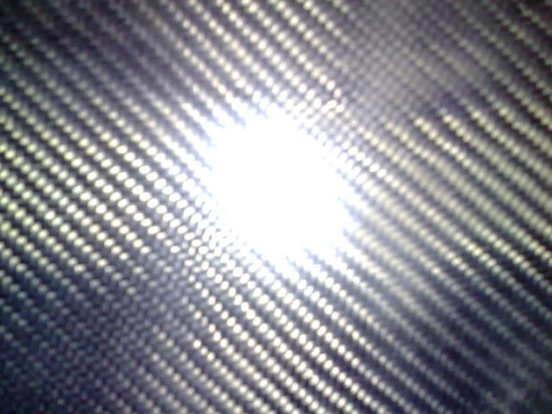

This may look like a humble grey rectangle but if you look closely you'll see some carbon fibre weave!

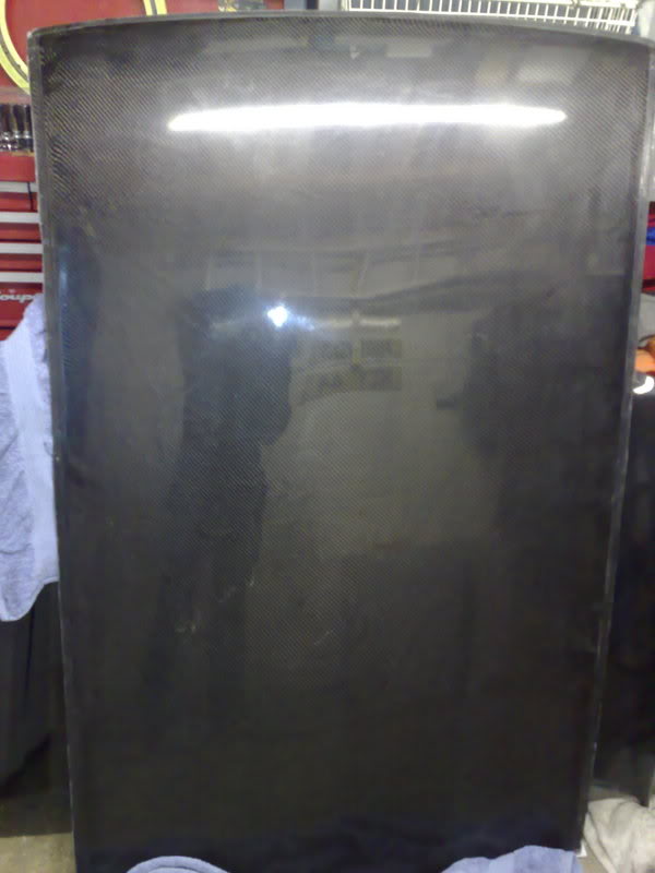

The carbon fibre roof skin is here!
Many thanks to the brilliant services of Mervyn Griffiths at Streamline carbon. (www.streamlinecarbon.com) for making the mould, roof skin and delivering it for a great price!
He chose this weave to match the weave used on the K tec bonnet! This bloke seriously knew what he was doing!
Also we have been given the mould so if anyone wants one we may be able to make a few more dependent on demand!

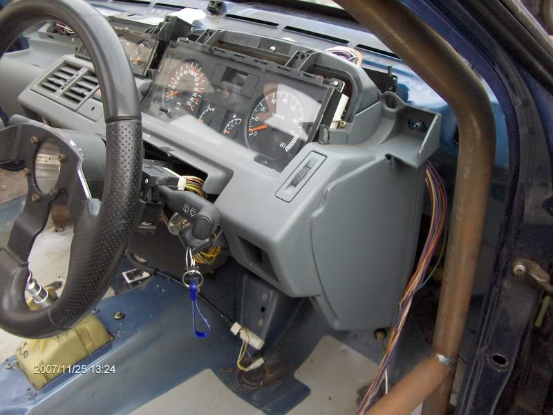

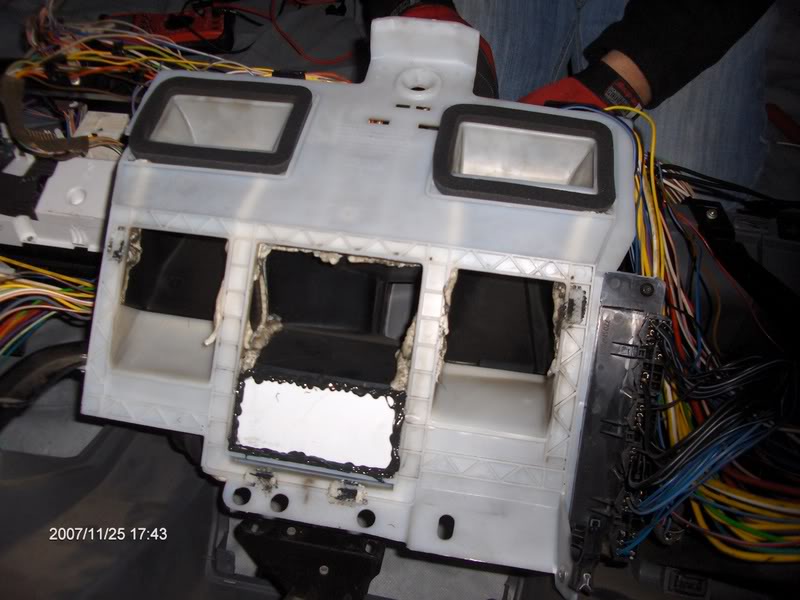

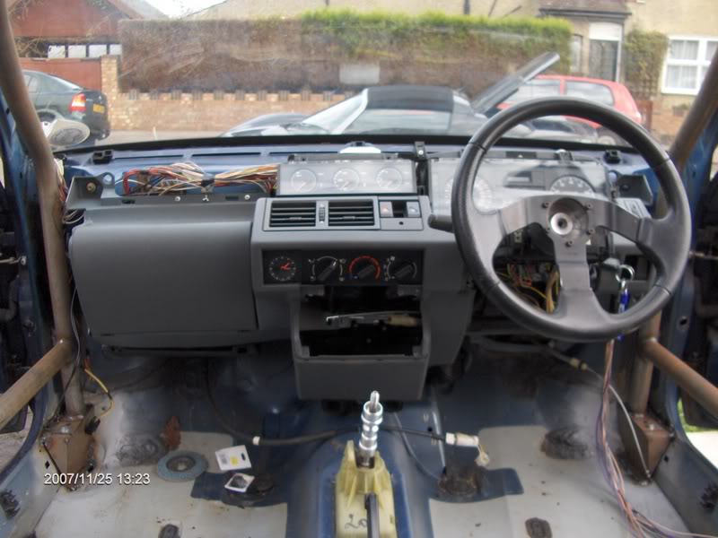

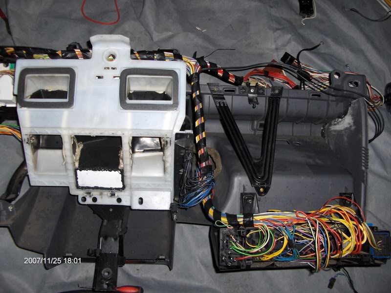

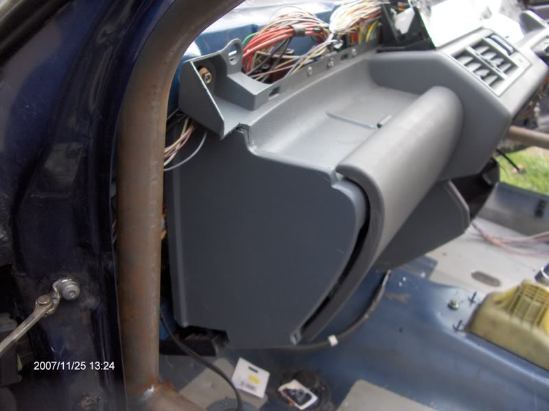

First thing was, we needed to shorten the dash to accomodate the weld in roll cage, so after about 5 hours of cutting, plateing, glueing and fillering the dash and blanking off the side vent outlet! We ended up with this which I'm rather proud of!

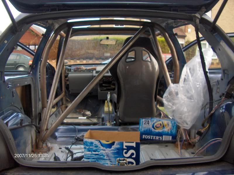

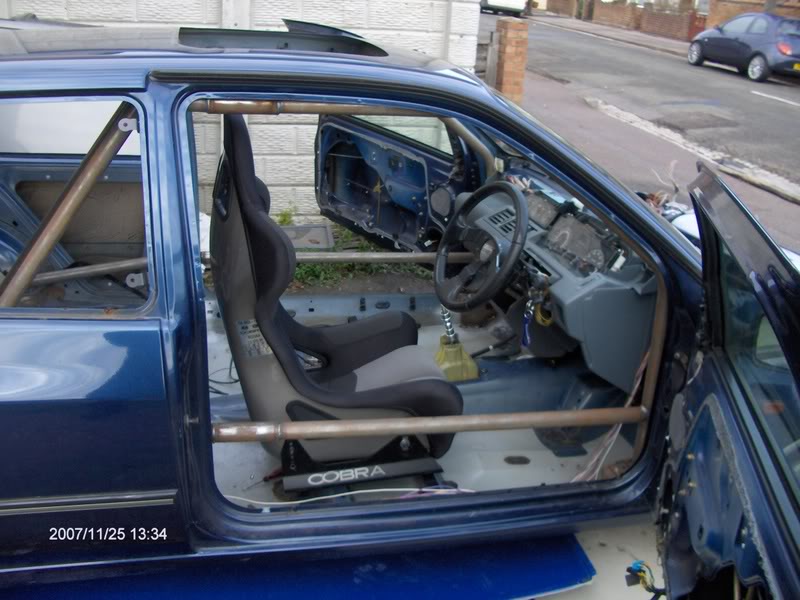

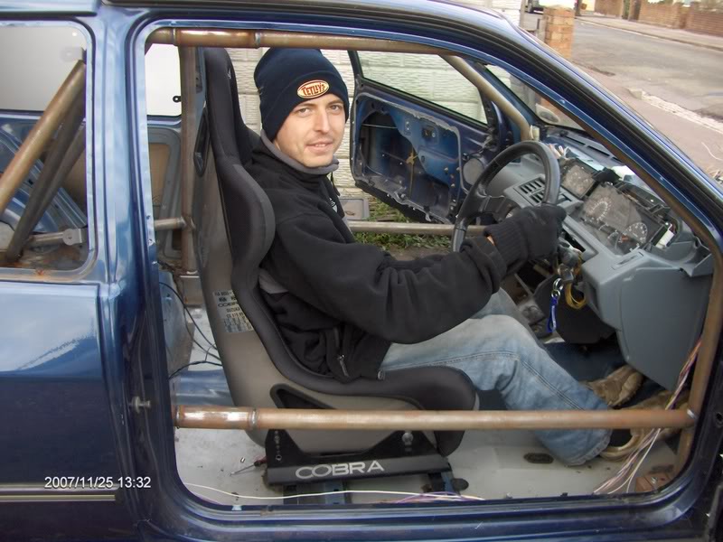

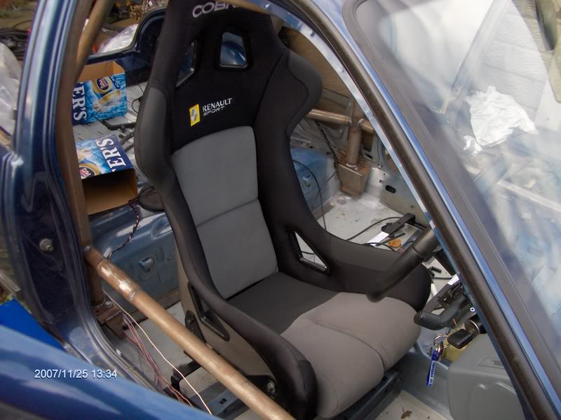

With the dash trial fitted to see how it looks and make sure everything still works, we decided to see how the the seats fit and look. The answer is they need to be lowered on the mounts but they do look and feel awesome!

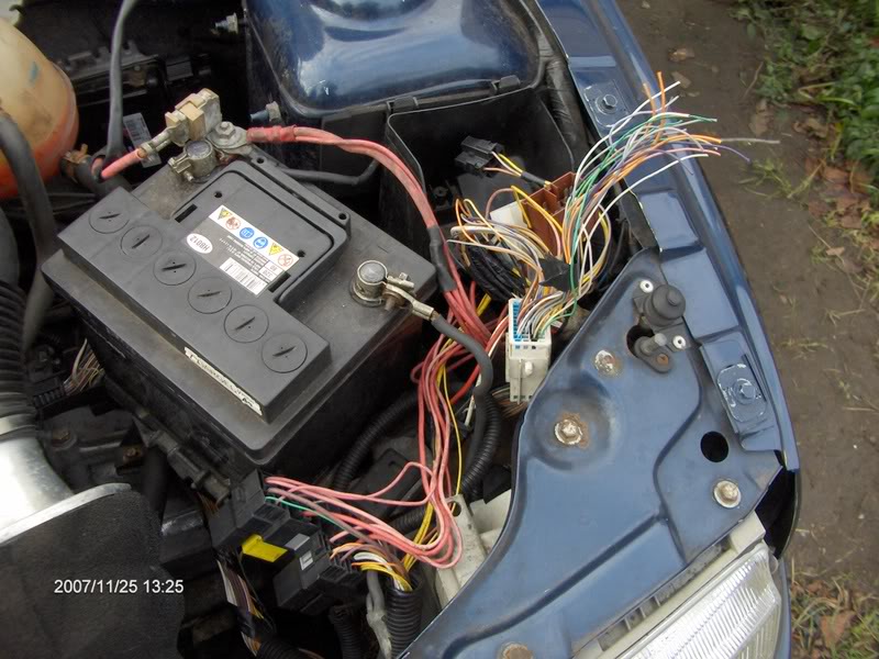

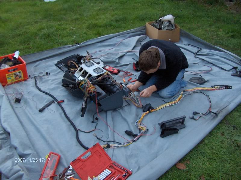

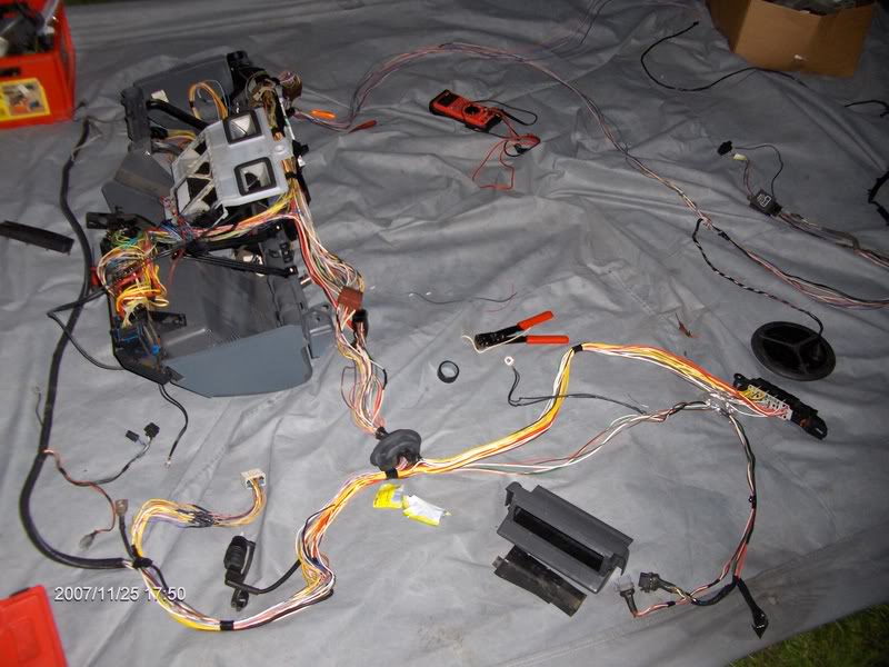

Now we know how everything fits and works (2 fuel pumps had us scratching our heads!) we decided it was time to tidy up the wiring to make the conversion look as O.E as it can! So we removed the dash, the body loom and the engine bay (not engine) loom and layed them all out, connected up in the front garden for some surgery!
First off we removed all plug connects not longer used, like the remaining wires in the engine loom plugs, for lights, rear washer pump, alarm and immobilizer etc...
Then with all thouse removed any wiring that went into a plug connector but did not connect to anything (you'd be surprised how many wires don't go anywhere even from factory, spec dependent I presume). And once that was done the looms looked so much better and more manageable.
This is how much wire we have removed from the car so far!
So we started to insulate the wiring trying to make it look as O.E as possible, but unfortunatly lack of light stopped play an 16:40 of al time!

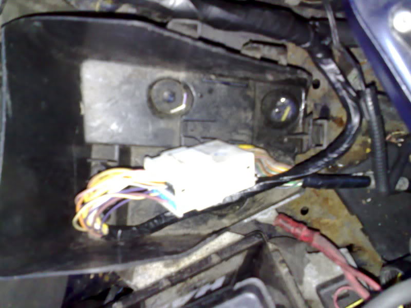

But this is what the engine plug looked like before today:
And after today the engine plug looked like this:

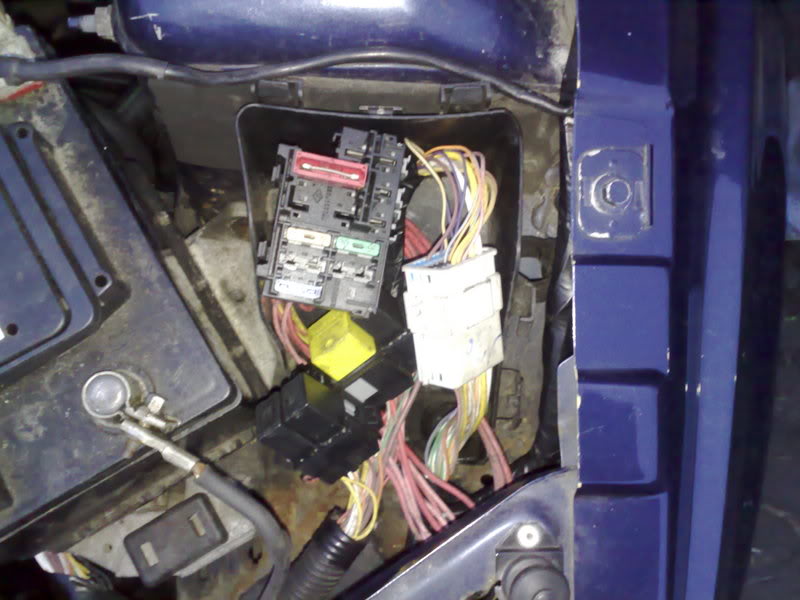

And with the fuse and relay boxes (they might need some tidying):

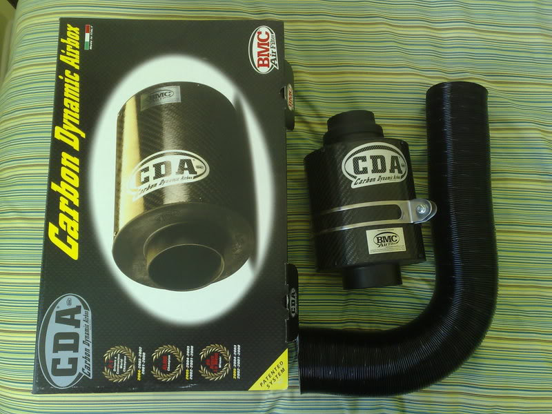

With christmas came a brand new BMC CDA, and a set of 16" tyres form the family.

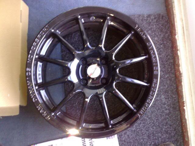

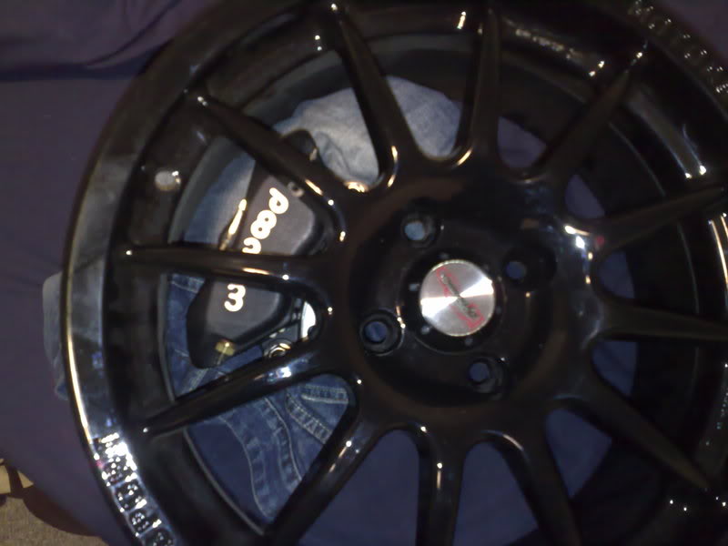

Last week all went to plan, we darted out early to Coventry to pick up a set set of wheels for the project and they are stunning!
This week however, we've decided that the world is out to get us!:mad:
We disappeared off to dartford tunnel to pick up our latest purchase. Only problem is this took from leaving work at 4:50 all the way through to getting home at about 10:30 due to accidents, traffic, roadworks etc! All of this time spent in my brothers dark, leaky, steamed up uncomfortable VX220!
Well after some sleep it all seemed worth doing looking at these beauties, and I hope you all agree

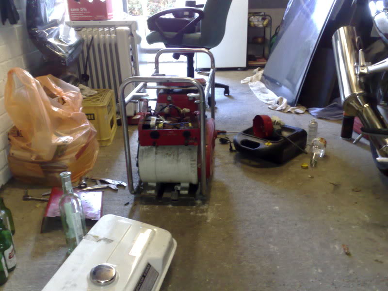

Nevermind we thought we'll just have to struggle. So I started drilling out the rear seat mounts with a battery drill while Moo fired up the generator to run the grinder to tidy everything up.

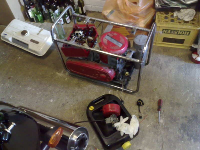

As the battery drill decided enough was enough I realised Moo still hadn't got the generator running, when questionned on this I was hit with a barrage of insults!
So, no generator means no electric which in turn means all our good intentions have now gone to waste!
Doing this improved nothing! So we need to buy a generator... with buttons!:(

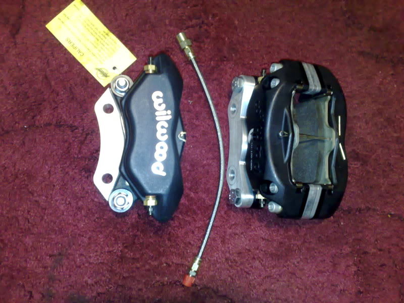

loving the willwoods! im fitting mine tomorow! had to buy a bloody brake flaring kit to fit the new 2lb residual valves
and the unions compbrake sent...look.. erm. wrong LOL

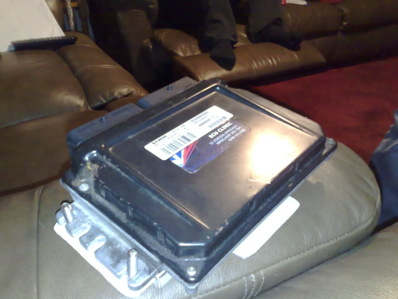

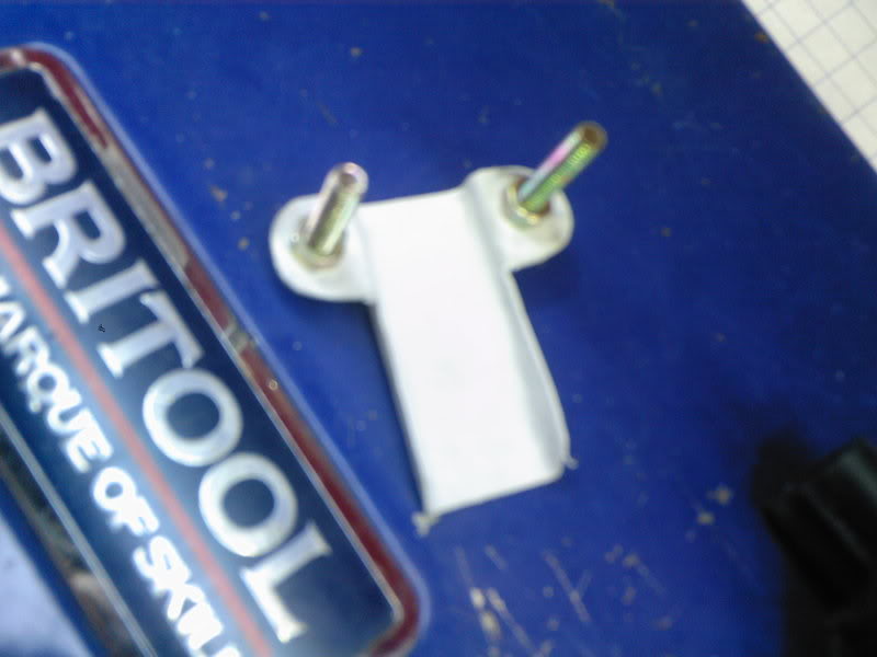

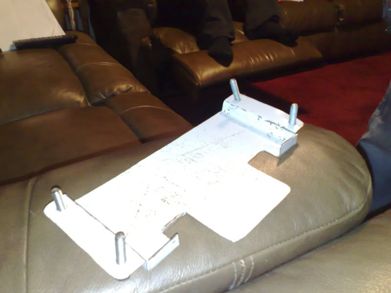

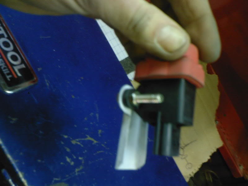

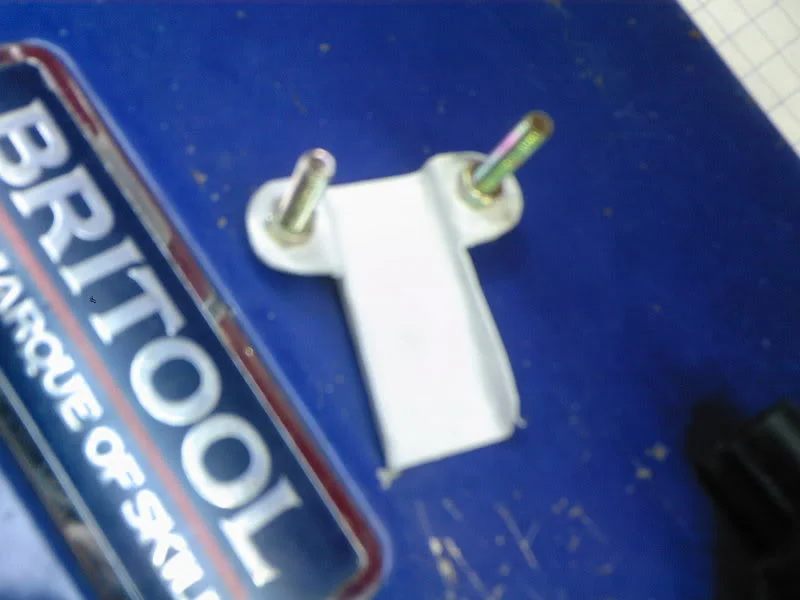

We've been playing around making mounts for the ecu, crash switch and coolant header tank, and here they are:
Crash switch:
ECU:
Still got to get the coolant header tank mount done, but we're rather happy with the quality and fit thus far, and these will all be welded or riveted onto the bulkhead to tidy everything up.

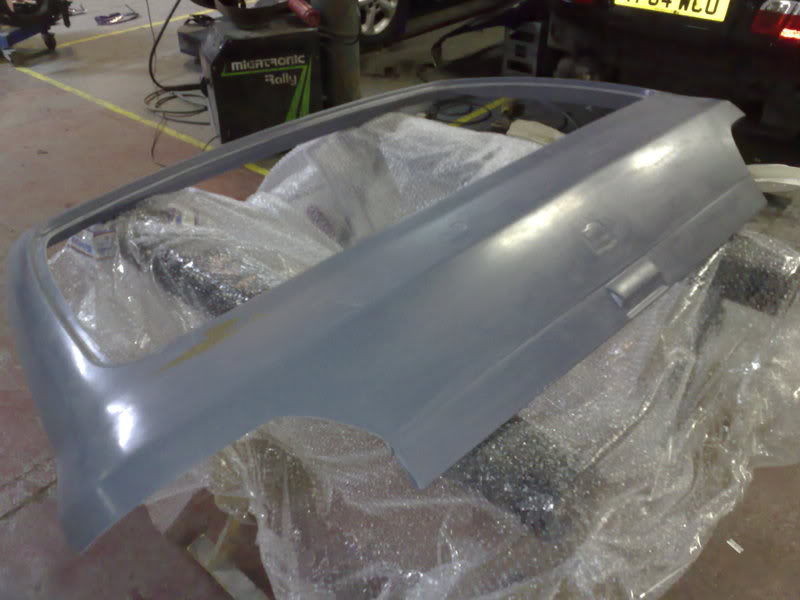

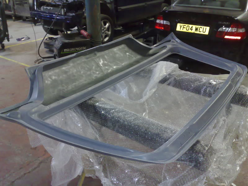

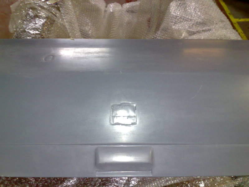

Then out of the blue and much to our surprise we had a delivery turn up at work:

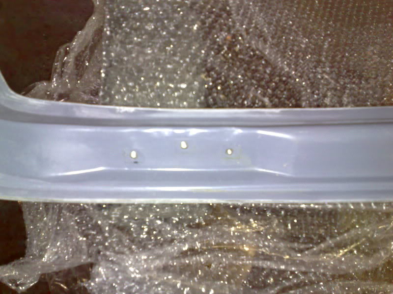

The fibreglass tailgate is finally here! We'd ordered it back in err... September I think, It'd been so long I'd almost forgotten about it! But looking at it, it was definatly worth the wait, it weighs nothing and looks to be of a very high quality! It comes with hinge mounts, but we won't be able to run gas struts (not that we were going to) and it doesn't look like a boot latch will fit so we'll have to pin it, but thats not really a problem either. It'll be interesting to see how well the fit is on it, but I'm sure It'll be good enough after a bit of fettling!
