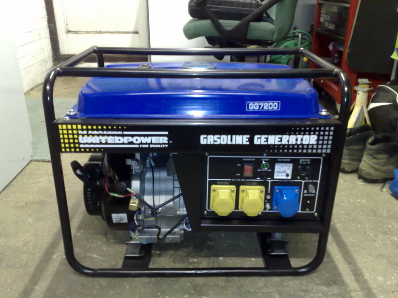

We have finally managed to find a generator shop that accepts buttons as payment:
So hopfully we should finally be able to make some progress on the car itself over the next few weekends and try to get the project back on track!

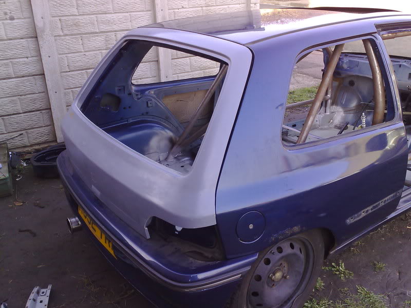

Sorry for the lack of updates but not a lot has been happening recently until, we decided to book this week off to hit it hard and get on with it!

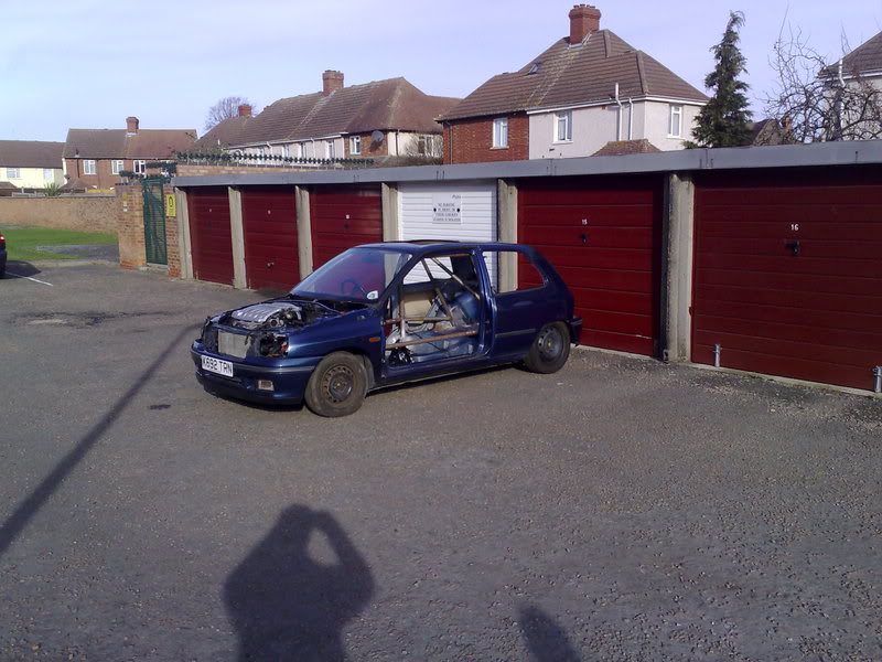

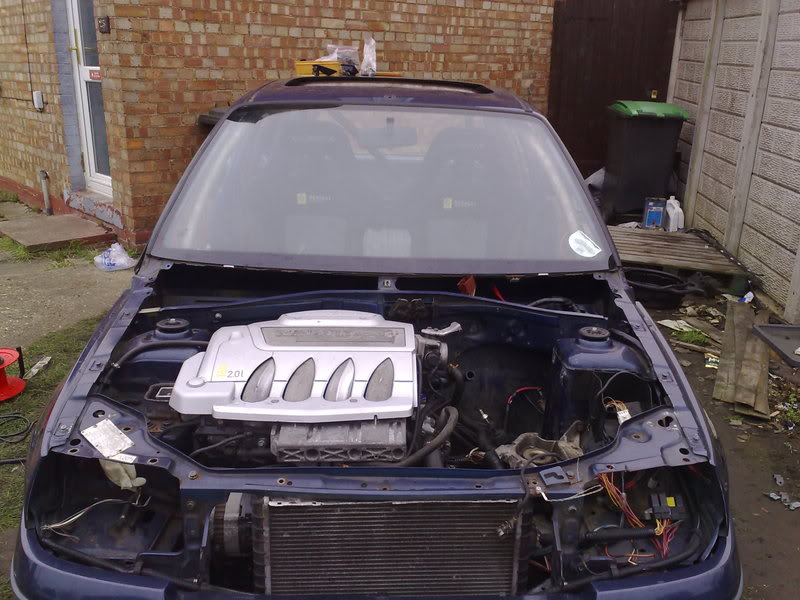

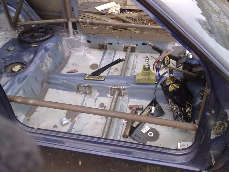

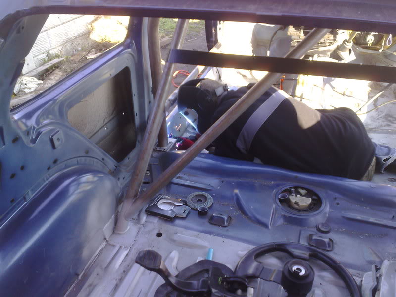

Story so far from saturday morning is as follows:
First thing we did was drag it out the garage, have a bit of a tidy up and assess the situation.

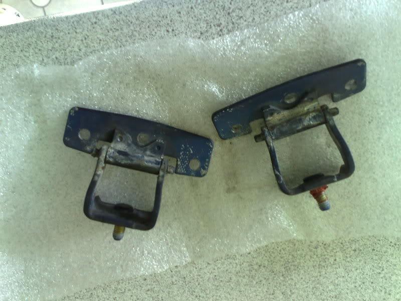

We removed the doors and tailgate for sale, which went that day, which free'd up a vast amount of room.

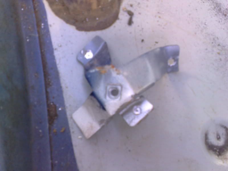

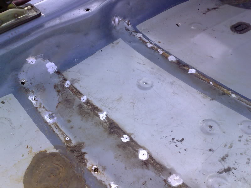

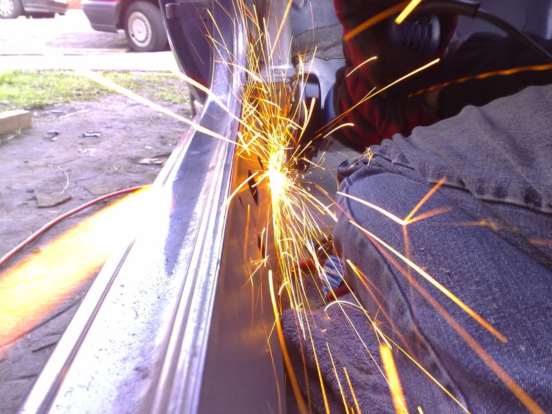

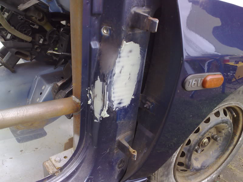

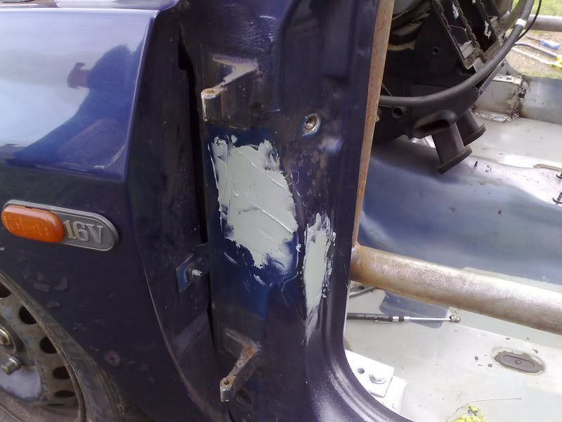

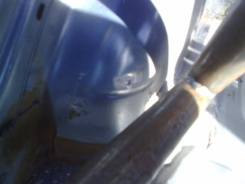

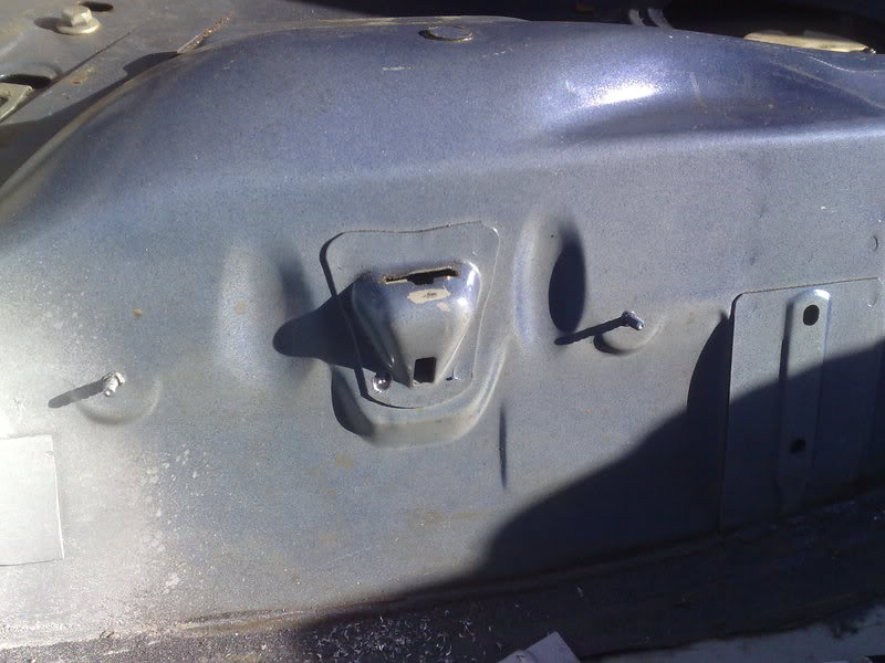

Next thing we did was start drilling out all the brackets we no longer need as we're not running... anything really.
Unfortunatly this left us with a few holes in the floor (drilling the spot welds out thick metal to thin)

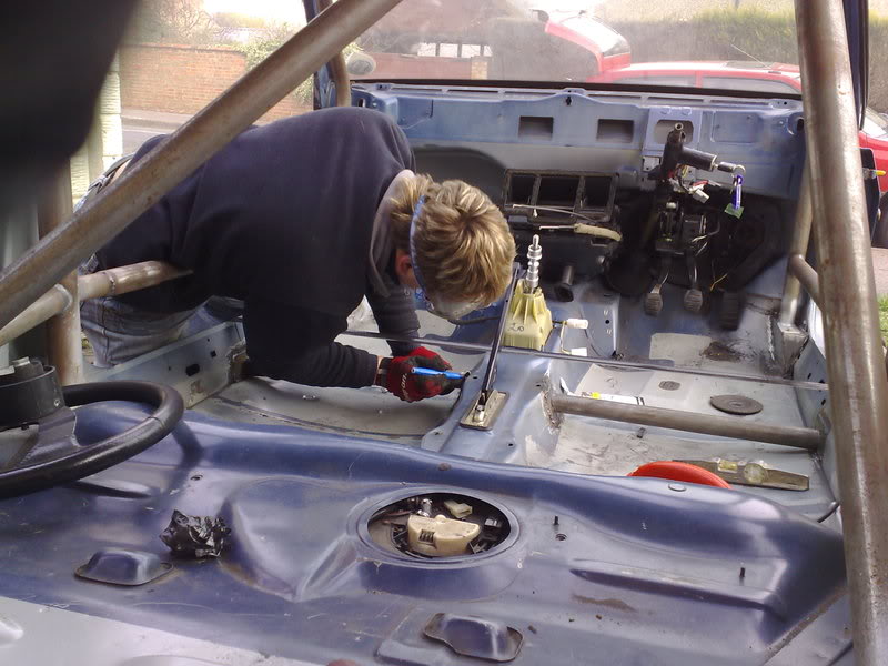

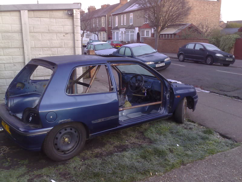

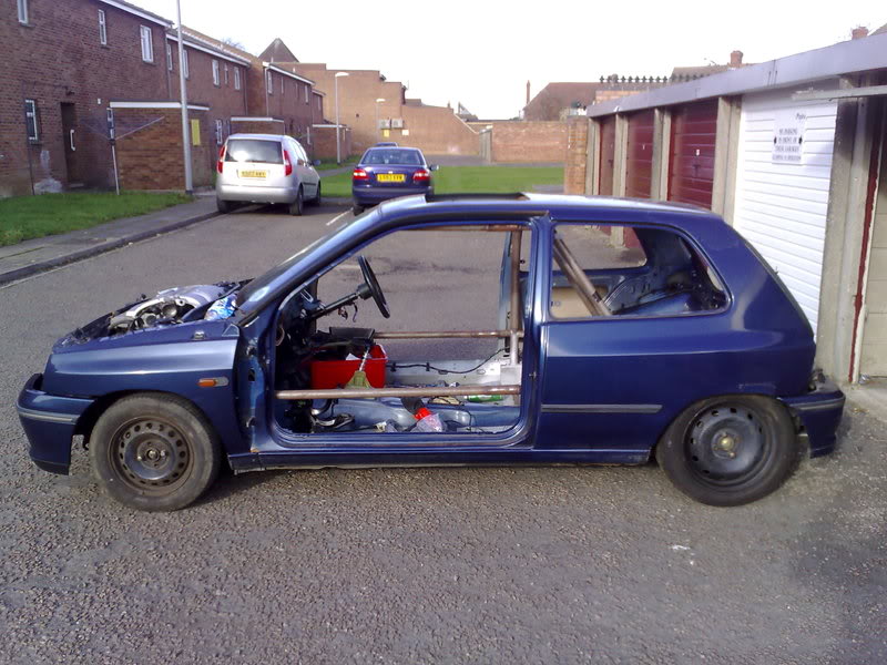

Sunday morning came round and we had a very early start, 6:30 to be exact! You can see the frost on all the cars, it wasn't plesent.
We got up (stinking hangover), went down to the garage and pushed the car back to the house.

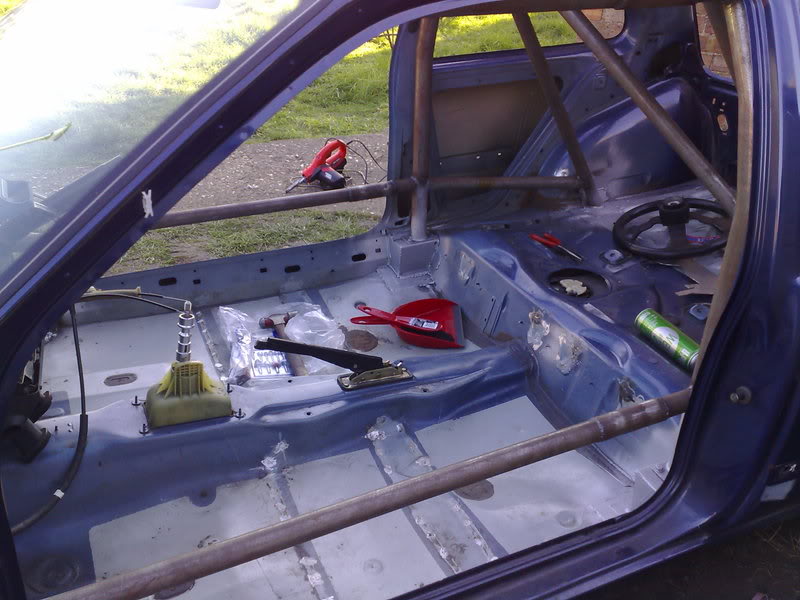

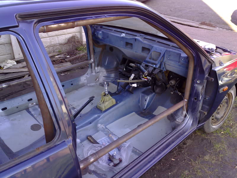

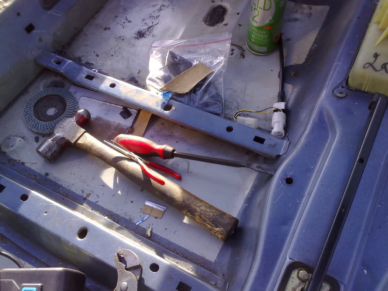

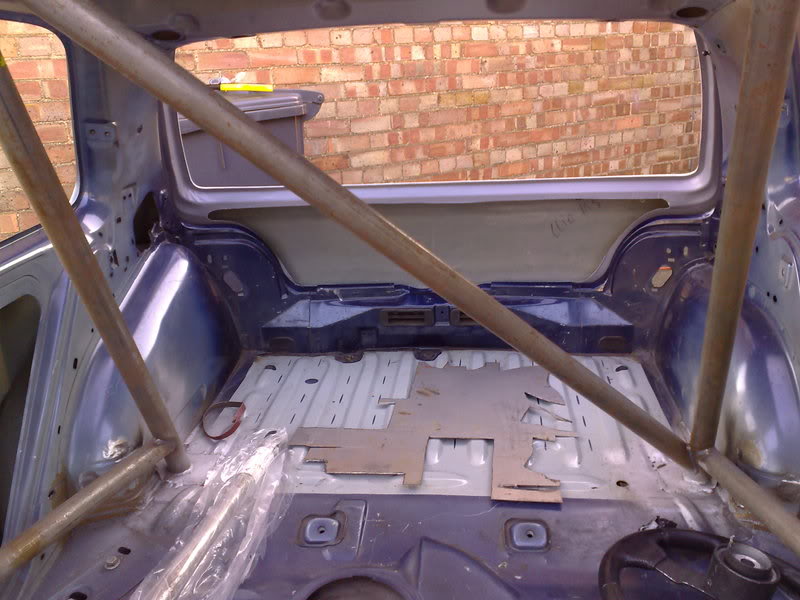

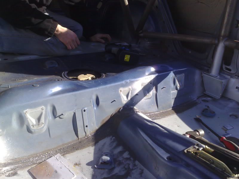

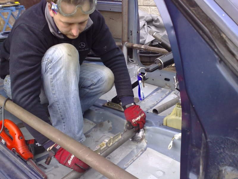

Continued to drill off all the bracket we don't need, including the origonal seat rounts.

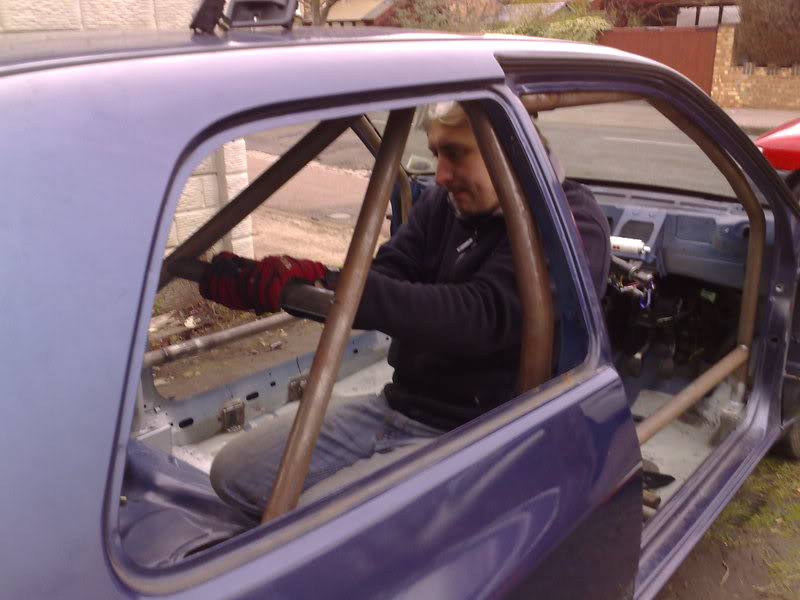

Once all that was done we finished off box sectioning the roll cage and grinding back everything to make it look tidy (we still have some tidying to do)

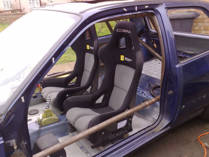

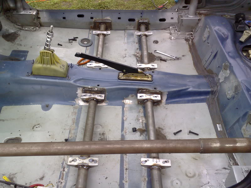

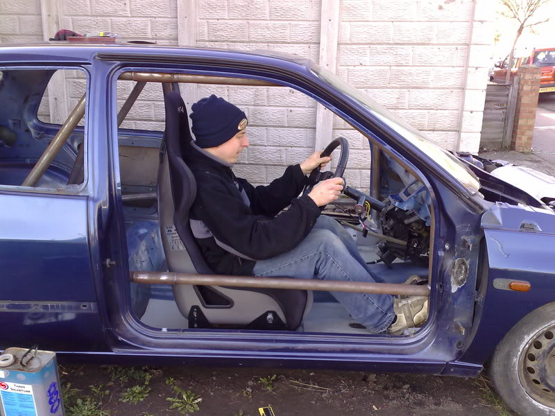

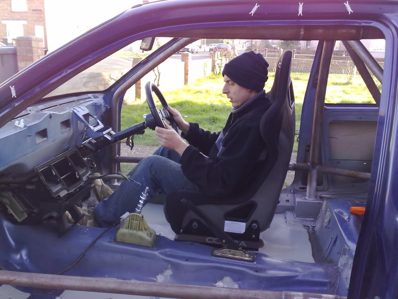

Next thing was to mount the seat (thanks holister for the picture).
We measured, measured and measured some more before starting to make sure the seats were in the correct postion as they won't be adjustable.
We even compaired to the seating postition in the Nissan.
We came up with some random ideas to try and make sure everything was true.

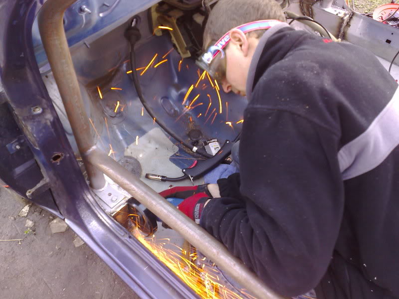

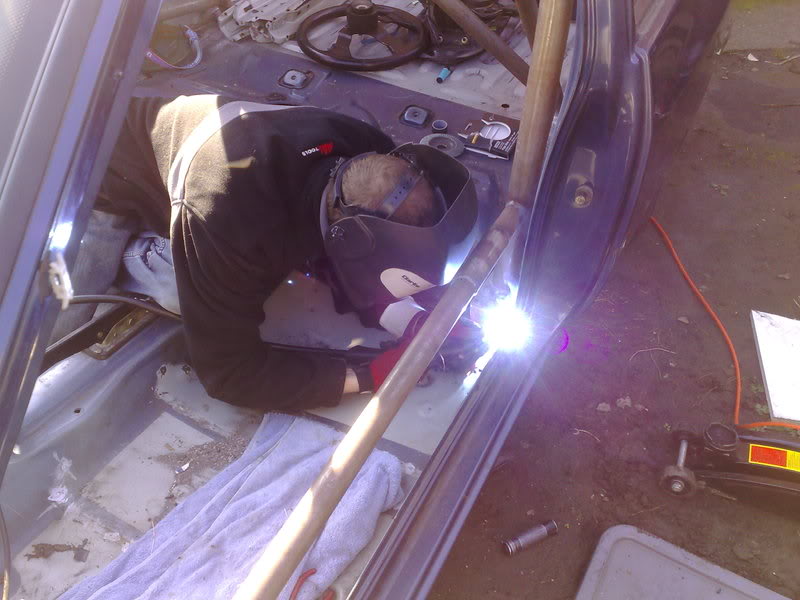

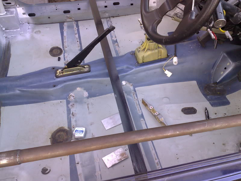

We then welded strengthening plates into the sills and tunnel, but ran out of welding gas, so began to shape the bar the seat will mount to before we ran out of light and didn't want to annoy the neighbours.

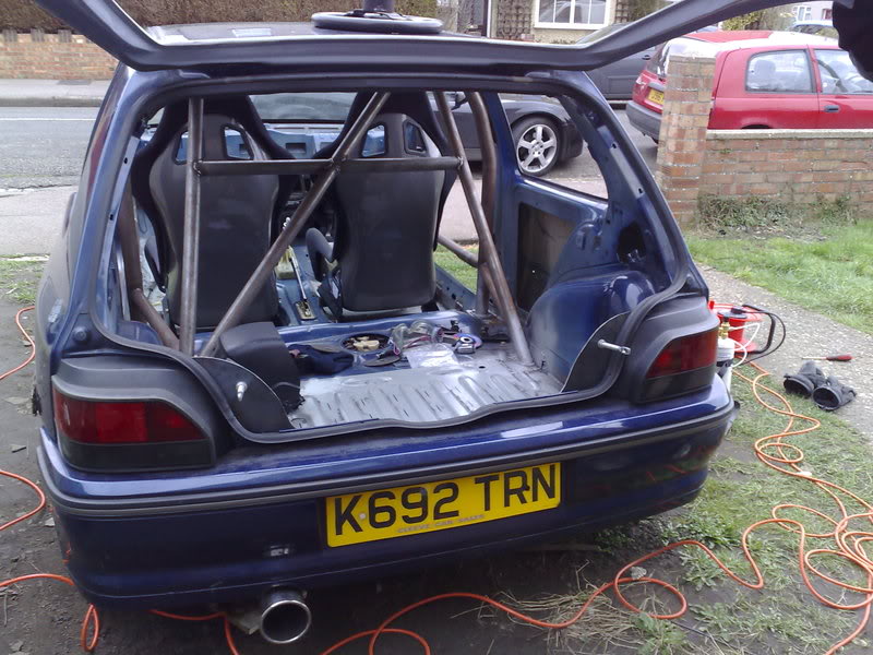

More progress from today and yesterday, although disappointingly it doesn't look vastly different from before, but its all going to come together soon (we hope)

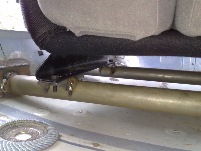

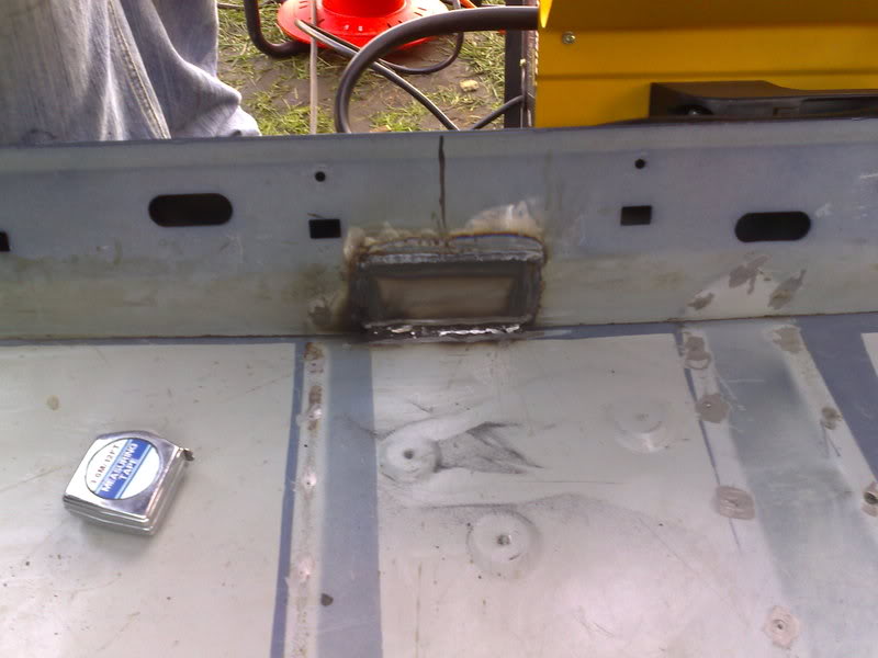

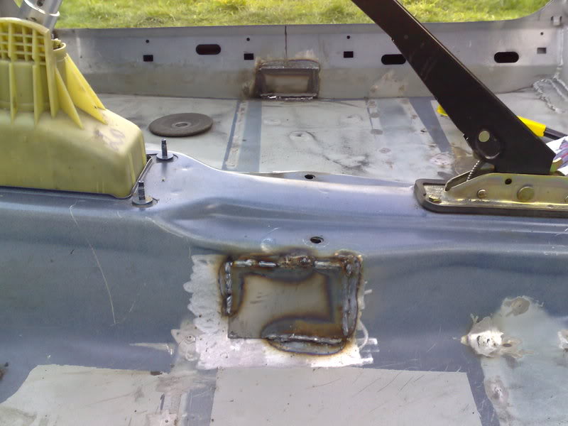

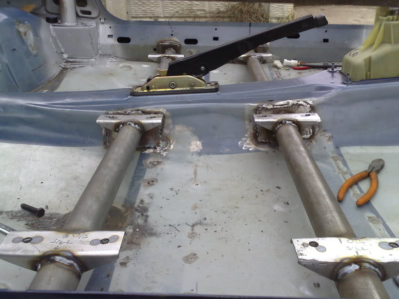

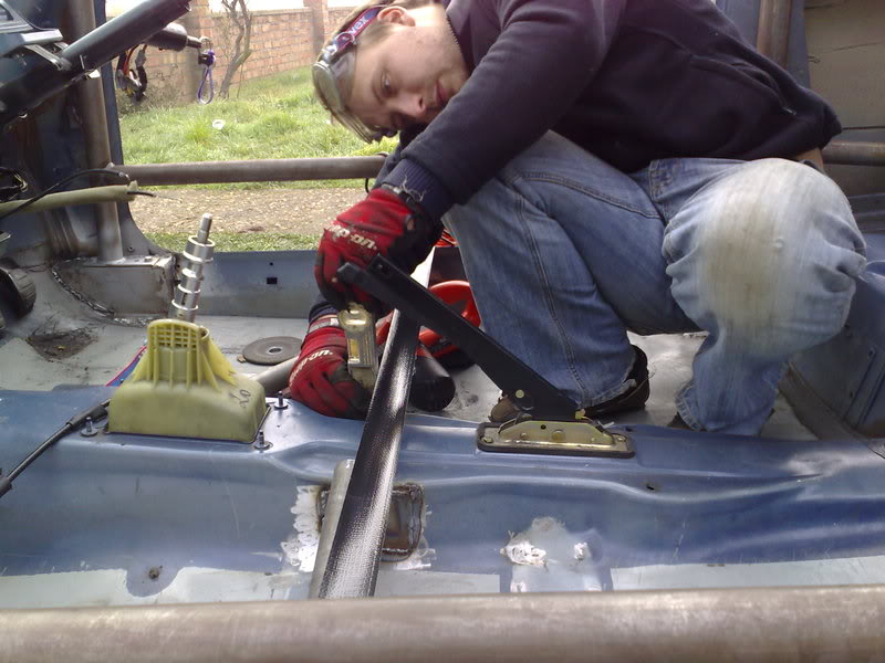

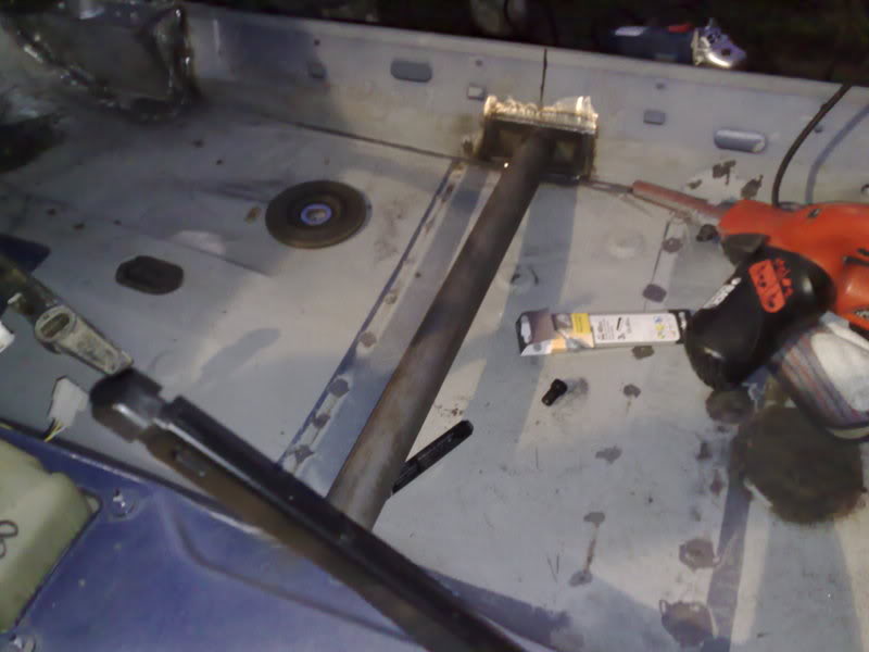

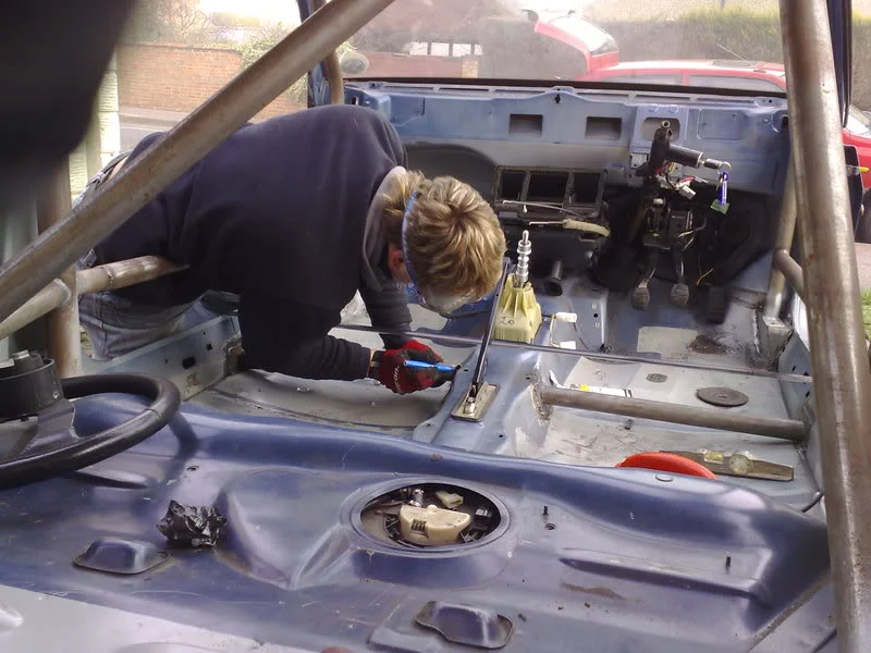

We started off by shaping both the front seat mounting tubes to the plates on the sills and tunnel, making sure at every step everything was straight from every angle. But we were unable to attach them oweing to a lack of welding gas.
So we decided to head home and check for any deliveries. As luck would have it under the door mate we found the tailgate hinges (thanks Mattbrown from Clio valver)!

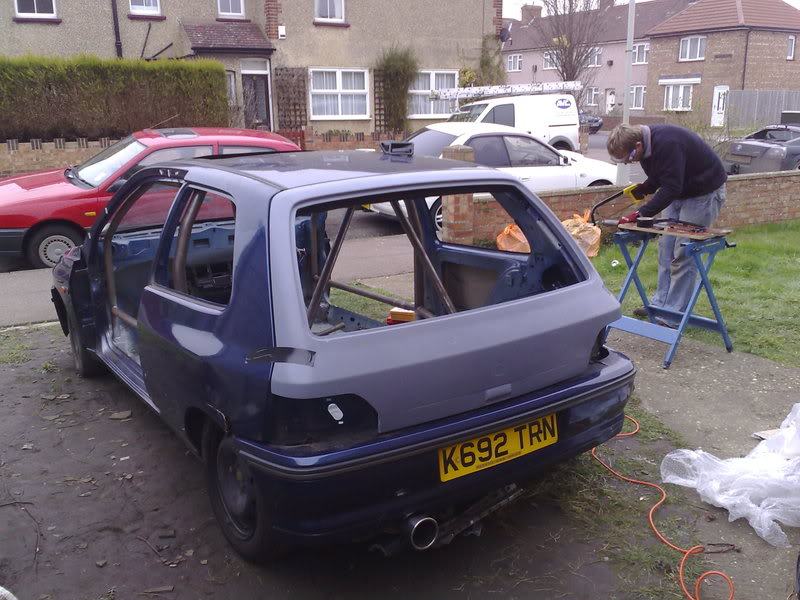

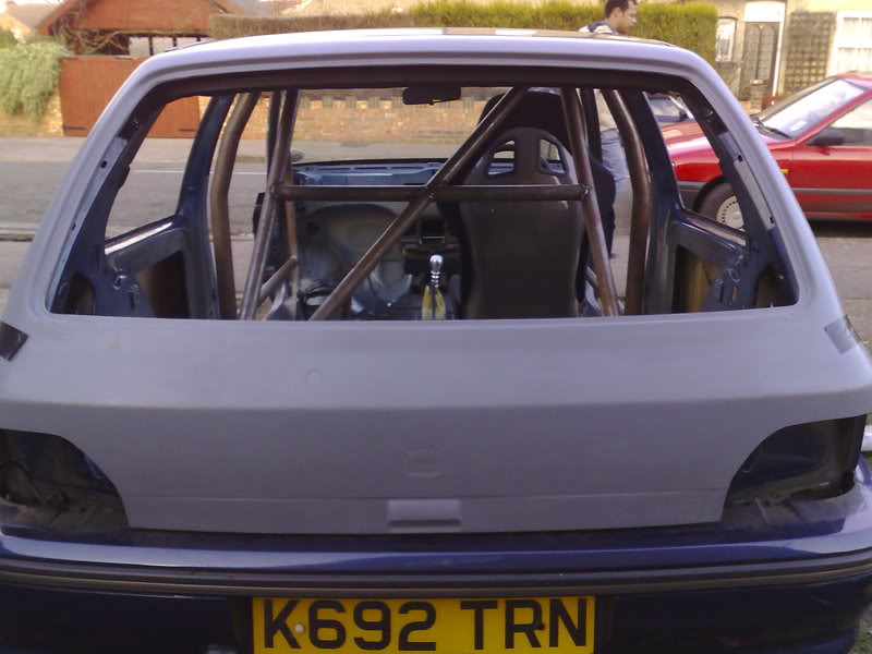

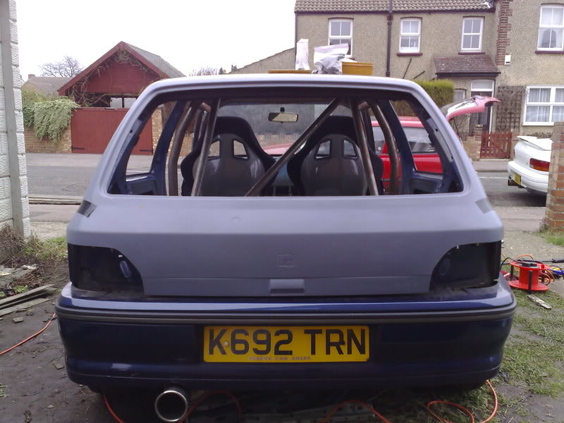

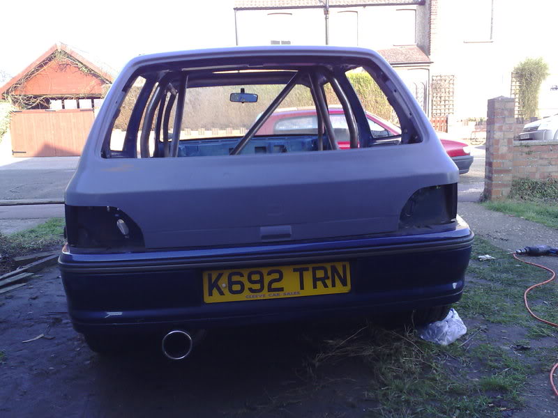

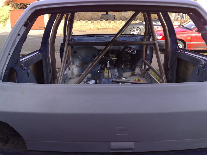

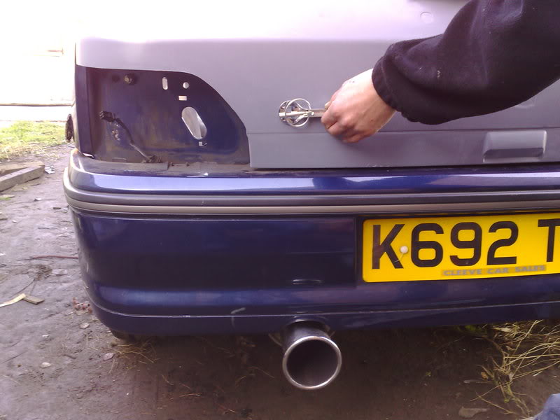

We then set about fitting the tailgate to the car. Amaizingly it fits pretty well, just needing adjustment to the top hinge mounts to bring the gap in to the roof.

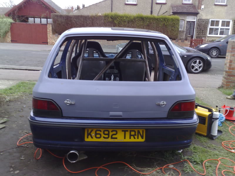

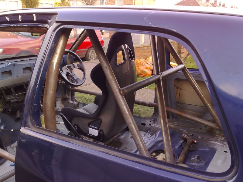

This morning we managed to get hold of some welding gas so straight off we welded in the seat mounting bars, again making sure everything was straight and level.
Once these were in we trial mounted the seats to make sure they weren't on the piss, and OH MY they look awesome!
After a bit of an accident by Moo causing our last remaining peice of roll cage tubing (till tomorrow hopfully) to end up being too short for the rear seat mount we set about shaping the o/s half the harness bar.
What a job this turned out to be, so may angles of tube butting up against tube does make things complicated, but we're very happy with the results.
More updates tomorrow or in the weekend dependent on went the roll cage tubing and sheet metal arrives

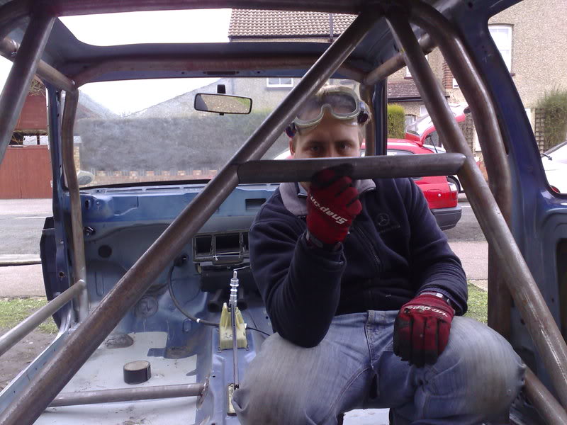

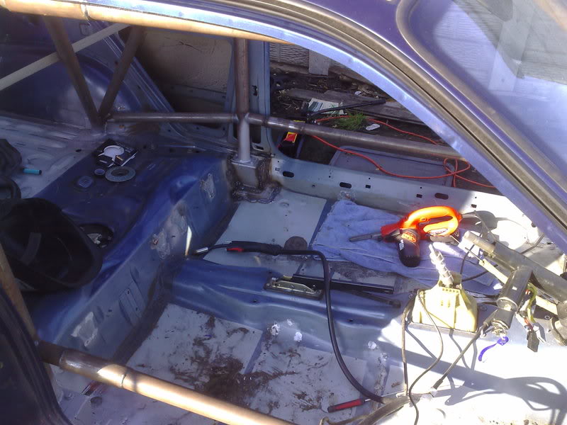

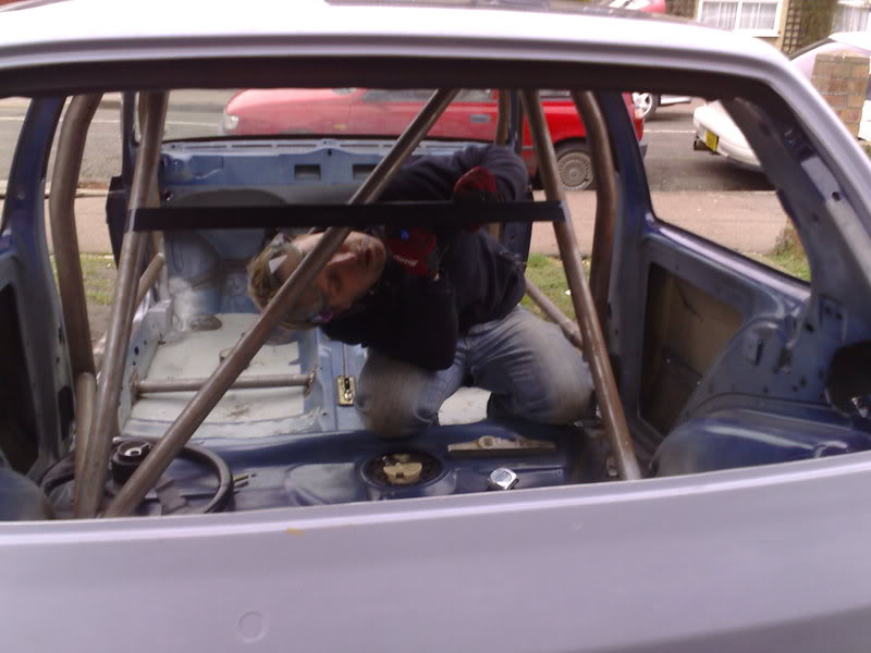

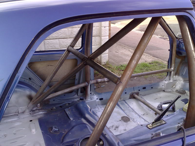

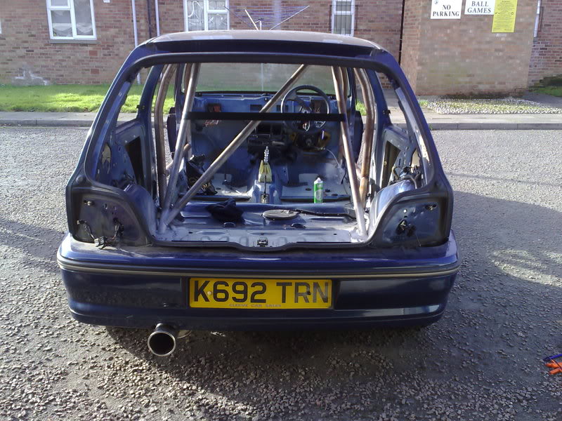

Not much progress made today, but the rest of roll cage tubing turned up so we were able to finish off a few things.
We manage to shape and fit the harness bar. It was a real mission to shape but we are rather impressed with the outcome.
We also managed to finish off the drivers seat mount by fitting the rear mounting bar.
Once we'd done this we'd truely had enough of shaping the end of tubing so decided to call it a day.
All that leaves us to get done what we wanted to this week is fit the passenger seat rear mounting bar, and make the plates to pin the tailgate down with, but we need the metal sheet to turn up.
The feet to bolt the seats to the seat mounting bars will turn up on Tuesday, so all is good!

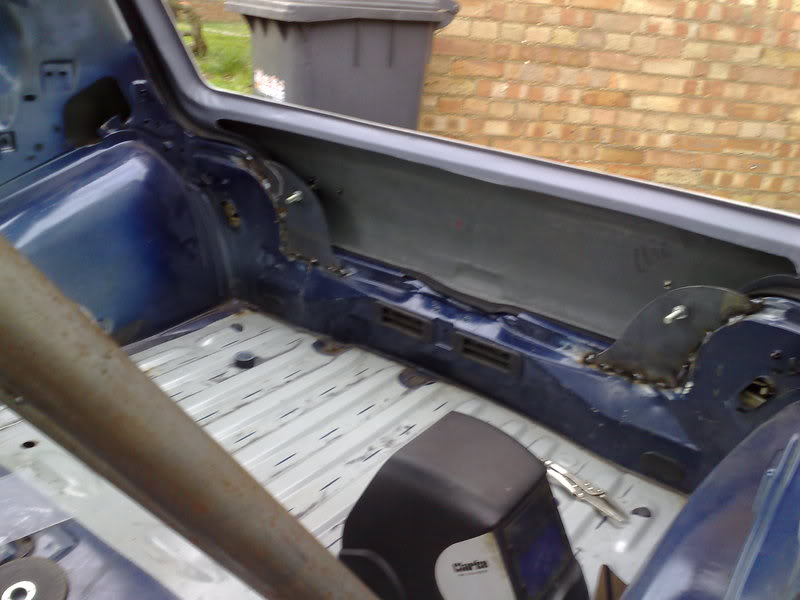

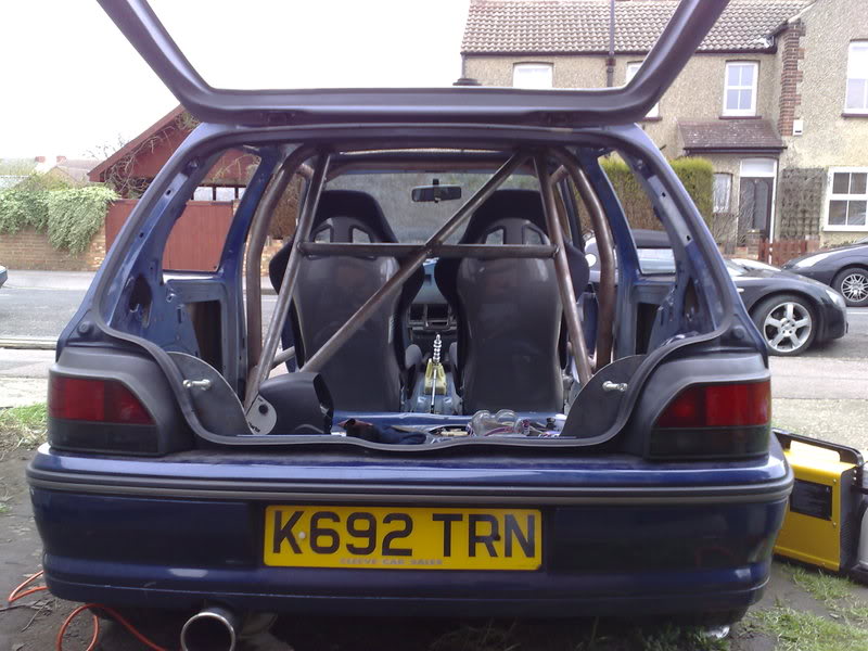

Another progress report from the weekend.

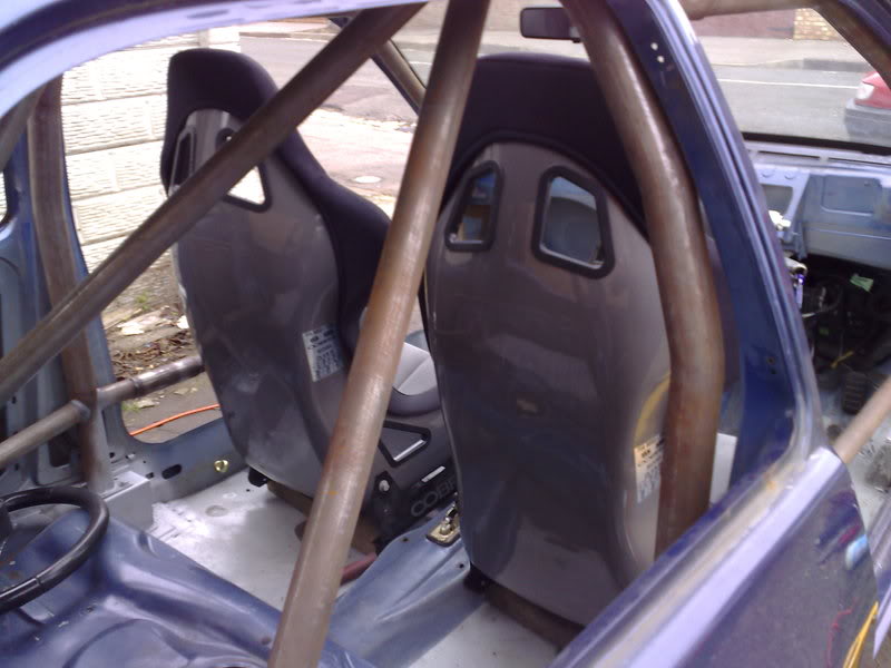

We have managed to finish off the seat mountings, by welding i the last of the tubes on the passenger side and welding the feet onto the tubing with captive nuts.
Huge thanks to James (James172Cup) for haveing the feet lazer cut for us.
We have also fitted some plates in the boot shut and finished off pinning the tailgate down. It doesn't fit the best in the world but its fine for a track car.

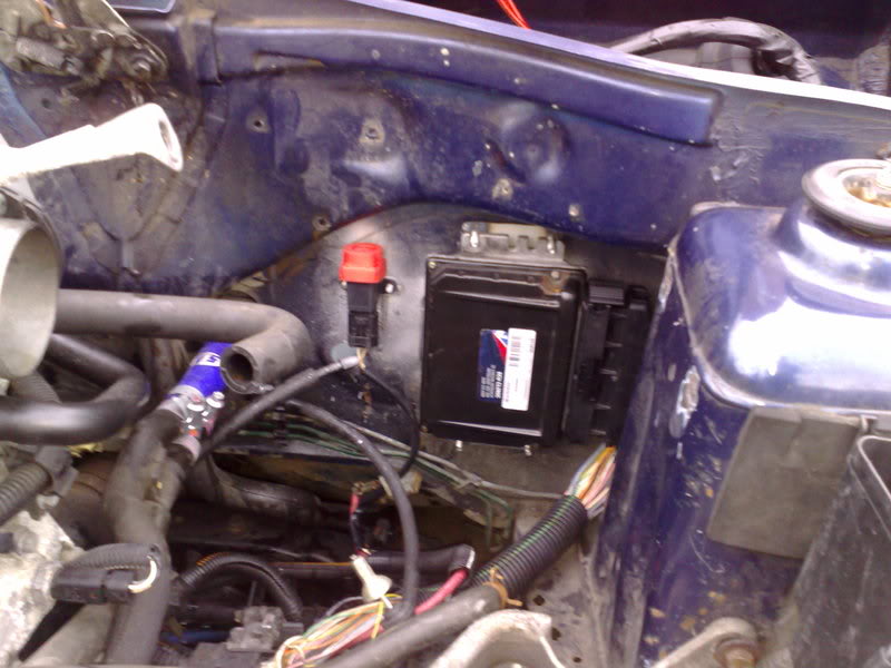

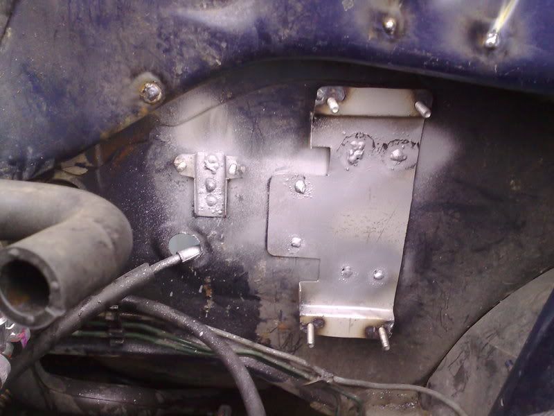

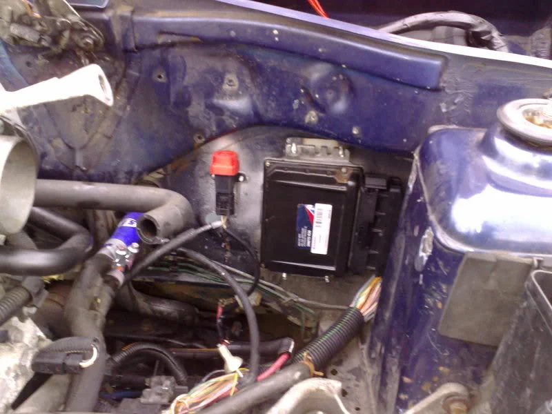

And then last of all we fitted the ecu and crash switch mounts all with captive bols. Its all looking pretty good, we've stil got lots to do like coolant header tank bracket and do some tidying but it is coming along
Thanks for looking

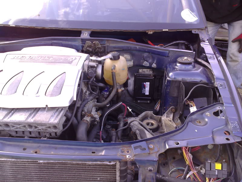

Not much progress this weekend, not even sure if its worth an update really but here we are. First of all our carbon fibre scuttle panel arrived and its beautiful!

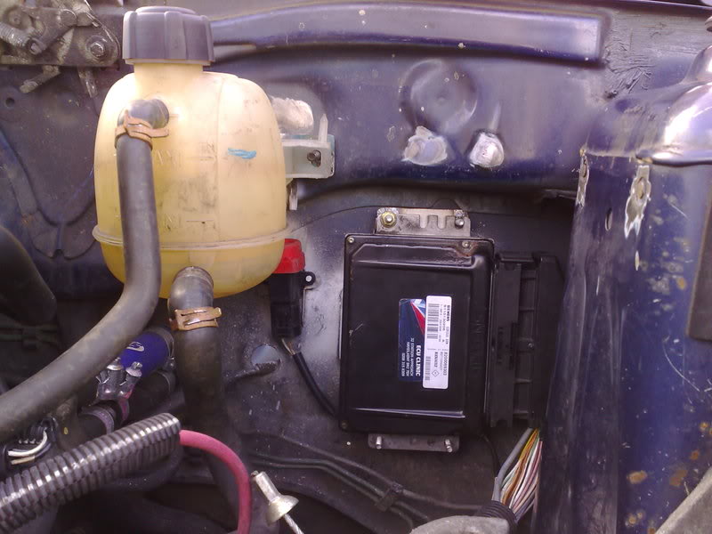

We made a bracket and fitted the coolant header tank. We're both very pleased with how it all looks.
We also plated the holes in the 'A pillar' for the wiring for the door and the door pin switch, then started to filler them but had to leave sanding it down as I was busy.
