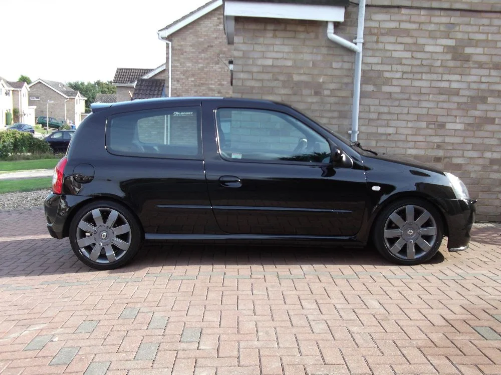

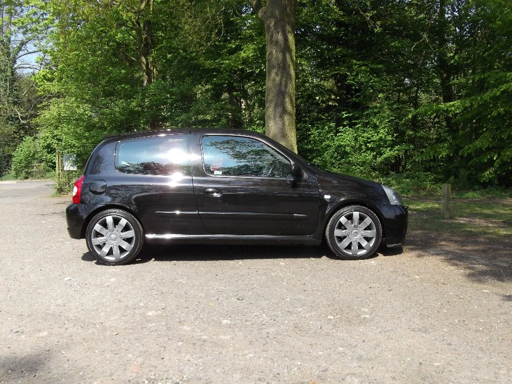

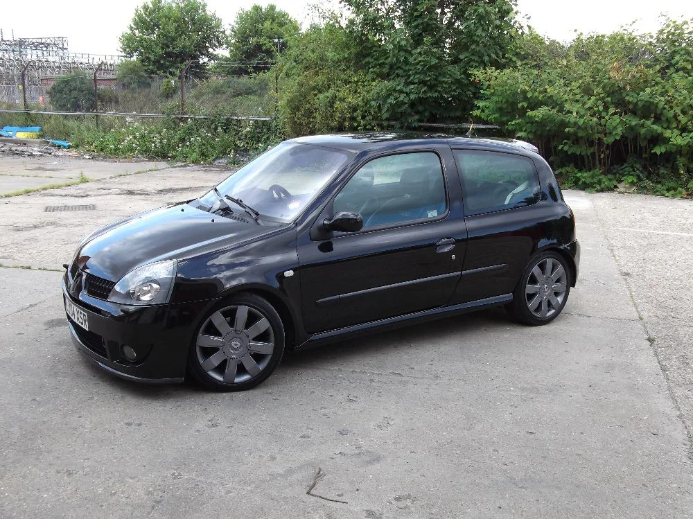

Hi guys and gals,thought I would get a few pics of the progress with my 182,had the car for about 6 months now and I am really enjoying it.The car was pretty much standard when I got her just a yozza cat back system had been added,so I got to work making the car into my own,first of all I decided to go for a decat pipe,couldn't get a yozza so went for a ktr decat pipe,I think I my have had a collapsed cat,because this made quite a difference to the power and feel of the car not to mention the noise,and what a noise never thought a clio could sound so mean.I also added a ITG filter and drilled the cold side of the airbox,then it was of to TDF for a custom remap,the was running a good 172.2 hp and 149 ft/lb and Matt said it was a good for standard,so on with the remap,power is now up to 179.6 hp and 159.2 ft/lb very pleased with the result car feels much better to drive,with better power lower down in the rev range.
Right now it was time to get her looking meaner,not being a big fan of coilovers on the road,I went for a set of Eibach sportline springs,very good bit of kit,car now sits really nice and handles a lot better without sitting to low.Next it was onto the nasty plastic trim,going for that stealth look so I have done the front grills,fog light surrounds,bullets,badges etc in satin black looks so much better,I also added a carbon front splitter and carbon tail pipe surrounds,I have also done the silver trim inside the car in satin as well,I have also removed the rear wiper.
I am not sure what to do next,I would like to go for the RS2 manifold with some 428s and maybe some head work,want the car to be really responsive and to stay N/A.
I have also fitted new exhaust hangers on the rear of the car,but still can't seem to get the pipes sitting right,was thinking of getting them heated up and using some gentle force to get them right(any thoughts on this would be useful)
The car has clso had new plugs,ht leads,and Elf 5w 40
Will keep this updated as and when I get more done.

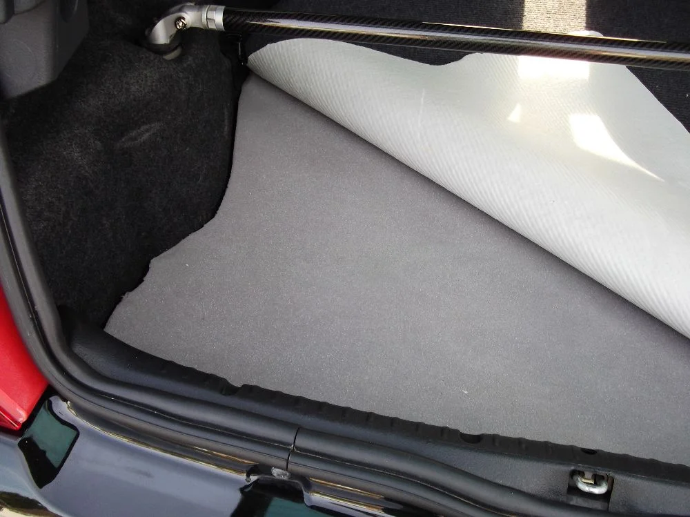

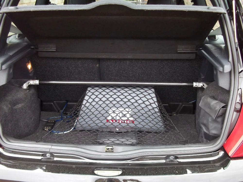

I have added a few bits since the last post,ss brake lines with 5.1 dot fluid,ktec carbon fibre rear strut brace(wanted a whiteline atb really but everyone seems to be out of stock)and a metal foot rest lol.The lines have made a good difference,firmer pedal,less fade,also the strut brace is a good edition thought it might just look nice but it seems to keep rear of the car nice and tight,I must admit I seem to notice it more on the road then on the track for some reason.I am hoping to get the whiteline before I go to the ring,if anyone knows somewhere that have some that would be handy,will get some pics up at weekend or next week some time,and yes there will be speedo vids up hopefully doing 150+ down the autobahn:cool:

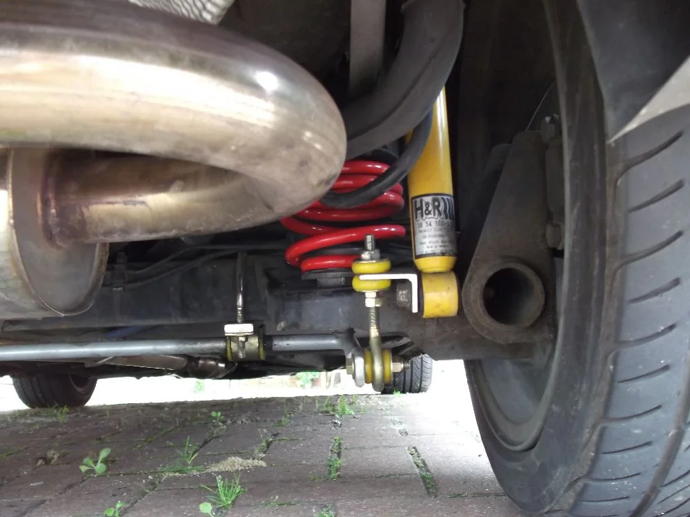

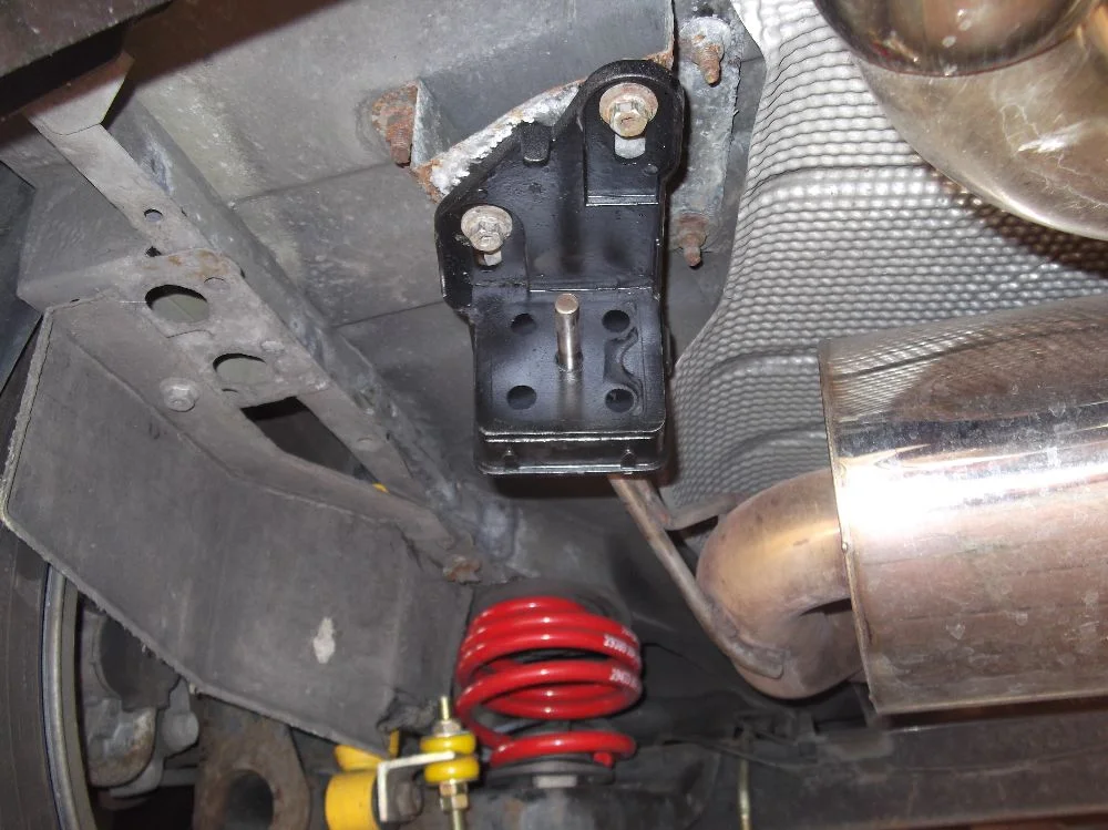

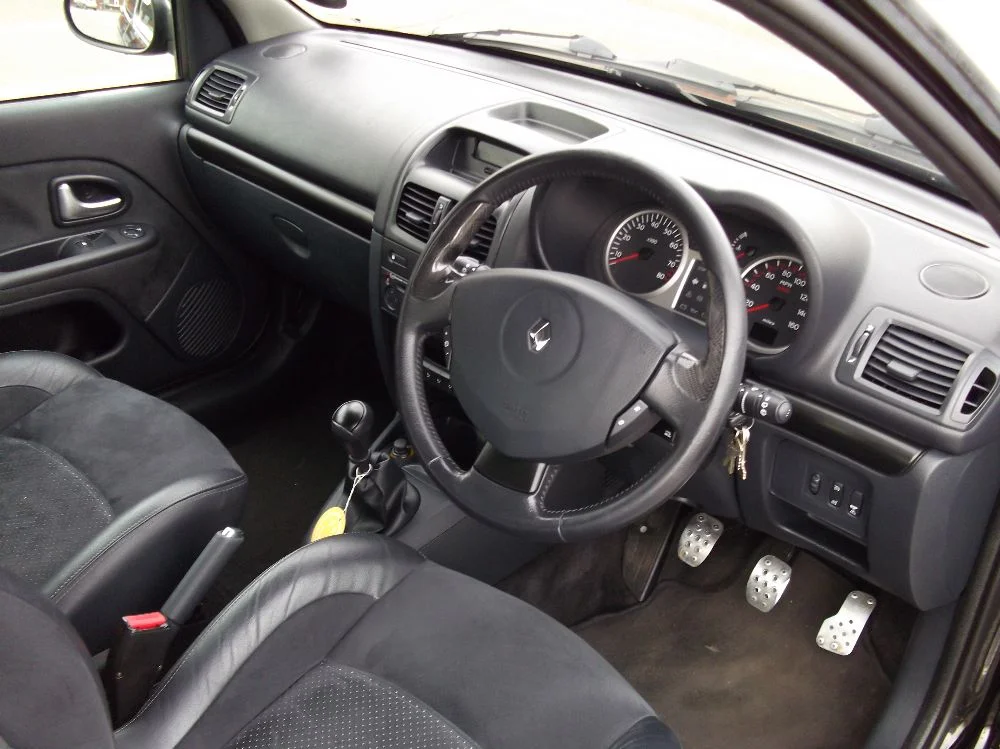

Love the interior! looks awesome. The rest of the mods seem really sensible too, proper stuff to make it go faster/handle better. Well played
The brace works well but the whiteline transforms the cars handling,put it on when I still had the sportlines on and it made a big difference,more so than the H&R's,but with the whole package at the moment the car is on rails.

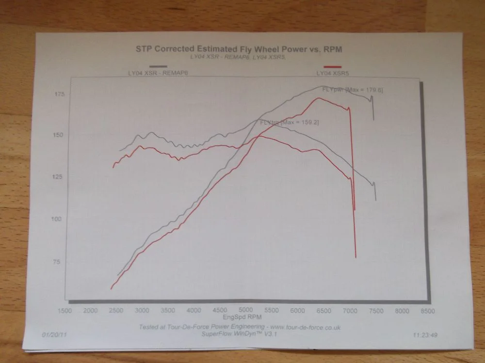

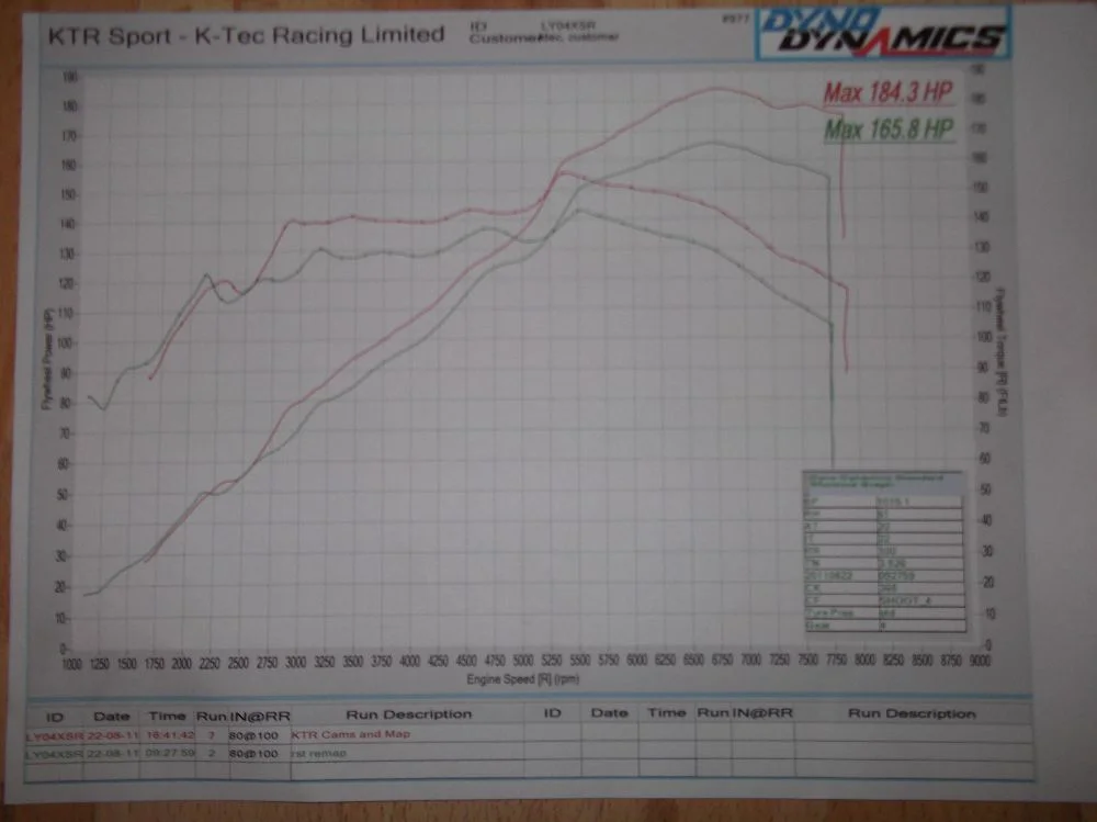

Just spoke to ktec and the will be having the cams fitted on Monday,will be interesting to see what my car makes on there roller's(compared to TDF 179.6 bhp 159 ft/lbs) before the cams go in.Going to have to leave my house at 4 30 am to get there for 8 30 :eek:
Cam's are now fitted and wow what a difference,the car pulls so strong now and it's so smooth,ktec really seem to have done there homework.I would say the cams are even smoother than standard,very very impressed.The extra torque that is developed low down(see graph)make's it feel that the engine has gone up a few cc,you can really feel it.I must say the service I received from Ktec was top notch,they did not have a hire car so the lovely lady(can't remember her name sorry)at reception gave me and my dad a lift into Bournemouth and we had a nice day by the seaside and got picked up later on,top service.
The gains achieved were 18.5 bhp and 15 ft/lb,I think that even Andy was impressed its the best gains they have had so far:clap:
Will be taking the car back to TDF in the coming weeks to see what there Dyno has to say and see what Matt thinks of the cams.
On another note,when Ktec carried out the work they said that a few bolts ect on the cambelt were loose,so it looks like I had a lucky escape there,again thanks Ktec,they did ask me if it was them who done the last cambelt change,but alas it was done by JMS
Graph is below,let me know what you think,and what you would do next,power wise that is.Andy said the cams will work well with ITBS and s/c set ups.

Get them mate both worth there wait in gold,tip,don't do the link nuts up as tight as the ones in the pic,thought it was a bit loose after my mate had fitted it and thought I can do up a couple of bolts,well I can too much it seems,read the instructions afterwards DO NOT OVERTIGHTEN LINK BOLTS MAY CAUSE FAILURE lol I have done properly now though:D

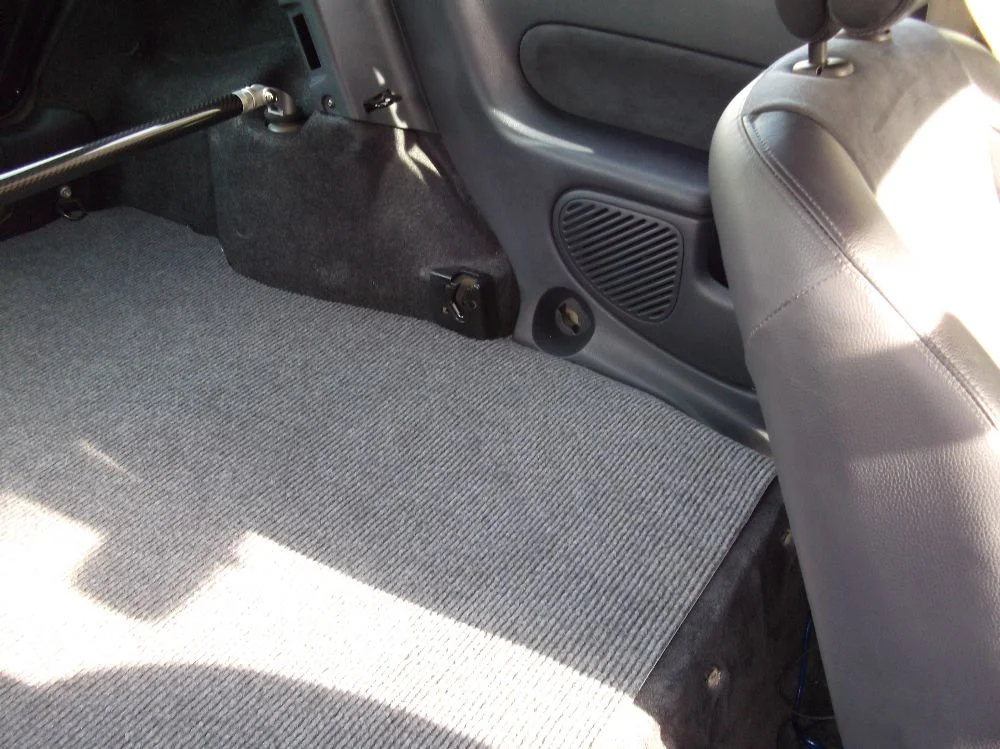

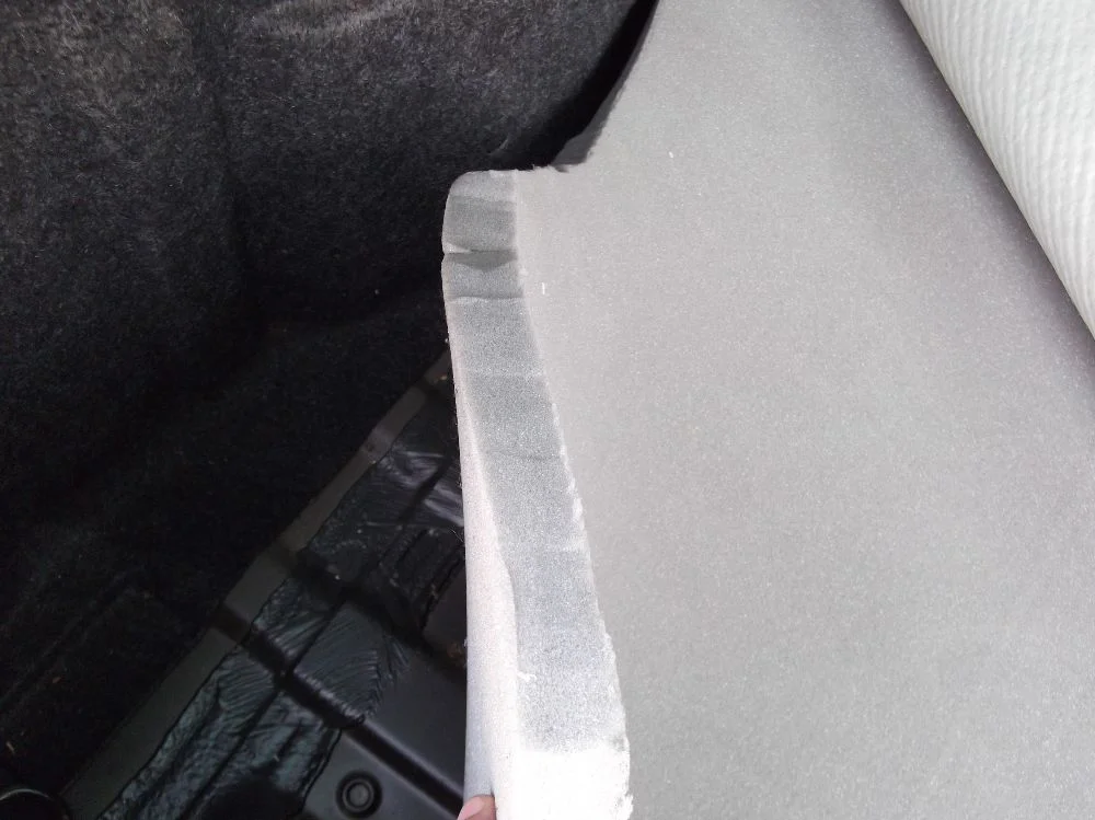

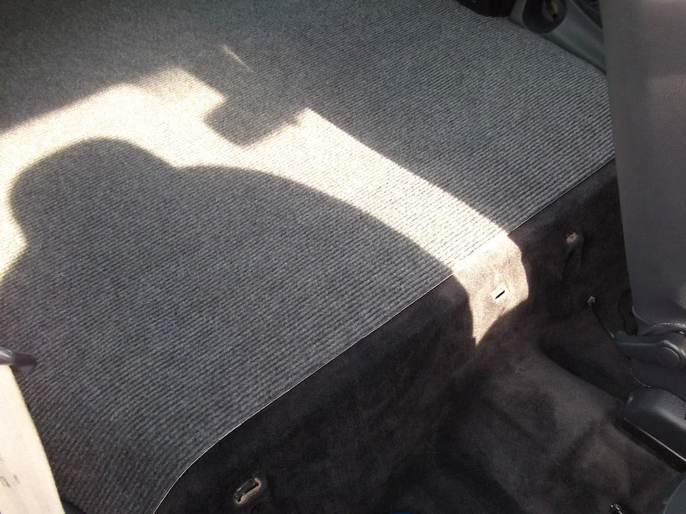

Just a update on my progress,decided to strip out the rear seats as the car is being used more on track now,I have used some sound proof foam with carpet on top to cover the boot ect,looks tidy and the foam really works well in reducing the the db's in the car and weighs nothing.Will have to remove the top nut on the rear suspension adjusters as the car now sits a little high.Very happy with the improved handling and responsiveness of the car now.Will be adding some buckets as soon as I can afford some nice ones.

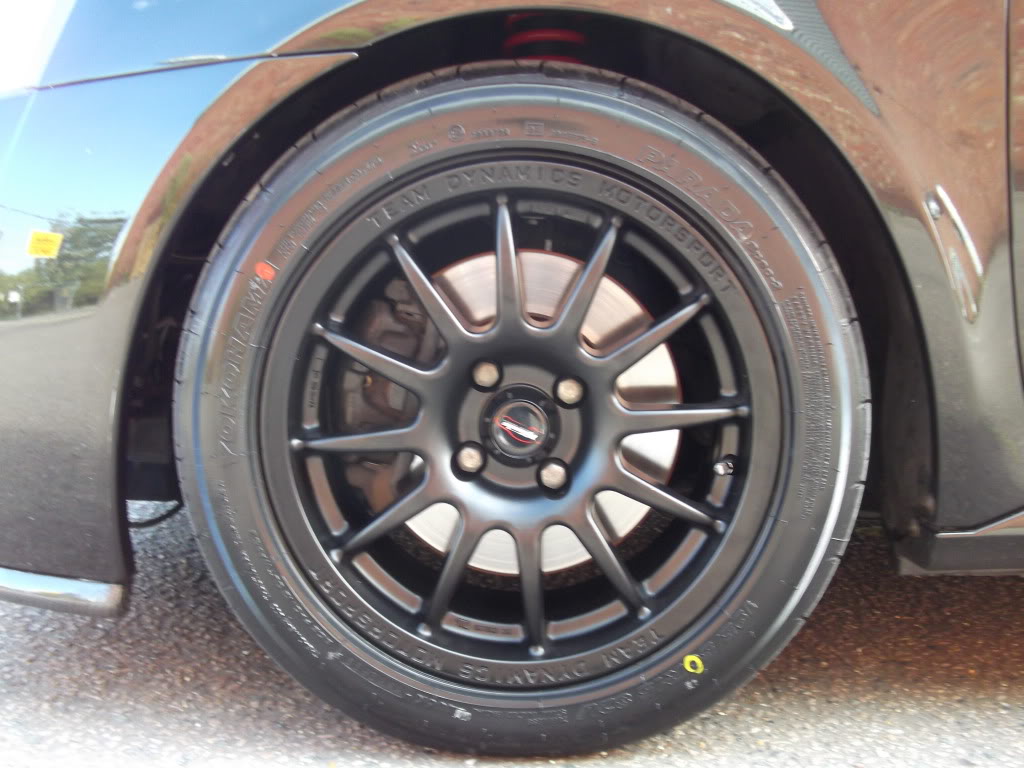

New wheels will be going on Monday,satin black pro race 1.2's with yoko parada spec 2's

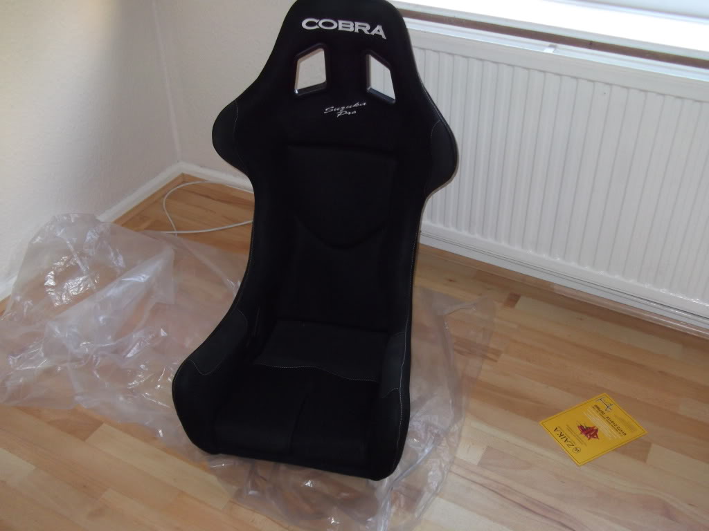

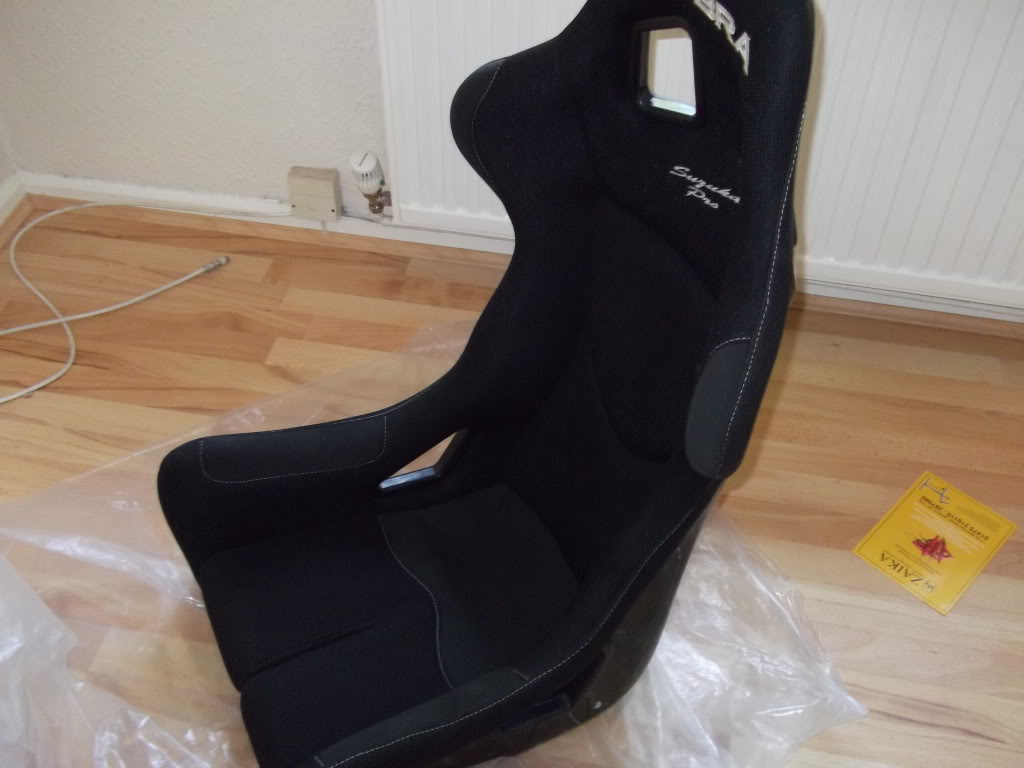

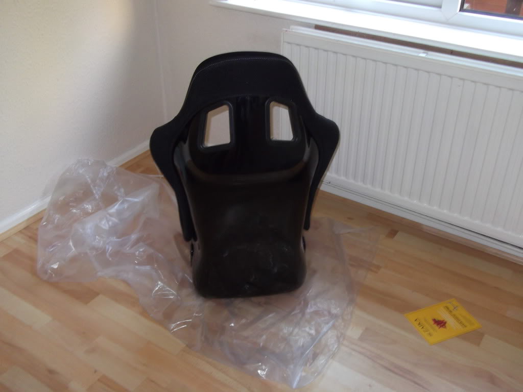

Picked my new seats up Friday night,thanks Dan sorry for being so late.
Just need to get the side mounts and subframes.

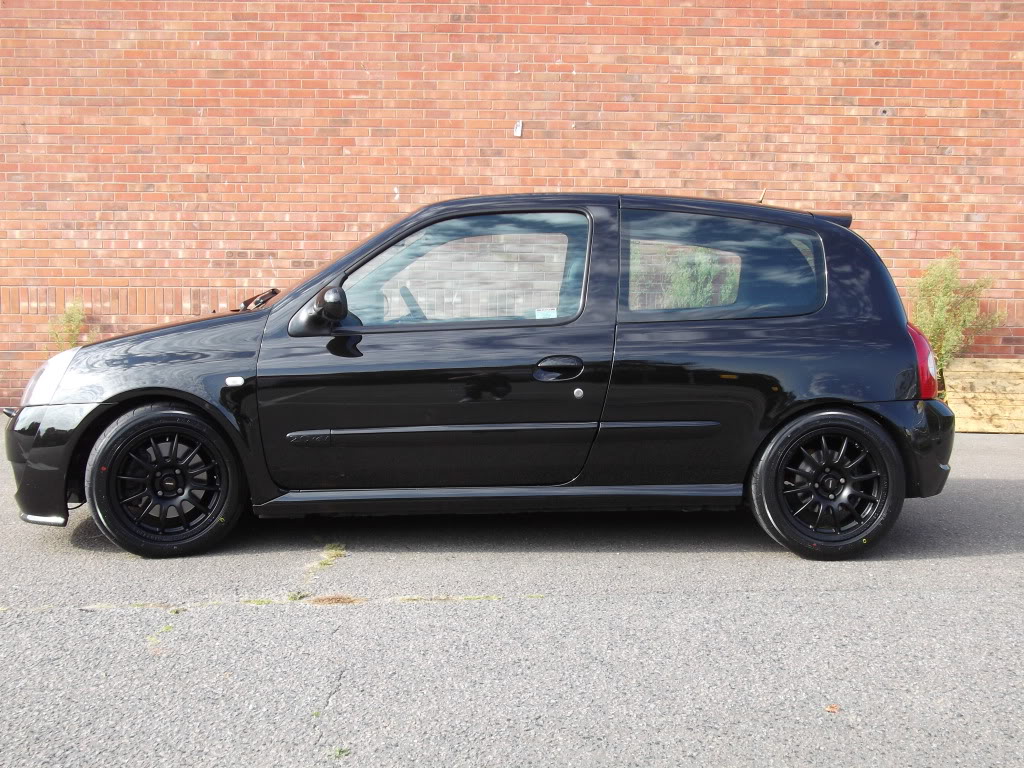

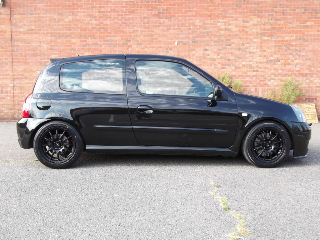

Just a few pics of the car.
I have removed fog lights and used mesh on the holes,brakes seem to work a bit better like this.
Wheels on very happy with them,they look awesome in the flesh,pics are not to bad either:)
Hoping to get the seats in next week sometime
looks good mate, changed abit since i saw it at snetterton, has to be one of the nicest BG 182's on here, you going to ITB's for the RR meet? will be interesting to see what they make with the 438 cams :)
Thanks mate,don't think I am going to get the Itbs done until next year now,can't really afford to buy a brand new kit at the moment.Need to speak to ktec to see how the 438s perform with itbs,may even change my mind by then and go back to my original plan to supercharge,watch this space lol
black on black looks very good! you went with the paradas then i see.
do you have spacers on there dom? it seems the wheels stick out rather nicely.
