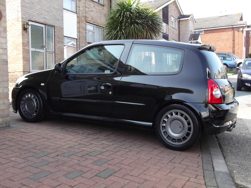

looks brill fella really like the mods how much is it lowered in front and back if dont mind me asking looking to get mine lowererd not sure were to start just yet =)

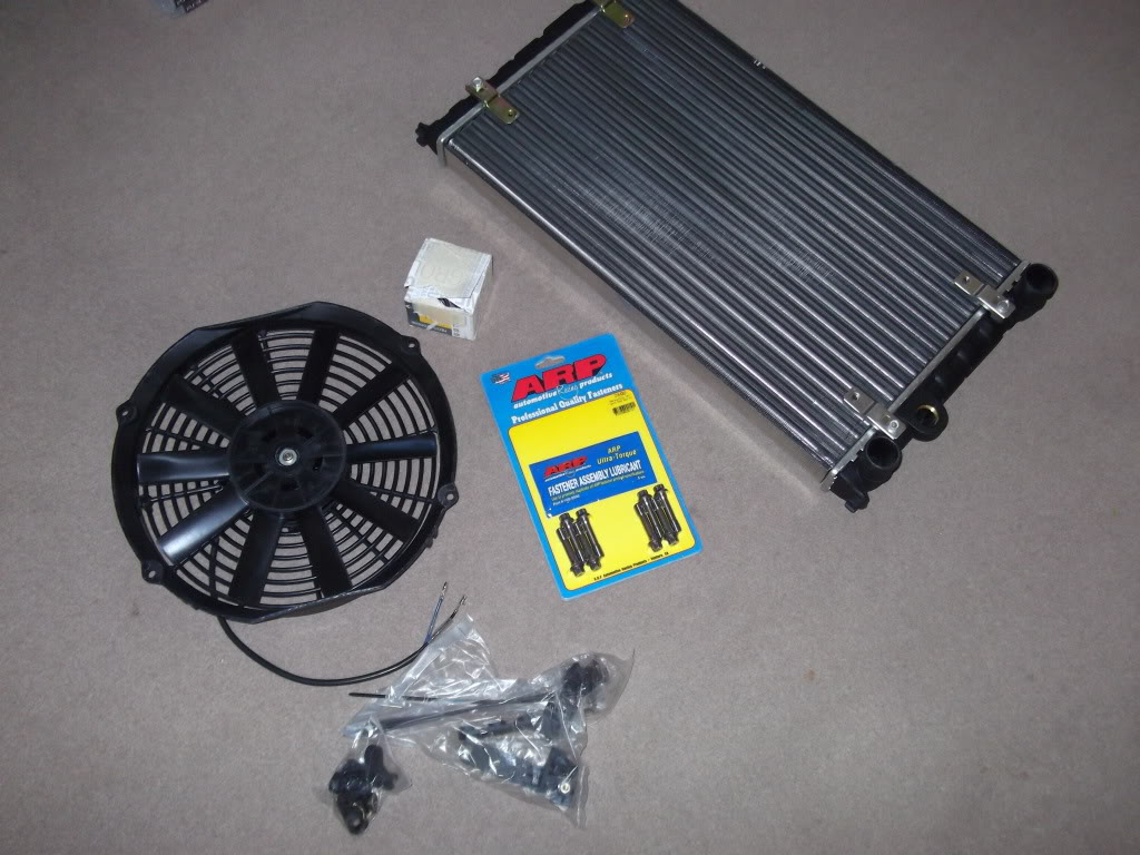

Little update,starting to get a few bits together
ARP bolts,polo rad with smaller fan(new thermostat as well)
Will be fitting this lot towards the end of the month as I only changed the oil a couple of weeks ago and will need doing again when the bolts are fitted,then it will be off to TDF in march to have the bodies fitted,going to hold off on the NOS set up for a couple of more months.

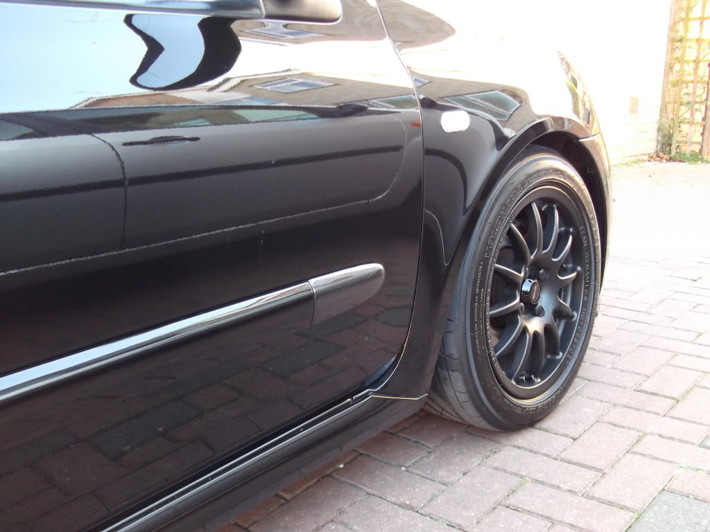

Thanks mate,not sure how much is lowered compared to standard,from middle of wheel to arch front 310mm and back is 290mm,these are only rough measurements hope this helps,car is on H&R's.

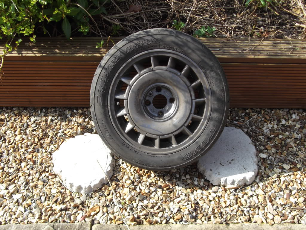

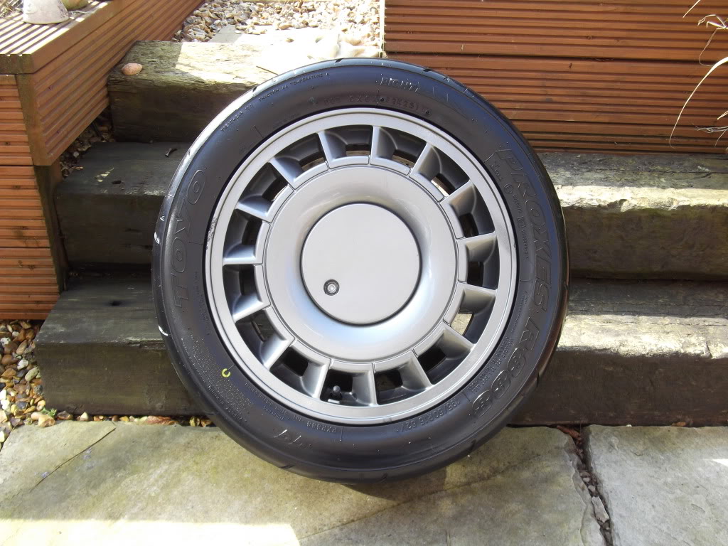

Picked up some Turbines wrapped in 888's on Friday night for a good price tyres have only down a few hundred miles on the road,so are not far off new really.The Turbines are in not too bad condition,but will be giving them a refurb myself with a rattle can,think I am going to do them a bronze colour.
As for the engine work,everything is on hold at the moment,I am starting a new business so that will be taking the brunt of my money.Hopefully if the new business go's well should be able to get the car finished by the end of the year maybe.
A few pics of the Turbines
Before a good clean
After a good clean
Put them on to see what they looked like and how they preformed on the road,not sure if I like them on the car(maybe need some spacers)but as for grip,they are awesome,can't wait to get to Snetterton next Friday to give them some stick.

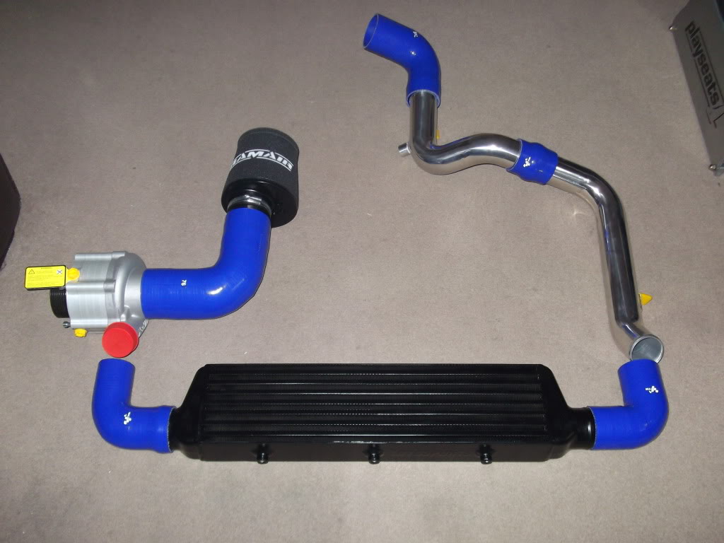

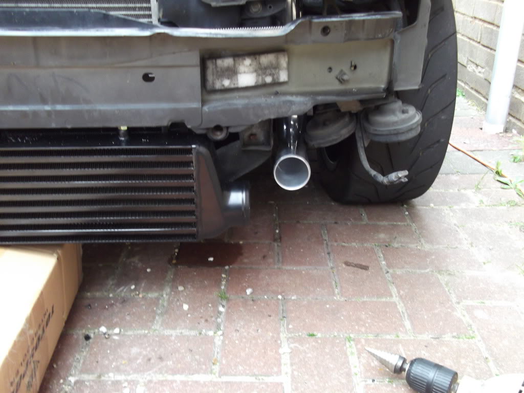

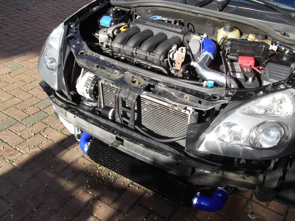

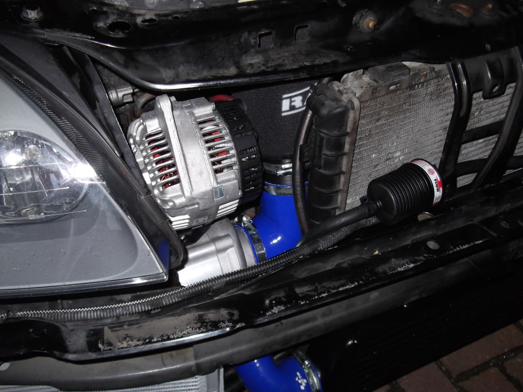

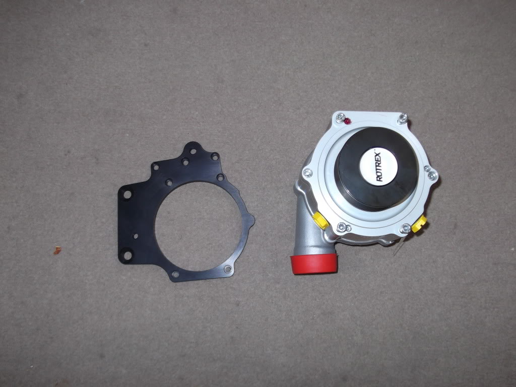

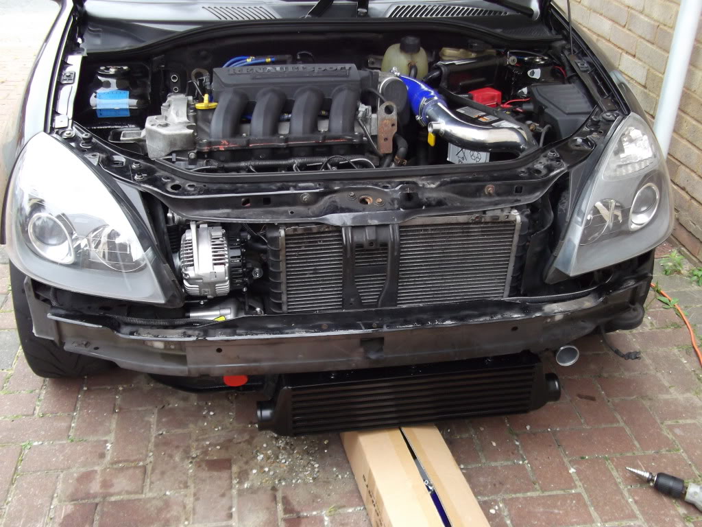

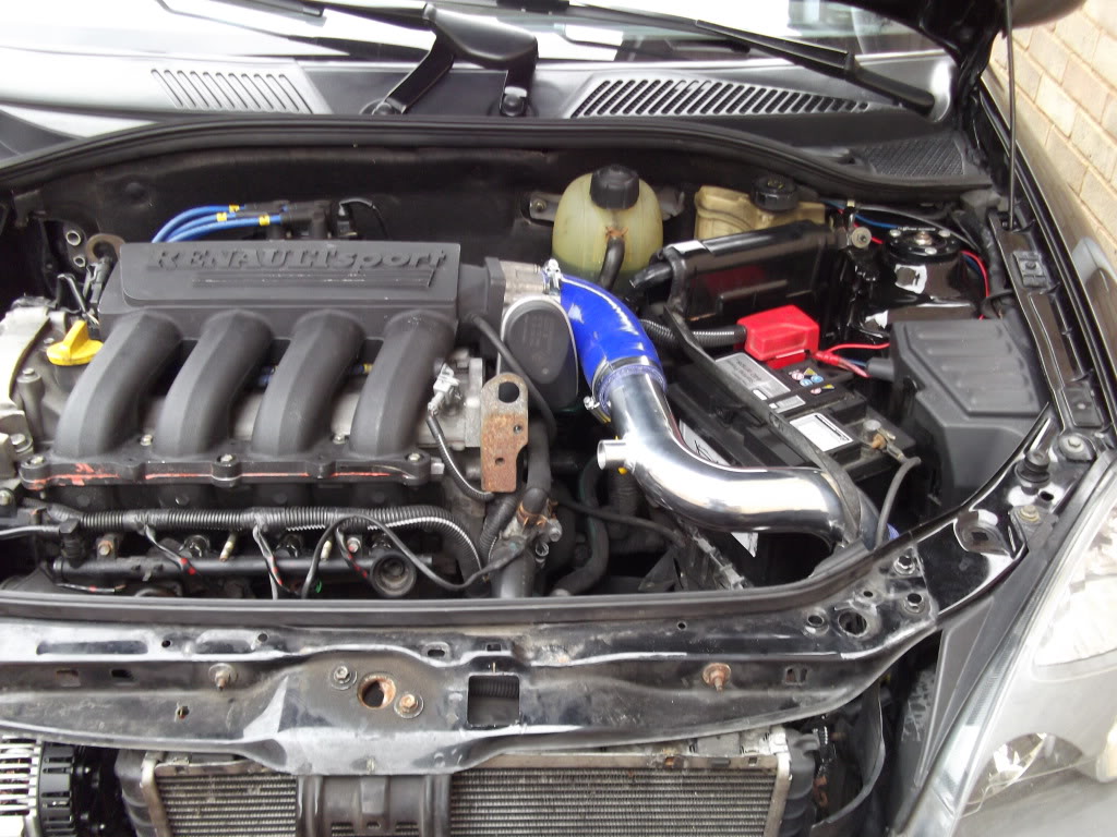

Not updated this for ages as I have been saving up to get a supercharger, well I have finally got one. I installed the kit with the help of a mate.
A few pics of the install.

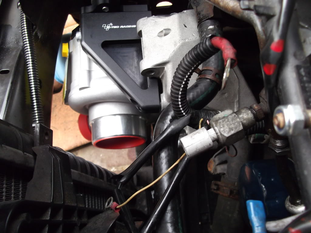

Fitting the charger was a bit of a pain due to me haveing the cup alternator set up, so had to bend the pas pipe again and put the power steering pump back to its original position. In total it took about 6-7 hours to fit everything mainly down to having to mess about with the pas lines, but all in all it was quite simple.
Once the kit was installed we took the car out a test run, the Gen 90 supplied with the kit had a base map on it with a 4.5 k limiter, the car started first time and the test drive went without issue.
We finished installing the kit at about 11 pm last Thursday due to not have all the bits we needed and I had to get up a 5.30 am to take it down to Ktec to have the car mapped, I was a bit nervous due to it being a 190 mile drive, but the car made it with no issues.
The car went straight on the dyno once the install had been checked over by Andy at ktec, everything was going fine the car had been mapped when Andy called me to the dyno room to see the car do some finale power runs. As the car was doing the first power run it just stopped, at first Andy thought the car had run out of petrol which I thought was a bit strange, checked that there was fuel and then tried to turn the car over but it didn't sound to clever. It seems the cam belt had slipped gutted.
When the car was taken apart I was told that the bottom pulley on the cam belt had not been done up to the correct torque which caused the problem. The car has got to have a new head:(
Well the car is being fixed with a new head, full cambelt kit and the all important Megane key way bottom pulley. Maybe I should have fitted the meg pulley from the off, as then then I maybe wouldn't be in this situation, but you live and learn and was told that it was a bolt not being tight enough not the lack of the meg pulley, I don't know what to think really so have just taken it on the chin. Ktec have done me a great price to fix the car and I should have it back early next week.

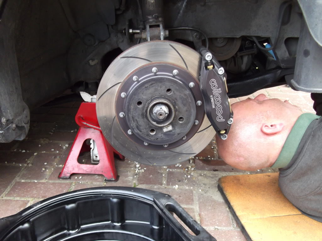

I have also uprated the brakes to Wilwood 4 pots with ap rotors, they came up at a really good price so had to snap them up, they are like brand new.

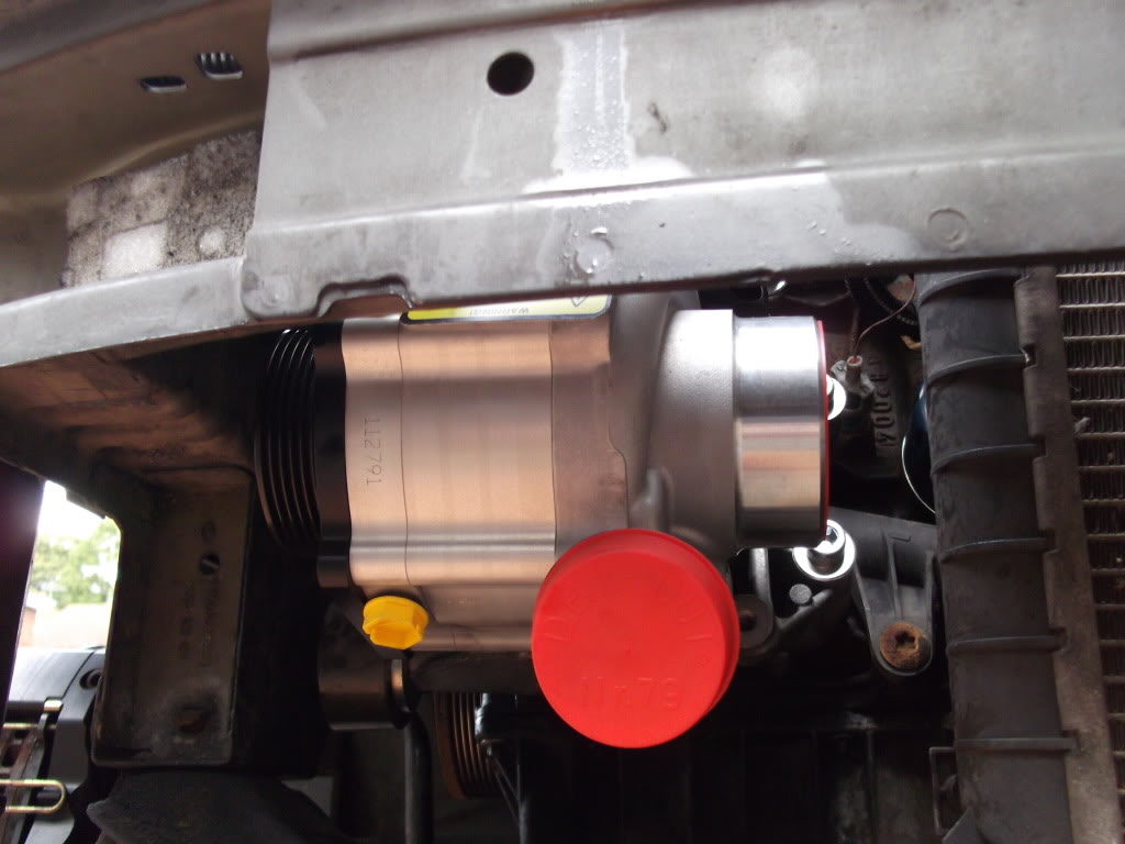

Thanks Dan, car will be at the FMS rr day, but I don;t think I dare put it on the rollers but will take you for a spin if you want. The supercharger brackets are a nice design, there is a bit of messing about moving the rad forward a bit in order to fit the charger induction pipe and air filter and is still really tight, I am looking at getting a different induction pipe that will put the air filter to the right hand side of the bay which will look a lot neater.

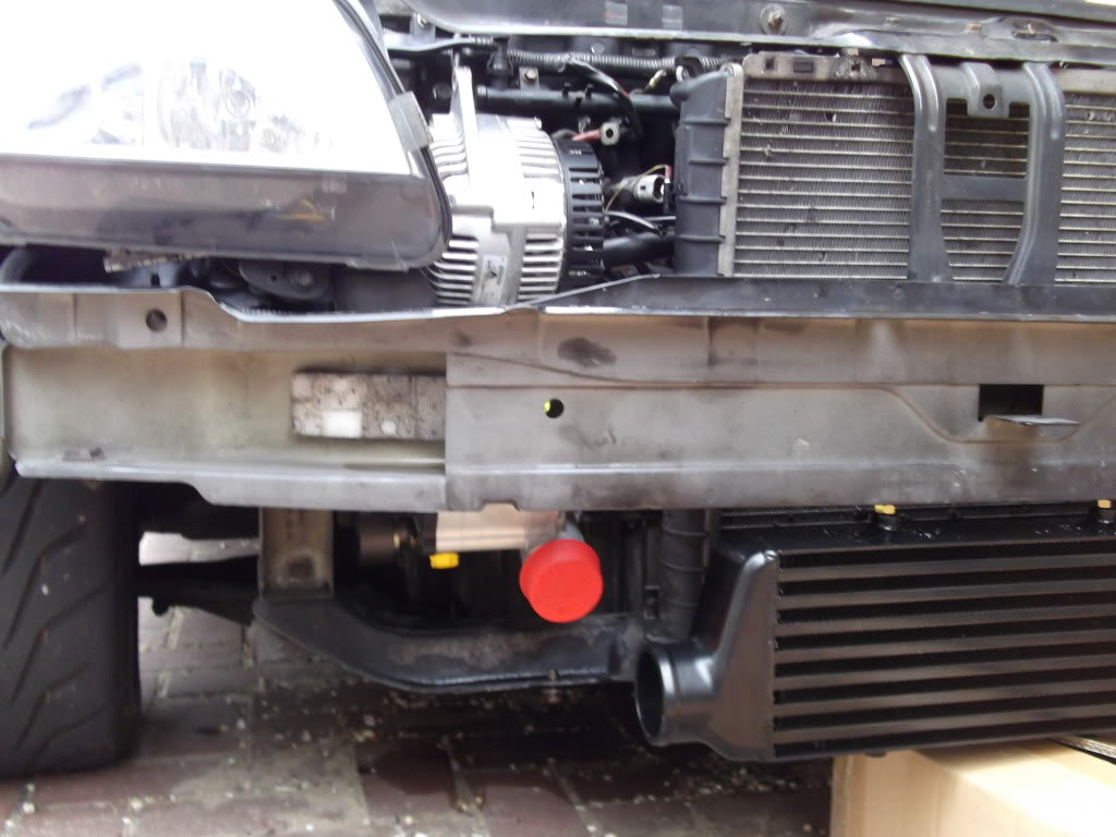

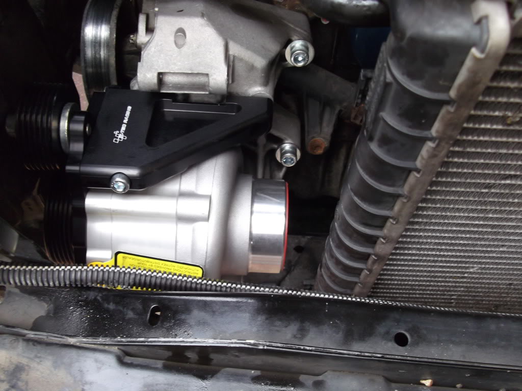

A few more pics of the install, oil lines plumbed in for the charger cooler.

Thanks Lewis, the install is very easy really esp if you still have air con as the charger takes the place of air con motor so you don't have top piss about with pas lines ect like mine.

Thanks mate, so if that just replaces the air con pump does that mean you use all the alternator brackets off the standard 182 engine and same belt?
I only ask as i've just fitted a cup setup on my 182 engine but still have the brackets off my old alternator setup.

The air filter won't fit there Dan due to the intercooler pipework, it will have to go under them pipes so will be to the right of the engine near/under the throttle body if you see what I mean.
  KTM 990 SD / S60 D5
Yes you will need the old brackets and alternator, I take it you haven't bent any PAS lines with it being out of the car.
