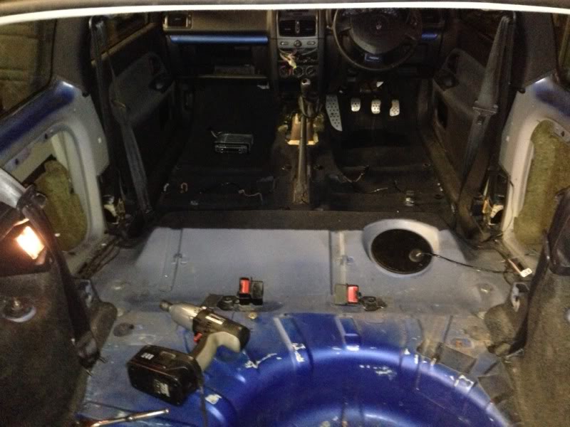

Small update.

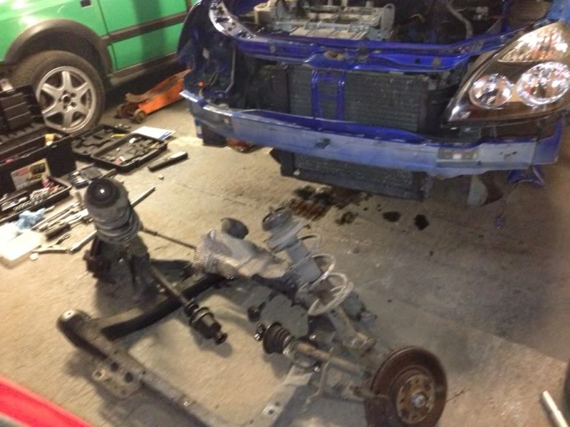

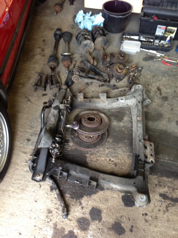

Home now so got a start on stripping down the car today ready for all its new parts and mods. I decided to start at the front removing the subframe, rack, suspension etc. It turned out that the frame dropped was all I was going to get done at the end of play. The car put up a big fight, I had 5 subframe strengthener plate bolts break and one of the subframe bolts, the rack heat shield captive nuts spun making it impossible to remove and get to pas hoses, union's rotted solid on pas hoses etc etc.
I got there in the end after buying a blowtorch to heat up pas uninos and 6 hours of crawling on my back shouting bad words. I'm a bit disheartened too as I done a compression test before the strip down and the results wasn't great, 3&4 were 210psi, 2 was 190psi and 1 was down at 160 but did go up with cranking for a bit. So it turns out the engine isn't the healthiest about but it goes like .......off a shovel so I'll persevere for just now and if it gets any worse I'll swap it out.
Safe to say I hate Renault Clio's just now, the only thing encouraging me is some of the nice bits I have to fit. I will fit my 197/225 4 pots that was surplus on my race build, got a set of 16" td pro race 1.2's in anthracite coming and got a cheap rear ARB and some spacers so should look good and go well......hopefully.
How it was at the end of play tonight.

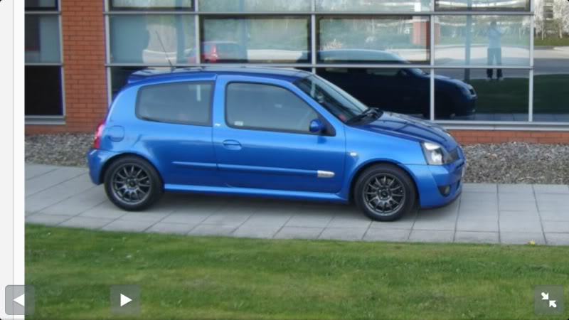

Opinions on pro race 1.2's in anthracite??? Picture below is 15" on someone's car on here I think, I'll be getting 16" and have a choice on the colour they go, I'm stuck between anthracite and silver (never seen them before in silver)
I had them in anthracite, in a 15 too! The colour itself is cracking, loads of flake in it and when clean they do shine!

Anthracite
Hides the brake dust ;)
Thats my thinking too. Silver would look fresher. I still haven't found a picture. 2 reasons, either it looks crap or someone never had the 16" changed to silver before.

Morgan, I'd say the anthracite will be a better suited colour, and certainly more forgiving in the environment you intend to be using the car.

Heres my old 172 on pro races and coilovers
Looks good, 15's need to have coilovers or cheap springs to look half decent.

Yeah I'm decided on anthracite, save me cleaning them too much. 1.2's are a good all round wheel for any car and there not that expensive.

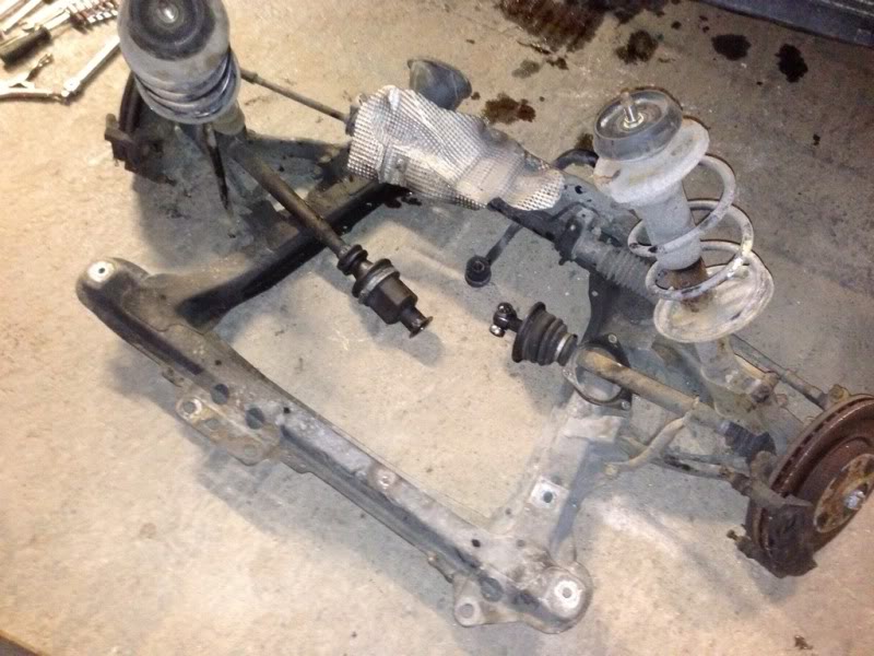

Broke down all the subframe, gave it a wash down ready for a paint and the new bits.

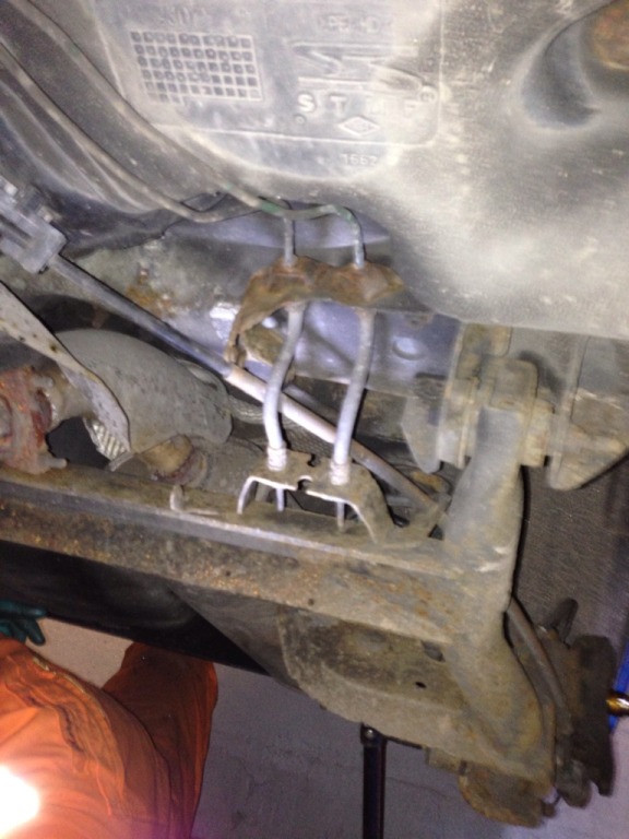

Spot the difference, someone's had a little too much fun here. It's part of the reason for the strange handling. A different way to adjust your caster.

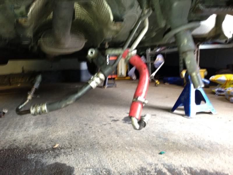

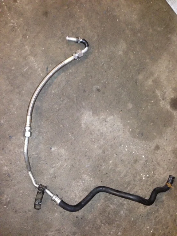

Someone's bodge on the pas low pressure line, off to Pirtek tomorrow for me!!

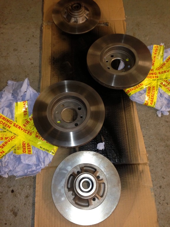

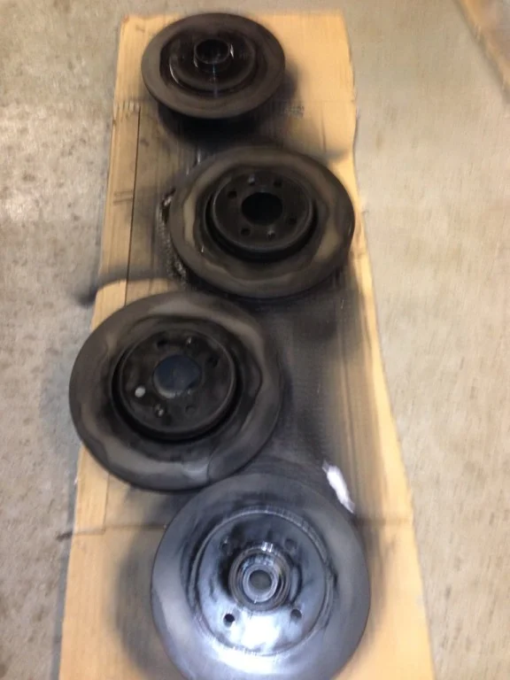

Had my mate skim and blast a set good condition disks.

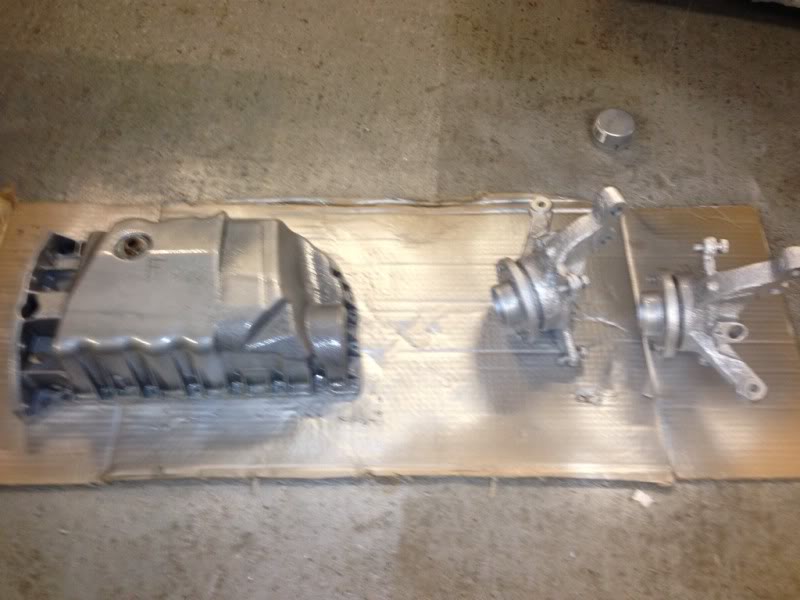

Removed sump, cleaned and painted hubs and sump

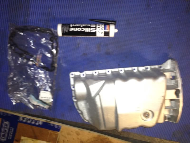

Sump ready to go back on with new gasket after checking over oil pump and main journals and big ends, all ok.

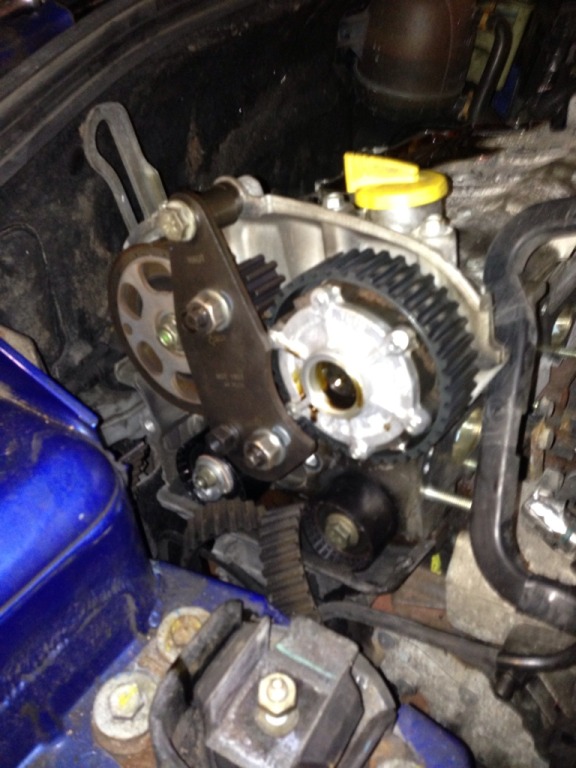

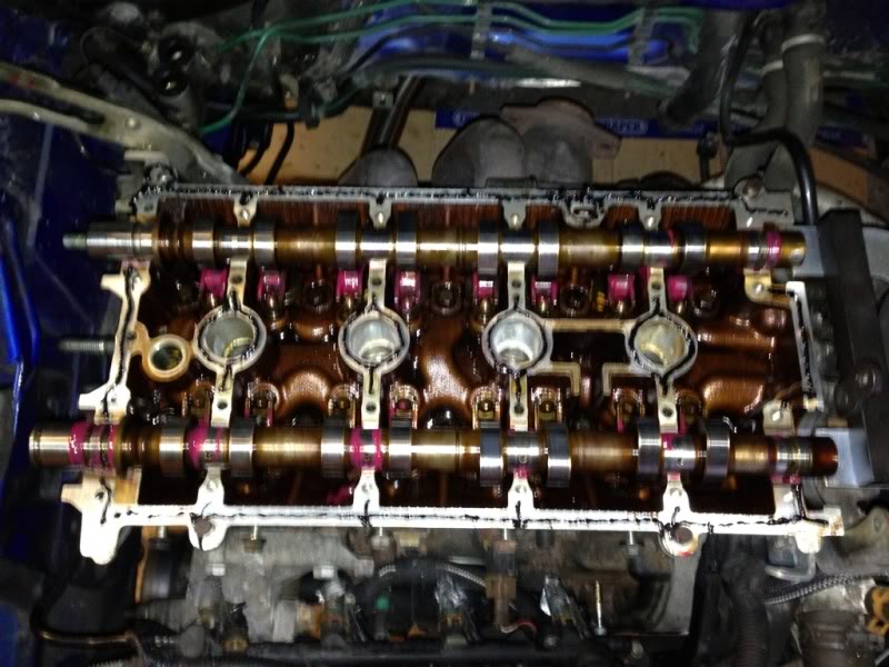

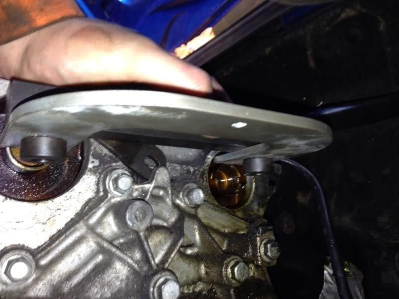

Tried to throw in timing tools to give it a quick check before removing, inlet cams a 5deg out :S ....No sign of the tippex timer so must have been done wrong with the right tools

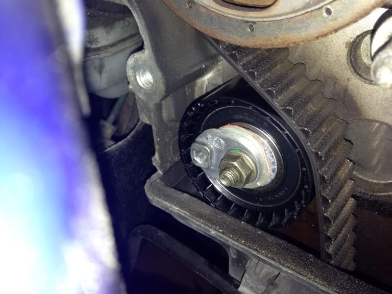

Fred won't be happy with this one either....
It does have an almost new dephaser and belt but will do the belt just because it was cheap and I in there.

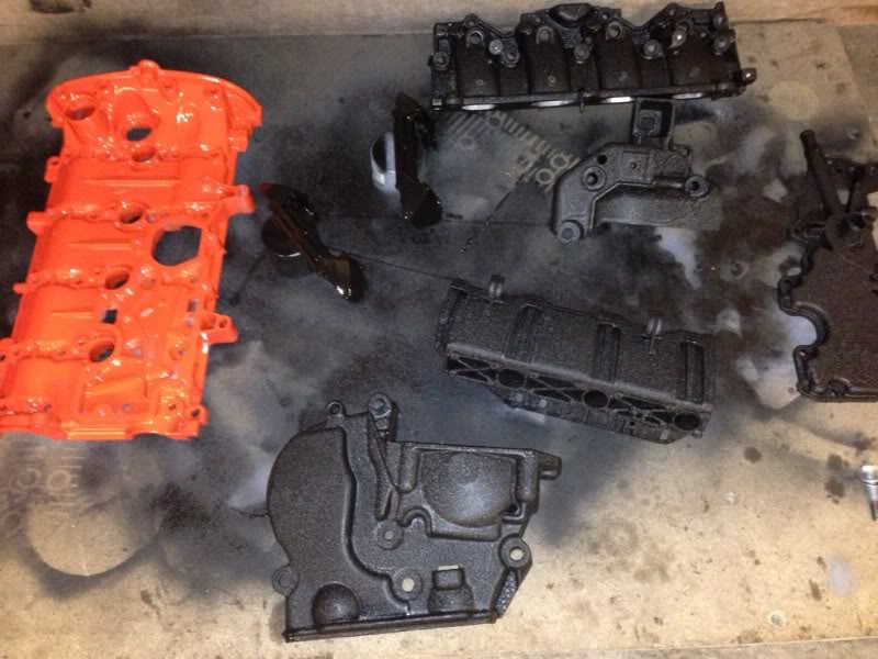

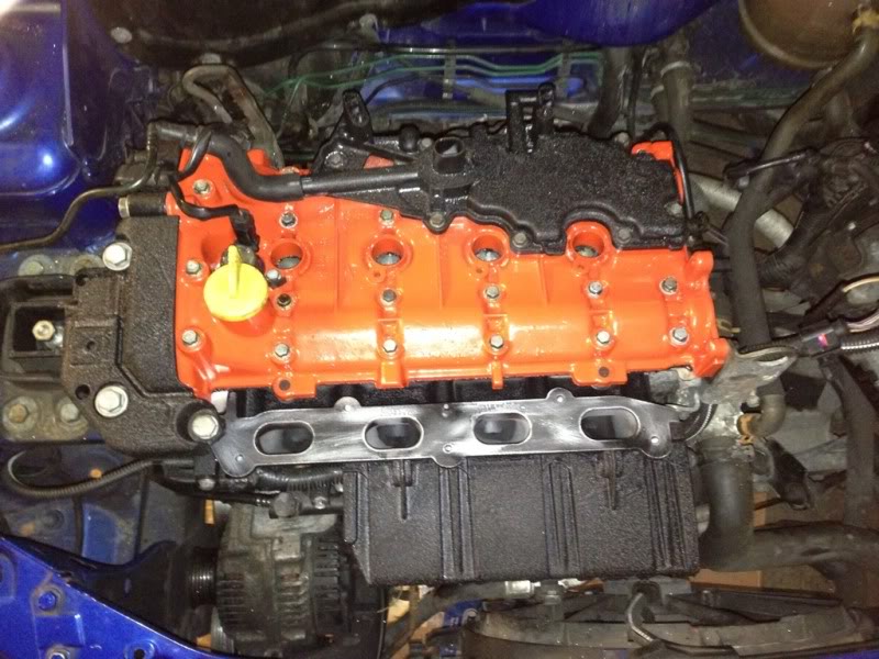

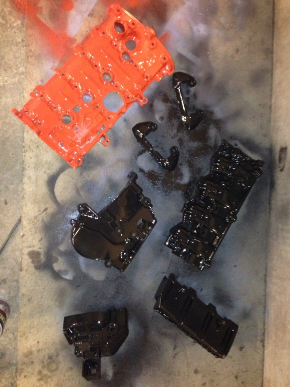

Cam cover, inlets , engine mounts etc are all away for blasting and will get a coat of paint before going back on.

More done today, I was held up with waiting in blasting and my mates ST needing some suspension. Car will be running and back on 2 wheels tomorrow, I'm waiting on rear disk spacers before I can get it on the ground.

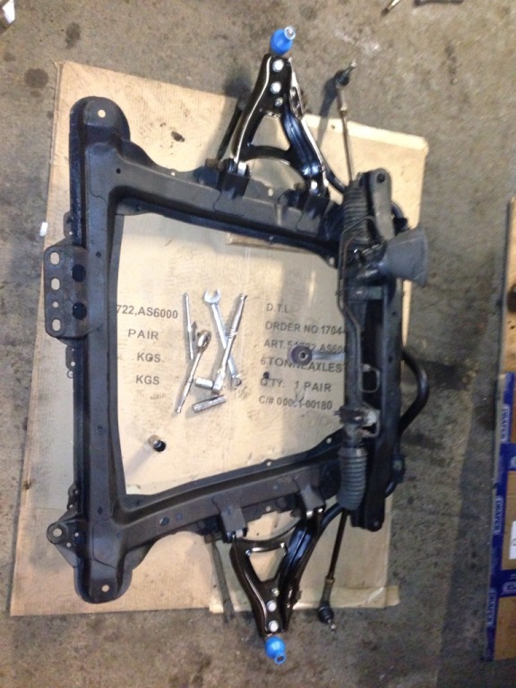

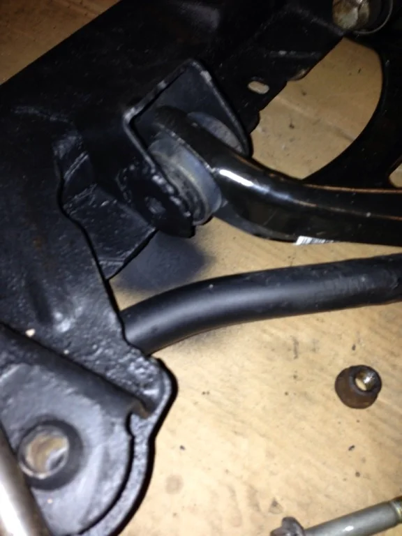

Subframe painted and rebuilt with new tie and track rods, bottom arms, painted ARB and replaced bushes.

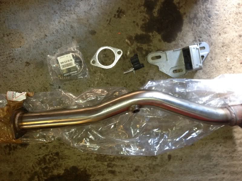

Un used decat from the racecar and new hangers and gaskets fitted

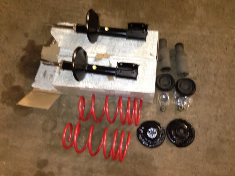

Built up struts with new top mounts & bearings, Eibach sportlines and painted spring cap.
Had Pirtek make up a repair hose for the bodged repair on the pas pipe.
Got all the pieces back from blasting by my mate tonight so gave them Ll a coat of paint, graphite grey never turned up so the cam cover went orange and everything else crackle black.
Crackle paint starting work after some time with the heat gun.

regarding the timing tool pic, how do you if its out? does the tool have to be level? (this is an area I have absolutely no idea in).

LOL @ the cambelt tensioner!
Thought you would like it.
Everything has been bought for it, no more should be spent other than fuel,insurance and a couple of track days, all my £'s and time will be spent on the race car when it returns from paint. This thing should be a nice little b-road blaster.
Yeah the tool has to be level and slot into both cams easily (the grooves are off centre on the cams and as you can just make out on the pic, the small section is on the top when it should be at the bottom, the crank is 180 deg out in that pic) when no1 piston is at TDC (top dead centre, i.e top of its stroke) and when the crank pin is in you tension the belt and lock off all the pulleys.

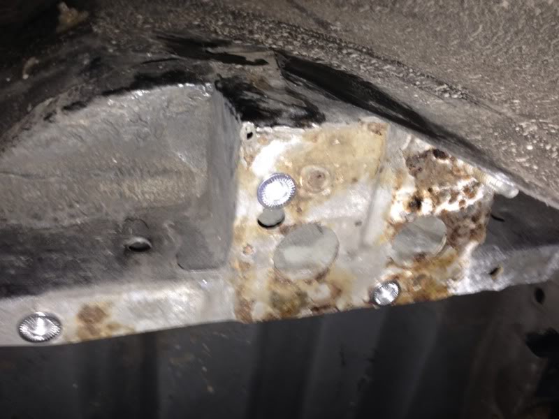

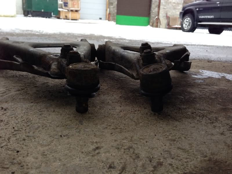

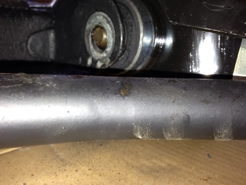

The car was snap steering over bumps when out in the road, I found a buckled wishbone on the o/s but after further investigation the subframe hole was enlarged causing the car to steer when it wanted.
Welded on a repair washer so that should be sorted.

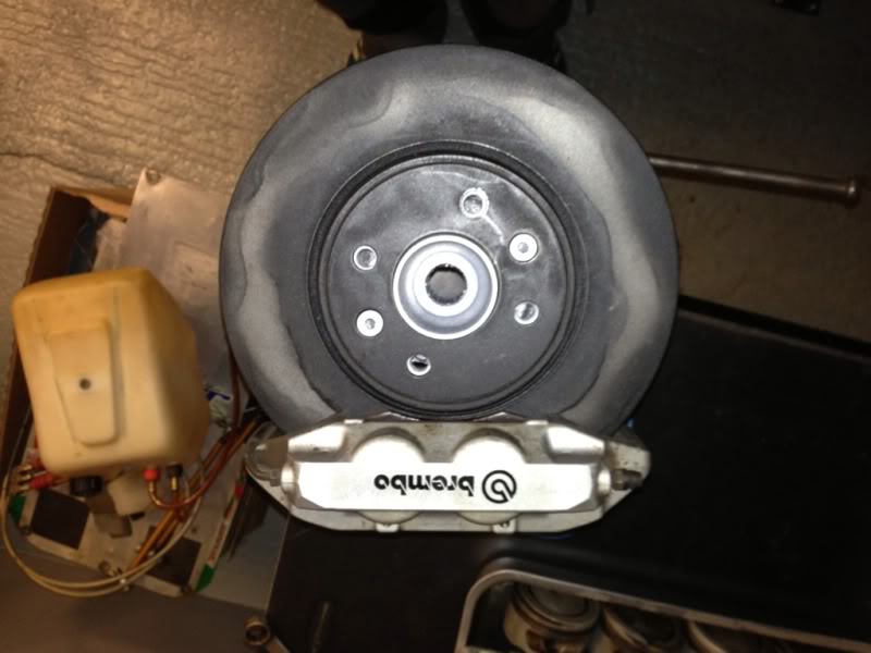

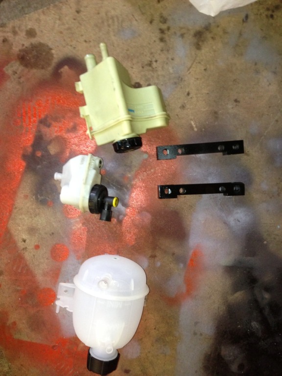

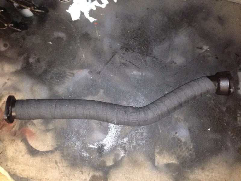

Wrapped and painted decat, painted Brembo mounts and cleaned brake and pas fluid bottles, new coolant bottle.

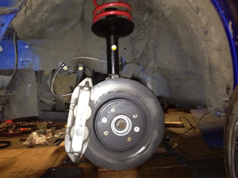

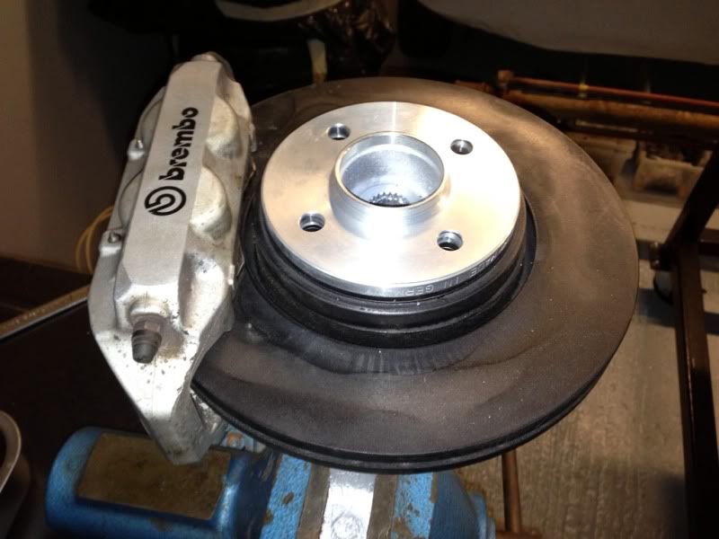

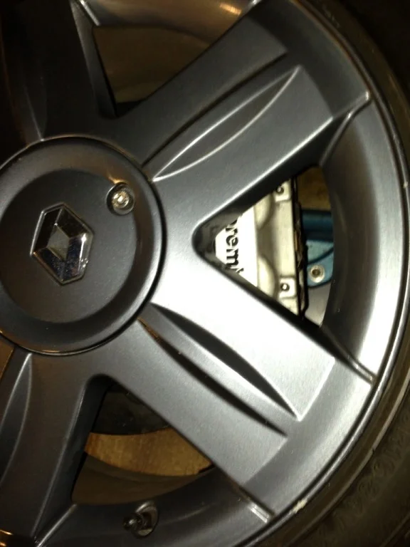

Mocked up brakes

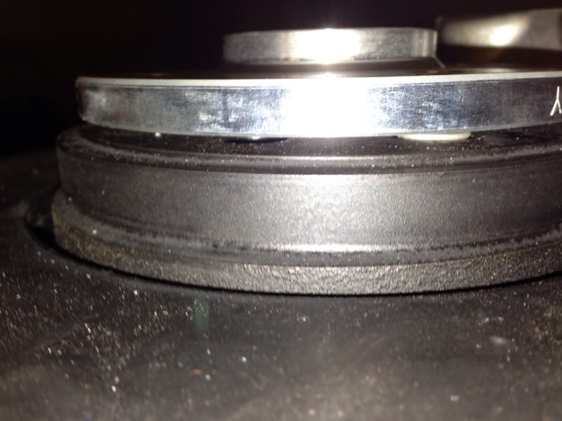

Spacers arrived but they were 4x10mm instead of 4x20mm, the spacer spigot isn't even deep enough for the hub spigot (some machining needed or wait for new ones to be sent)
Wheels clear with 15mm spacer if needed

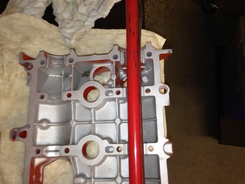

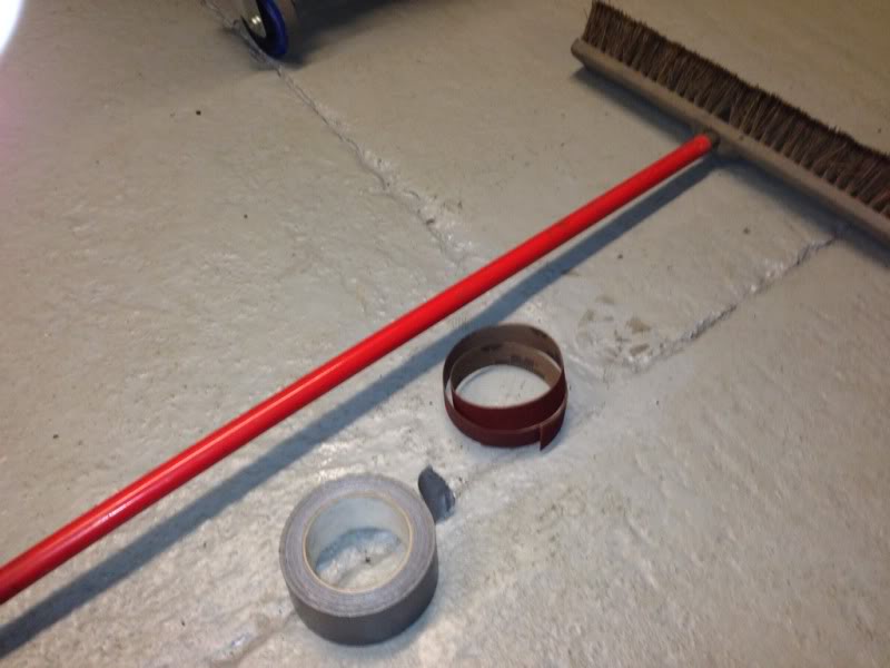

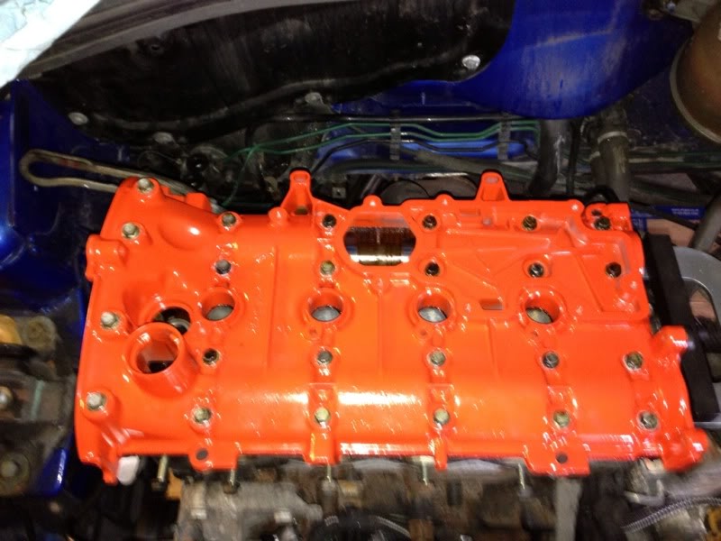

My mate blasted my cam cover for paint and done the bottom despite me telling him not to, cue some barn yard engineering with the cam journal polisher 3000.
Take a brush, emery cloth and duct tape.
Remove brush head and tape emery to handle.
Voulais, a polishing tool lol.
Cam cover ready I bolted it down ruining all my nicely painted cover :mad:

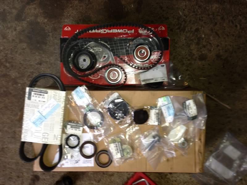

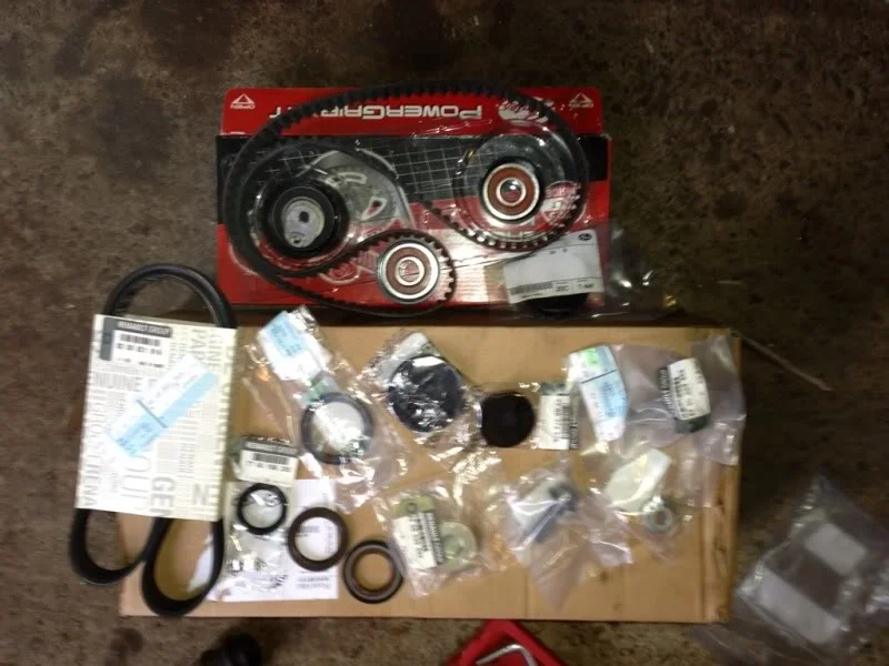

All new seals, bolts, nuts , belt kit etc.
Everything bolted together, waiting for inlet to dry before fitting. I'm pissed that I threw away my RS stamped lower inlet from my racecar as I didn't have a use for it at the time.
I just set the cams to standard timing until the mot is passed and then I will have a play with either semi group n or full group n settings.

With regards to the blasted cam cover, are you not concerned that the removal of a few microns of material from the bearings, and a change in surface roughness will stop them from working properly? Especially as it is the top half of the bearing that will be doing all the work reacting against the valve forces.
  Cup In bits
Yeah slightly worried but you can only piss with the c**k you've got. I'm more worried about the lower compression on one of the cylinders. You can take a fair bit off them without issue on this type of thing unlike a big or small piston end or crank journal. It was a wet blaster that was used too so not as harsh as sand blasting, I polished them back upto a half decent finish and the cams will do the rest come time hopefully. Only a couple of £100 to put right if the engine goes, if it was a expensive race engine I can't say I would be doing the same but it ain't as bad as it sounds tbh.
  182FF
Fair enough mate I hope it holds out, should do. Am I right in thinking it's a liquid gasket that seals the gasket cover? That'll help seal it now it isn't a shiny surface!
  Cup In bits
Yeah liquid gasket so it will take up any slight imperfections. I'll know soon anyway as I'm away to start it
  182FF
haha just came back to edit my post since you've got a picture with the liquid gasket on page 1!

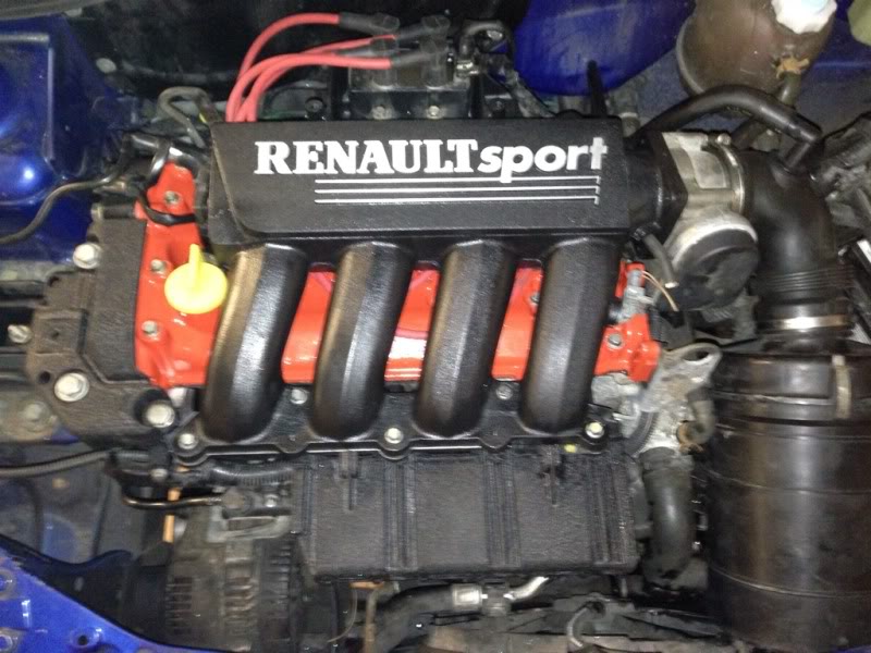

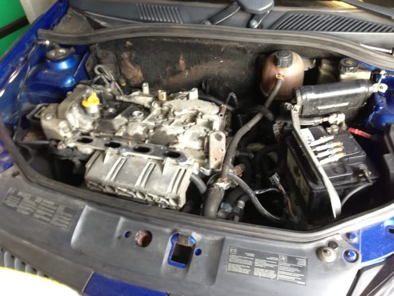

Got some more done, got all the fluids in and started it up, subframe on and suspension built up. The car wants to idle at around 2k then will drop down after you hold the revs up for a while. I will swap out for my spare TB to see of that helps, it looks to be pulsing on idle.
Almost finished bay, just needs a big clean and some heat shield on the bulk head
I fitted the brakes, just need to bleed system when rear disk spacers and nipple finally turn up, they were due today.

How do you have no rear brake compensator if you have no ABS? What's limiting the fluid distribution to the rear?
I r confused lol
Compensatirs are usually fitted irrelevant if its abs or not, If I do have on then its not in the same place as my other cup and I have yet to find anything compensator like lol.
Brembo's look great! Fantastic progress.
Cheers, they really need painting but that can wait.

Found the pas fluid leak, tightened dodgy union on the pirtek hose I had made and topped up and bleed the steering.

Fitted new rear disks and brembo pads with stub axle spacers after removing 5mm off the front and back hub spigots to allow 10mm spacers.

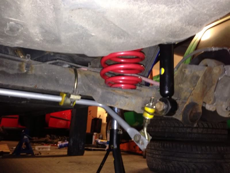

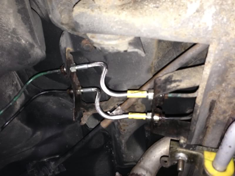

Fitted the rear braided lines that came with the 197 front hoses and flushed system with ATE super blue fluid.

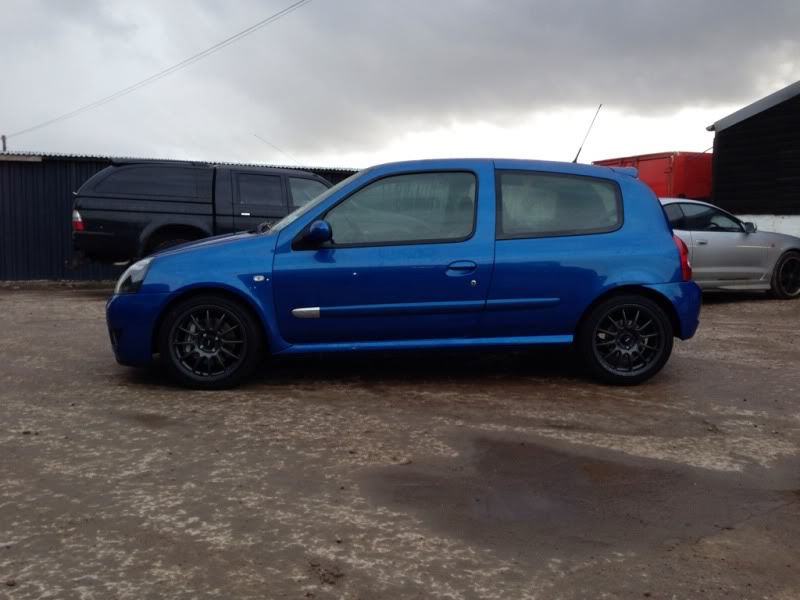

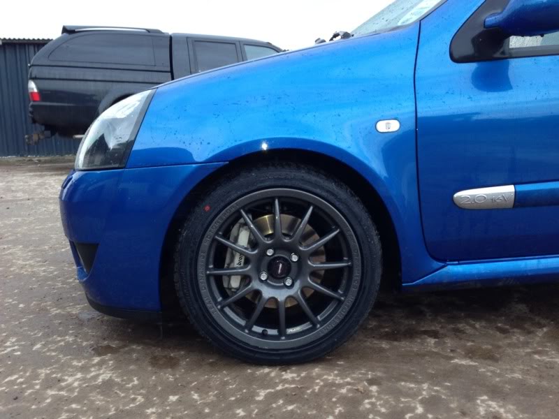

Tomorrow my new pro race 1.2's will be here that have been freshly powder coated in anthracite, I will get the new hankook s1 evo's fitted and chucked on the car, I will remove clean and swap out the interior for half leather/alacantra and potentially fit the buckets, harnesses and steering wheel after I have a word with the tester.
That will just leave giving the car a quick wash and a good road test to scrub in the brakes and tyres ready for a track day on Saturday if I'm not punted away to work.
Pictures will follow tomorrow.
  Cup In bits

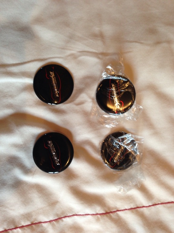

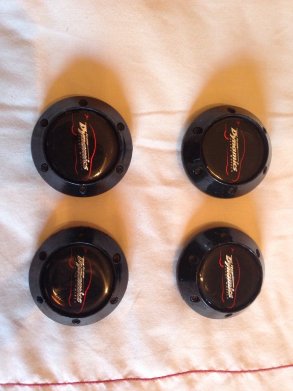

So.....got a bit more done finally after the wheels arrived. They turned out to be et40 wheels as the seller was clueless. Bit of a disappointment as they came damaged after being freshly powdercoated and a few other bits wrong with them like no spigot rings and badly fitting centre caps, i'm going to persevere with them for just now and get the damaged ones re done at my leisure.
Earlier in the week I contacted Team Dynamics and had some new centre badge stickers sent out.
Removed old, cleaned and fitted new.
I got the tyres fitted at my local Kwik Fit and realised they had just had a new Hunter alignment machine fitted so I'll give them a go when the geo is getting done, can't go wrong at £40 with me watching over them. I think I will cancel my geo and MOT tomorrow, I'll see how I feel when I get up.

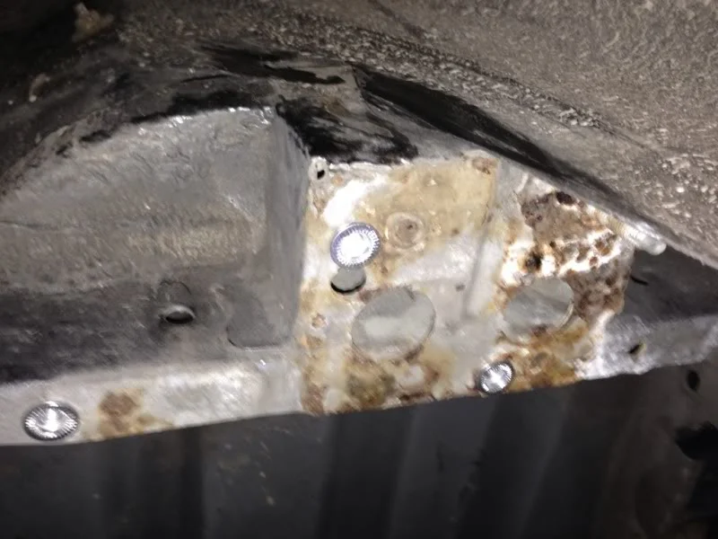

All the exhaust hanger bolts had broken when I got the car so I drilled and fitted some rivnut's with my Memfast rivnut tool, loving the tool tbh, makes fitting rivnut's a doddle
Hoses I fitted last night.

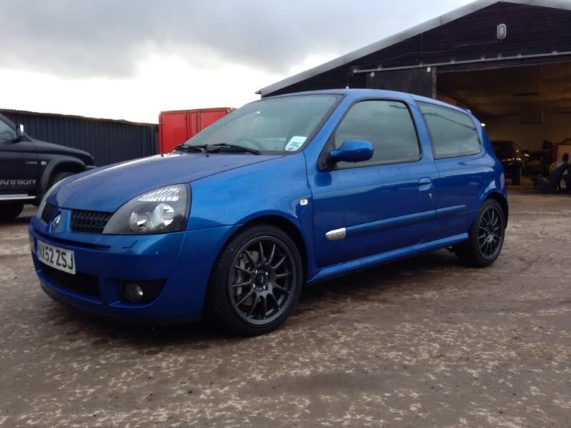

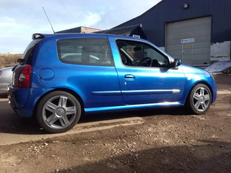

So I got the car back down on the ground finally with 20mm spacers up front and nothing on the rear, I plan to have 10mm all round come time when I get the right bolts, this is now possible after modifying all the hubs to accommodate 10mm hubcentric spacers. I went for a quick run and the brakes are rudiculous and aren't even bedded in yet, I have some DS2500 pads to fit too :S
Its sitting with a fair bit of rake just now which hopefully the half leather/alacantra will go some of the way to level out.
