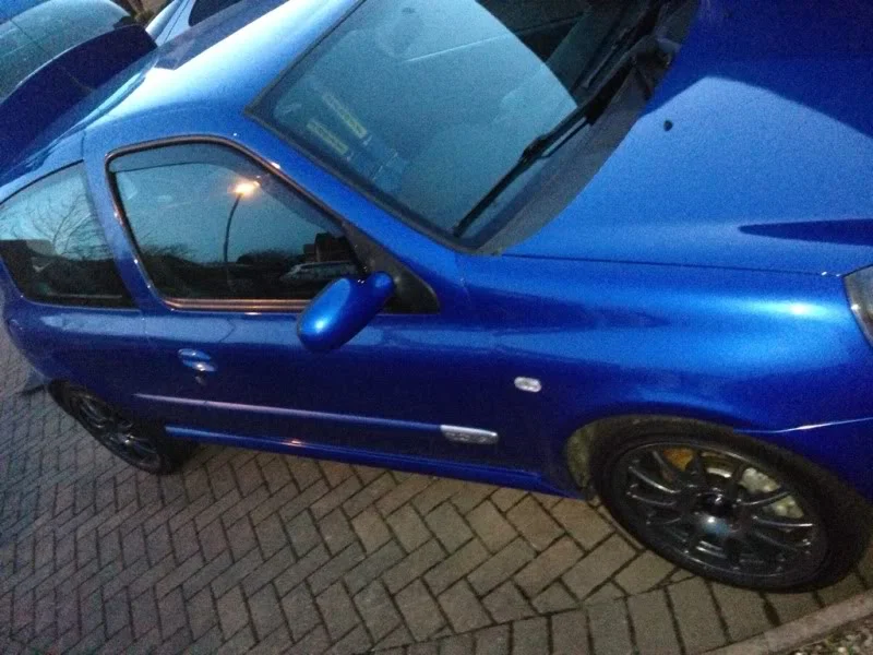

Another Clio 172 Cup Road/Track

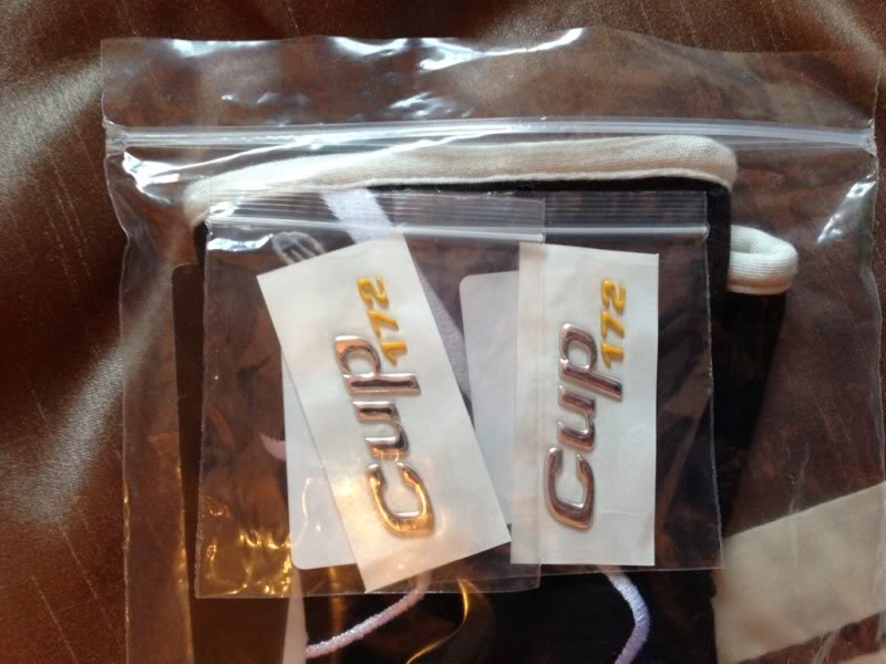

Bought one of these to keep up with the kids.

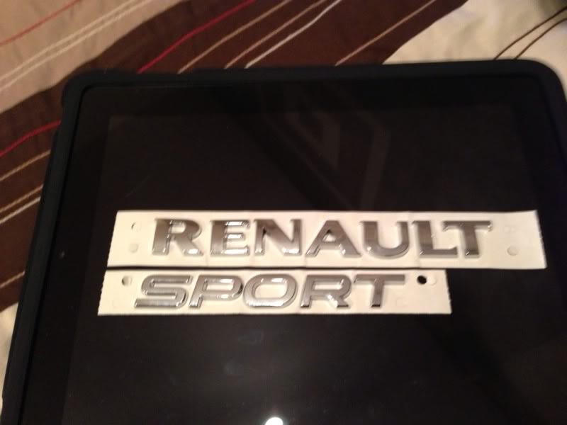

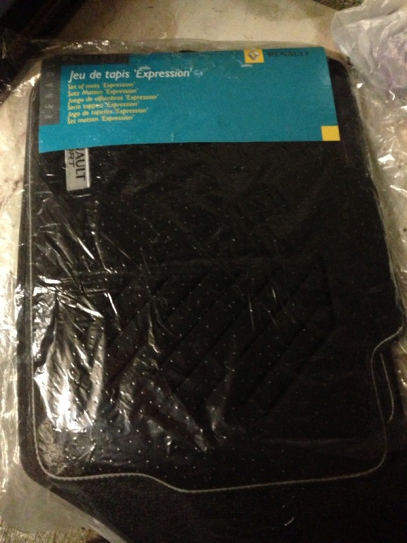

Stupid money tbh for what is just bits of plastic, so that's 3/4 plates and new badges.....what next. Oh and Renault sport mats
Your one of the cool kids now mate, does look good though.
FLOL

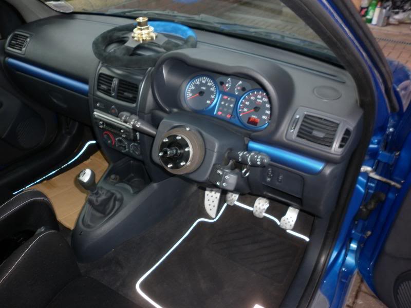

The car went in for its MOT yesterday after fitting the full fat interior and mats, I played mix and match with all the best plastics and trim from both my cars and the half leather interior so its looking good, fair bit of difference between interiors on the 52 plate and 53 plate Cups. Main difference is thicker carpets in a different colour, I kept the lightest version for just now.

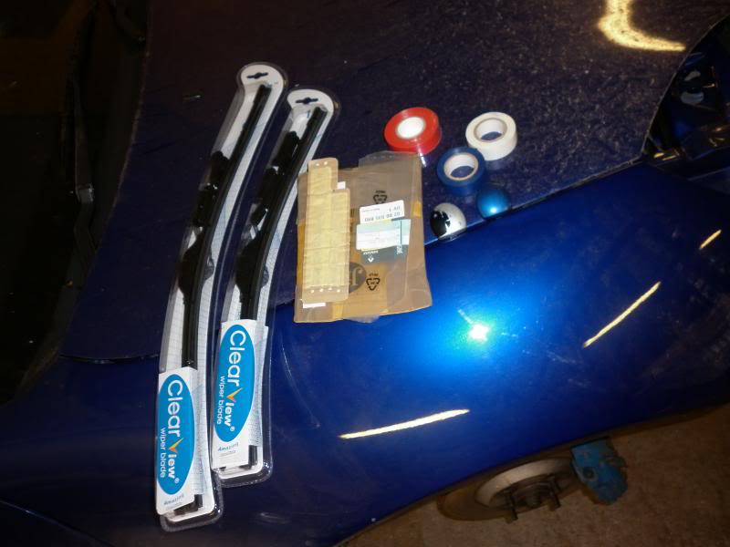

Window washers (stupid oversite) replaced the pump and its good now.
Headlight adjustment, ball joint had popped out on the n/s light adjuster, sorted.

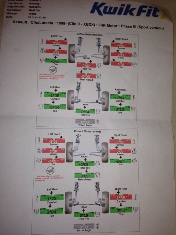

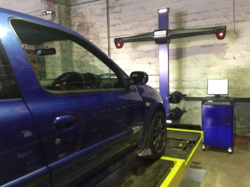

I went from the test station down to Kwik fit to utilise there new hunter allignment machine, well impressed with it tbh it's so sensitive. I done the allignment with the guy as he wasnt sure what a minute was or anything tbh. It turned out slightly off which will be sorted in a week or so when everything has settled, not bad for a £20 casher.

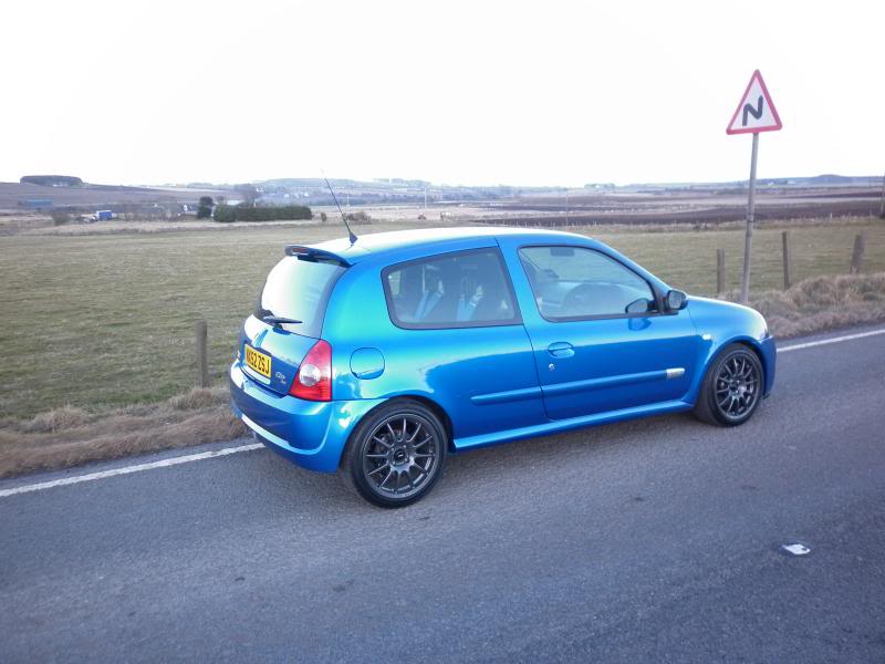

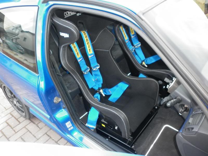

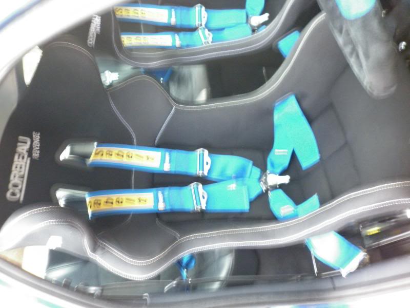

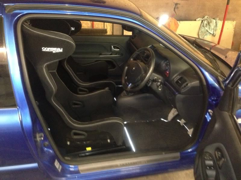

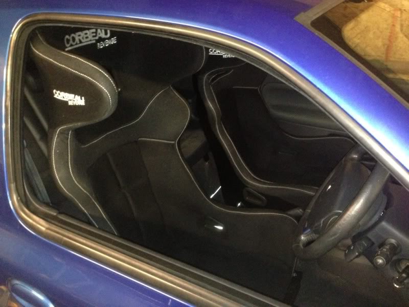

I went for a blast (private road) after fitting the seats, didnt want to go too far without seatbelts but I'm well impressed, the cars very front biased, not sure if its just the RARB doing it or what but I like it, I will fiddle with the roll bar over the next week and then maybe have some more camber and toe out on the front depending on what it turns out like.
Good stuff passing the mot!

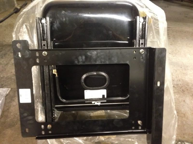

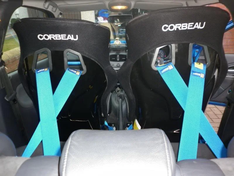

Love those seats and glad the runner came in handy. Did you get the seat low enough?
Aye glad its finally got the golden seal.
The seats are nice but a real tight squeeze in a little Clio tbh, Im tempted to get non winged seats come racing time. The runners don't want to work with the seat in place (unbolt the side mounts and it slides :S) so i'll check that out so It can be moved back and forward. They allowed me to mount the seat a lot further back and the end result was the base is probably 50mm lower than standard which is well needed with the 'ride on' standard seating position and my lanky frame. Racecar is hopefully getting painted this weekend as well so I'll get to use your spacers soon too...thanks for both.
Get some pics up of the spacers. Interested to know how they'll look at 30mm a side.
Is the runners lined up square and is there any bolts catching when they're trying to slide?
I will when I get a chance to fit them mate. I'm looking forward to the results, might need a fud hair off them with other shims in there but better to be too thick so I can change them.
That was my thoughts as well but I used predrilled holes on the base frame so it should be square, it was pitch dark while doing them so I'll get a look tomorrow in the light.
Maybe you have to use smaller headed bolts as it may be catching on the bolts you have used. I had Recaro sliding frames and they used small flat headed bolts
The side mounts are probably pulling the runners inwards slightly - causing too much friction for them to move
Sorted it today, I originally bolted the runners to the side mounts and then bolted that to base frame which was pulling them in at the back causing it to bind, I had used M8 bolts with no washers so that wasn't an issue inside the runner. Slackened all base frame to runner bolts and it glided back and forth, secured with the seat in place. That's what happens when you work by torchlight :dapprove:

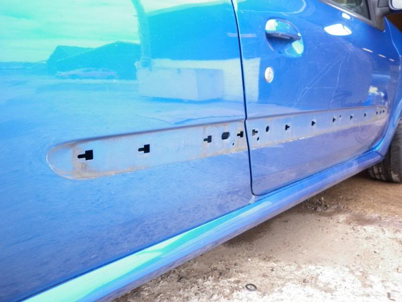

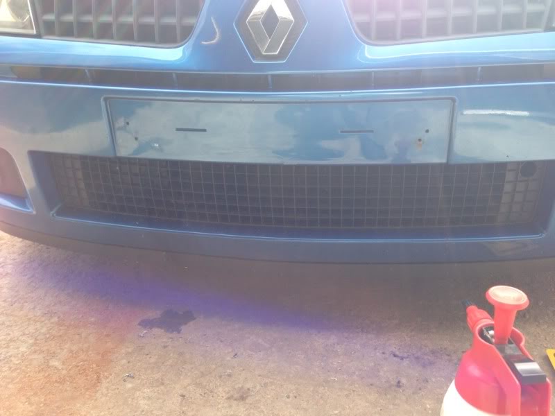

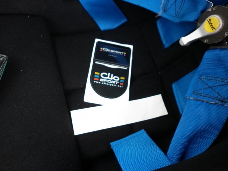

Removed the old plates and gave the recesses a good clean with petrol.

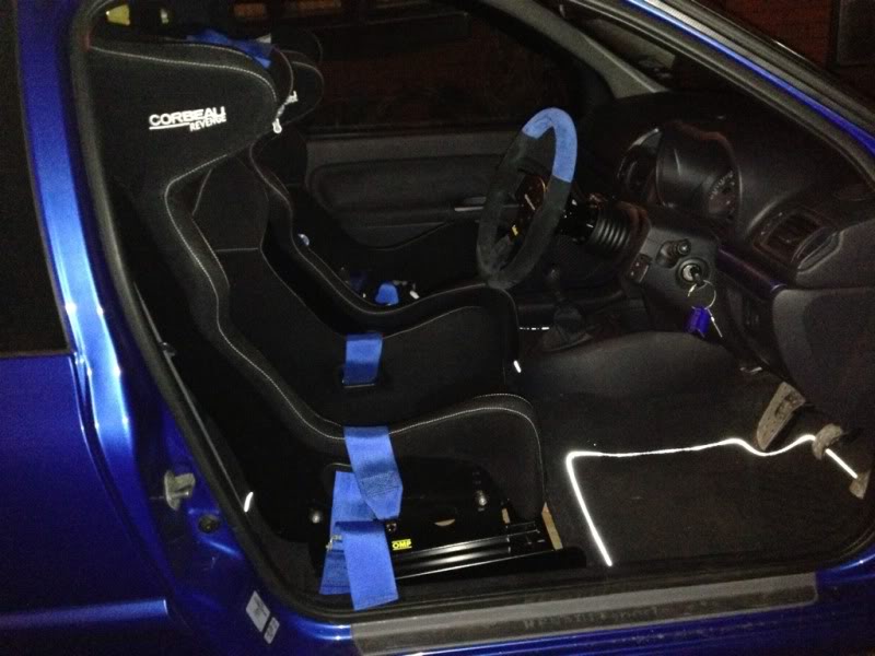

Had a hand from my mate to fit harnesses at the right length, he sat there as a manakin basically the whole day, I also moved the drivers seat over 20mm to the inside to allow it to move back and get a good bit if tilt, solved the sliding issue as well and theres no rubbing issues with the seat wings so I'm chuffed with that.

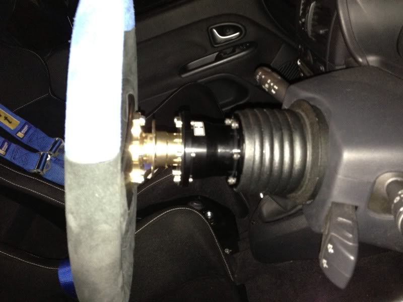

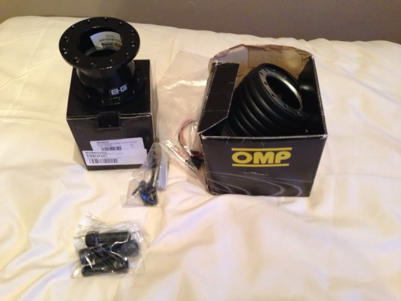

Fitted my R-sport wheel with a cheap bolt on snap off boss (got it off here and I cant remember the lads name but thanks for that) also I have Iceman's main boss with electrical connections built in for wheel buttons, need to do some work on that before it goes on the racecar.

Looking good. Regarding the frames, I put a few metal washers on the transmission side to even it out a little.
Yeah if you just leave the standard seat spacers in on the gear tunnel then they are perfectly square, not possible for me unfortunately, you can barely feel it, looks stupid from the rear view though.

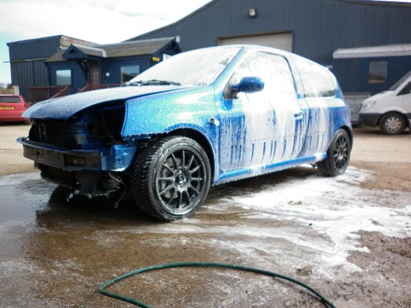

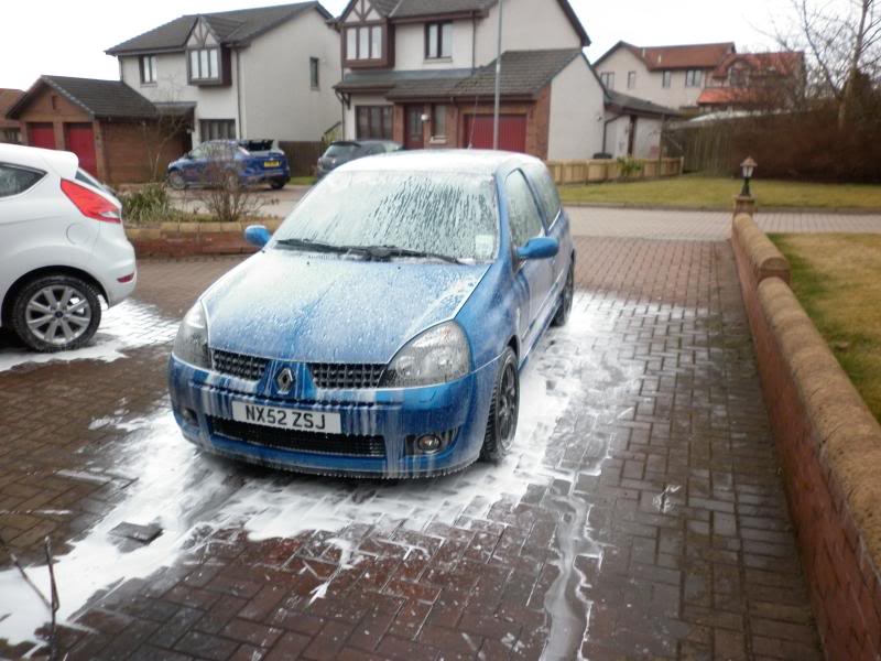

So over the last few days I have detailed the car, probably the only one it will get so spent a while doing it. I like to take the first clean in my ownership to extremes so that its easier to keep up. I also fitted some new badges, wipers and the CS clobber. I'm still waiting on new b pillar badges, PMS stud kit and spigot rings and I will then detail the arches with a bit of paint and seal my wheels. Interior needs front door cards fitted and a full going over too.
Steps were
Snow foamed with AS actimousse XLS.
Jetwashed.
Wash mitt and some more XLS.
AS fall out remover.
Tardis.

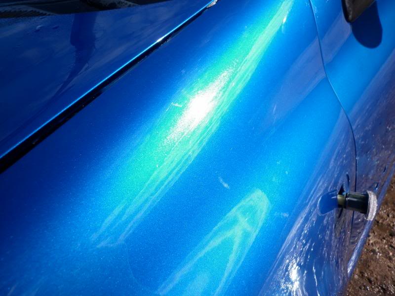

Clayed.
Compounded with Mezerna 301 (iirc)
Wipe down with Megs quick detailer.
2 coats of Wolfs body wrap.
Plastics treated with Megs ultimate protectant.
Tyres done with Megs endurance tyre gel.
Not the best pictures and my camera miss placed a few too somehow but you get the idea.
Day 1

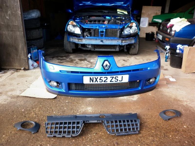

Stripped all trims and bumper of the car
Snow foamed
Couple of before's
Built back to drive home.

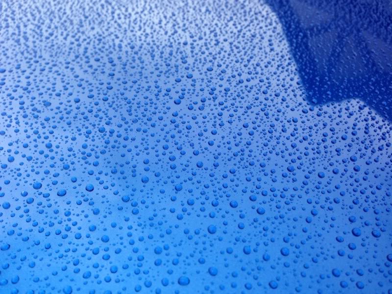

Woke up to a bit if rain, beading after one coat of Wolfs
Car wiped down with detailer, lights polished along with front and back bumpers, 2nd coat of Wolfs, all trims dressed prior to fitting and tyres shined.

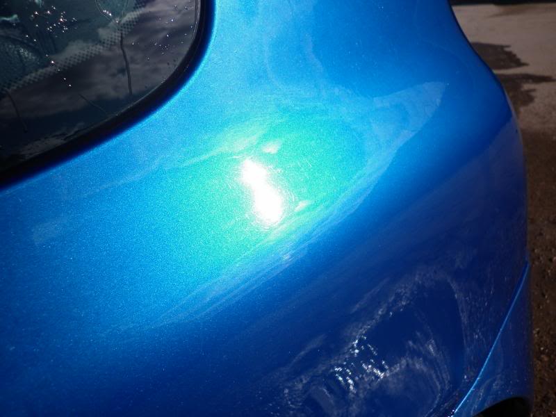

Finished product, overall pretty happy but the front and back bumpers could be doing with respraying to be perfect and some more time spent on deep scratches, can't see myself doing the painting though as its not a keeper.
Excuse the new badge position its covering a big scratch.

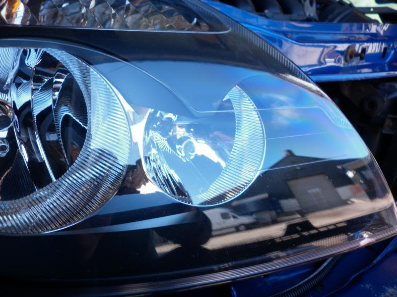

Not bad for 106,000 miles eh, that headlight was pretty crazed too. I have a set of xenons coming In a few days, improves the cups loads I think.

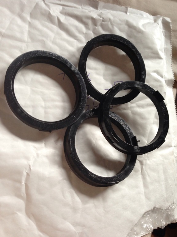

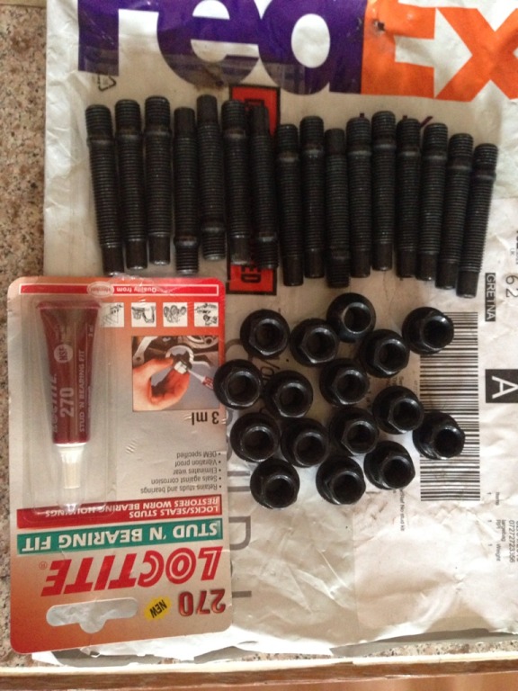

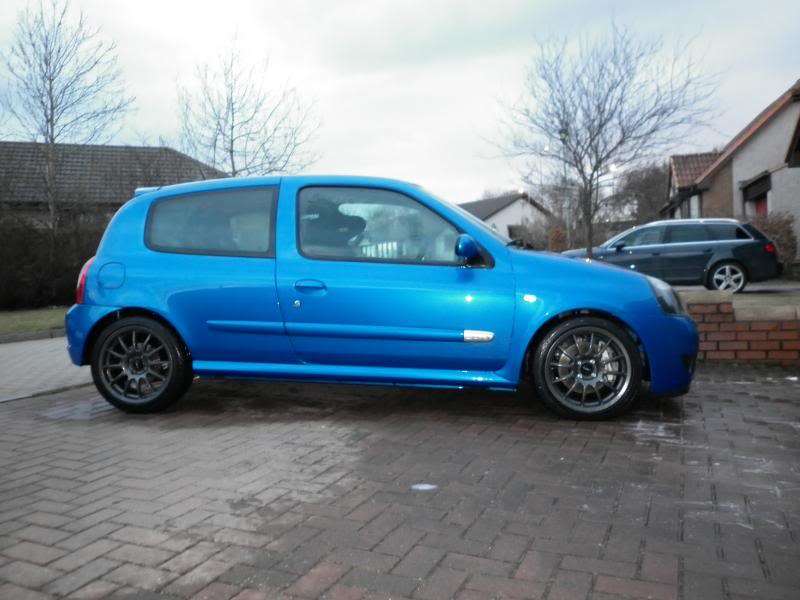

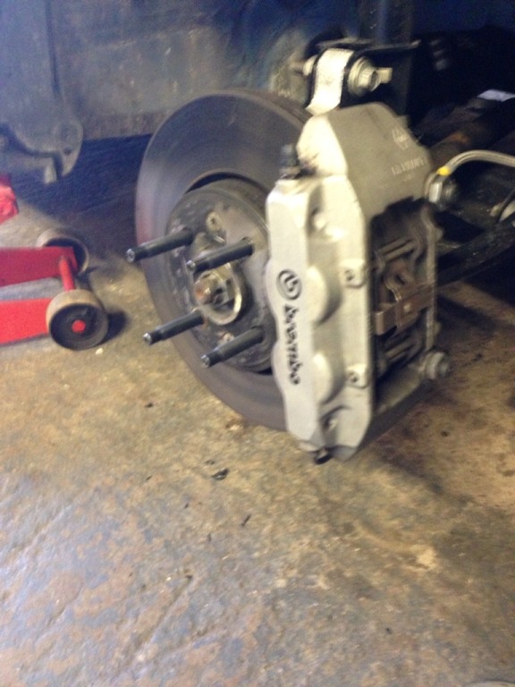

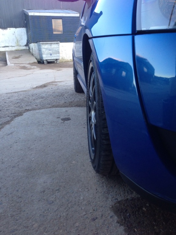

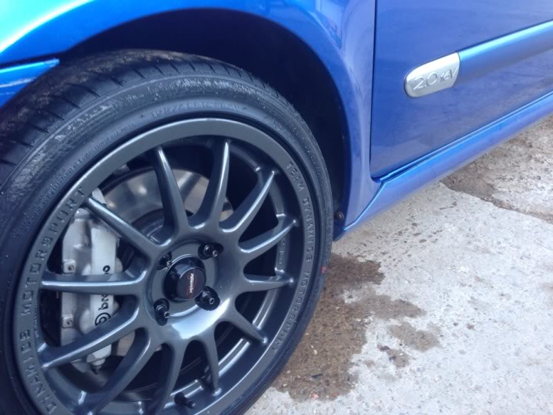

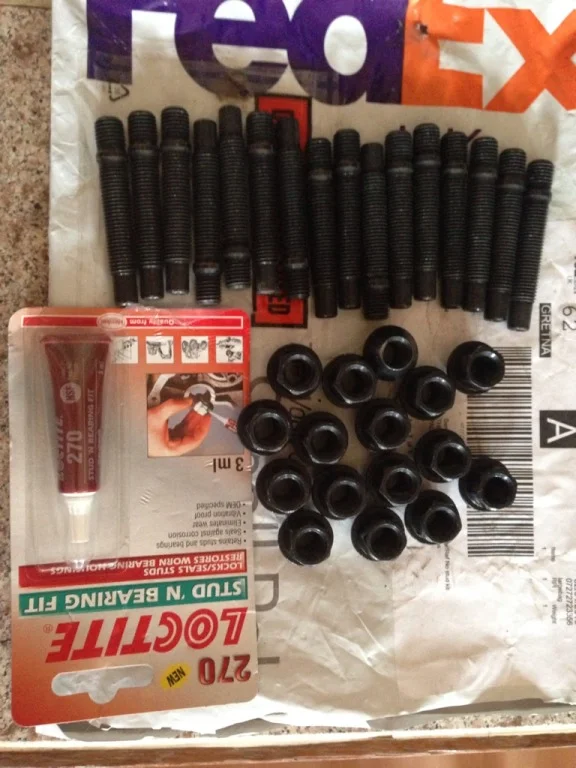

Wheel spigot rings and stud kit have arrived so going to get that done tonight, save me worrying about having 20mm spacers with no spigot rings.
Stud kit fitted with spigot rings and wheels sealed ready for some abuse when the ds2500 go in.

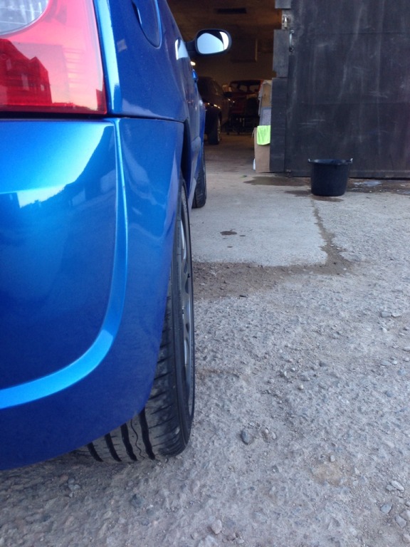

10mm spacers on all wheels now.

Looking good, iv still got my stud bolts to put on yet.
PMS studs are a nightmare to find the right allen key due to their coating, I have used a torx socket on both my cars now and it gulls the ends slightly which isn't ideal, a slightly ground down 4.5mm Allen key would be perfect iirc.
You can do that fine but you really need to lock the two nuts together for any purchase which then damages the coating on the nuts (unless you have other m12x1.5 nuts)

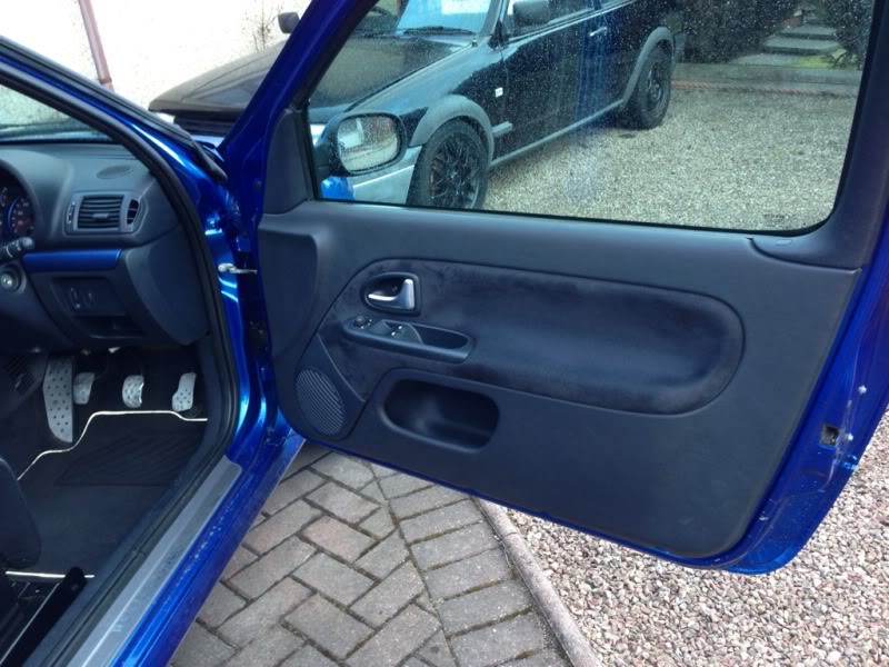

Finally got the front door cards fitted and hopefully sorted the rattling drivers glass, okay so far.

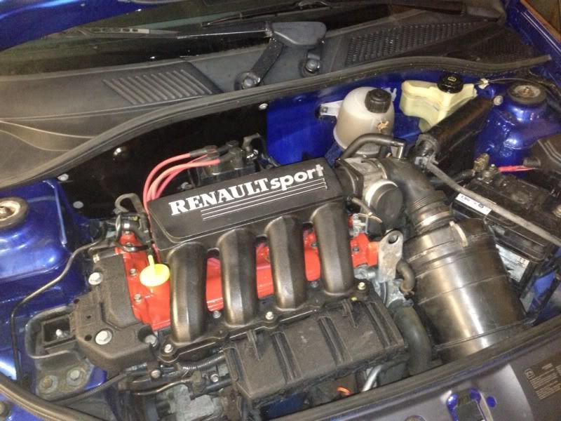

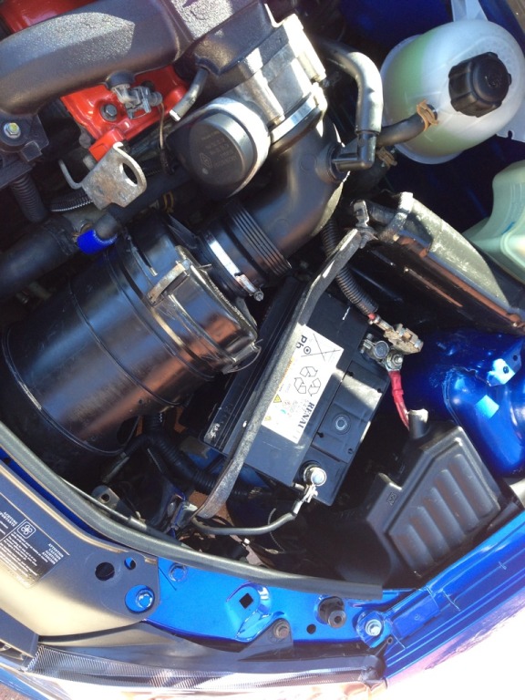

Fitted the genuine Renault battery that my other cup won't be needing and gave the bay a wipe over.

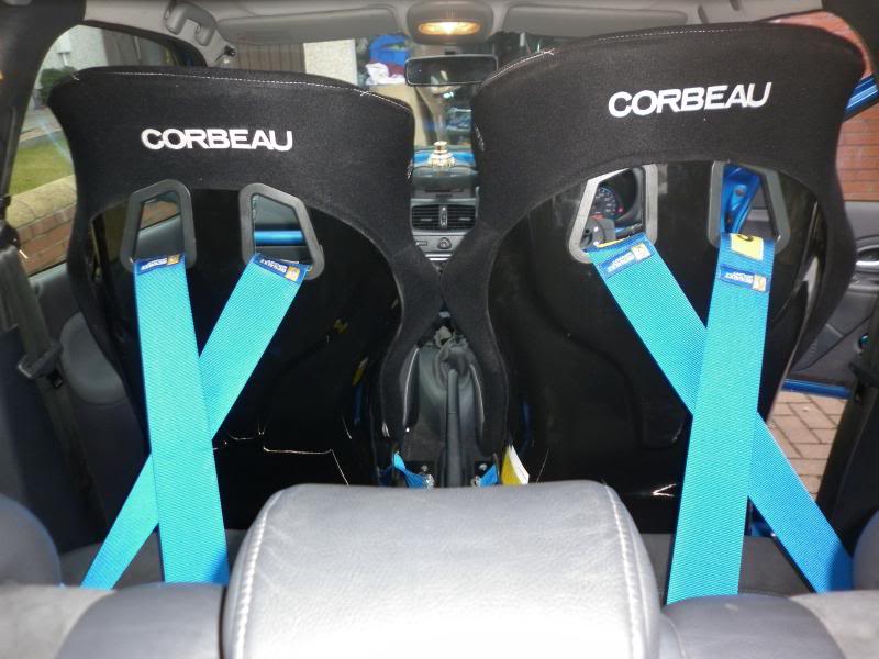

​Have you got anymore pics of the harnesses and how you've set them up? I've full interior and want to have 4 point 3" straps in mine.
Cheers, yeah I have a few I'll PM you, they are actually 6 point roll cage mount harnesses converted to four point d-clip fitment.

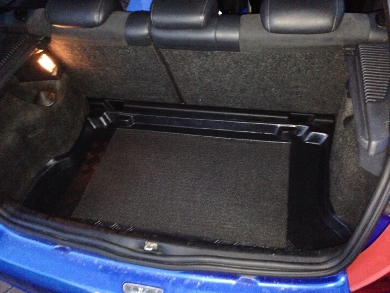

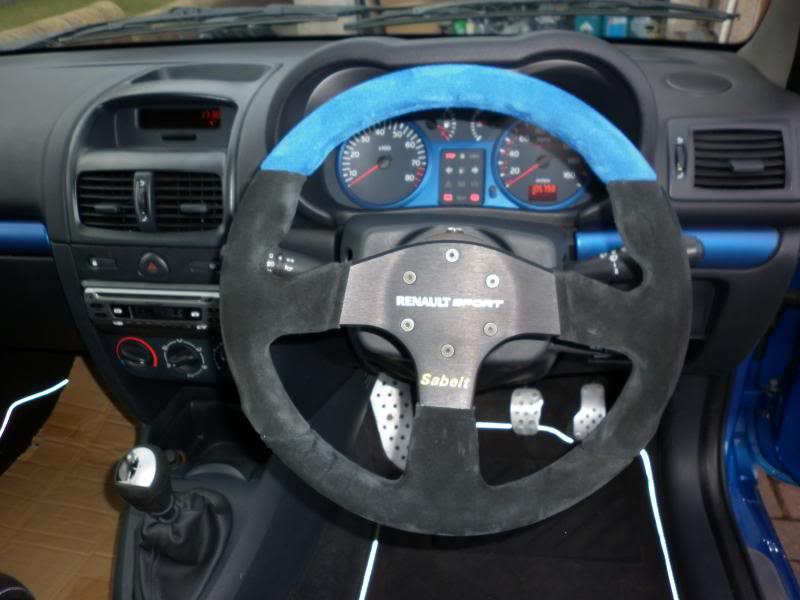

Got a few bits done tonight, I fitted the boot mat, wind deflectors, steering boss and extension (lifeline snap off to come from Iceman before Sunday hopefully)
Steering wheel is almost perfect distance now, would like to lower it slightly but I'll see if I get a chance.

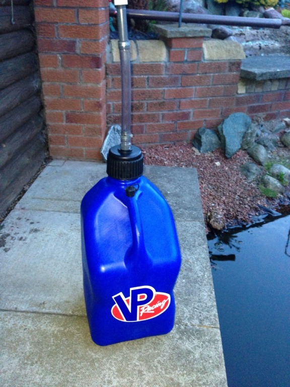

Treated myself to a jerry can, gloves and tyre pressure gauge too. I have got my helmet to pick up from KH on Sunday as that was away getting painted.
