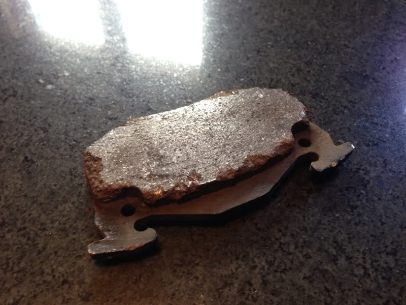

Cheers, was a decent day with rain in the morning and dry in the afternoon. Few dramas getting there but the car ran almost faultlessly until the last session where it chucked a rear pad going down duffis, nothing damaged, just new pads and boxer shirts required. Shattered now so I will update with vids and pics soon.

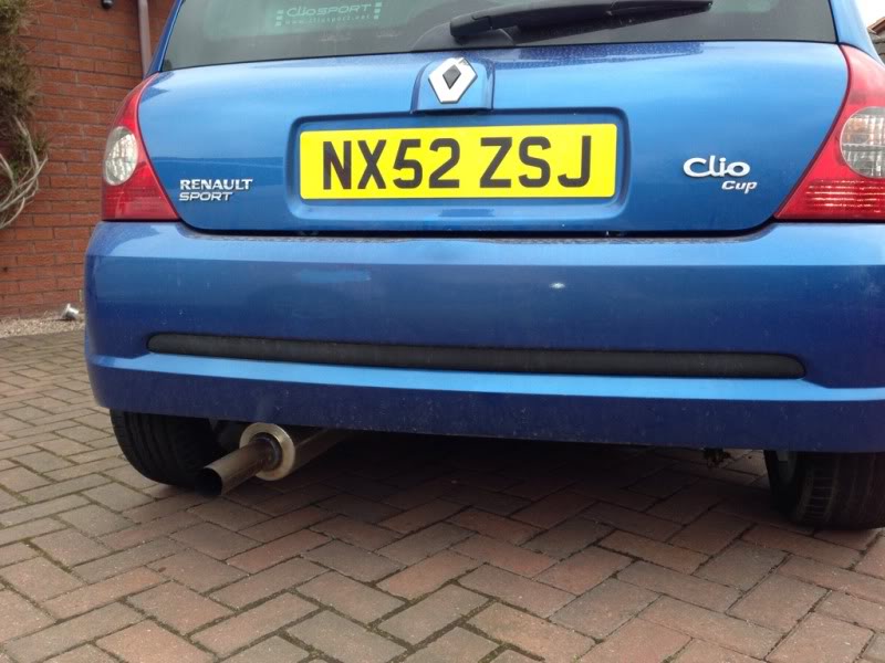

I fitted the exhaust and modified hanger, fitted xenons, removed fog lights and secured front bumper properly with new riv nuts to the subframe. Fitted new tie rod and had geo setup up again. Had a mishap, while I was rushing so much I never tightened the rear wheel nuts after doing the exhaust and the wheel fell off leaving my lock up, no damage done except some paint off the inside wheel and lost 4 of my PMS nuts. Just seen the wheel overtaking me in the mirror, first time in 10 years I have done that...whoops. Found some Ford nuts to last me the track day until I get more from PMS.
Forgot to take pics as I was rushing to get things done, how the car looks today.

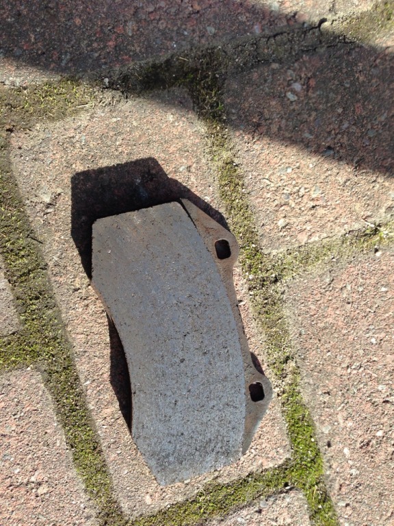

Pic of the remaining pad from the side where one fell out, oem pads (Brembo) just aren't up to track abuse, these have done less than 200 miles before yesterday and are falling to bits.
Few randoms I stole for bookface, videos to follow.
you sure you don't have bias valve issues, we ran £12 rear pads in ours and they only ever got mildly warm
The braking was perfect all day balance wise, just a little extra bite would be nice. I don't have a bias valve fitted Fred, not even an oem one, my other cup has one but not this. I came to the assumption that early Cup's never had one? It still has the green oem pipes leading to and from flexi's so it hasn't been tampered with.

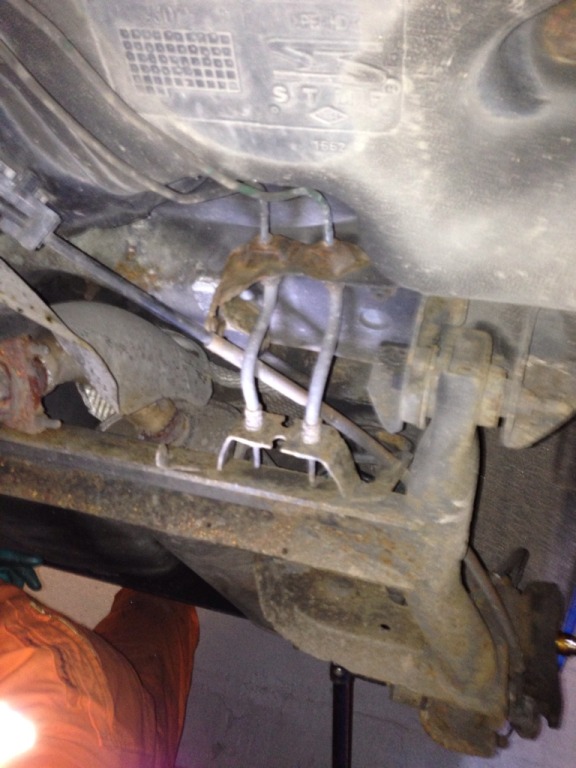

I still don't understand how your car has no bias valve
My understanding was that the bias was either done with a valve over the rear beam or internally in the ABS system
But if you have no abs and no bias valve then surely the rear is gonna lock up loads?
​Nope brakes lovely.
Me neither tbh, my only idea is a different master cylinder with different sized pistons proportioning the force, it brakes perfect even in the wet. I'm uploading a video just now, you will see its fine. It has a better feeling to the pedal since fitting the brembos but that might have been because it was overdue a fluid change.

P.S I agree with Freddy, I've run less than £10 rear pads in mine and they do so little its not an issue. I firstly ran PF97's and had no end of issues with locking the rears. I've got them still if you are set on getting some decent rear pads :)

Im too cheap to throw away a set of new pads, these still have loads of life left, a little crumbling won't hurt anyone....hopefully. Its cool I'm not wanting mental brakes on this thing anyway, there's already enough noise with the exhaust fitted, french interior rattles so don't need to add squeaky brakes to that list for a daily. I will take you up on that offer if you have a nearly new oem outer rear pad (can't remember if there sided)

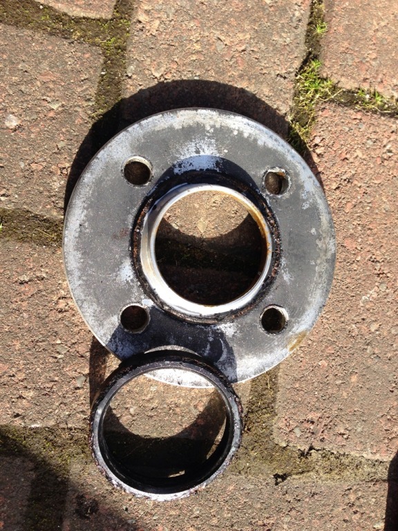

Removed my front pads for a look today, seem okay tbh. Spigot ring was a but worse for wear, it has melted to the spacer.

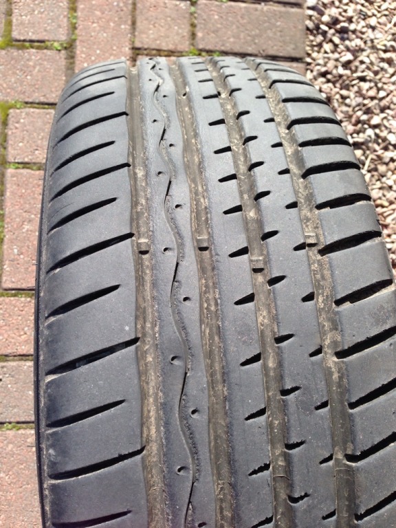

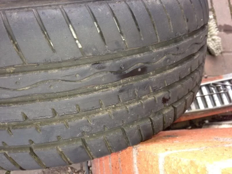

Tyres not looking the best, fair but of feathering just in from the outer edges.
That pad looks normal.
​Spigot rings are a pain, that's why we changed wheels, so that we didn't need them.
I hope that's sarcasm haha.
Yeah not ideal, they are still in one piece and the rough shape they came, just a little lip gone from them. TD will be giving me more if they get worse tbh, they are meant to be Motorsport wheels FFS.
I was going to say when you said you were fitting plastic spigot rings that they would melt but didn't for some reason lol.
I got some made in aluminium for this reason but mainly use the 2118's so don't need to bother.
Yeah that's the best solution. Getting these ones from team dynamics I thought they would give you a good quality thermoplast so this didn't happen.
I've used brembo rear pads since day one, they've been spot on for me.

Going to get the headlights setup soon so i'll get them to chuck it on the brake machine to see if anything's not right, cant see it tbh. I just think I was pushing too hard for the setup I had although James has run them for 40 minute races :S

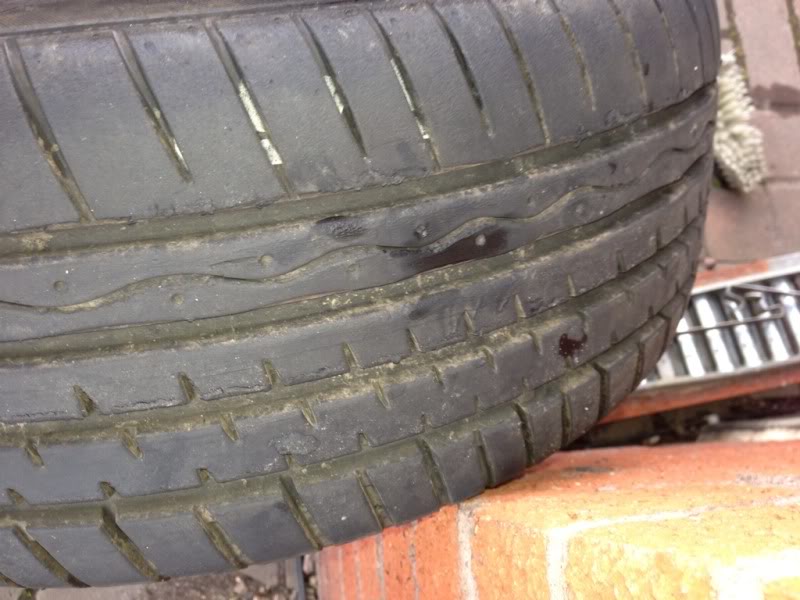

Rear tyres are worse than the fronts :( , they have only done 250 miles. All the blocks have started to melt and are feathered, pics don't really show it well.

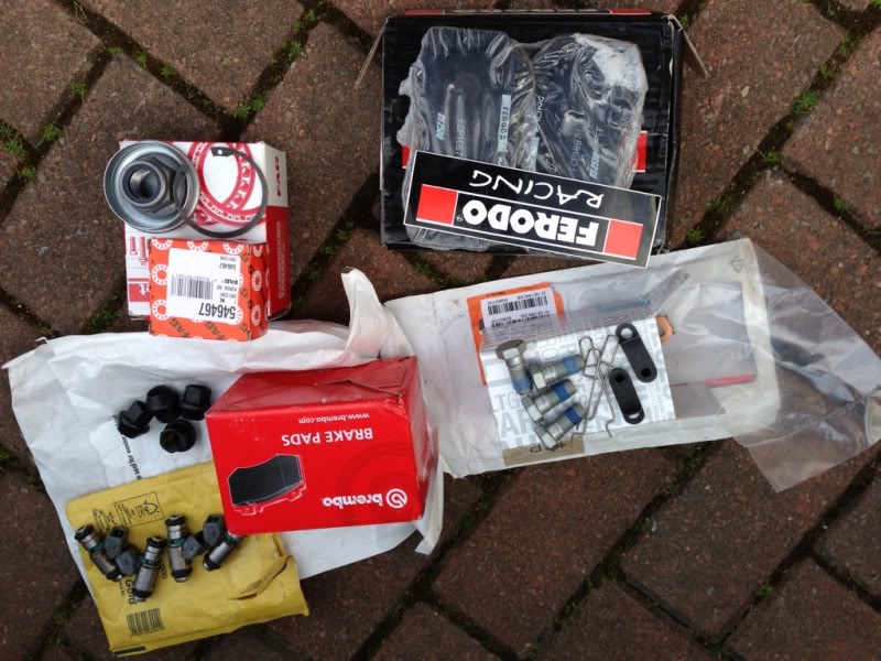

Fitted new Brembo rear pads again along with shim, springs and clips. I decided to fit my set of DS2500's to the 4 pots instead of swapping to standard callipers, PF97's and 15" wheels and tyres I have at my unit. Staying with the 4 pots meant I had to keep my 16" wheels so I bought some better tyres for them rims too and decided on 595 RS-R's in 205/45. The rear bearing was replaced as well on the same side where the pads fell out and the exhaust was re aligned. Some new PMS nuts fitted as I miss placed a few when my wheel decided to come off a while back. I got a set of injectors ultrasonically cleaned which has got rid of the light load misfire I was getting and just generally made it a better drive so im happy with that, few extra pony's released there.

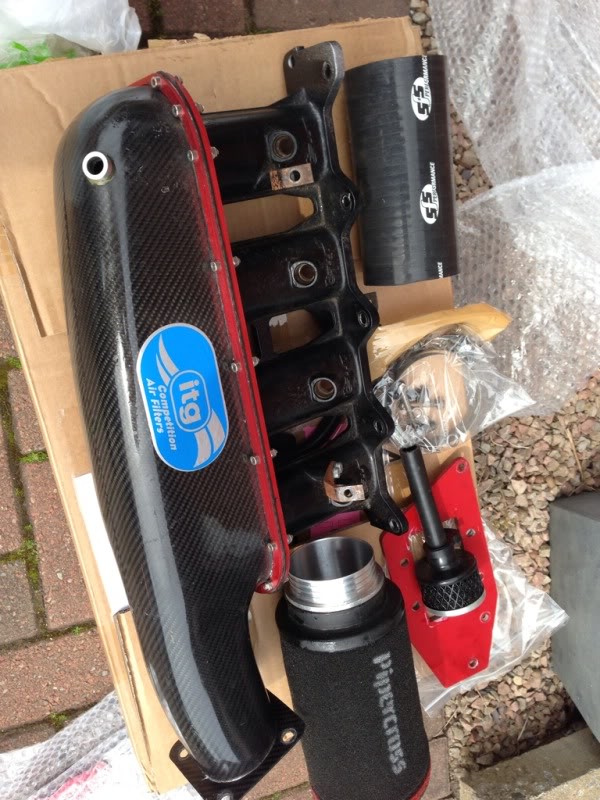

I also received a nice little package this morning, shame I can't fit it as I couldn't get it mapped before Sunday and didn't want to risk the engine with a dodgy map on track. Some people have said I won't notice a difference on track with the RS2 so I'm not 100% on fitting it now?!?
