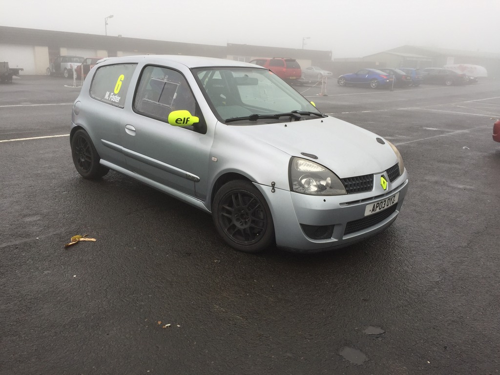

So I Bought APp03 OYZ from @pez84 in September 16. This was intended to be a track day car and a bit of fun for me as i'd just sold my evo and was "done" with cars.... again....

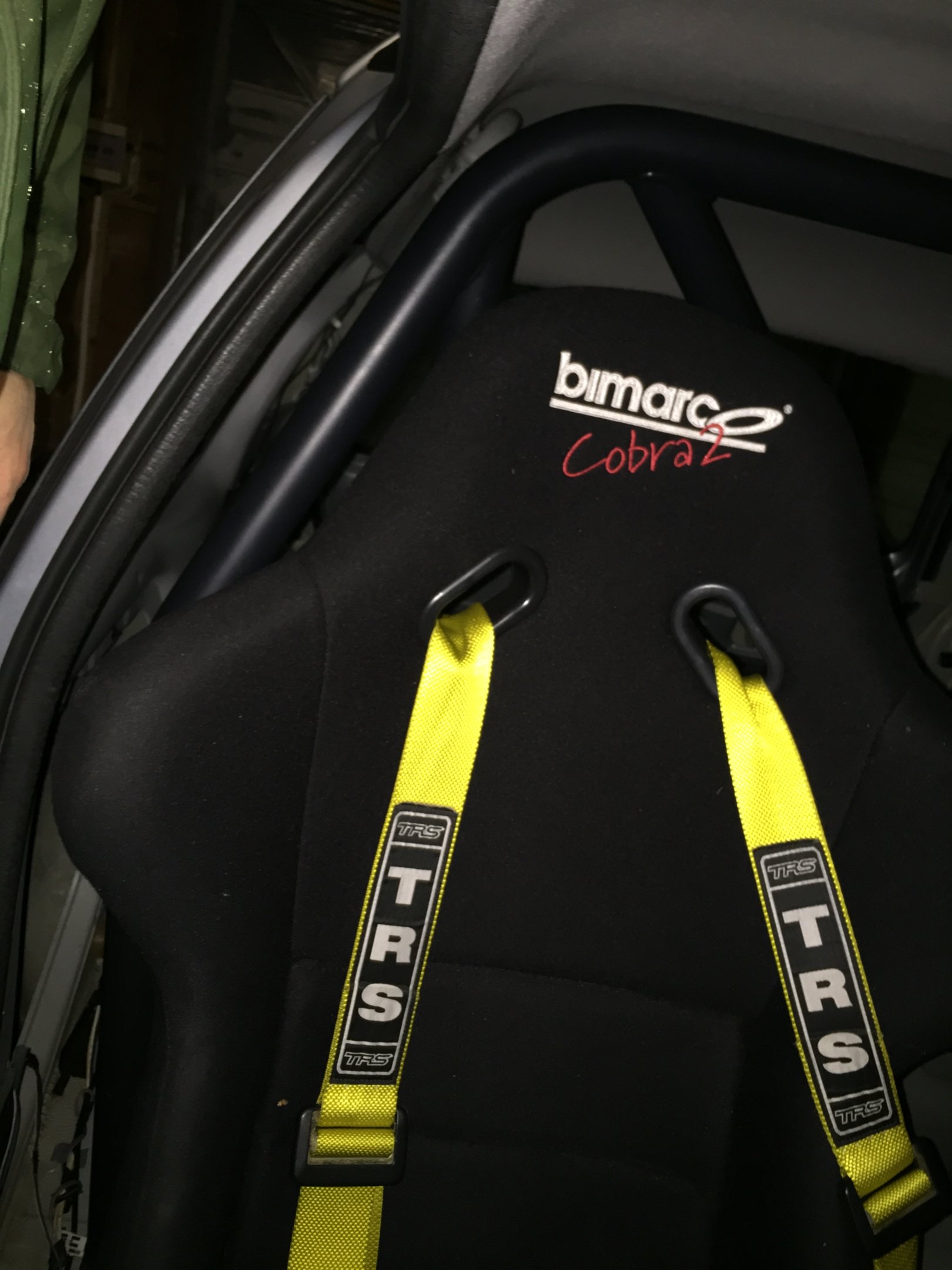

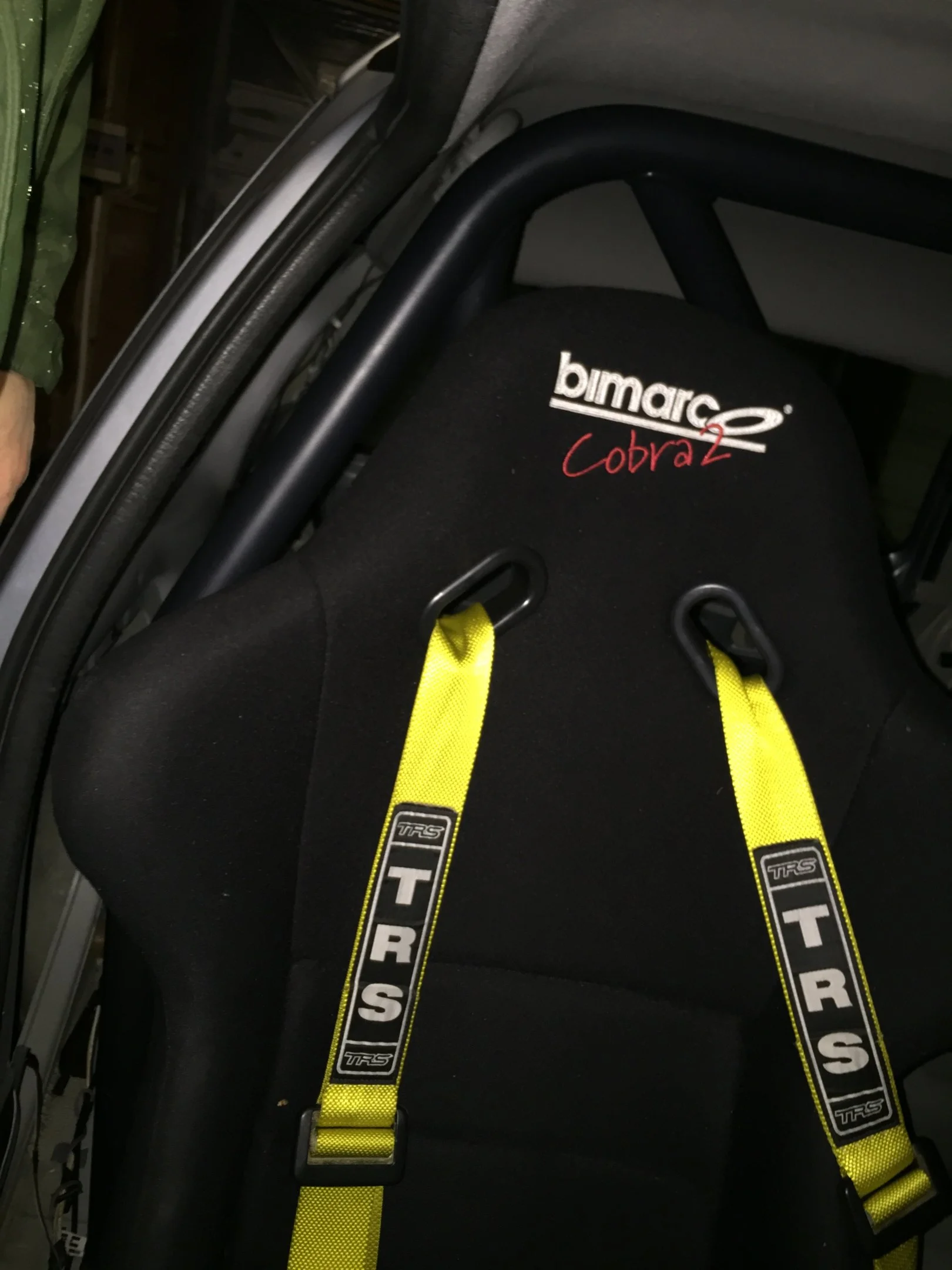

When i got the car it was on AVO GTX coilovers with pms top mounts. belts had been done. had bi marco futura seats, harnesses, rear cage, federal rsr + a bunch of spares.

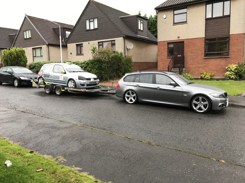

fraser.J doing the decent thing and picking the car up for me! top lad

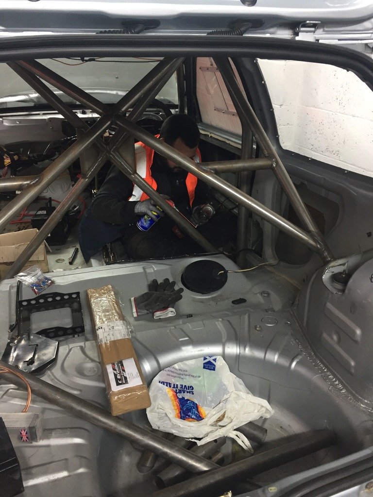

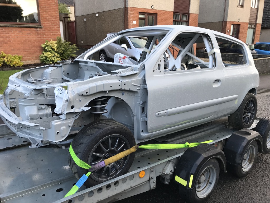

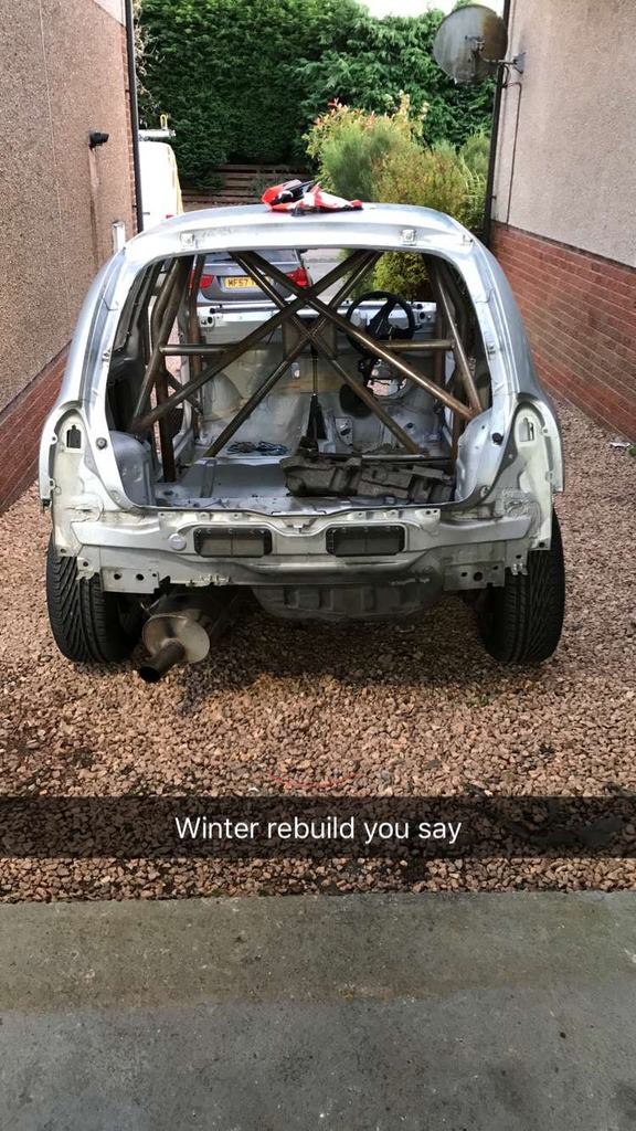

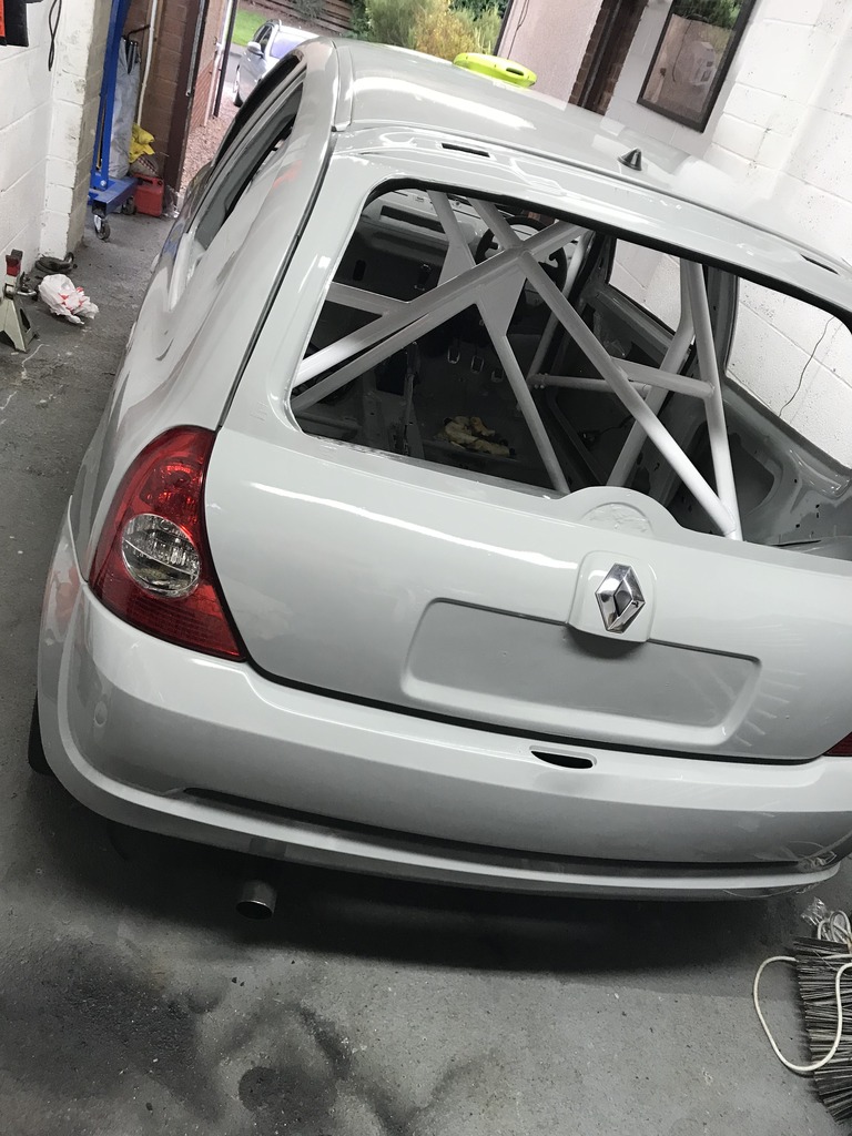

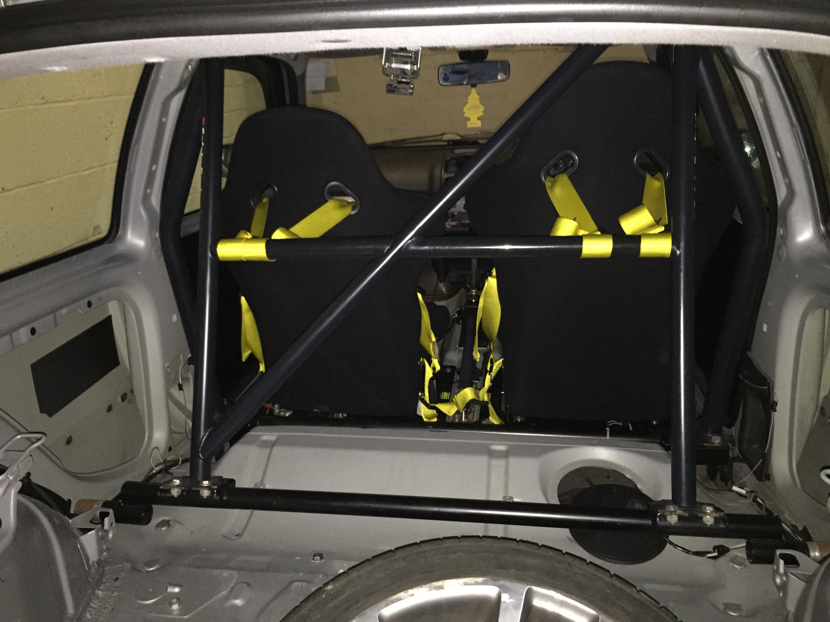

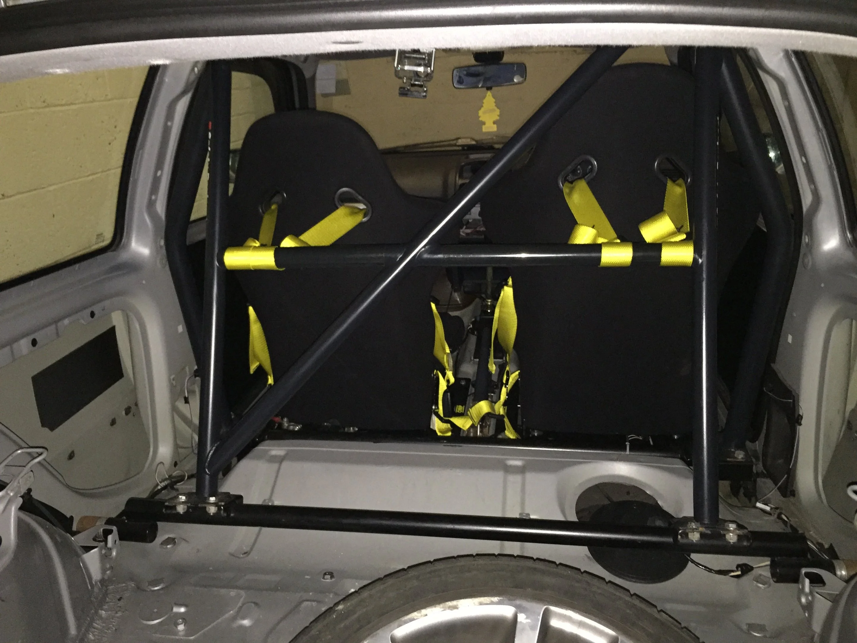

I decided that the car was going to be used for Superlap Scotland to compete, the old cage wasn't pleasing my eyes and decided that a full cage would be the best bet. It also helps if i decide to enter any other motorsport series, hill climbs etc etc
out with the old cage, in with a new sassa cage from tim finch. Additional cross welded into the roof. this was a terrbile idea and made fitting the cage a nightmare. Old seats and harnesses were removed and sold.
A new corbeau revolution ordered up and sabelt 6-point harness

removed some more tar and cut out the doors to help with weight saving
headlights cut out, wiring chopped out

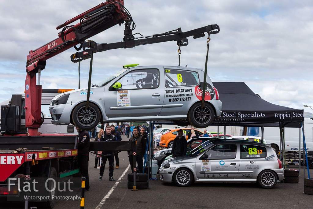

Somehow i managed to bodge the car back together in the final and nurse home a lap in the rain giving me 1st place on the day and 2nd place for the season!

at the end of the season the car was stripped to help resolve the issues that i had throughout the final.

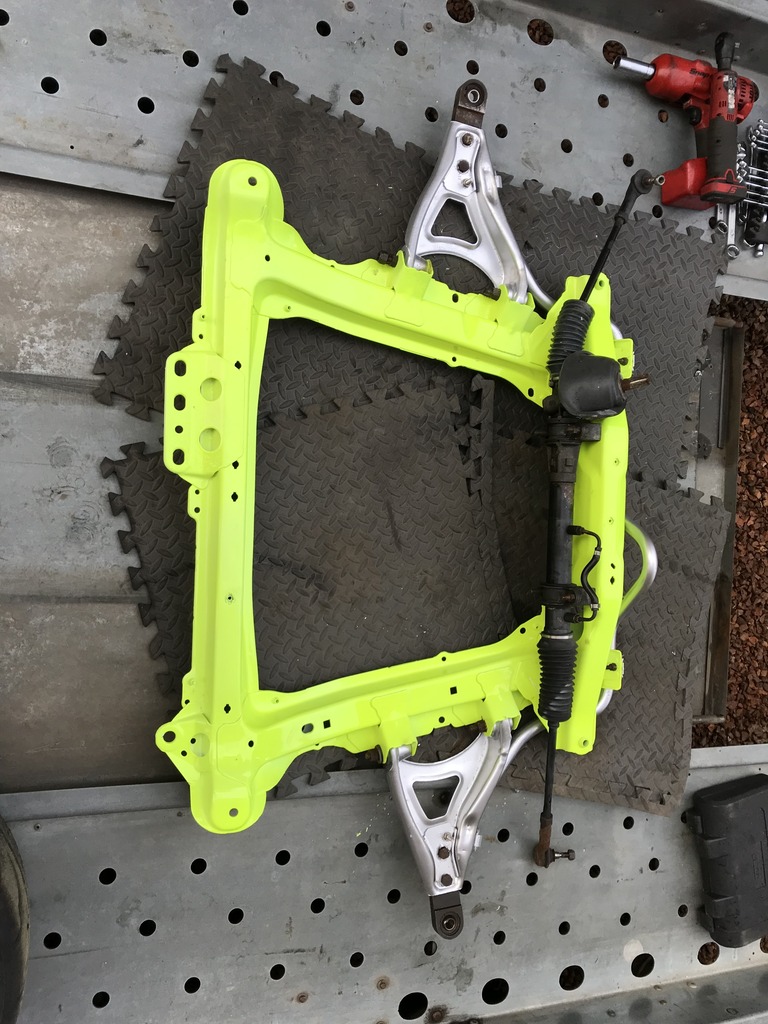

cup subframe

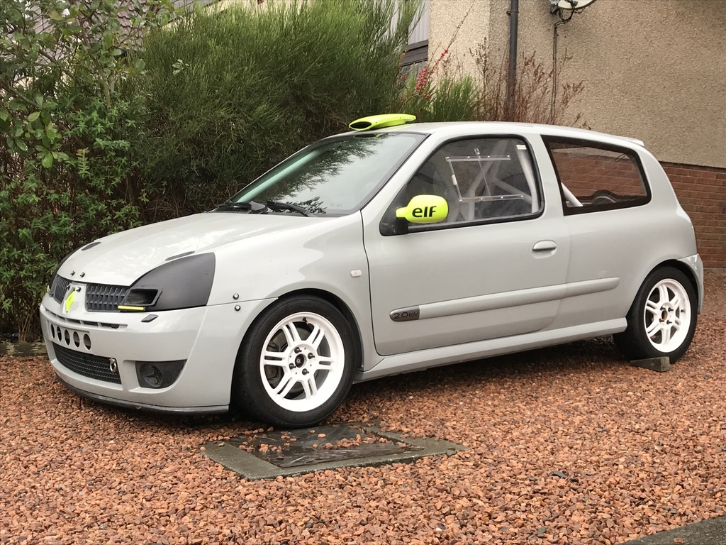

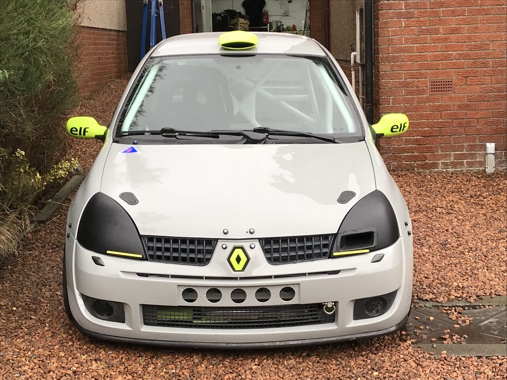

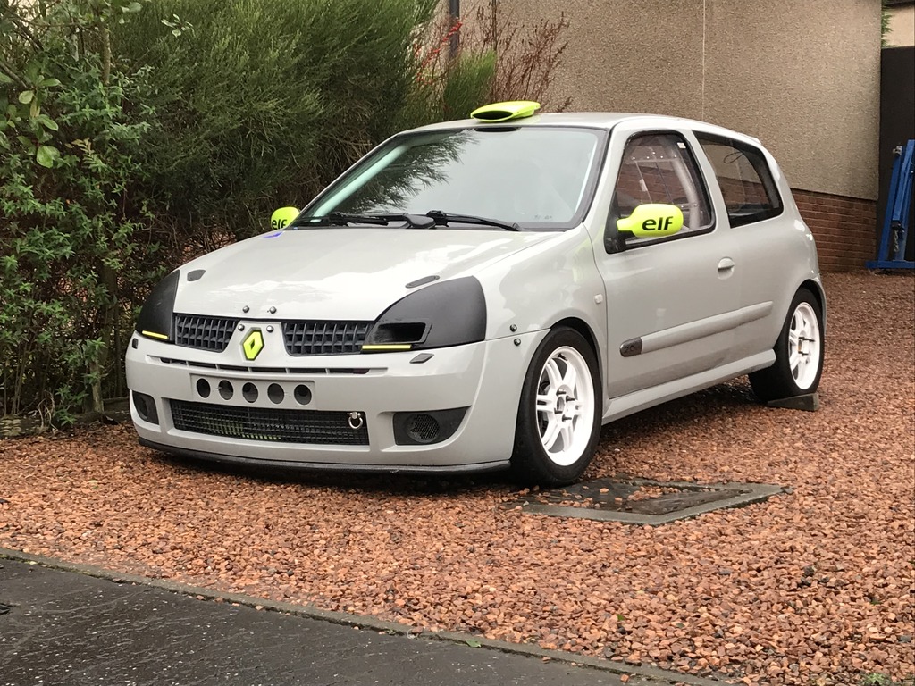

full respray in storm grey as the car was a bit of a mess inside... not sure how this leads to a full respray but thats exactly what happened

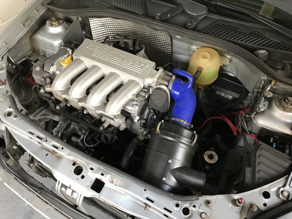

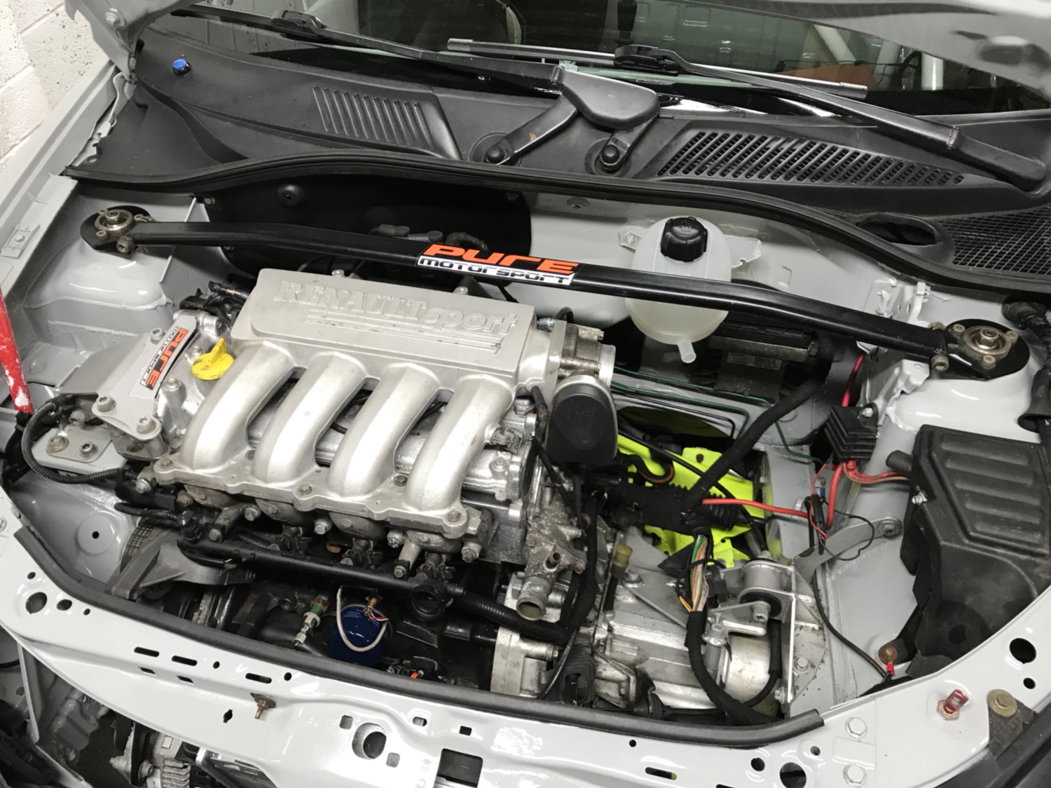

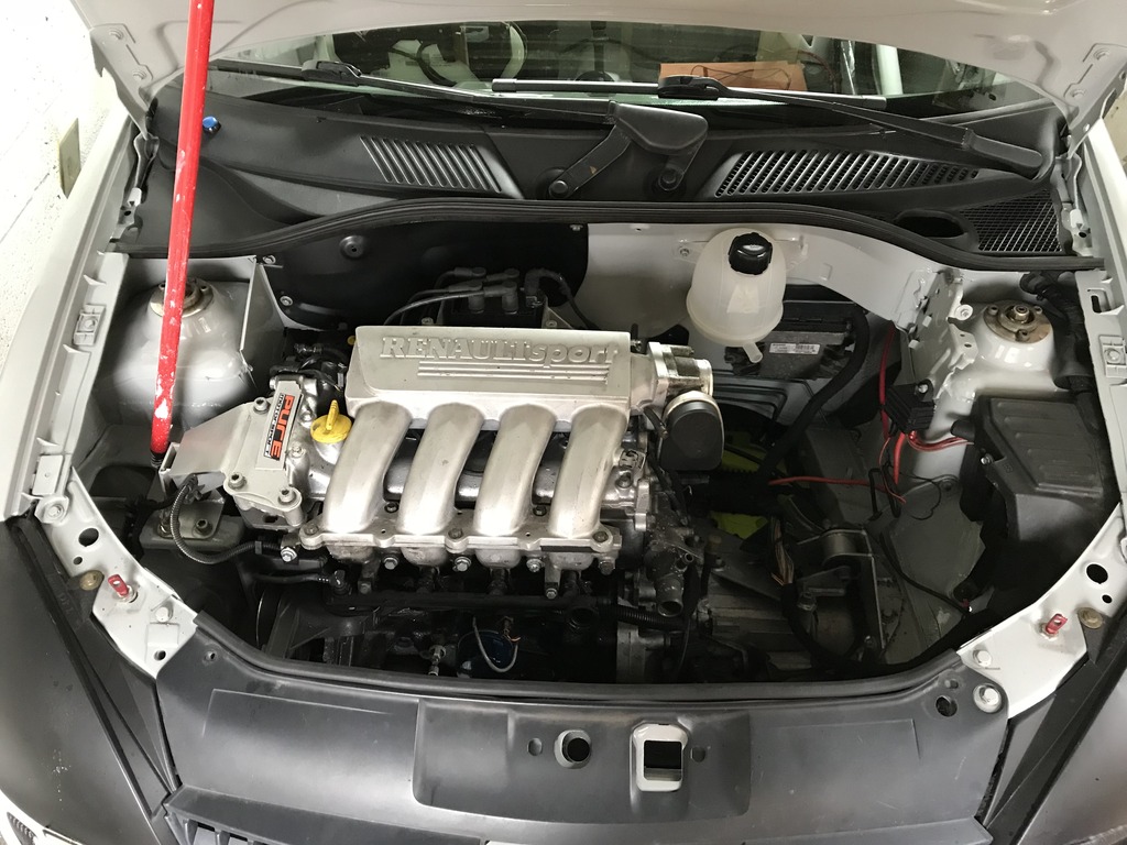

Love the winter changes , and how clean the engine bay looks with the wiring cleaned up.
The engine bay looks super tidy but that’s because there is no coolant hoses haha!

Did you try to see if Roose was interested in making a hose set.
What day you going down to NEC ? I was tempted to go but away back to work on Sunday.

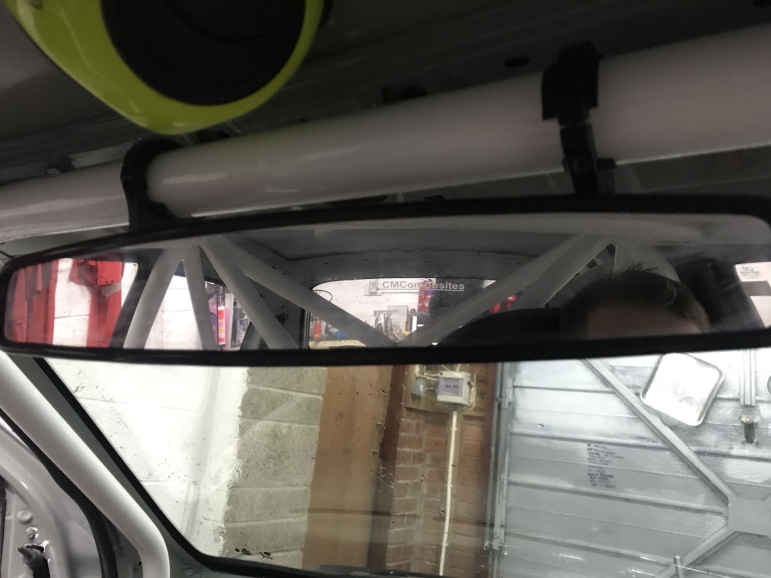

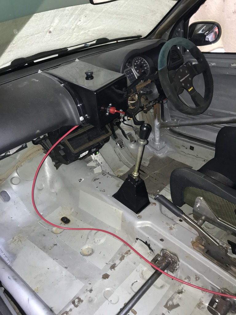

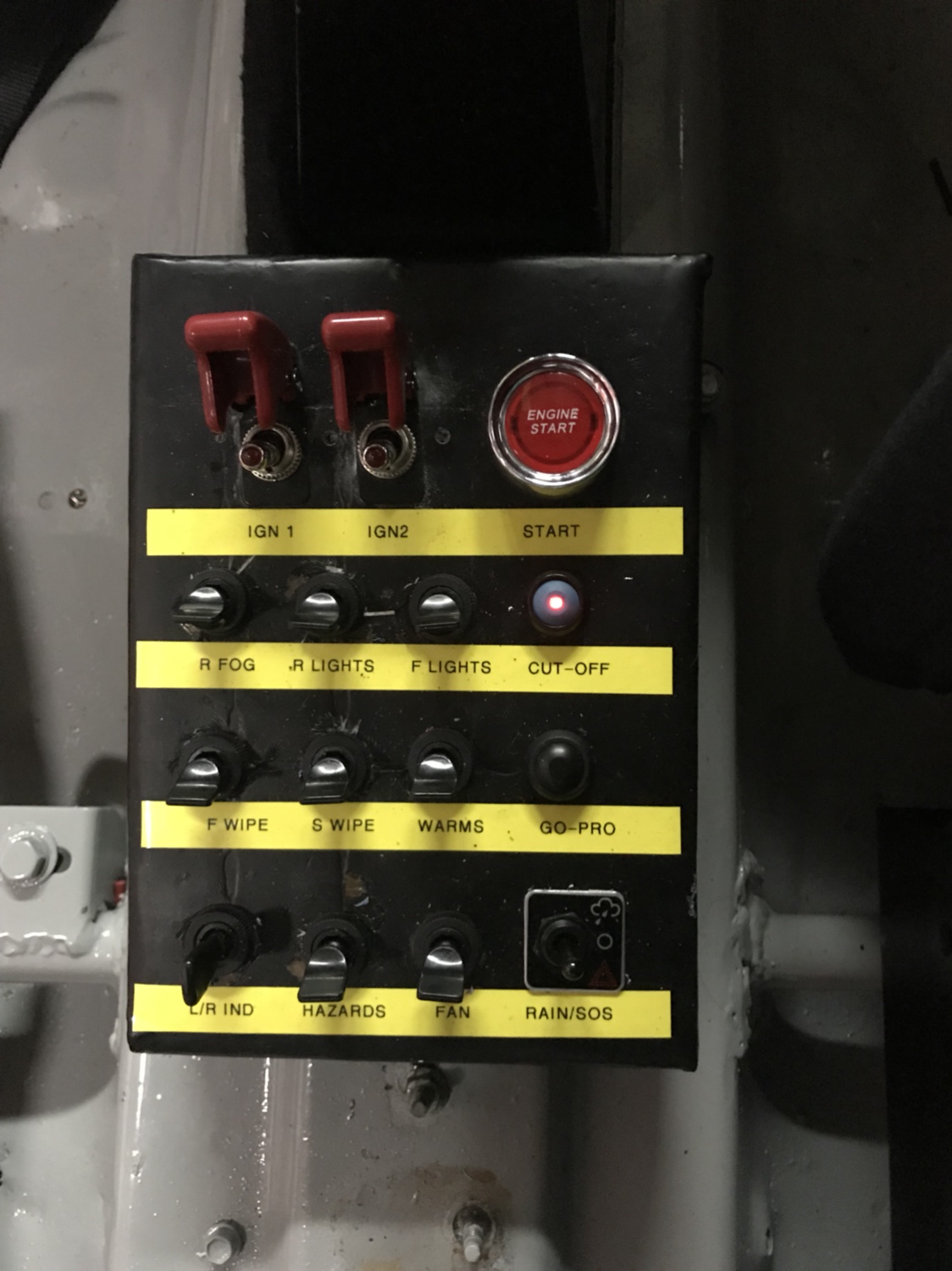

New rear view mirror installed today. Vision is a lot better which is always handy!

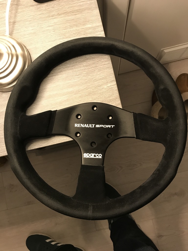

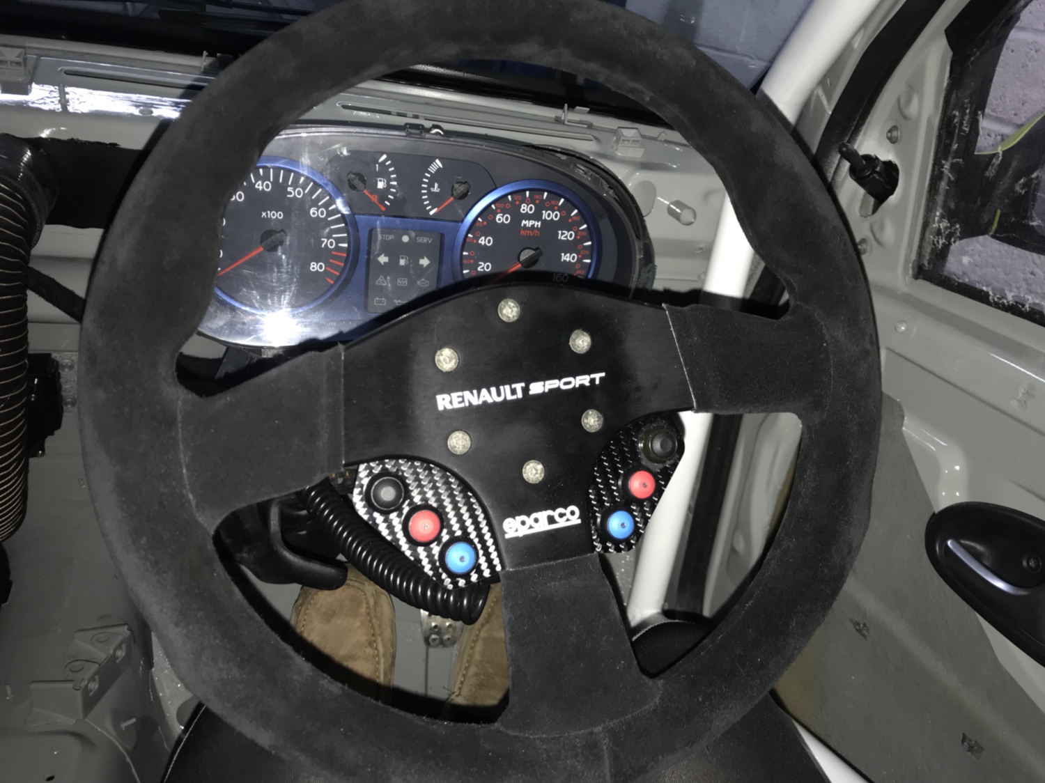

New steering wheel installed with button bracket and all wired in!

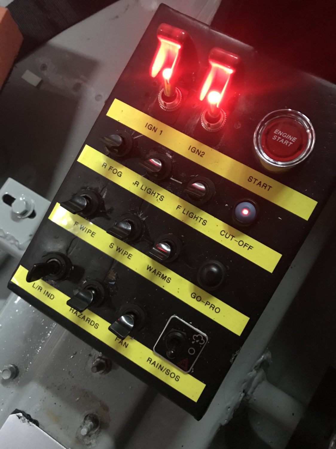

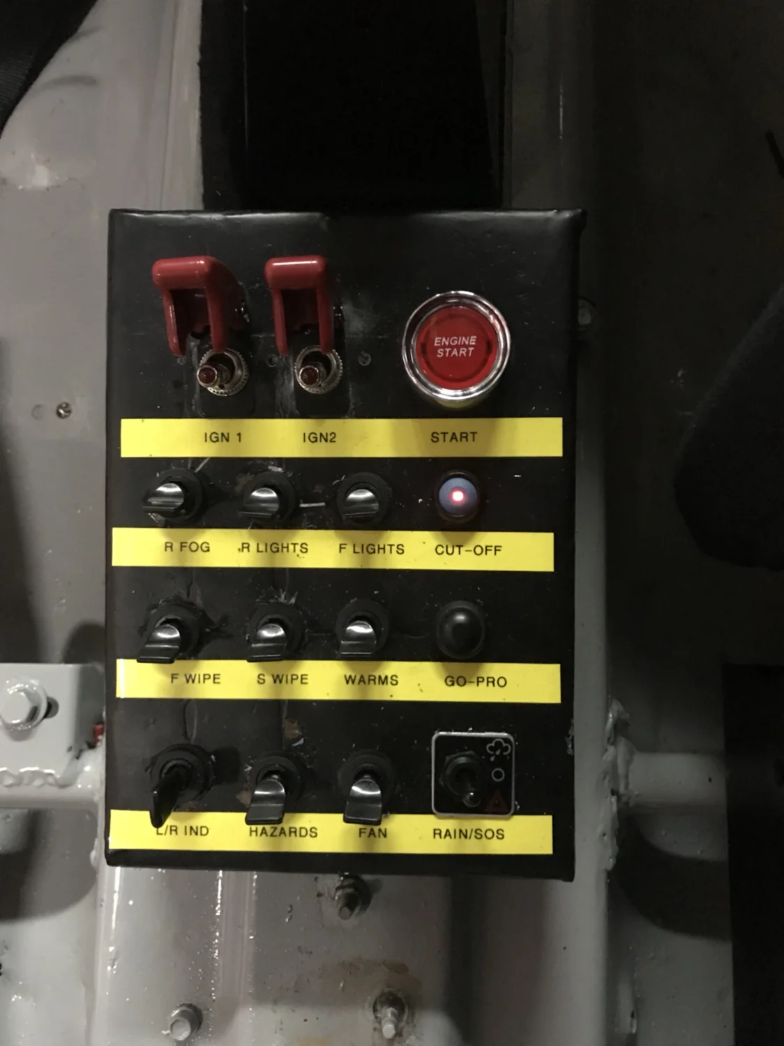

Custom switch box that I made for all the necessary items!
My mate paul gave me a huge hand with the wiring side!
I do hammers. He does coloured string!
Can’t have toggle switches unless you’ve got lights in them [emoji23][emoji23]
I've been looking at doing the same with mine for the ignition - push button start.
What worry me though is if you flip one of the ignition toggles down would that turn the car off ... ?
How do you turn the car off? By pressing start again or cut off?
You may need to point me in the direction of your mate Paul haha
Ign1 doesn’t stop the car but ign2 would if it was flipped down.
Unlikely tho! (Famous last words haha)
Finally got myself a pms strut brace! Fitted it up tonight. Luckily the previous owner had the holes in the right place! Ha!

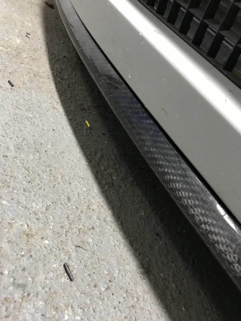

Also got round to fitting a couple of bits of cheap carbon.
The splitter was free so I thought why not! Might only last 15 seconds but worth it for a few photos before hand haha!

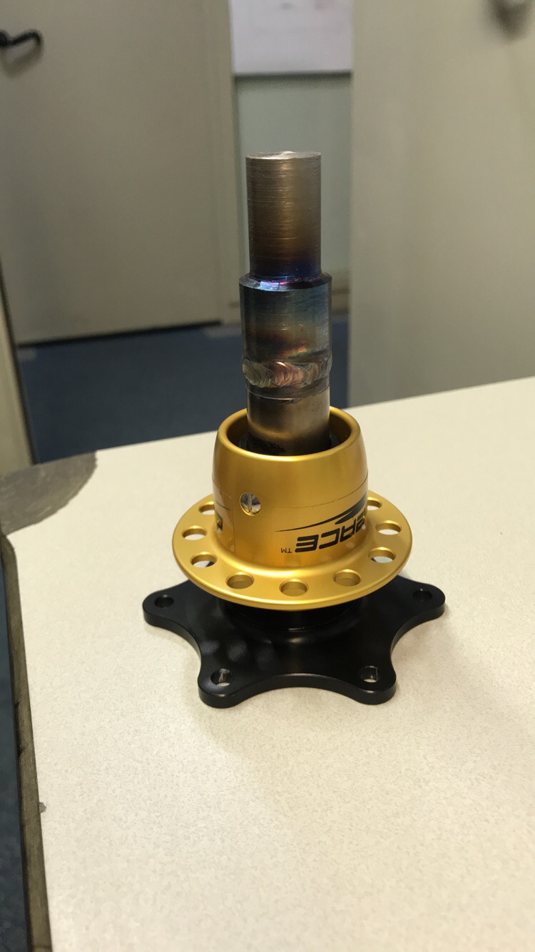

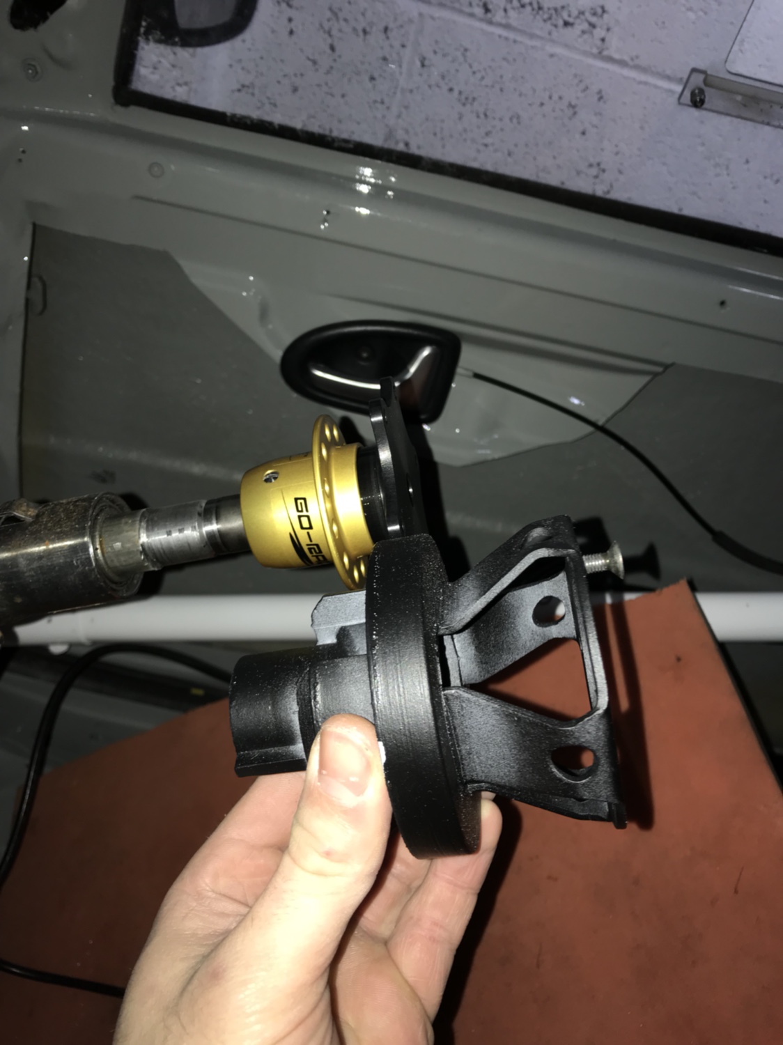

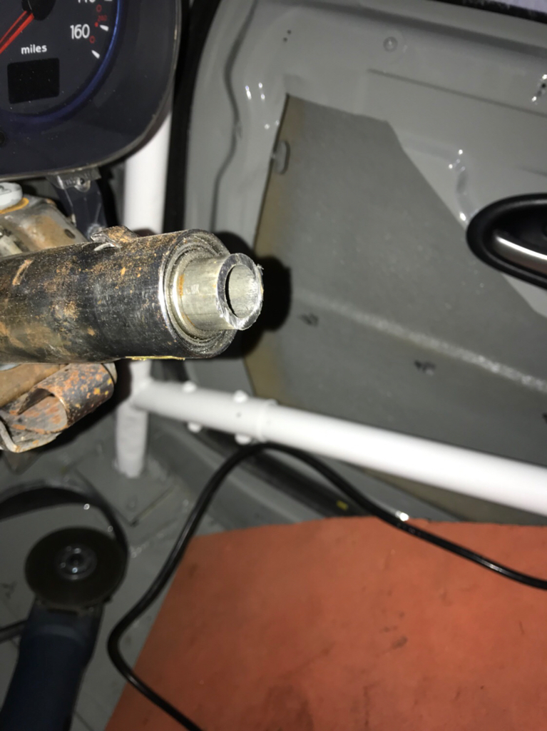

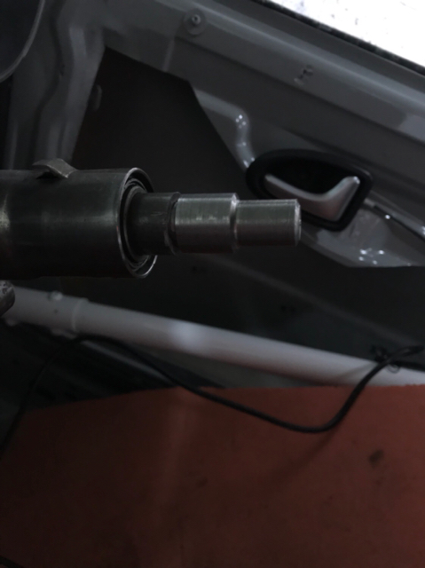

Cut the end off my steering column because the wheel was sitting too close and it was annoying me.
Made up a male-male adaptor
Welded it onto my quick release boss. Cheer to select motorsport for sorting me out with it!
It should sit a few inches closer to the end of the column which was all I needed to make driving that Wee bit more comfortable.
No photos of it fitted to the car fully welded yet but those will be coming!

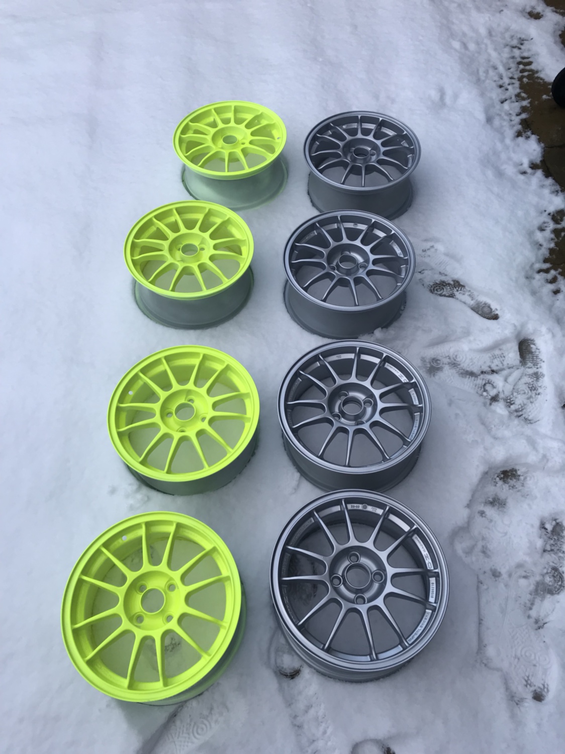

Also got my wheels powder coated my Damon @ wheelcoat in leven!
Thanks to @neil.a for dropping them off for me!
Just need some sticky rubber to put on them now [emoji16][emoji16]

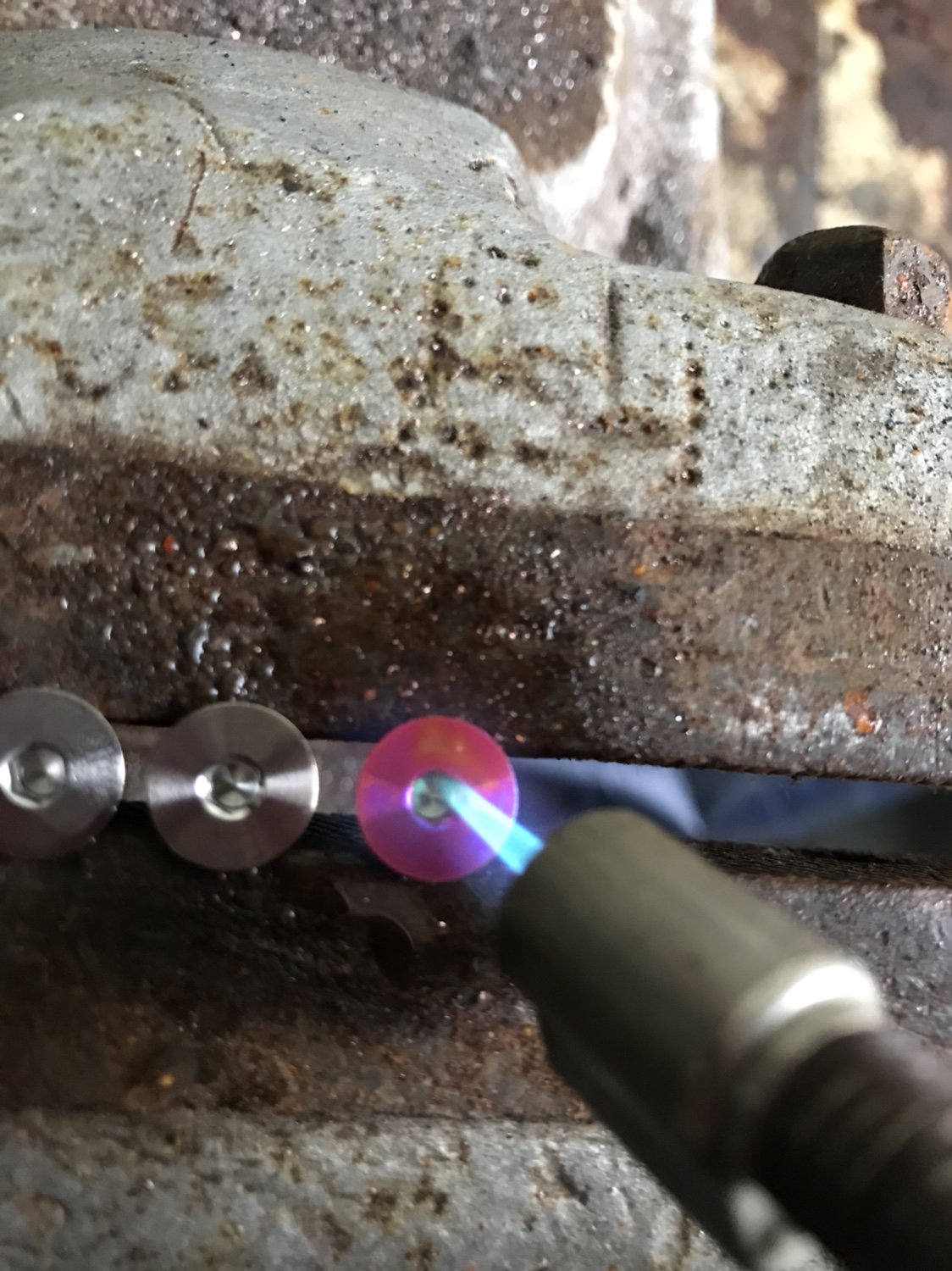

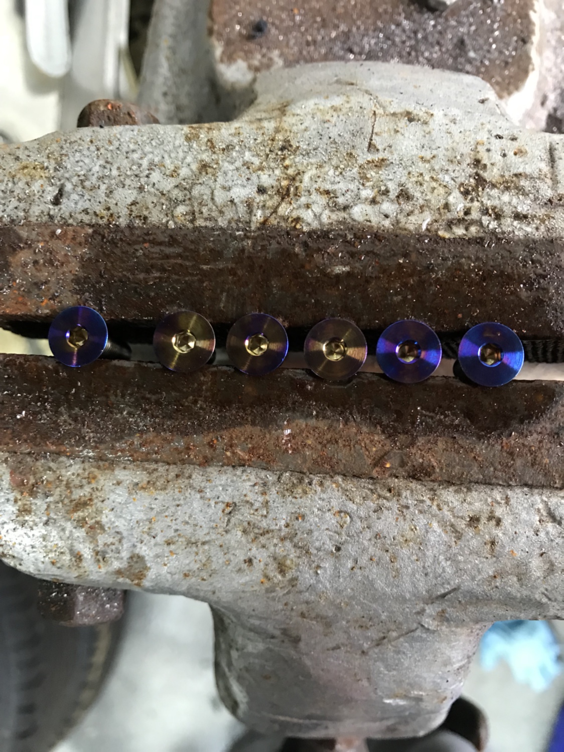

Bought some ti bolts to hold on my steering wheel as the Go-race snap off bass isn’t threaded...
Set about making them pretty

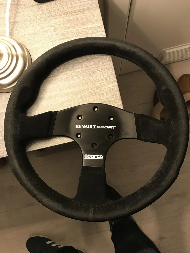

a
Sparco wheel bolted in with the button bracket and new bolts
New schroth hans harness fitted in and a longacre steering wheel hook!
