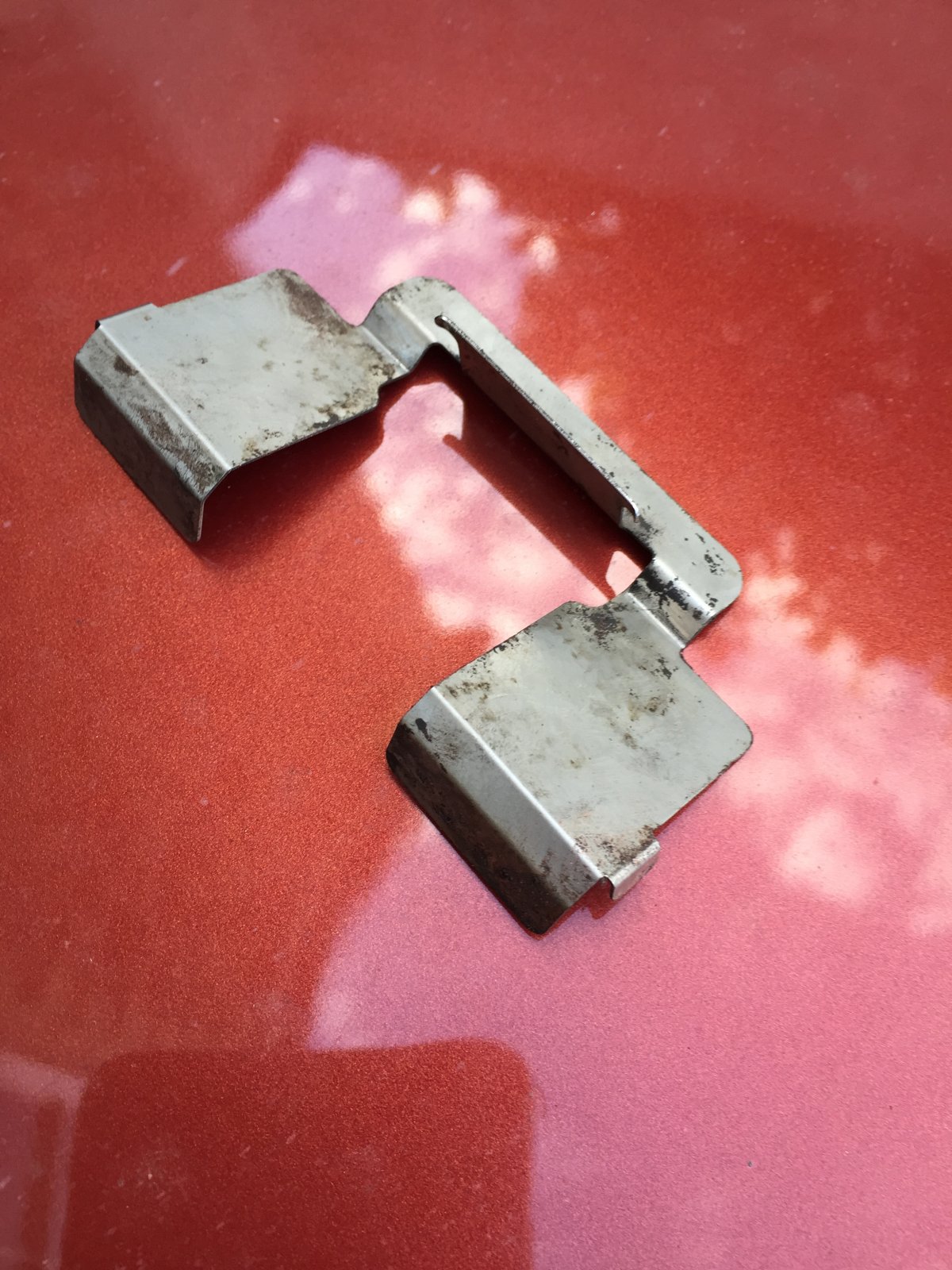

Even after filing a little bit off the tips of my Ferodo DS2500 pads, they are still a tight fit and I fear will bind a bit. Should I file more off or is it better to perhaps remove the anti- rattle springs?
I have cleaned up the calipers, so there is no debris or rust causing a tighter than necessary fit. I've also not fitted the shims.
Any advice appreciated :up:
remove the springs and allow for some play when moving the pads up and down in the caliper - about 1mm of play I'd say (that may require some more filing). I did this on mine and never had any issues
Cheers!
Great, thanks for your replies. I've already removed the anti-rattle shim/spring on the one side and it seems so much better. I'll get on and do the other side :up:.
Just to be sure, we're talking about these shims attached to the calipers (rather than the shims on the back of the pads, which I also haven't used :wink:).
