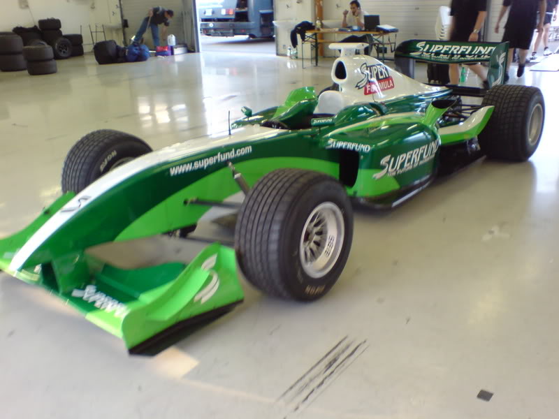

when i was working on this little toy
we had to disconnect the rear ARB as the driver was getting too much oversteer on turn in IN THE DRY
it depends on a lot of things such as is the car FWD or RWD? where's the engine
tyre pressures is a massively important area
touring cars in the wet run with the ARB's disconnected

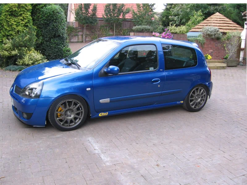

Your car looks plush mate, do you keep it in oxford?

haha cheers mate, altho i feel i should admit the pic in the avatar is not what my car looks like - its a photoshop:rolleyes: ! Its not that low and the wheels aint anthracite! but apart from that.... lol! yeh i keep it here but have suffered a few bumps due to d***head cyclists dropping their bikes into the car! very annoying!

Is the anthracite wheels on the wish list then? I'm thinking of it with my standard wheels. Or i might get turinis
