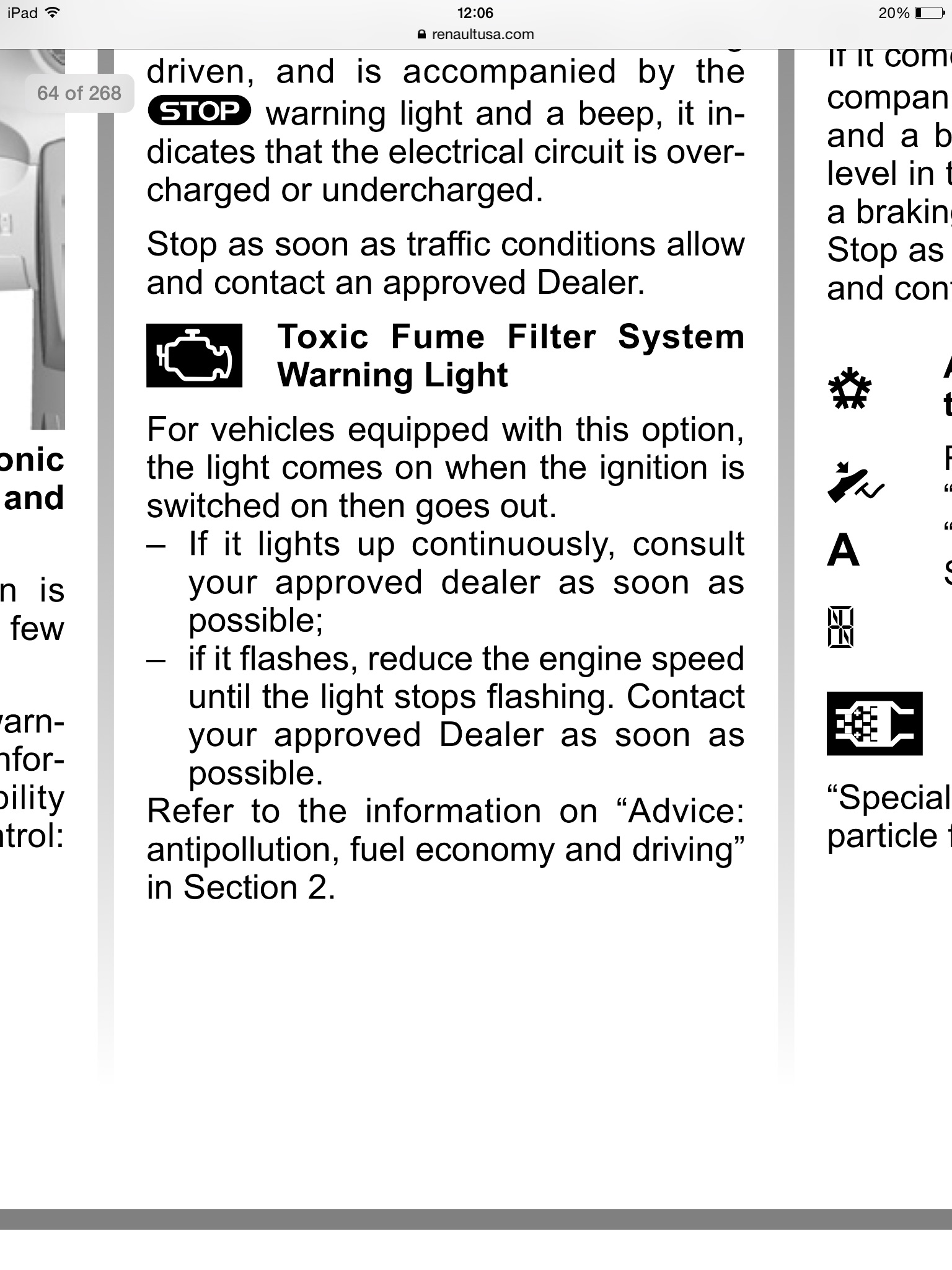

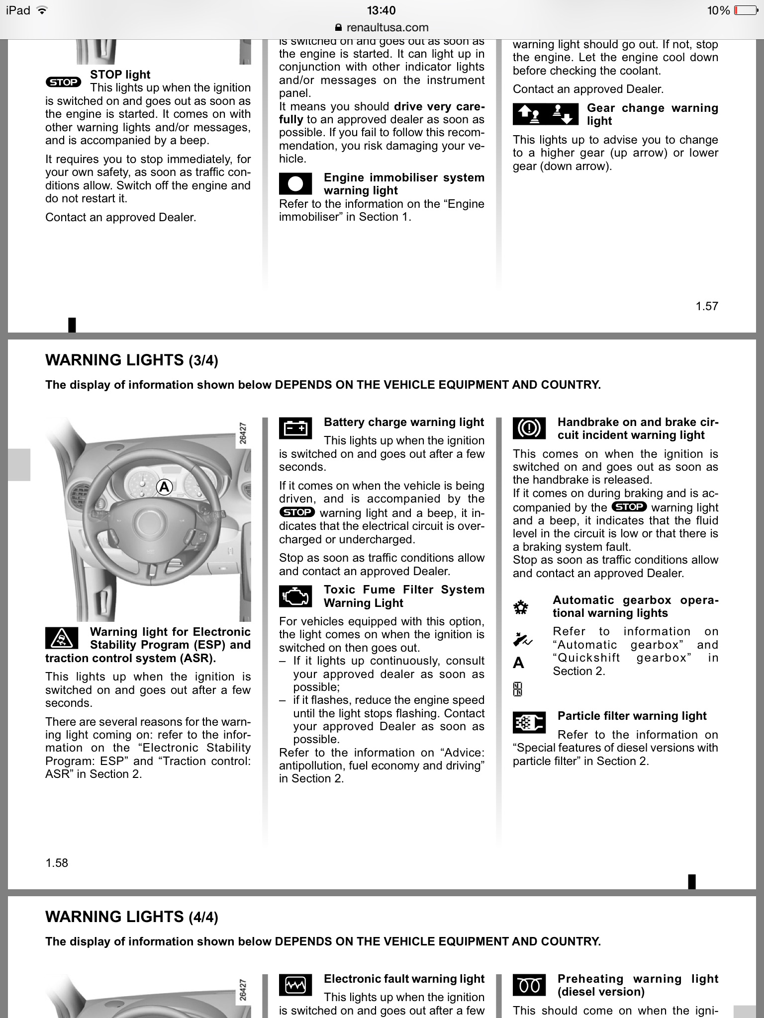

Cheers Martin, it's not the Particle Filter, as it's a different light
It's this one here :
The DPF is this one in the bottom right :

Isn't that just the U.S. Market?
It's referred to as an engine management light in my manual I'm sure.
Pretty sure mine stays lit till the engine is started.
I don't know, it was in the manual with the Clio that I looked at
I always refer to it as the Engine Management Light, but when I looked in there it said Toxic Fume Filter...so don't know?

Will have to take a look. I know because of California and the hippies, their emissions are quite harsh, but I've not heard of anything like that in the UK cars.
Martin_172
yeah that's just the eml then, nothing to worry about, it lists it as the "toxic fume warning light" but that's obviously just for petrols with a cat/lambda
on yours its used to highlight issues with EGR valve among others, as long as it goes out when the engine starts then that's fine, its the same on all clios
