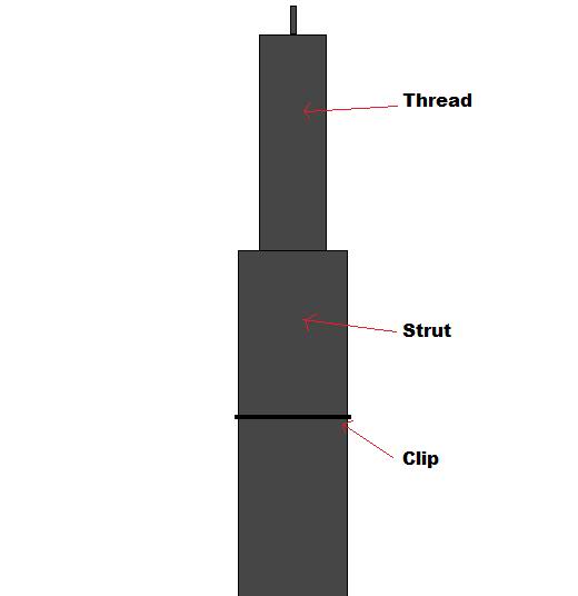

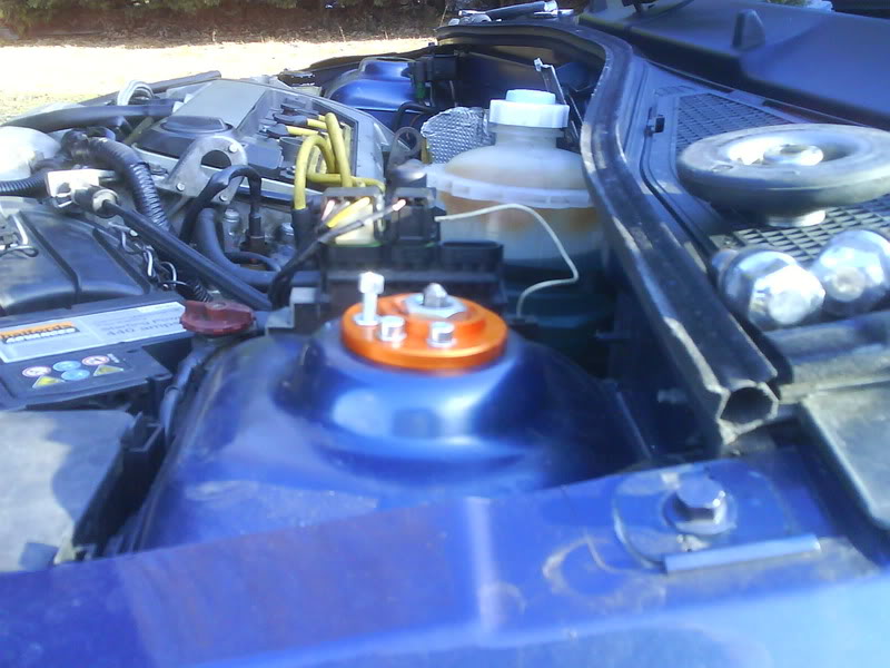

in your third pic the bearing and orange bit should sit on the black top hat, there should be no gap between the pieces. I think there's a little metal clip on the damper which is stopping the upper bits dropping down enough. You don't need to remove the clip but might need a tap with a rubber mallet or something.
On your last pic, the main orange bit should also be under the turret, just the small bolt ring sits on top.
I'll try and find some pictures :)

Ahh i see what you mean about the orange bit, did you have to drill the turret?
In you picture of your topmounts built up you have the adjustable tab showing. If you loook in my forth picture my nut doesnt even touch the thread. Am i being an idiot?
Yeah, the spring cap should sit with the rest of the bits (didn't see there was no spring :o). I'm sure theres a little metal clip which is stopping the spring cap dropping down enough. I'm trying to find a pic!
No drilling required :)
Yeah, the whole lot needs to drop down more. As far as I know the bearing and spring cap are standard sizes, the only mod for FK's is the top hat so it should fit!
Couldn't find a pic, so this is paint's finest!
Either it won't fit over the larger diameter of the main strut (which it should) or it's that little clip getting in the way.
Thas a great picture, To be honest i have'nt noticed any form of circlip on the strut. I think its the diameter of the strut or the hole in the top hat that is'nt big enough. It goes down part of the way but when it reaches the thicker part thats it.

It is quite a tight fit so maybe just needs some WD40 and mallet persuasion?
I removed the clip to get the parts on then put it back on, probably don't need to replace it but saves losing it!

Sorted now with some hep from MC hammer, just had to tap it down over the wide bit of the strut. Thanks greg
