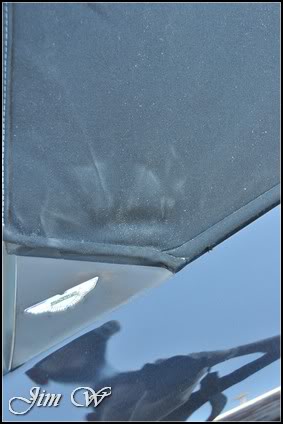

The car wasn't in the best of conditions; hazy and scratched paintwork, a grubby interior and a roof full of sand (life on the coast!). No way would the car fetch its full asking price in this condition, and, as the car was to sit under the spot lights in the showroom, it needed to look its best. *Cue WhiteDetails!*

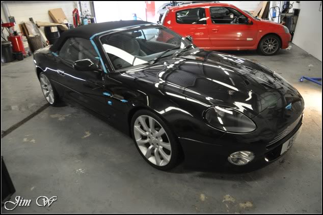

Vehicle inspection:

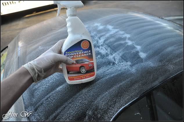

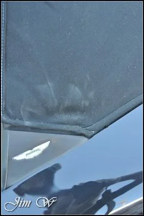

Roof scrubbed with 303's cleaner:
A bit of time spent with G101 and a soft bristled brush cleaning panel gaps, badges, petrol filler housing etc.
Usual two bucket wash carried out and then rinsed.

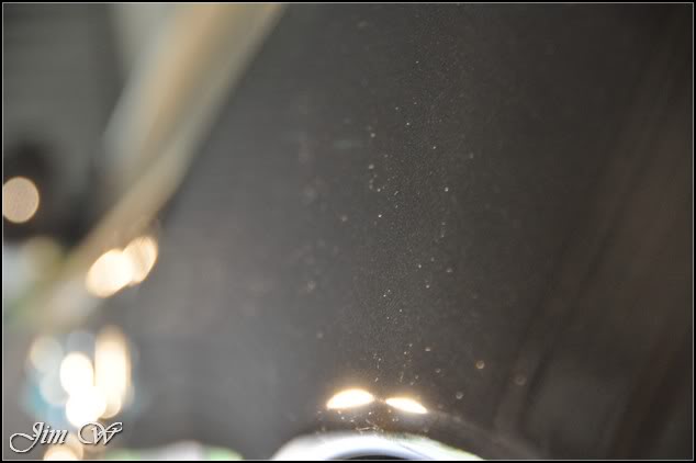

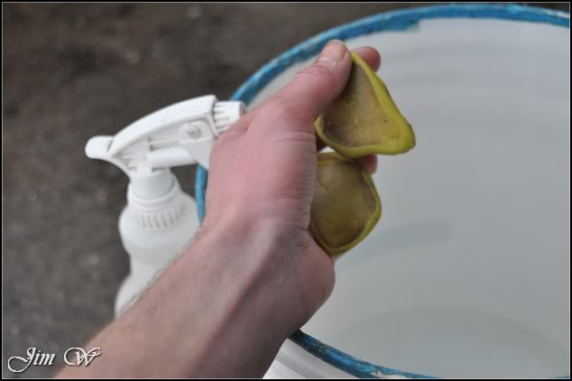

Clayed with Elite's Mild grade clay bar. Badly contaminated!
There were a few areas where I had to reach for a medium grade clay bar; the car was covered in specks of paint (proved very difficult to remove! (either from its previous life, or, from the bodyshop where the front bumper was recently sprayed))
Once rinsed and dry, the car was parked up behind the scenes and prepped for polishing.

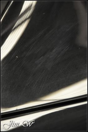

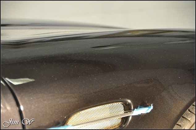

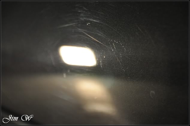

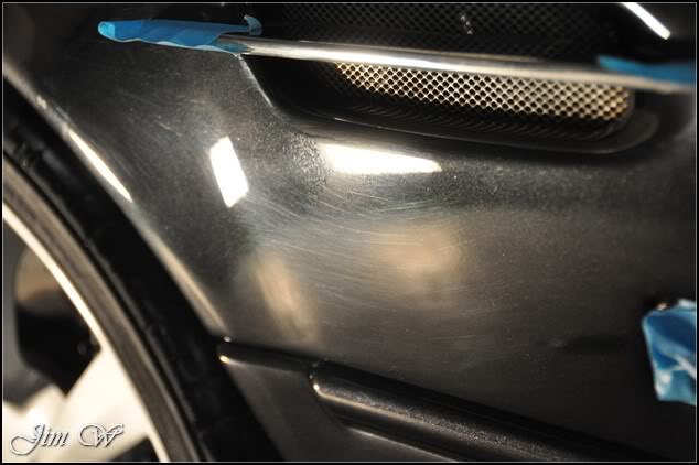

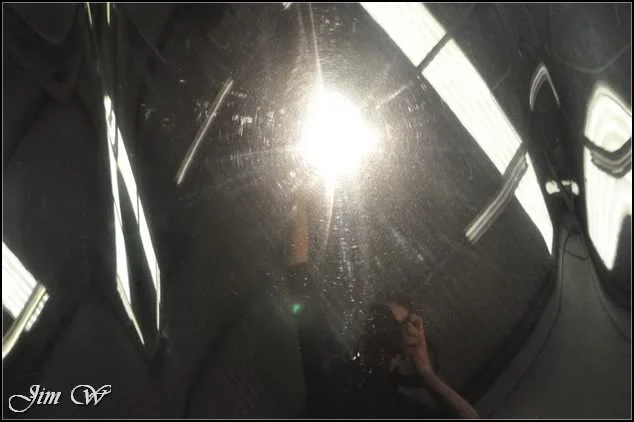

Paint inspection...

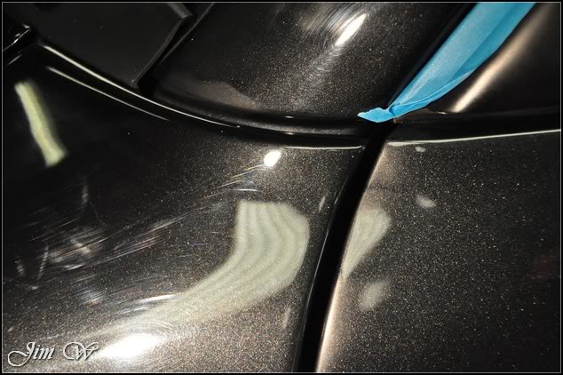

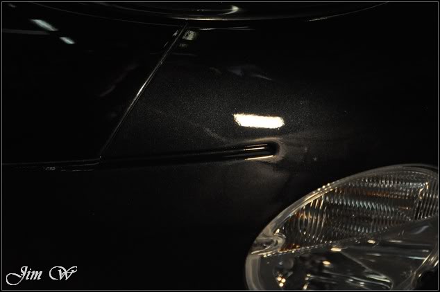

Overspray on the N/S front wing:
on the lower edge of the N/S A-Pillar:

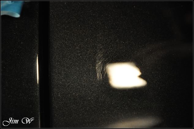

on the bonnet:

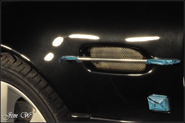

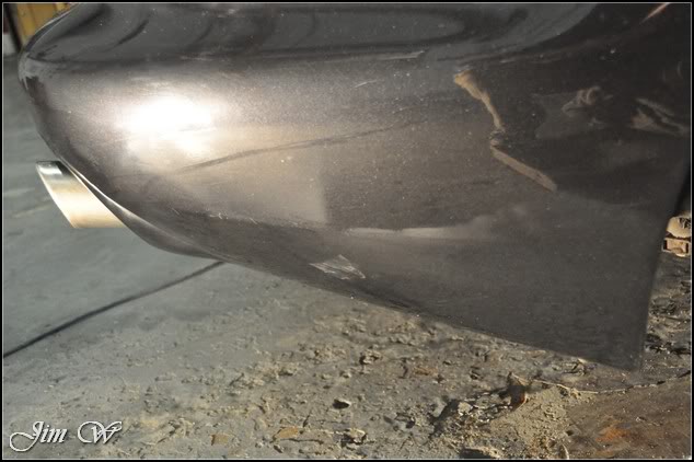

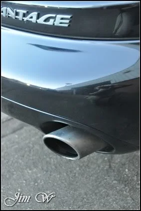

and on the O/S corner of the rear bumper:
Nice.

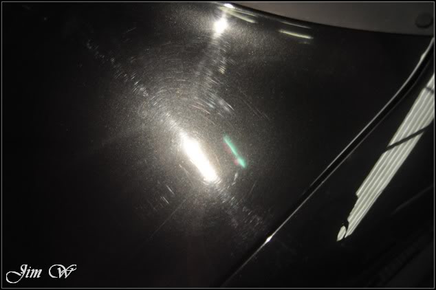

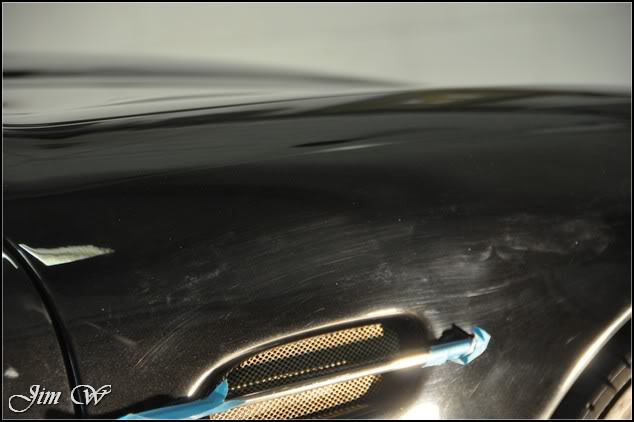

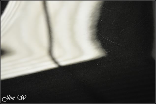

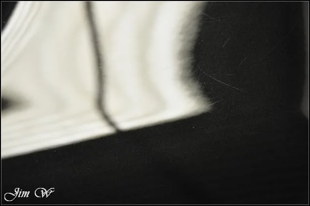

More defects:

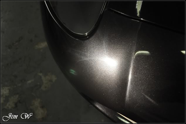

Here's the freshly painted front bumper. Buffertrails:
My spec was to perform a major paint correction detail, add some engine-bay work, leather care and a full interior overhaul. Time allocated? Two days.

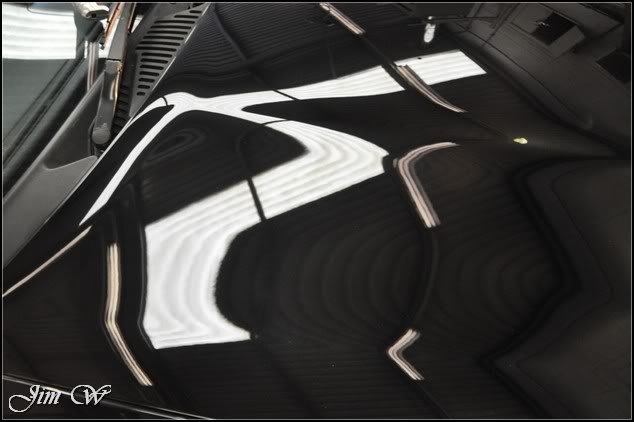

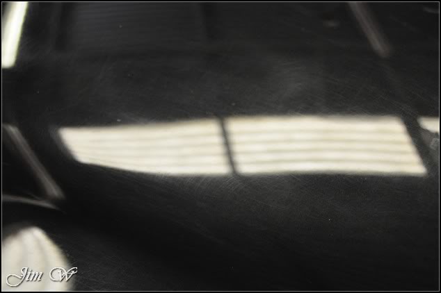

After testing, my go to polish and pad combination for the resprayed bonnet was the heavy cut yellow hexlogic pad, 3M Fast Cut+ and a blob of 3M Ultrafina to aid my work time.
Bonnet before:
and after my first pass with the above approach:
Too many marks remain; a second pass required.
It took three heavy hits of compounding to achieve the desired results. After refinement, we were left with:

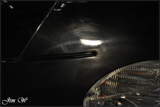

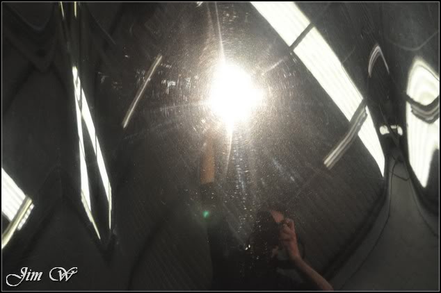

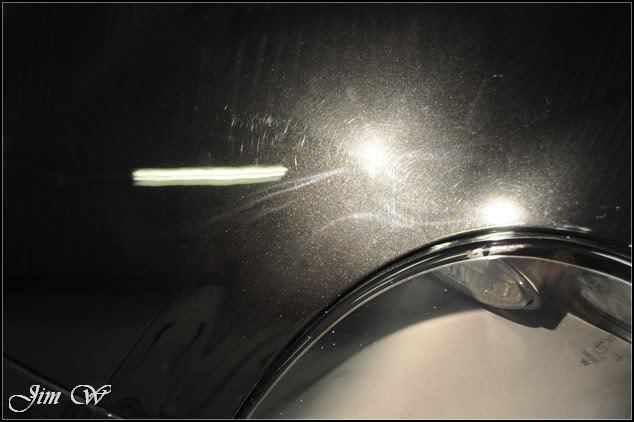

N/S front wing before/after:

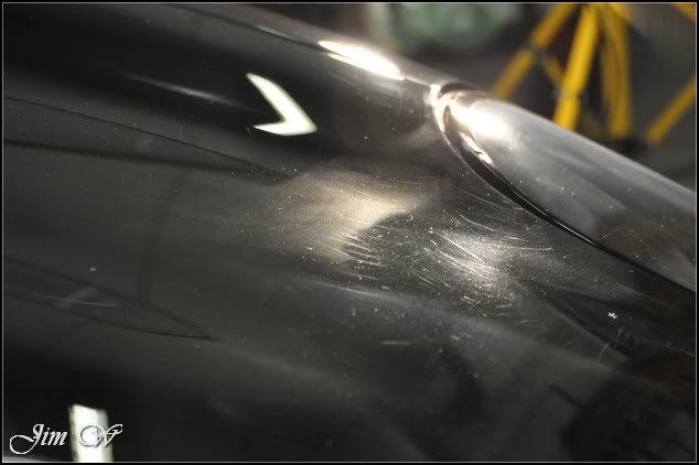

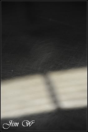

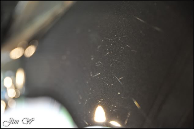

Oops. Someone missed a bit at the bodyshop! DA sanding marks:
Area had to be re-hit and refined to remove completely.

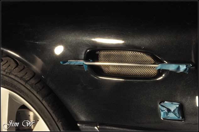

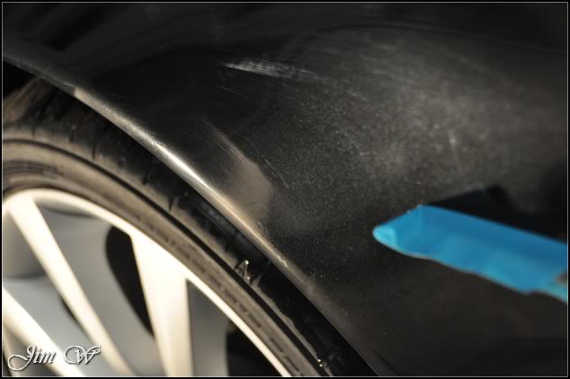

Although the initial compounding passes were making a world of difference, lots of panels had to be hit again and again as they were riddled with deep scratches.
Before (after first pass)
After (four hits later (on the N/S rear wing))

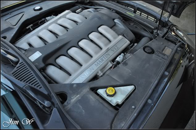

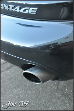

Back inside, it was blown dry with the black baron vehicle dryer. Wiped with IPA to remove polishing oils. Sealed with Blackfire's All Finish Paint Protection. Exhausts polished with Autosol and 00 wire-wool and engine bay dressed where appropriate.

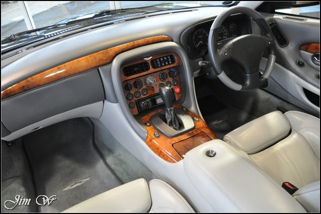

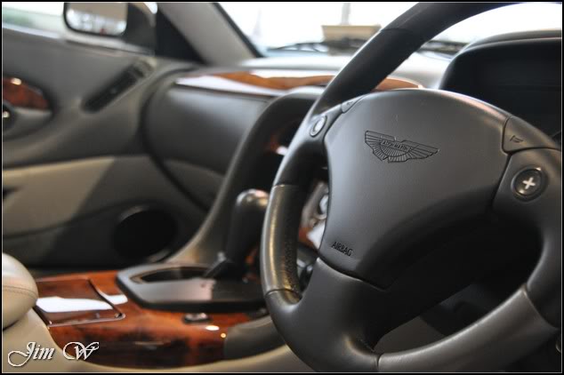

Interior.
Leather deep cleaned with LTT's Auto Ultra Foam. (including centre console, doorcards etc). Plastics, pedals and mats cleaned with G101. Glass throughout with 3M Glass Cleaner.

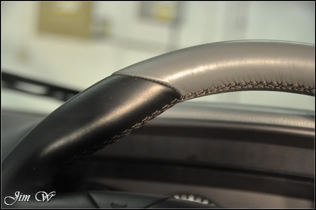

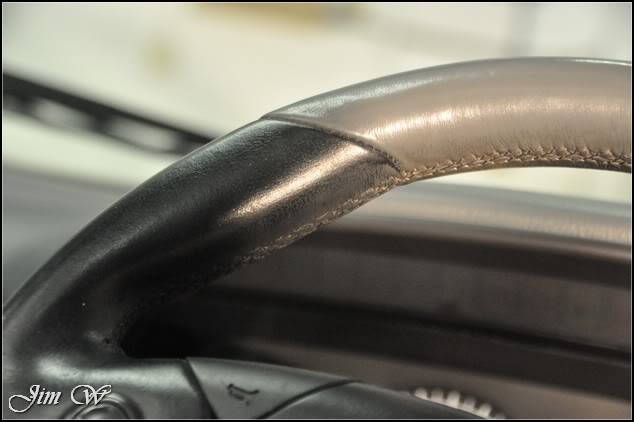

Steering wheel caked up. Before/After

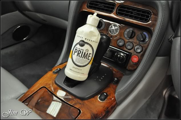

Trim polished with Jeffs Prime:

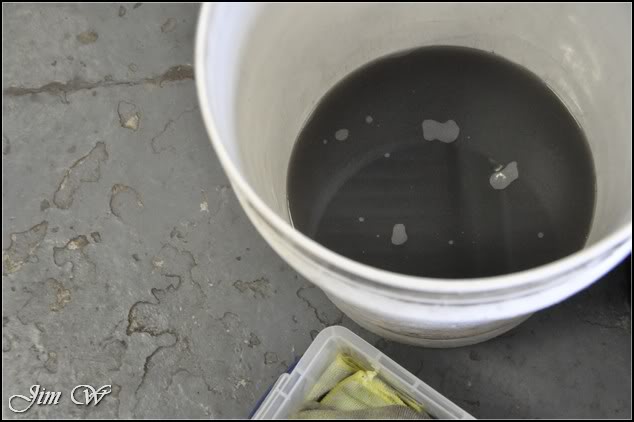

Rinse water collected from the leather seats, carpets and trim.

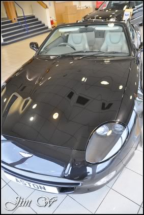

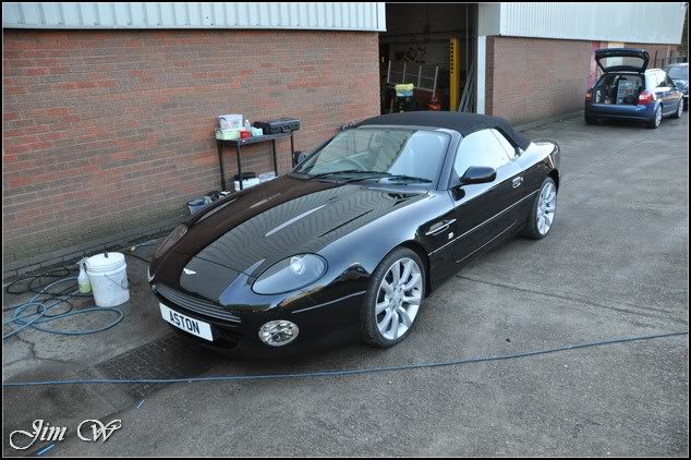

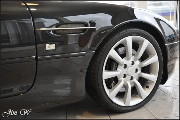

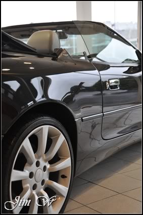

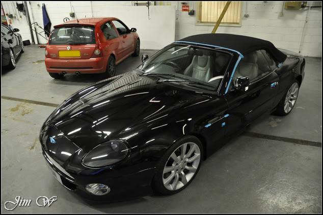

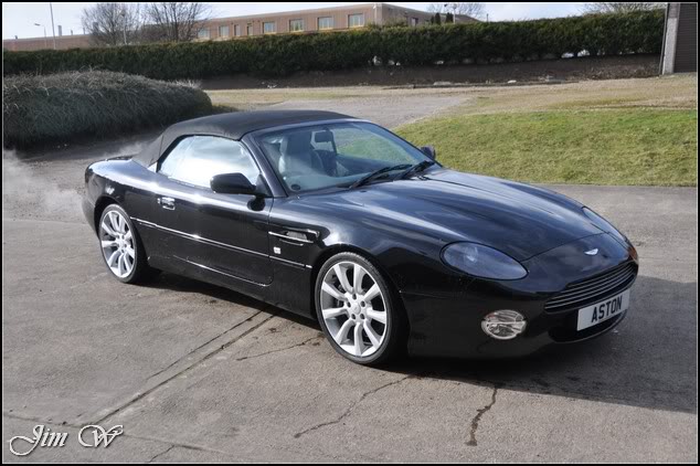

Finished.

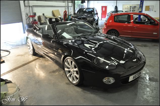

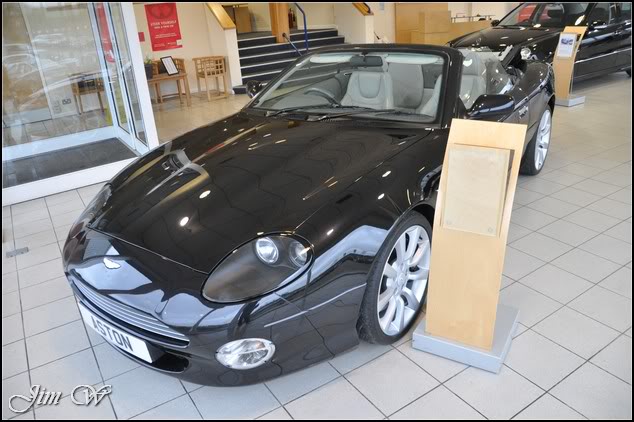

And after dodging the rain, in the showroom ready for sale:

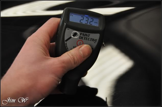

Interesting that the paint was so hard Jim... I had a DB7 (granted a Y reg so quite a lot older) and the paint was very soft. I swapped to the DA purely for ease as it had enough cut! I'll drag out some photos...

Holy crap, JD, that bonnet looks ruined! Yeah, granted the bonnet had been sprayed so it wasn't factory, but the likes of the pic of the N/S rear wing, that was standard paint and was laughing at me! Crazy how much difference there can be between the same car and a couple of years in manufacture!

How did you get the leather restored so well?
Amazing work Jim, i am assuming some of that dirty water was picked up via help from the Vax 6131?
Nope, all hand work. The bucket was my rinse water for the cloth.
Leather was cleaned with LTT's Auto Ultra Foam and the wiped with a wet microfibre to hydrate.
