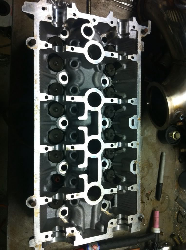

Head all back from having work done. It had actually bent a valve so scoffs ordered a new one for tommorow, really could of done without all this as he has more cars coming in this weekend so not going to be able to focus as much on mine :(

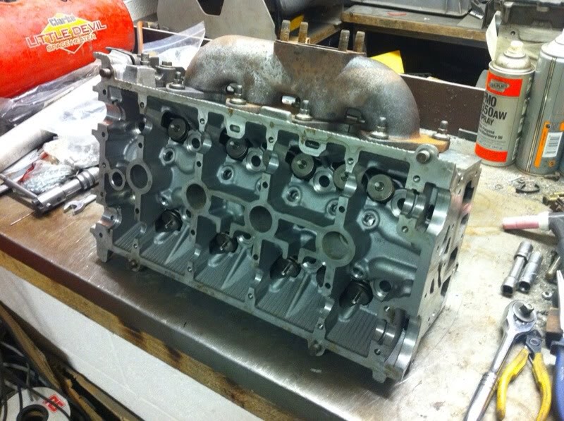

Head done and built back up new valve fitted looks mint to me :)

Hopefully pal he has a scheduled car coming in tommorow for the week so working around them both done for sat he says :)
