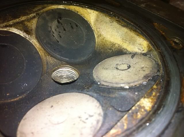

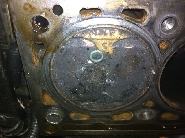

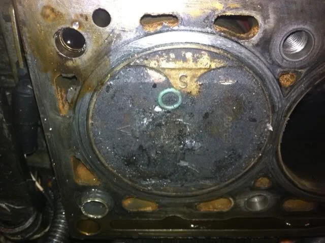

I guess this is kind of good news. There is no damage whatsoever to the valves or anything inside the head!
The bore had loads of dirt and junk in it as thought it had somehow been sat in the manifold and sucked in and it had got trapped between the valves and seats causing no compression. Scoff also found a rubber O ring sat on the piston!!
At first he said he wasnt going to bother with the other head i had and was going to clean that one up and re cut the valves..
Now hes decided that he would like to use the new head as on of the threads for the plugs is pretty s**t from when it blew one at the ring and doesnt have much hope staying in with all the extra pressure thats going to be running through once boosted.
So ive got to get my other head off my spare engine which im struggling to do as i dont have the locking tools send it him and hes going to fit that head obviously this has added a fair few £££ on the job but i just want it done now

Yep and i rememeber a while ago had fuel leaking out of the injector closest to gearbox end now im not sure if there was an o ring on it when replaced, by the looks of it there wont have been as its there!
