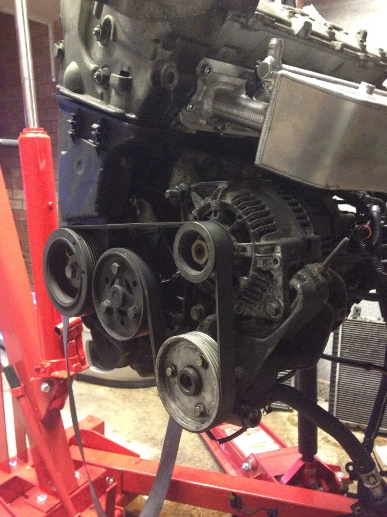

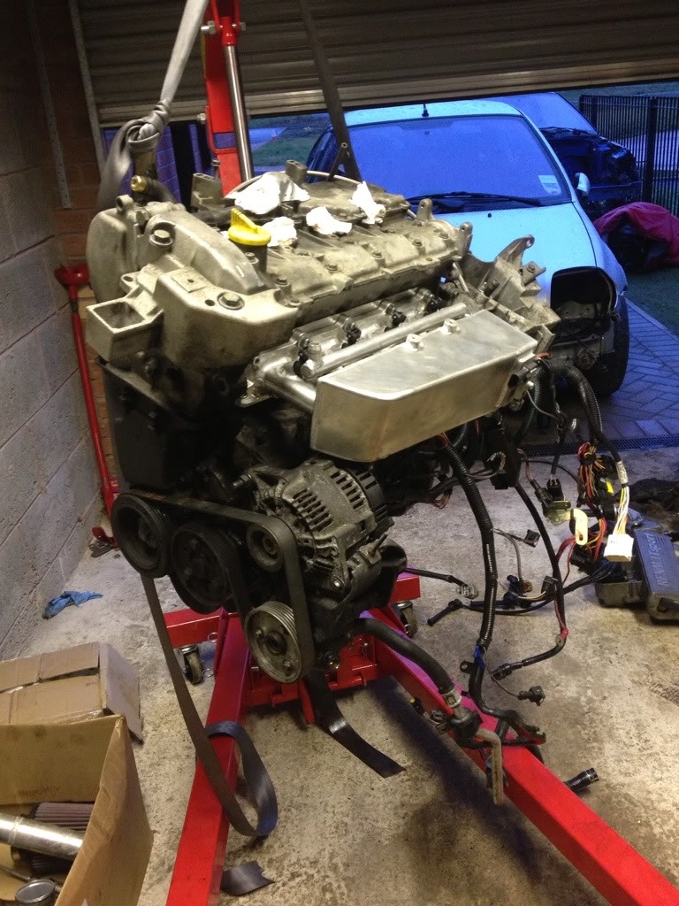

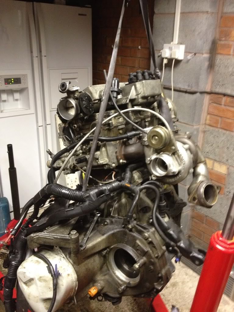

Just finished fitting the cup alternator setup and the custom Manifold along with the Megane injectors :)
Does the alternator setup (aircon delete) look about right followed a few pics on here basically took all mine off and put all the cup setup on,,

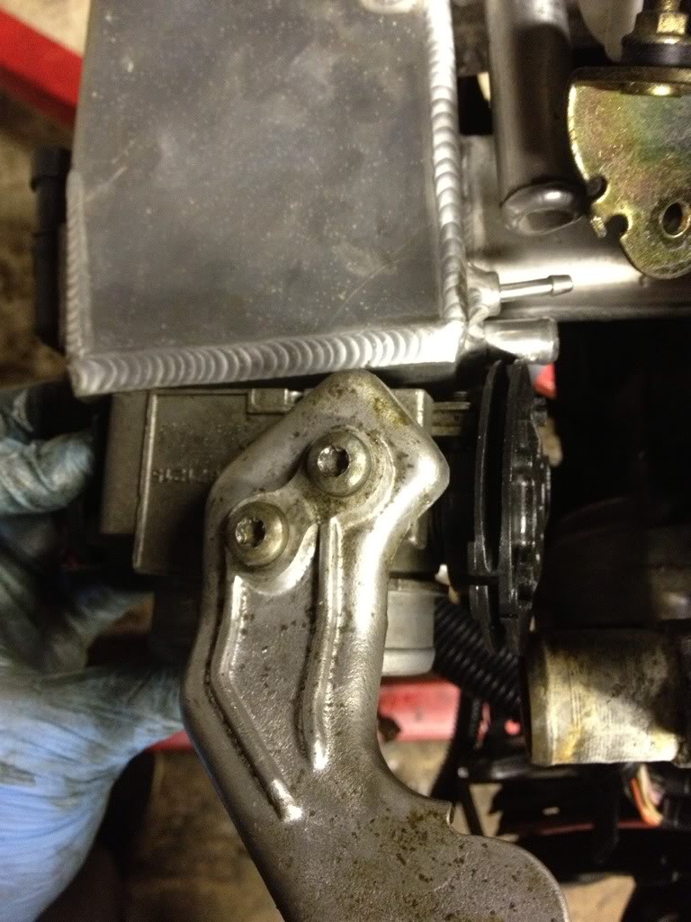

Slightly concerned about my TB been down at the front regarding the throttle cable,, would I be okay re routing the cable or is the idea just not gonna work
  Trafic 140dci
That inlet plenum looks pretty sexy tbh :)
Regards to throttle cable i'd re-route it to come though the side of the engine, under the top engine mount and then bring it over the inlet plenum if that might work? Done my ITB's that way.
Thats not the way the belt normally is routed so expect someone to start telling you that it is "wrong", reality though is that it will work fine the way you have done it, you just have a little less purchase on the alternator pulley than done the normal way, although on the flip side you have more purchase on the PAS pulley done the way you have.
Normally goes from the top of the crank pulley under the water pump, then up to the alternator then down to PAS then from PAS back to crank.
  172 cup, Impreza P1
The belt is on the wrong way. It should run flat along the bottom between the ps and the crank then over the alternator and under the water pump.
Chip- beat me to it but it's not the way renault say it should be routed.
  HBT 172 Cup
I seem to do that belt route every bloody time i put an engine back together lol. I actually ran it like that for a few thousand miles without ill effect but it chews up the plastic cambelt cover. do as the above wise people say :D
  182/RS2/ Turbo/Mk1
Renault way isnt always the only way that works, it honestly will be absolutely fine the way you have done it, but if you want CS approval then re-route it as no one on here likes any form of variation from renault default, lol.
Personally I think the advantage of your way is that it is less likely to slip when the PAS is loaded up (slicks etc) as it gives more purchase on both the PAS and the bottom pulley, so if its for a trackday car where the alternator is unlikely to be loaded up much, I kind of think its an improvement that way if anything (once its made its own clearance on the plastic cover like Laine mentions)

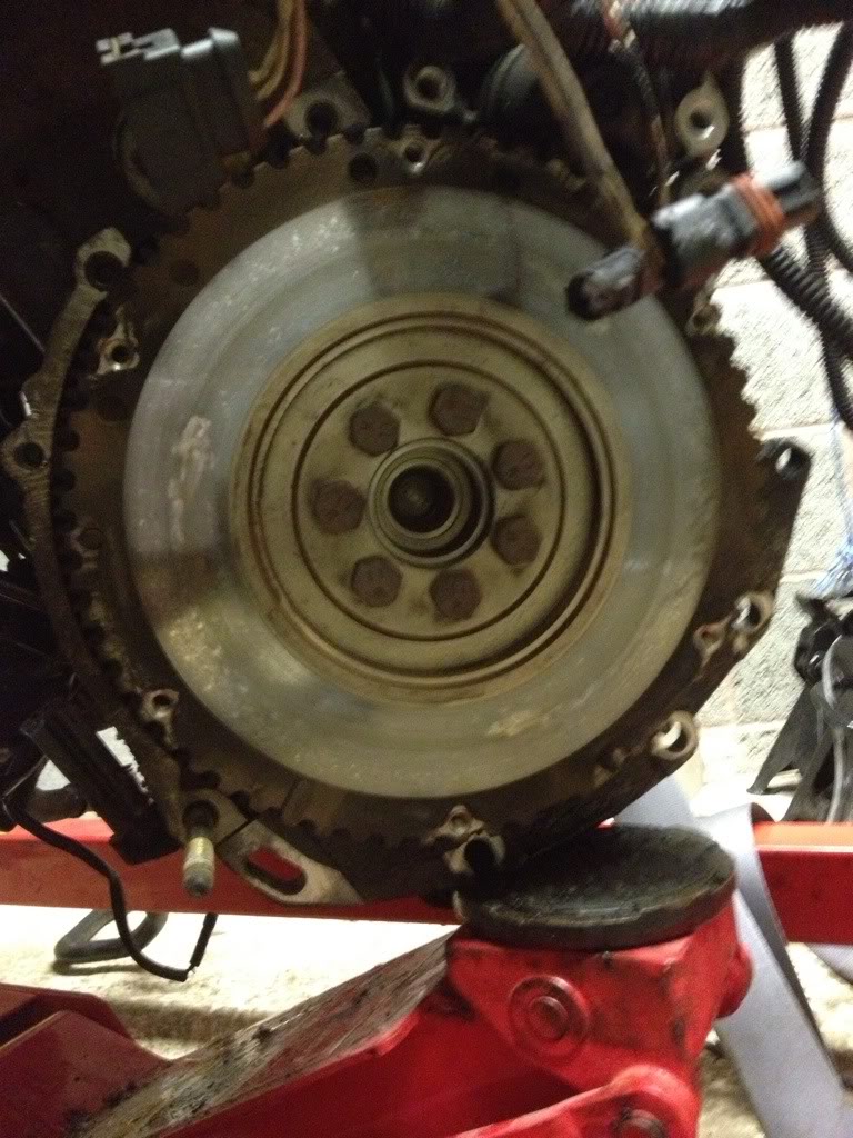

Get the clutch off and look at that while you have it exposed anyway.

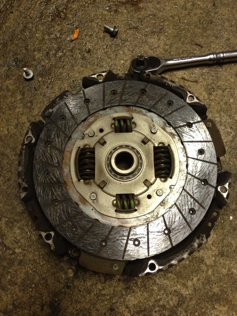

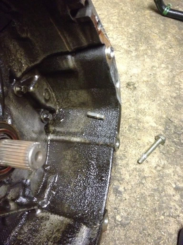

Removed clutch now ill upload some photos as I don't know what I'm looking for to tell condition wise
  182/RS2/ Turbo/Mk1
Its worn but not worn out.

Just make sure you line it up as centrally as possible as it will make it awkward getting the box on otherwise as the spline wont be in the right place.
Just use that one then mate if its only for a few months, then buy a proper one next time.

Just put box back on the fork is that the bit the clutch cable goes on? There's no play in that and I'm sure it clicked when moved it before??

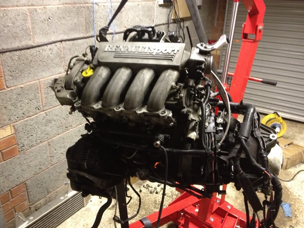

Not happy! Looks like the inlet manifold is going to have to come off after all..
Won't fit on at all
  Ph1 T
And it had been built for a ph2 TB and the fitment must be a lot different as nothing lines up. Idiot for not checking before
Won't fit on at all
That will be easy enough to sort.
Quick fix is just grind the end off the bracket, if that weakens it make a new bracket.
I've moved mine a long way to clear by strut brace with the 197 inlet and it still operates fine.
  172 cup, Impreza P1
Think they are straight on but can check tomorrow on my old cup engine with the 225 manifold. Just so you are aware though, the inlet diameter is 42mm but this is still enough for 300bhp and I think is capable of more.
I made a simple adaptor plate to mate a megane 1.6 cable tb to the manifold. You woul also need a megane fuel rail.

Been working on the car from about dinner up until now got a few bits done and spent a lot of time doing stuff I shouldn't of had too my own fault though...

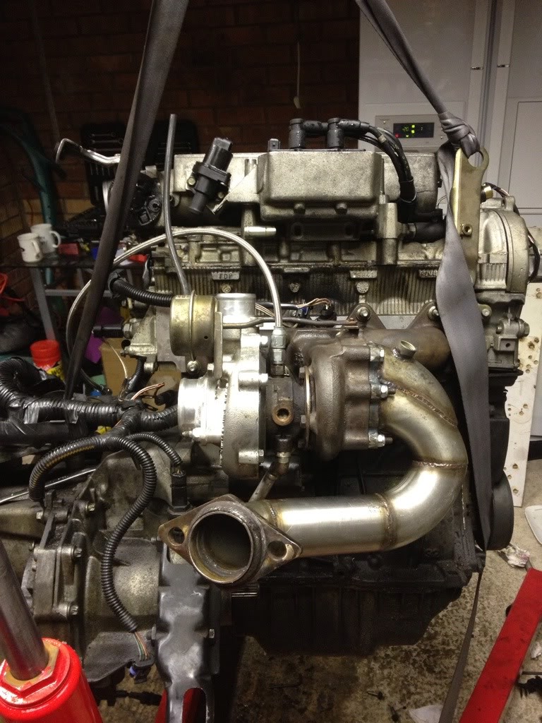

Fitted new downpipe (thanks cupman29)
Fitted cup alternator aircon delete kit
Fitted then removed custom manifold :/
Had gearbox off checked clutch
Fitted new Megane 225 injectors
Think that's about it few pics
We had both had enough by 11 :)
Plans for tomorrow:
Somehow get hold of a deep E8 socket to remove cup sump and fit it on my engine.
Fit intercooler
Get some vht paint and do a few bits, manifold,TB,engine mount just tidy it up abit
Basically get everything done and ready for the engine going back in Monday :)
