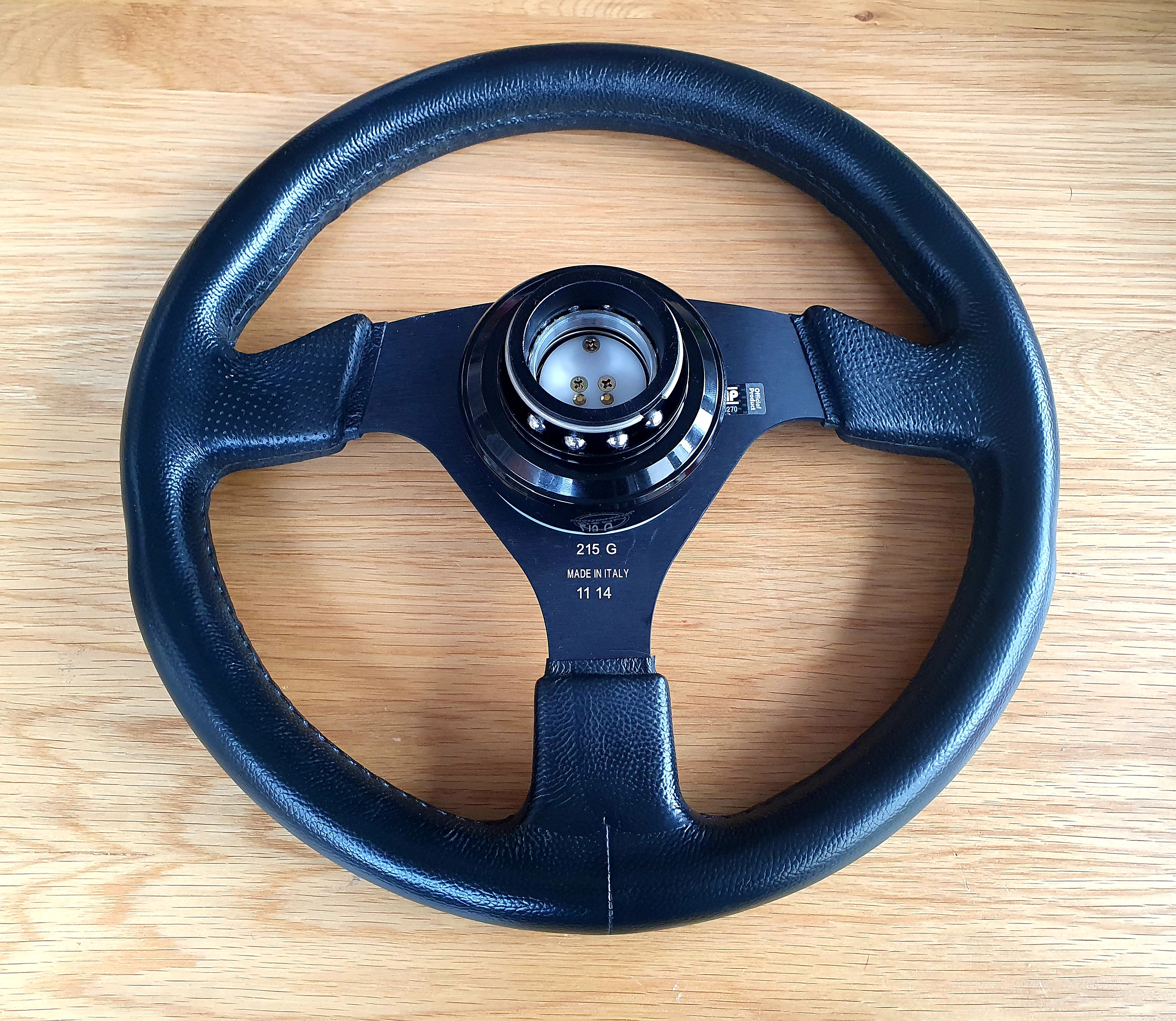

I use one from jjc, quality seems good.
I’m sure it is the same as the motacoarsa one but half the price
The one I have
The motacoarsa one
I have always found the ones with splines as per the 2 above tend to develop play. Only ever used lifeline splined versions though.

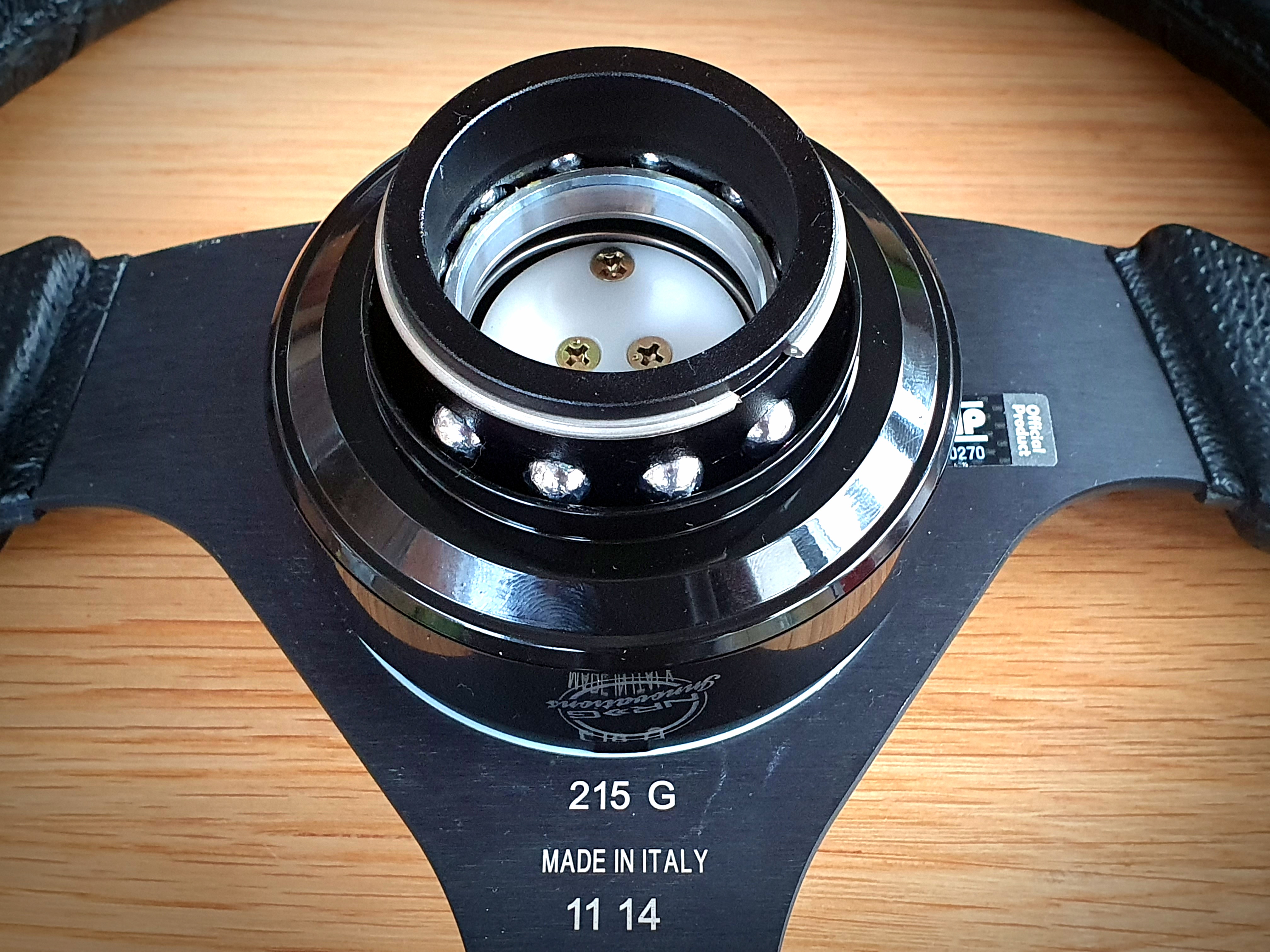

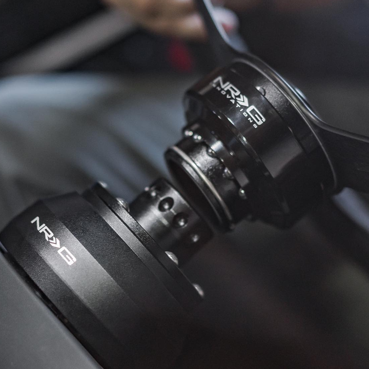

The CBS, NRG Innovations style etc use a series of ball bearings to locate instead of splines. As yet i havent found any issues with the ball bearing type

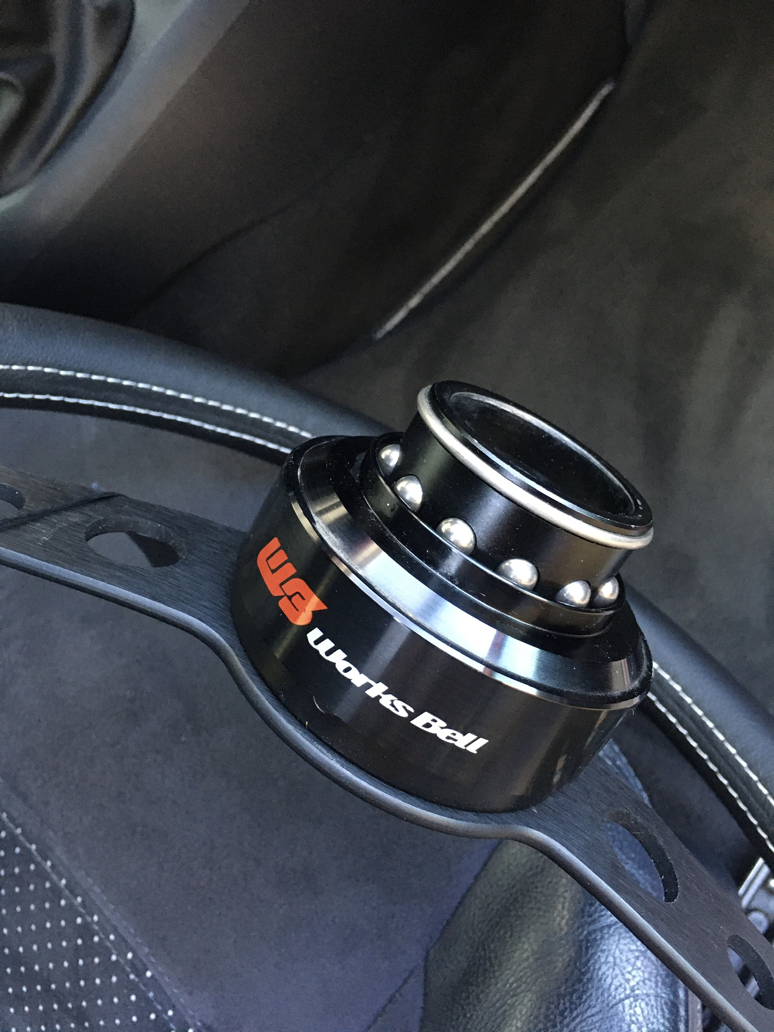

I’ve a Works Bell Rapfix2. Really high end JDM build quality and zero play at all.
Nice part of this setup is the optional lockable boss cover. I leave the wheel in the car on the seat with the lock installed. I can’t ever see anyone getting it off in a hurry.

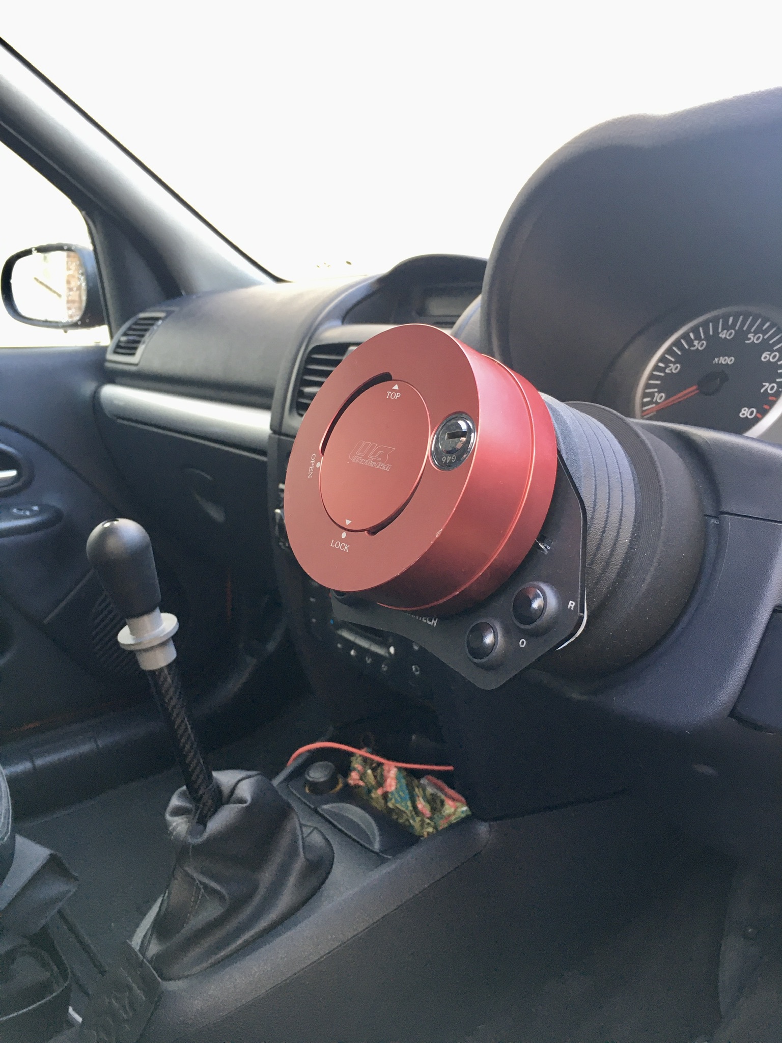

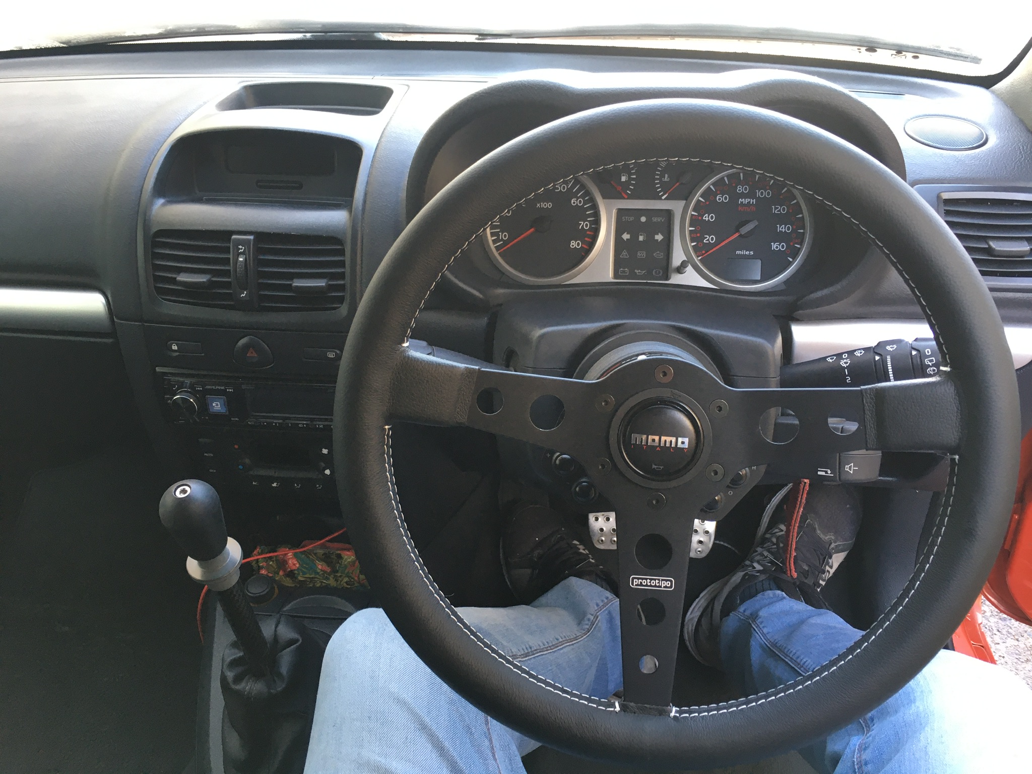

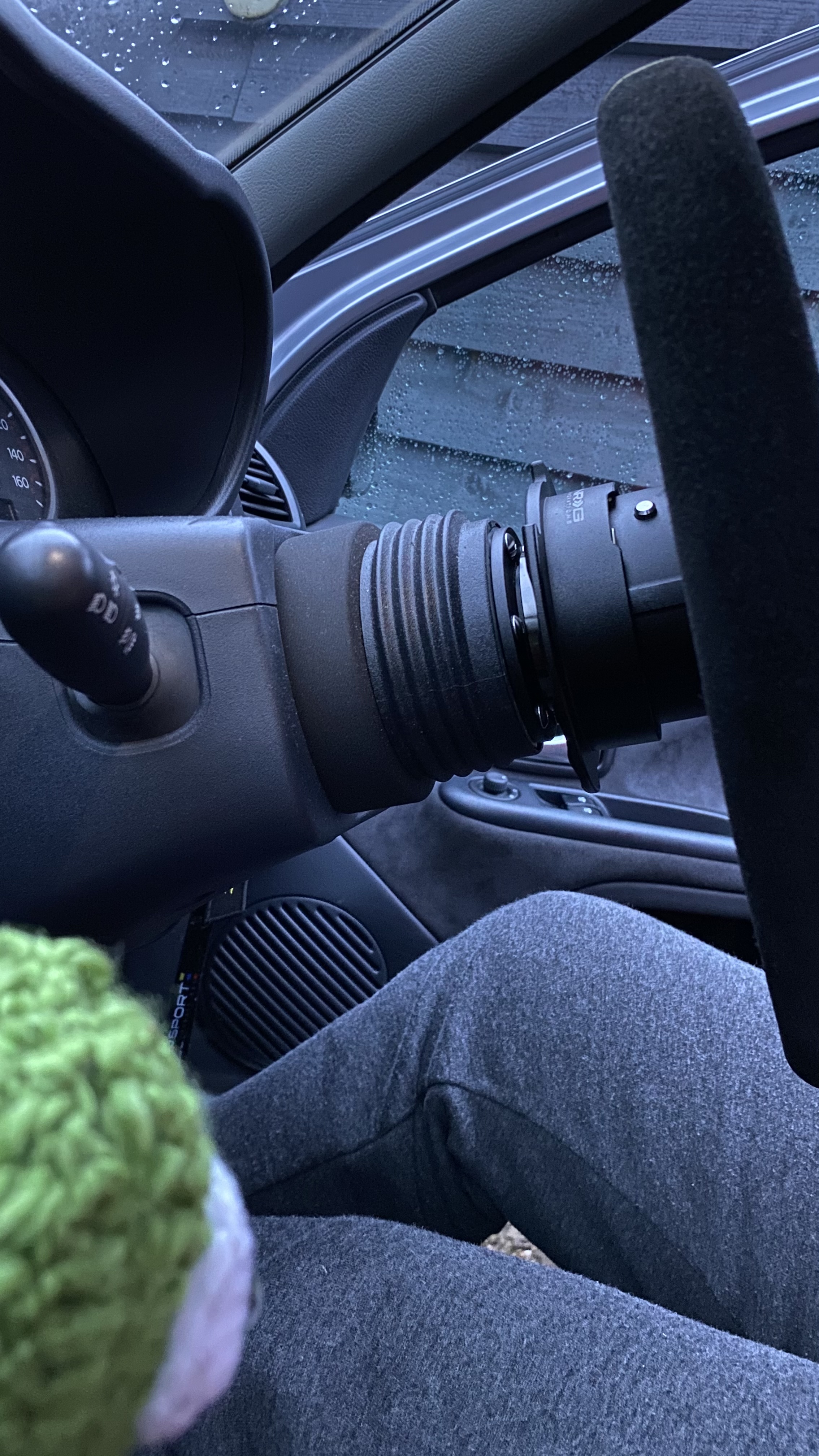

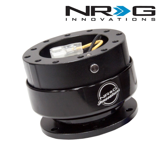

@MrBlonde What boss are you running here, the length along with the NRG QR looks spot on and not in your chest.

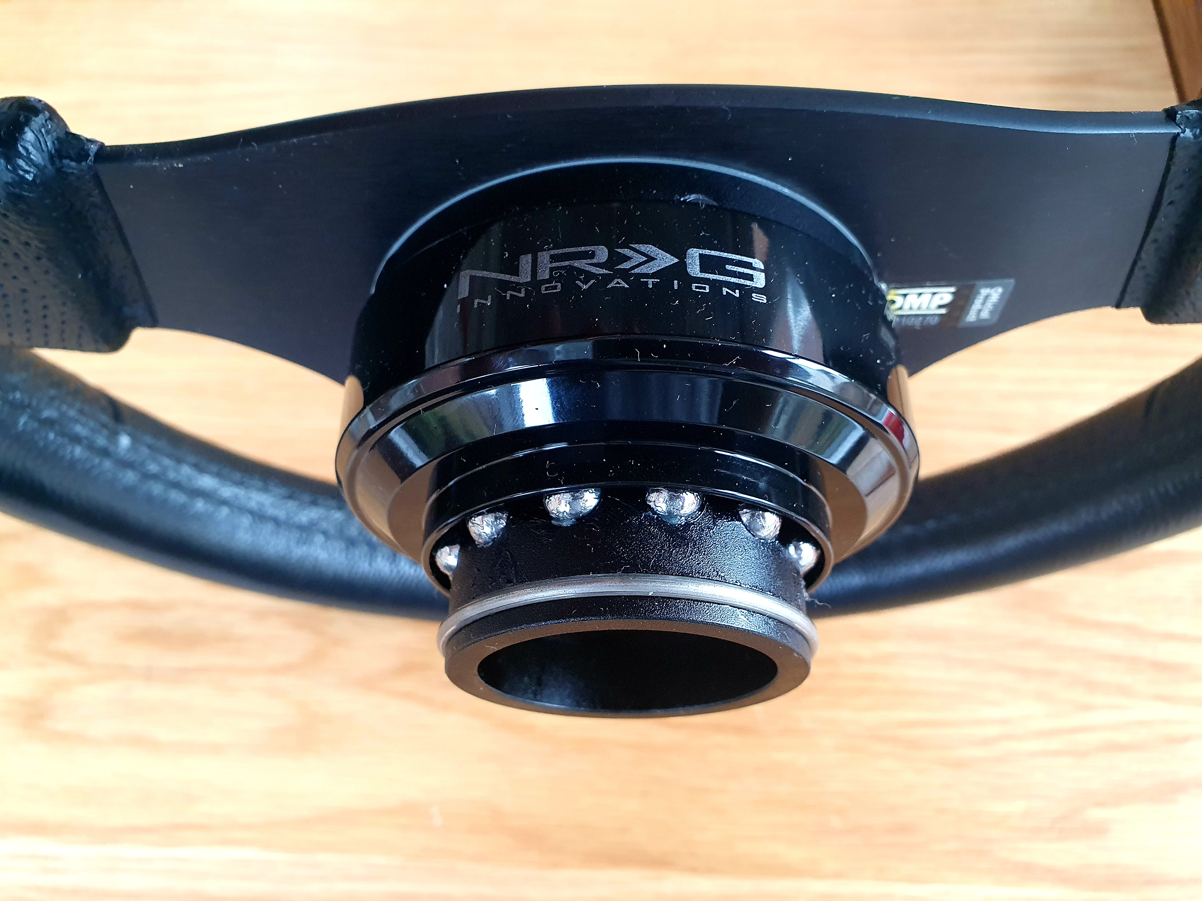

Also where did you get the NRG quick release from as I cant seem to find the one in your picture?
The NRG Web site has shown out of stock for nearly a year now. I guess they've gone tits up.
The only place I can see them stocked currently that looks like the one in Mr Blonde's picture are on the Tegiwa page
Its mainly the boss I'm interested in as it looks nice and short. Last time I had a boss and B&G QR on my evo the wheel was pretty much in my chest...
Driftworks have them in stock, and a 2.8 version that looks stubbier. Unfortunately they don't have any dimensions on any of them🤷‍♂️.
You can have a look when we meet up at C&M if you want mate.
Its a Momo one mate,as this one has the hole big enough for the cables etc to go through easily,not like the OMP one which i had before.

Is it this one mate?

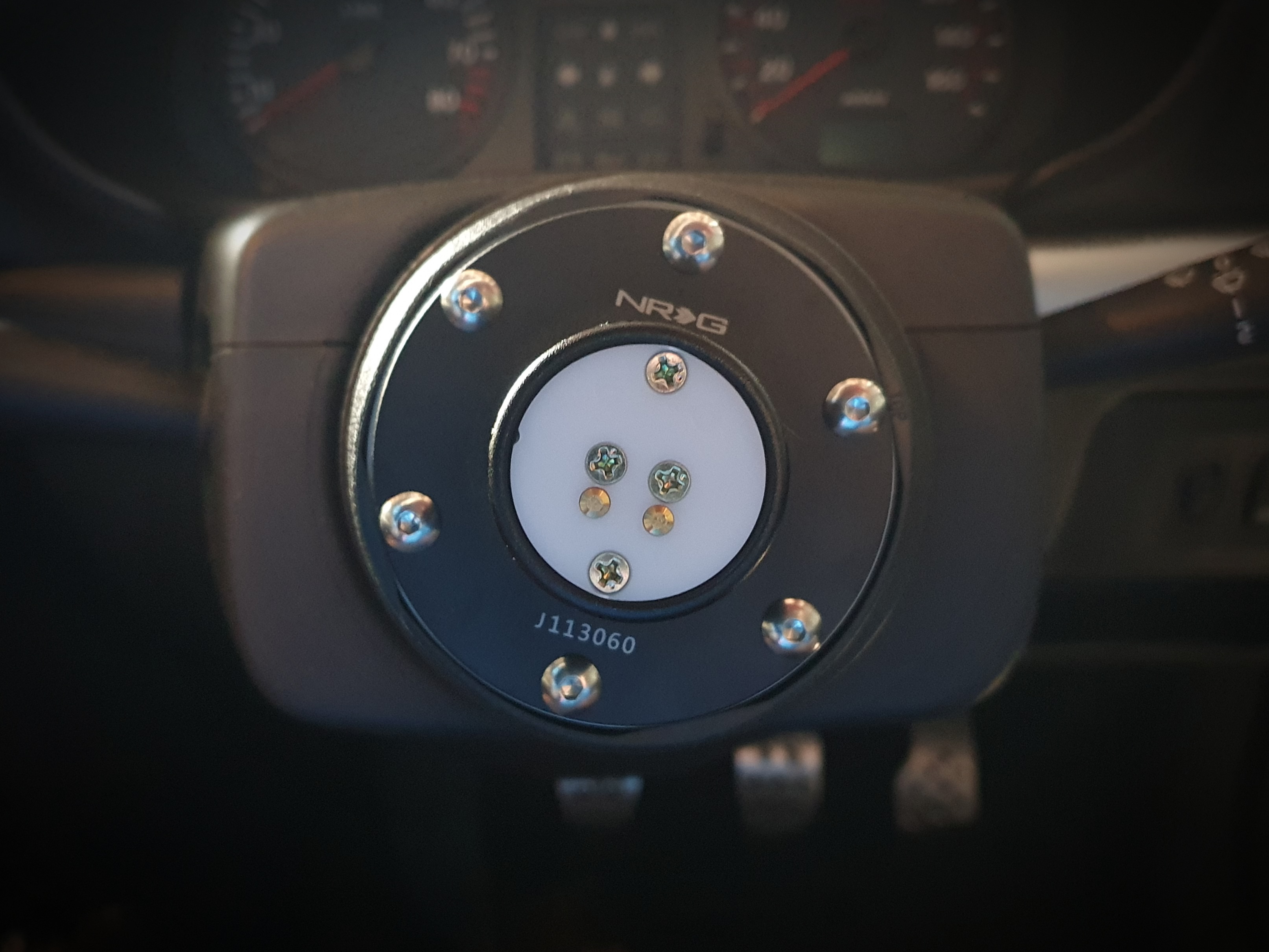

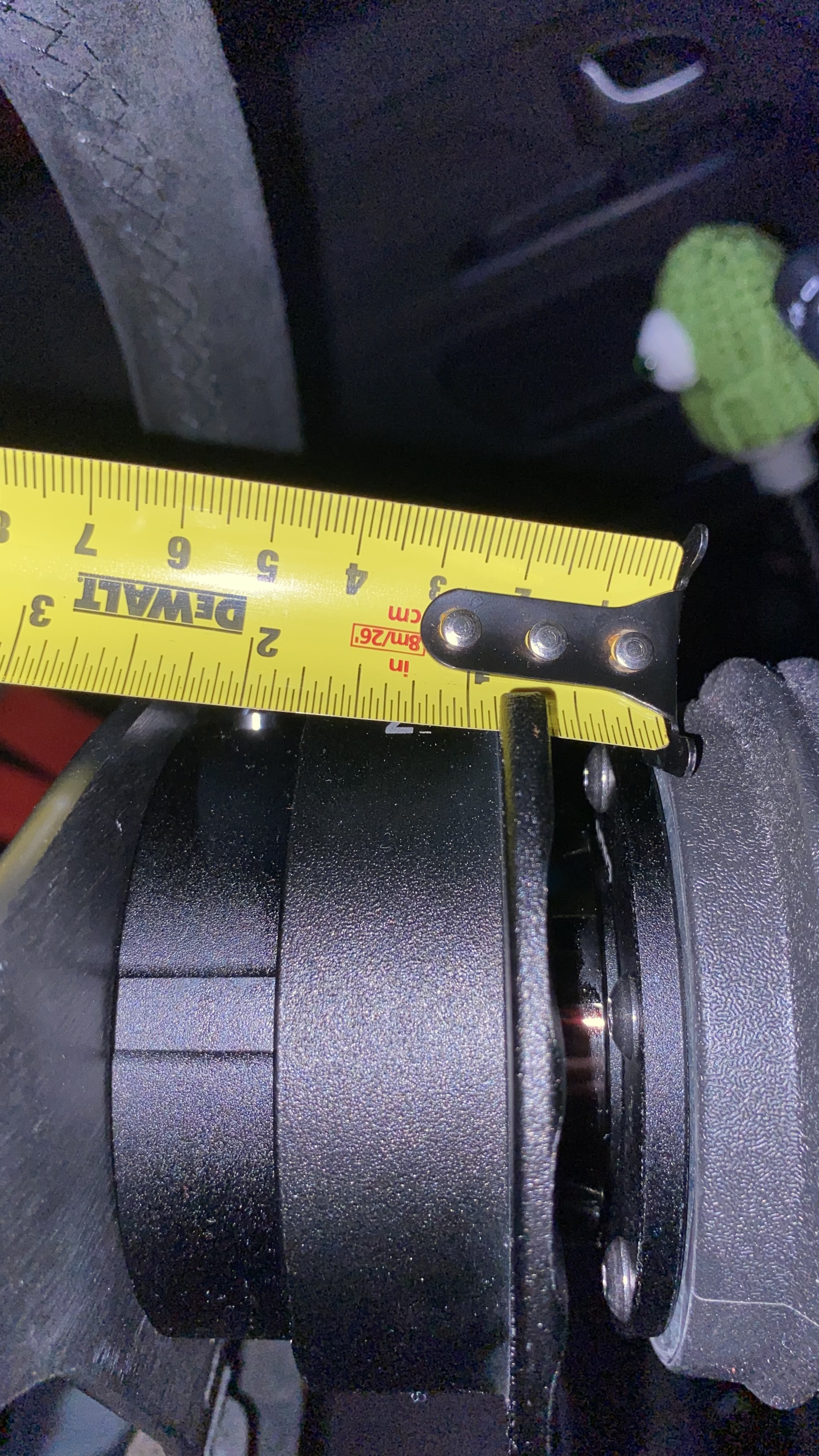

@VenomUK this is my NRG 2.8 QR with a crude measurement made using a tape. A mate of mine emailed driftworks when we bought these and confirmed all the NRG QR’s are the same height/depth, regardless of the model.
I’m also using the same Momo boss as @MrBlonde has.
Hope this is of some use.

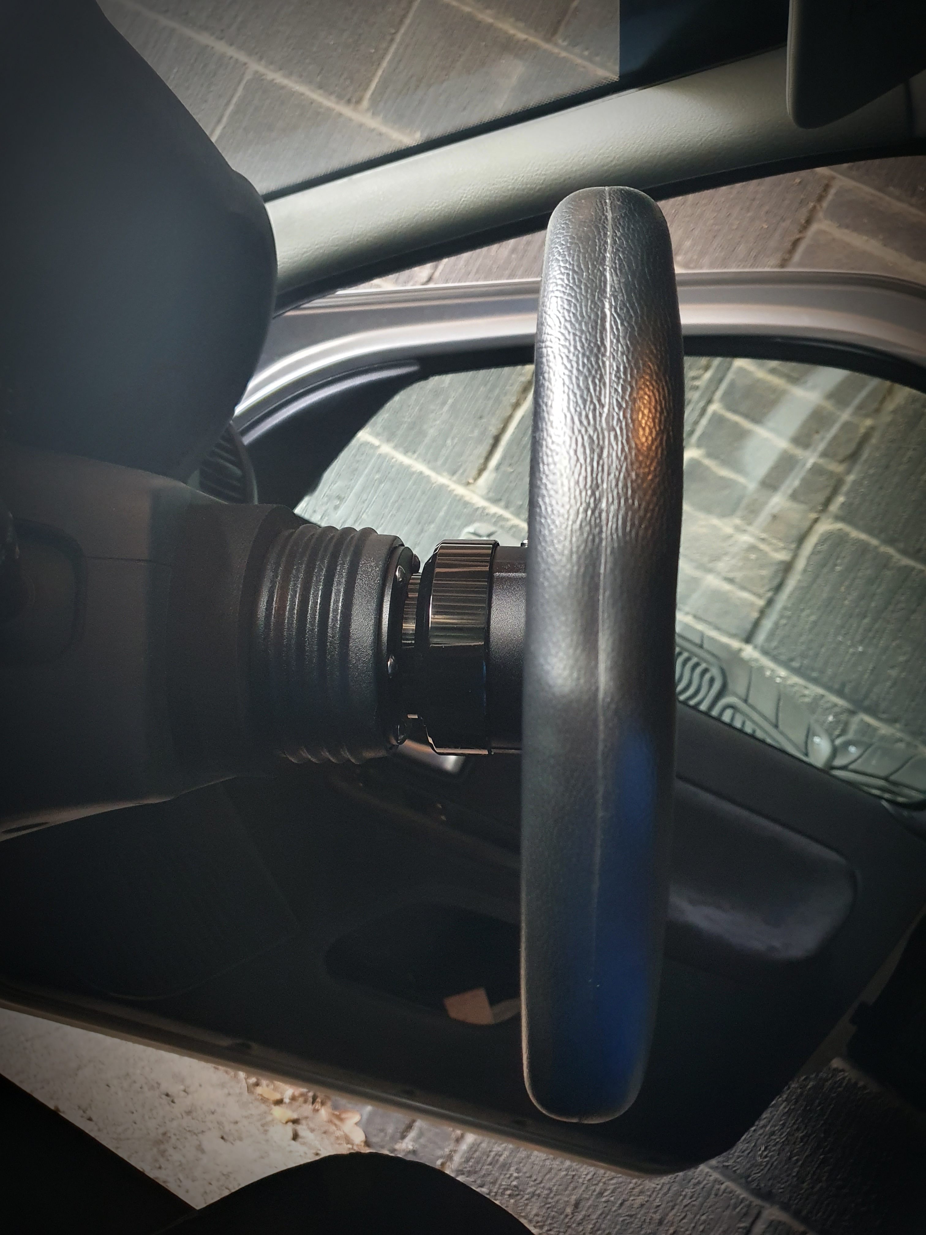

@clio_ross where did you get your MOMO hub from?
I’m assuming it’s a generic picture used on websites which is why they look longer if counting the ribs on the hub sleeve
Cheers @MrBlonde appreciate that.
I seem to remember I got mines from venom motorsport as well, and yeah it does look like they use a generic image for the website item.
100%. Spline ones always play after a while. I have the BG in OP and its perfect.
