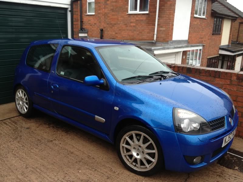

A few years back, I brought a 172 Cup off a mate and signed up here. Only kept it for a few months until our little girl was born when it was deemed too small for the buggy (even though she had a Scenic!). I was a bit gutted as it was immaculate and only had 50k under its belt.
Any way, picked this up for under a grand yesterday (found a £1 coin under the seat so it cost me £999) very straight body wise and all seems solid mechanically too - which was a surprise. Standard other than a stealth S/S exhaust and a wierd induction kit. May keep the exhaust as its not too loud and I'm aiming to use it for the occasional track day - on the lookout for a standard air box/panel filter.
Niggles are: squeaking on initial startup, Aux belt kit reqd, Steering wheel looks like its been in the oven, Cambelt kit not due for 10k, but needs doing ASAP ready for a trackday
