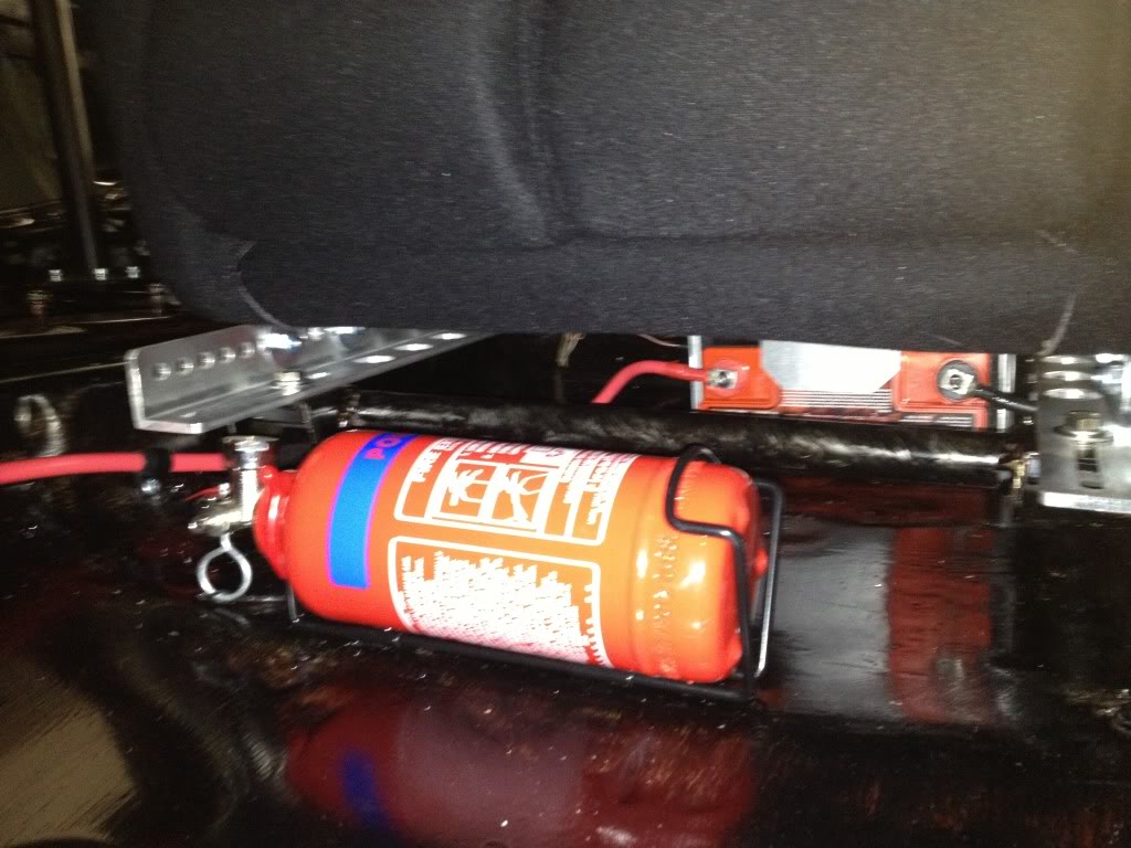

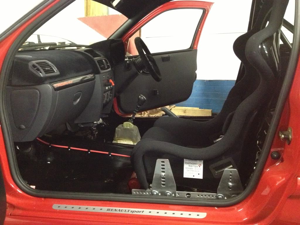

  XC90, 330d, Trophy’s
mine has been mounted between the seat rails under the passenger seat.
The best I can do :)

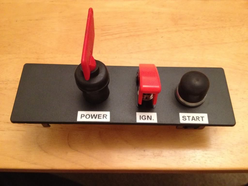

Still isolates the battery.. Same as when you take -ve off to work on something electrical
  Polo + Micra
you know there is a reason why everything is fused on the +ve and everything is switched on the +ve aswell
i wouldn't like to see what happens if you disconnect the -ve with the engine running

you wouldn't but it can be done quite easily with your setup
why would you fit a kill switch on the -ve !?
  Clio.
Check the position of the switch, and where the terminals would be.......best to have negative touching down onto the body instead of positive if for example someone were to tread on the switch mounting bracket, otherwise 'boom' goes the battery which is under the passenger seat.
