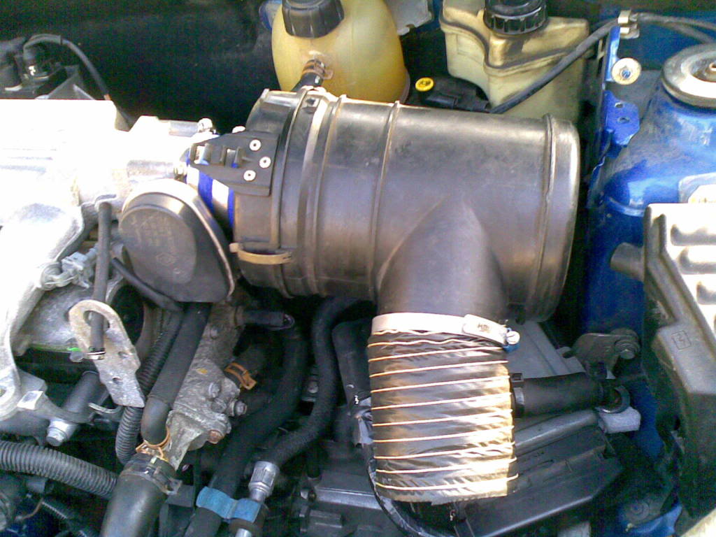

Yeah too much money for little to no gains especially seeing they are no lighter. I might just try to make a better heat shield for my ITG open filter then as although the one ive bodged together works it looks crap!

Mine really improved with the straight inlet !
Layed the ecu on it's side after removing the bracket from it.
battery went to the spare-wheel compartiment i'm afraid
