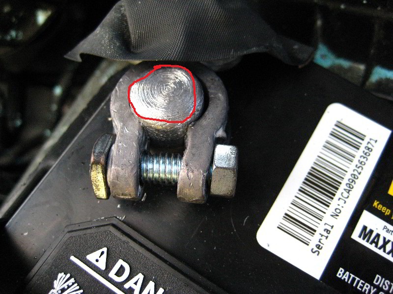

A quick question. Bought a new battery for my other car and the terminals are too small to connect to the battery. I tried bending them apart but now the bolt is too short. Is it ok if i chisel this part, drawn red, a bit smaller for the terminals to fit?

Just buy the correct battery.
You can get a correct decent one from a motor factors thats the correct size
  Clio 172 Cup
No, go an buy a battery that fits.
No dont chizel it !!!! if your gonna do it file it your likely to split the battery or snap the post from the plate inside>
But like quoted above get the right battery as making the terminal smaller will increase the resistance of the connection and cause tha battery to fail prematurely.
