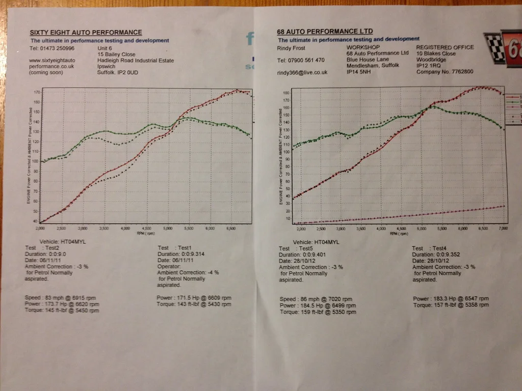

Before & after K-tec Induction Kit graphs
Greeny.
  440i + 182

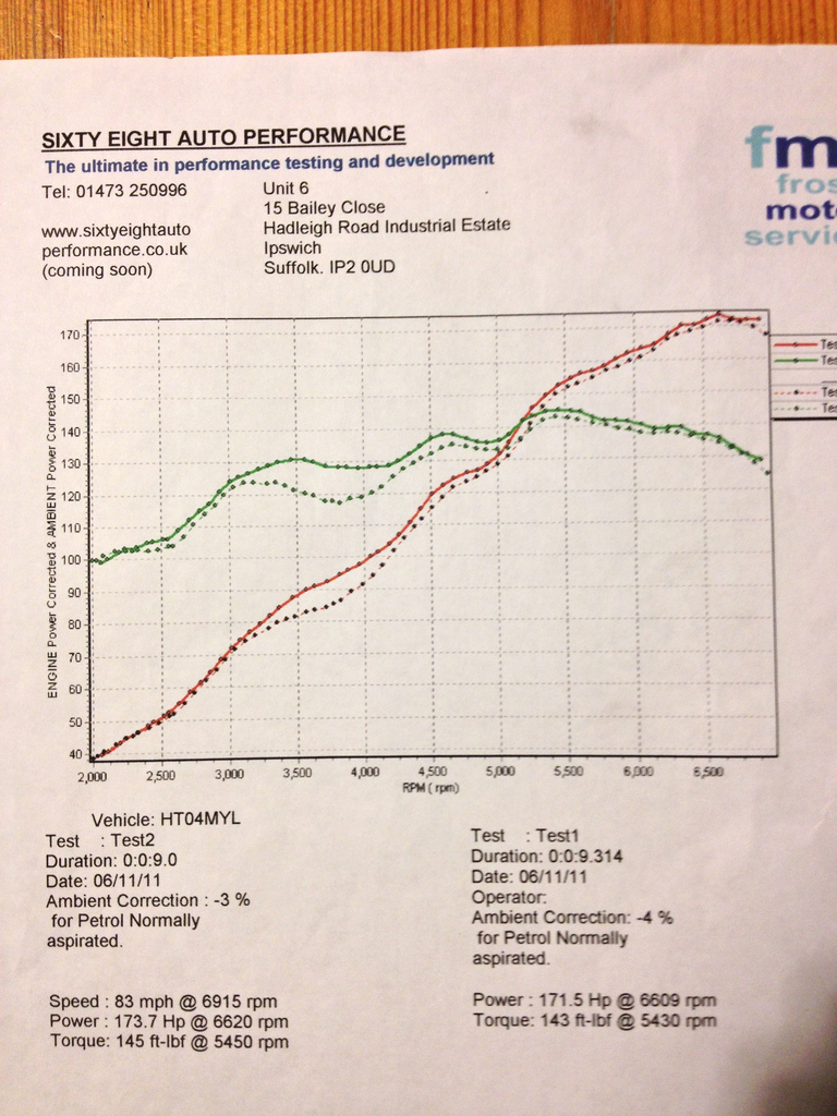

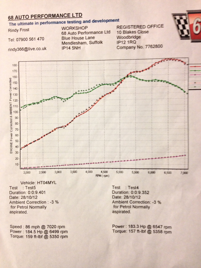

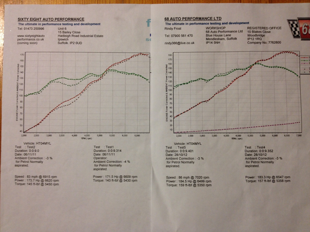

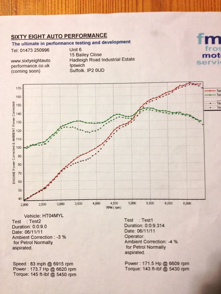

Before:

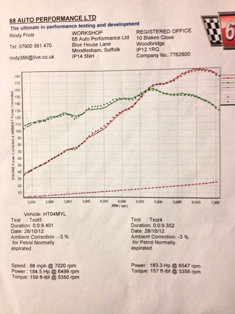

After:

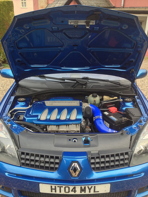

Same rollers & dull cold weather on both runs. Only difference between the two was obviously the date, a KTR IDK & a ph1 twin cat fitted:
Engine mods:
519 Matched Inlets
Ph1 Twin Barrel Cat
BTB Exhaust
RSTuner Remap
KTR Induction Kit
Im happy with the result as this RR is known to give more realistic figures and for the above basic breathing mods I think its about right, would of liked 180bhp but 178 is more than enough without spending the value of the car to get around 20/30bhp more.
Dan
  BMW M4; S1000 RR
Cool.
Dip in power at 5k seems to be gone however since you've made 2 changes between the dynos it would be hard to make a conclusion. Imagine it drives a bit different despite the figures being so similar.
  182/RS2/ Turbo/Mk1
Im unfamiliar with that particular set of rollers, is the -3% and -5% correction saying it took 3 and 5 percent off the measured figures, or that it added it on?
Nice to see you lost the little dip that was there before, wonder if that was down to the change in cat or the change in filter, im sure you can notice that being gone when driving :)
Obviously not the sort of huge gains that people were at one point claiming this would do, but it does seem to have made a slightly improvement for a large chunk of the rev range, so its certainly better with with the different car and inlet than it was before if those readings are correct.
Main advantage of those setups is the noise though, they might only gain a couple of lbft but they gain about 20% in acoustic horsepower :)
  182/RS2/ Turbo/Mk1
4bhp and 3lbft, from the combination of the induction kit and cat done together, there isnt a seperate graph for each mod though so no way of knowing which one made how much difference out of that total.
The gains look reasonable Dan, and as we know these rollers are accurate on figures. The noise alone is worth it!

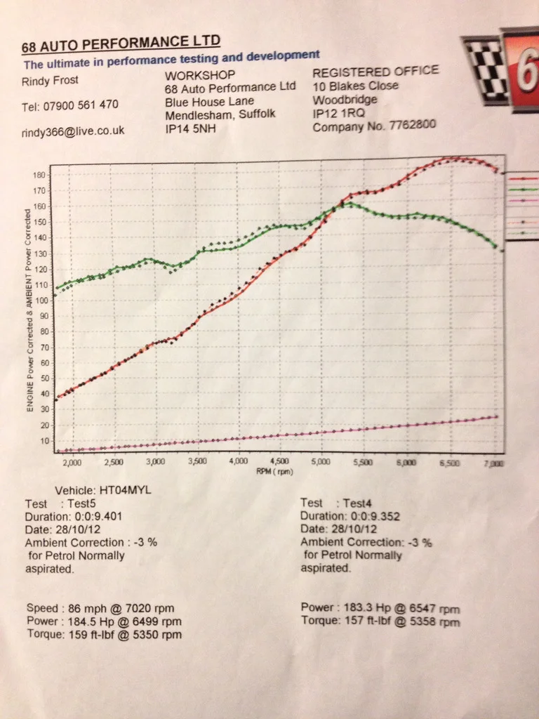

My before and after graphs on the same rollers on a very similar dull cold day
Before
http://
Untitled by Rhys Beal, on Flickr
After
http://
Together
http://

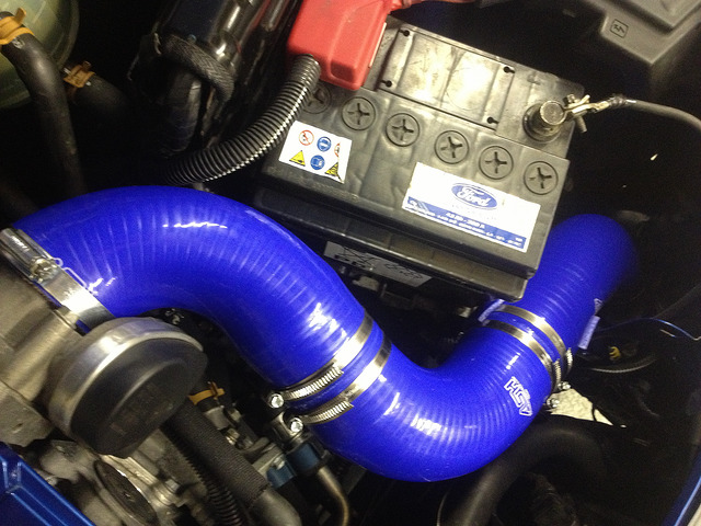

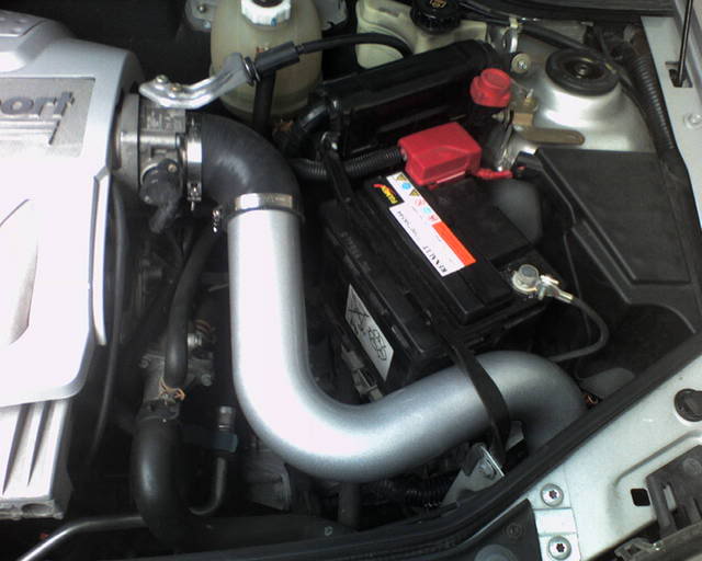

The silicone pipework follows the same route as the old K&N Typhoon from the ph1 172 and the filter is an ITG Maxogen
Engine mods:
- Signiture Pikey induction kit
- Milltek exhaust on the dyno (now has the new BTM one)
- Silenced decat

Thats incredible. 10hp gain and 14ftlb gain. I'm interested to see some pics of your induction kit!

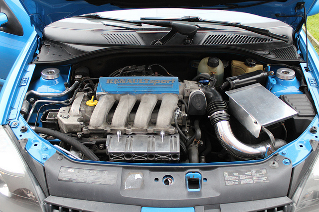

So you had a 90 degree alloy pipe, a 90 degree silicone joiner and whats after that?. A straight bit of alloy pipe connected to a filter?.
Correct. It was from my Simota airbox. It was a bit of a struggle getting the filter past the headlight adjuster.
  LY R26 #288
90 degree alloy bend 70mm outer diameter £16.08
90 degree silicone bend 70mm internal diameter £17.44
ITG maxogen air filter 70mm outer diameter. £63.84
Thats what I've come up with. thats using the standard bend from the throttle body. Wonder if the silicone is going to reach far enough down behind the headlight?.
How far down behind the headlight does the filter actually go?.

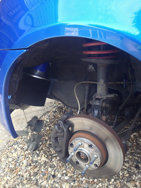

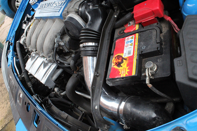

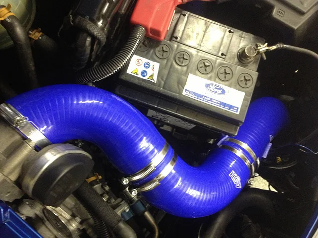

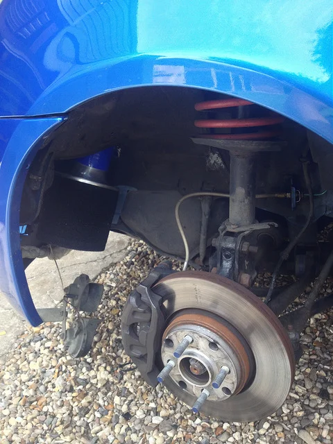

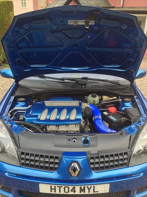

Also here are a couple of pics of how my induction kit looks.
http://
http://
Here is a pic from when I mocked it up. It now sits ever so slightly lower and obviously I relocated the horns lower down on a bracket and put the arch liner back in.
http://
I made the kit from 2 70mm 90 degree bends and 1 70mm 45 degree bend with ally joiners inside.
Realistically the setup is flawed massively by the fact that nothing fits. Because I have xenon lights the pipe is perilously close and does require off cut pieces of hose slotted in as you can see in the pics to stop it wearing through the pipe. Not a product that could ever go on sale for anything but the ph1 172 because there just isn't space. Makes good power though:)
